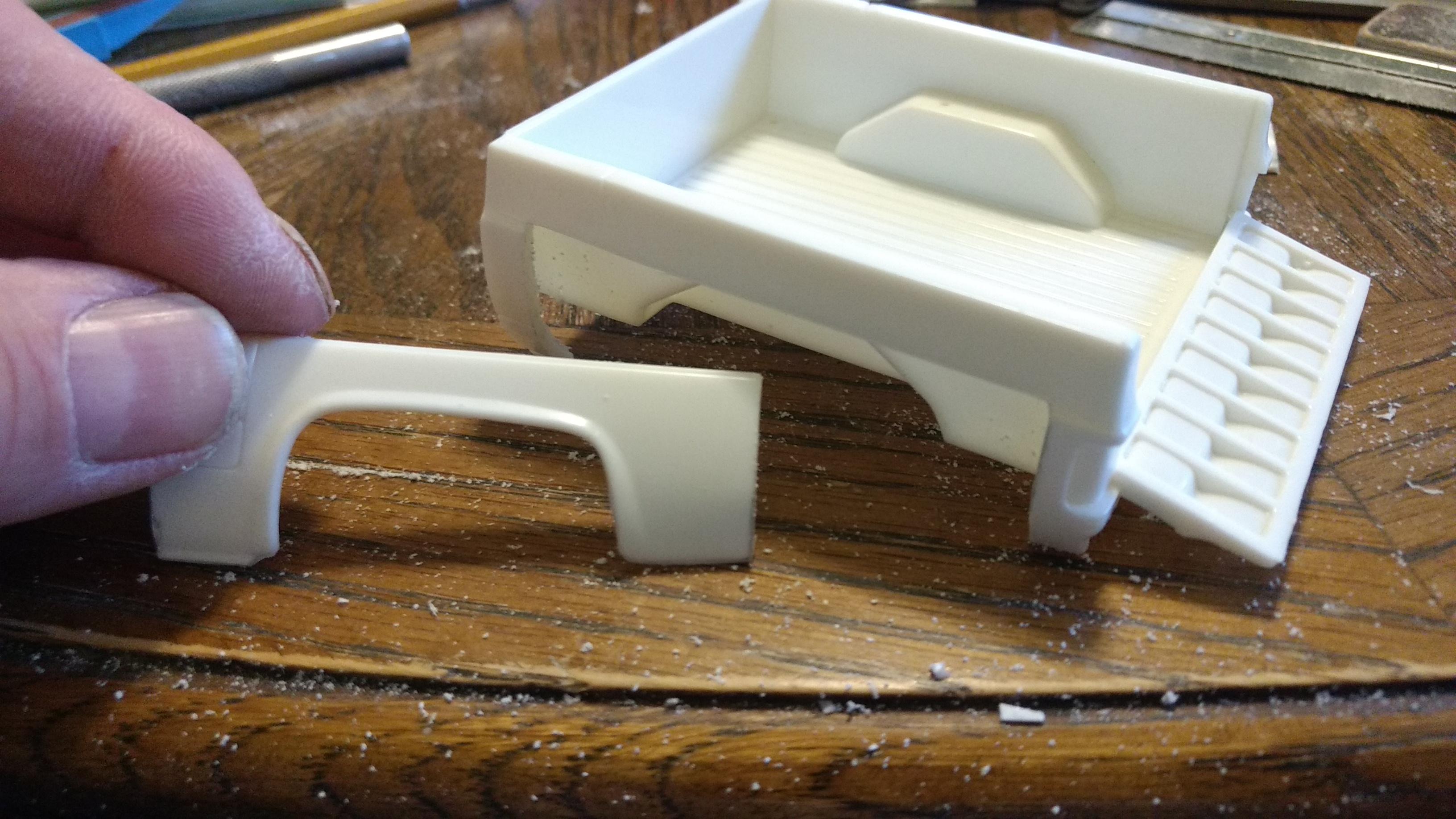

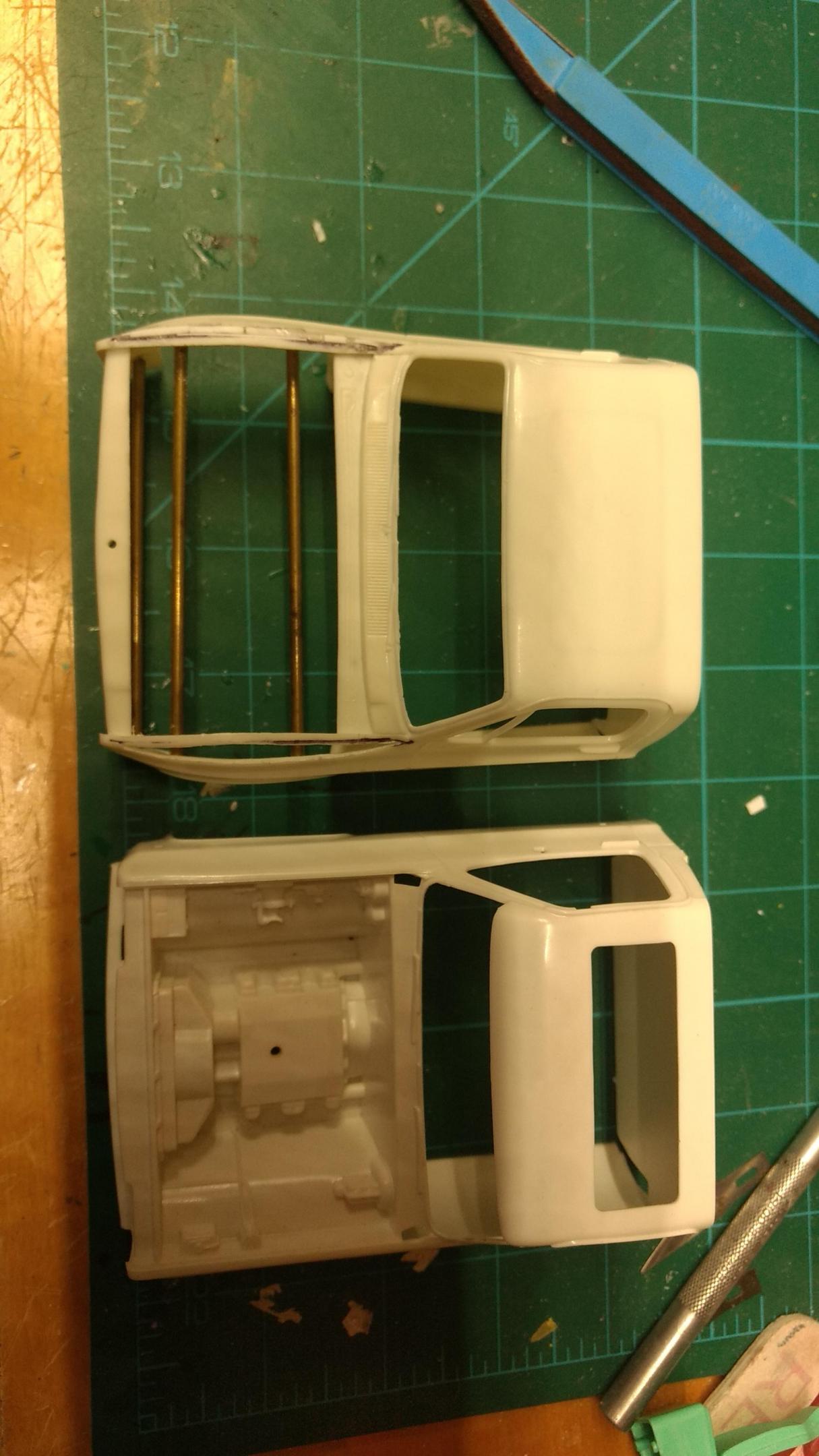

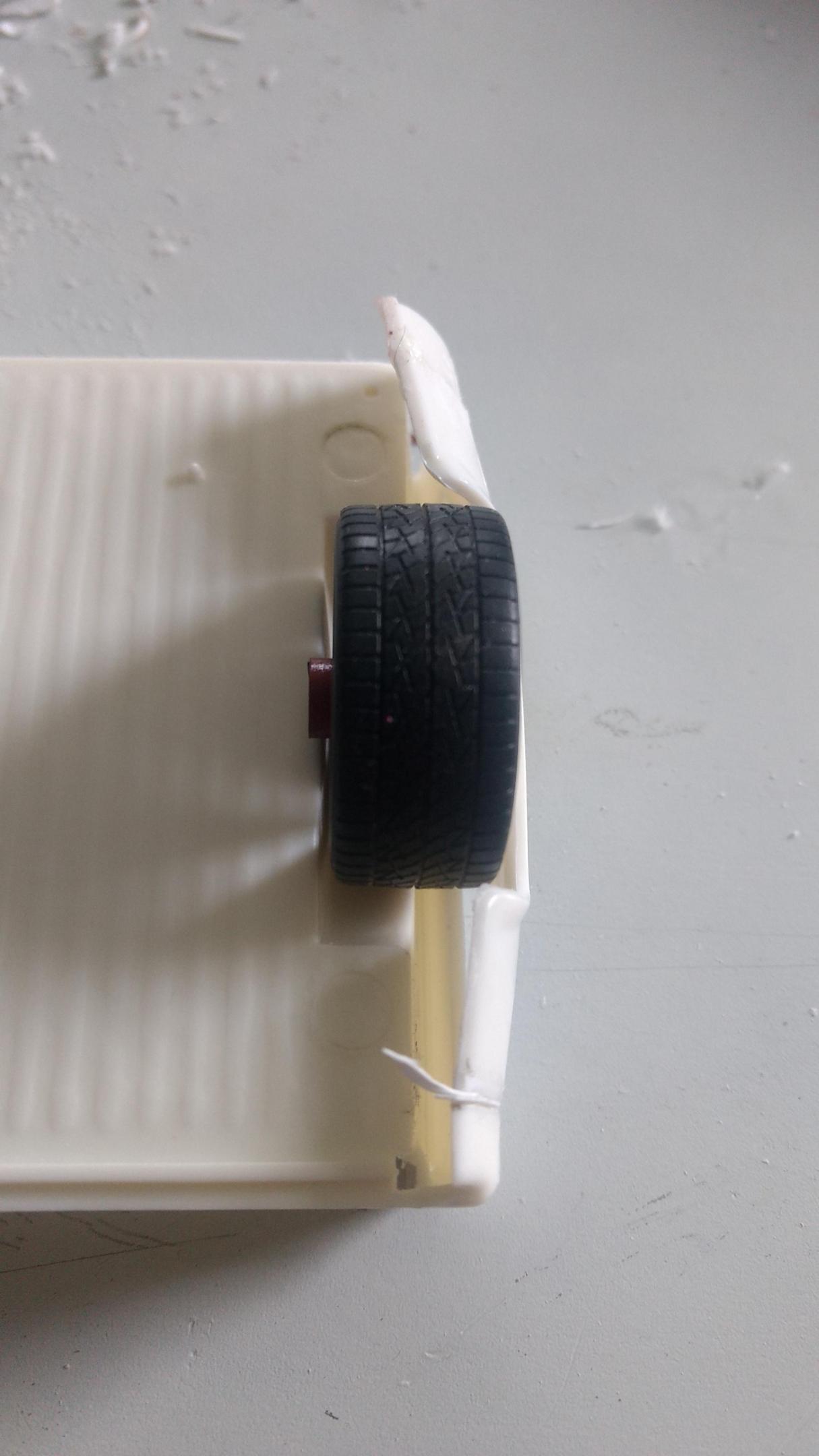

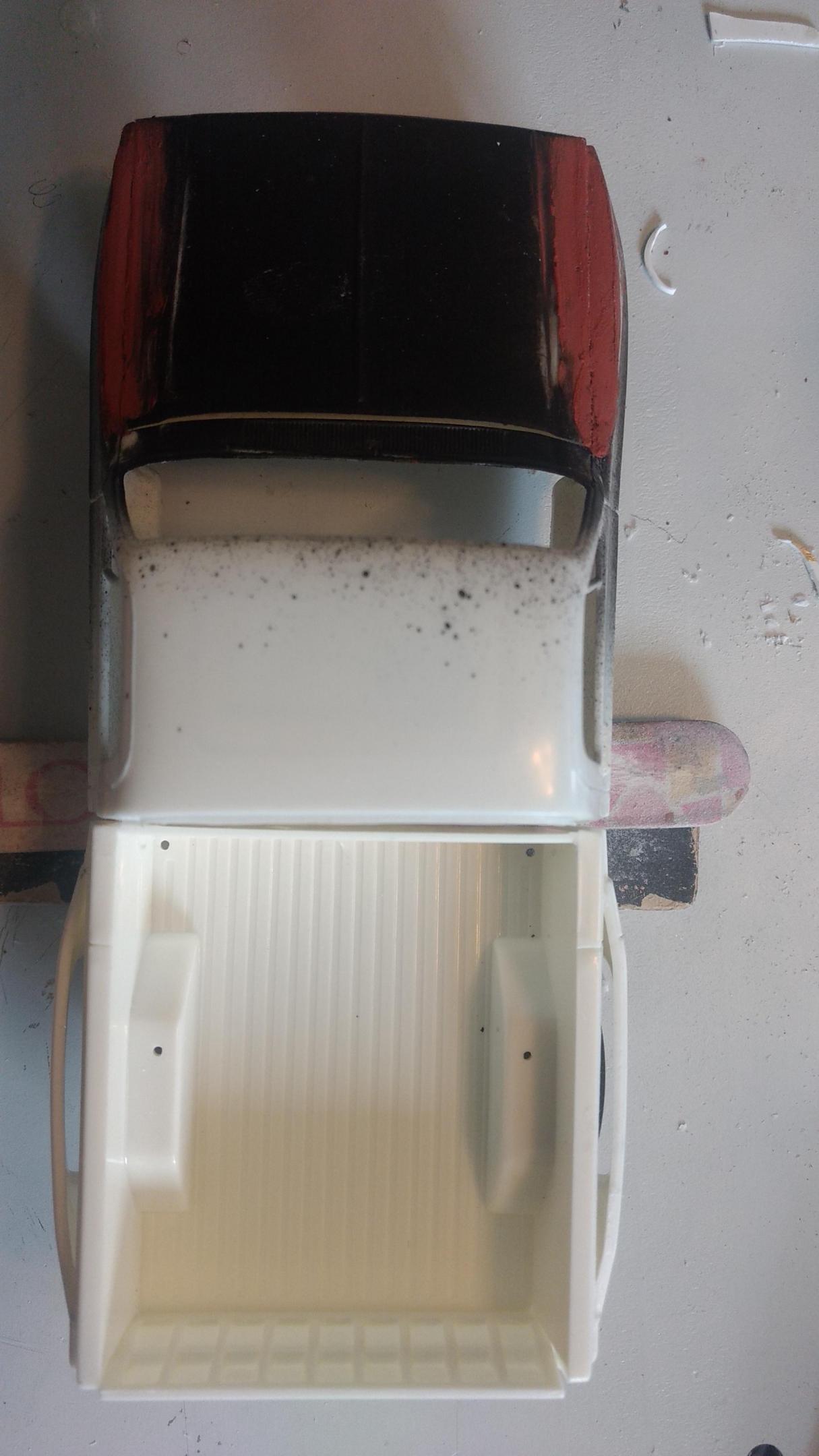

I've been working a bit on this idea of widening the fenders of this squarebody. I was curious to see what it looked like. The rear fenders are wide enough now that I don't need to widen the wheel wells in the bed. I will need to raise or remove the tops in order to lower the bed. But, at least this way, I won't have to cut up the bed floor details. I'll be making a custom frame and suspension for this. Any comments or criticisms welcomed.

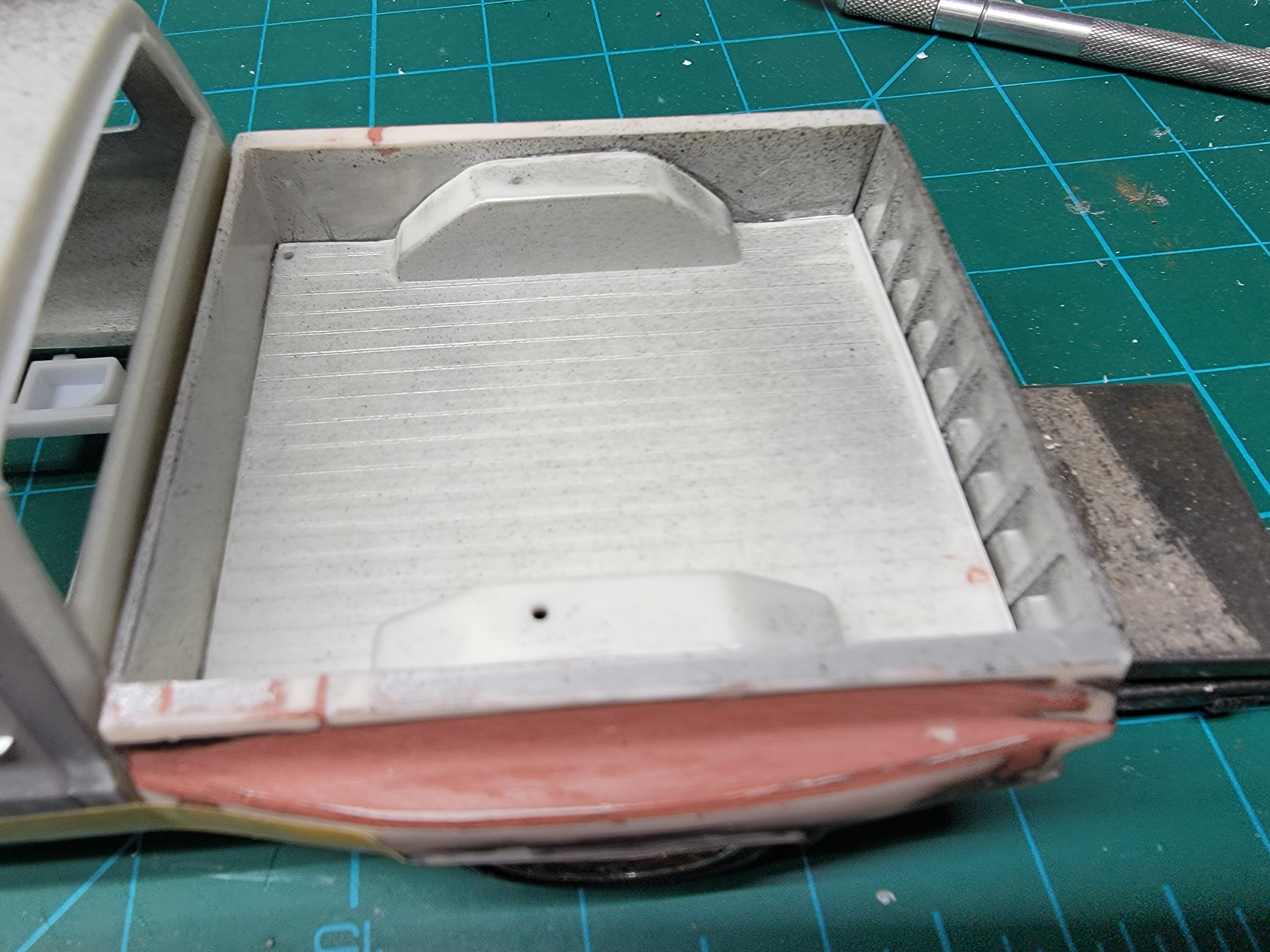

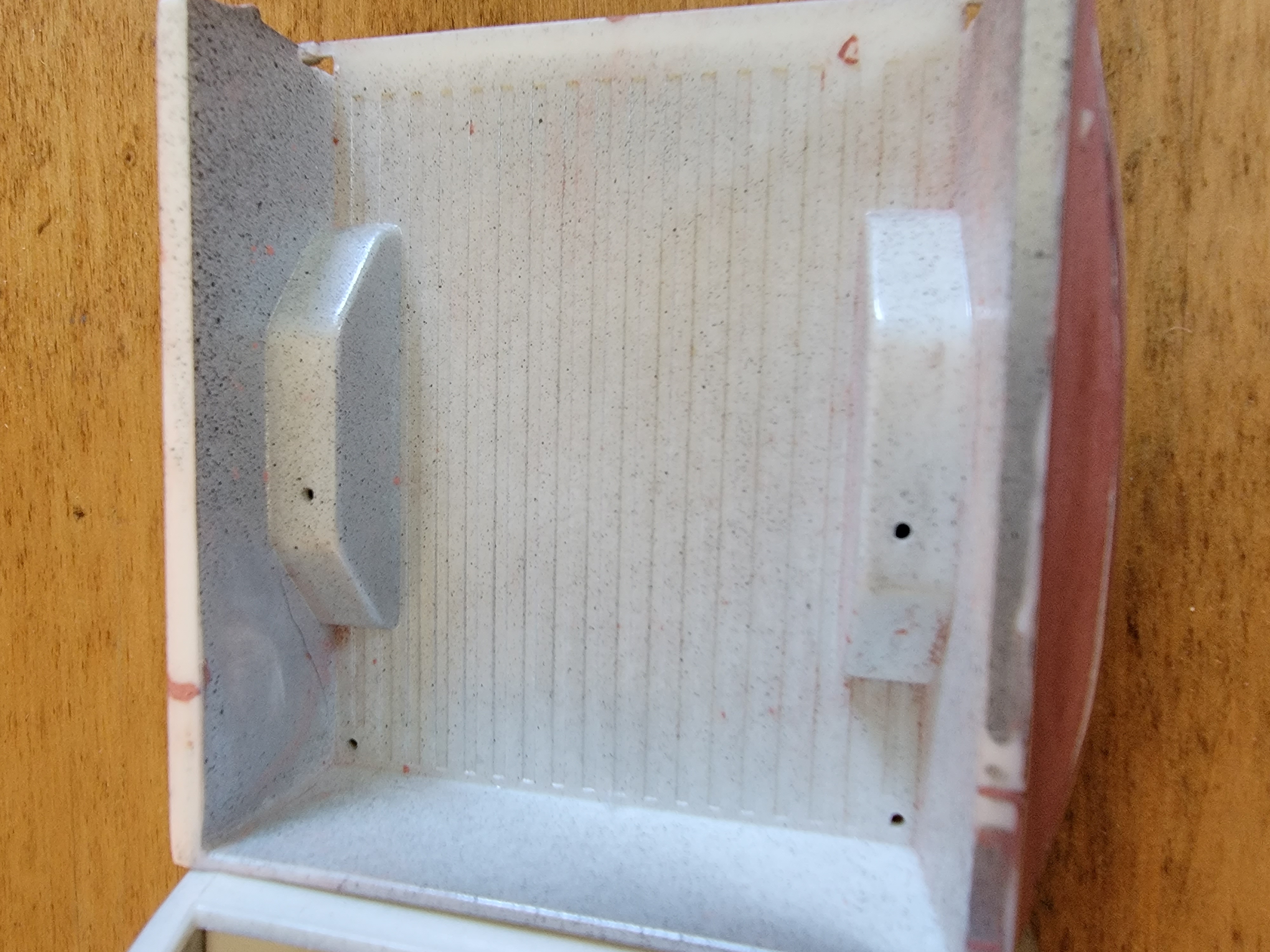

Brought this one back out and did some putty work on the bed. Getting excited about it again. I like that I only need to cut the tops of the inner wheelwells and not the bed floor to lower the rear. Going to start work on bagging the chassis.

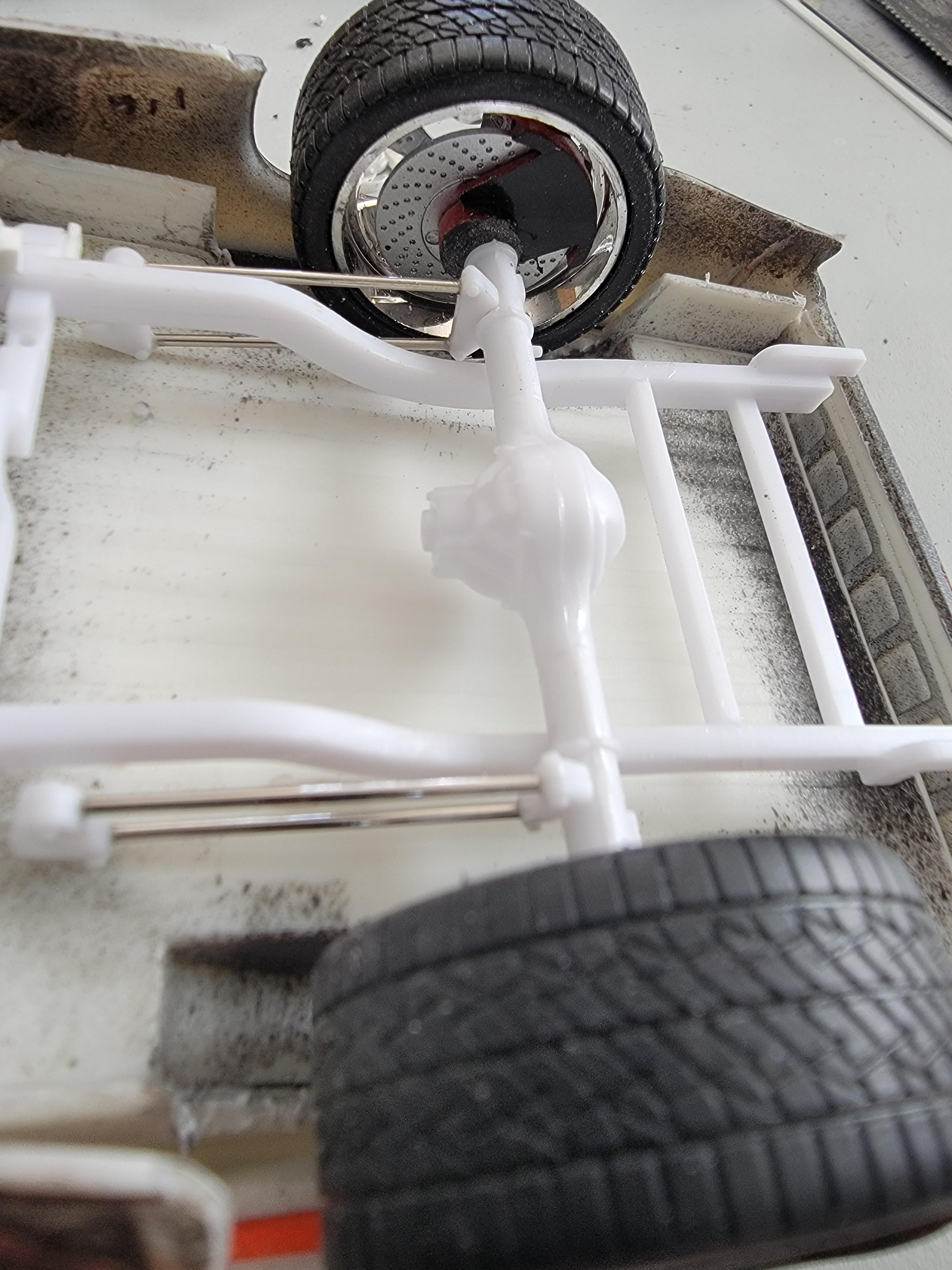

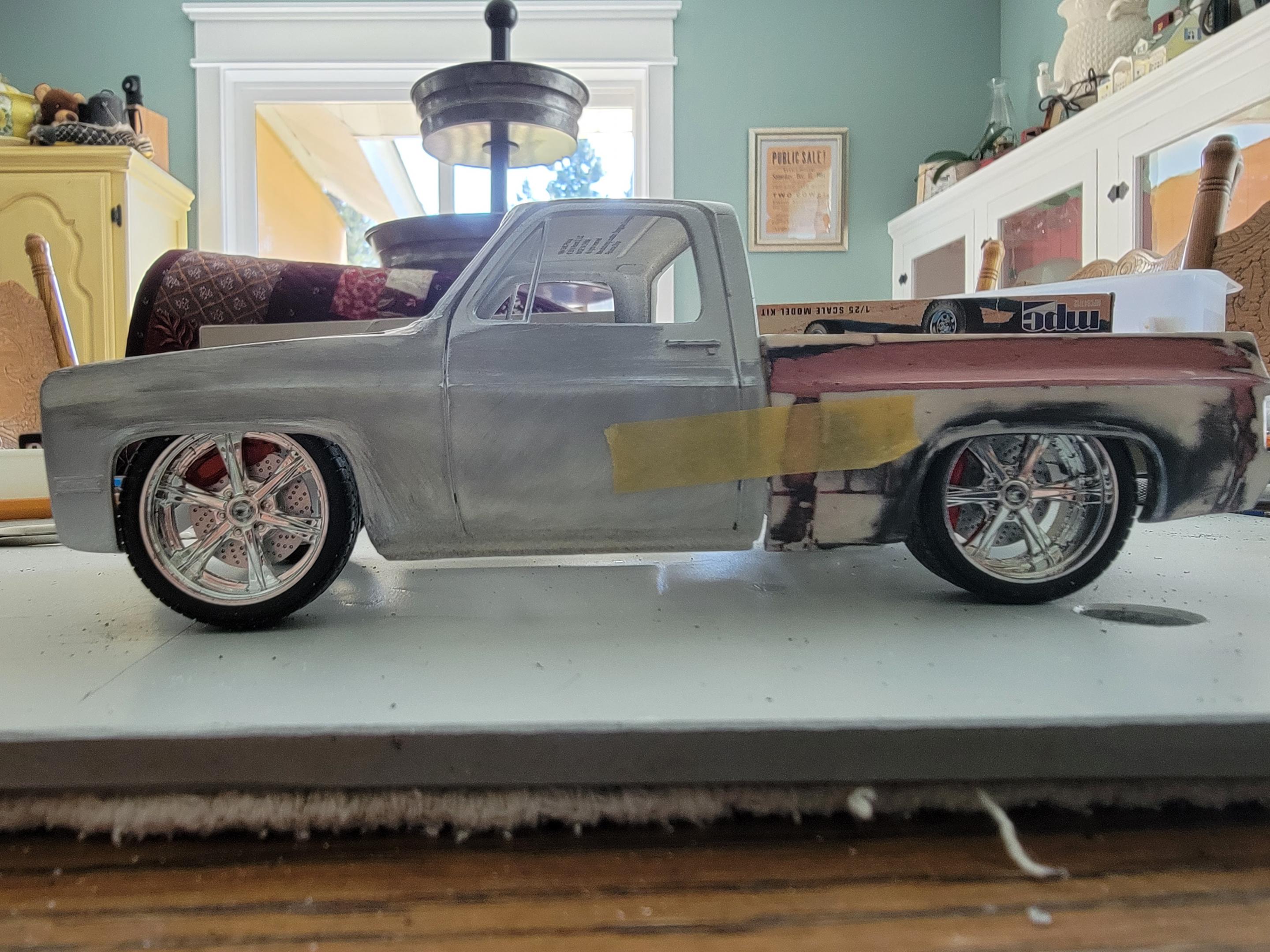

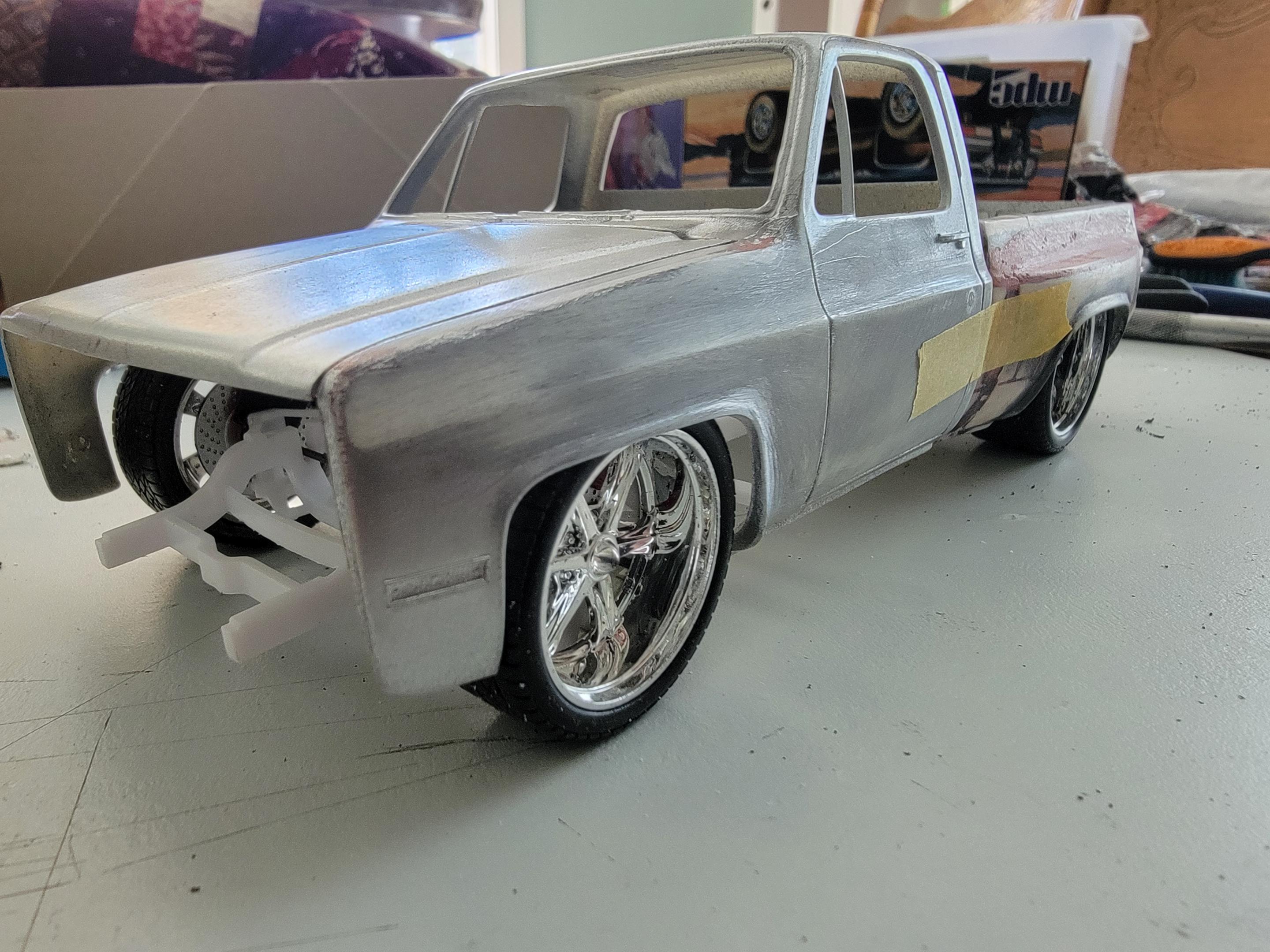

Been working a bit at a time on this lately. Using the frame from the Foose F100. I reworked the rear four link by removing the plastic bars and putting in longer metal bars to improve the.look and move the rear axle back a bit to the center of the wheelwells. I also raised the bed floor a bit.

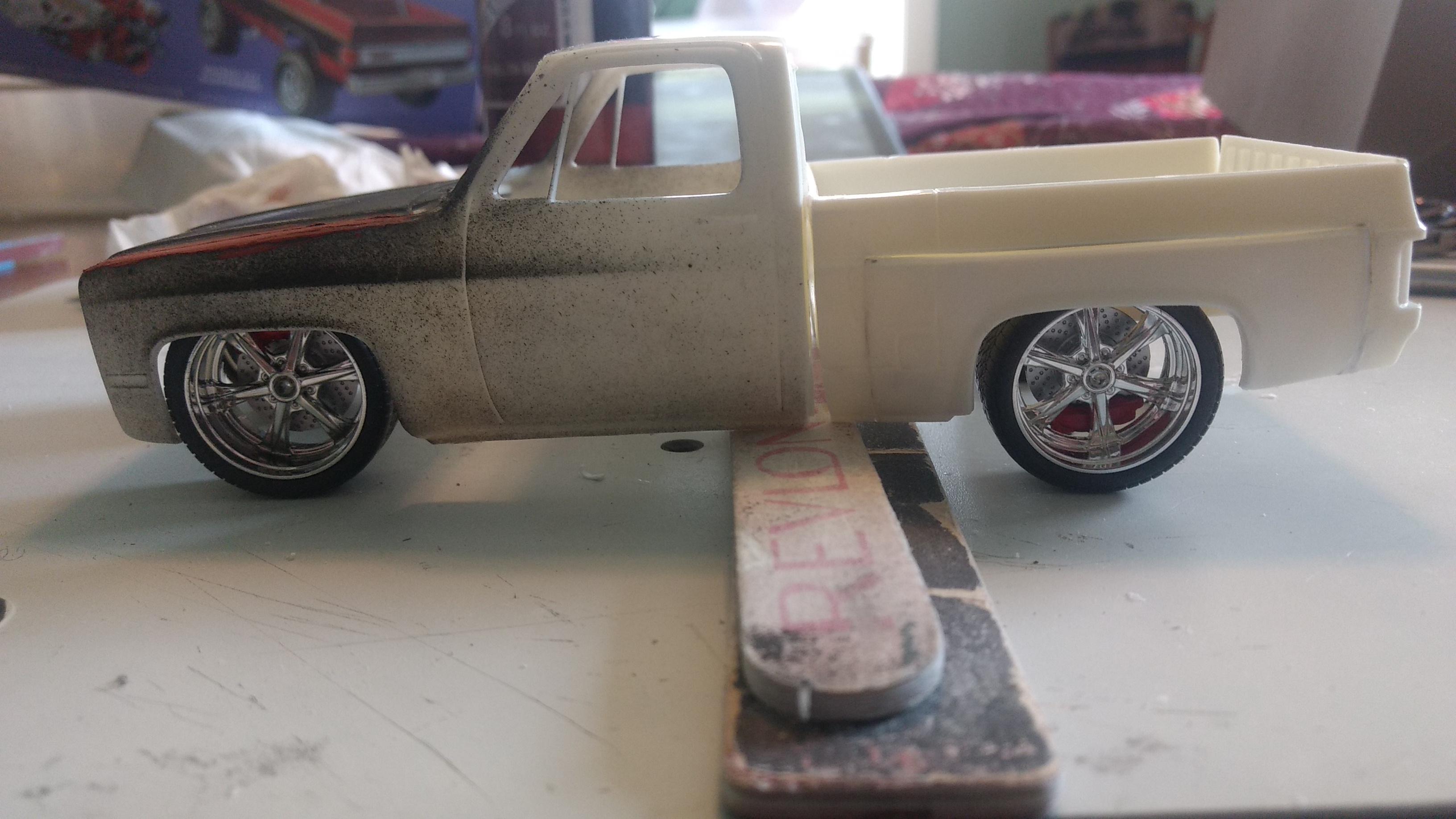

Tonight I temporarily set it up on the wheels to see what it looked like. Still needs some modification. The first order is to narrow the front track. Easy enough by cutting down the mounting posts on the wheels. Next is o get it a bit lower somehow.

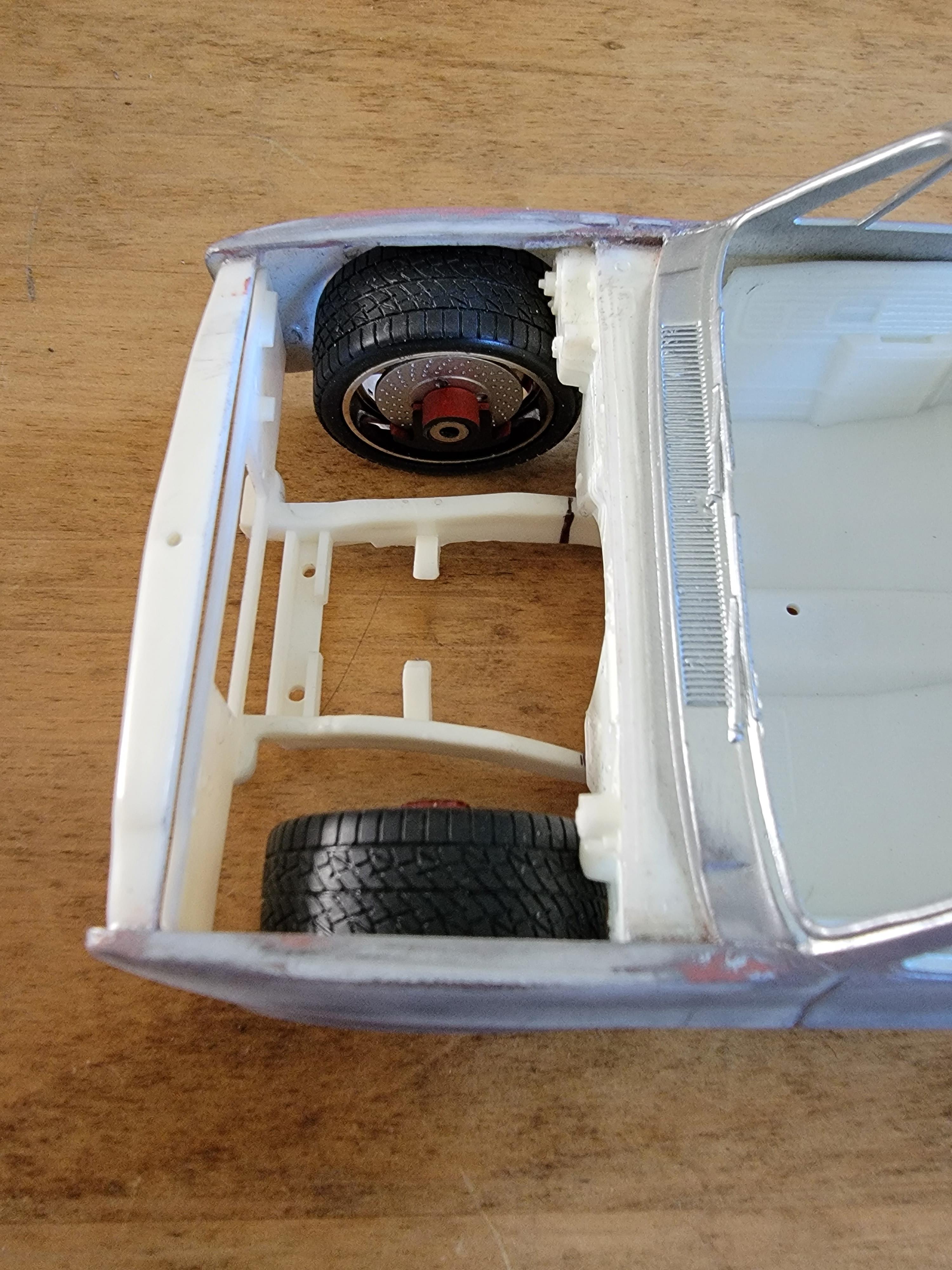

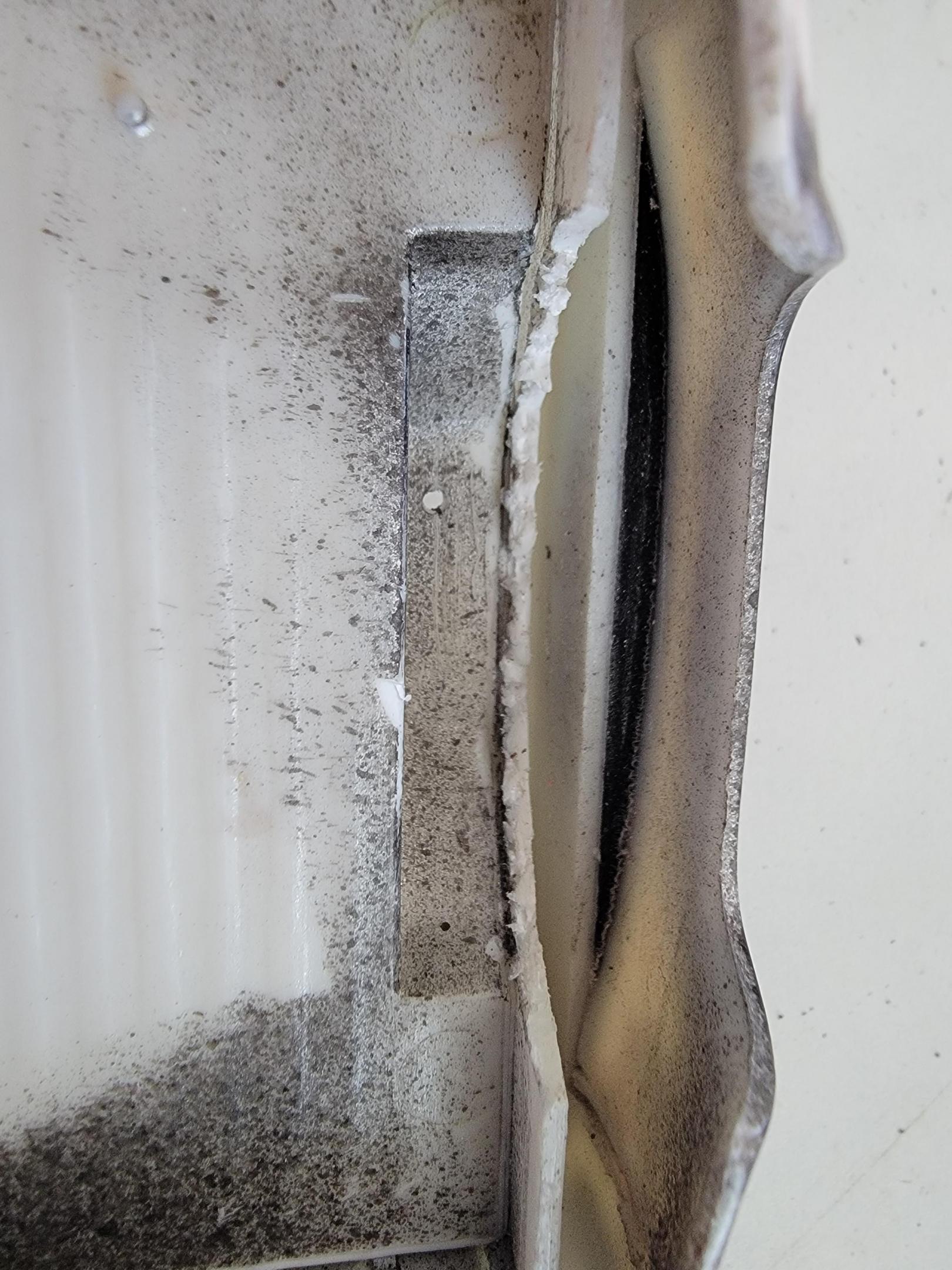

Got a bit more adjusting done on the suspension. In the rear I had part of the plastic where the inner wheelwell wells had been that needed cut out. (Second pic)
In the front the wheel hubs needed to be shortened to get the track narrow enough to fit inside the fenders.
I wouldn't mind getting it a bit lower but the rear fenders will not allow it. Plus, as it is it sits level now.

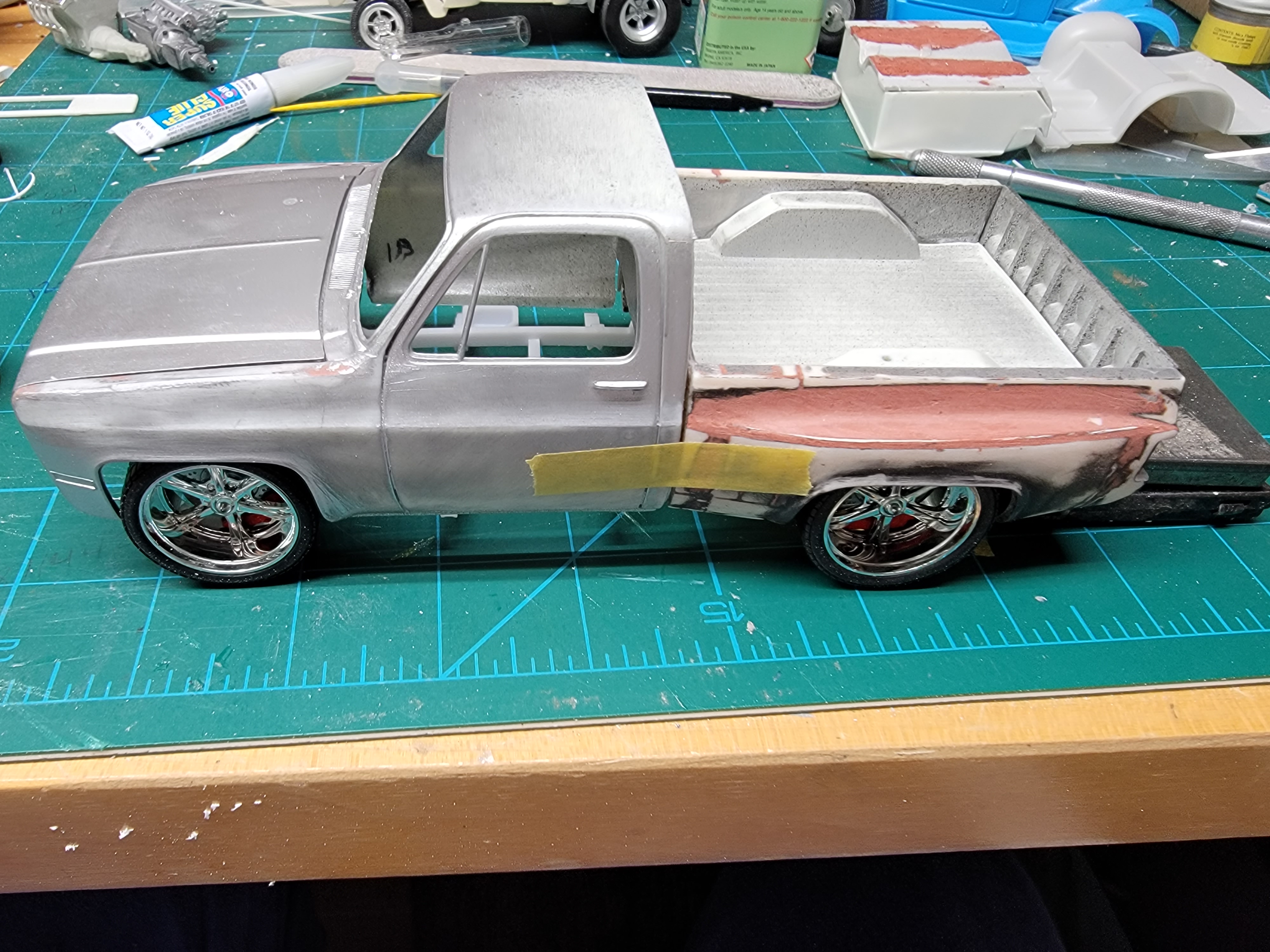

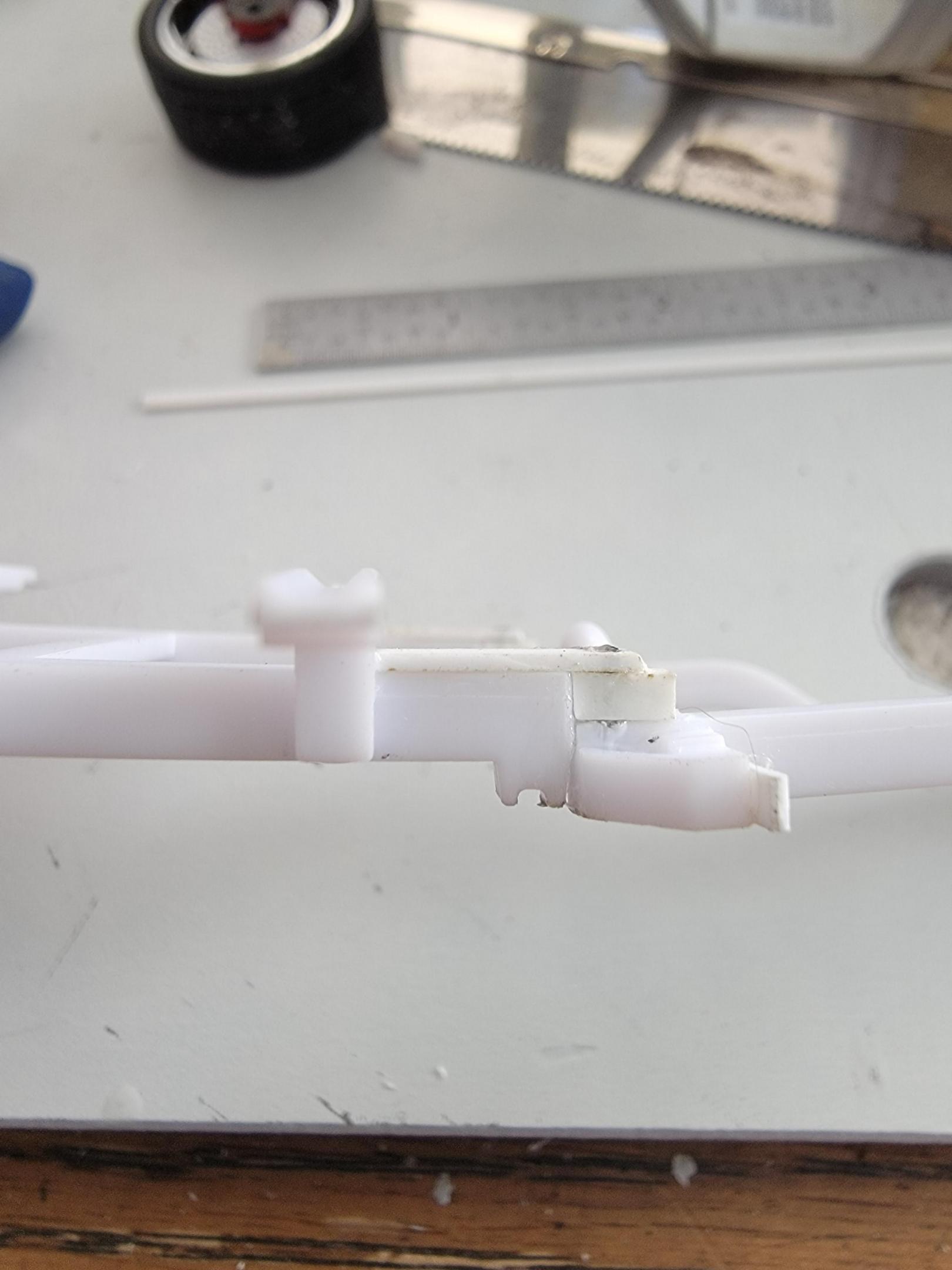

I made a quick mod to the frame in the rear. Ill clean it all up on my next bench session. I cut the frame just past the Cab and added a block to raise the rear of the frame a bit. I did this for a couple of reasons. Now I will not have to add such a tall block between the frame and the bed floor and now my rear axle does not touch the frame.
Later-
