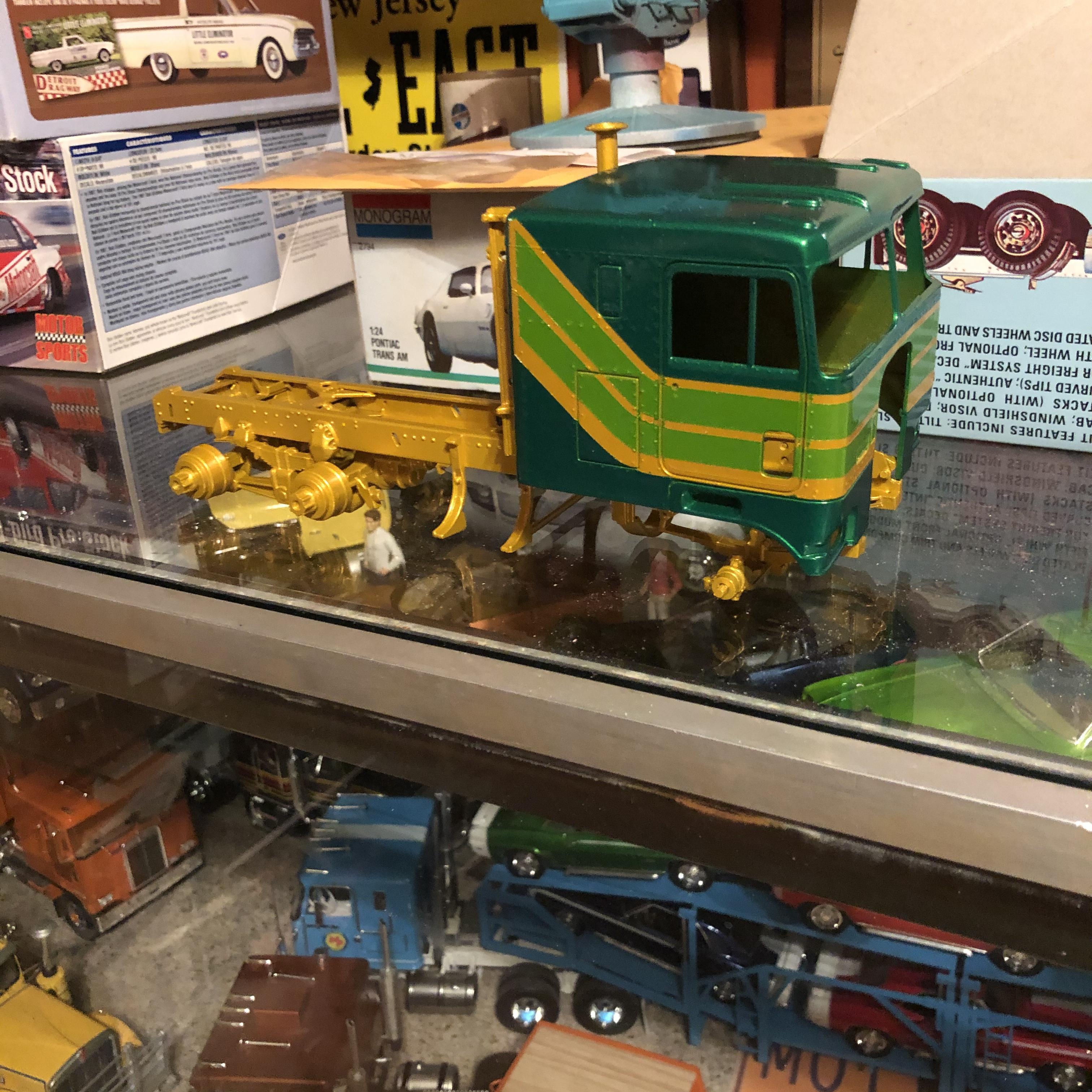

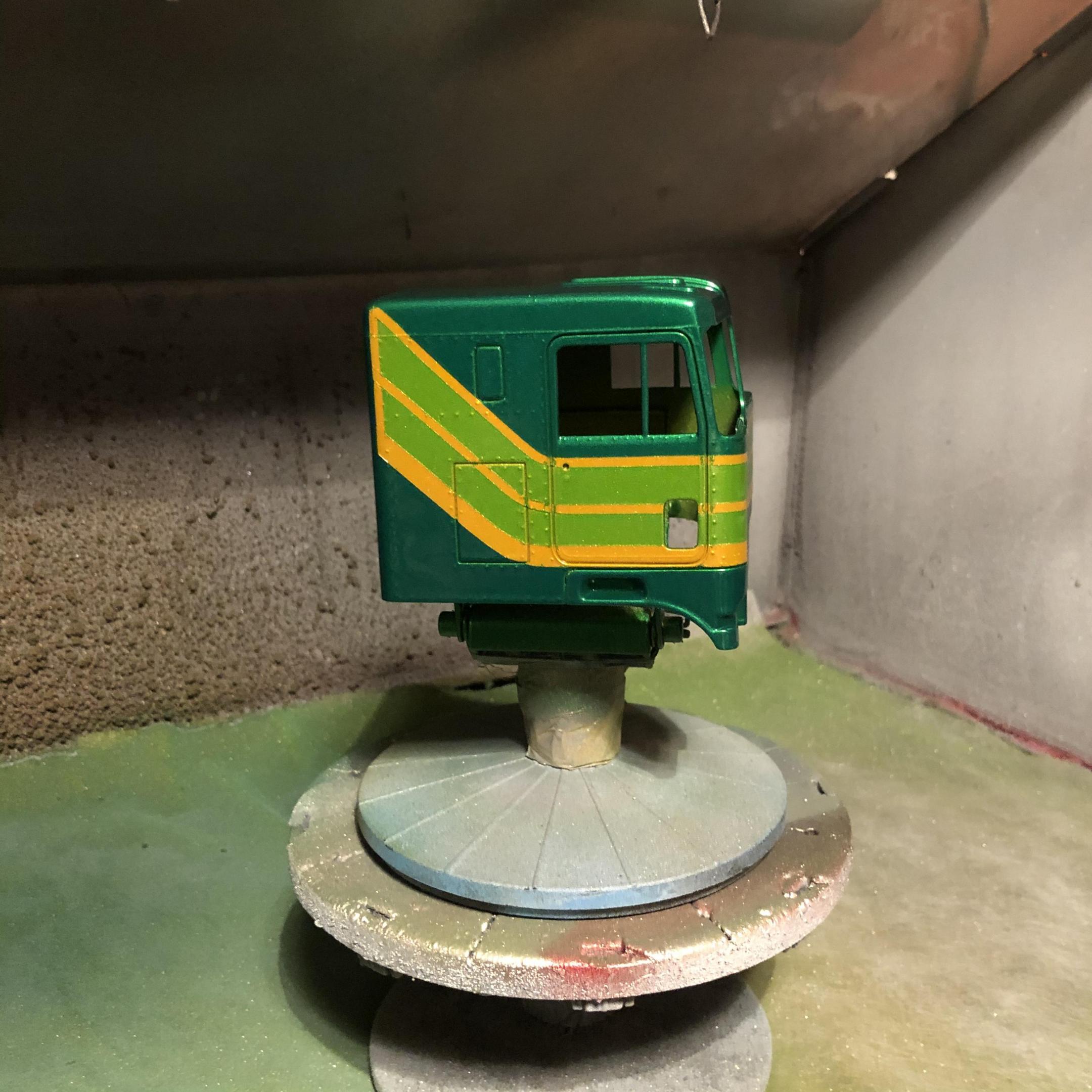

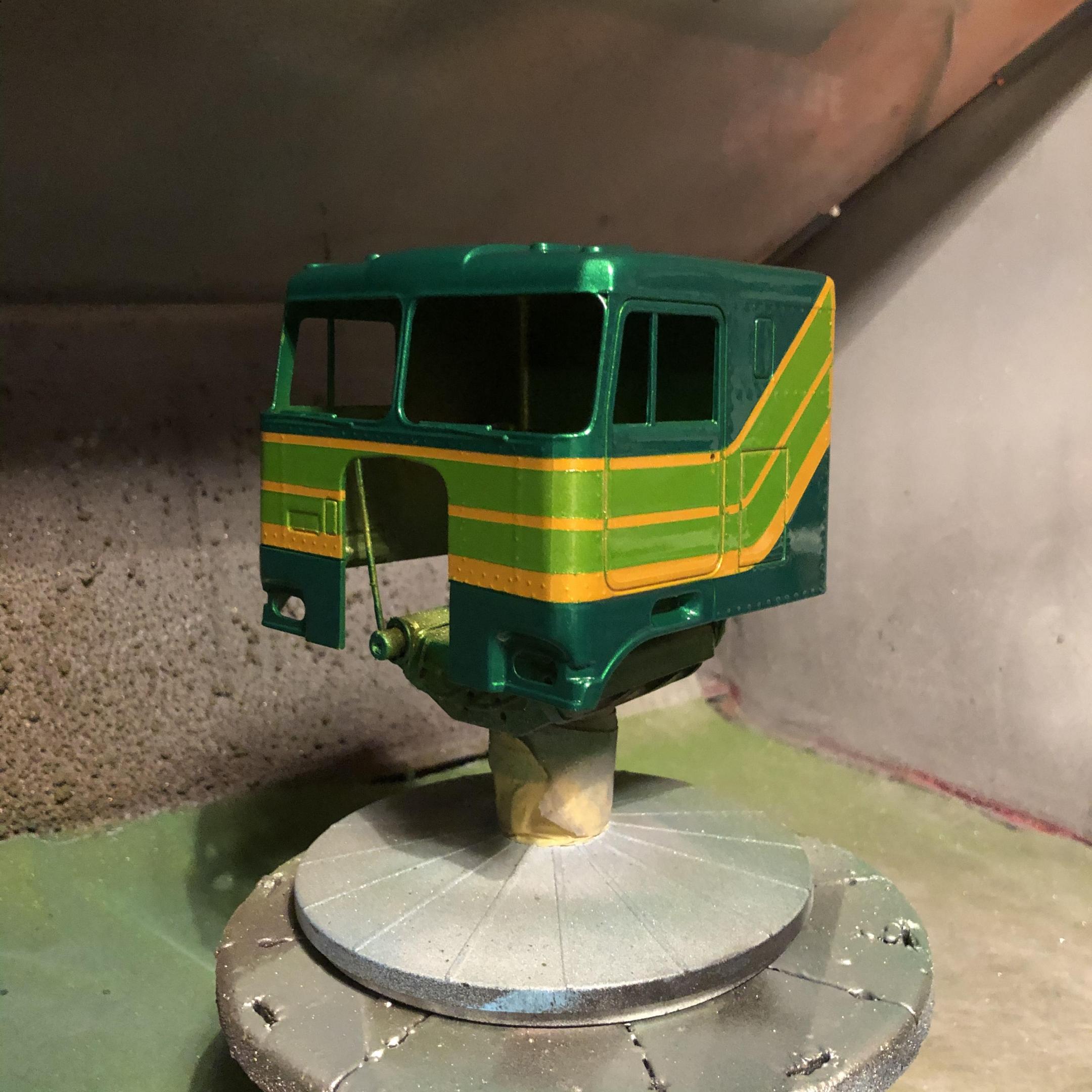

Got some new/different masking tape the other day and wanted to try it out , so I got out a KW cab and had at it. I kinda like how it’s turning out. Don’t know how much will get done from here on in seeing as how the weather has finally come around, but we will see. The plans are to use a grill and tires from double take replicas, and a couple of moebius steer tires.

Nice job!! I don't think I could have done those stripes.
Share this post
Link to post
Nice colors Tom, to avoid any risks, just put the cab in hand-warm water to remove the tape, so that nothing will chip off with removing the tape.;)
Hermann.
Share this post
Link to post
Nice colors.  I like the stripes.
Hermann, good tip about the tape.

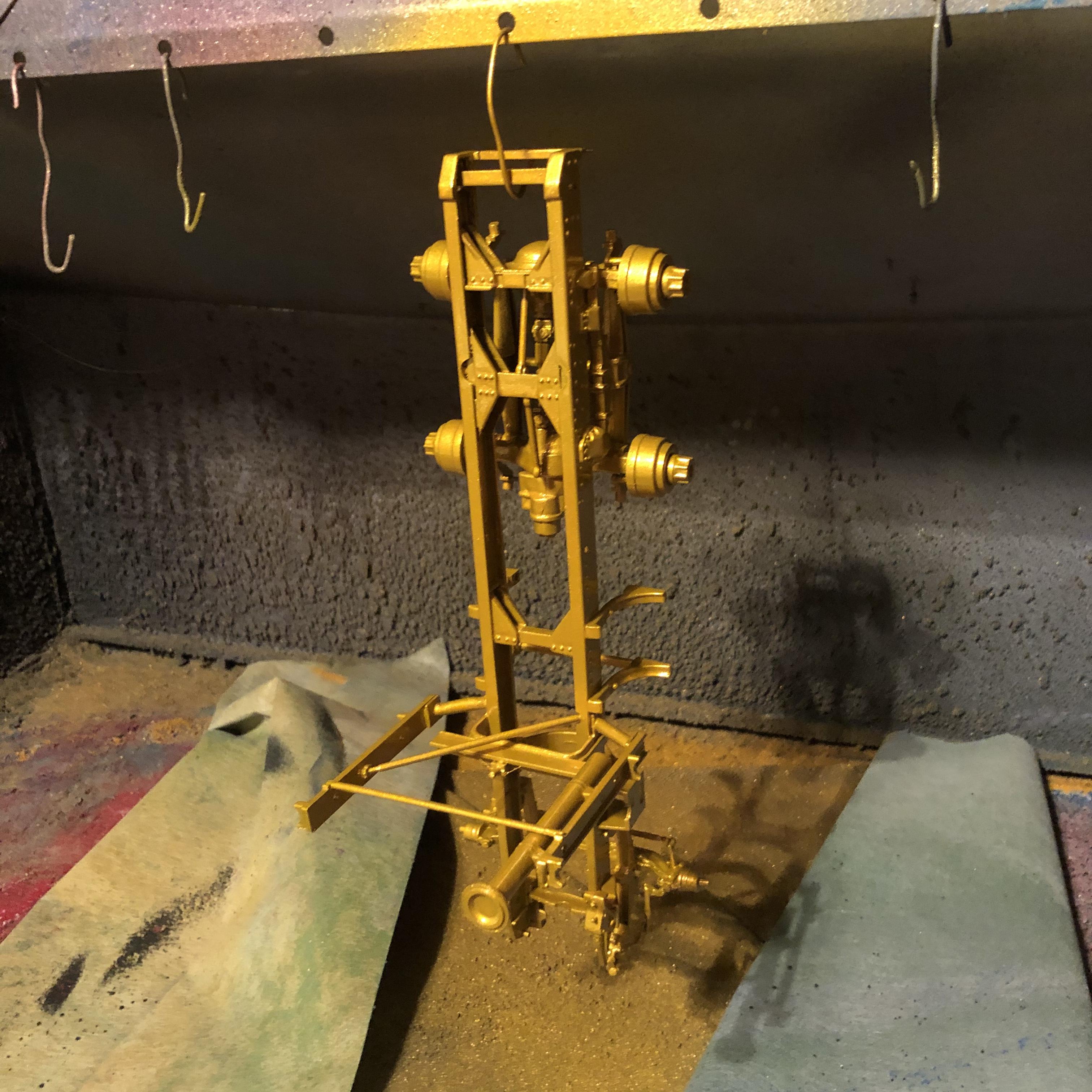

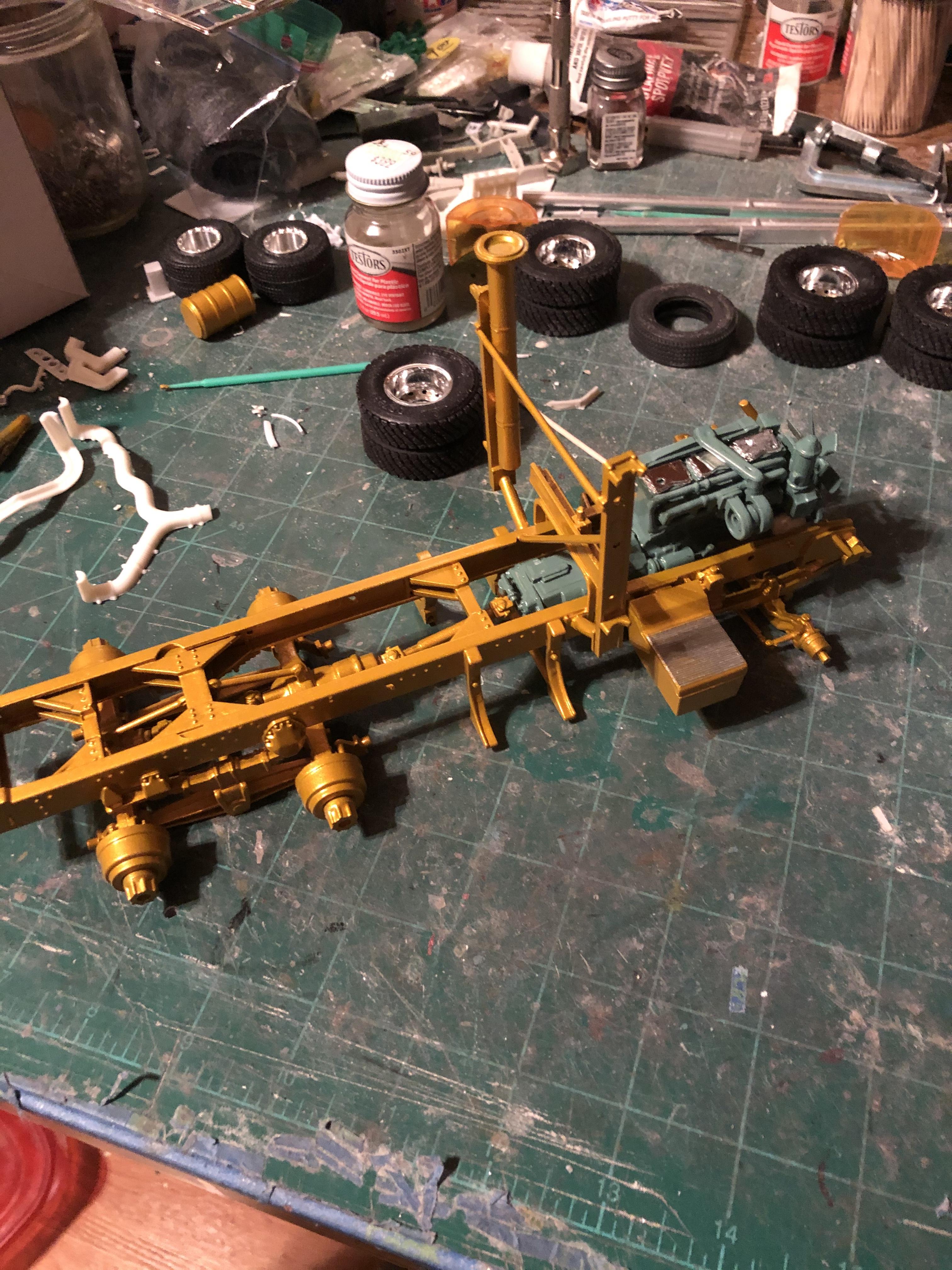

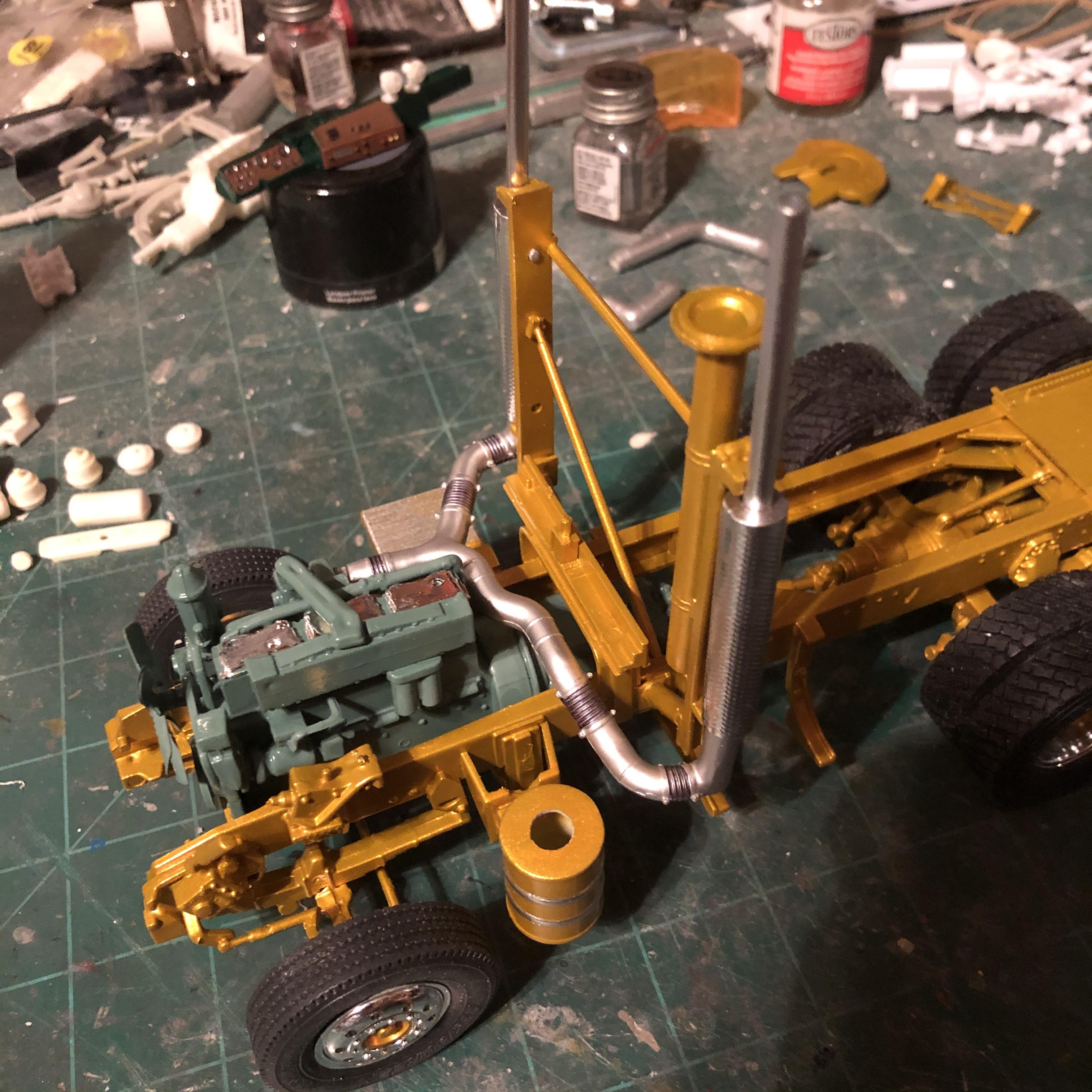

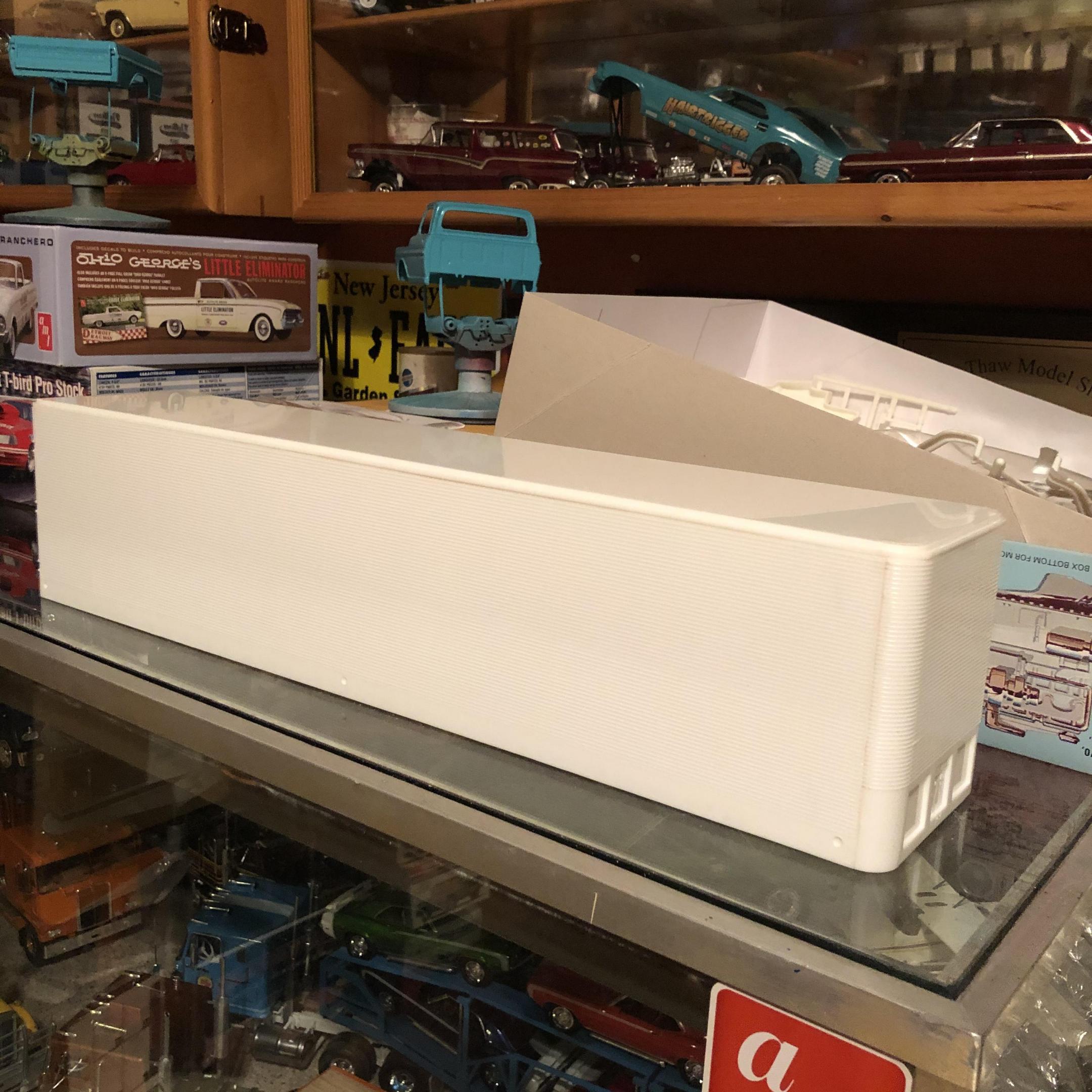

So this build has hit the bench again, I have the frame pretty much done, and a lot of parts in the chrome stripping stage. I also decided to try building a matching trailer, time will tell how the paint job on that works out......

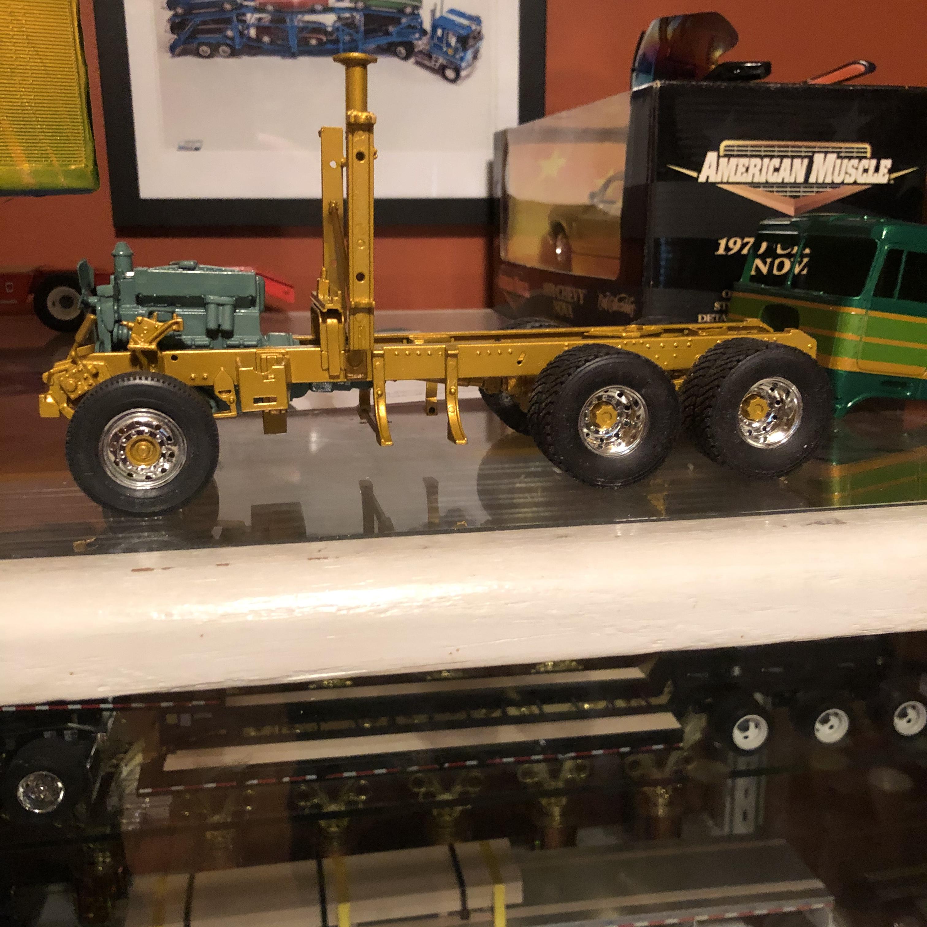

Thanks all, slowly making progress on this project. As usual though, I thought I had enough paint, but need to get some lime ice to do the trailer stripes , it’s always something, haha.
Jerry, the way I do the frame /suspension is pretty straight forward. I glue all the crossmembers to one side ( I use testors liquid glue currently), then to the other frame rail before the glue totally sets up, this gives me the option to tweak it if need be to get it flat/straight. Once that’s all dry/cured,  the suspension springs get glued on, once that’s dry, I build the rear diffs and get all the mounting hardware ready, along with the driveshaft that goes between the diffs, I glue the diff shackles to the beam, and while still flexible, glue the rear diff in place, then do the same with the front diff, I pretty much use the driveshaft to determine my ‘level’. It seems like a lot, but you have enough time to cram all this in before the glue really sets. Hope this helps some.

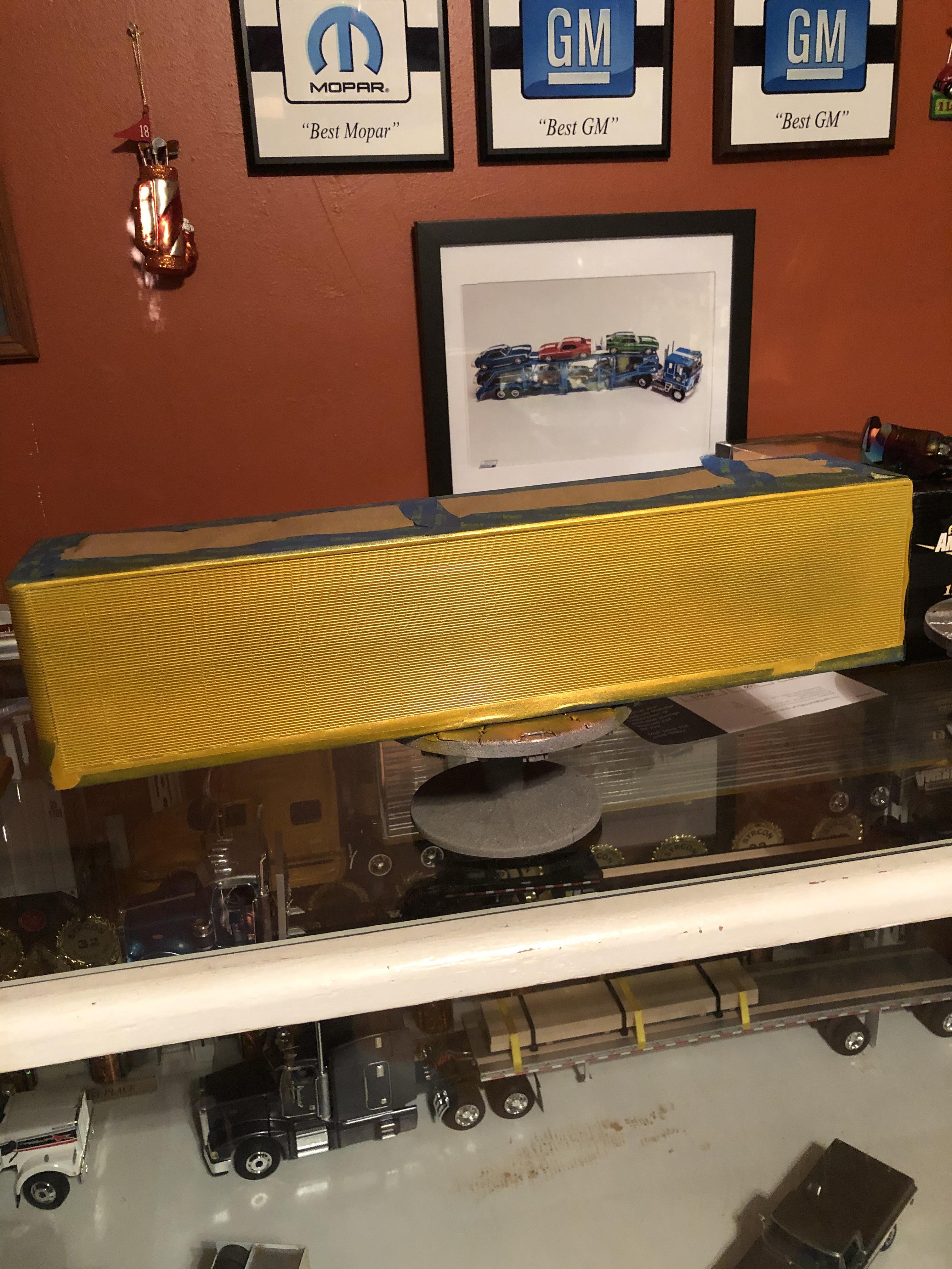

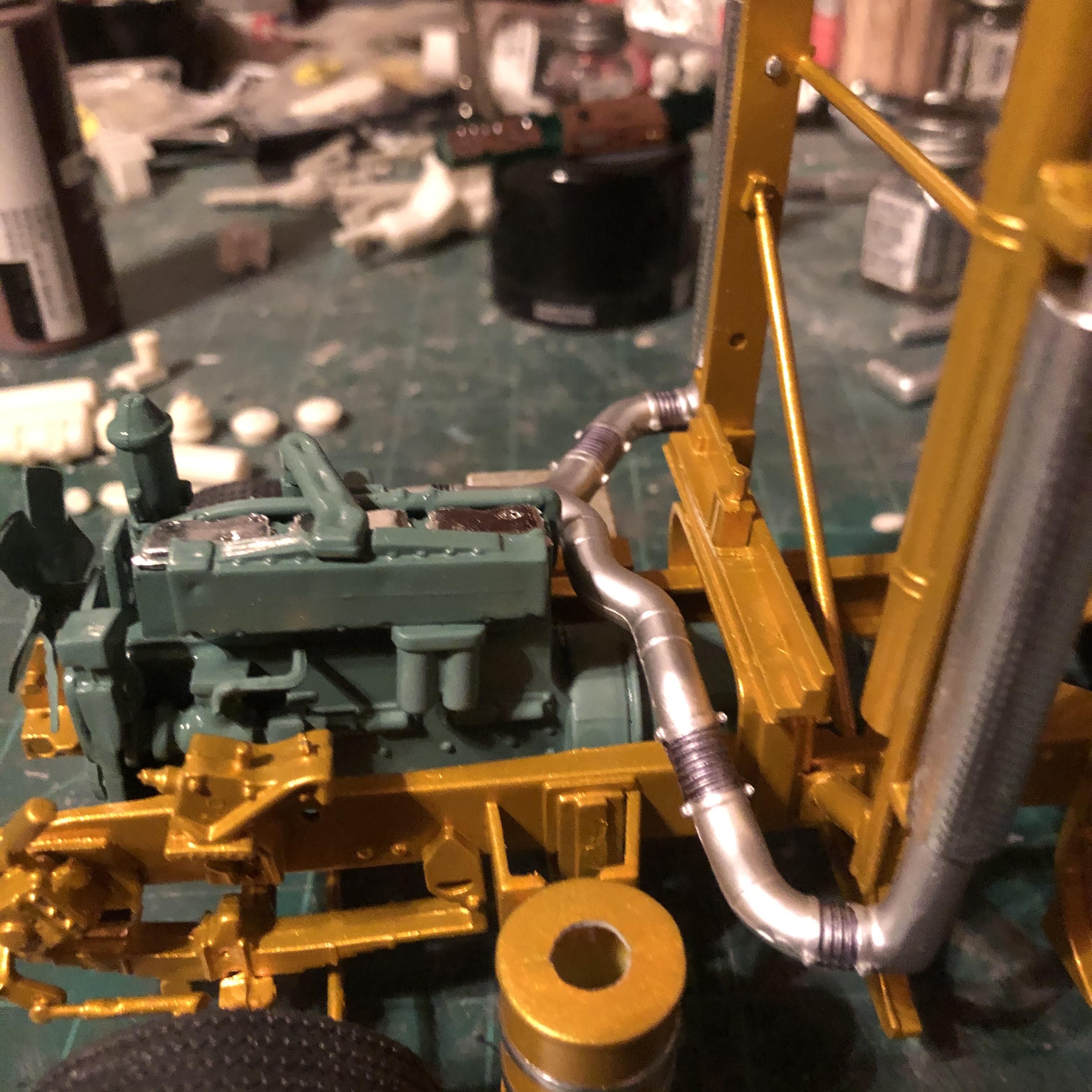

I went with alpine green on the motor to keep with the green theme. Also got the trailer aluminum bits painted, and masks off for the first color, stay tuned......

My goodness!! Look at them flippin' tires, Man!! Nice...
