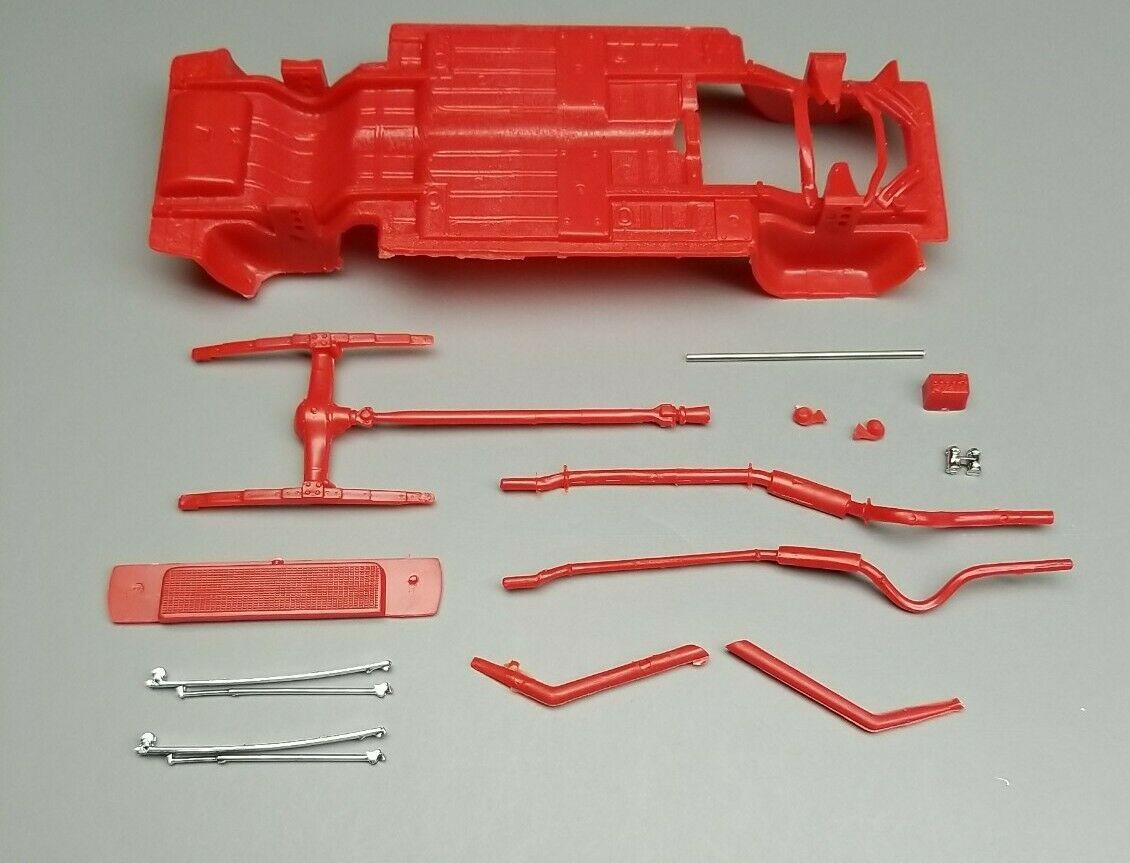

If the presence of rounded and lack of oval mufflers are the worst thing you see in this group of parts, I have no further words for you:
There is not a single separate front suspension piece. NOT ONE. And this is not even a promo style chassis.
At least the exhaust isn't moulded-on , nor is the driveshaft .
The worst example of mufflers I can recall seeing is the exhaust setup of Monogram's 1971 Hemi'Cuda ( every iteration ) ---- then there's the exhaust-pipes-moulded-to-the-rear-axle-assembly of Monogram's 1970 GTX , SuperBird , Super Bee , Road Runner , and 1971 Satellite (later , GTX) .

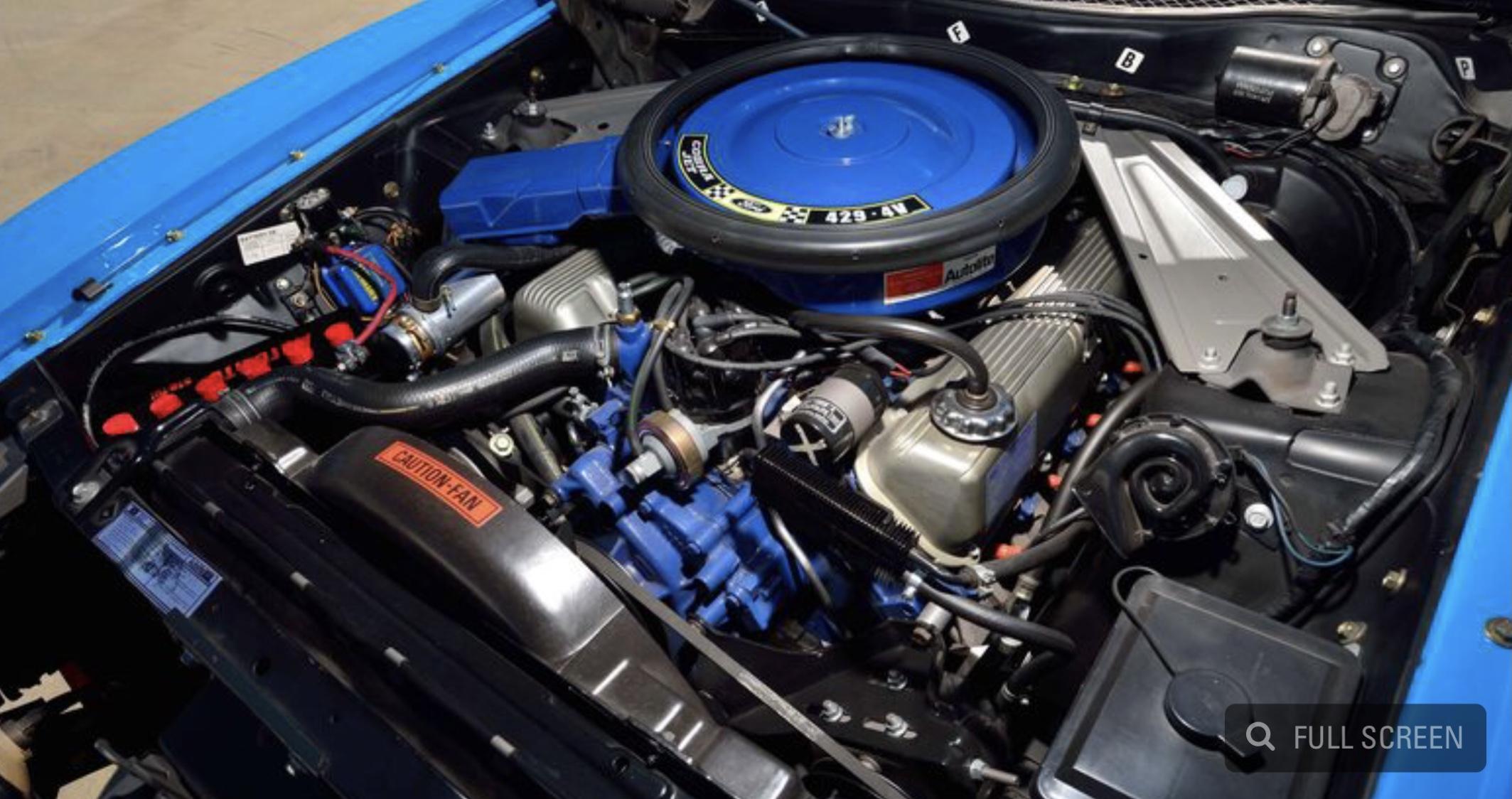

Found this picture of a nice C code 429 in a 71 Mach1.  It’s the non ram-air engine which is usually associated with a Mach1 that does not have the black or silver paint on the hood.

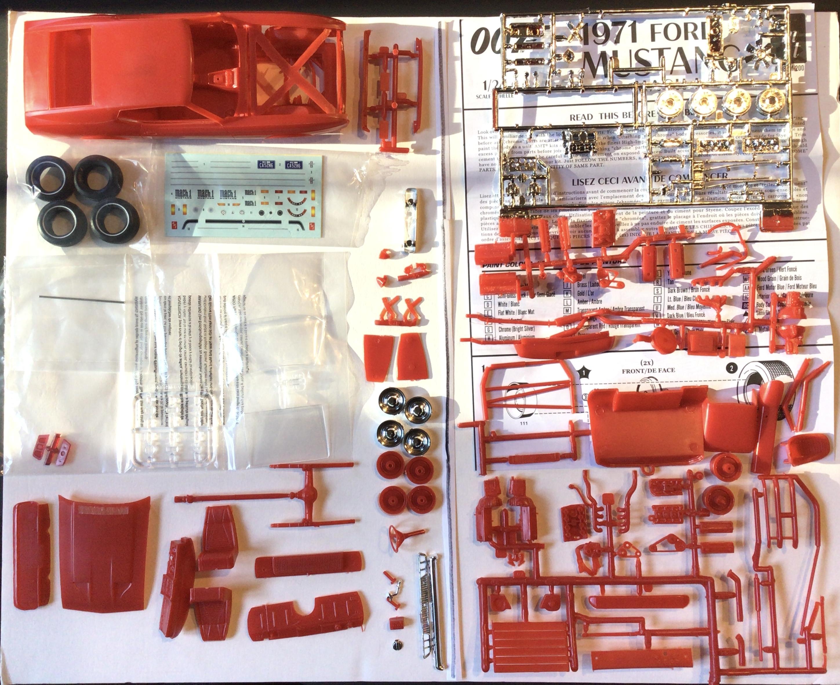

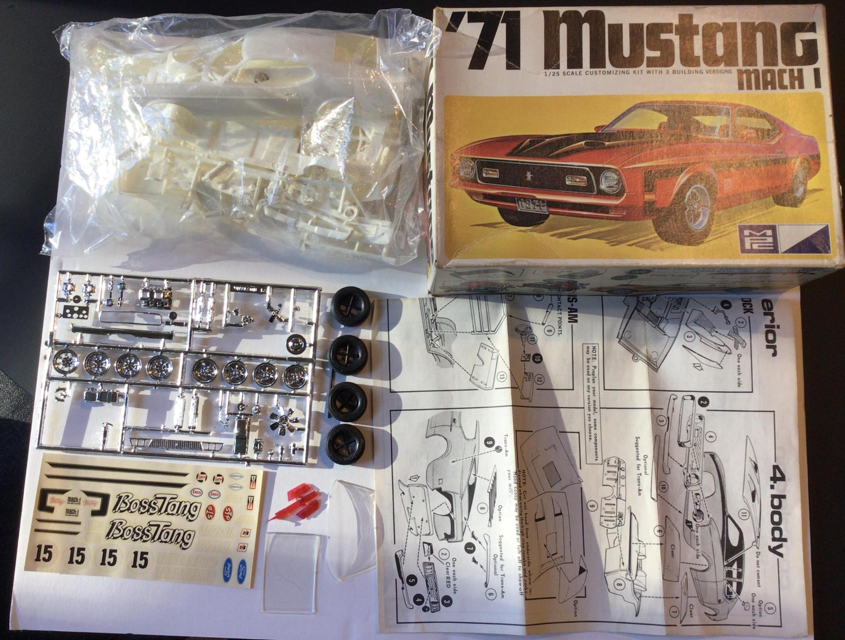

So here’s the review some have been waiting for although I see some people have already built this kit so this my be just a reminder of what’s inside and some tips if you want to make a true 1971 Mach1.  On the left are the kit parts I would use (plus other parts not pictured) to make a somewhat accurate Mach1 from the movie.  On the right are the parts you would not need for an accurate 007 build.  Also pictured is the original MPC kit from this iteration is derived which explains a lot.  The original kit was a three in one (stock, road racer and drag car) hence the odd engine choices.  Even by the summer of 1971 it should have been clear to anyone paying attention to the redesigned 1971Mustang that the V8’s choices would be either the 302 Windsor, 351 Boss and 351 Cleveland (2 and 4 bbl) and the 429CJ and SCJ.  So back in 1970 or so MPC was still using the tired old 260 V8 from the ???  kit and the Boss 429 engine from I assume another mold as strangely enough neither AMT or MPC made a “stock” 1969 or 1970 Boss 429 kit.  So, with a correct engine (351 4v or 429CJ) sourced from another kit or kits and a dual exhaust with correct style mufflers and a better 9 inch rear end this kit could be made a whole lot better.  I nor anyone else thought Round2 would tool up a new 351C or 429CJ engine in 1/25 or make any refinements to the body (except for the sportlamp grille and front bumper) or the “vented” hood for this kit so no surprise there.  As other have pointed out the clear headlight lenses and new decals are nice and include the trunk stripe (which is a first) but the hood still has those $%^&* vents that should never have been engraved in the molds - I highlited them with white paint to illustrate this old error.  The wheels do a respectable job of replicating the FOMOCO trim ring and hub caps but otherwise this kit shares a lot in common with previous issues (some under the AMT name like this one) but let’s just say I will not be rushing out to buy more of them especially if I wanted to paint it a different color.  Kits molded in red are not my favorite as I am sure many would agree.  I guess the silver lining is anyone bidding on a vintage kit for over $100 at least has an alternative as long as they do not mind all that red plastic.
Rex
Edited by vamach1

1 hour ago, vamach1 said:
The hood still has those $%^&* vents [...]
Is it just me , or are the scoops' leading ends off-centre ? Driver's-side looks longer than the passenger-side .
The non-updated Windsor engine is disappointing ; similar to the undersized Chrysler LA Engine in the Dart Sport and Duster kits .
An interesting aspect to the MPC 428 engine : it includes the Therm-Actor lines and tubing --- something that's sorely-lacking on the newer crop of Revell's 396 / 427 engines ( i.e. , the A.I.R. Pump plumbing ) .
Share this post
Link to post
I see what you mean about the scoops.  I have not measured the distance but since they are not “opened” if it’s off one could fix that while they are at it.  The thing about the scoops is for all the non-ram air cars there was a honeycomb “block off” plate in the opened glass to stop water from entering while going the “speed of sound.”  For the ram-air cars, there was a vacuum driven “flap” that opened up when the driver revved the engine or was at full acceleration.  It is presumed the Bond Mach1’s did not have ram-at as that option was past of the package that included the twist locks and black paint on the hood and of course the ram-aim plenum and special air cleaner.
You are right about the smog canister - it was also required for the 429 SCJ engine so those parts could be repurposed.  I notice the “small block” valve covers look like the ones in the Cougar Eliminator kit but of course those would not be correct if they are supposed to resemble the standard Cleveland steel valve covers and not a Boss 302 style,
Edited by vamach1
Share this post
Link to post
I think the scoops looking off is just a lighting illusion
Share this post
Link to post

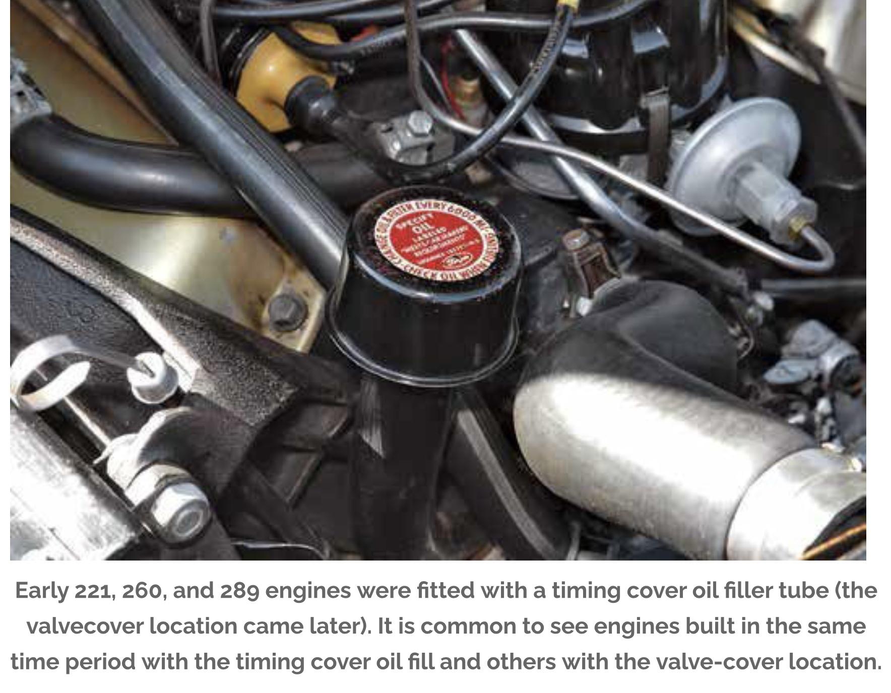

MPC didn't do Cobra, AMT did. I'd guess it's MPC 66 Mustang 289?
Thanks for winnowing chaff from wheat,
You are correct so I will blame my confusion on the AMT packaging or old age.  ?  Now that makes me wonder why in the world MPC did the same early Ford small block engine that looks just like the AMT one.  I have very few early MPC kits ( a few glue bombs) so your guess is probably right.  How odd they both based their SB Fords on the early version of the 260 V8 with the filler tube.  I will have to compare the AMT vs. the MPC ones to see if there are any differences.  At any rate I think we can agree a 260V8 engine does NOT belong in a 71 Mustang. ?even if the base Mach1 engine was a 302 2v which you do not see too often but some were made.
I found pictures of the 67 MPC Mustang fastback small block engine.  It looks very similar to the AMT one but that answers the question that it’s been around for decades and made it’s way into later kits.

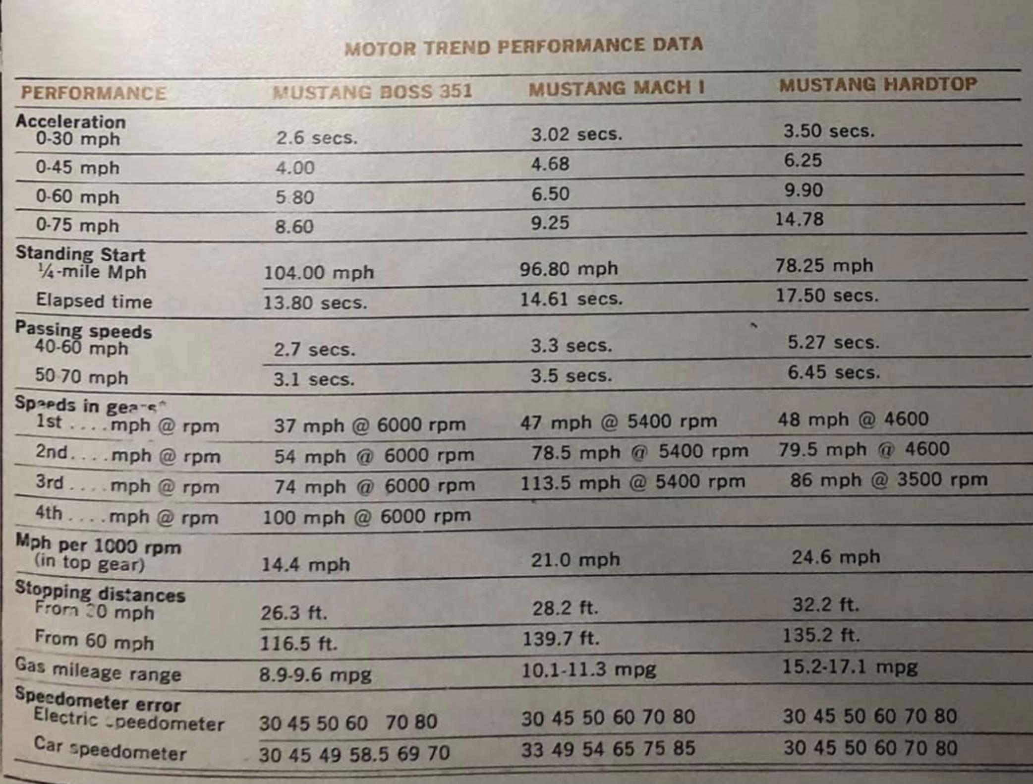

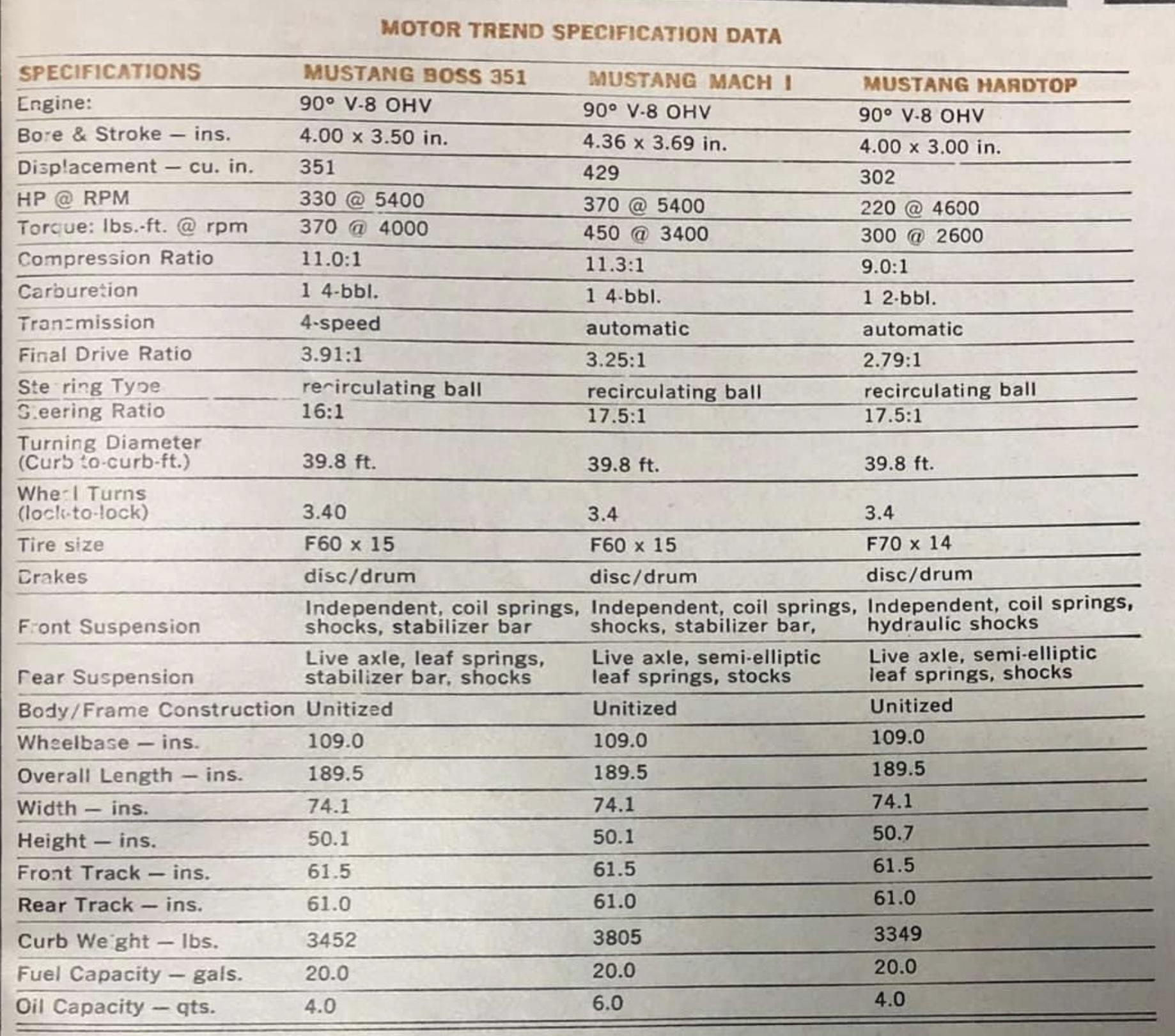

I just saw these road tests posted today for the Boss 351, 429CJ and 302 2v from Road and Track.
As for those houses - they were built about 20 years ago and like any real estate in this area I’m sure they sell for big money.  I just looked it up and they are valued from at a tad under $1M up to $1.4M ?
Edited by vamach1
Door panel & performance info.

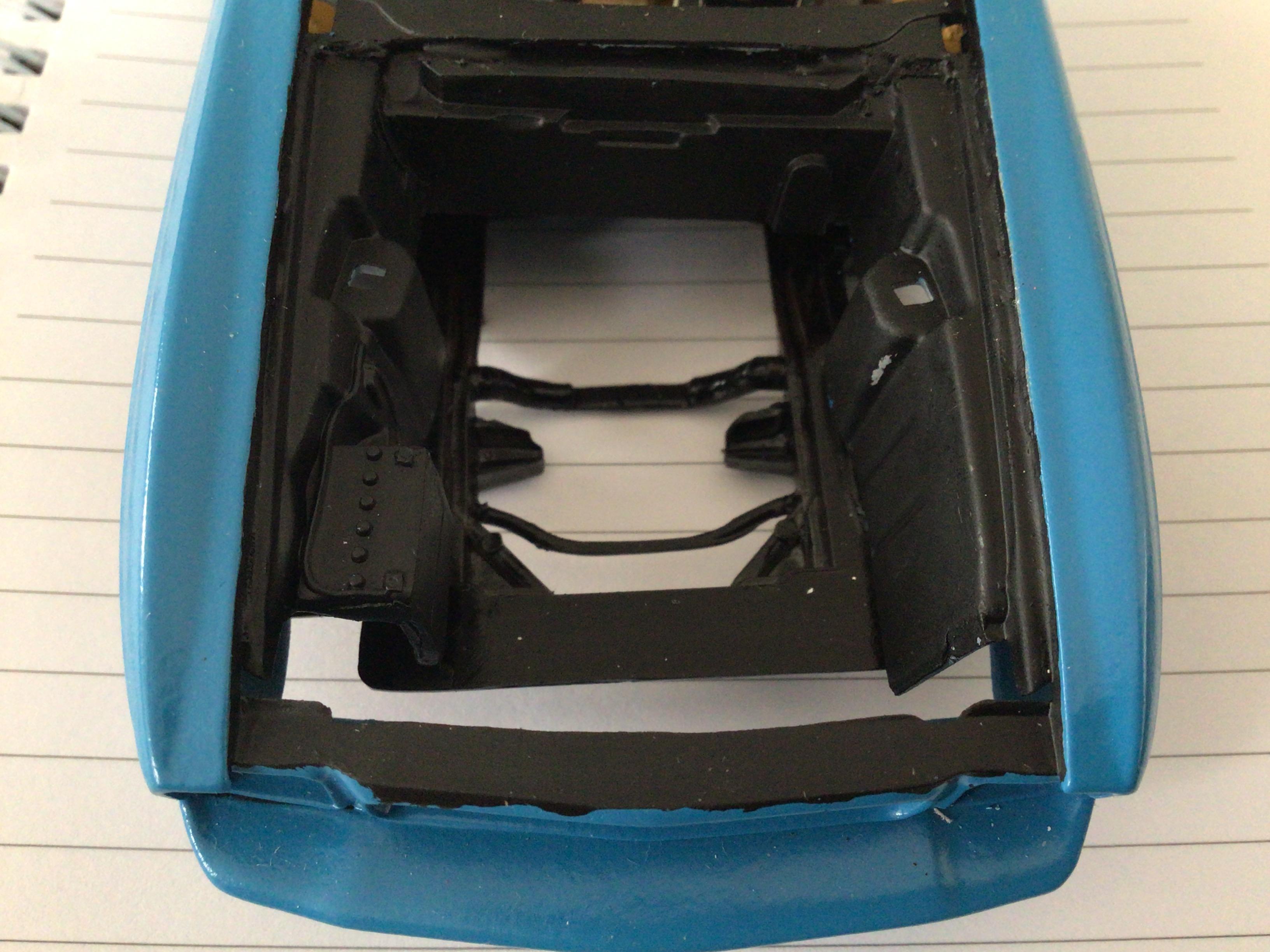

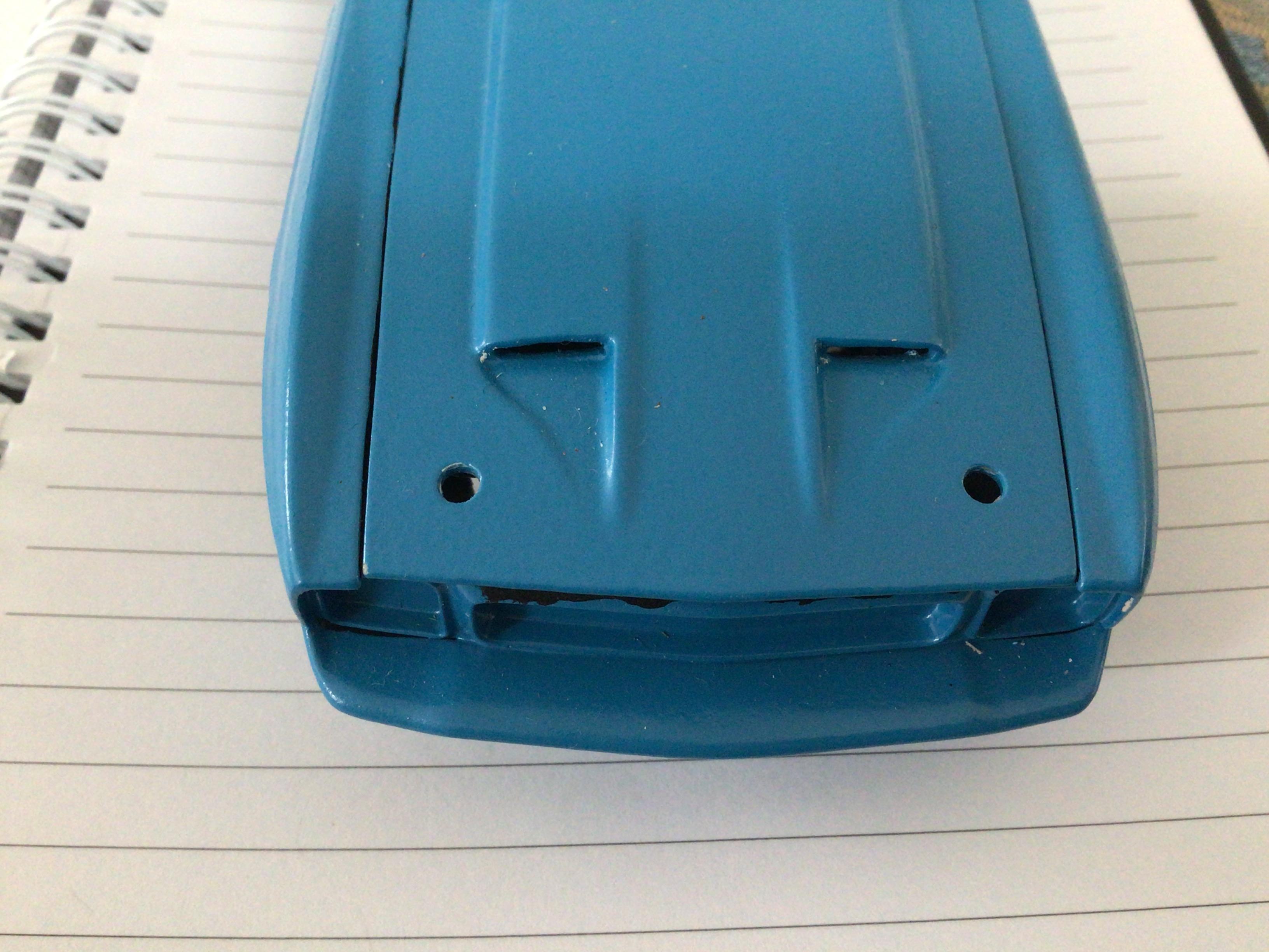

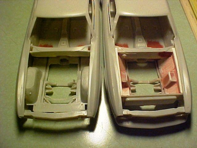

As an FYI, this modification did not take that long. Not 100% correct, but looks acceptable IMO
Share this post
Link to post
I did the same thing on one.  I used the 69 Shelby engine compartment but it’s a shame two or more other kits are needed just to make one more realistic one.
Share this post
