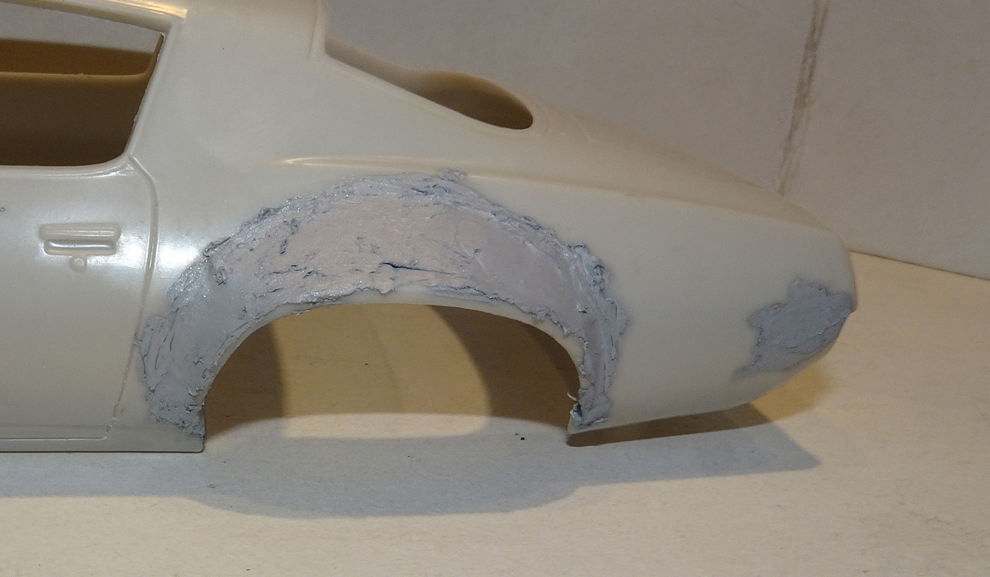

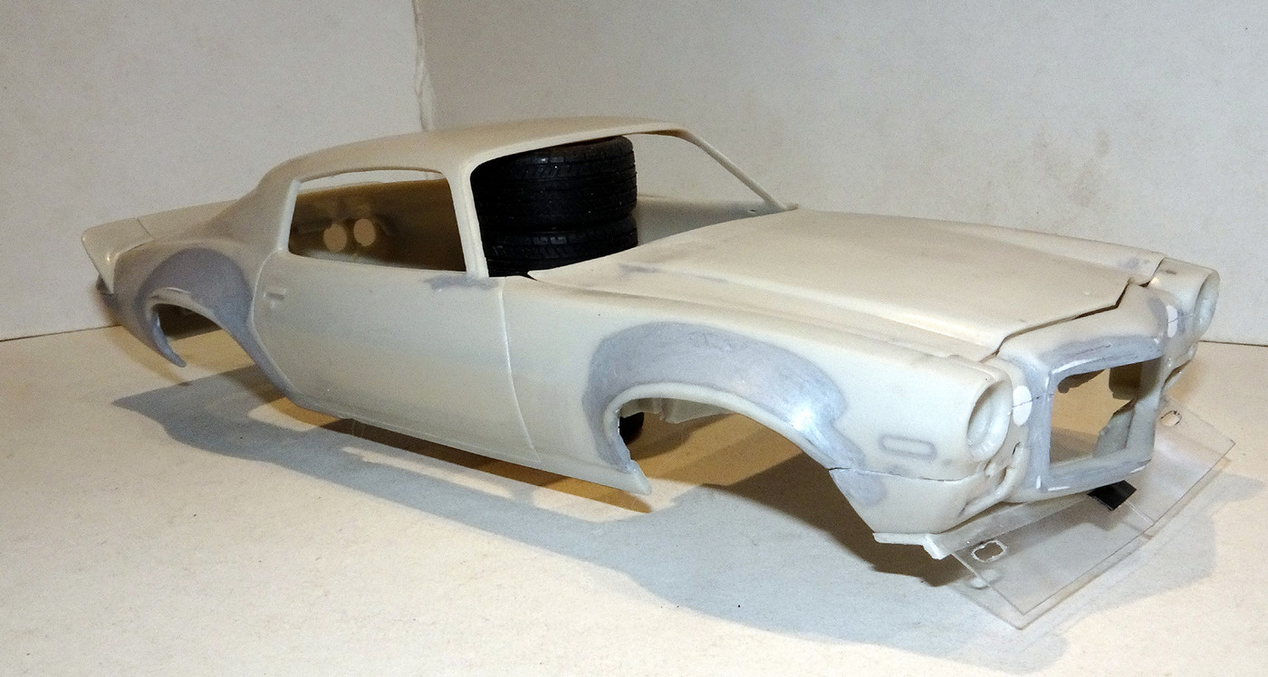

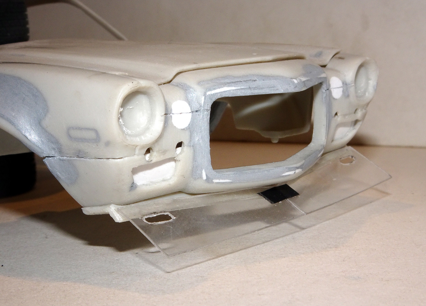

1970 Chaparral Camaro Trans-Am - I started this project a few years ago and after doing the initial work to convert the front end to full bumper configuration it got shelved. With the prospect of the release of a full bumper kit I figured I would wait until I could get one of those before resuming this project. I have recently learned the release of the new kit has been significantly delayed apparently due to some tooling issues. This project is the last one on my list of started but not completed builds and I needed something to work on so I am back at.
Up front I managed to approximate the full bumper grill area by mounting the grill upside down. The small inner headlights were filled. The center section of the bumper started as 1970 Mustang piece. The parking light area under the bumpers were cut open and then filled.
For the flared wheel-wells, I first cut of the stock lip. I then cut away the body to match the shape of the inner wheel-wells. To this I glued sheet styrene and then reattached the lip after which the whole area was puttied. The wheels and tires are from Replicas & Miniatures.

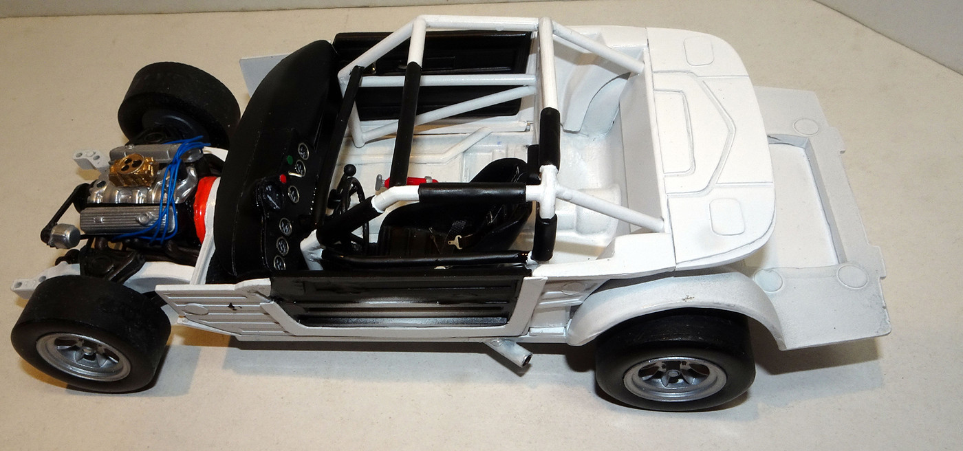

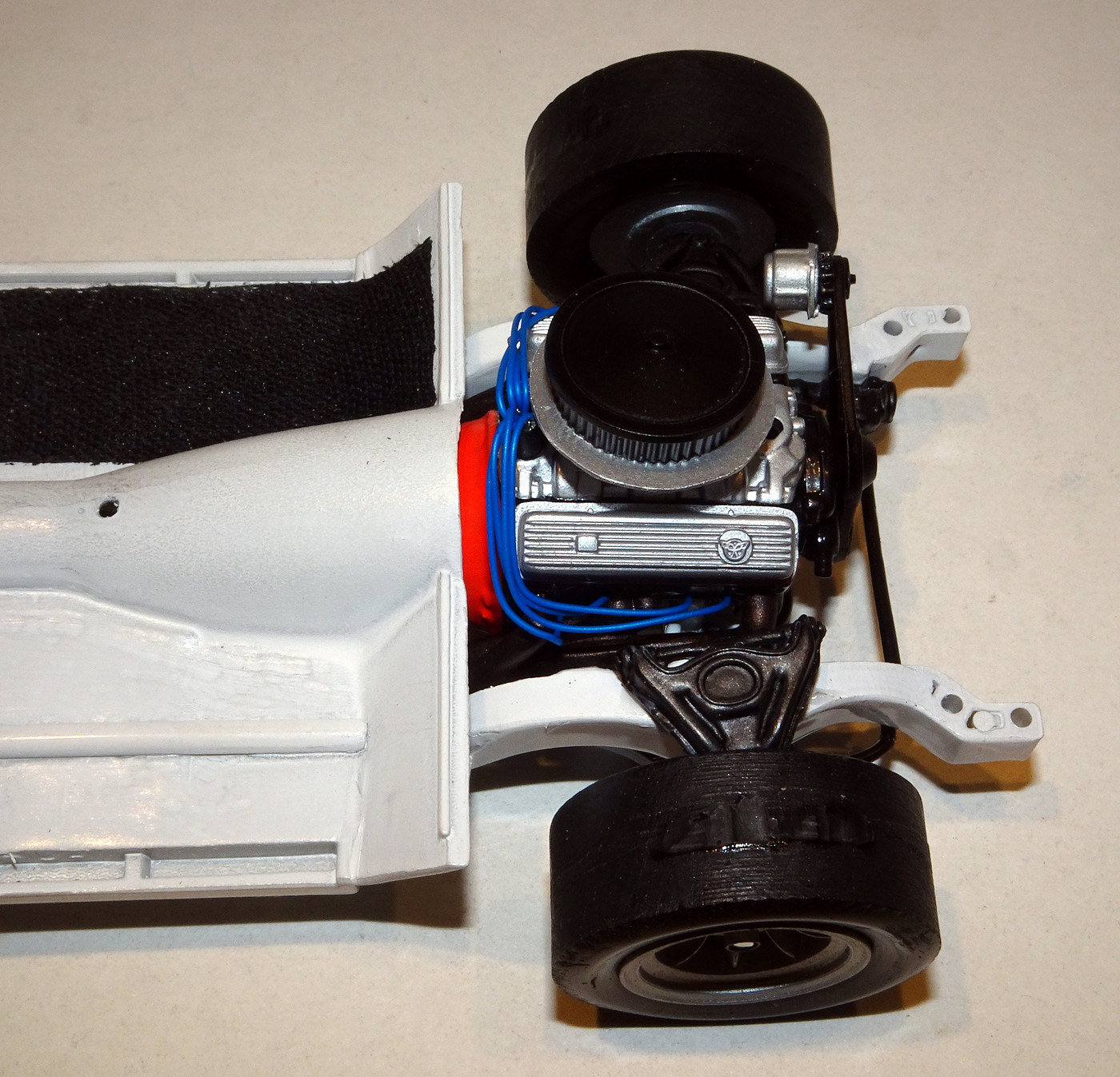

I managed to get quite a bit done before summer really kicked in regarding finalizing modifications but I did zero modelling for most of July. Lately I have managed to find the time to paint parts and do some assembly. More or less building from the ground up, the first order of business was getting the model up on its wheels and then installing the engine.
CHASSIS – I was surprised that I had two rear axles in the kit box. At some point I must have had the big block version because I had a tall rear spoiler so maybe the second axle came from that kit. It already has lowering blocks. It took a bit of study to figure out the best way to lower the front suspension. I was hoping I could simply reverse the spindles but they are offset so I had to drill new mounting holes inward on the lower A-arms. A neat feature of the car was that the exhaust pipes were recessed into the floor plan which I attempted to simulate. I did fabricate and add a fuel cell style gas tank which the restored car has but not sure if it was used back in the day. I also added a differential cooler and a skid plate under the oil pan.
ENGINE – The kit engine did not require a lot of modification. I did have to find a belt and pulley assembly for a left-hand alternator. The air cleaner is from a Revell Deuce kit with a larger lower flange that will work with a yet to be fabricated hood induction system. The headers are from my parts box and sectioned to fit the chassis with additional aluminum tubing and simulated heat insulation wrap.

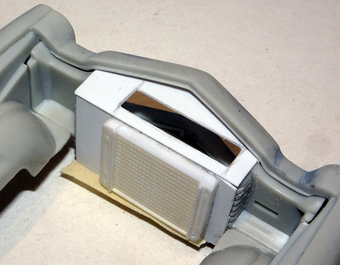

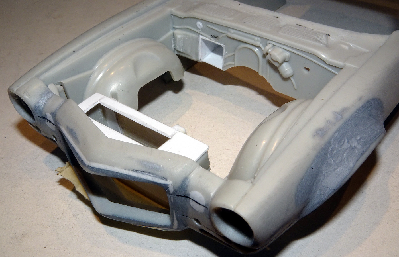

To fabricate the under-hood induction arrangement, I first removed the stock radiator from the forward bulkhead and then added fill in structure that would serve as the air inlet to the hood and a mounting surface for the radiator sourced from the Revell Willys Street Rod. In order to get the shape of the under-hood air chamber I made a template using thin clear plastic which I transferred to sheet styrene. To get the dimensions of the sides of this structure I took measurements from narrow stripe of plastic placed longitudinally across the engine compartment to mimic the underside of the hood. Once the air chamber was formed, it was put in place on the engine with glue on the upper edge to locate it in the correct position on the under side of the hood. Another interesting under feature of this car is the location of the battery. Many other Trans-Am cars had their batteries relocated to the trunk for weight transfer to the rear of the car. The Chaparral Camaro’s battery was moved aft from the stock radiator bulkhead mounting but stayed within the engine compartment in a cubicle in the firewall and protruding into the passenger side of the interior.

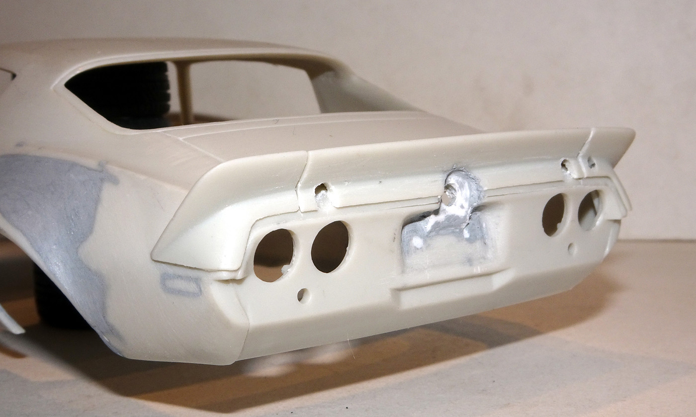

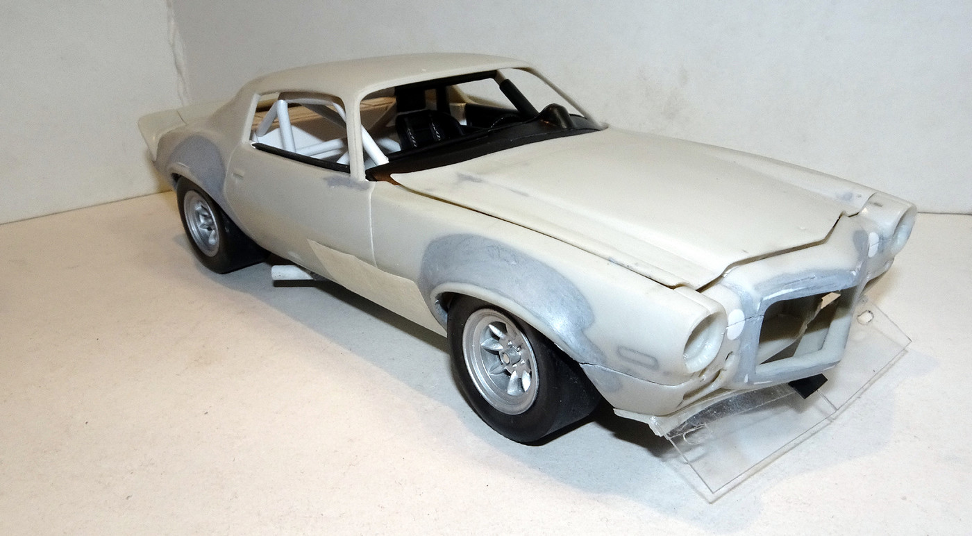

2v2HmKUHFximYT.jpgI have done some work on the body like removing the rain gutters and trim on top pf doors. I cut down the stock front spoiler to provide a mount for the "Lexan" spoiler. The rear spoiler was modified for fuel filler pipe, fuel tank overflow pipe and trunk securing pins. Mounting holes for the license plate were filled. The hood was drilled for hood pins. The body is almost ready for its first priming to check for final body work.

Body looks good Phil particularly the flares.
