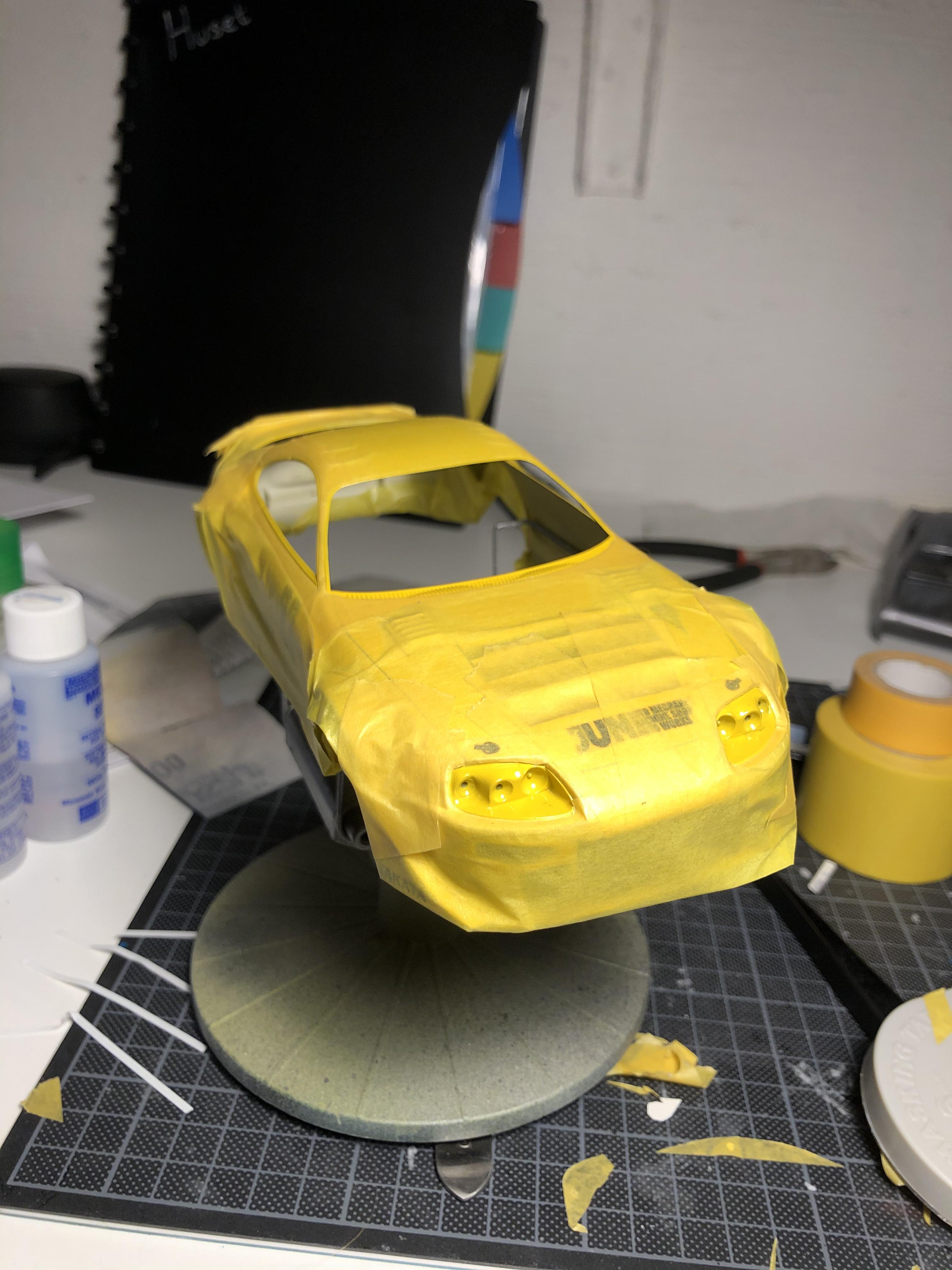

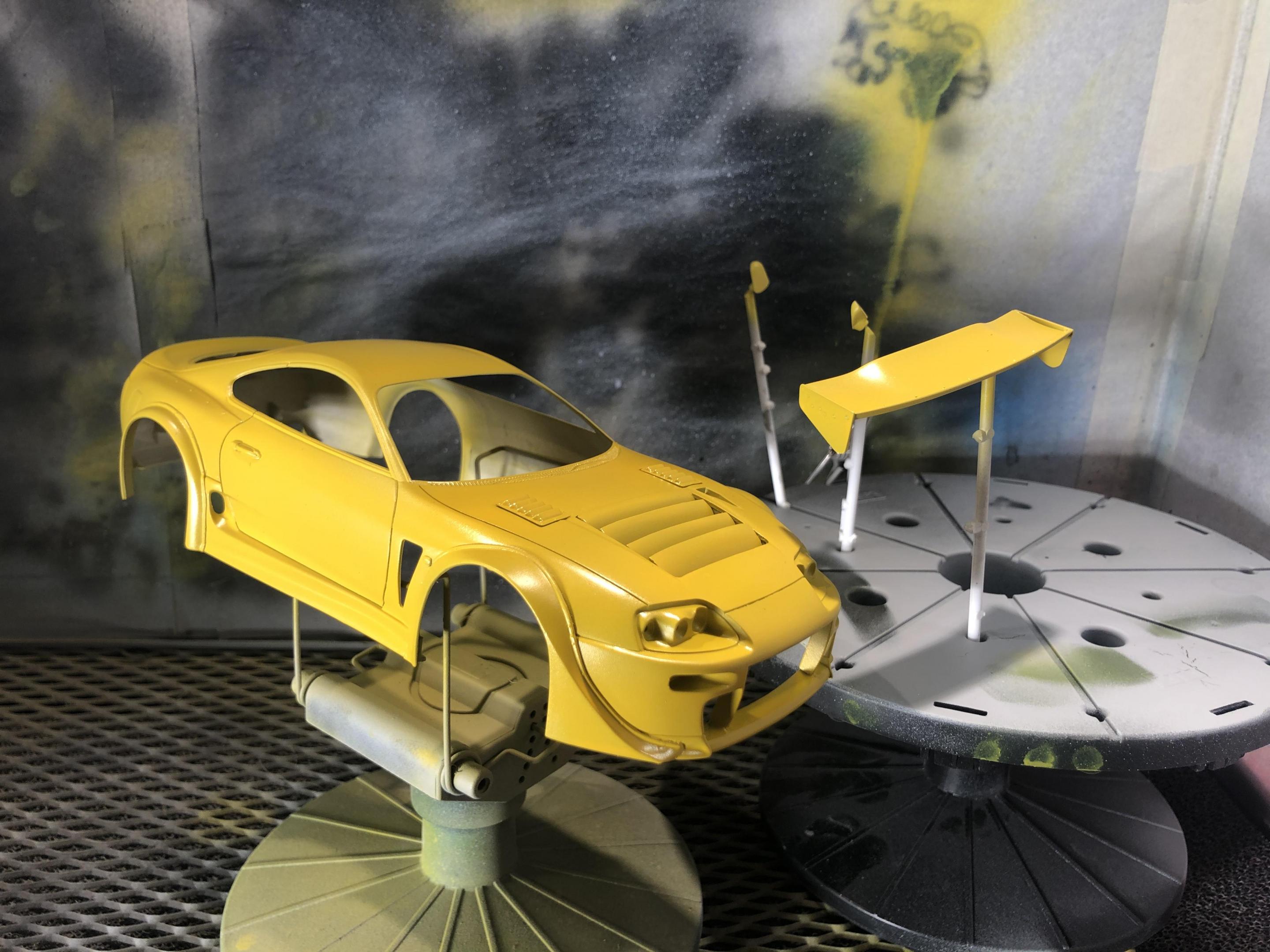

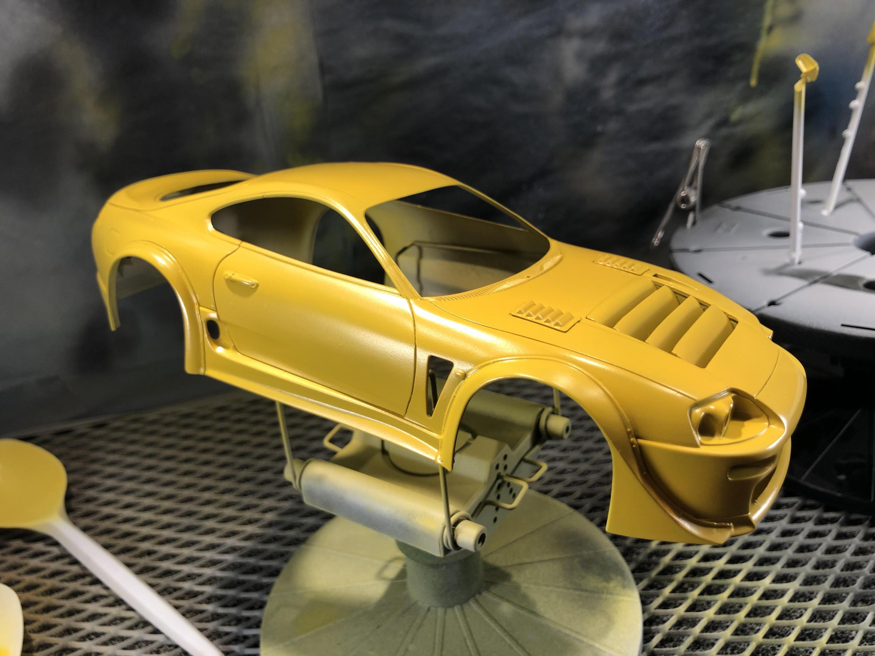

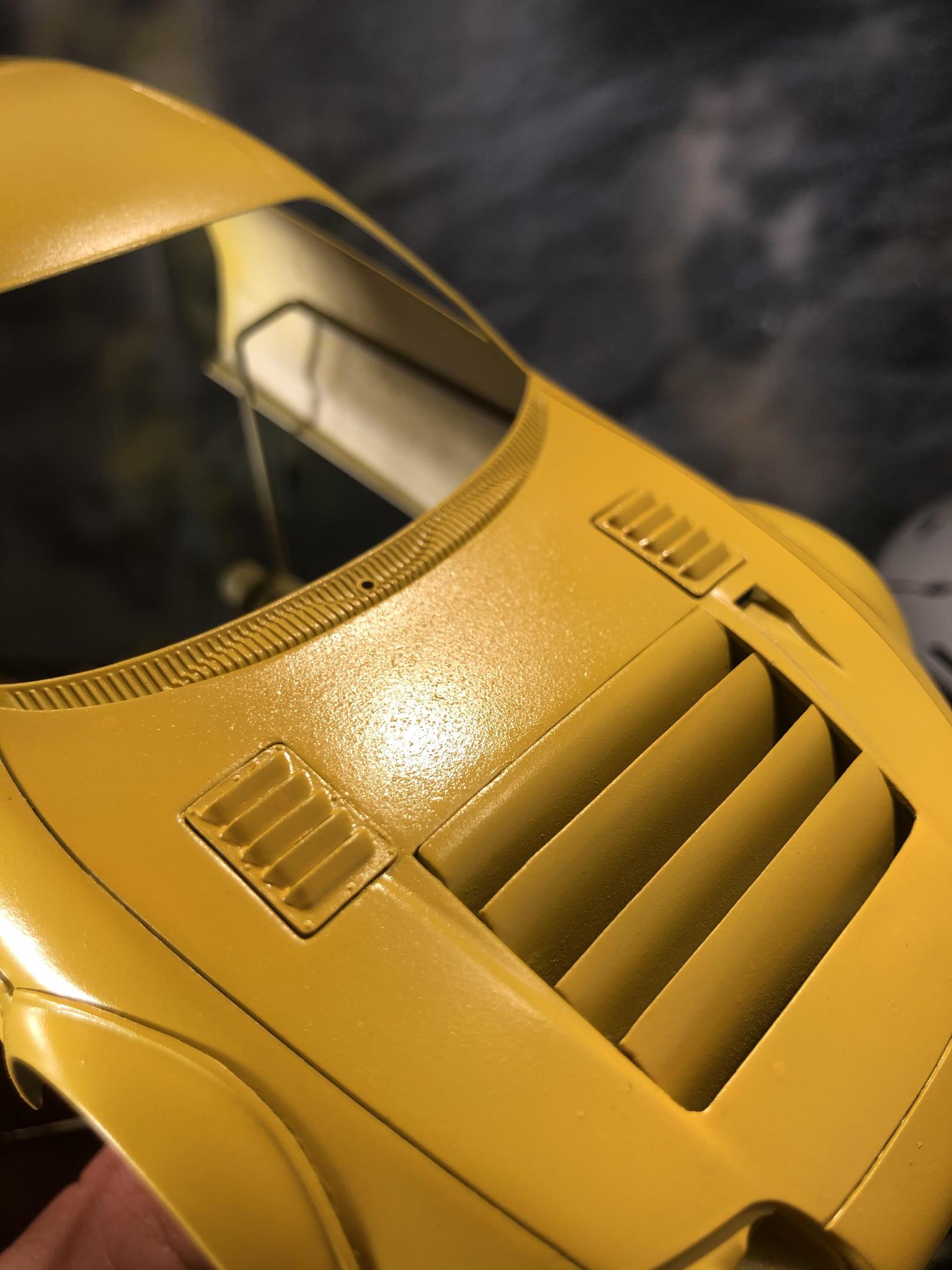

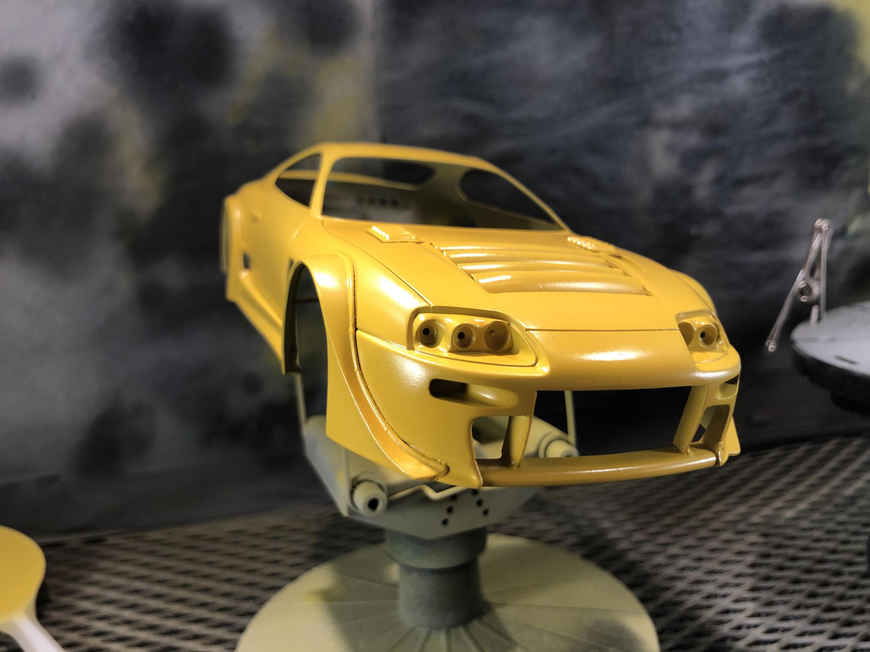

Got some yellow on the body and wing. Still learning how to mix the paint and use the airbrush and it’s hard. My ADHD does not comply well with airbrush so I might just go back to tamiya TS for the body’s in the future.
Any suggestions what went wrong and how to fix it?
Paint is modelmaster Acrylic and thinner is Vallejo Airbrush thinner. Working around 30psi. Had the first mixture to around 3/1,5 next mixture felt better but I added in the pot so I don’t know the ratio. First mix made the orange peel. I am using an Aztek brush.. wish I bought something else, it’s a pain to clean.

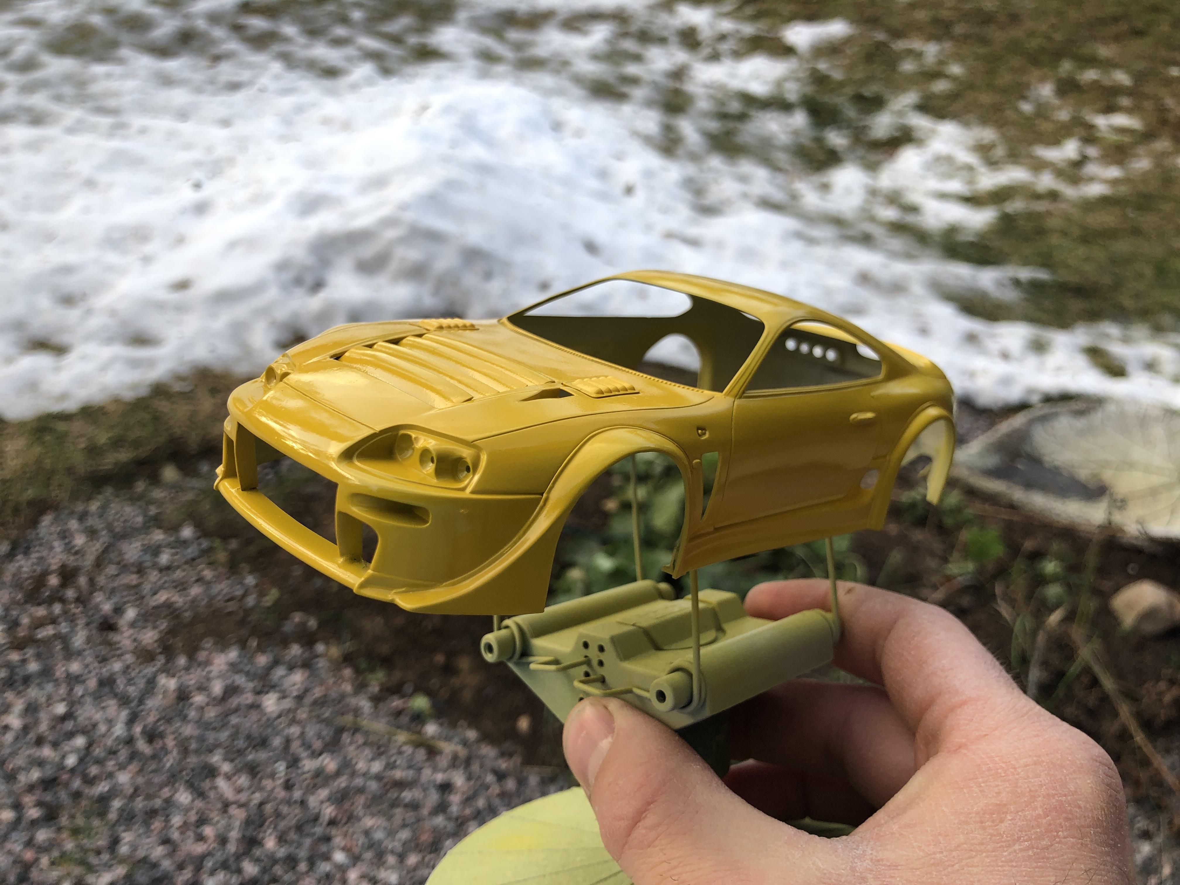

So i did a test with my airbrush from the local auto store, it costed me about $30 10 years ago. It sprays way better than my new gun... no spits and the pattern is what I want from my gun. So the new one went for sale to chip in on a new airbrush, suggestions? Would like to spend a maximum €150 for the gun, gravity fed I presume, and as easy as clean as possible since I have no patience for that.
A wet sand and an second coat with the old gun and it looks better. Will need clear after I make my decals.

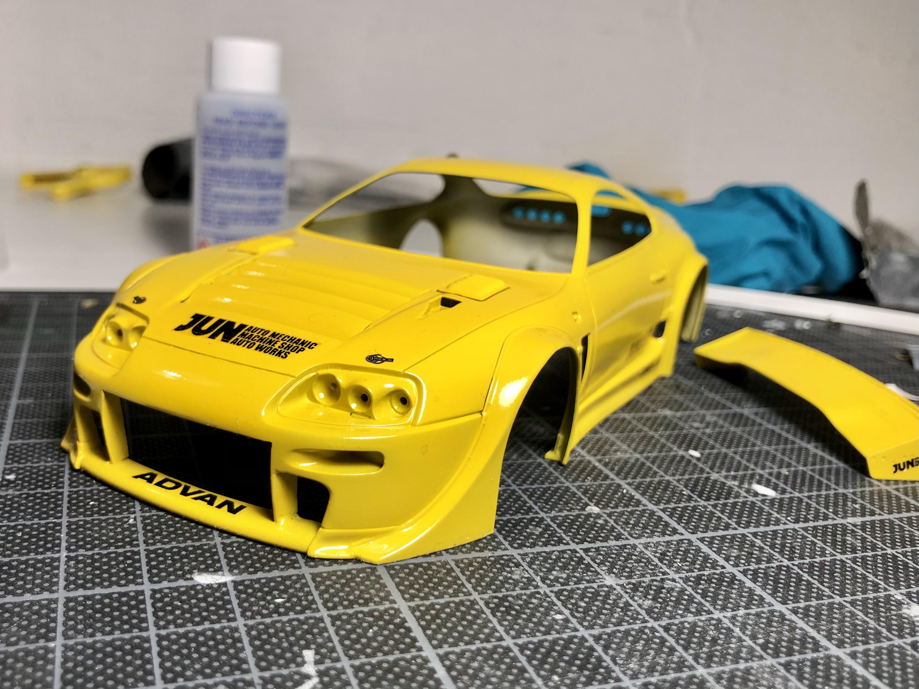

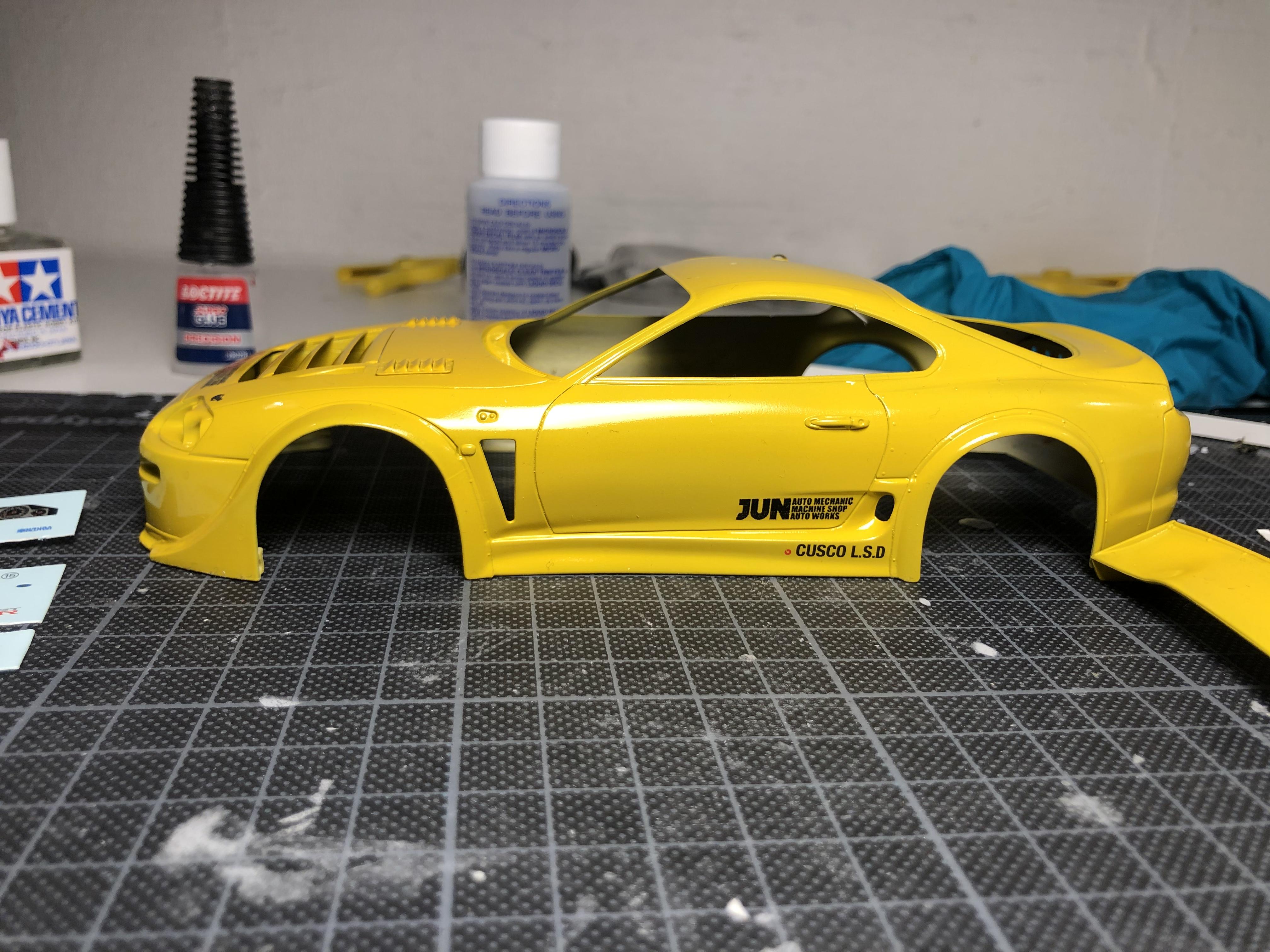

Made some huge progress today! The JUN decals are on! Still have to ad some more sponsor decalS before putting on the clear but I am so stoked to get the custom decals on!! Took 4 tries before I managed to put the big one without damage to the text. Think I added to little liquid decal on the print.
O.. and a question for every one following.. shall I put racing numbers on the sides or not... I am thinking that it might have been competing in JGTC?

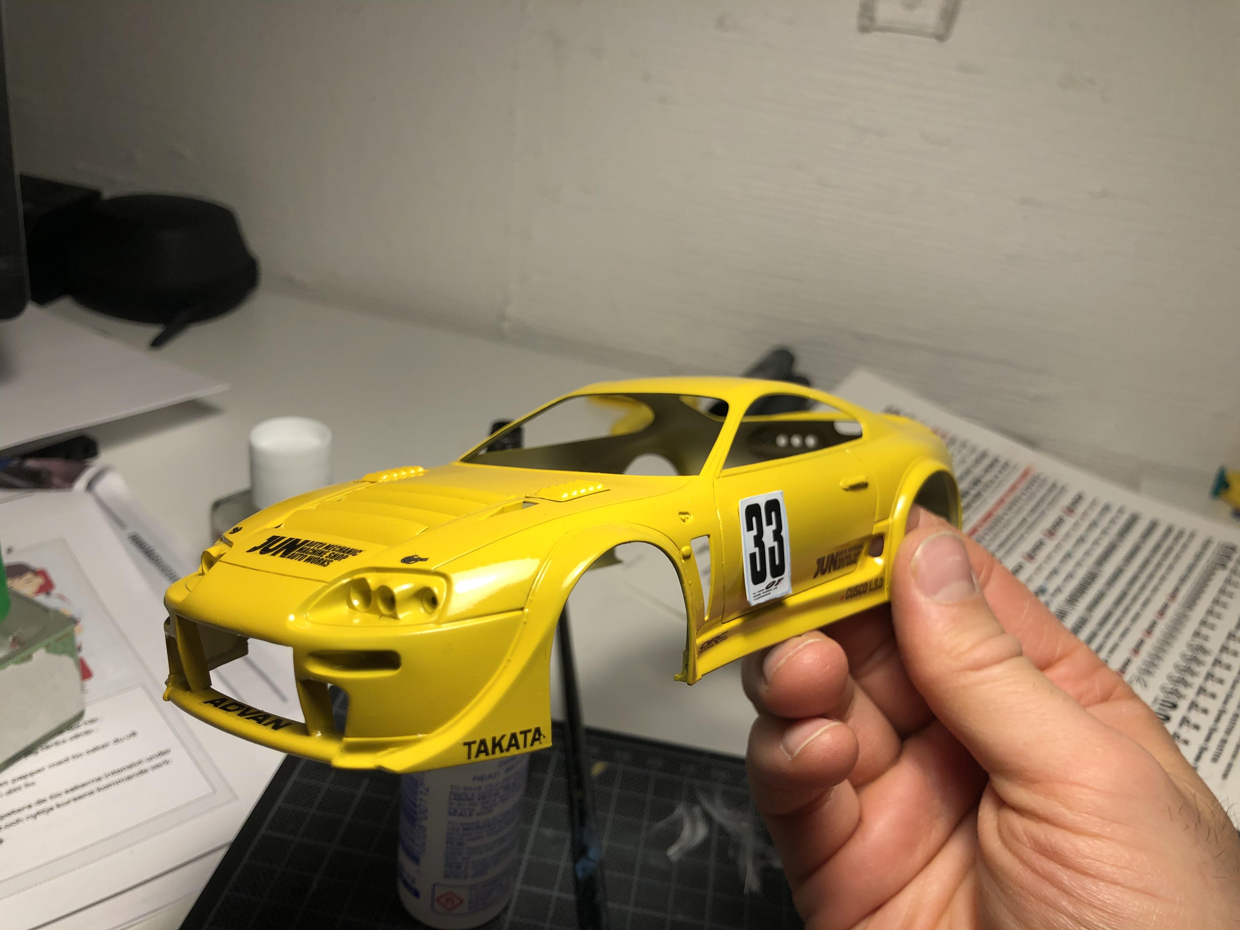

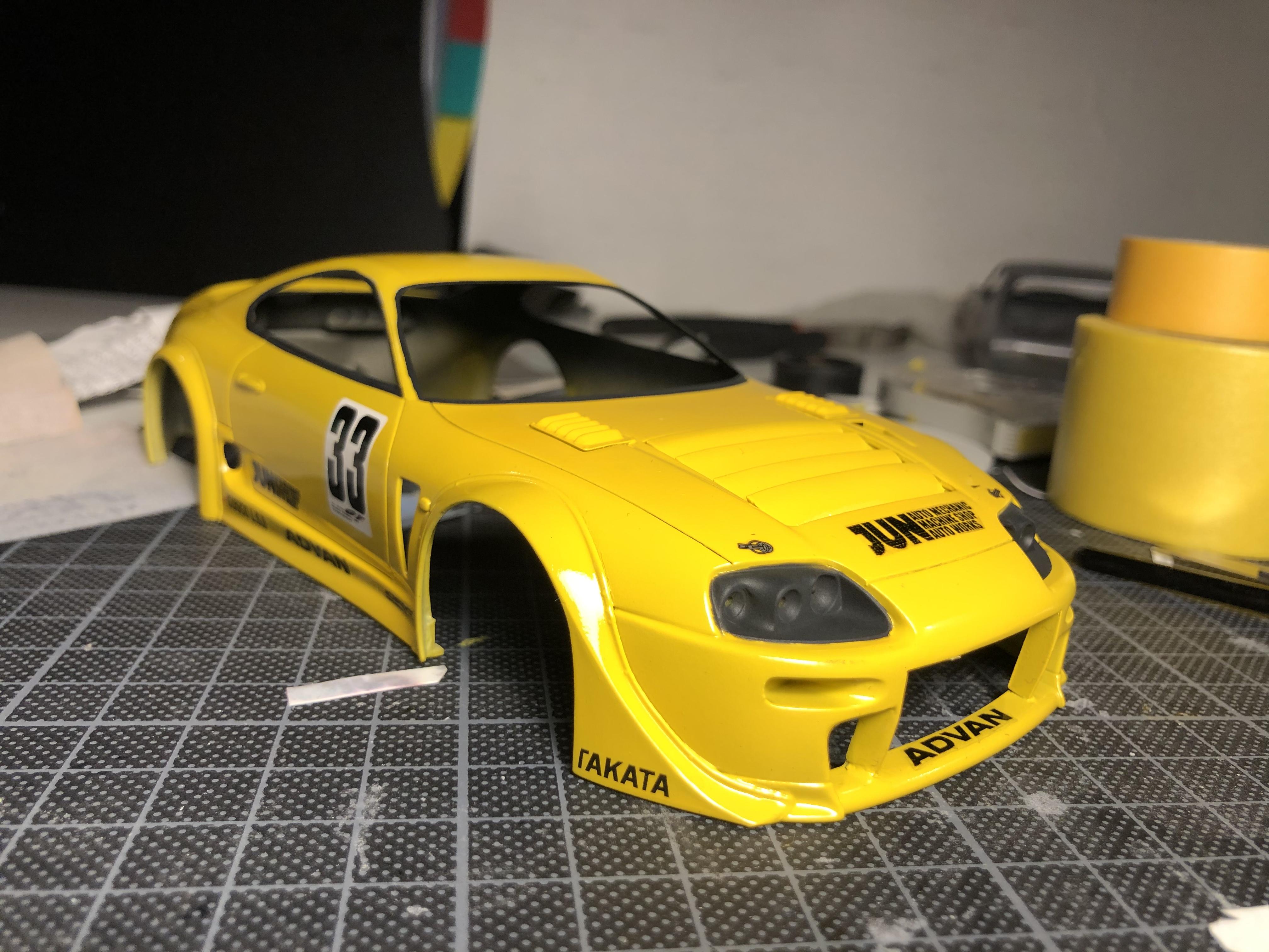

After the fifth time I placed the decal and one scraped number decal, glad I have two GT2 porsches to steal the numbers from, I am satisfied with the placement. CF00935A-2B5B-4A2C-B548-2FEC8797FC82.thumb.jpeg.934e611dfc5d4dfef6b2b0022a8fc3fd.jpeg
Share this post
Link to post

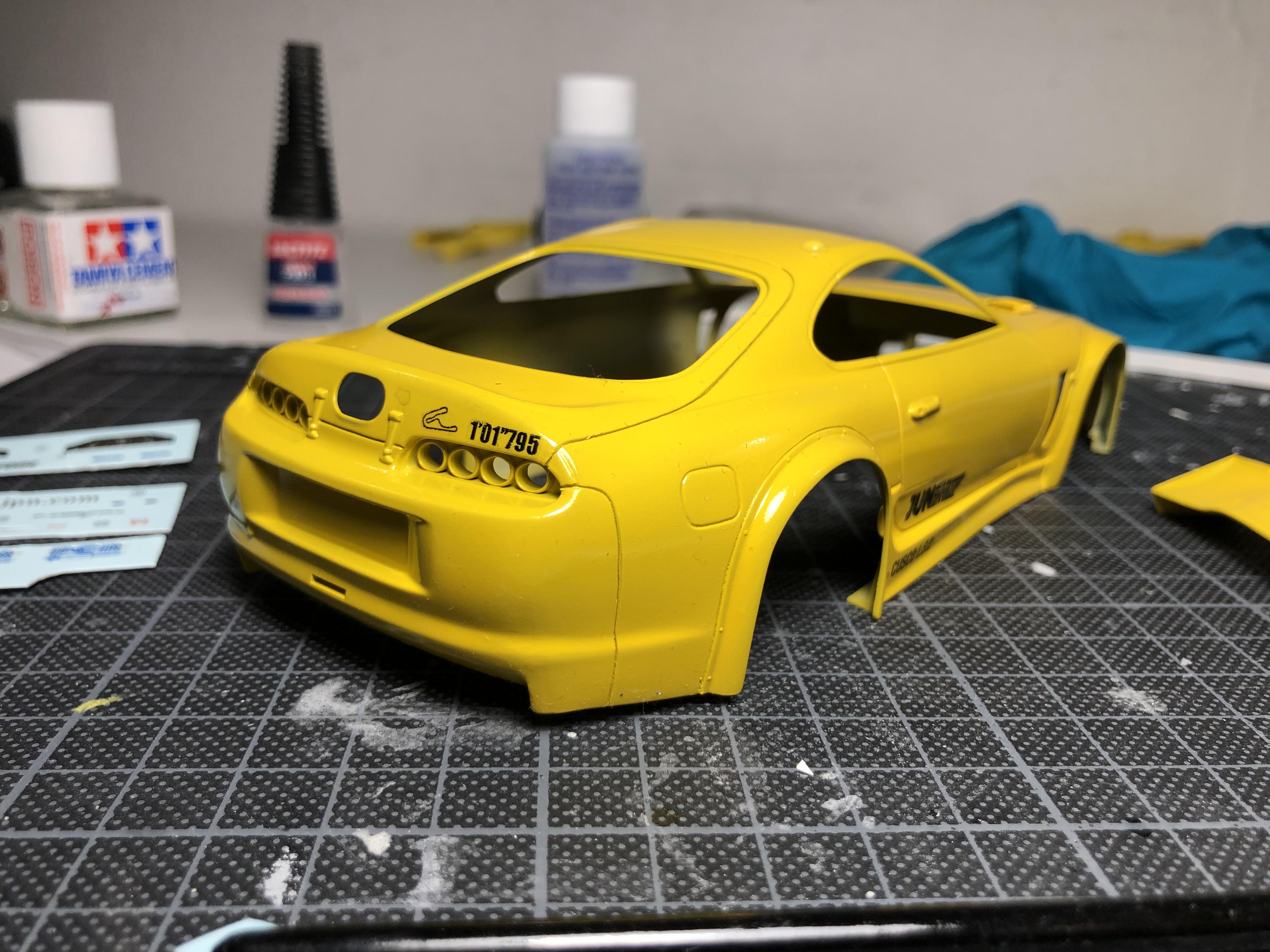

Masked and sprayed the black. Had two issues.. some spray trough and two decals came of, not enough clear obviously.. I have some dust in the clear as well.. lessons learned.

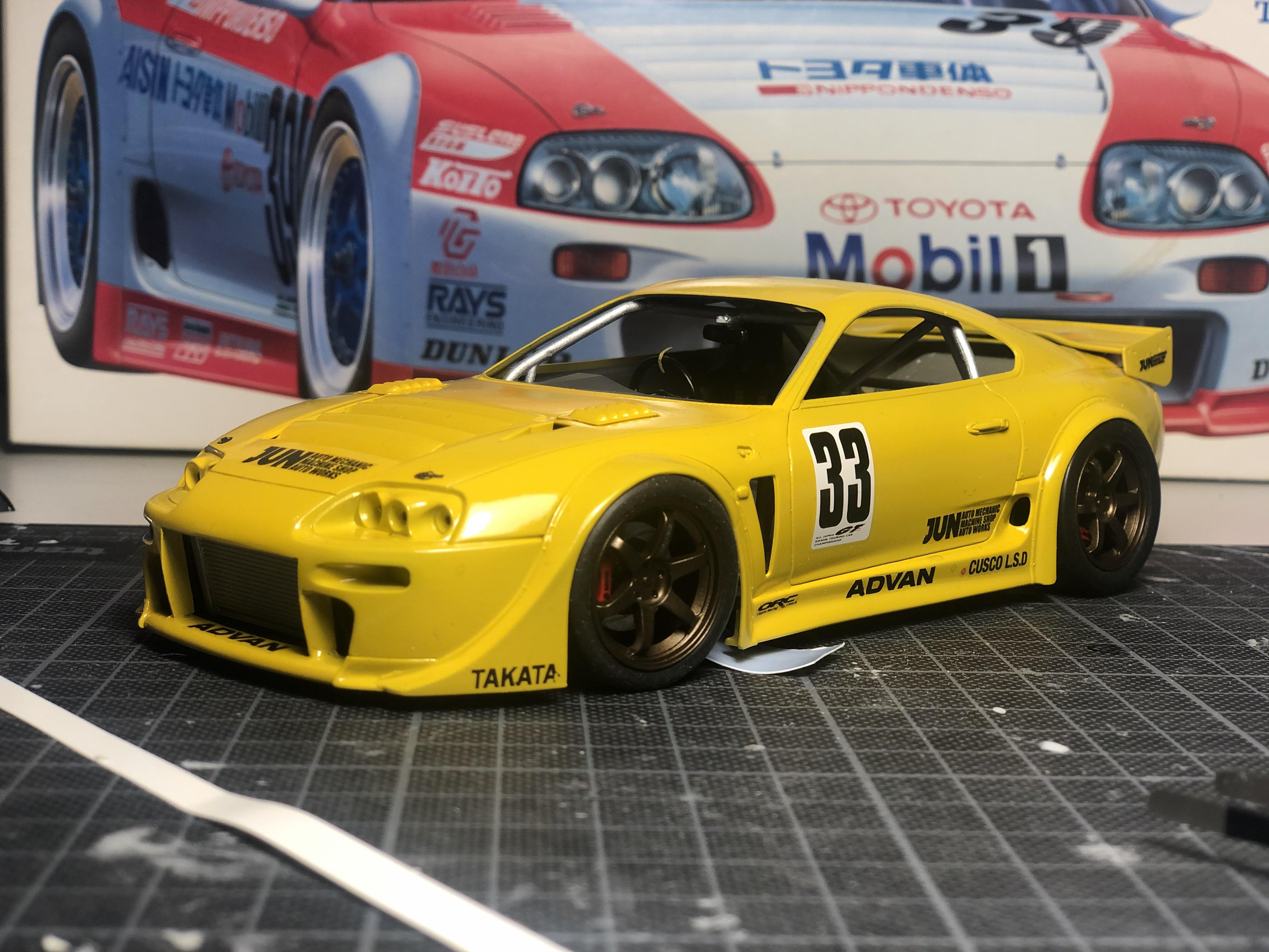

Have made some progress with lights and such. And since I am a poser I can’t resist spending those 10 mins on posing. The wing is still resting on the high supports since the lower once are not built yet.
honest thoughts are welcome. 😃
0661CEF1-4FF4-4F3B-9BF8-C729F720903A.jpeg.e4eadbaf6dec7615a99faffd07a38c72.jpeg9571B78B-0930-4356-A63D-0B205839BD9E.jpeg.f5de73fa47bd8fd6f5079257d9f7ed7c.jpeg38E60C10-C024-4B59-9ADB-BBA8310EDF66.jpeg.5ab3235449b8c490e380799eb1d42ce9.jpeg
Share this post
Link to post
Fixed the steering which was damaged and glued fixed. It also has a very small steering angle due to the counstruction.. and the bigger rolling stock hit the plastic wheel wells. I just had to do it so I could make the classic photo when done.
