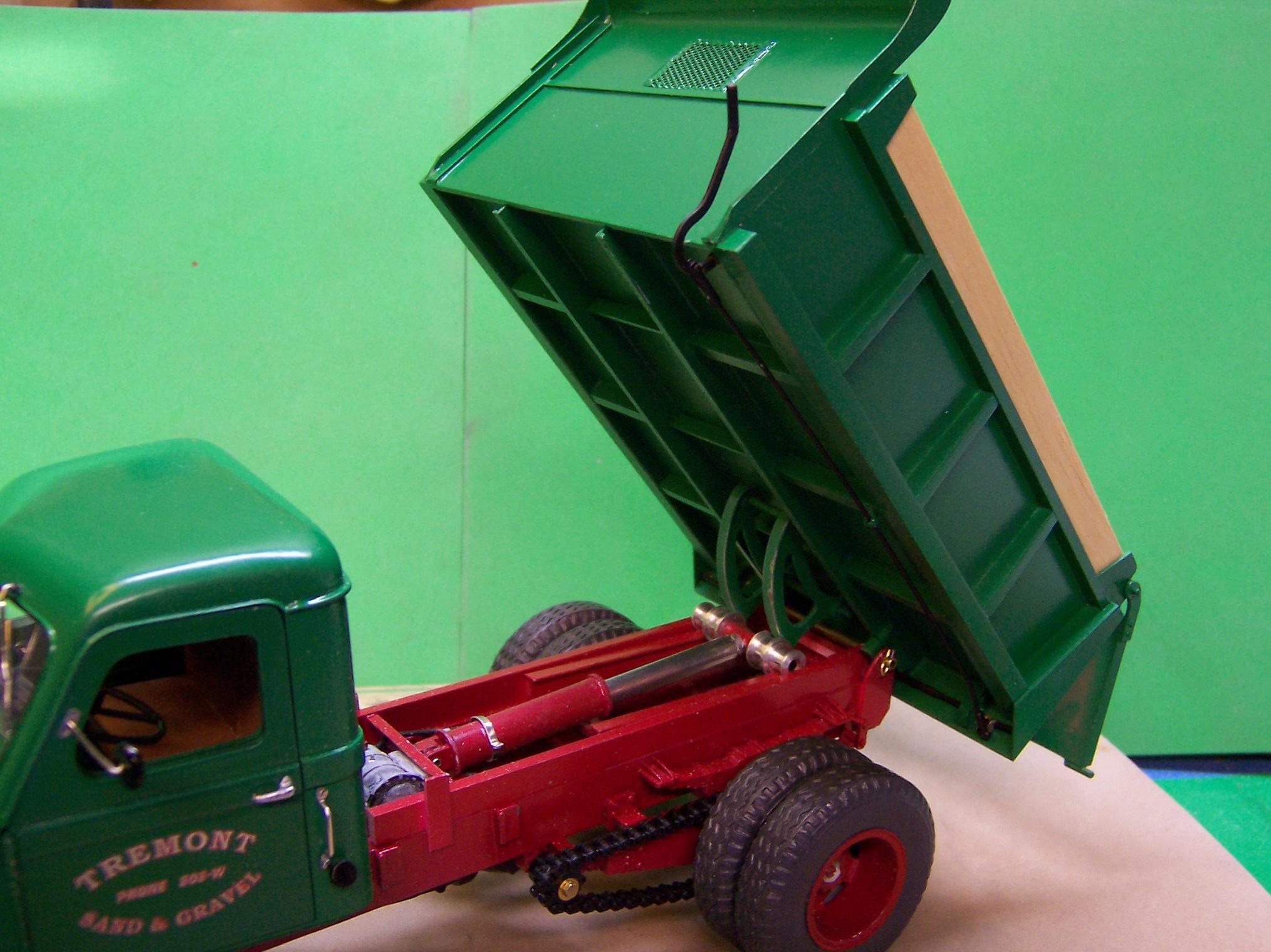

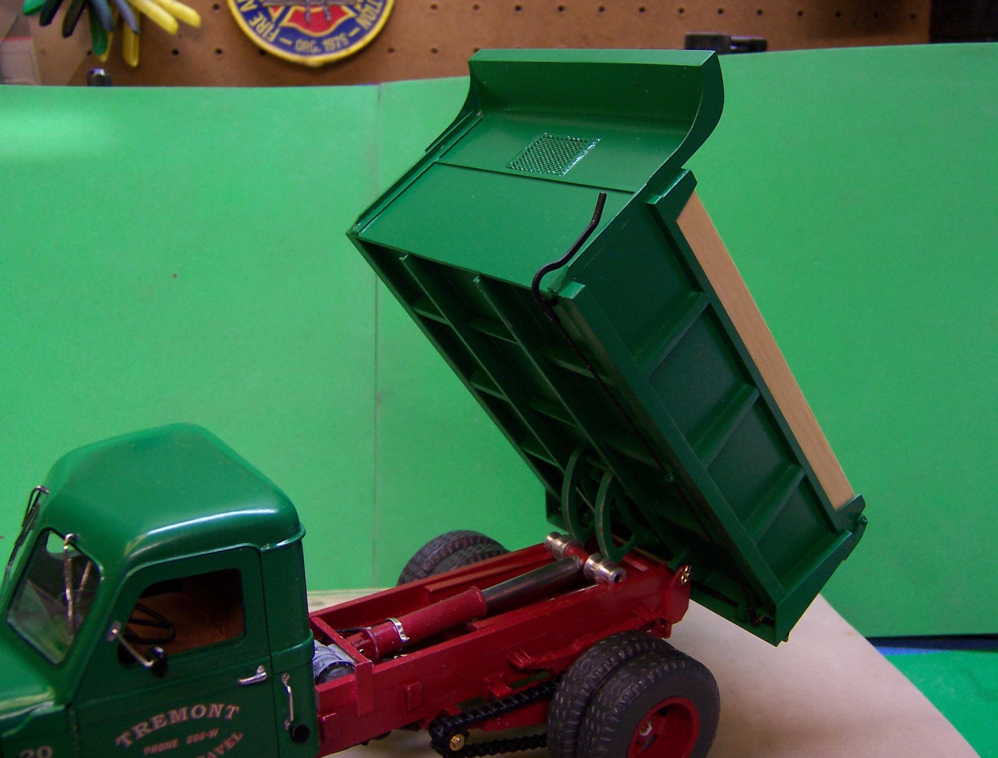

Got the body lifting mechanism done today.  It's an older style but the photo in the background shows that it was really done at least some of the time.  I would have expected a slightly more modern version of mechanical arms and just the piston but this is were we're at.
The piston in the photo above is in the retracted position.  When moved back the inner rollers apply pressure against the curved runners and move the body up.
And this is where it would be at full extension.

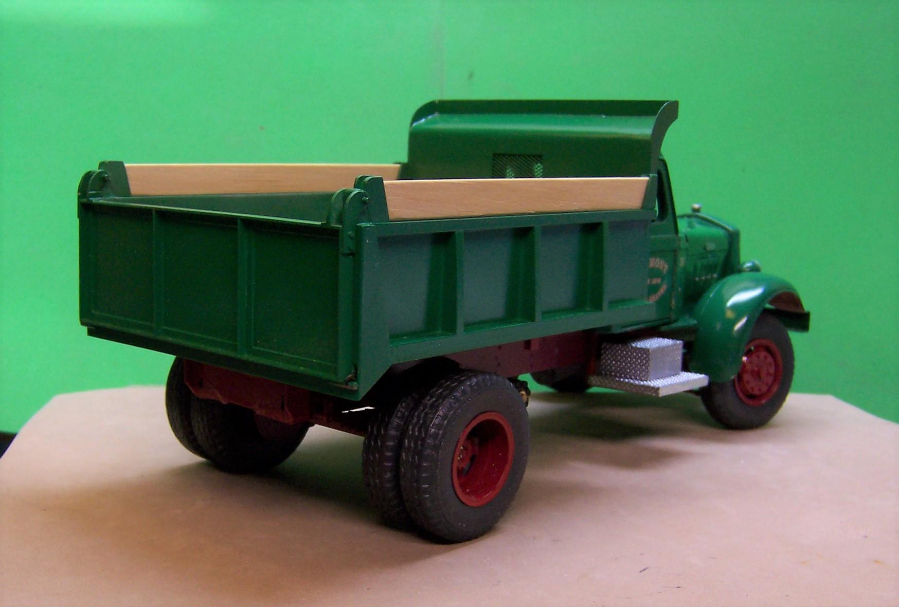

The work on the tailgate is done.  Although the option of adding a small sliding gate was appealing, I think I will forego it on this one and concentrate on just the basics.  The operating tailgate is taking shape though with the mechanical side of things done and ready to install.  The bottom needs to be painted first though.
In the photo are the latches that go through the end of the body attached to a long rod that is hidden underneath.  The handle for opening and closing the latches is at the corner of the body.  The connecting rod is in the middle.  It will be soldered to the handle after installation to insure that both the handle and latches are in the correct position for operation.

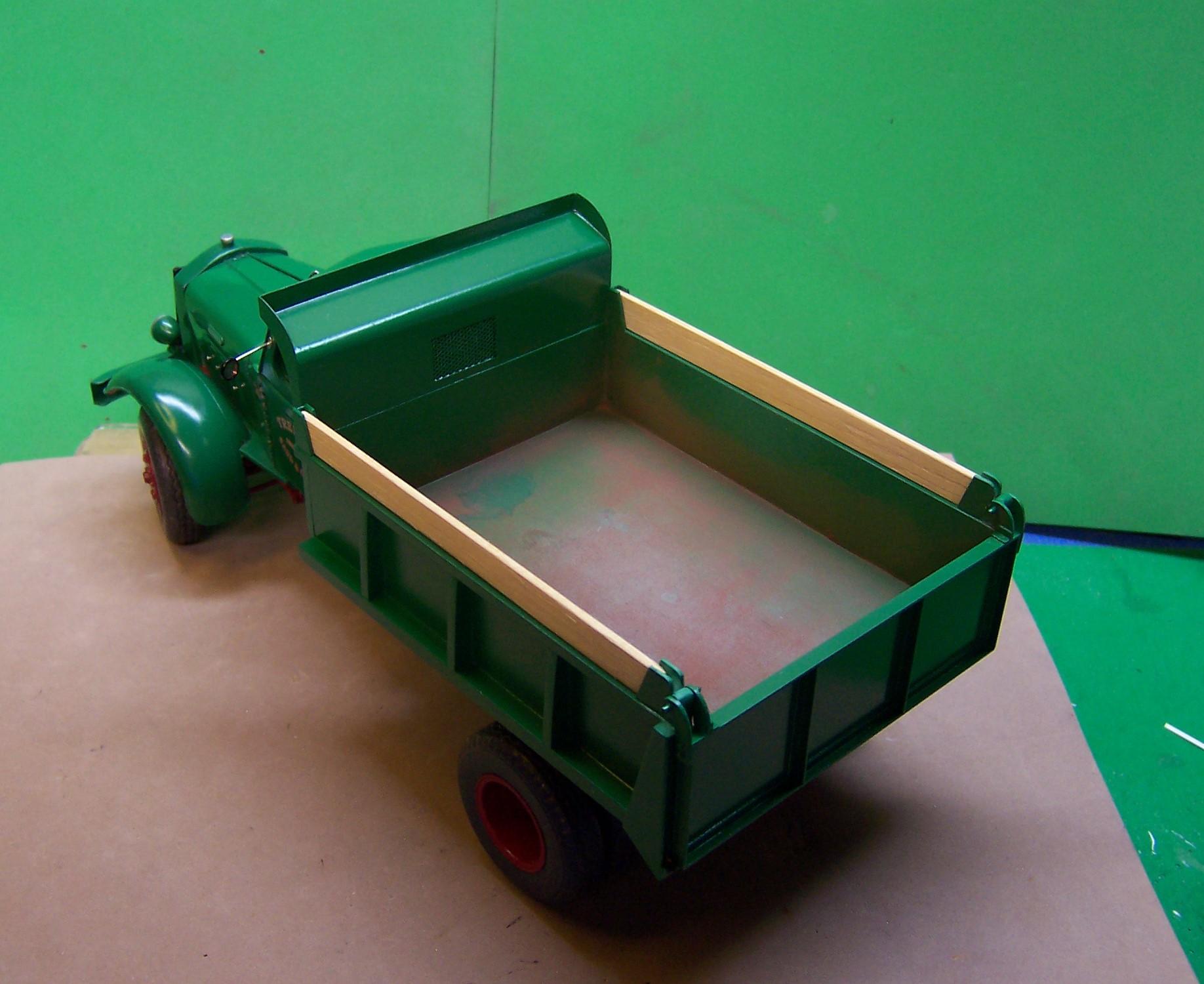

Body is now painted and the latch and handle are in place.  Still some detailing left to do but we are approaching the end of the build.   Each of the driving chains need an oil container and spout that would drip oil onto the chain to keep it lubricated.  There are also some air cylinders needed as these rigs had air brakes and step on the driver'060.JPG.43f08a24bca420c6a5cb120472ed5ade.JPGs side.  Mud flaps and tail lights also need to be added.
I decided to make the interior of the body look as if it has been used in spite of its pristine outside appearance.  I left the center portion of the body in primer and then went over it with some Doc O'Brien weathering powders.

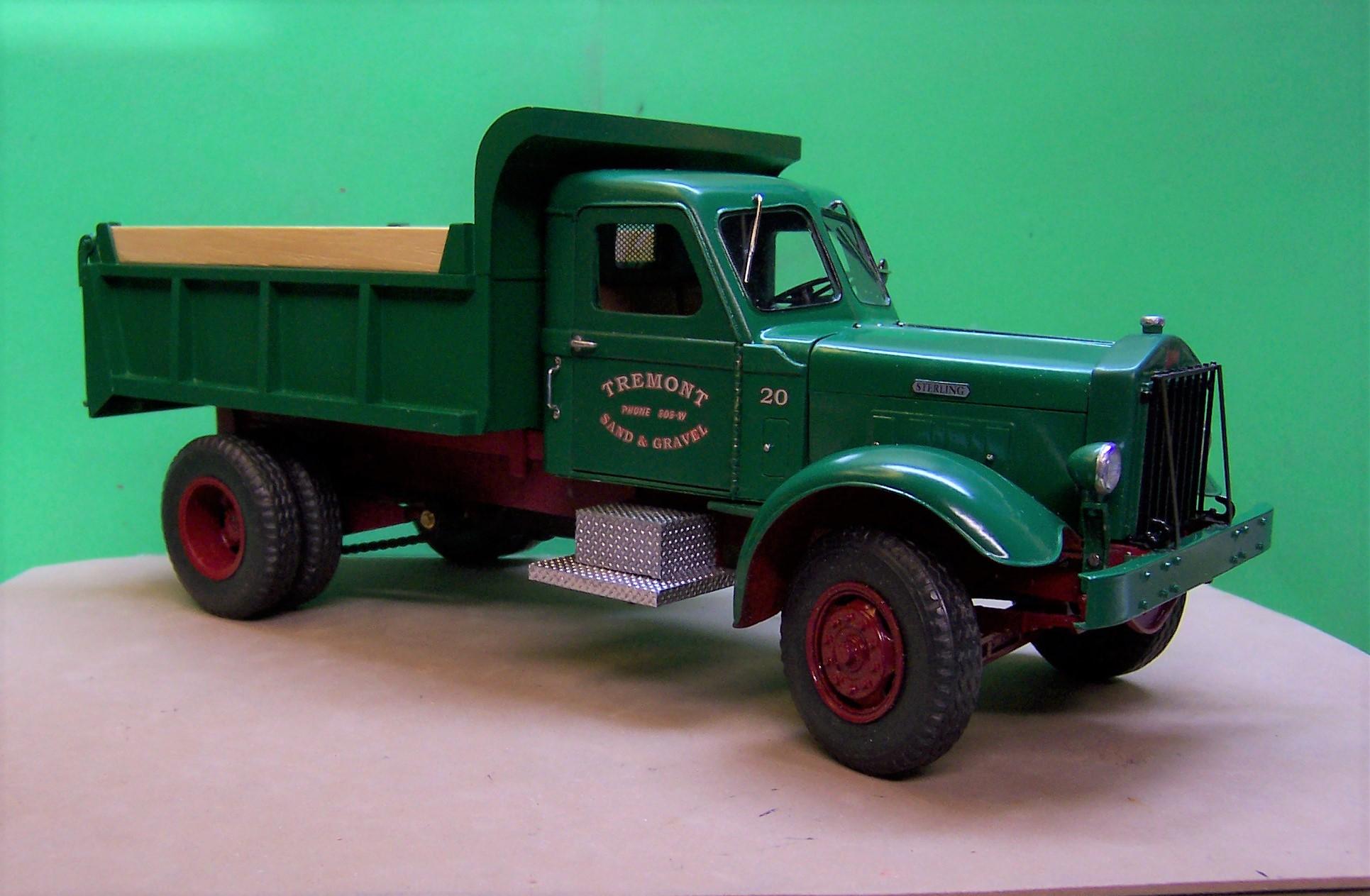

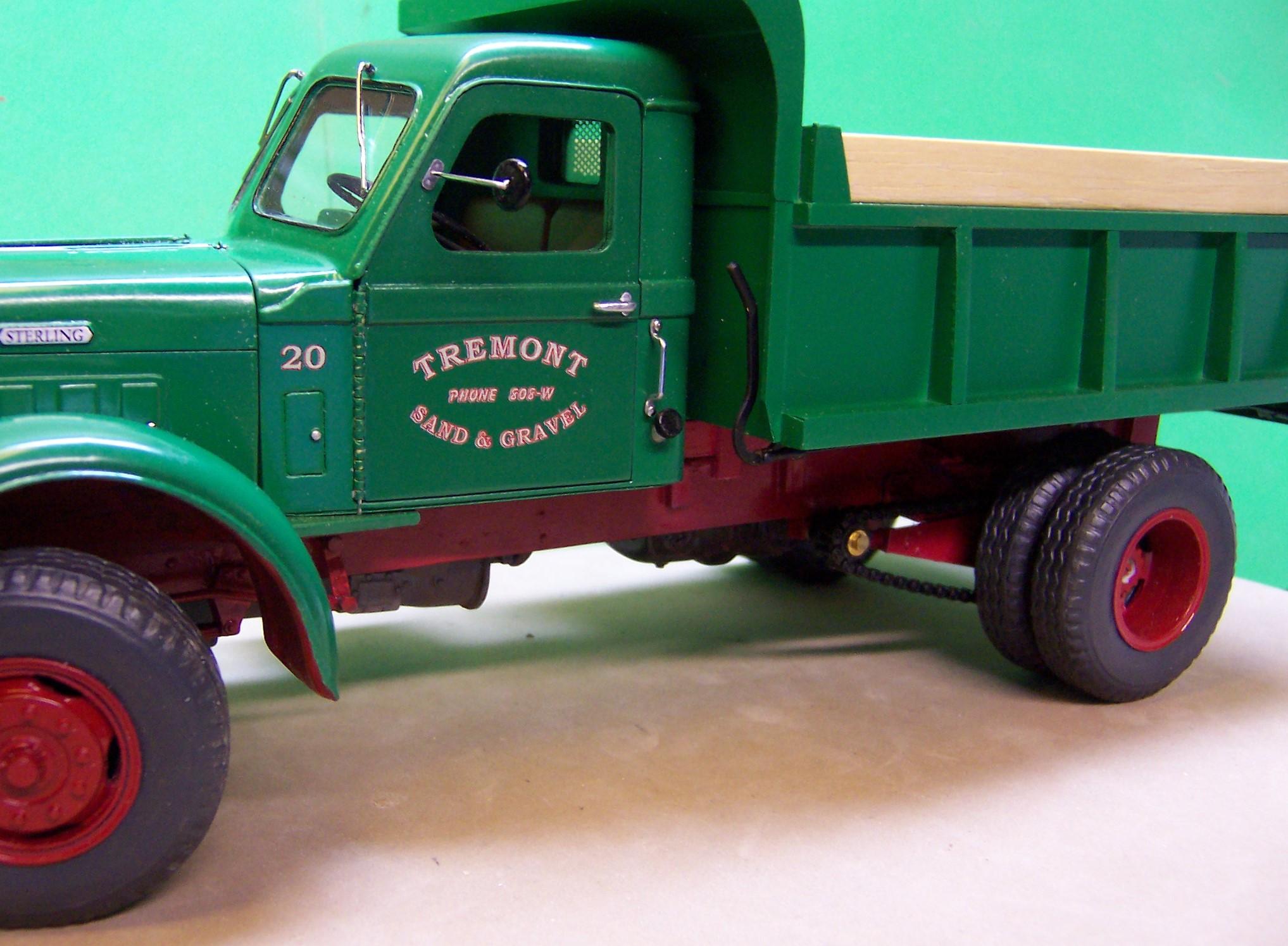

I can't believe I didn't post the final pics!  So here they are.  I added oil reservoirs above the drive sprockets and put on the mud flaps.  Tail lights and license plate finish off the back.
