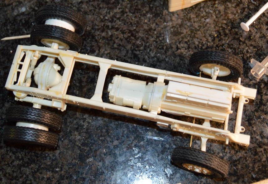

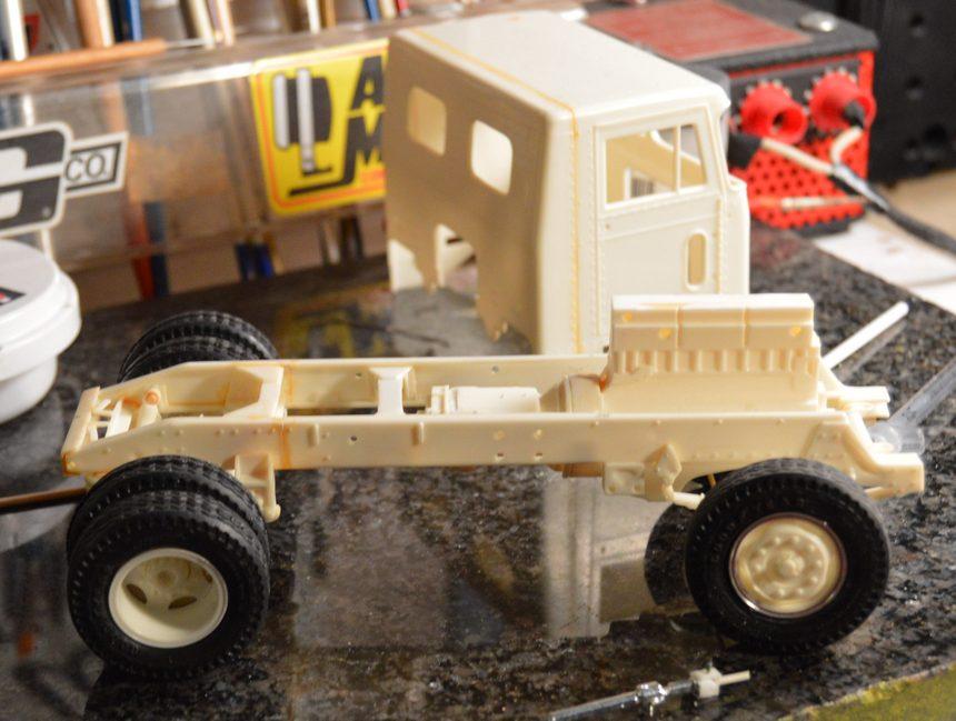

Recently, while reorganizing some stuff in the shop, I pulled this out. I don't recall when I cut the chassis and cab, but, as you can see by the yellowed liquid cement, it's been a while! It's a 60" cab on a 120" WB. I'm going with an AMT Cummins for power. I haven't decided yet, whether turbo or naturally aspirated. I'm not sure where the rear axle came from. It had stubs on the ends, with a ball on the end. Was that an Ertl thing? As I recall, MPC favored plugging that big, ol' square end into the wheels. It appears to have something like an Eaton or Spicer two-speed, which would be appropriate for this truck's job. It would represent a small local/regional freight company, and be used to tow 27' boxes. Critiques, questions and comments always welcome! Thanks for looking!

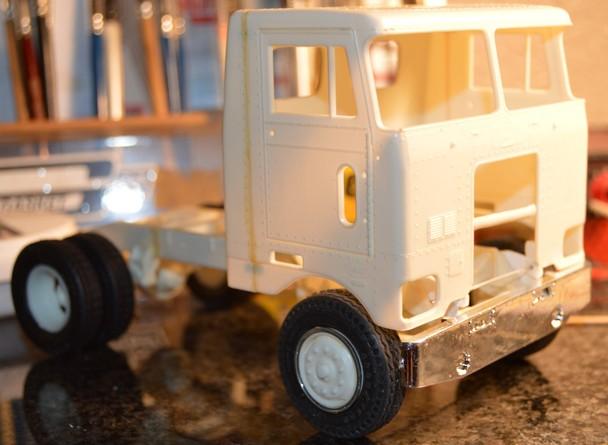

Got it on the  wheels. Something looks off, to me. Any ideas? I made yokes for both ends of the driveshaft. Questions, comments and critiques are always welcome! Thanks for looking!

Thanks, Guido! I think I just need to narrow the rear axle. I think  that may be what looks odd, to me. I dry-assembled the hinges to the bumper (not worried about its finish, it will be painted, and likely, bobbed), then I mounted some Evergreen strip to extend the kit's molded-in "tabs" to locate the bumper. Once those were cured, I was able to insert them into the hollows at the front of the chassis, to mount the cab. At that point, I was able to install the rear cab supports. Then, I cemented one side of each hinge to the cab (the same side--left, or right, otherwise the hinge will be trapped between the hinge halves.). To disassemble it, I only have to remove the loose hinge side, and slip it apart. At any rate, here it is with the cab mounted.

That is cool.  I agree rear axle is too wide.  I have one of these in my pile, might have to try a day cab. Gotta get up the nerve to cut the cab down.  If I may say something, it looks like the frame rails need to be cut back pretty much even with the front spring perches.  That will make the cab move back a bit and center the steer tires under the wheel arches. It also helps to line up the grille in the cab opening.   This is a tricky kit, at least to me.   Looks like a fun project.

Thank you, Doug! Cutting the front of the chassis was exactly what I was thinking, to get the cab centered over the wheels. The sad part is, you have to get it to this point, before that becomes apparent! Had I known, I would have simply installed the front axle about three inches forward. I've been hankering to build a truck for a few years, now. I decided it was time. I was lucky enough to get a nice, clean cut, on the cab. I think a little stretched sprue, and some liquid cement will fill it, and leave the cleanup easy enough to save the rivets, since I'm  not sure what the proper decals would be to order from Archer.

Thank you, Dan. I narrowed the rear axle, some. Adding the brake drums, in front pushed the front tires out,  which is a help. Although it wasn't completed in these photos, I have since got the front axle centered in the cab's wheel arch. I think the latest modifications are a big improvement! Questions, comments and critiques always welcome! Thanks for looking.

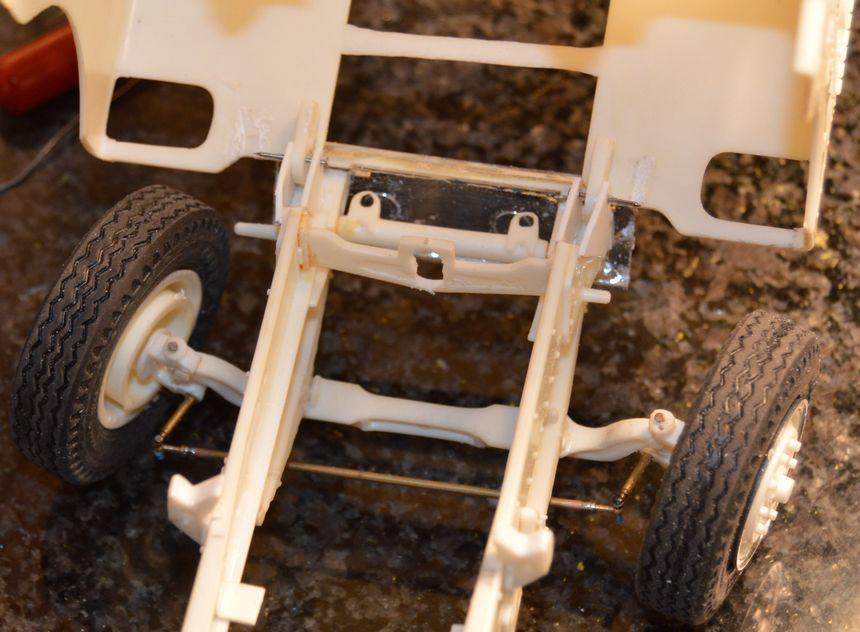

Now, this is what I was looking for! The front steering is pretty much as it will live, with a bit of cleanup. I  moved the axle forward a tad. I moved the cab back, a hair, as well. I am likely going to do something slightly more prototypical, instead of this ridiculous bumper hinge mount! I scuffed the  front tires' sidewalls with steel wool, to dull them, a little. Now, it has just the look I wanted...

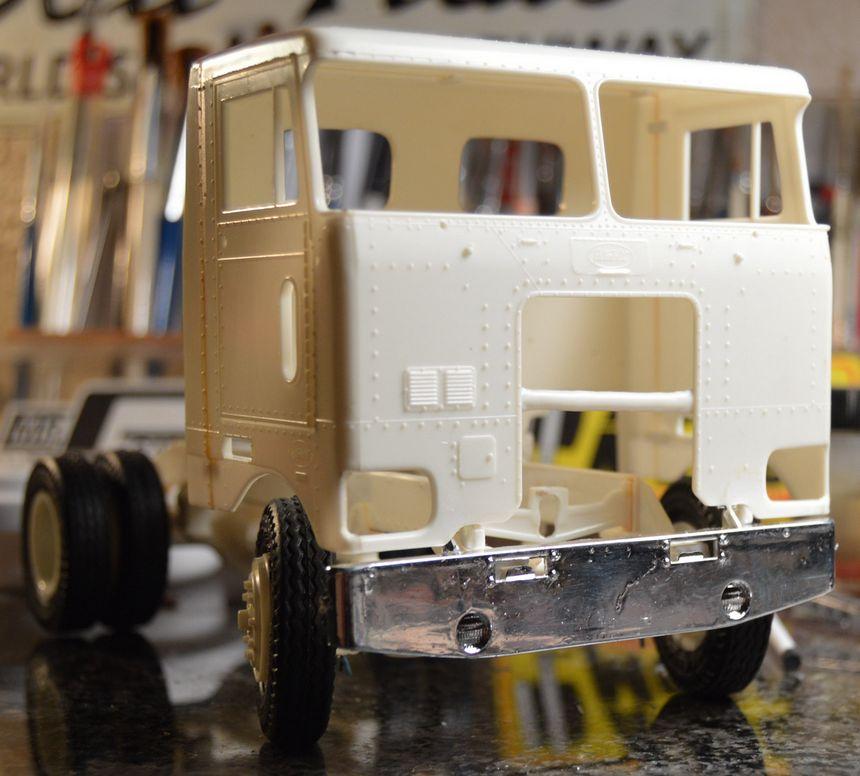

Thanks again, for your interest, and comments. They are much appreciated! You'll note that the cab hinges are now missing from the front bumper (I mean, really?!). I replace the kit's setup with something that, while not prototypical, it IS actually feasible! I still need to make the inner plates, and move the rear cab supports back about 1/16", but, I am satisfied that it is much better than AMT's design. Photos are poor,  sorry. Questions, comments and critiques are always welcome! Thanks for looking!

Nice work on your cab hinges. Looks like you could add another plate next to your current ones to fill in the gap.

Thanks, Dan! I think I can get the inner ones loose, and move them closer to the outer plates, to tighten the gap. It looks pretty sloppy, like this, for sure!
