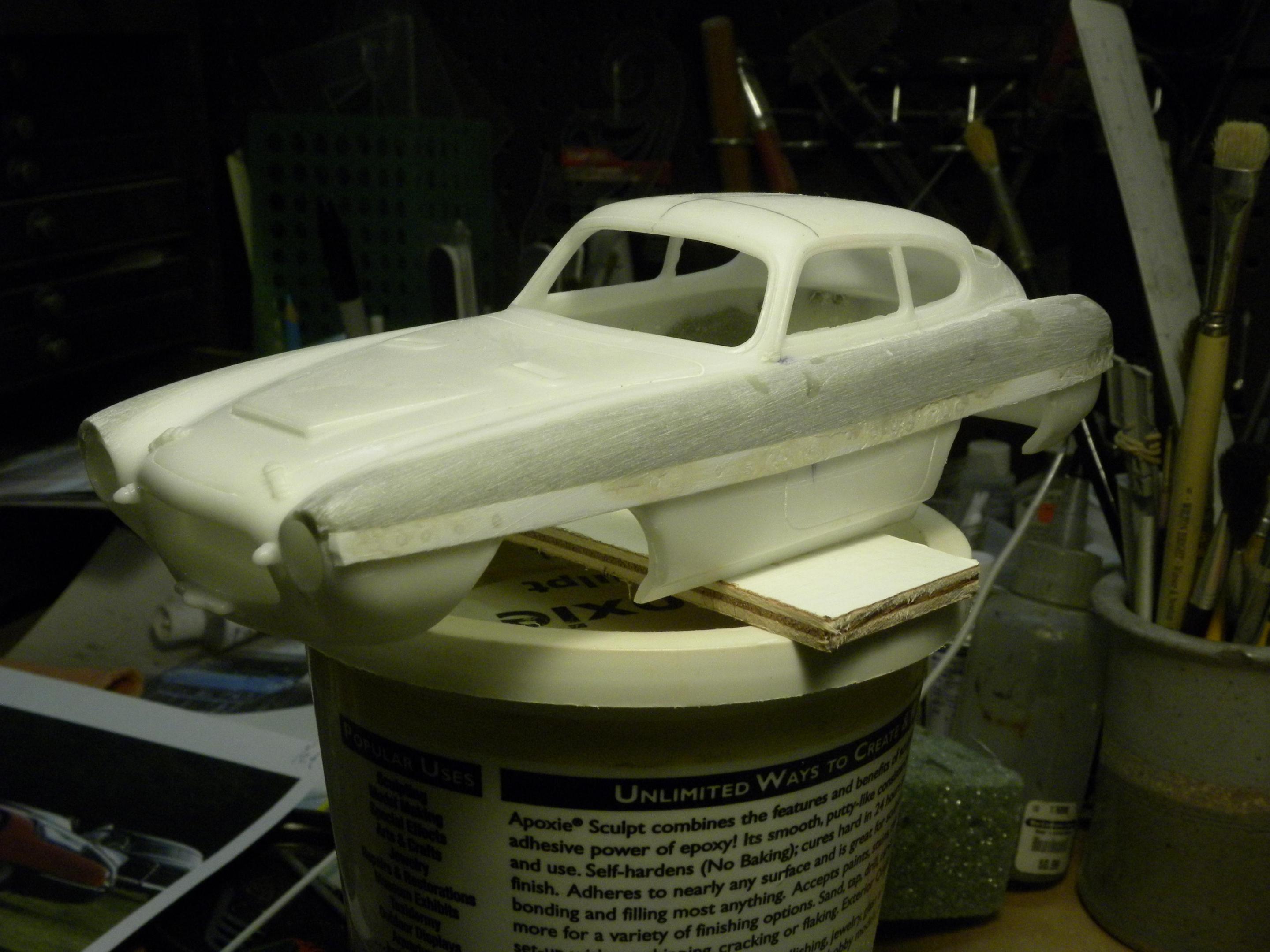

Pico Posted July 8, 2020 Author Share Posted July 8, 2020 The Thrill has a prominent beltline running rather low, and forming the tops of the wheel openings, which I'm replicating with a strip of .040" glued and pegged into the body. Quote Link to comment Share on other sites More sharing options...
Jantrix Posted July 8, 2020 Share Posted July 8, 2020 2 hours ago, Pico said: The Thrill has a prominent beltline running rather low, and forming the tops of the wheel openings, which I'm replicating with a strip of .040" glued and pegged into the body. I don't understand the pegs. Isn't glue enough? Quote Link to comment Share on other sites More sharing options...
Pico Posted July 8, 2020 Author Share Posted July 8, 2020 1 minute ago, Jantrix said: I don't understand the pegs. Isn't glue enough? When I build, I build to last forever. Quote Link to comment Share on other sites More sharing options...

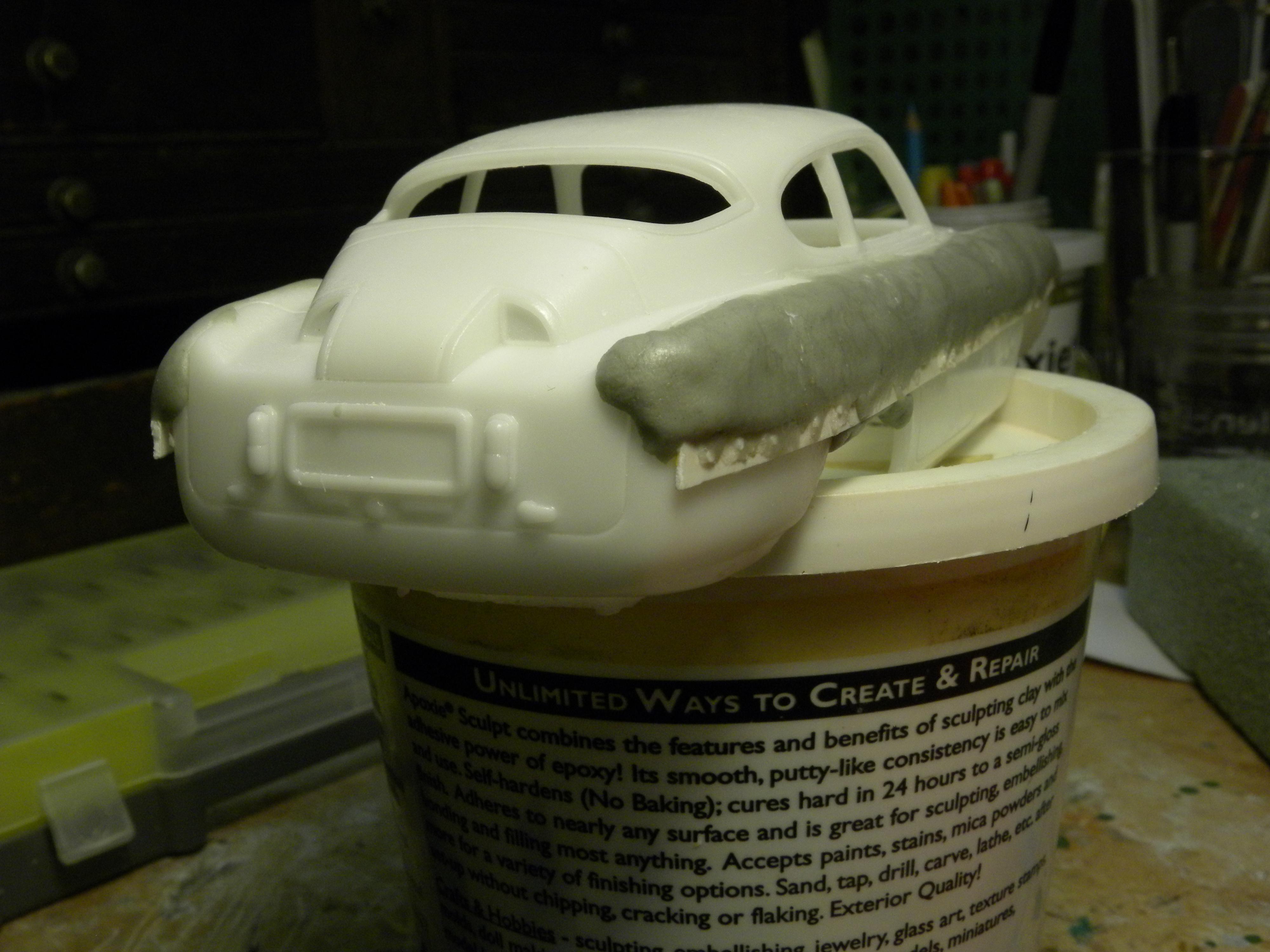

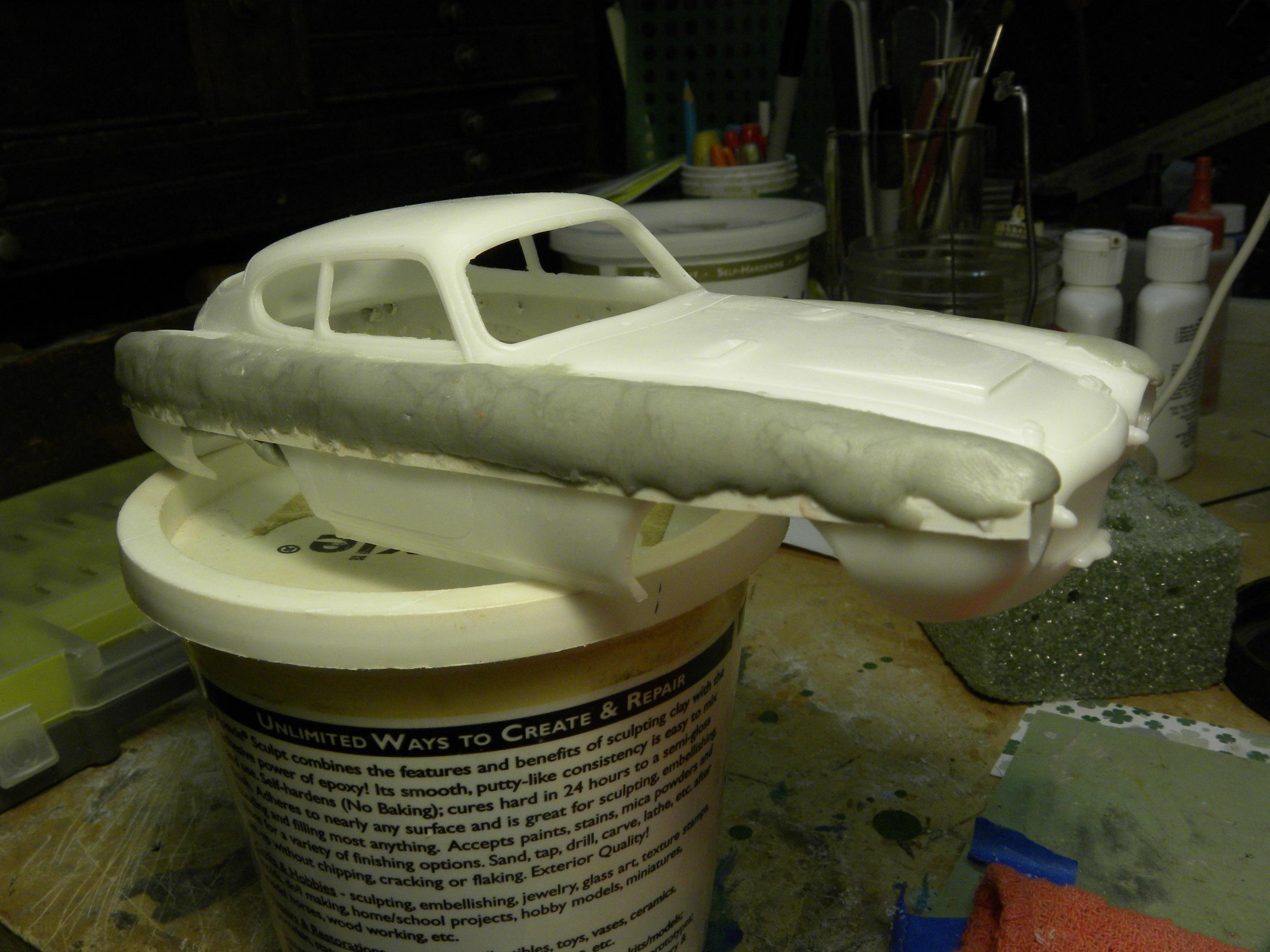

Pico Posted July 8, 2020 Author Share Posted July 8, 2020 Putty time. I use Aves Apoxy Sculpt: https://avesstudio.com/shop/apoxie-sculpt/ It has a long working time and is easy to sand and takes paint very well. Slow setting time, about 6 hours. Quote Link to comment Share on other sites More sharing options...

absmiami Posted July 8, 2020 Share Posted July 8, 2020 Got a use for that putty ... thanks ... Quote Link to comment Share on other sites More sharing options...
Pico Posted July 9, 2020 Author Share Posted July 9, 2020 15 hours ago, absmiami said: Got a use for that putty ... thanks ... You will love it. Quote Link to comment Share on other sites More sharing options...

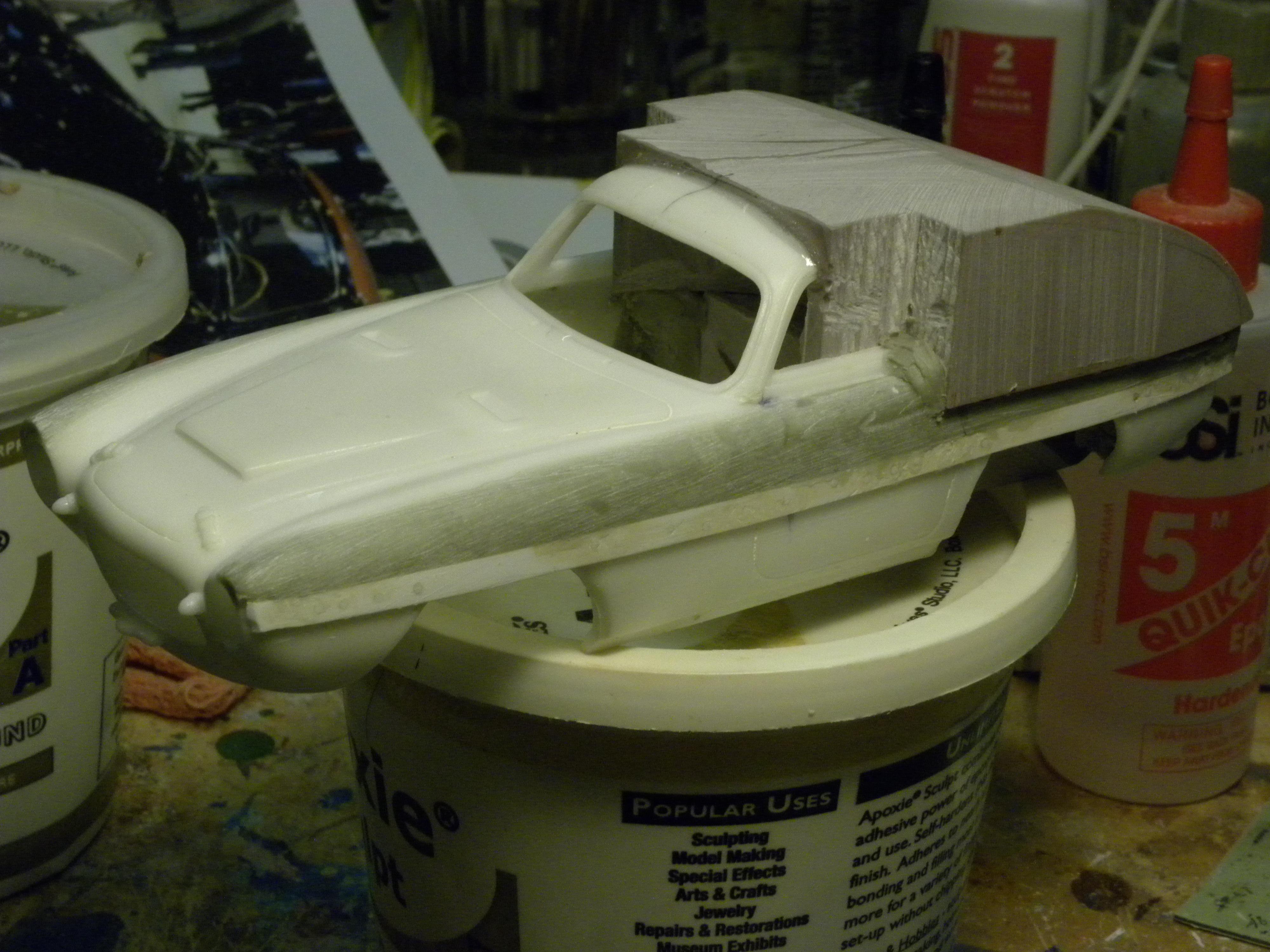

Pico Posted July 9, 2020 Author Share Posted July 9, 2020 Renshape time. Quote Link to comment Share on other sites More sharing options...
absmiami Posted July 9, 2020 Share Posted July 9, 2020 Yeah renshape ... Quote Link to comment Share on other sites More sharing options...

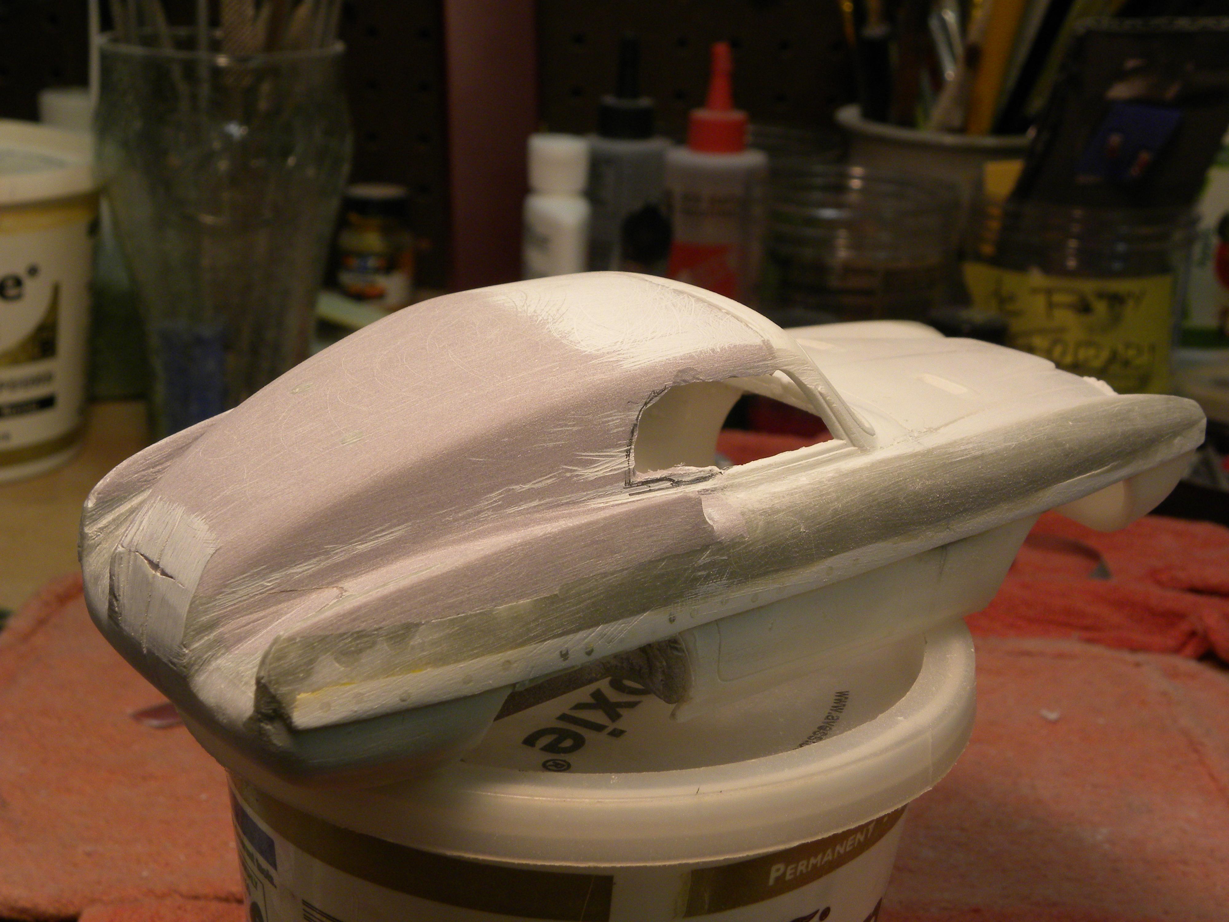

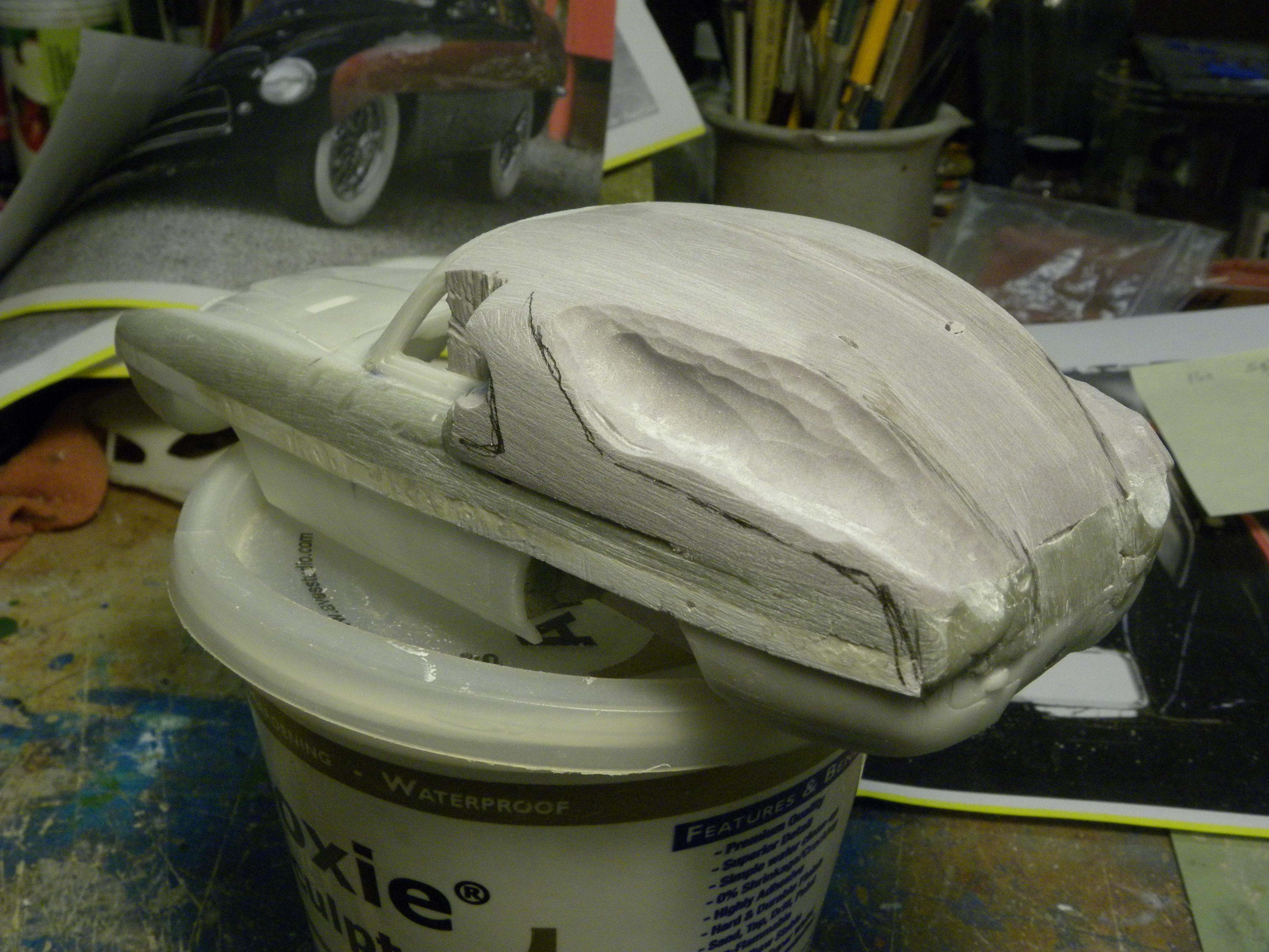

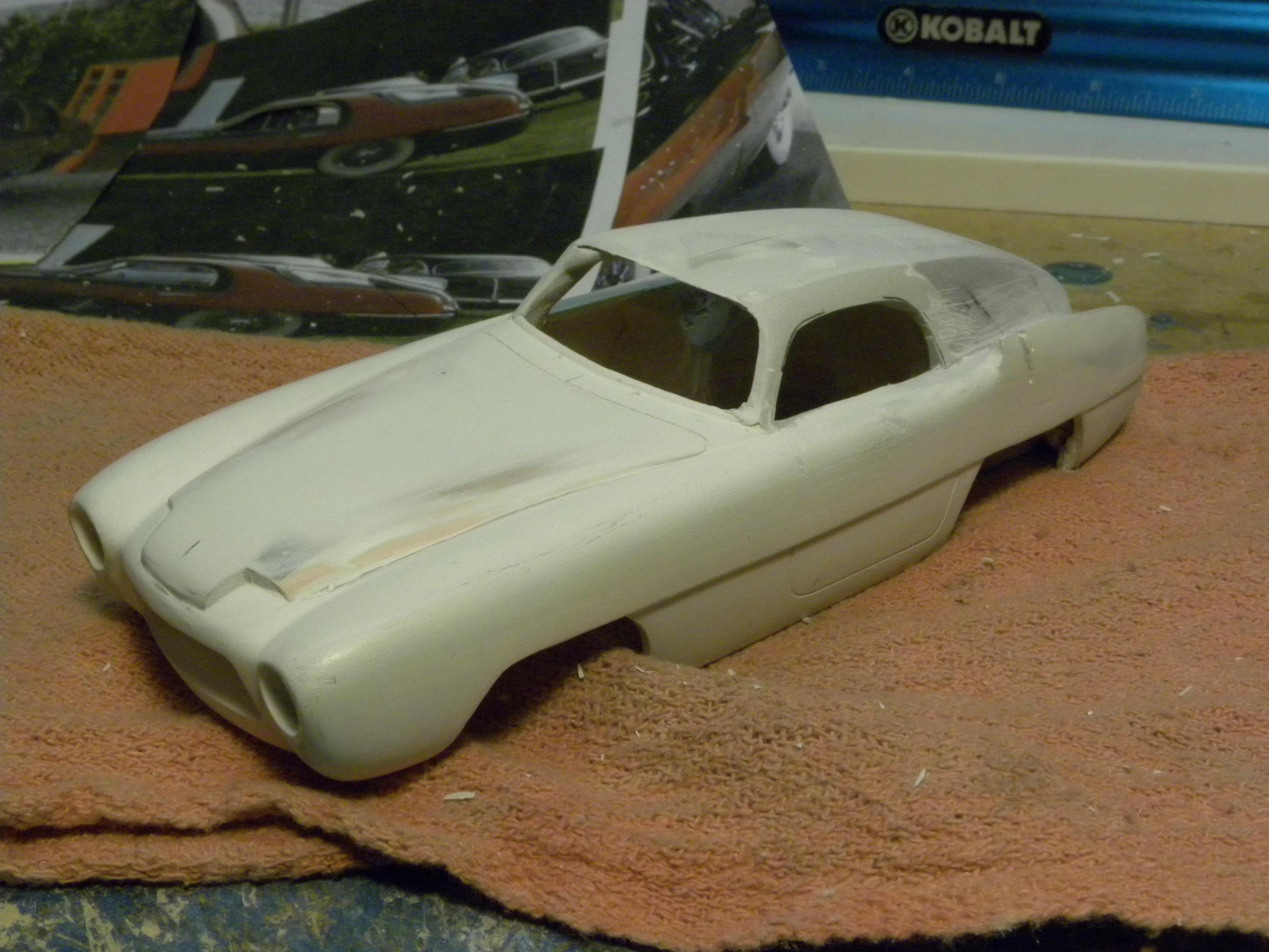

Pico Posted July 10, 2020 Author Share Posted July 10, 2020 It's time to go to work. Quote Link to comment Share on other sites More sharing options...

Pico Posted July 11, 2020 Author Share Posted July 11, 2020 More sanding, beginning to find it's shape. Quote Link to comment Share on other sites More sharing options...
cobraman Posted July 11, 2020 Share Posted July 11, 2020 Wow ! Quote Link to comment Share on other sites More sharing options...

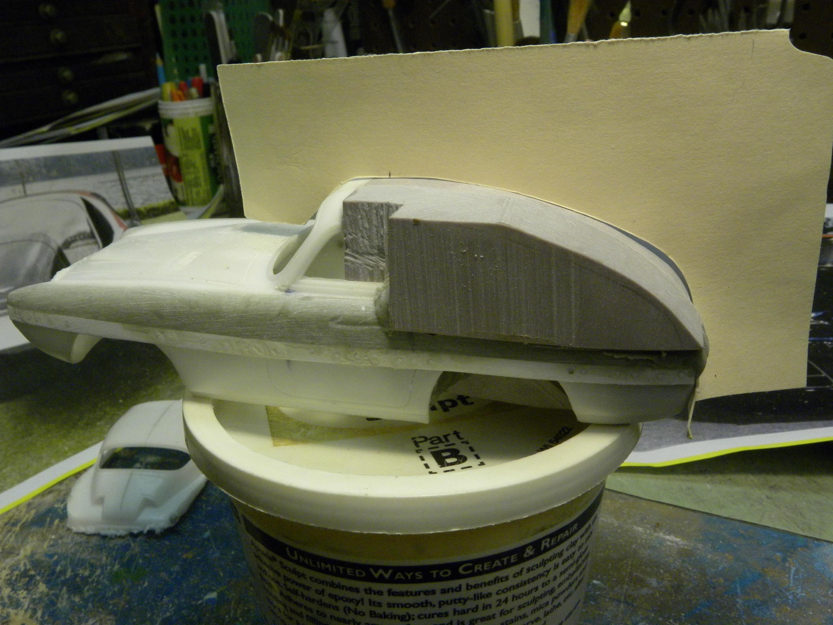

Pico Posted July 12, 2020 Author Share Posted July 12, 2020 Made a mold, of Apoxpy Sculpt, to form the flying buttresses over. Flying buttress is an architectural term but used in other contexts; so I'll use it here. Quote Link to comment Share on other sites More sharing options...

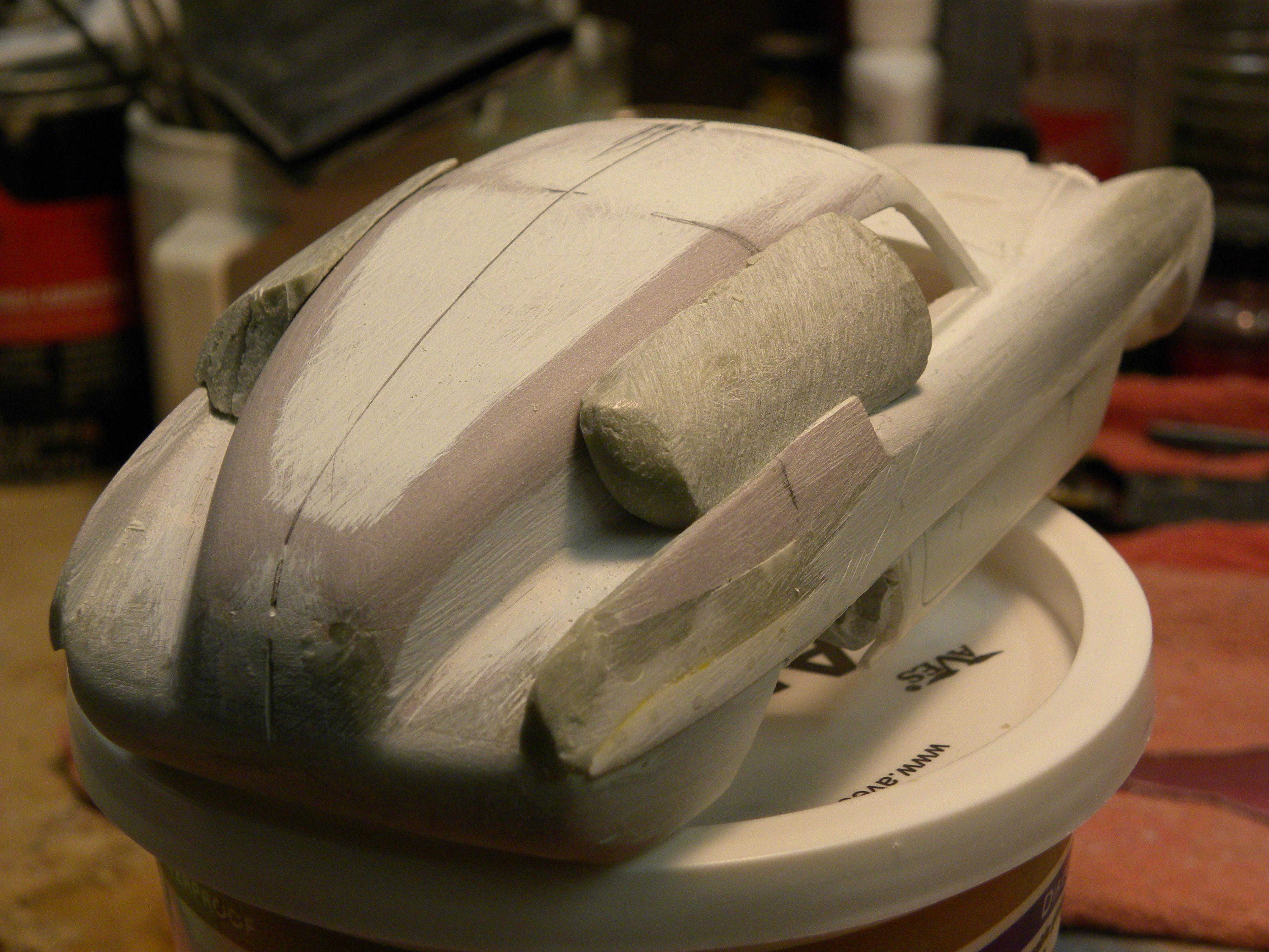

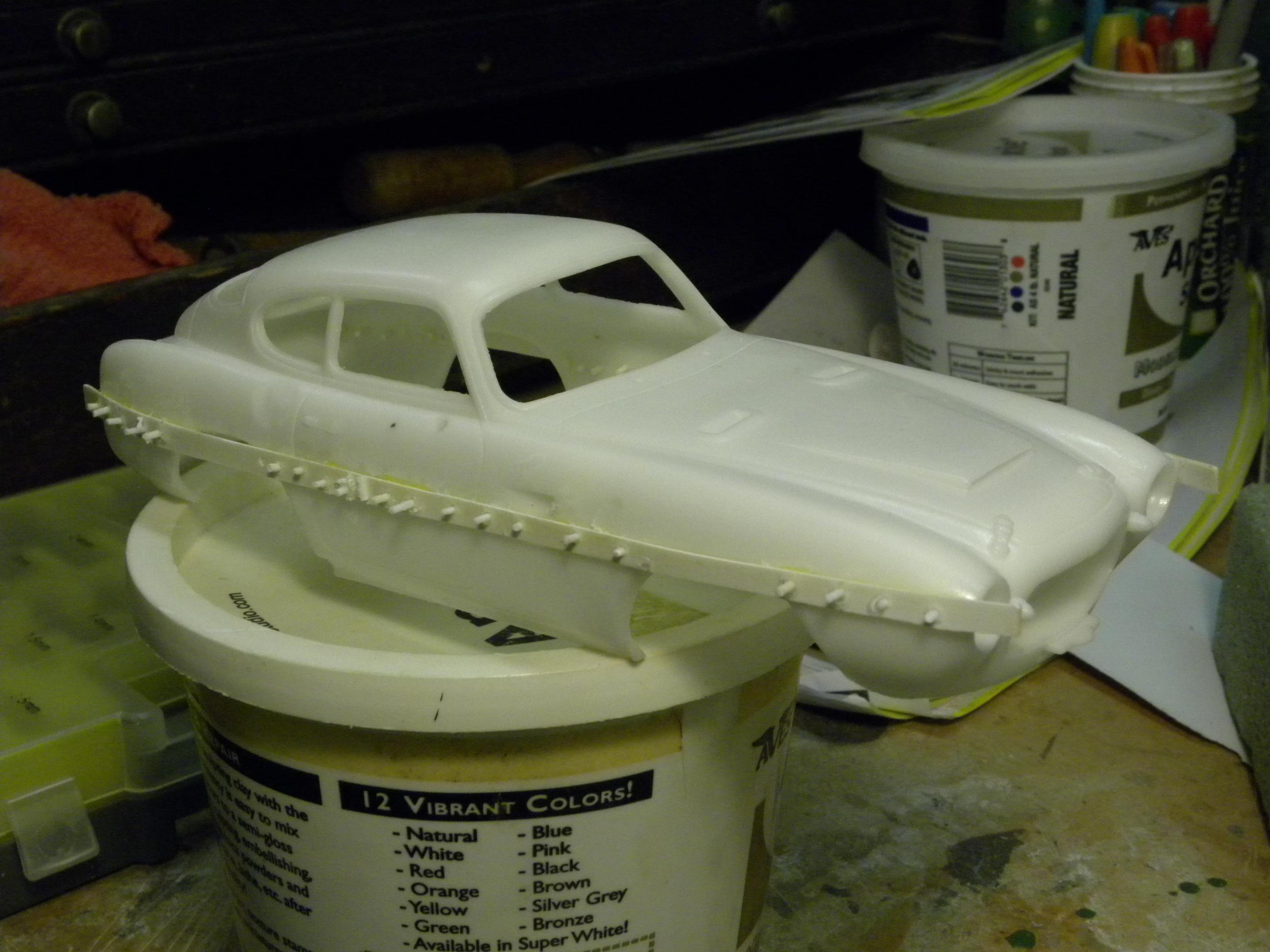

Pico Posted July 13, 2020 Author Share Posted July 13, 2020 More sanding and drilled out for brass reinforcing rod for flying buttress. Quote Link to comment Share on other sites More sharing options...
