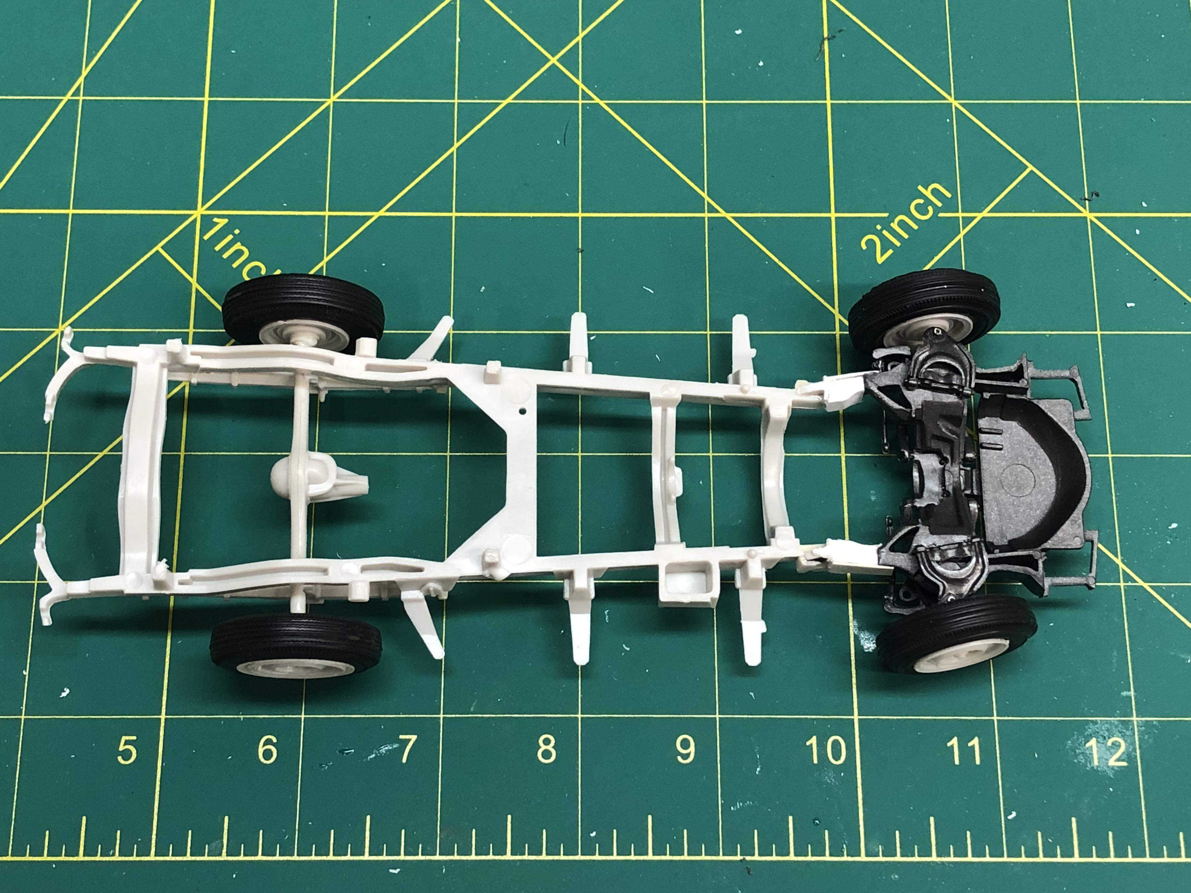

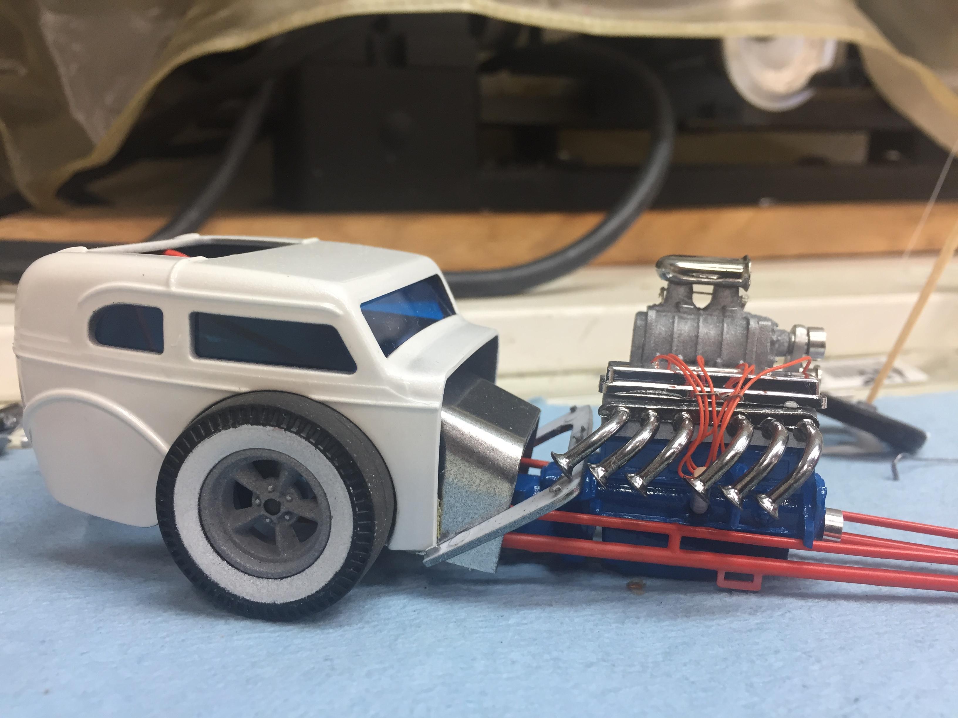

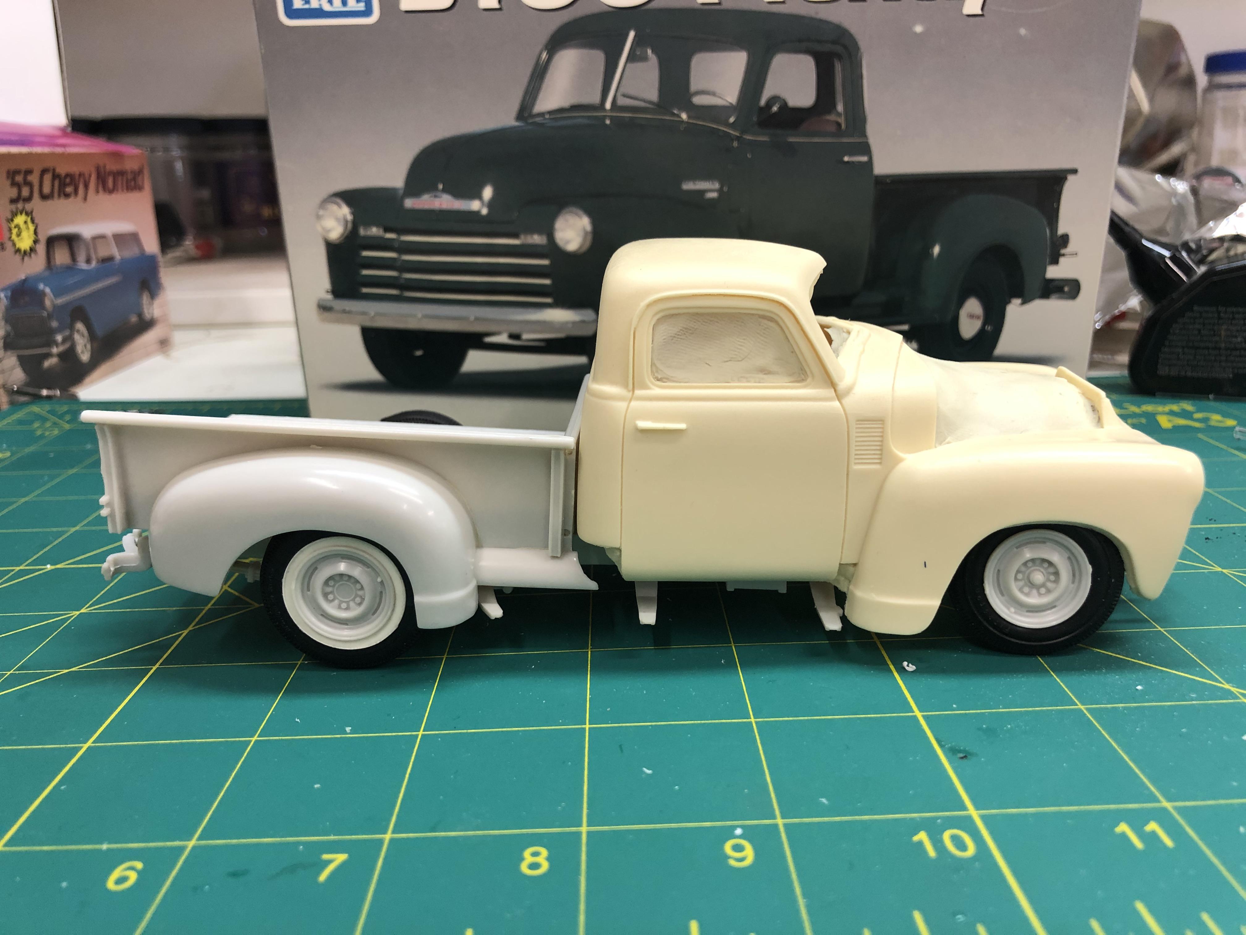

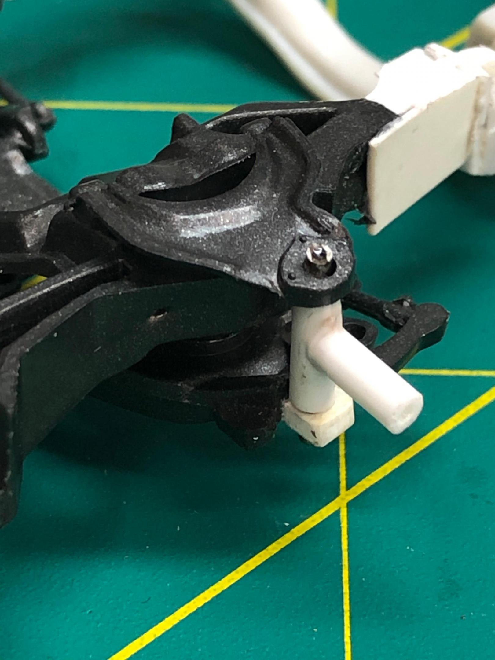

Stance is everything in any hot rod. On early Chevy trucks the semielliptical front suspension really limits how low you can drop the front end. My ’51 has a Mor Drop front axle and it is anything but in the weeds. My model gets a subframe, in this case the front clip from the  Revellogram ’59 Caddy which just happened to be the first kit I grabbed off my shelf. Since the Caddy kit lacks poseable front wheels, I fabbed some spindles from Evergreen and king pins from stainless tubing.

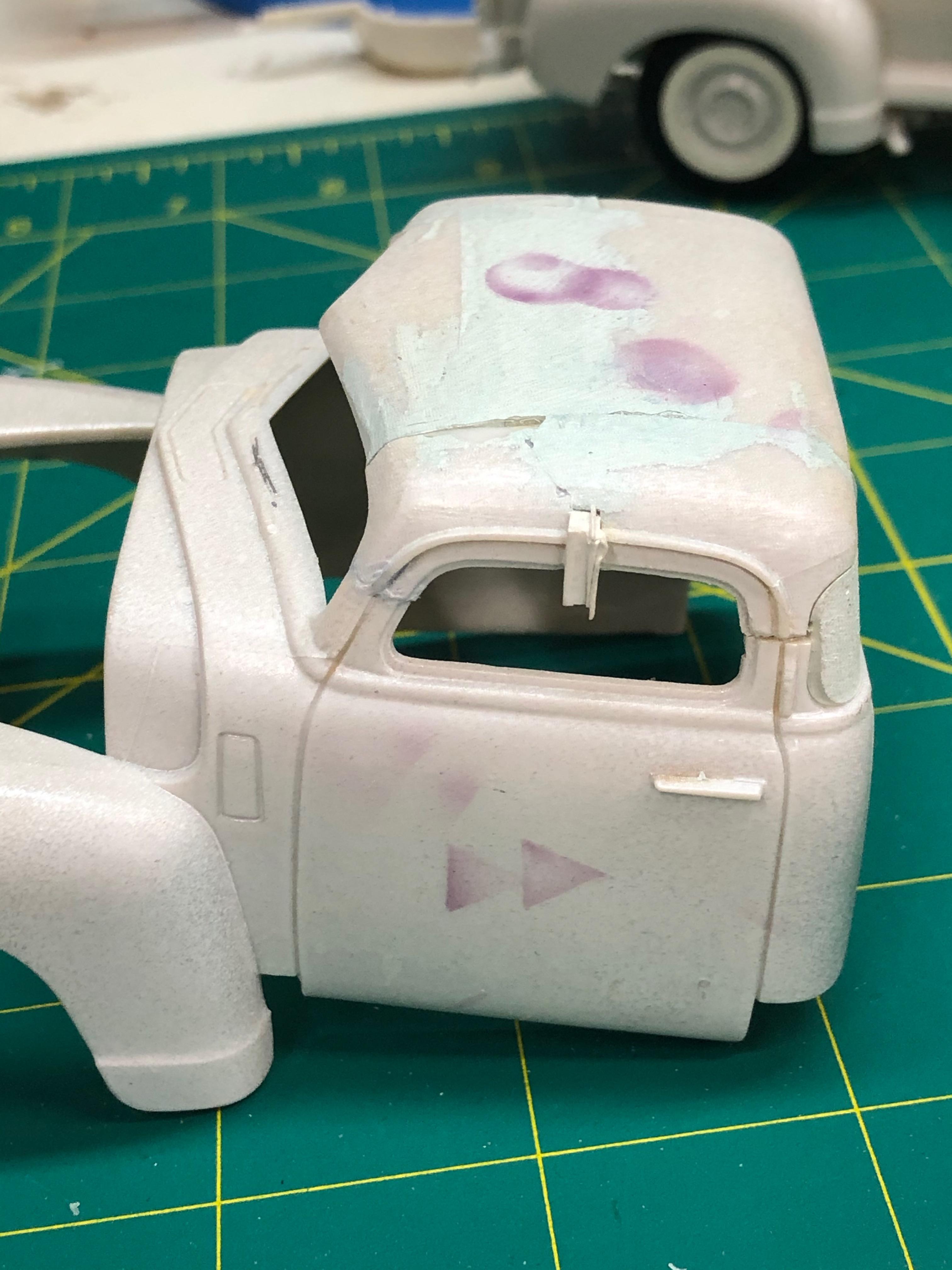

I got started on the top chop before I realized I could let Jimmy Flintstone do all of the hard work so I snagged a resin body on Ebay.
This is everything I’ve done so far held together with Elmer’s glue. I’m going for a beater vibe, weathered paint but minimal surface rust, tinted glass with a few period decals, using the inline six and stock trans. Stay tuned.

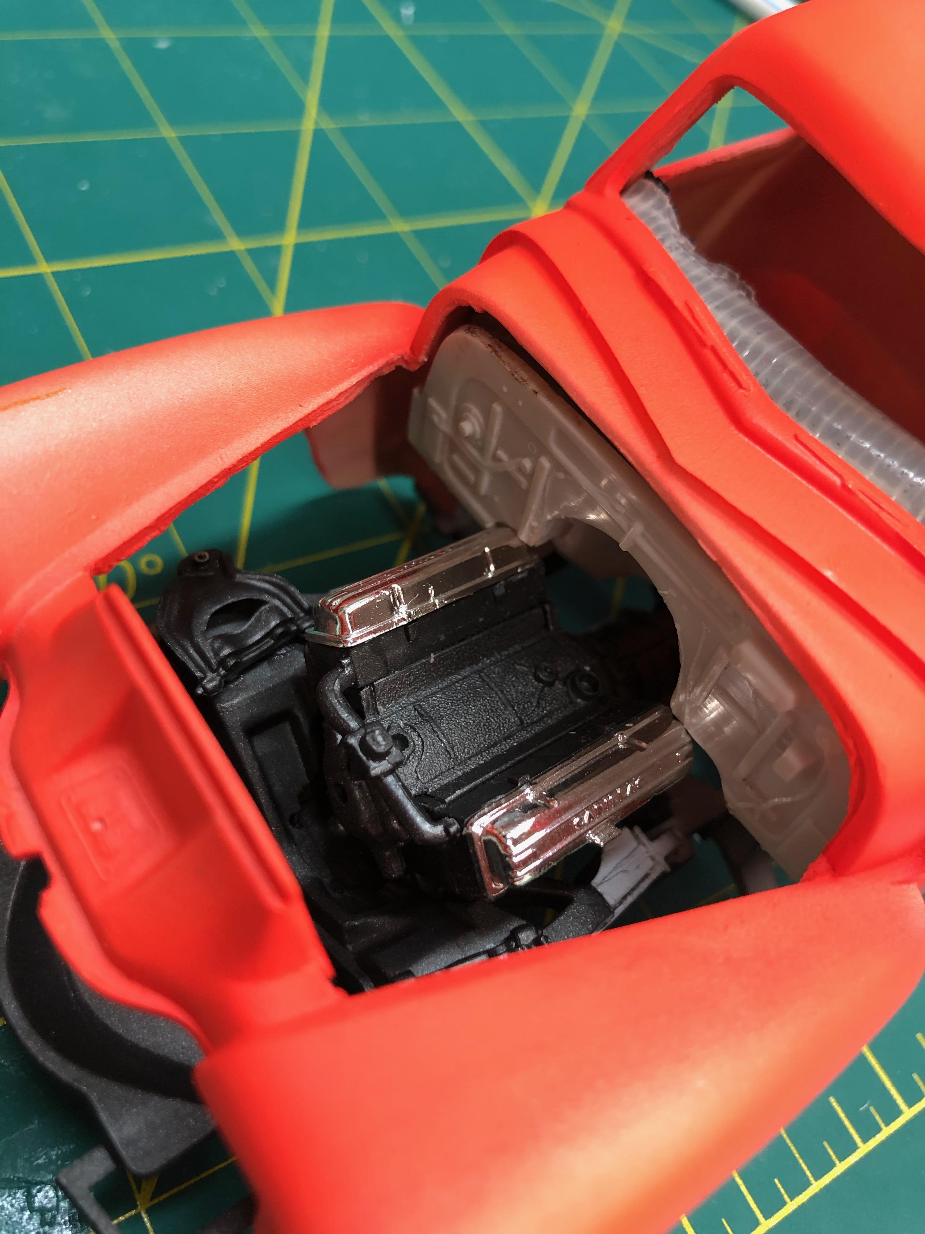

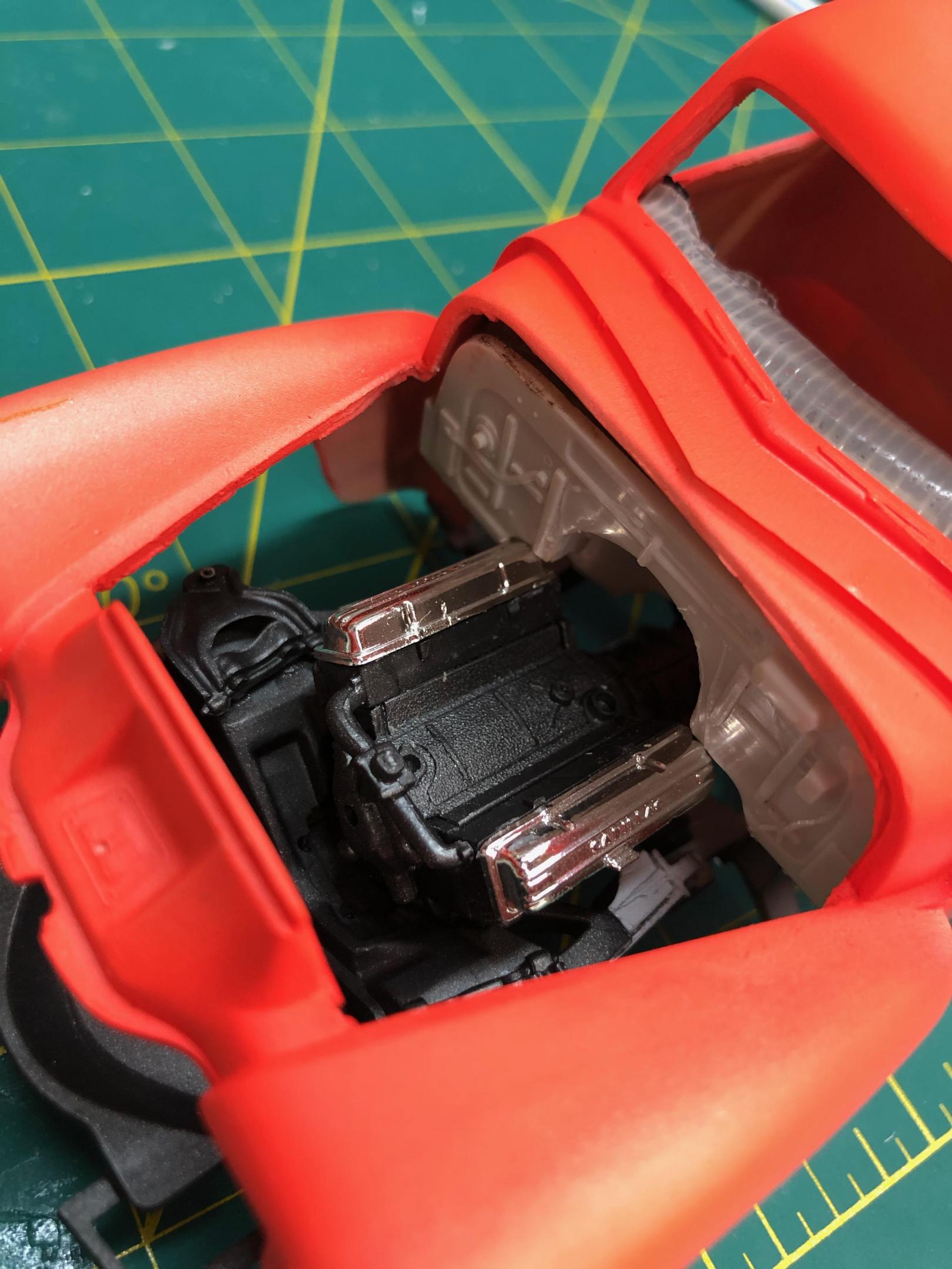

So I decided since I have already raided the Cadillac kit for the front suspension I might as well use the engine as well. I even had a set of valve covers that had been plated by Chrome Tech 20 years ago!! I wanted to use to stock engine mounts which set the engine pretty far back .A little surgery on the firewall and I was in business.IMG_5502.thumb.jpeg.a953ae30126bd607dc1a745be0f38a24.jpeg

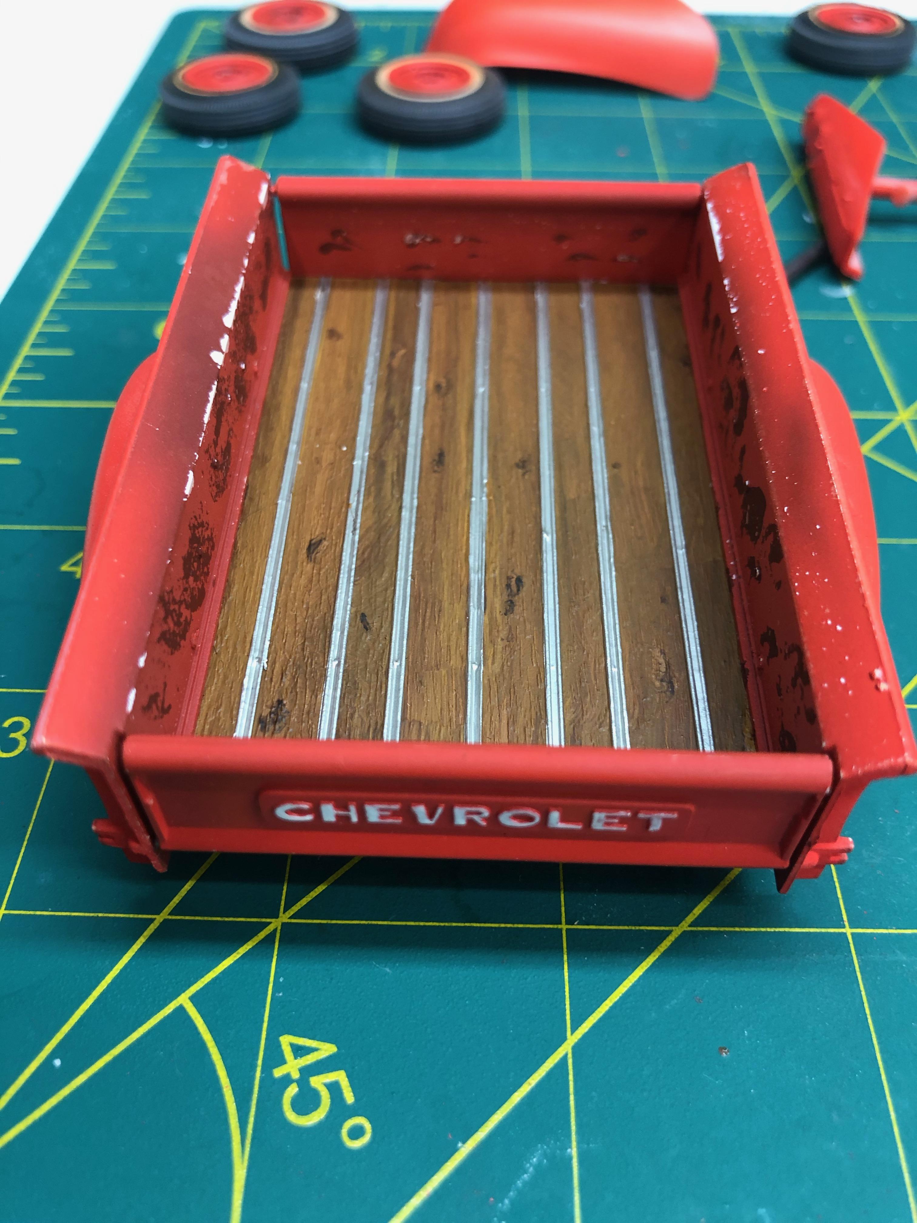

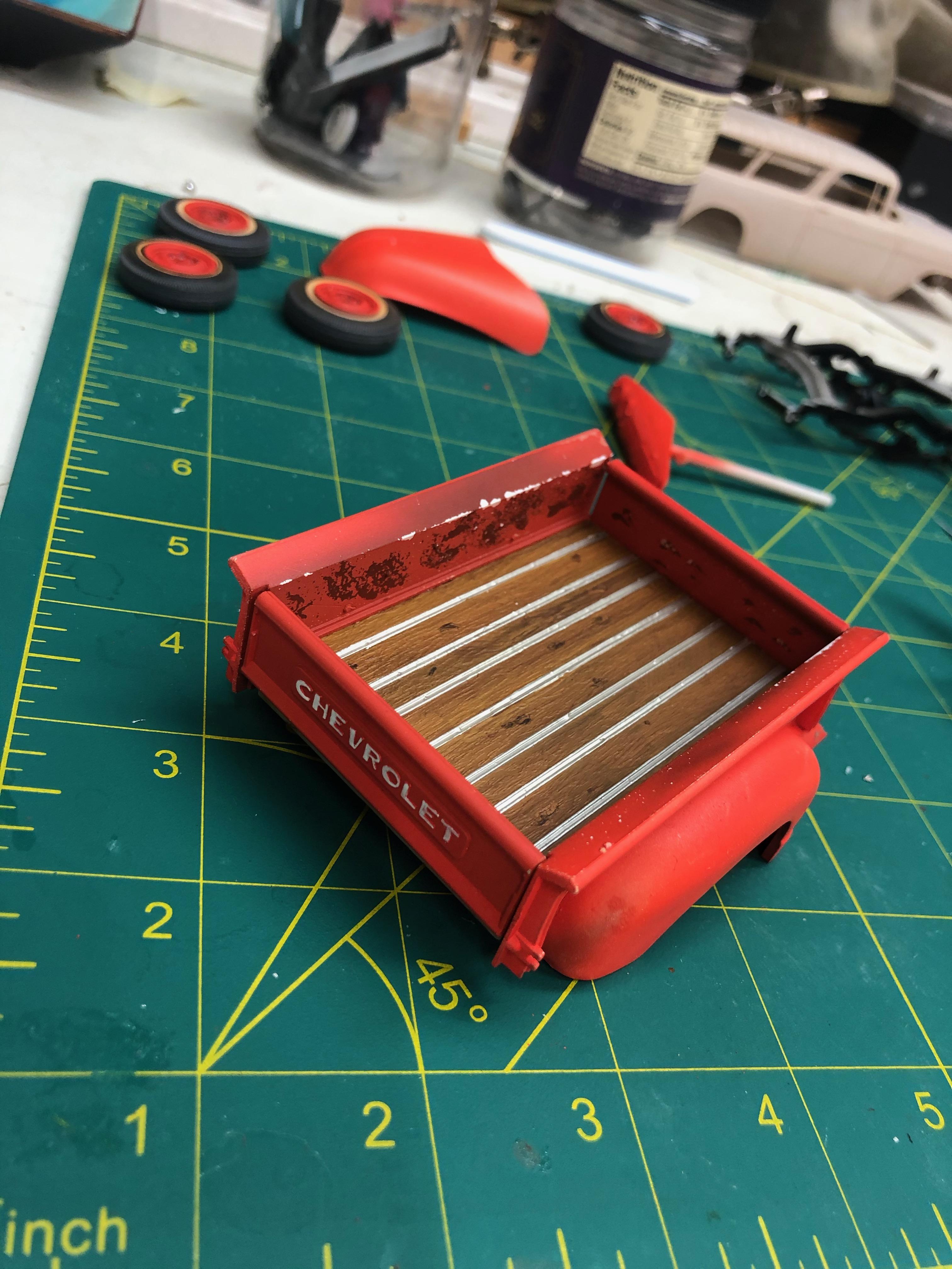

I painted the body with Testors orange and did some light weathering. Found a really cool Fred Cady nostalgic speed shop decal sheet which provided the signage. I wood grained the bed using artist oils and a technique that can be found at this address http://www.clubhyper.com/reference/woodgrainel_1.htm
Check it out, first time I tried this and it turned out great!!

Glad to see you're back on this one. The firewall may need even a little bit bigger relief for the valve cover clearance. The bed floor looks outstanding, are the metal strips going to be painted or chromed ?   I also like the painted wheels with the white walls.

Great question about  bed floor. They are chromed on my 1:1 truck. I’ll probably go with BMF then dullcoat and maybe mist some rust enamel from my airbrush. I have a bit of work left on the firewall before painting. Thanks for looking!

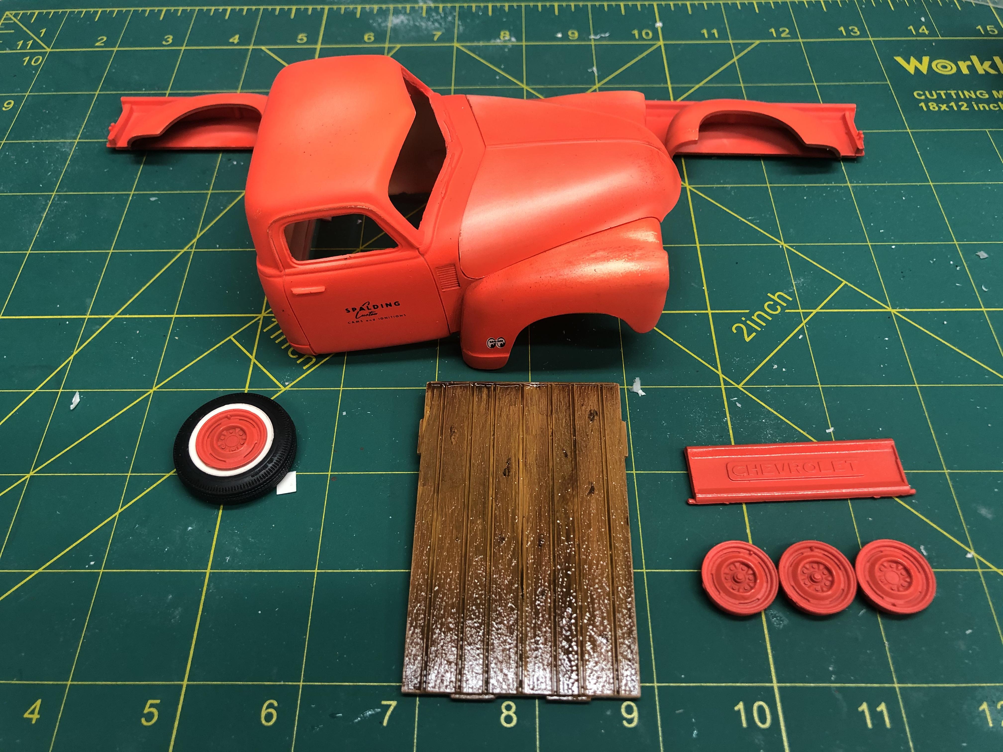

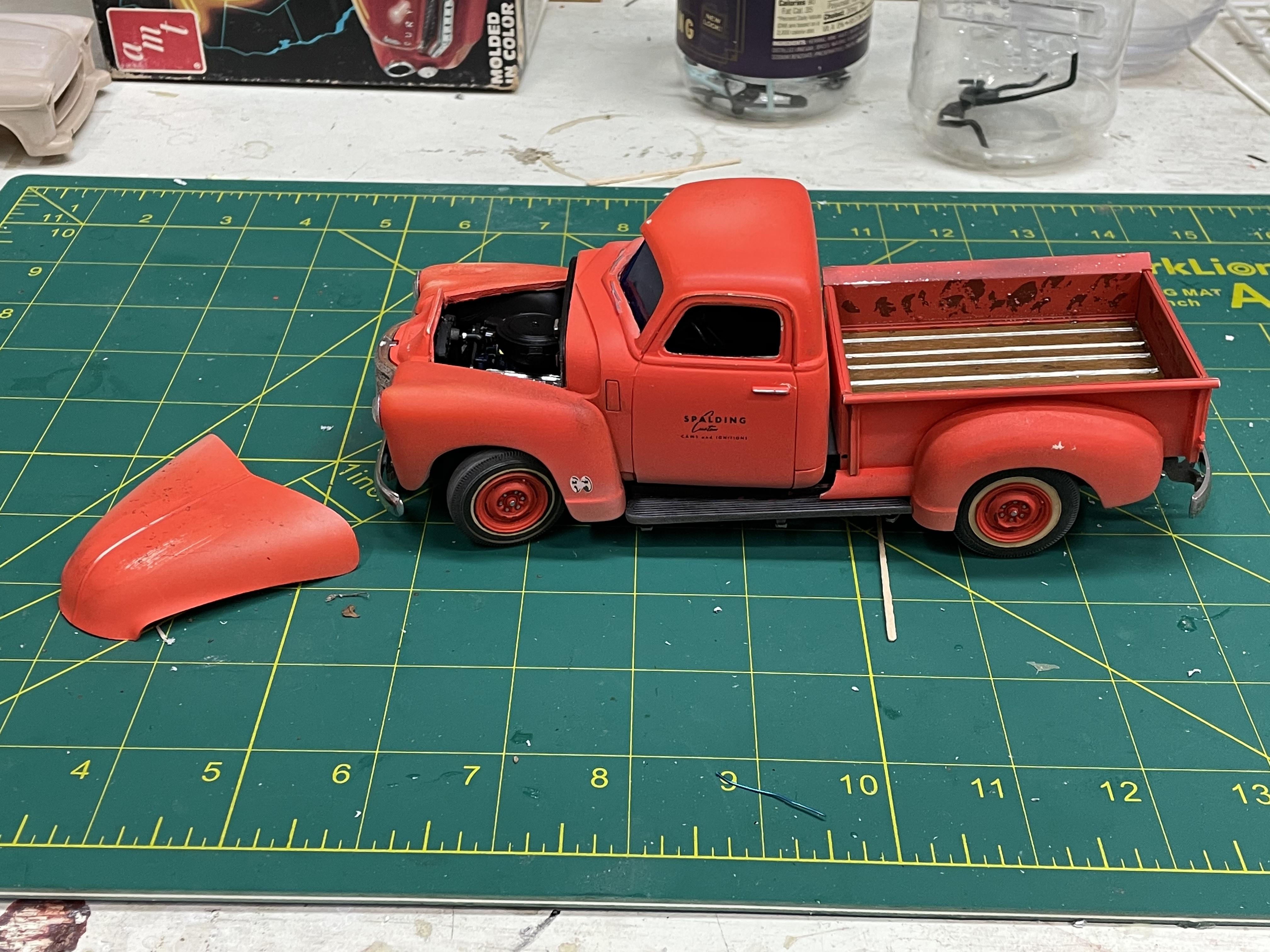

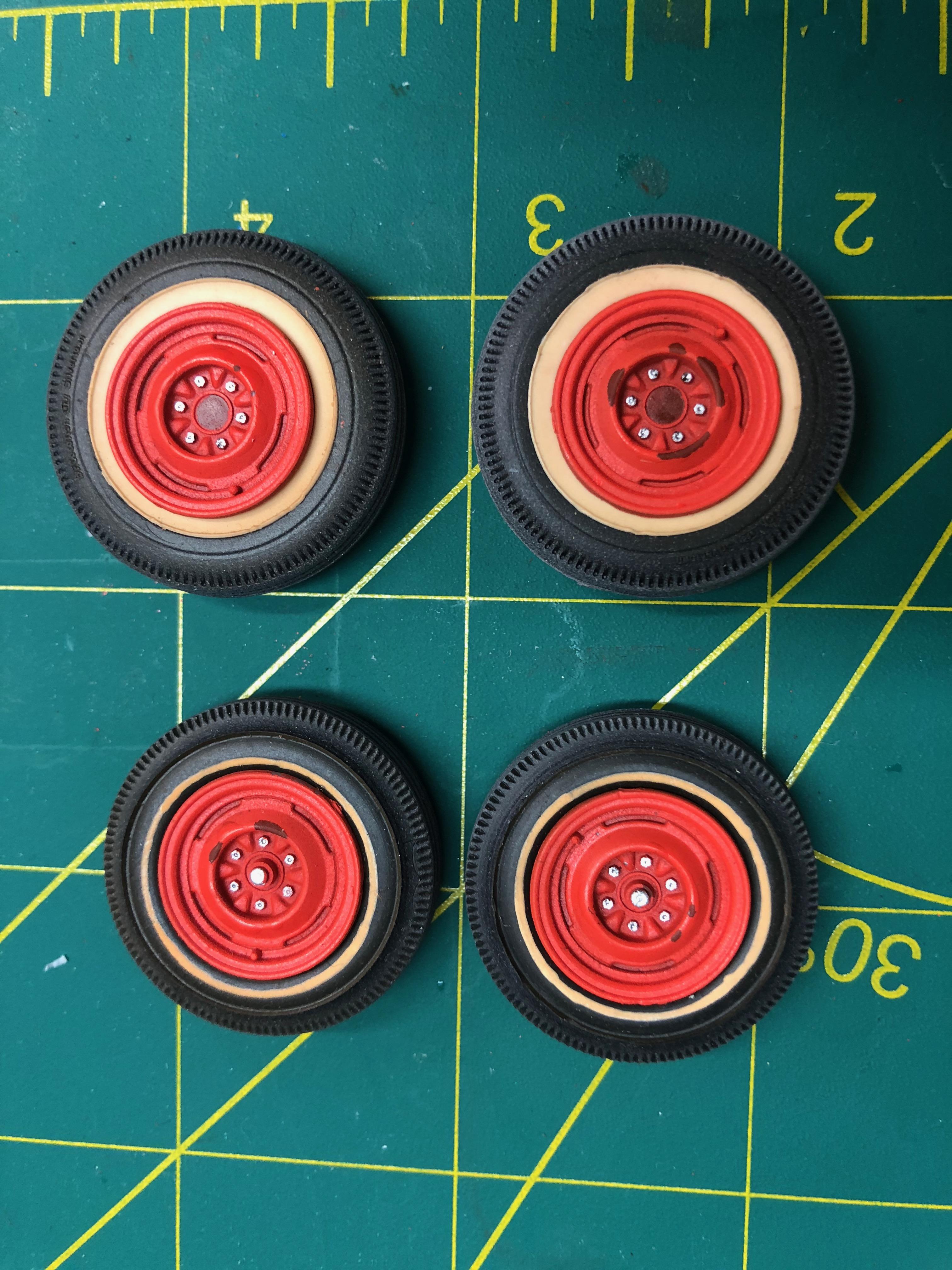

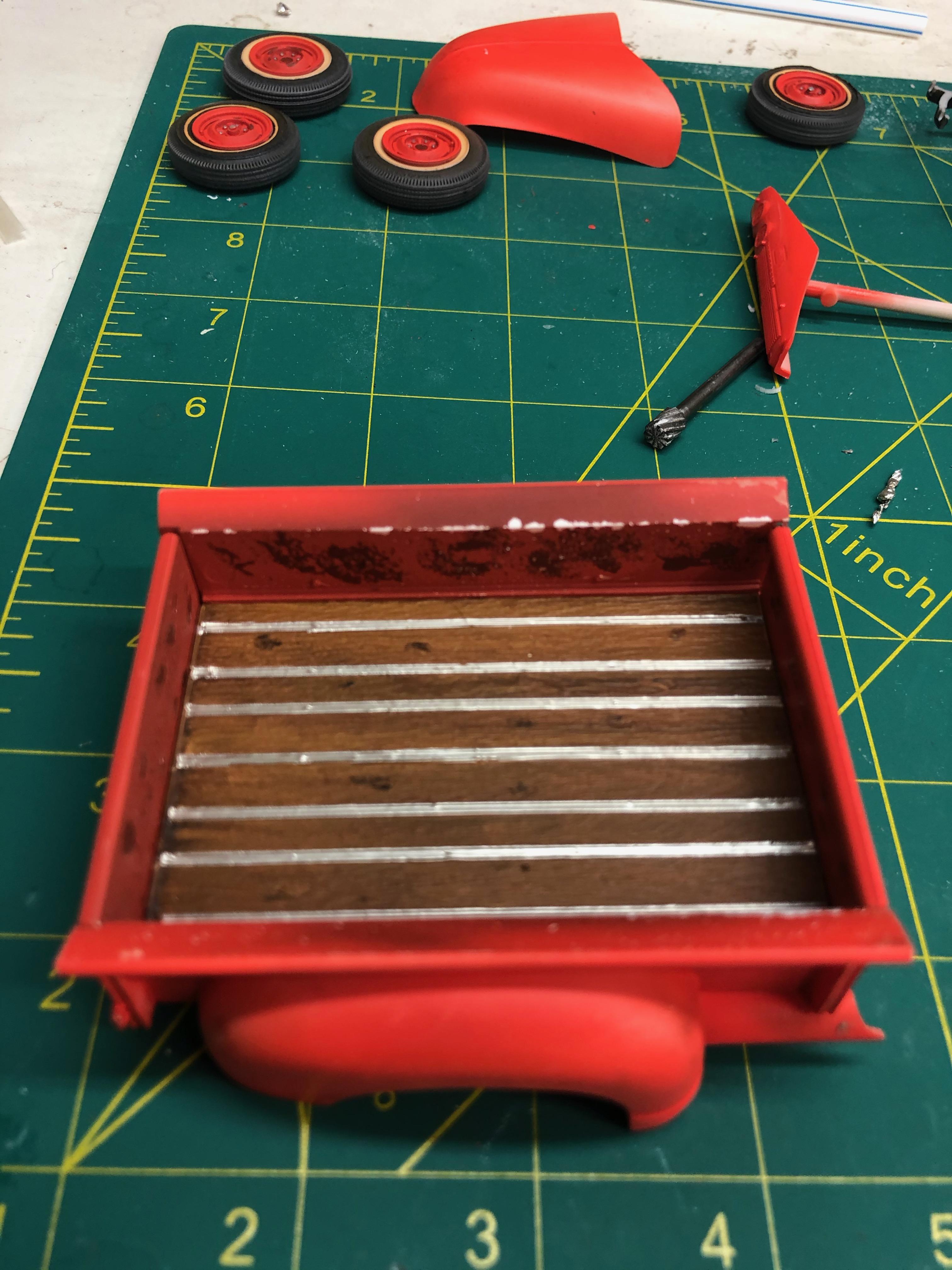

It's kind of subtle but I have a lot of time in weathering these wheels and tires. I used a chipping technique on the wheels that utilized a Testors rust base coat, a few dabs of white glue in the areas to be chipped, followed by Testors orange and, finally,  Dullcoat. I used a wash of Tamiya flat black after painting the lug nuts, bearing caps (front) and axle ends (rear). The thin front white walls in front were created with a circle template and a gel pen. The rears are the inserts that come with the monogram tires. Each tire was mounted on my Dremel and, while spinning at low speed, dusted on the tread and sidewall surfaces with Testers dust enamel. The whitewalls were aged by airbrushing Floquil rust on the spinning tires . A lot of work but worth it.IMG_5583.thumb.jpeg.7509f467a7ab0bd60a0b9ec565952d18.jpeg
The bed was similarly chipped using the white glue technique utilized for the wheels. There are so many cool YouTube videos about weathering techniques. I spend hours watching these and trying them out at my bench. I Bare Metal Foiled the bed rails then applied Dullcoat. I used a white gel pen to letter the rear gate. Once this thing is done I'm going to load the bed with rusty flathead parts.IMG_5585.thumb.jpeg.66e6bf36a74a0a4c75148e43f330a098.jpeg
Really like where you are going with this build.  I have a couple in my stash and will hopefully some day get to them.  Just wondering about spraying those tires with enamel.  Are they dry yet.  In my experience enamel never dries on those tires, it will stay tacky forever, but acrylic works very well.  Just my $.03 (adjusted for inflation).
Share this post
Link to post

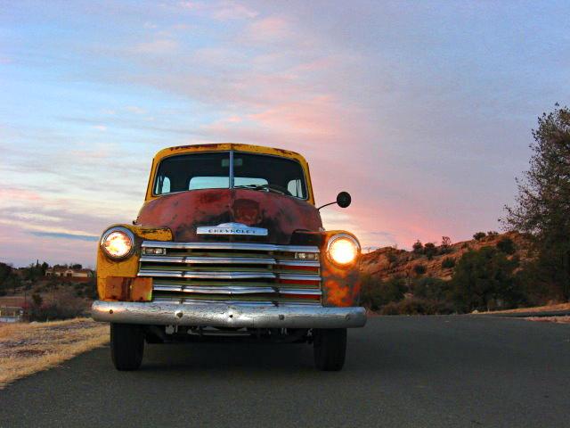

     Hahahaha ! I’ll be switching to acrylic since Pegasus just informed me that Model Master is no more ! I already used my last drop of Model Master dust and Tamiya buff is really close.  I’ve never had a problem with the enamel failing to dry on tires but I’m shooting it very dry and the tire is spinning so very little paint is being applied. As for the Floquil I similarly have never had a problem. Floquil rust is semi transparent and it is absolutely perfect for “aging” white walls. I don’t know what I’m gonna do when I run out. They are already getting 18 bucks a bottle on eBay !!
       I love that picture Kurt posted. Tomorrow morning I’m going to Dullcoat the grille and do a fine stippling with rust. I kept blowing output seals on my M-22 until a transmission guy told me my driveshaft was too long !! I would have never figured that out on my own !!

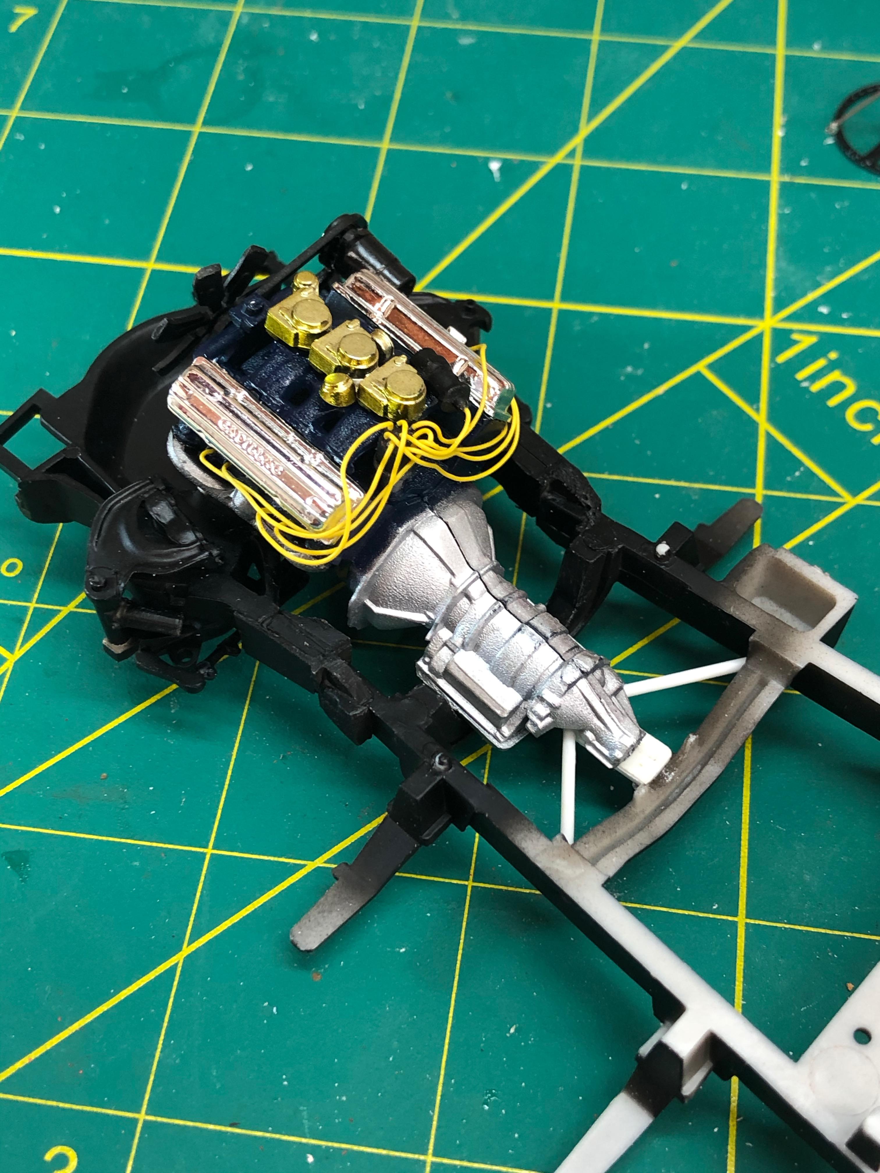

I haven’t been goofing off, just working very slowly! The Cad mill is done no thanks to the instruction sheet which has the exhaust manifolds reversed and neglects to show any distributor (the kit has a nice distributor BTW). I hope Cadillacs have the same firing order as SBCs or this thing is going to have a terrible misfire. image.thumb.jpeg.33cea96b9467881ac36766583363414e.jpeg

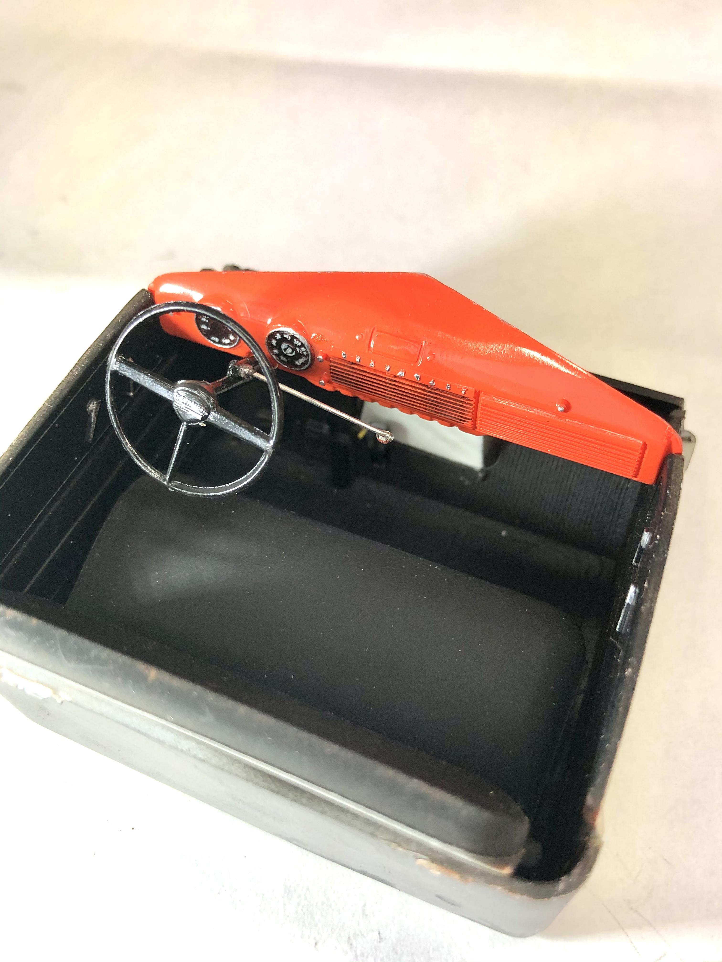

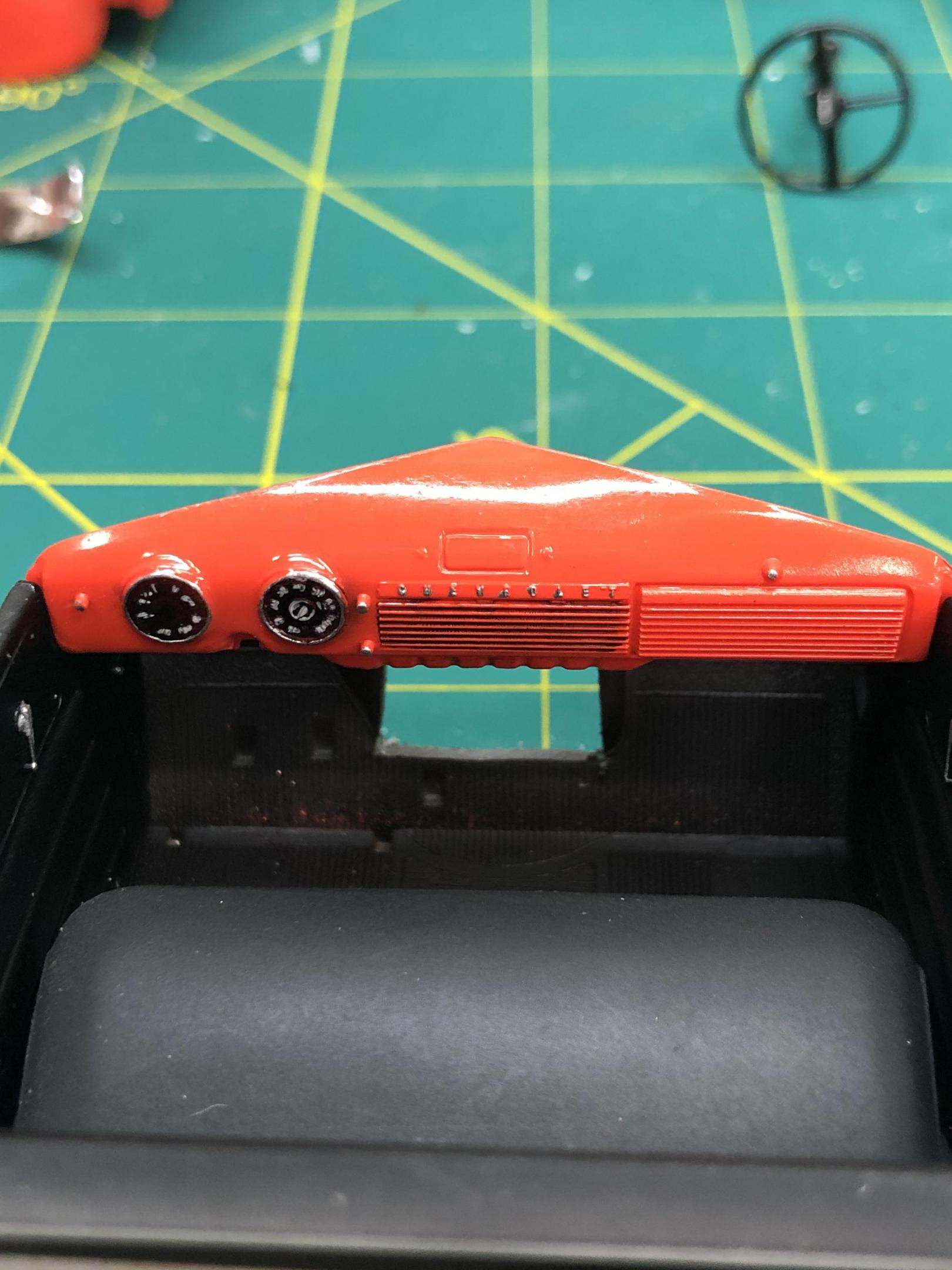

Used the Molotow to detail paint the dash and Micro-Scale  Krystal Klear for the gauge covers. I painted the seat with flat black enamel and then, after a week, burnished the surface with my finger tip after a trip to Popeyes. Yeah it’s gross but what a great technique. That’s all for now.image.thumb.jpeg.9861e06367aa765e587289abcab1de5c.jpeg

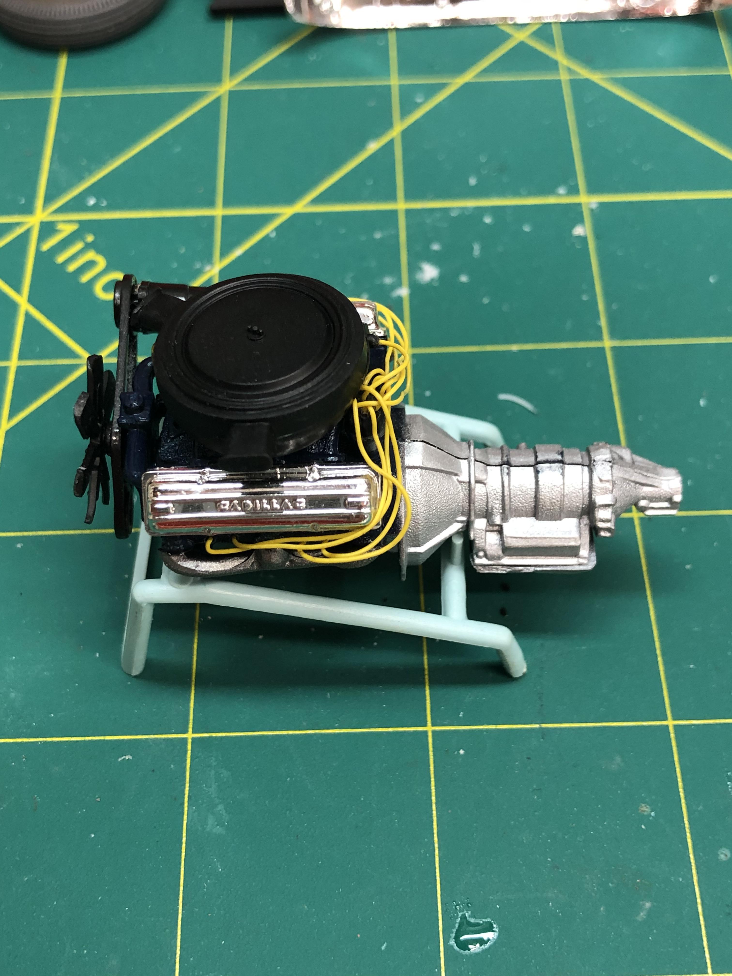

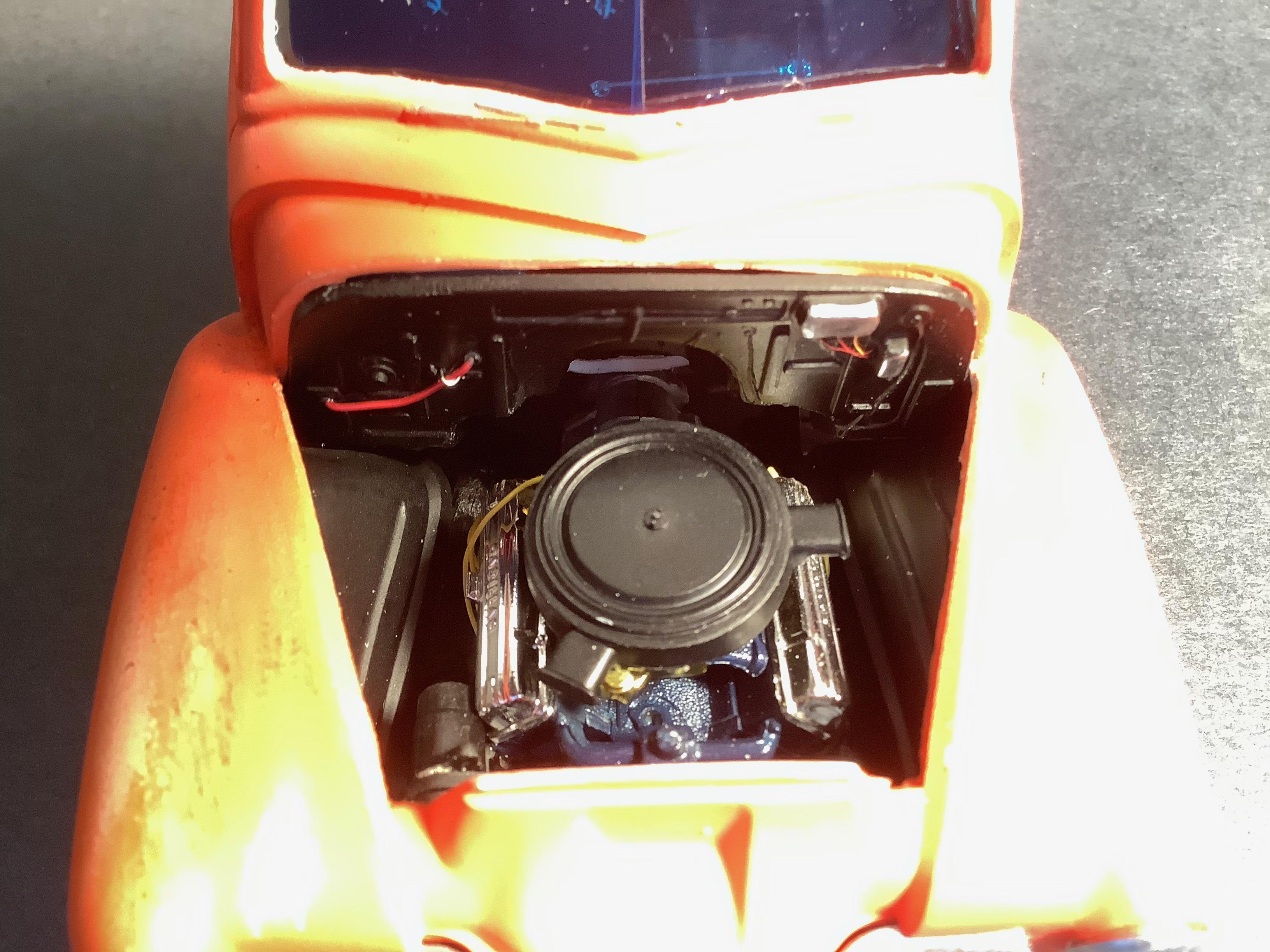

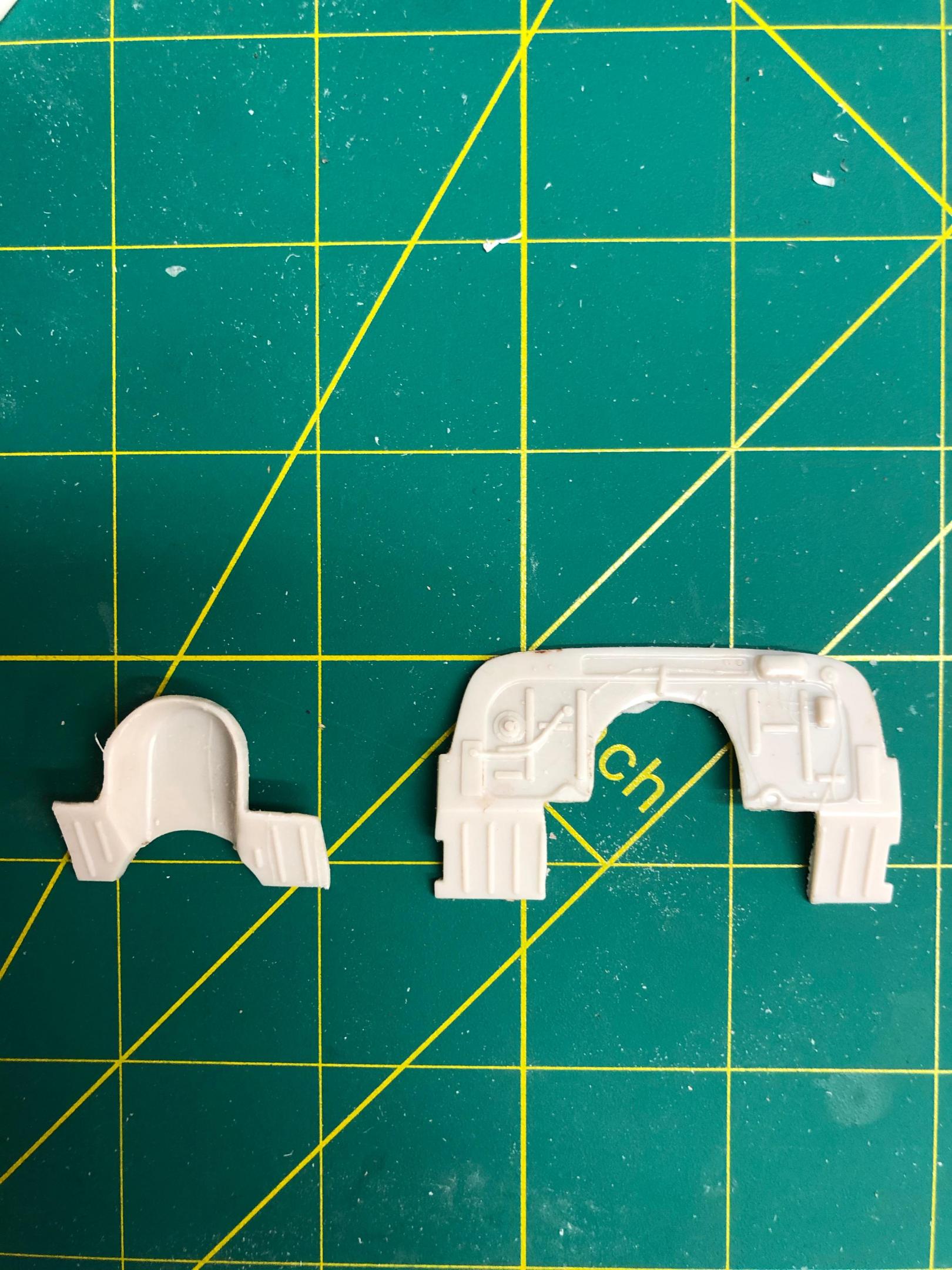

David was correct. The firewall relief was not adequate to clear the engine location. In fact, trying to use the stock Cadillac mounting points was a stupid idea which I remedied by fabricating new forward mounts and a new transmission mount bringing the engine forward to a more reasonable location
IMG_5699.thumb.jpeg.a79157d5ebcc41be9aa0c3f25807d230.jpegIMG_0181.thumb.jpeg.ef316eafdd49d2a3aef3cff8c9e81517.jpeg

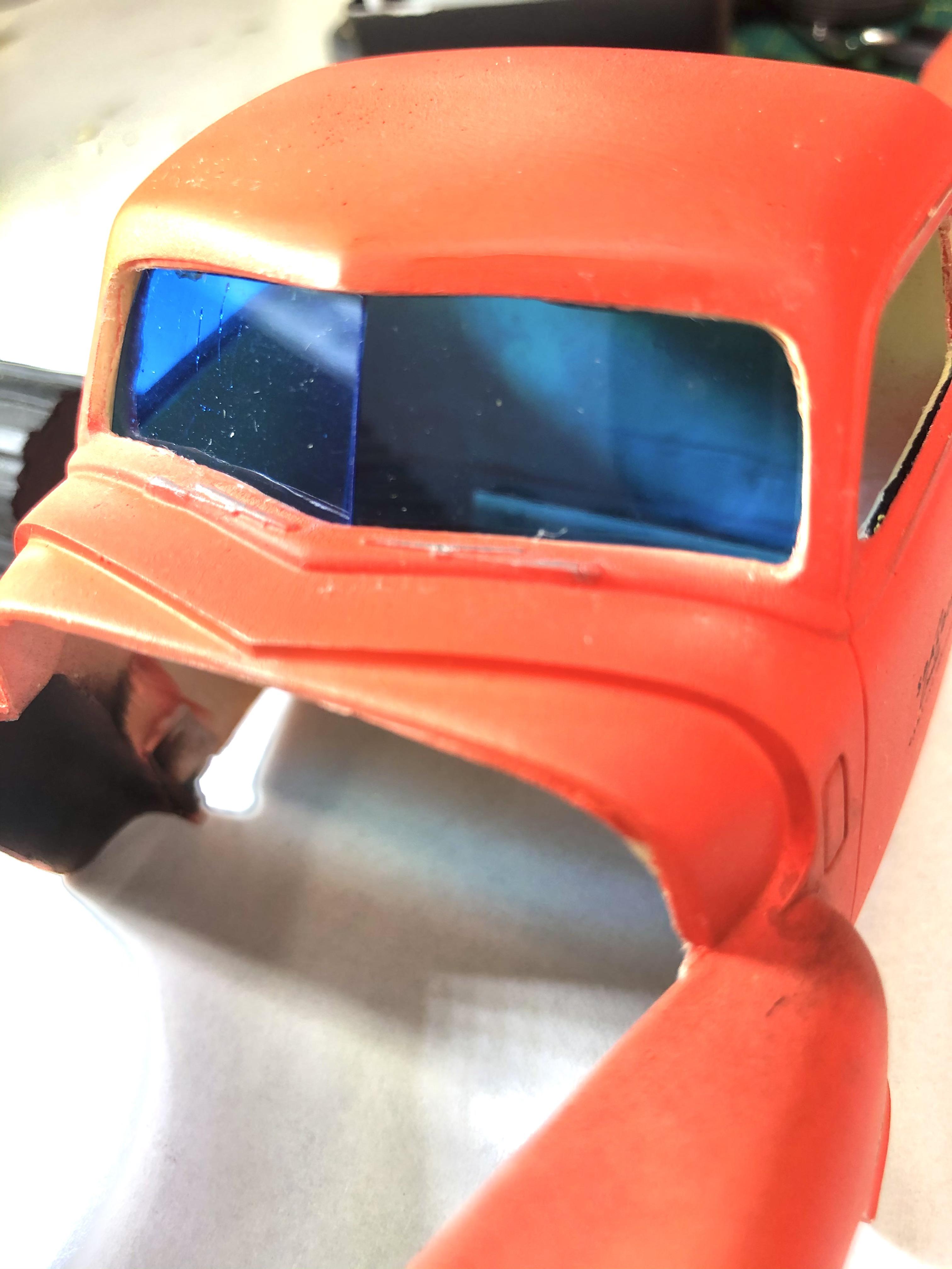

The interior is going to be nearly invisible between the chop and the blue tinted glass so I didn't get too carried away. Just some detail painting and a shifter fabbed from some stainless tubing.
The V butted windshields turned out way better than I expected. Ignore that shmutz on the passenger side. Just some lens cleaner I neglected to dry.

Very cool. I am building one stock. I wanted to know how to take the sheen off the seat, and give it a little worn look, more like leather. I am going to try a little artists charcoal and my finger to see how that works.
Share this post
Link to post
You might think about shooting some dullcoat  then buffing it with one of those fabric softener sheets you throw in the dryer. I’ve had good luck with that technique. BTW that dash looks awesome.

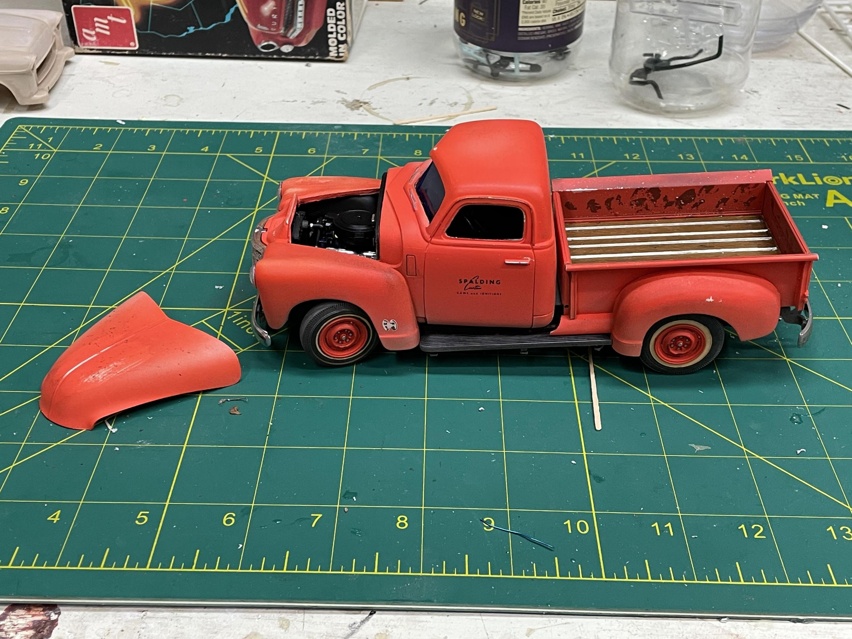

This one is done. All kinds of fit issues in final assembly. Blame it on builder incompetence, it’s a great kit and the Flintstone body is terrific. I’ll take some good pictures later to post under glass.011A4442-637C-4020-A129-EE0106DB5001.thumb.jpeg.bd51256423db3ea26fcceaad8b2aca46.jpeg
