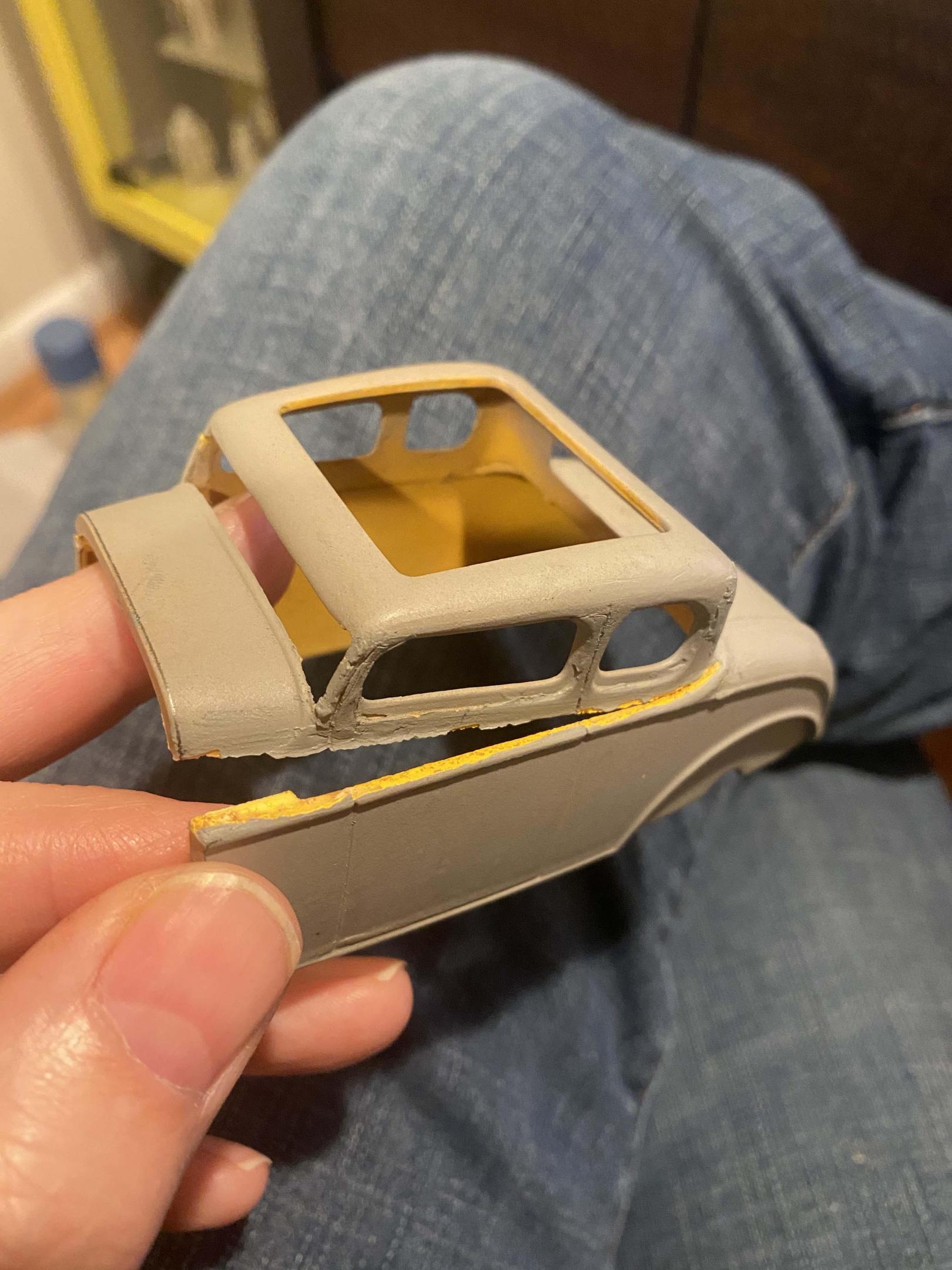

I'm going to start out with an MPC Switchers 32 Ford body I had int he parts box (same as the MPC Milner's Coupe kit and AMT Earth Boyd Coddington's American Hot Rod 32 Ford kit). At some point in its life, the roof was chopped and there's some putty work that's not very nice. But that's ok, I'm ok with it. Some model glue fixed the split area where the roof connects to the body.

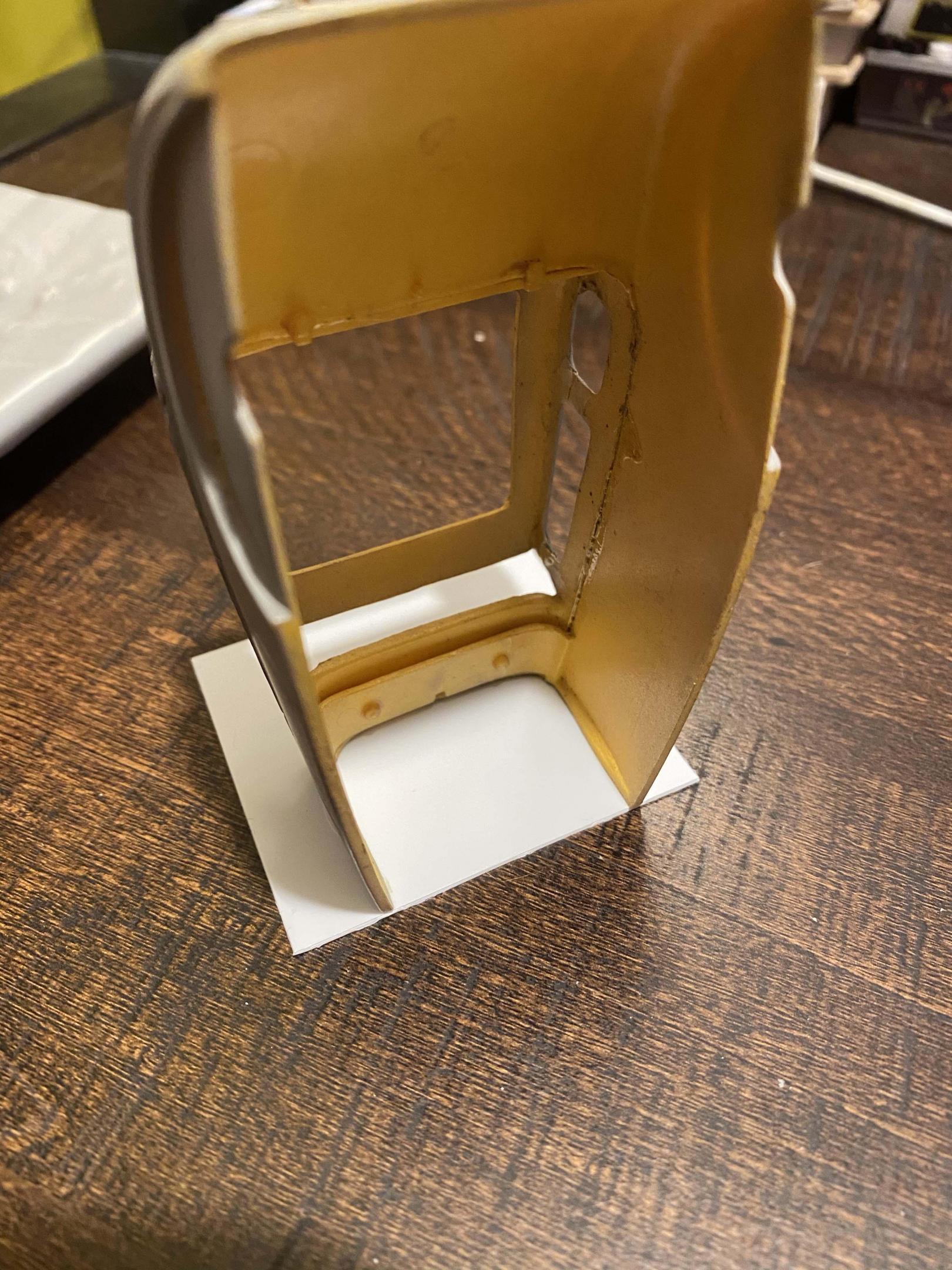

I needed a new firewall, so I'll make one out of a sheet of styrene.After a few attempts at tracing, then cutting out the shape from the plastic sheet, I figured the easiest way to get an accurate shape was to glue the sheet to the firewall area, wait for it to dry, then trim around it with a box cutter blade.
Not too shabby. A few minutes of sanding and now I have a firewall with a lip that the hood will sit on top of.

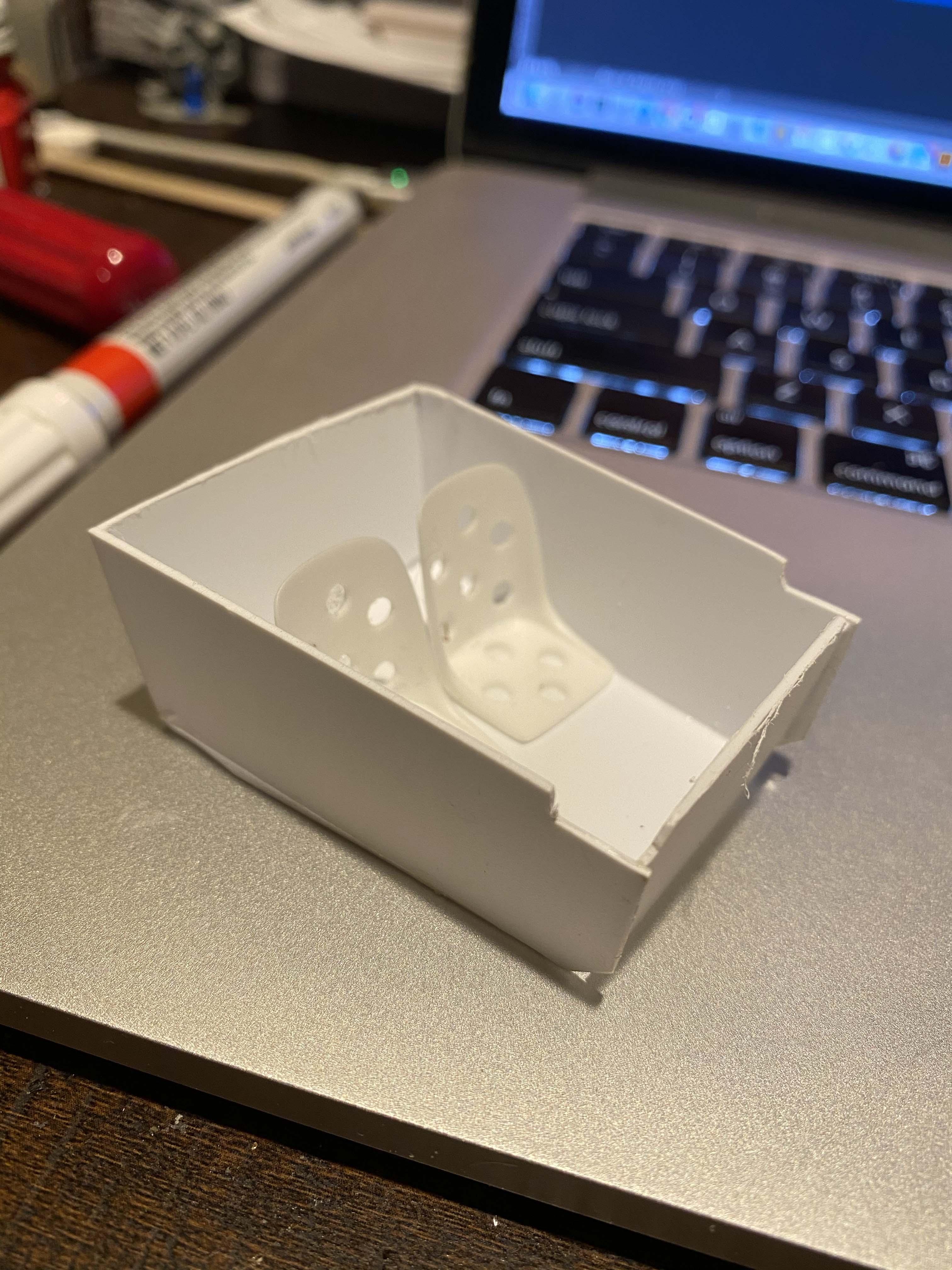

I couldn't come up with a suitable interior tub, so I made my own based on measurement from the interior tub from the AMT Ertl Boyd Coddington American Hotrod 1932 Ford. Could I have just broken up the Boyd kit and used that tub? Sure, but I didn't want to. I made my own interior tub from sheet styrene. I'd never done this before and thought for sure I'd fail, but it went together pretty nicely and pretty easily. If I were to do it again (which I may when I get more sheet styrene) I'd glue the walls to the side of the floor piece, not on top of it; that would make the tub about 1/8" wider and that would be a perfect fit.IMG_0978.thumb.jpg.ea07802210b94a7ff8c3674d121e918f.jpg

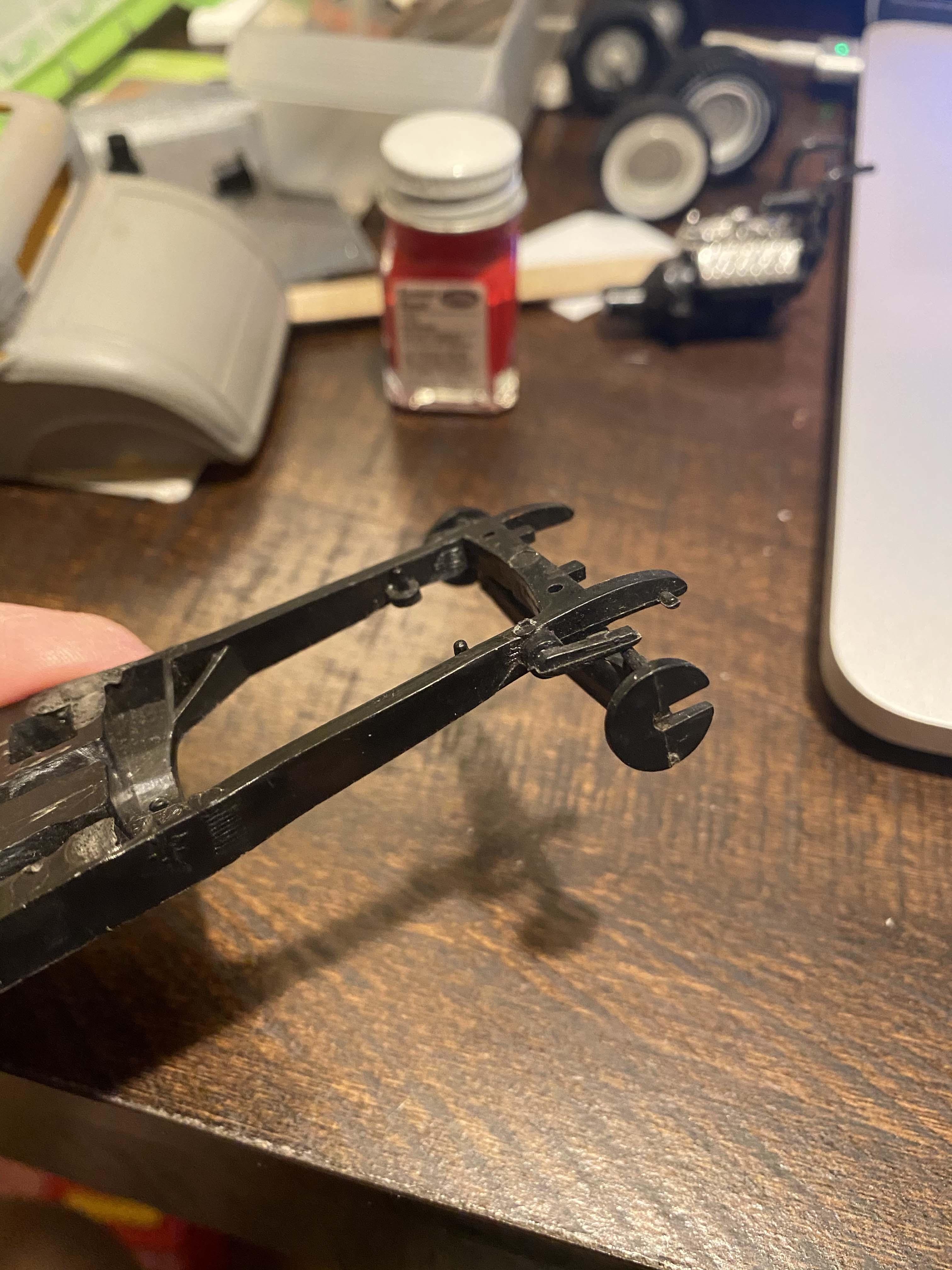

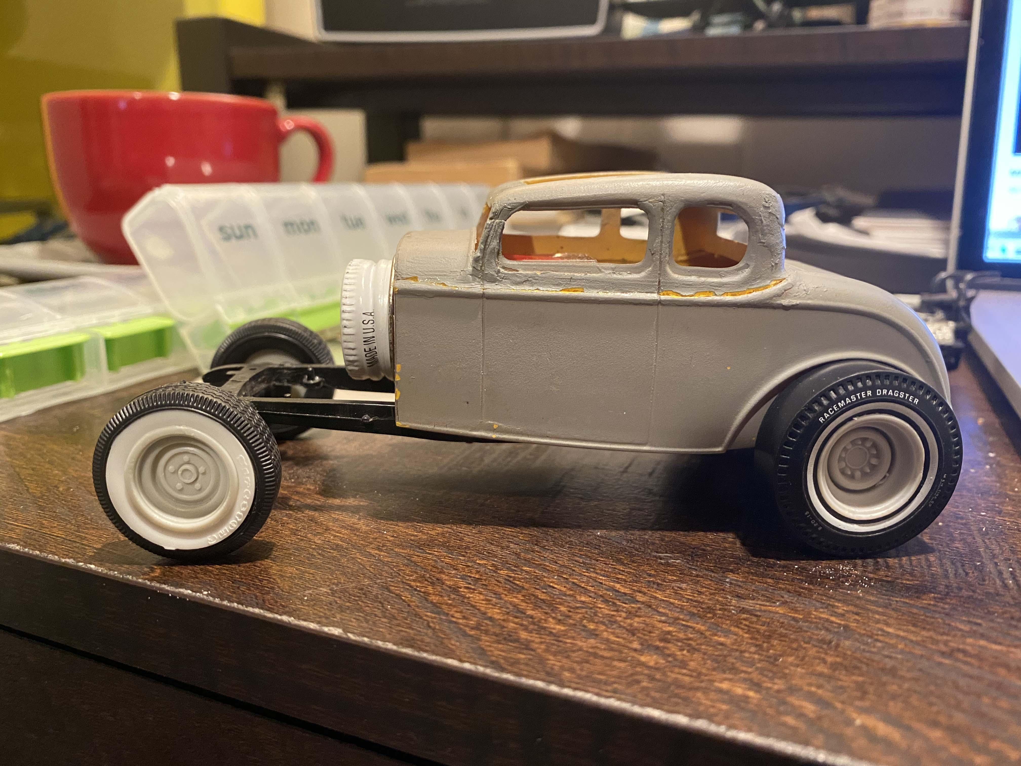

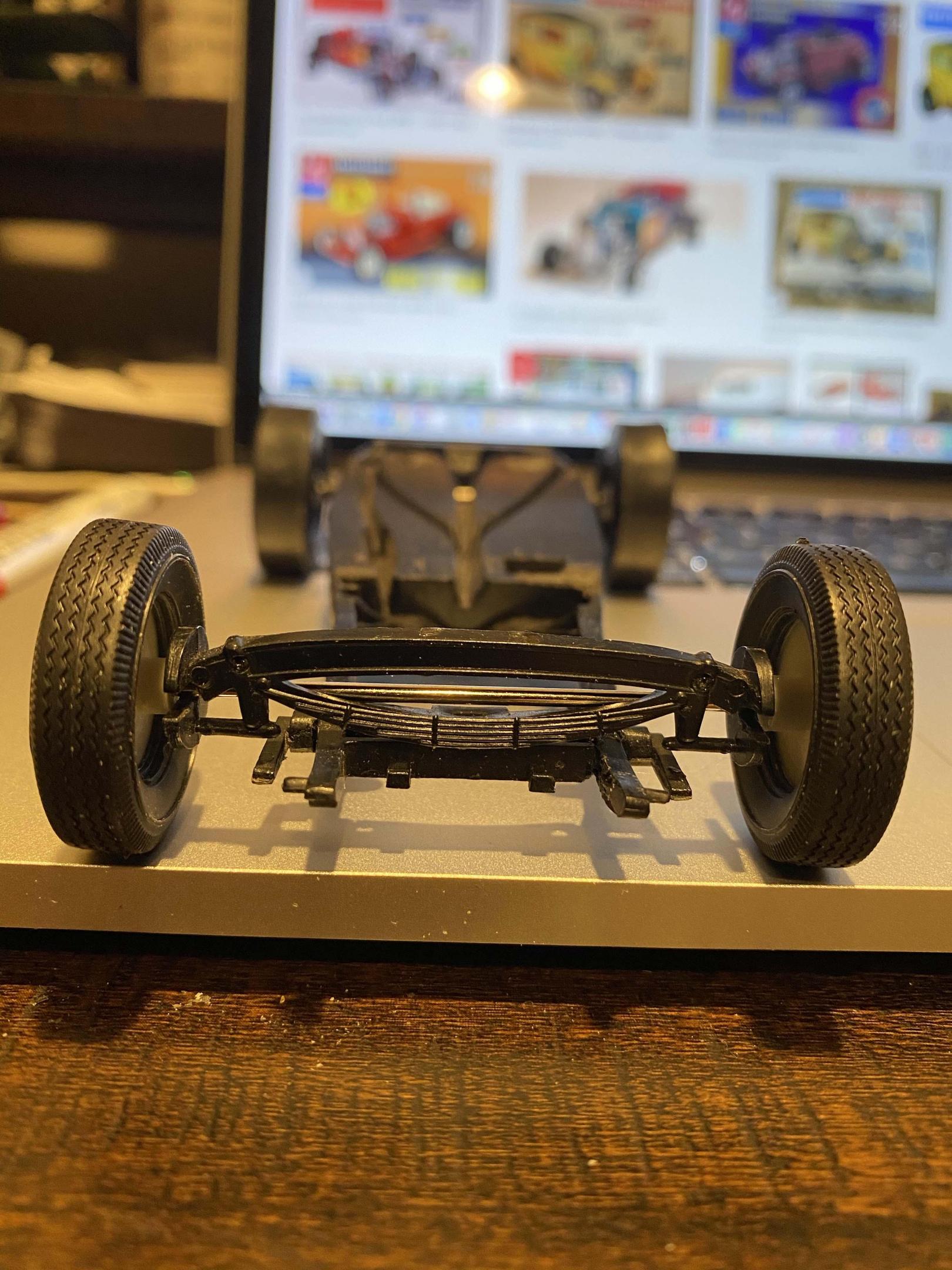

Got my tub, got some parts box steelies and small whitewalls from an unknown kit (they're really small) and AMT Racemaster piecrust whitewall dragster slicks. The parts box AMT 32 Ford frame (I buy these every chance I get) is pristine, but the front suspension had already been glued and assembled. I can't live with the "going uphill" stance, so I start planning what I'll do. Someone ought to start producing altered AMT lowered front suspension parts.
I had done this before and it worked out well even if it's a little unconventional. An old school model builder friend of mine taught me this. I used a thin X-Acto saw blade and cut through the suspension mount each side, then flipped it over. Boom, now we're lowered. I broke on of the frame horns off while cutting, but was able to put it back on. Model glue sort of melts parts together, so even hours after the glue setting, I'm able to gently push the horn into shape.

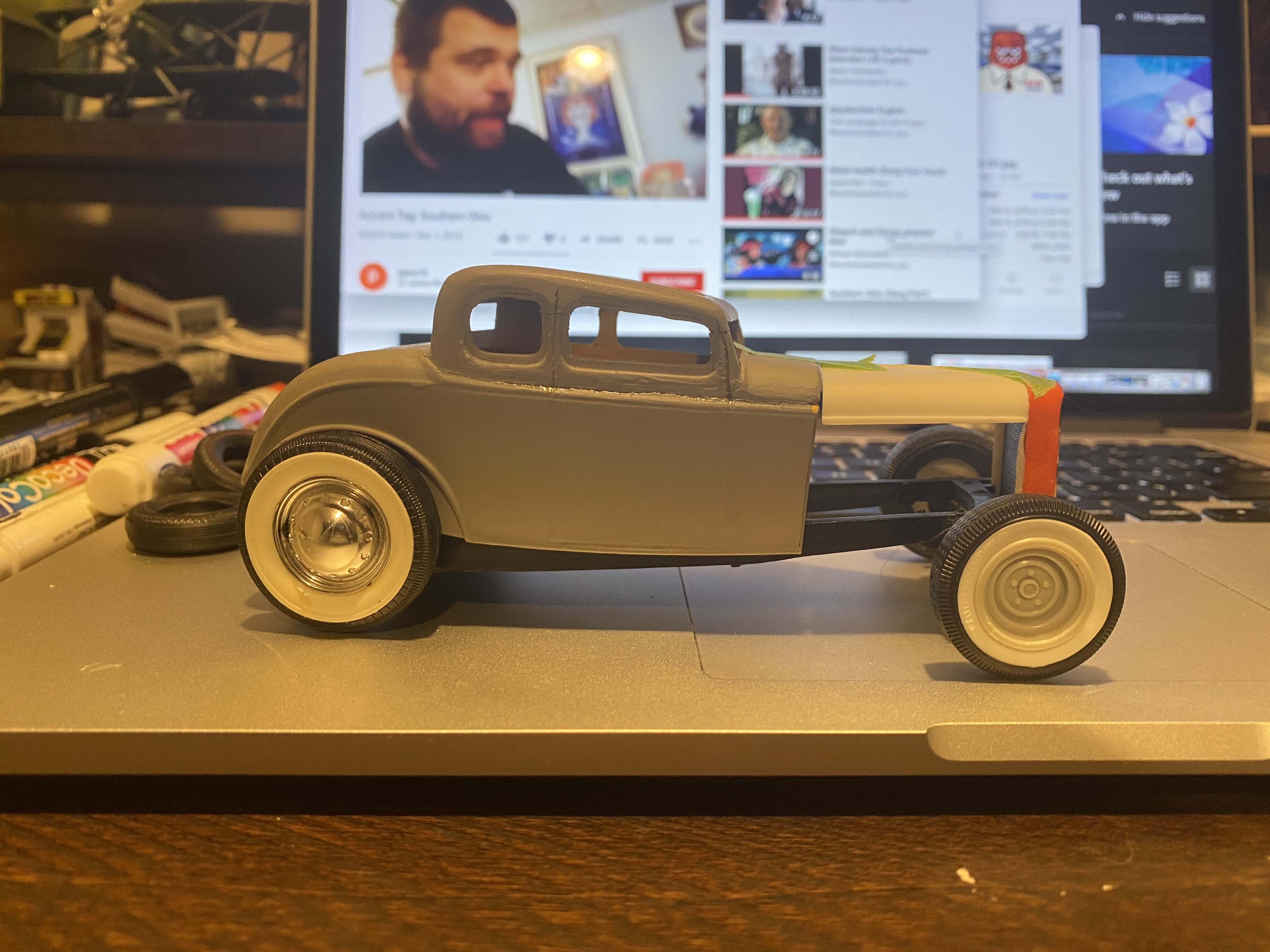

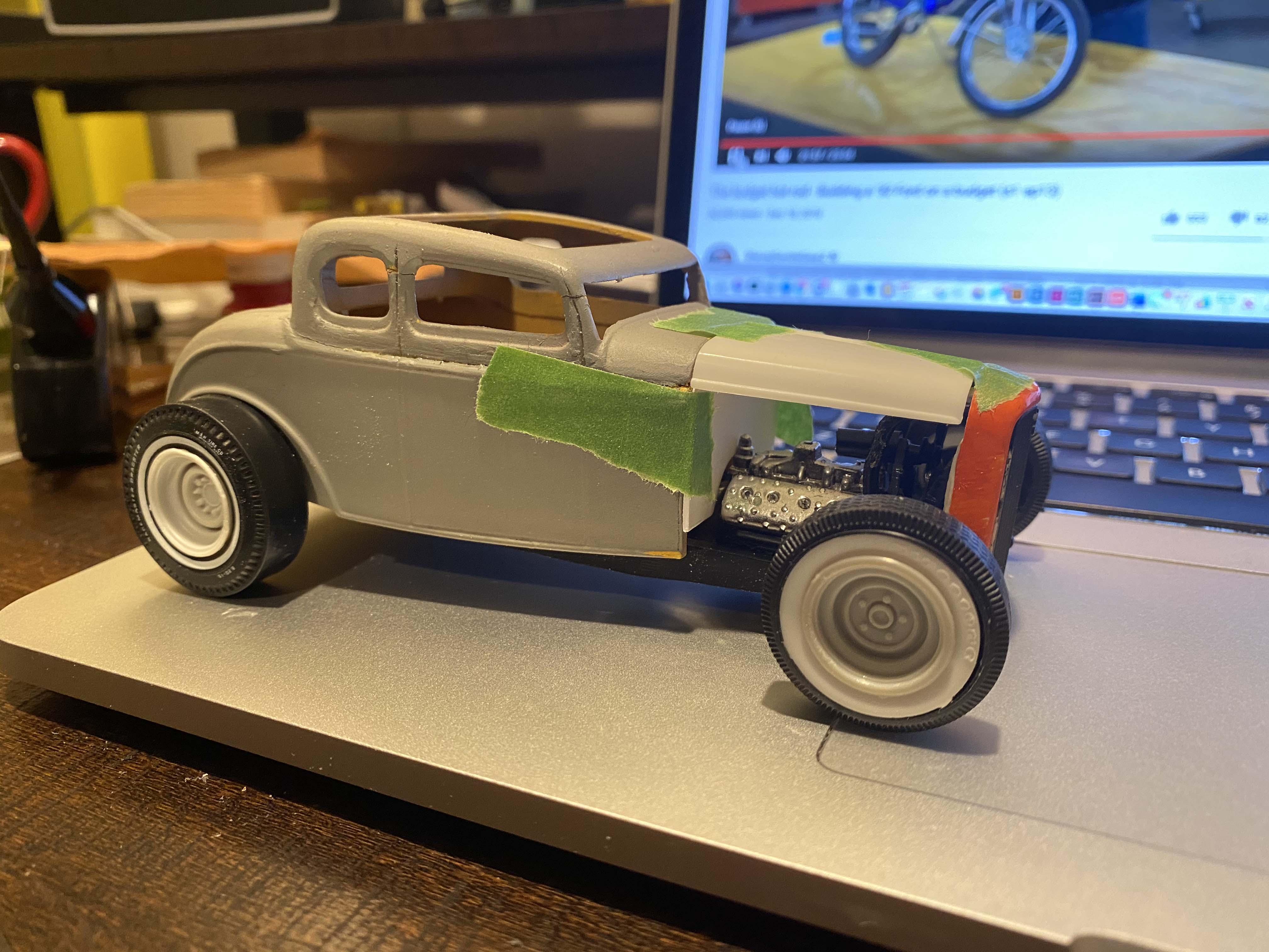

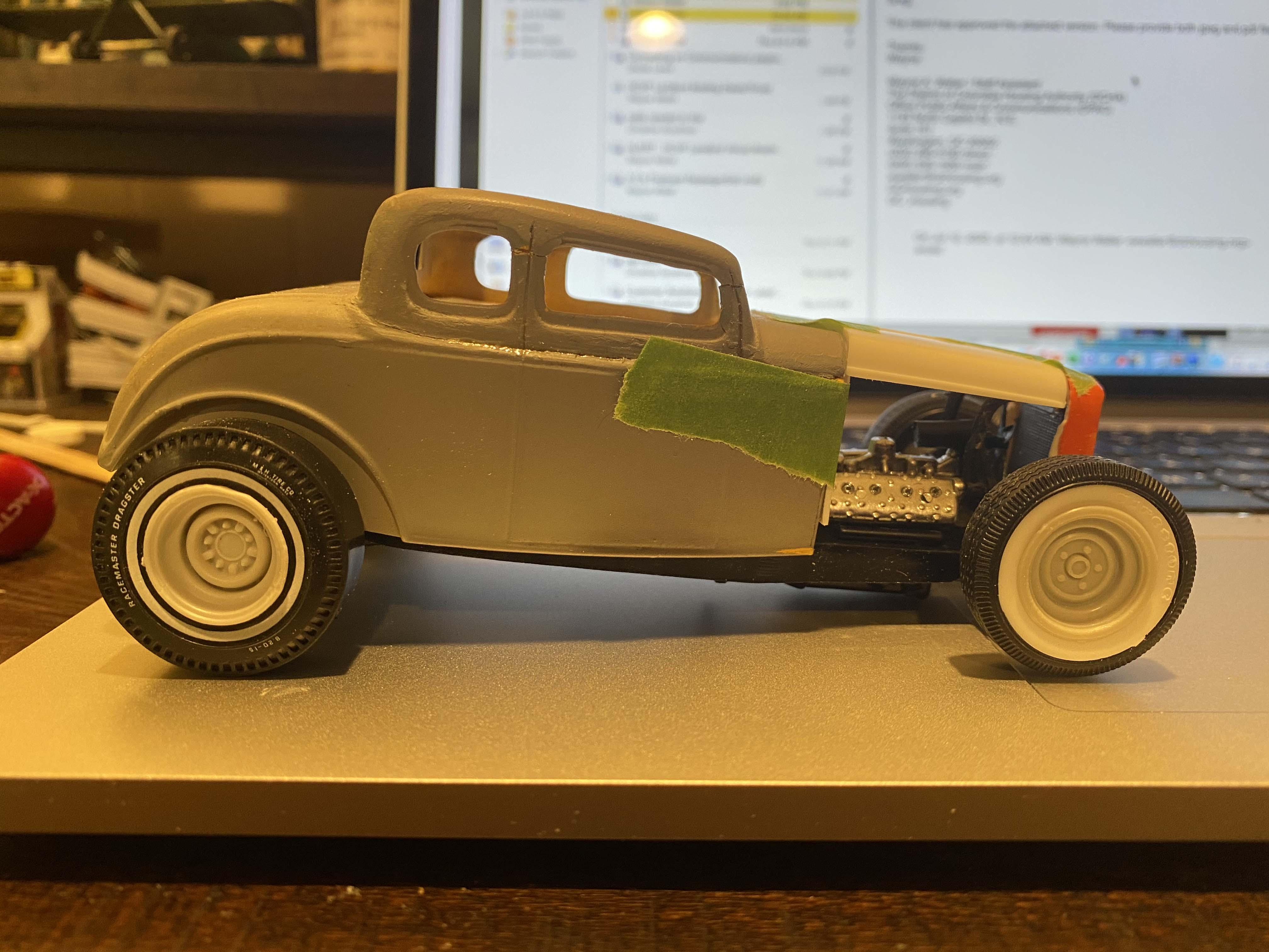

Now I'm really liking the rake and suspension height on the front. The best part is that since I won't be using the sides of the hood, the metal axle (yes, I use them) won't be impeded. The parts box flathead V8 fits perfectly after trimming the homemade firewall.

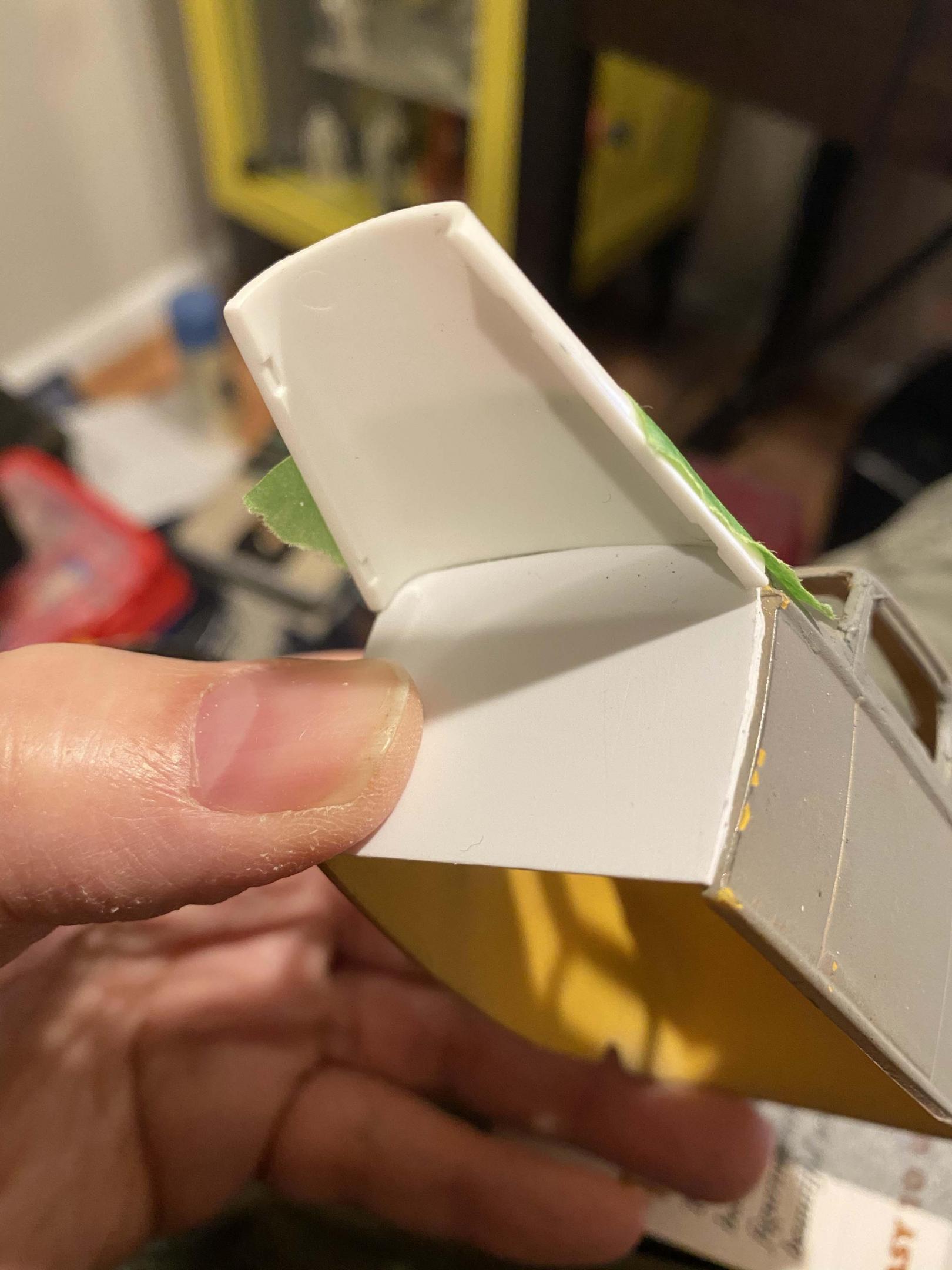

Ok, so I did a little work on the tub. I wanted to redo the floor so I cut a new, longer piece from styrene sheet and add two angled areas so the floor meets up to the wall a little better. Scoring the styrene on the underside allowed me to get the right bends. Some rods have wood floors over top of metal, so I like that look.
The wood grain is actually self adhesive wallpaper from wallstickery.com. I made the mistake of misplacing the 6.5' door roll of this stuff (found it this morning) and went out and bought two rolls of wood grain shelf liner yesterday. Let me tell you, there's a world of difference. This modern self adhesive wallpaper is amazing. Tons of it in different colors on amazon.com.
I wanted some kind of texture for the interior so I found this corrugated siding from Wee Scapes that's used for model train layouts. A little trimming, a little sanding and it lines up pretty well inside. Should look pretty good combined with a set of Replicas and Miniatures P-86 1/25 "Rat Rod" Seats (the best $4.95 you'll ever spend). I'm thinking a flat black or something like that for the color of the interior.
