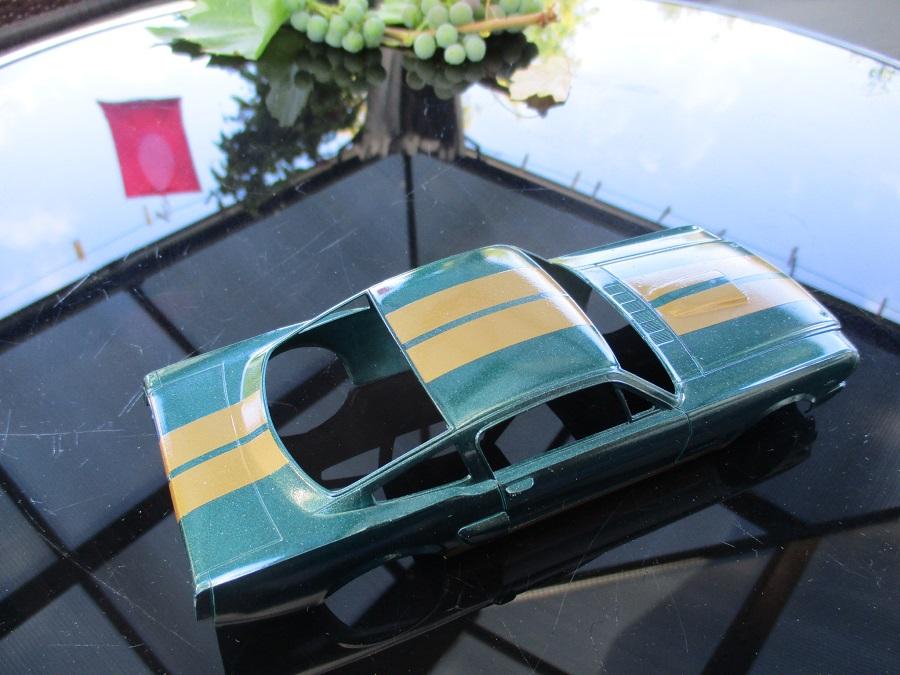

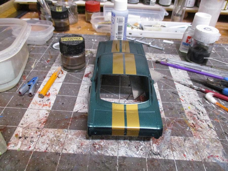

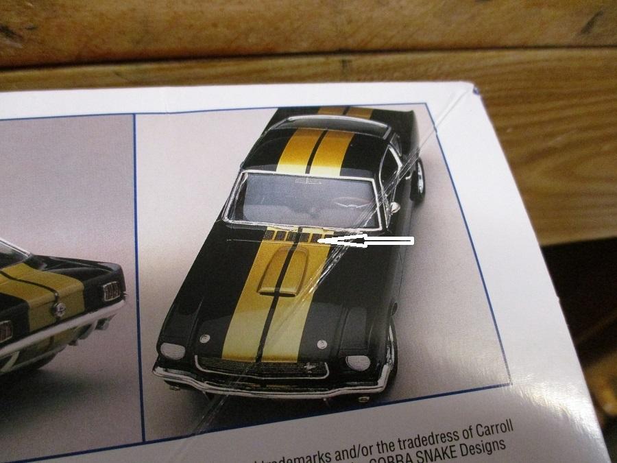

bisc63 Posted August 12, 2020 1 hour ago, CabDriver said: Of course, some decal setting solution would probably get you pretty close and make those decals snuggle in to the vents and then you can do a black wash over those after you’ve done the clear in the same way My first thought as well... Quote Share this post Link to post Share on other sites
landman Posted August 12, 2020 8 hours ago, CabDriver said: I wonder if the stripes on that box art model were painted rather than decalled? Would be easier to paint that scoop than decal it for sure. Then, a black wash would give you the dark spots in that vent. Of course, some decal setting solution would probably get you pretty close and make those decals snuggle in to the vents and then you can do a black wash over those after you’ve done the clear in the same way ?? My decal setting solution hadly gets them to curl around the lip of the trunk. Of course, it could be too old. Then the decals appear unusually stiff and brittle. Quote Share this post Link to post Share on other sites

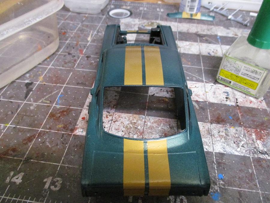

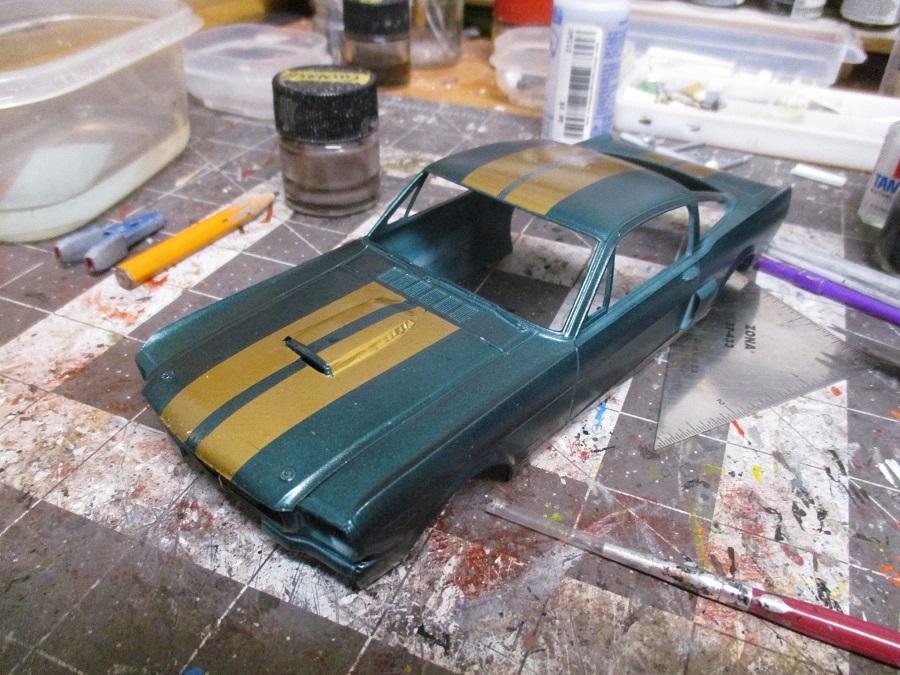

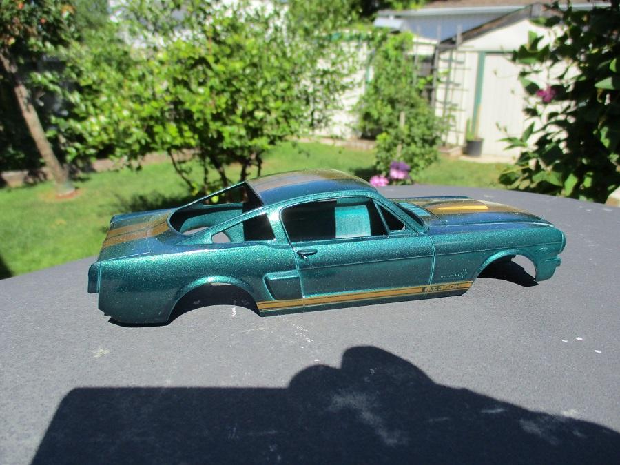

landman Posted August 15, 2020 (edited) It is with great shame that I present my decal job. Those were the nastiest decals I was given to work with. Well, I have to blame something, don't I? Edited August 15, 2020 by landman Quote Share this post Link to post Share on other sites

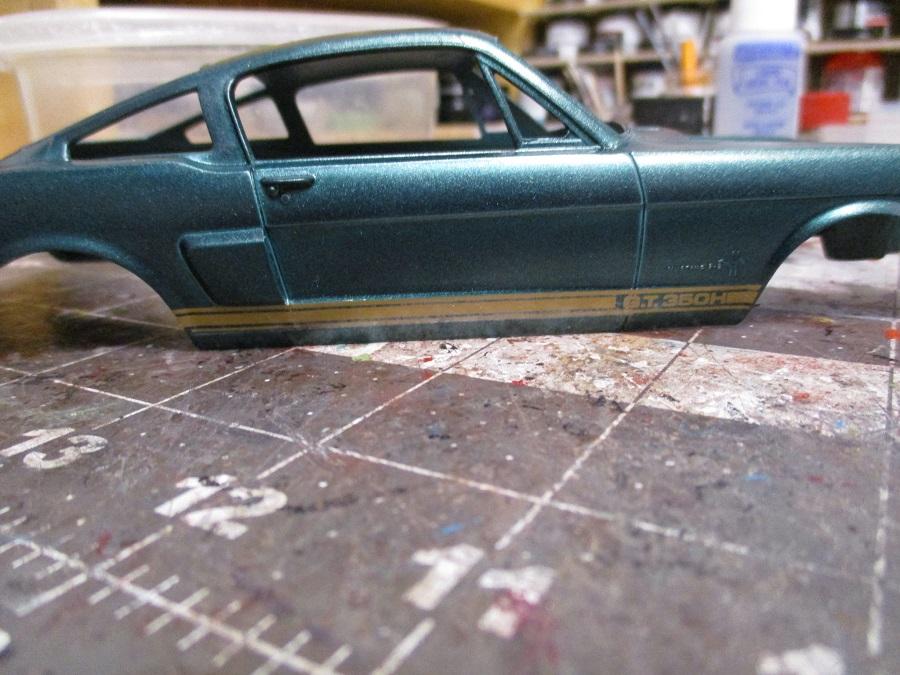

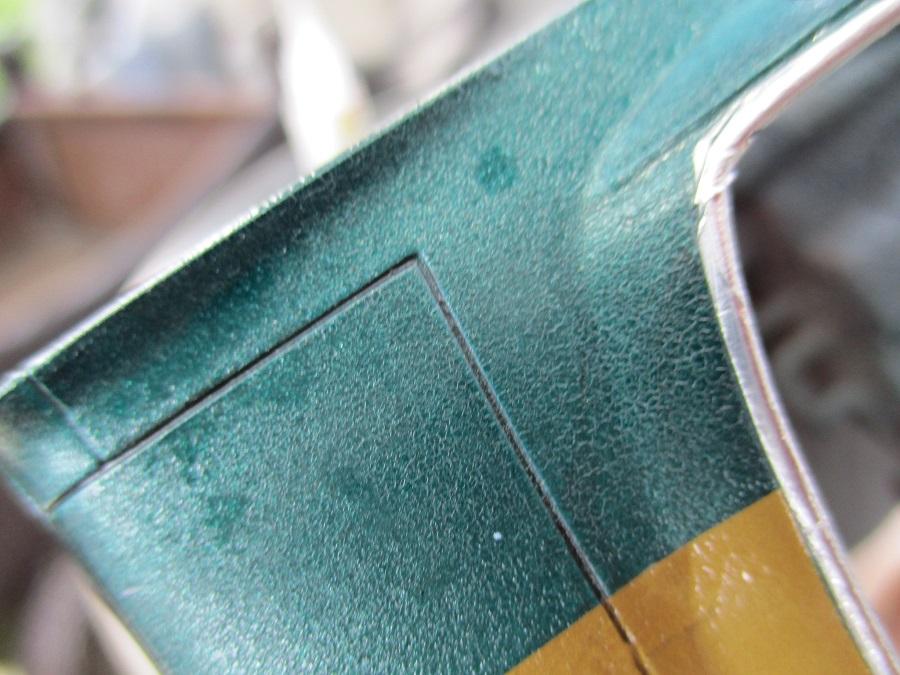

landman Posted August 17, 2020 Applied a clear over the car after the decals. Looks pretty good. Quote Share this post Link to post Share on other sites
landman Posted August 17, 2020 Added the foil, and black wash in the shutlines. Still OK. Quote Share this post Link to post Share on other sites

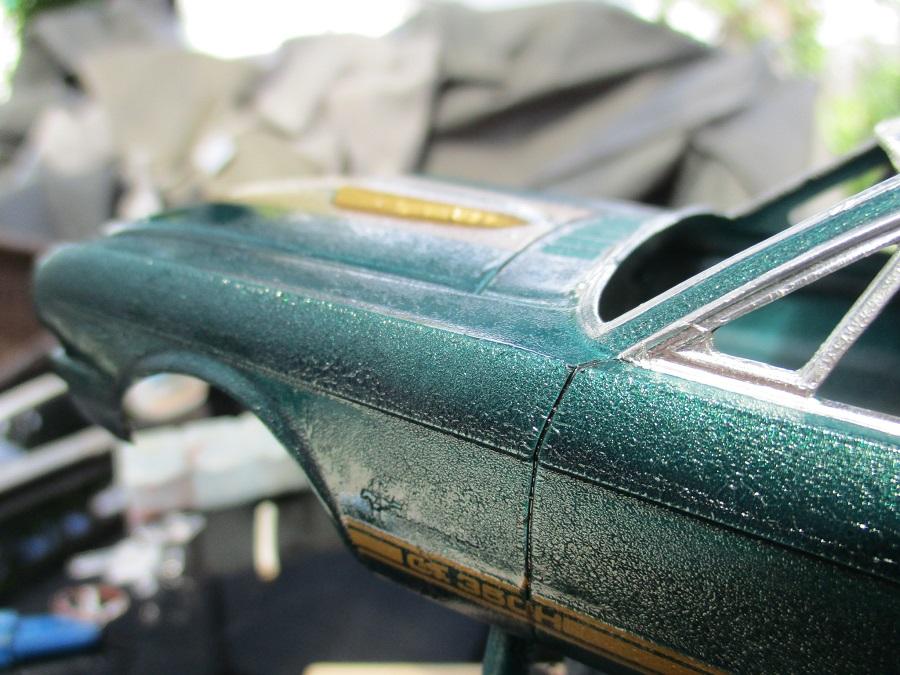

landman Posted August 17, 2020 Then decided to add another coat of the SAME clear to hold it all together. Quote Share this post Link to post Share on other sites
Rodent Posted August 17, 2020 According to the interwebs, the 50 Ivy Green 350Hs were built with only side stripes, no LeMans stripes. Sounds like a good excuse to not put them back on. Quote Share this post Link to post Share on other sites
landman Posted August 17, 2020 1 hour ago, Rodent said: According to the interwebs, the 50 Ivy Green 350Hs were built with only side stripes, no LeMans stripes. Sounds like a good excuse to not put them back on. I agree. the one in the first photo must have had then though, at least on the scoop. Quote Share this post Link to post Share on other sites
Canso65 Posted August 17, 2020 Oh man! You're having the kind of luck I have building a kit Pat! I'm sorry to see the bad reaction with the clear coat. What paint brand did you use? Rob Quote Share this post Link to post Share on other sites

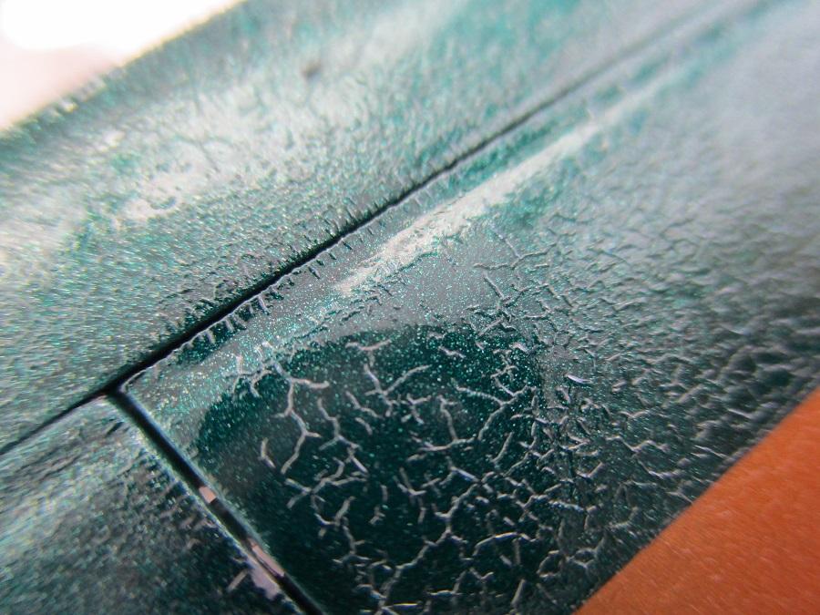

Dragonhawk1066 Posted August 17, 2020 Color looked great and I had the same problem with my hood decals. I decided to leave them off and just went with the side stripe. Sorry to see the bad clear reaction, awfully strange to react on the very last coat! Quote Share this post Link to post Share on other sites
bisc63 Posted August 17, 2020 Did you by chance use automotive urethane clear coat? Most have very specific re-coat timing; either right away, or wait 24 hours minimum. I learned that one the hard way when I rushed a small touch-up I had to do on a full size truck I was painting, and ended up causing myself an even larger problem. Hang in there! Quote Share this post Link to post Share on other sites
landman Posted August 18, 2020 2 hours ago, Canso65 said: Oh man! You're having the kind of luck I have building a kit Pat! I'm sorry to see the bad reaction with the clear coat. What paint brand did you use? Rob Quote Share this post Link to post Share on other sites
CabDriver Posted August 18, 2020 (edited) I seem to remember that directions for that Duplicolor enamel clear say not to recoat unless it’s within an hour of the previous coat, or MORE THAN a week later...not in between Did you get it in between that window somewhere? Edited August 18, 2020 by CabDriver Typo Quote Share this post Link to post Share on other sites
Maindrian Pace Posted August 18, 2020 Automotive paints are almost always too hot for plastics, and automotive clear can be very tricky. Quote Share this post Link to post Share on other sites
Psychobilly Posted August 18, 2020 On 8/11/2020 at 8:16 PM, landman said: Working on the decals. Not fun at all. How do I achieve that effect on the cowl? Maybe Micro Sol and a black wash? Quote Share this post Link to post Share on other sites
Psychobilly Posted August 18, 2020 Oh no! I just scrolled down far enough to see the cracked clear. The exact same thing happened to me on a Bronco build. I soaked it in Purple Power and repainted just to have my BMF turn into a headache. Definitely sounds like it wasn't cured quite yet or too humid. Quote Share this post Link to post Share on other sites

randyc Posted August 18, 2020 My first issue GT 350H decals would NOT work with any solvents. I ended up using vinyl stripes on the top. I think I got the side stripes on. Good luck working out the cowl. It's a great kit when finished. Quote Share this post Link to post Share on other sites
Painted Black Posted August 18, 2020 Sorry to see the paint ruined. If your going to go with stripes, try some of Microscales decals sheets and cut your own, they work well with setting solutions.and will suck right down into those cowl vents. http://www.microscale.com/Merchant2/merchant.mvc?Screen=PROD&Store_Code=MD&Product_Code=TF-39&Category_Code=TF Quote Share this post Link to post Share on other sites
