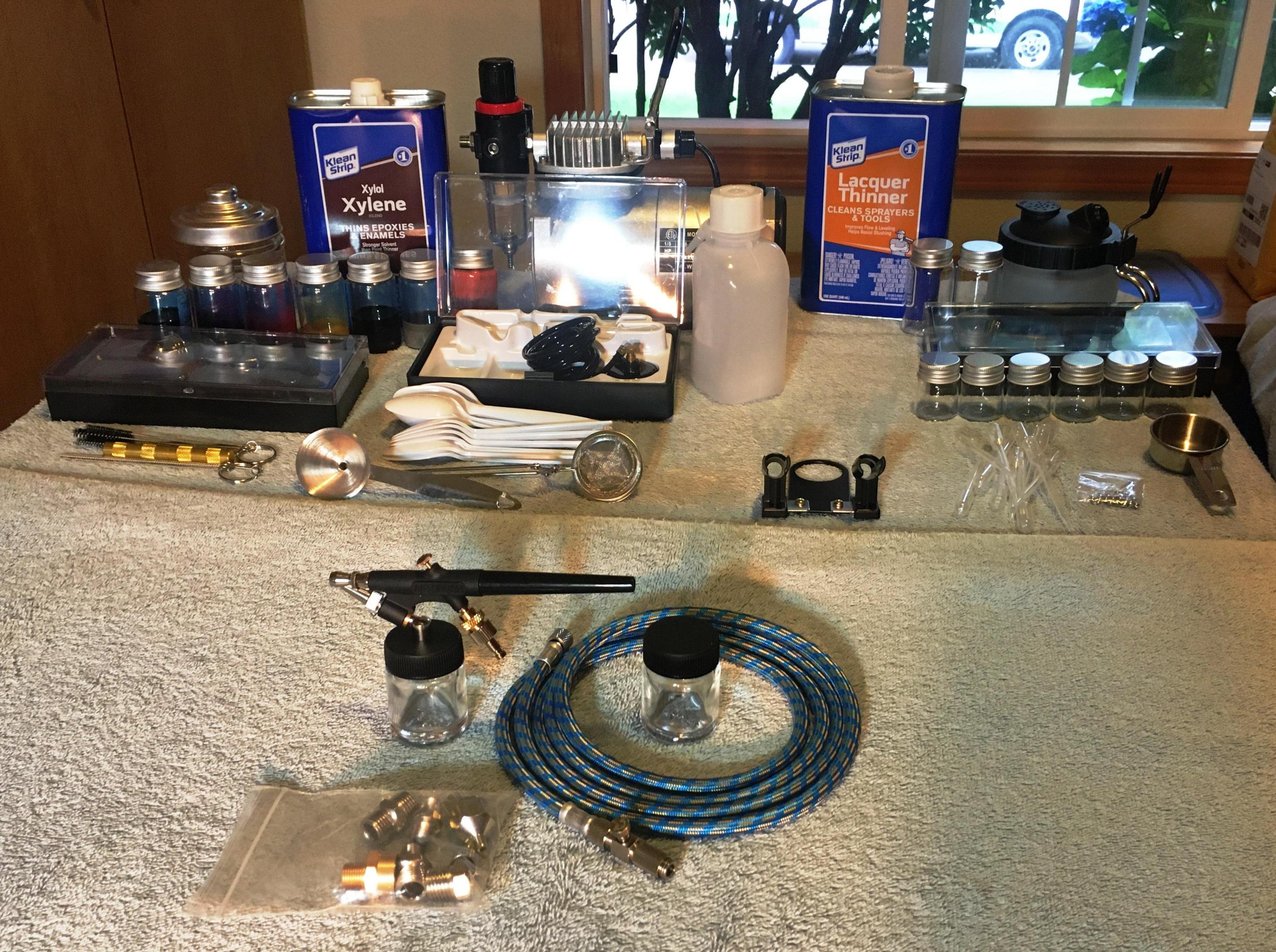

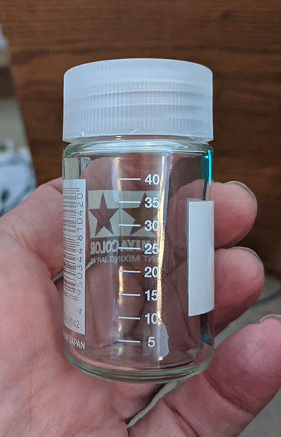

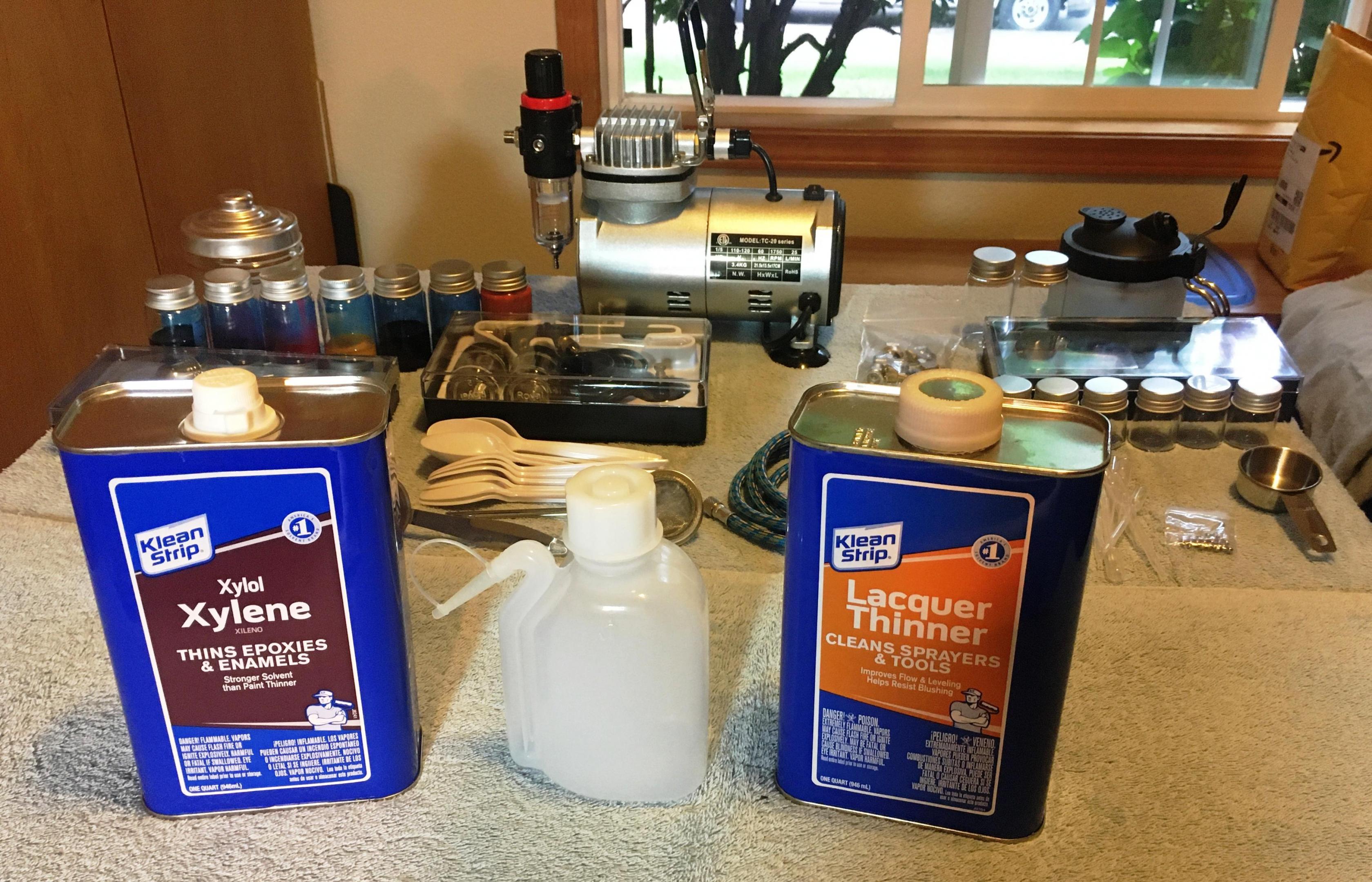

Bills72sj Posted August 22, 2020 Share Posted August 22, 2020 After seeing so many nice builds from others AND getting tired of "spitty" rattle cans, I am going to try my hand at airbrushing. After watching a dozen Youtube videos, I purchased a bunch of items to help me get started (hopefully, successfully). I made my own safe and mess-free decanter from a automotive Freon injector and a wide (enough) air intake band clamp. It works really well. Did I miss anything? Quote Link to comment Share on other sites More sharing options...
Pete J. Posted August 22, 2020 Share Posted August 22, 2020 With all you bought, a postal scale(zero-able in grams) would be handy. They are really cheap. Less than $20. Why? If you watch the customizer car shows you will see that they thin and mix catalyzed paints using weight rather than by volume. Much more accurate than using a graduate pipette or bottle especially for small volumes. I know most painters thin by eyeball to the "milk" consistency, but I stopped using that years ago. I keep a journal with the brand of paint, how I thinned it, temperature, humidity, compressor air pressure and my results. If you do that, it won't be long until you have your own manual. What I am trying to say is if you do each of these things the same, you will get the same results every time. Good luck. Quote Link to comment Share on other sites More sharing options...
Rodent Posted August 22, 2020 Share Posted August 22, 2020 9 minutes ago, Pete J. said: With all you bought, a postal scale(zero-able in grams) would be handy. They are really cheap. Less than $20. Why? If you watch the customizer car shows you will see that they thin and mix catalyzed paints using weight rather than by volume. Much more accurate than using a graduate pipette or bottle especially for small volumes. I know most painters thin by eyeball to the "milk" consistency, but I stopped using that years ago. I keep a journal with the brand of paint, how I thinned it, temperature, humidity, compressor air pressure and my results. If you do that, it won't be long until you have your own manual. What I am trying to say is if you do each of these things the same, you will get the same results every time. Good luck. Nothing to do with paint, but I have been carefully dipping my (hairy) big toe into doing some baking for the last year or so. Having a scale to weigh the dry ingredients is very important, especially the flour. Just want to agree that weight of ingredients is better than volume if you are looking for consistency. Paint or bread. Quote Link to comment Share on other sites More sharing options...
Bills72sj Posted August 22, 2020 Author Share Posted August 22, 2020 (edited) Thanks guys, I did buy a log book but I did not imagine that weighing would be important. I am starting off with decanted then sealed paints. From what I understand they typically do not need thinned. I guess I will learn from the spray pattern. Edited August 23, 2020 by Bills72sj grammar Quote Link to comment Share on other sites More sharing options...
Pete J. Posted August 22, 2020 Share Posted August 22, 2020 6 hours ago, Bills72sj said: Thanks guys, I did buy a log book but I did imagine that weighing would be important. I am starting off with decanted then sealed paints. From what I understand they typically do not need thinned. I guess I will learn from the spray pattern. The Tamiya lacquer in rattle cans can be used directly, but I still like to thin them, especially the primer. I would rather lay on 5 or 6 very thin coats than one or two thick ones. It allows me to control the detail loss like faint panel lines better. It also works better with metal flake(mica) colors. If you lay on a thick coat, the heavy flake will settle under the tinted clear and can get lost. Several thin layers will keep it closer to the surface for a deeper metallic look. Quote Link to comment Share on other sites More sharing options...
Matt Bacon Posted August 22, 2020 Share Posted August 22, 2020 Well, I see lots of stuff. But I also see a can of Xylene, so I really hope you've got also a high quality respirator mask (like a 3M 6200) and a paint booth with substantial extraction to the outside world and spark-free fans... That stuff on your desk can kill you quickly or slowly... please take safety equipment seriously. best, M. Quote Link to comment Share on other sites More sharing options...

Bills72sj Posted August 23, 2020 Author Share Posted August 23, 2020 10 hours ago, Matt Bacon said: Well, I see lots of stuff. But I also see a can of Xylene, so I really hope you've got also a high quality respirator mask (like a 3M 6200) and a paint booth with substantial extraction to the outside world and spark-free fans... That stuff on your desk can kill you quickly or slowly... please take safety equipment seriously. best, M. M., I bought the Xylene simply because it says it is for enamels. I may never use it if lacquer thinner works just as well. I do have an excellent paint booth with PLENTY of ventilation. Quote Link to comment Share on other sites More sharing options...
