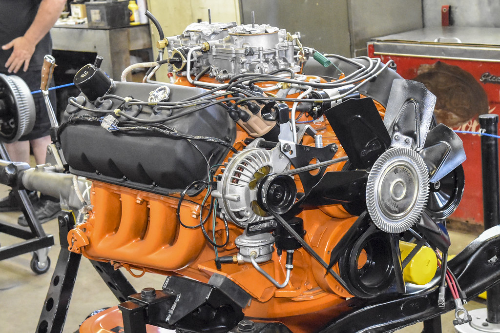

Now , at the risk of being "That guy..." , I must inquire about the fan : That's the base fan for auto / open rear , and would be incorrect for a Dana-equipped model ( if you're using an 8 3/4 rear , you can disregard this info )  .
NOS 1968 1969 CHARGER GTX ROAD RUNNER 426 HEMI 69 340 440+6 A-12 Fan 2863215 | eBay
Don't know anything about the fan except this is what came in the Revell '68 Charger to be used in conjunction with the Hemi engine provided in the kit.
I understand that the Hemi in that kit is not a stock engine, so I suppose it's entirely possible that it could be incorrect.
Not a major issue.
I'm pretty sure that I have a spare Mopar clutch fan around somewhere.
Steve

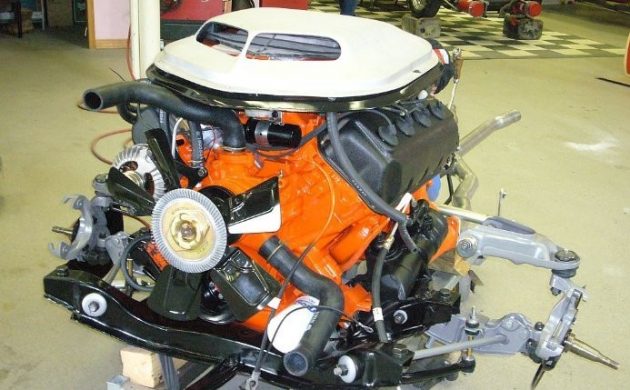

Ps, the 4 blade fan is 66 and MAYBE 67 only.
The later street hemi got the 7 blade fan and viscous fan clutch all other years
Link to post
That first engine appears to be a 1970 with 49 state emissions ( no C.A.P. breather , but does have a vapour separator adjacent to the fuel pump ) .
But , yes , that 4-paddle fan is a no-go for 1968-1971 --- even the LO23 / BO29 models got the 7-paddle fan with a clutch ( de-clutch ) .
Link to post
Thanks guys.
Already stripped a chrome fan from the leftover parts from my '65 Fury kit.
I'll get it cleaned up an painted and the issue will be resolved.
Steve
Link to post

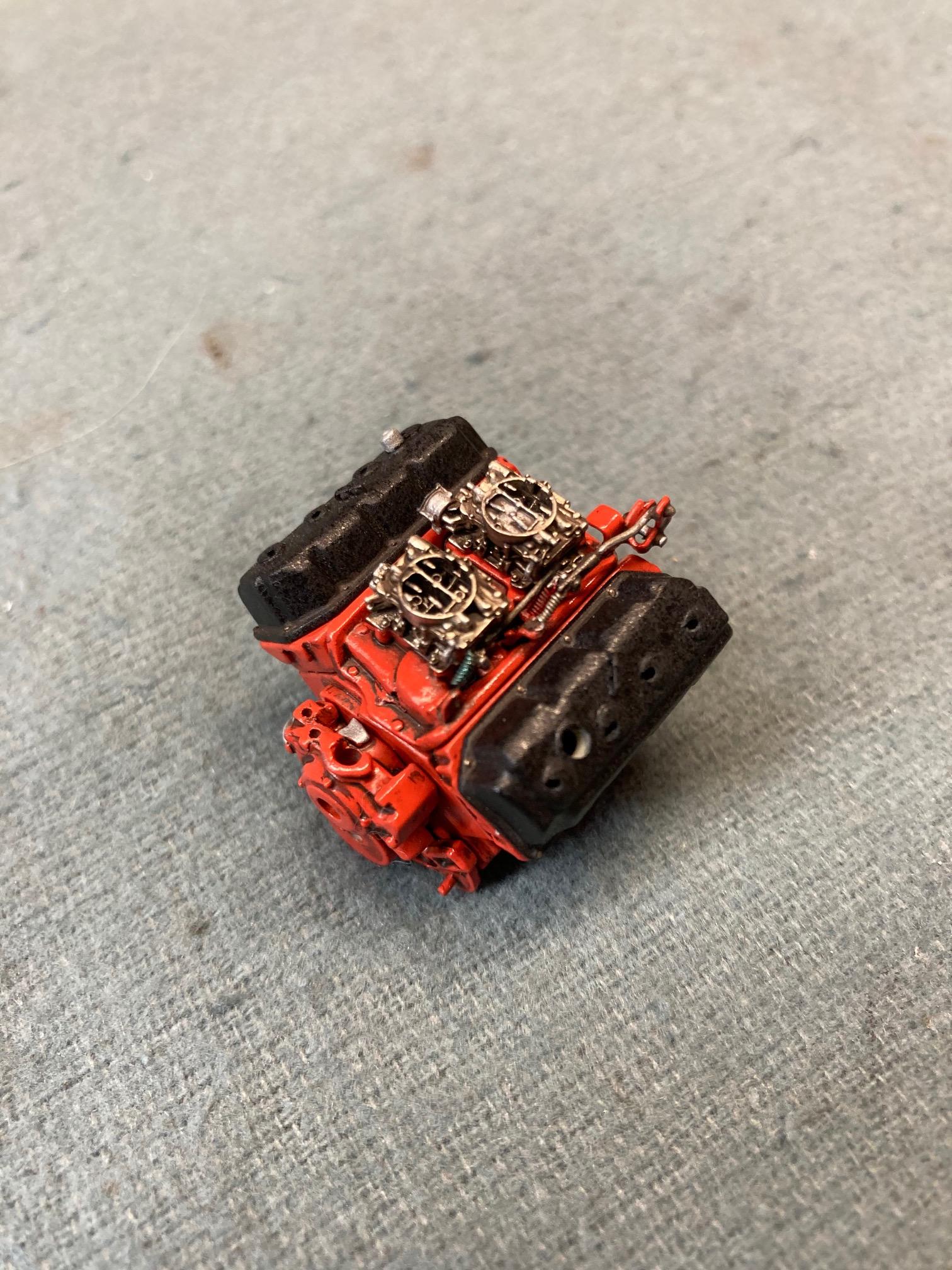

I believe so, but running the engine for a very short period of time burned the paint off of the exhaust manifolds very quickly.
Steve
Link to post

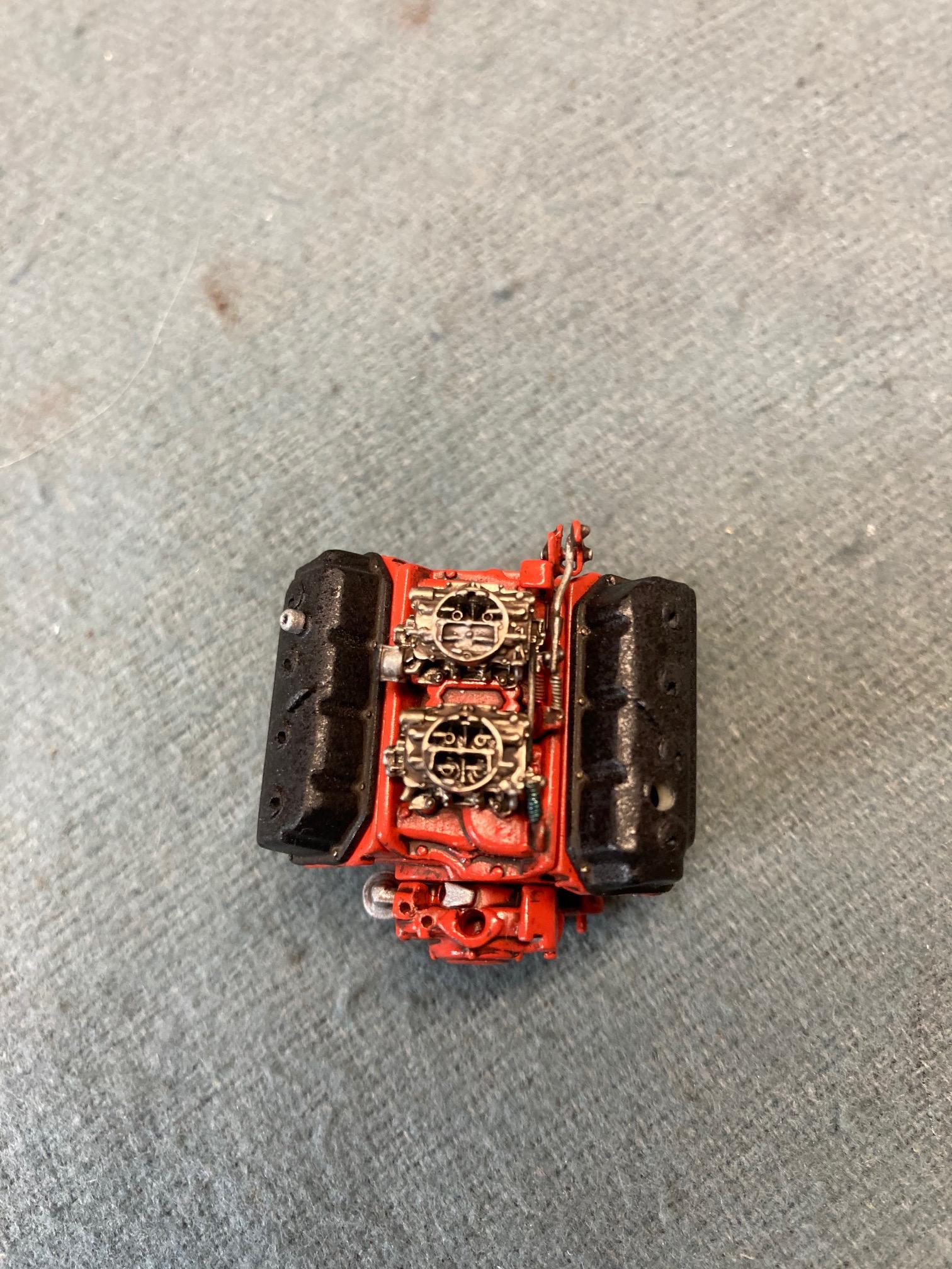

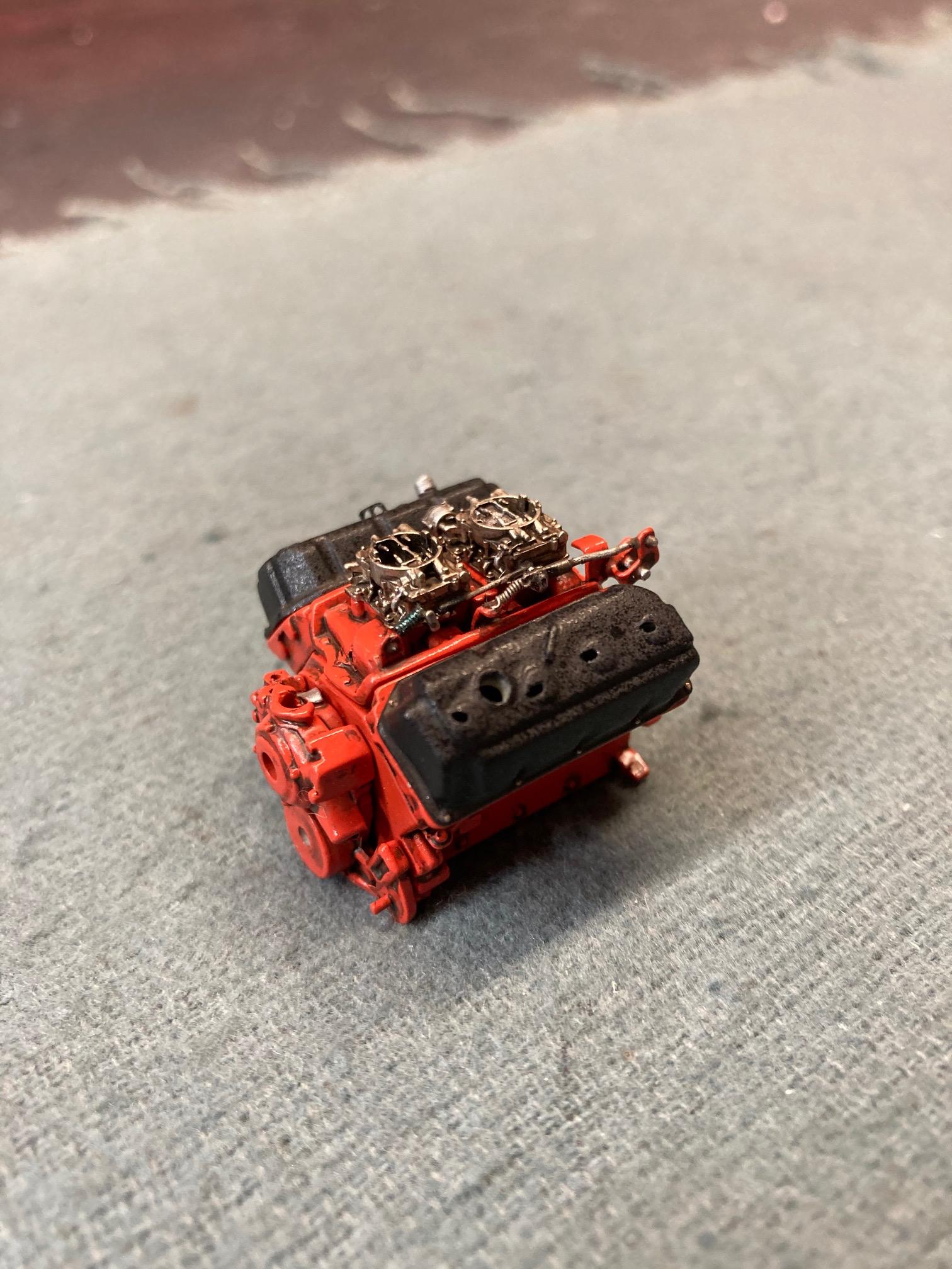

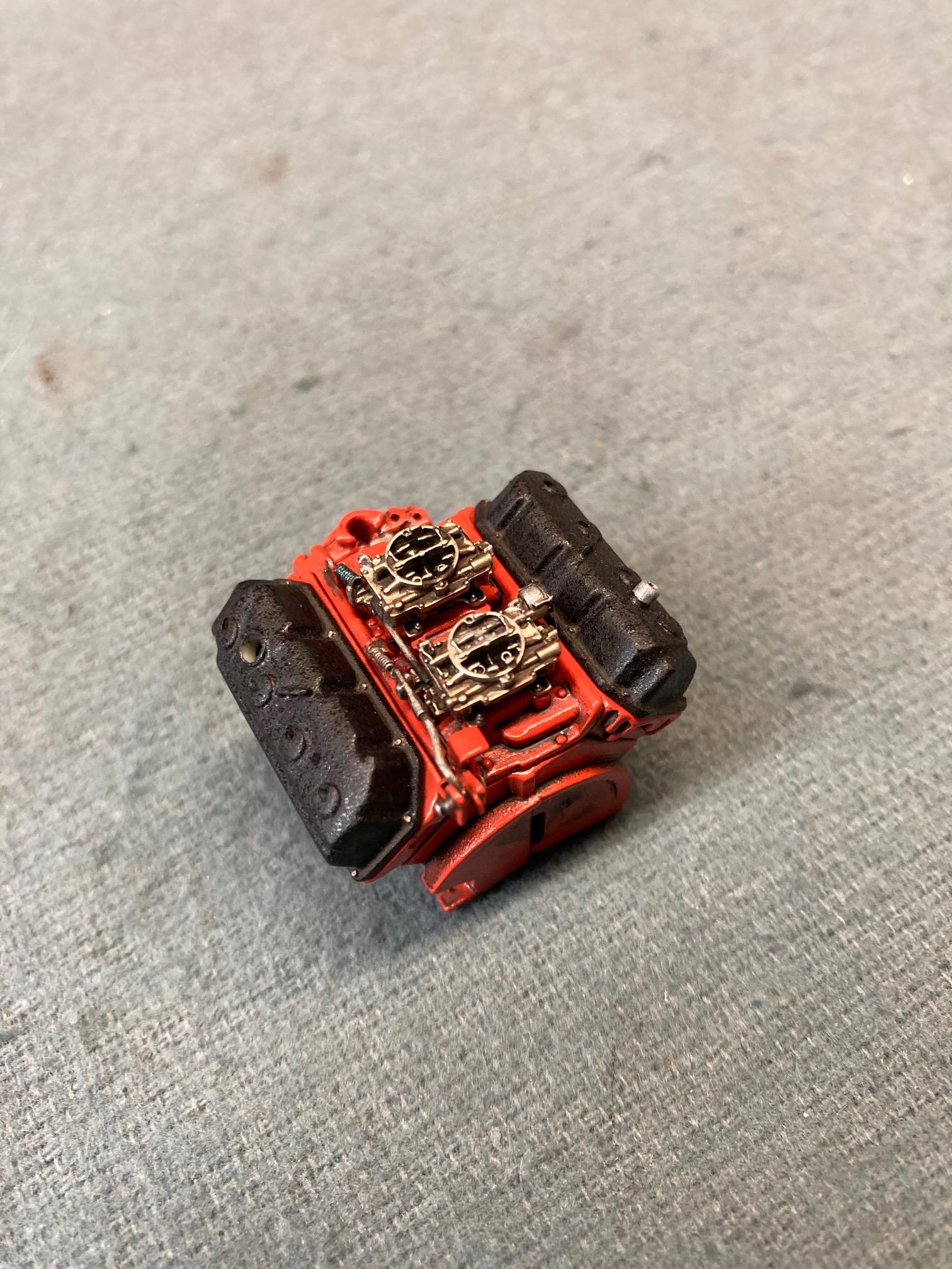

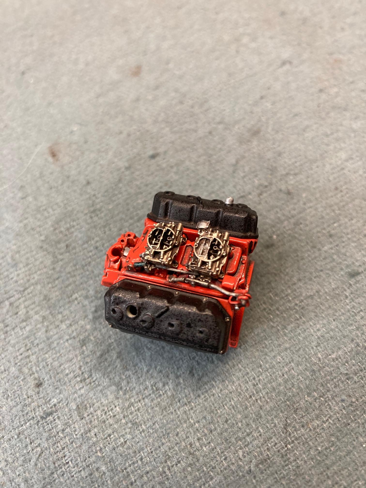

On 5/9/2021 at 11:28 PM, StevenGuthmiller said:
Got most of the carb linkage and return spring detail done this afternoon.
Steve
Outstanding Steve!
Link to post
Steve
Correct,
exhaust manifolds had engine color on them for a very short time
Link to post
Steve
This engine looks amazing. The smallest details are perfect, Steve. Can’t wait to see this completed.
BTW, what kind of magnifying visor are you using? I have one with just one flip lens.
Link to post
I don't use a visor.
Just a lighted table magnifier.
I decided that I didn't really like the kit provided coil, (I never really do like them)
So I threw together my own.
They're pretty easy to make, so why not. :)
Steve
Link to post
