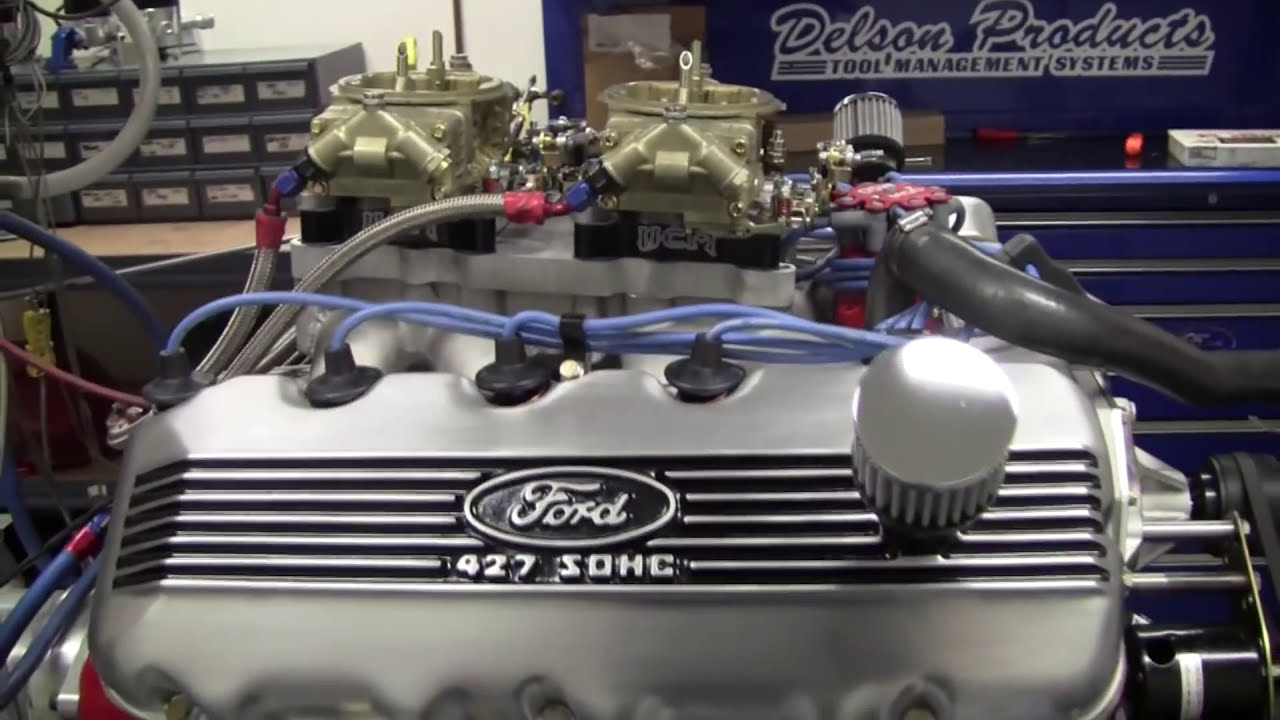

On 5/21/2021 at 12:08 AM, Bills72sj said:
How did you make the boot seals for the ignition wires into the valve covers? I need to attempt something similar for my 427 Cammer.
Hi Bill!
Sorry it took me so long to answer your question.
Got a little distracted you might say. ;)
If you go back and look at some of the earlier photos, you'll see that I started by sanding off the original boots and replacing them with thin disks of styrene rod.
I then sanded them down slightly to form a relatively smooth, slightly domed boot.
Then I drilled the holes for the wires slightly off center and at an angle.
I did this to allow the wires to lay down more flatly to the valve cover.
Once the wires were installed, I added a dab of 5 minute epoxy to each boot to smooth the transition between the boot and wire and to fill the gaps.
Finally, I painted each boot with flat black enamel.
From the look of your photo, I think that I would tackle the Ford boots a little differently as it appears that they stand straight up.
I would use the same general technique except I would drill a hole straight down the center of the boot base, insert a short piece of the jacket from a slightly larger wire than the plug wire, and then use a little epoxy around the base of that piece to blend the upper and lower sections of the boot into one seamless piece.
Once the epoxy is dry, paint each boot flat black, insert the wires into the jacket pieces, and you're done. ^_^
Steve
Steve
Thank you very much for sharing your techniques. I will make the effort with the materials I have. I have pre-drilled  the valve covers and also the heads. Mt distributor looks a bit sad but it is already glued in. Wish me luck!
