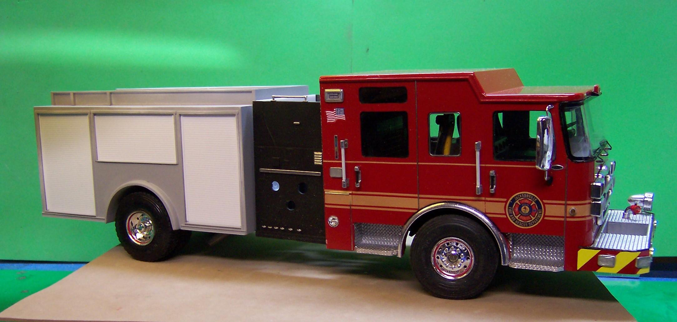

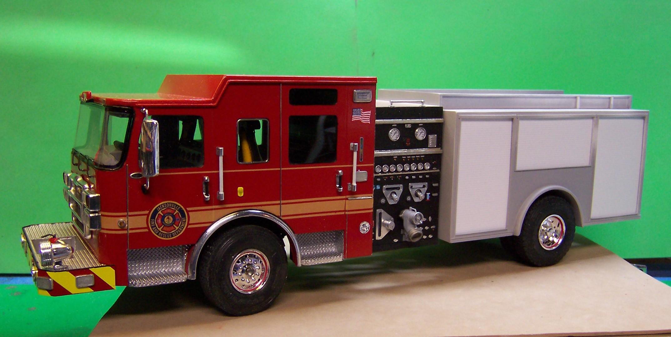

Just a couple of photos to show what it will look like with a pump panel in the middle.  This came directly from the Trumpeter ALF so it is not the one that ultimately will be there but it gives the idea.  I put a coat of primer on the body and it has had a first sanding.  Another coat of primer and it may be ready for paint.  The roll up doors will be done separately.
Before I did the primer I took the time to thin down the rear wheel well surrounds.  They were just too thick.  I used a cutter in my Dremel and took better than 1/16" of thickness out of it.  What a mess doing so!  I never realized PVC was so fibrous on the inside.  It is solid as a rock but the stuff went everywhere and stuck like glue!  I had to get out the shop vac just to get it off my hands.  Second time around I covered myself with plastic trash bags with holes cut out for my hands to stick through.  When I finished the bags just went in the trash.😵
The Trumpeter kit has some nice detailing materials.  That large diameter valve on the intake is direct from the kit.  Nicely done.  I did make the aluminum face plates for the two discharges above it and the one to the left.  Otherwise it is the same as what came in the kit.  The bright work is just BMF and a touch of a Molotow pen here and there.  No two pump panels are the same so there are loads of possibilities to choose from.
