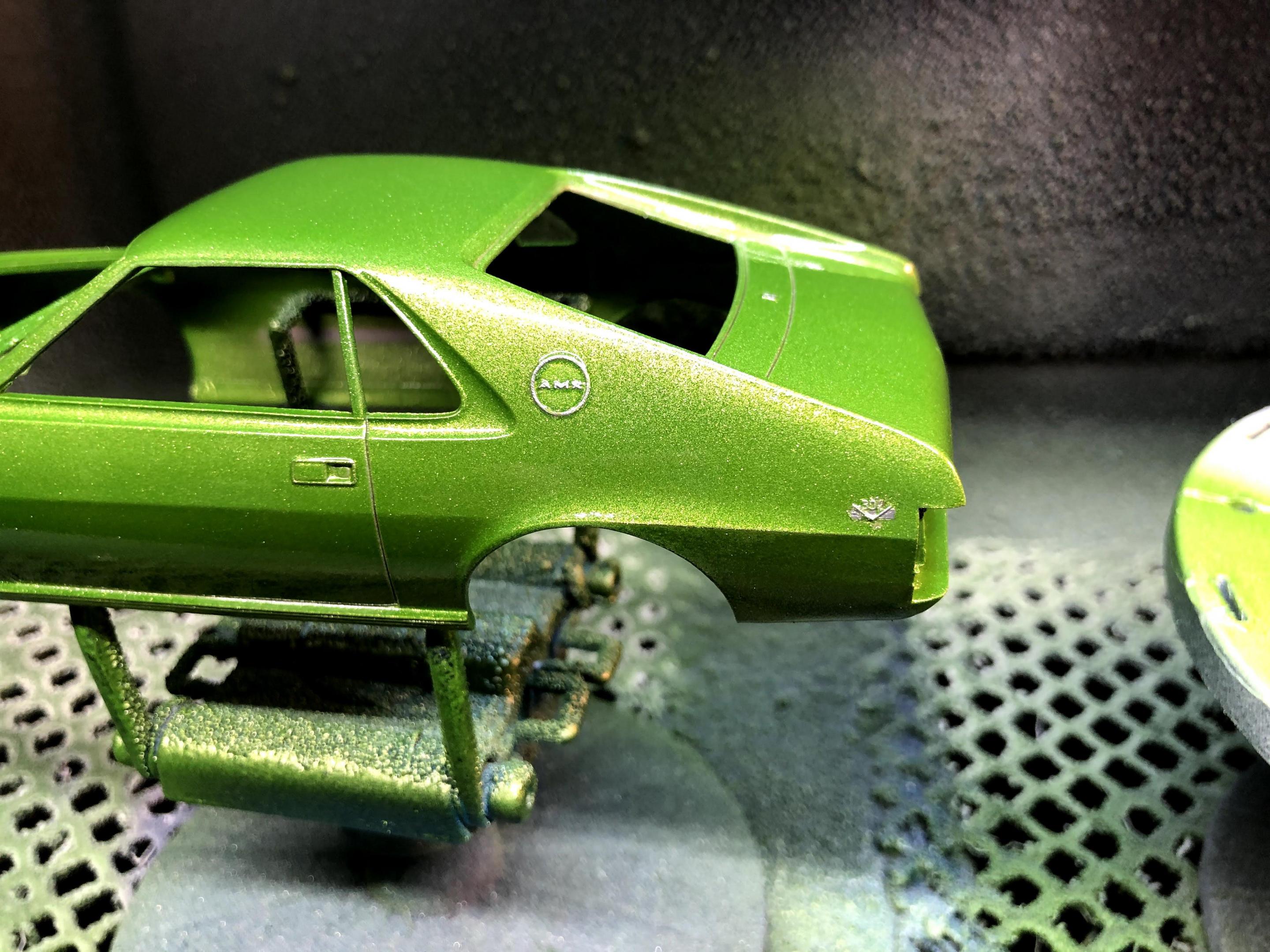

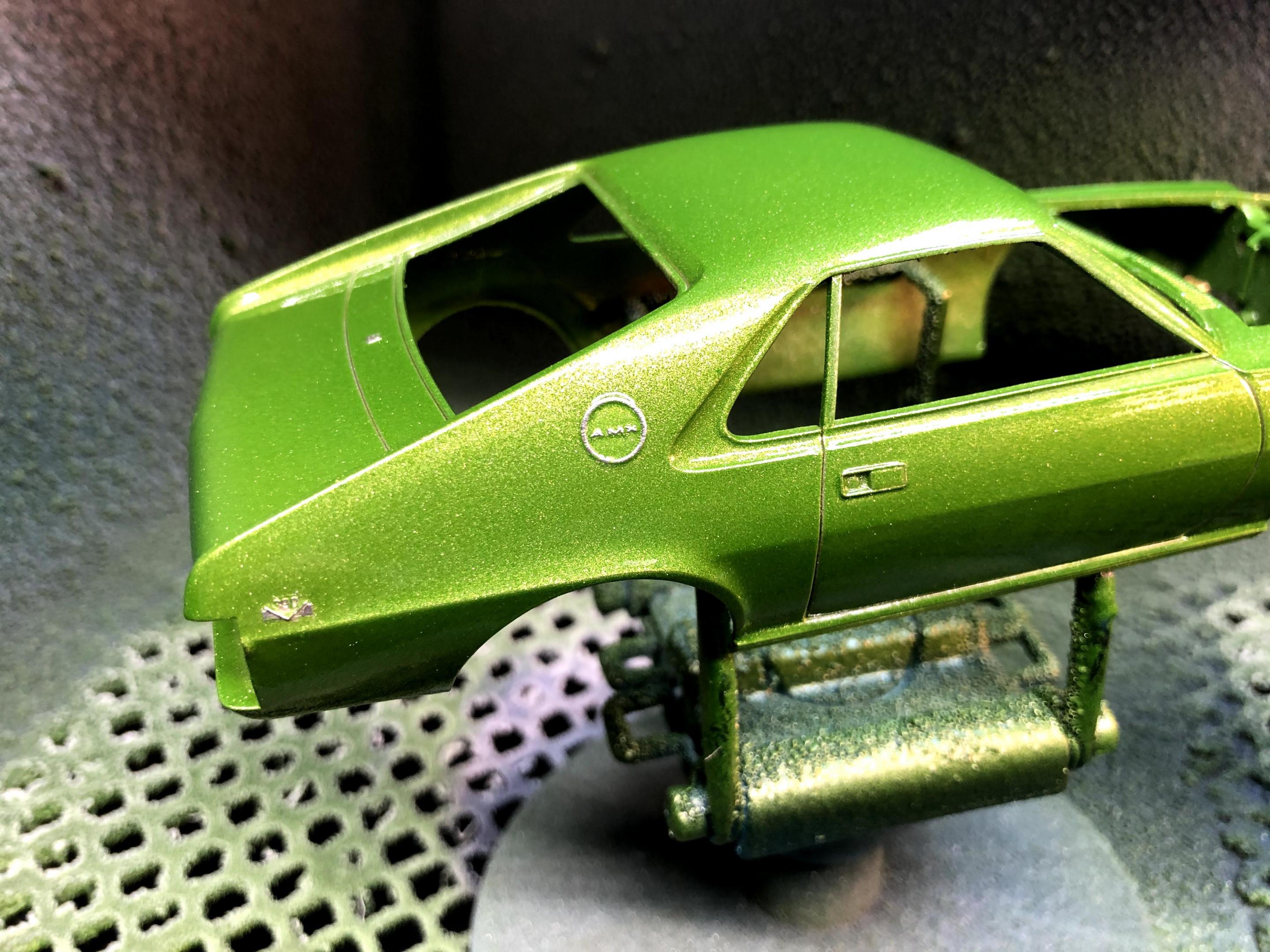

I made my first attempt at using BMF and used it under paint. For my first try I did the emblems on my 69 AMX. What do you think for my first try?

Thanks Guys, I learned a lot on my first shot at it and have what I think will be my technique doing it...
So how exactly do you get the paint off the emblems after painting ? Surprised it doesn't mess up the paint around the emblems
Share this post
Link to post
I used 2 methods to see which I liked better, first I used a toothpick soaked in lacquer thinner which worked pretty good until the painted started getting hard then it started to kind off peel the paint rather than take it off so I changed up to using a pointed craft cotton swap with lacquer thinner on it to wipe the paint off (very lightly) and that worked really well I thought and will probably be how I do it from now on....
Thanks for all the encouragement and comments guys...

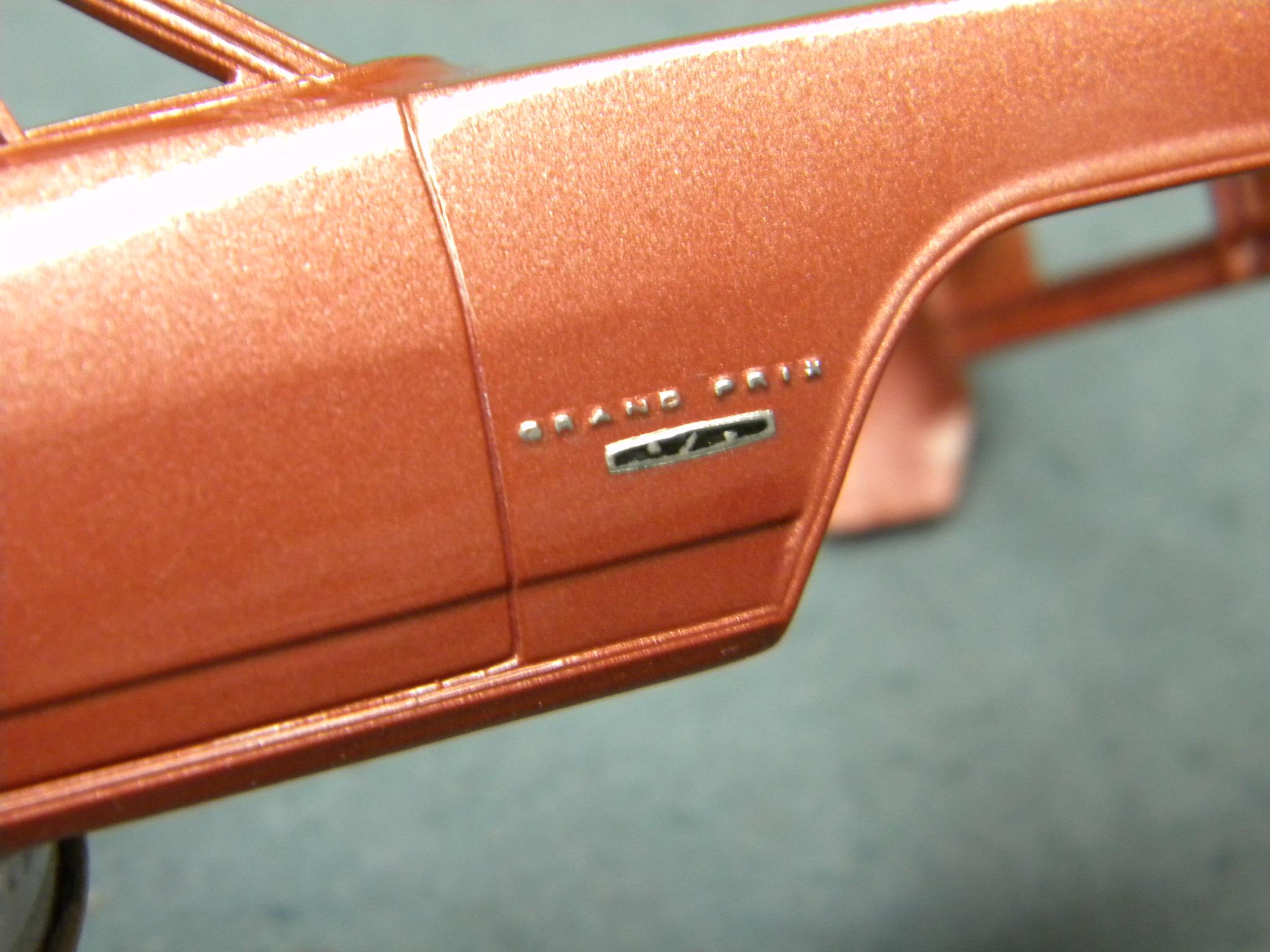

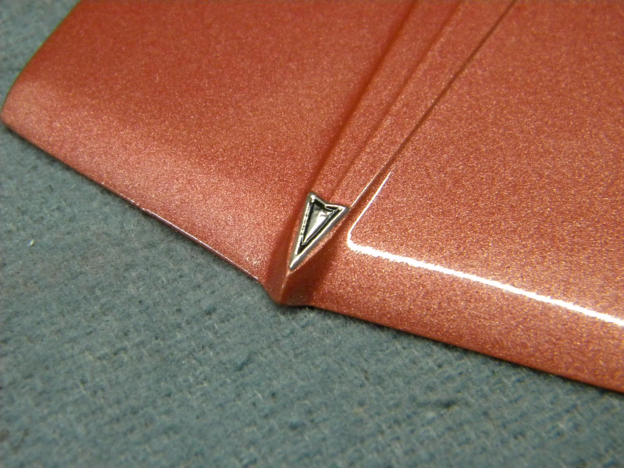

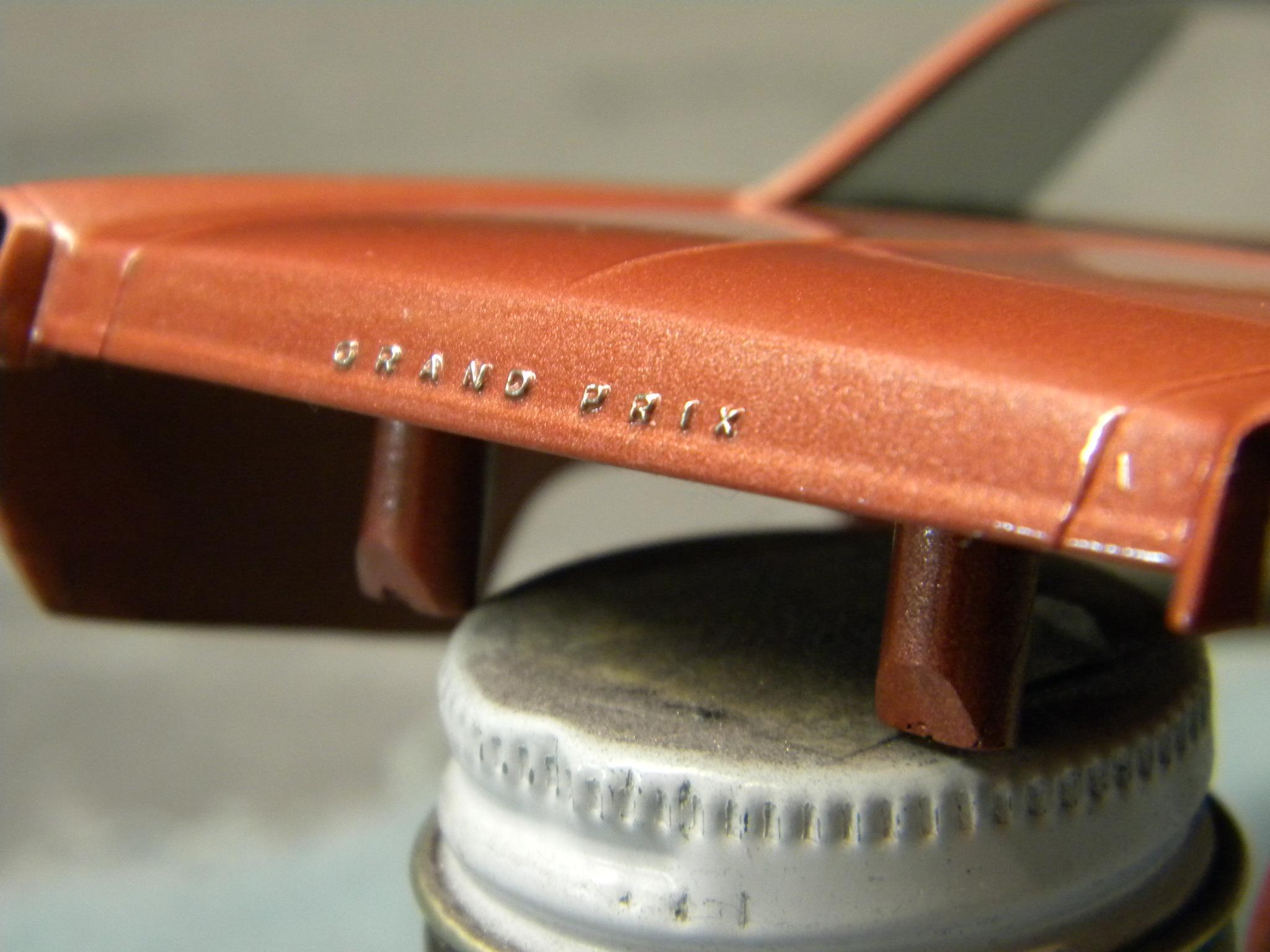

I use both methods on the same script with great results.
I use the conical swabs first.
This loosens the paint and takes it off of the high points.
Then I come in with the sharpened tooth pick dipped in lacquer thinner to clean up the edges of the already loosened paint.
This step will give you more "relief" around the perimeter of the script making it look more like it's sitting on top of the surface rather than embedded in the paint.
The secret is to be very stingy with the lacquer thinner to prevent any "bleed" onto the other body surfaces.
Take your time and repeat if necessary and you'll get great looking scripts every time.
Also, the less paint that you need to remove from the script the better, so applying the foil just before the final color coat and removing it right after, will be the easiest approach requiring a lot less effort than trying to remove multiple coats of primer and paint.
Once you get the hang of it, it's relatively easy to get nearly perfect results, even on the faintest and tiniest scripts.
My latest attempt on the old AMT 1964 Pontiac Grand Prix had me a bit worried because it's so faint and small, but with caution it went just as well as any other script that I've attempted regardless of size.
Another good tip is to detail any scripts containing color with a small brush after cleaning the paint off initially and then repeating the same technique for the added color.
I then spray my clear coats on after this process to seal and protect the scripts and badges.

It was definitely easier than I thought it would be and I think with some practice I can get them pretty good, And I want to thank you Steve for all the info you have shared with me on this and other detail work you have made a huge difference in my knowledge and have been a huge part of helping me step up my builds..... Thank you
