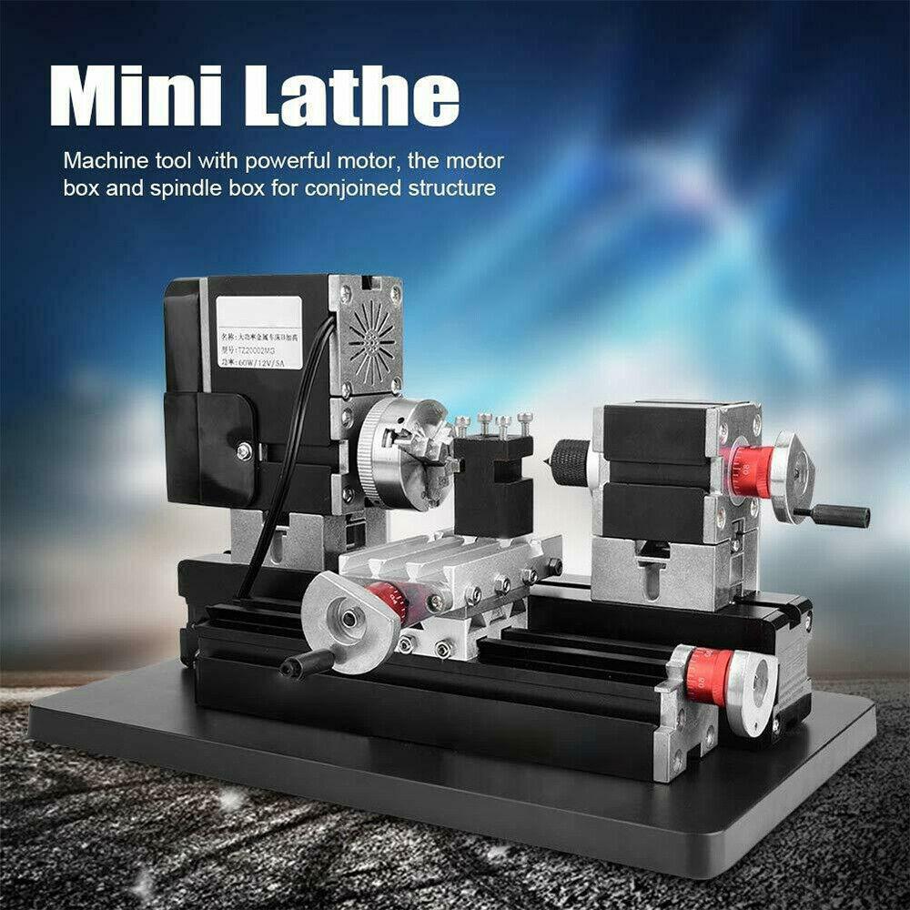

Bills72sj Posted September 19, 2020 I have been wanting to machine my own rims for some time now. Over the years, I have acquired one FULL model box of rims and 3 Full model boxes of tires. My problem has been that most of the rims do not fit most of the tires. Add to the fact that I build day-two rides that really need wider rims for bigger tires in the rear. For awhile, I sanded the backs out of some deep dish spares to add to a pair of wheels to accomplish the look. The problem is I keep running out of deep dish donors to sacrifice. Way back, I got a set of after market wheels with aluminum hoops. I had a hell of a time gently changing the depth of the step inside to obtain the desired offset with a rototool (what a PITA). I really wanted a mini lathe but had a hard time justifying $650 (and up) for a decent start and am very wary of the cheap chinese one with a 24W (or less) motor. Well today I ran across one with a 60W motor with enough features to get me started for $261. Since all I basically want it to do is turn short chunks of aluminum tubing into wheel hoops, I hope it is good enough. We shall see. Quote Share this post Link to post Share on other sites

Elmer Fudd Posted September 19, 2020 It took only a couple minutes to find an unboxing and review of this exact same model on youtube. (60w mini lathe unboxing) It was a little shocking to see that the overall length of the machine was about the same length as the reviewer's hand. It was sitting on one of those green mats with 1" squares. It looked to be 9-10" long. The review speaks for itself. The comments below the video were brutal. In closing, the Chinese distributor for this lathe probably became a millionaire because of this product alone. Quote Share this post Link to post Share on other sites
Bills72sj Posted September 19, 2020 Well something went sideways. My order was cancelled as of today. Quote Share this post Link to post Share on other sites

Elmer Fudd Posted September 20, 2020 I reckon that you Guardian Angel intervened. You dodged a high-speed projectile. This lathe was a POS. See the video. Quote Share this post Link to post Share on other sites
Pete J. Posted September 20, 2020 You get what you pay for when you buy cheap from an unknown manufacturer. Here are some thoughts on what to look for. Motor: Watts is only one factor. For consistent machine speeds and torque you are best off with a variable speed DC motor. It also helps to be a belt drive with at least two different size pulleys. Some times you need high RPM. Other times you need torque. Also, an infinitely variable speed controller is necessary to control the rotation speed. On smaller parts you need more RPM and less on large diameter parts. Think of it this way. At a given rpm, the outside of a circle is travelling as a faster speed than the inside. A variable speed unit that you can control on the fly means you can turn across the face of a large piece. Start at the edge with a speed that gives you a good chip and increase the speed as the diameter gets smaller. This way you get a smooth face. All of this changes when you change type and grade of metal. If you are going to use aluminum only, it is very important. There are literally hundreds of aluminum alloys and all machine differently. Second is size. Having a bed that is longer than any part you can imagine making will give you room to work around all your pieces. Remember, if all you make are rims, you will need to be able to bore the center with a drill bit and finish it with a boring bar. This means you need to mount the piece in the chuck and the drill bit in the tailstock and have a bed long enough to handle all of that. As your skill grows, I can guarantee you will want to make more than just rims. While you are considering length of bed also consider the travel of the cross slide. Some tools work better on the back side and others on the front. Being able to mount a tool on the front and back at the same time, can save setup time. Example: when I cut off a series of discs, I have a parting tool that works on the back side. I keep it mounted because that saves me the hassle of changing tools after every cut. Next is the accessories. No lathe will ever come with every possible tool and attachment you need as your skill progresses. Having a manufacturer with a broad range of tool and jigs Is a plus in the long run. This also begs the question of how long the manufacture has been in business. Will they be there when you want other tools or parts that may ware out? By the way, over the last 10 years I have spend more on accessories than I did on the original lathe. So, I guess what I am saying is the machining rims sounds easy and simple. It isn't. It takes some skill. Those skills are easily learned but if you buy a cheap machine you are quite likely to give up in frustration and you will have wasted your money. Save your money and get a good machine. It will make the job easier and you can grow with it. Quote Share this post Link to post Share on other sites
