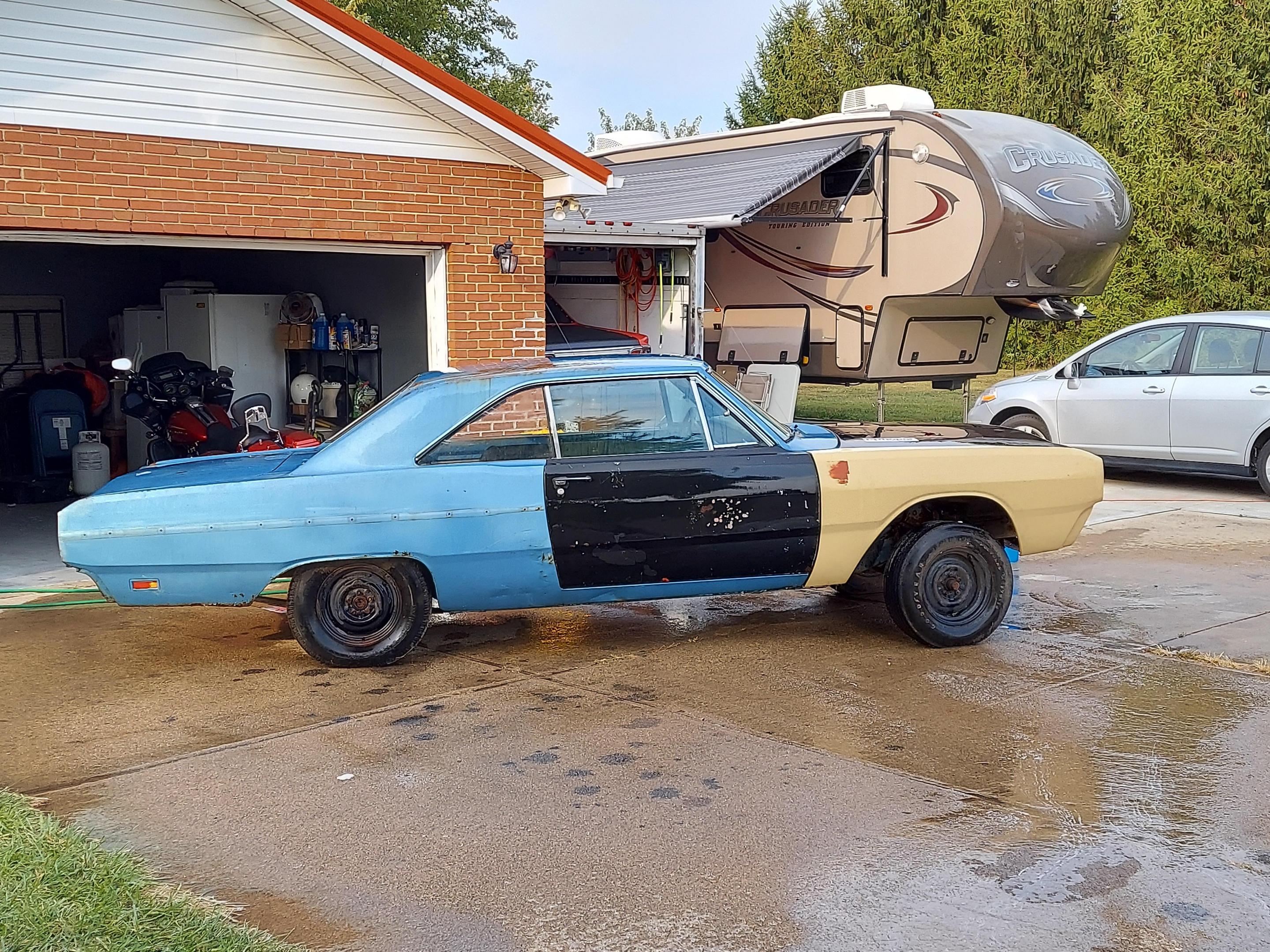

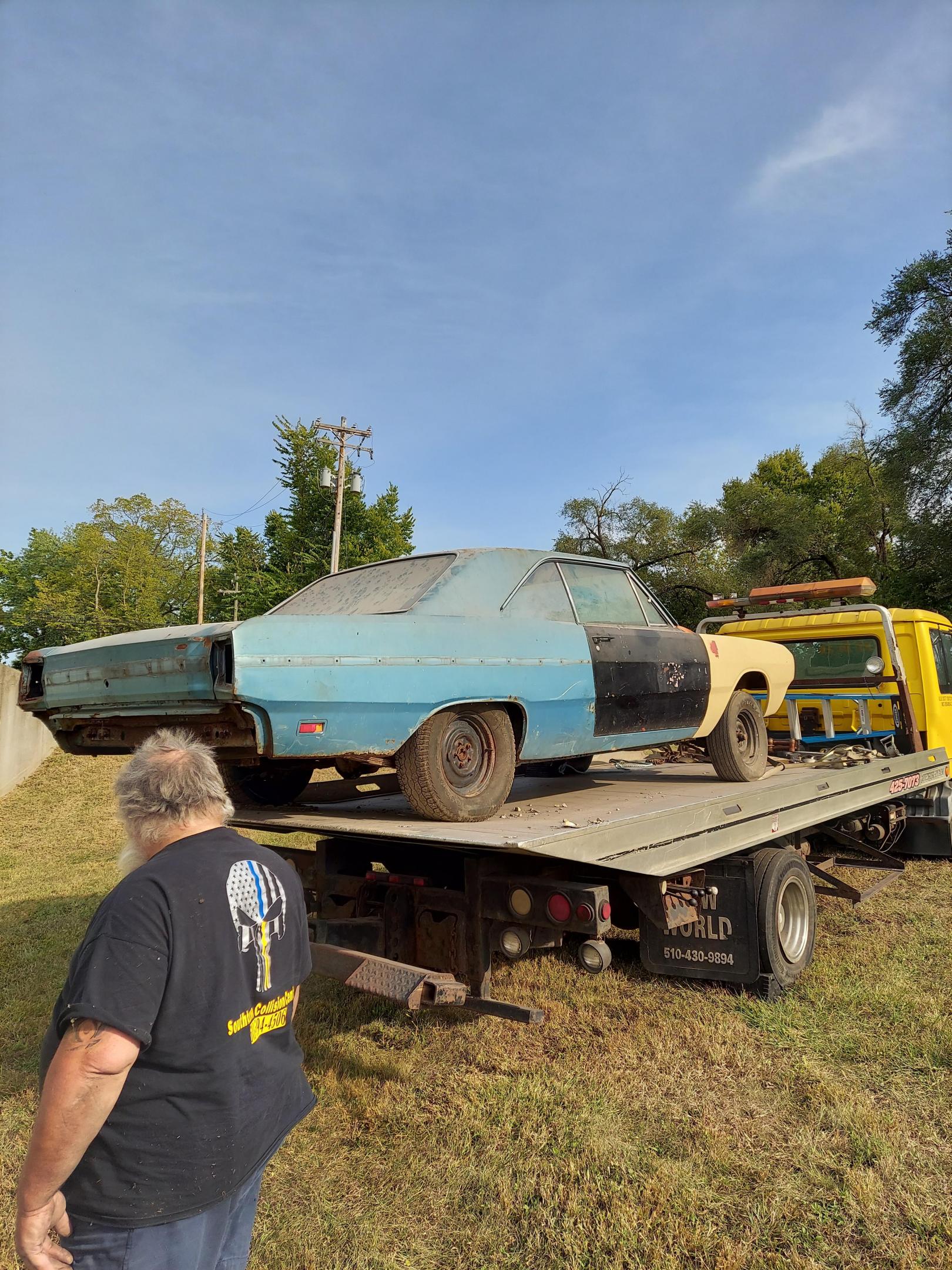

     This is the main reason for my recent absence of modelling. Right as I get back into it this falls into my lap. But hey, I'm not complaining. The Car is super solid and it will take some work, but I'm excited to have a clean slate to start with. I'll begin in Pro and then bump up to Nostalgia Super Stock here in a few years.
     It began with a discussion with a family friend about wanting to upgrade from pit crew, for my dad's '66 Hemi Dart, to my own ride. Wheels got to rollin' and next thing I know I'm on my way to pick this up. Already has Fiberglass fenders, and besides a scrunched up quarter panel/tail light pocket, it's clean.
     I have a mild 440 and a built 727 Torqueflite going in it, which will be hooked to an 8 3/4 after bracing it. Car should weight about 3000# with me in it, myself weighing roughly 265#.

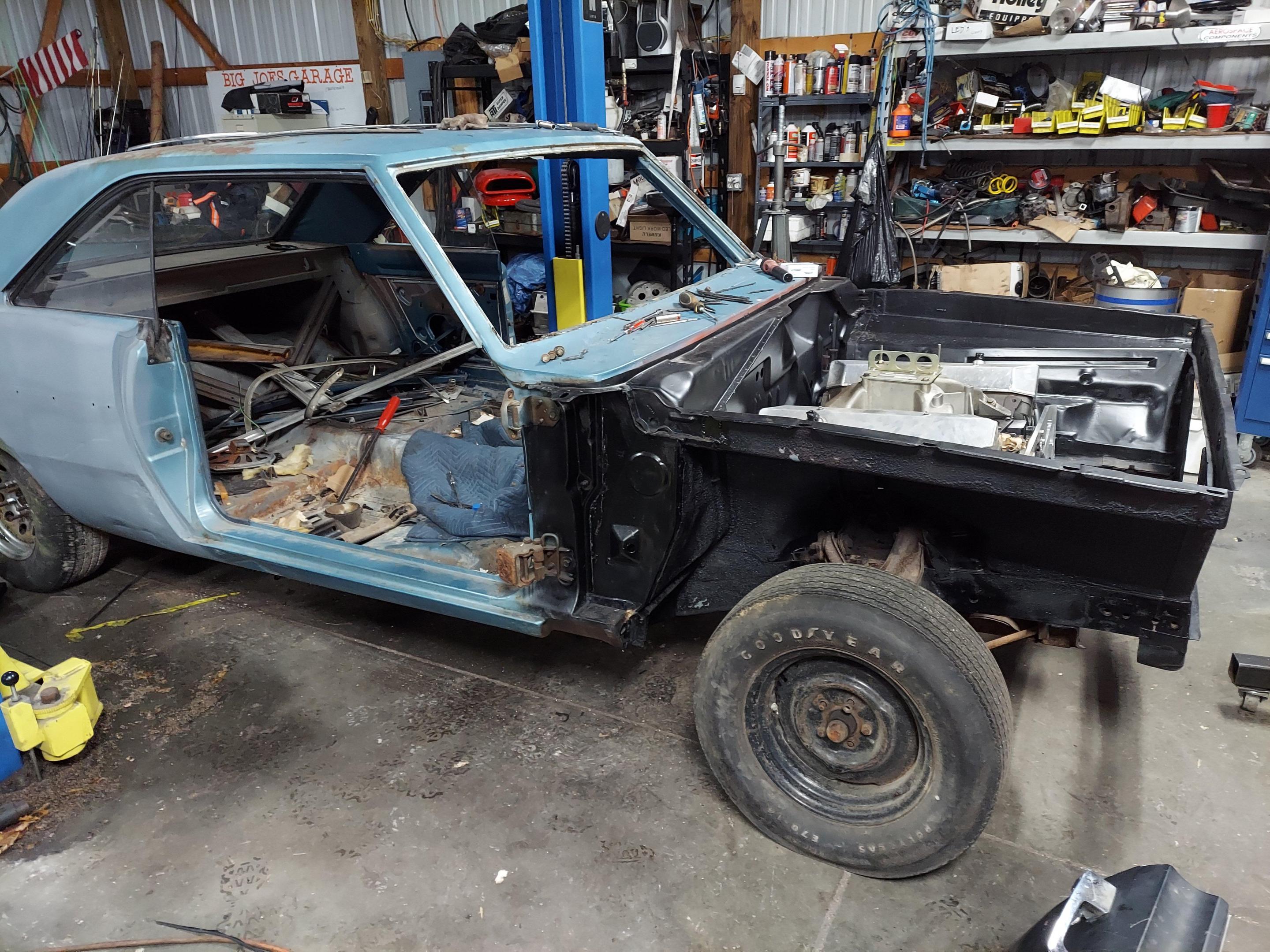

     I started on the rust repair tonight, and will smooth out the firewall and various under-hood bits and will leave the exterior as is until I can start the body work.

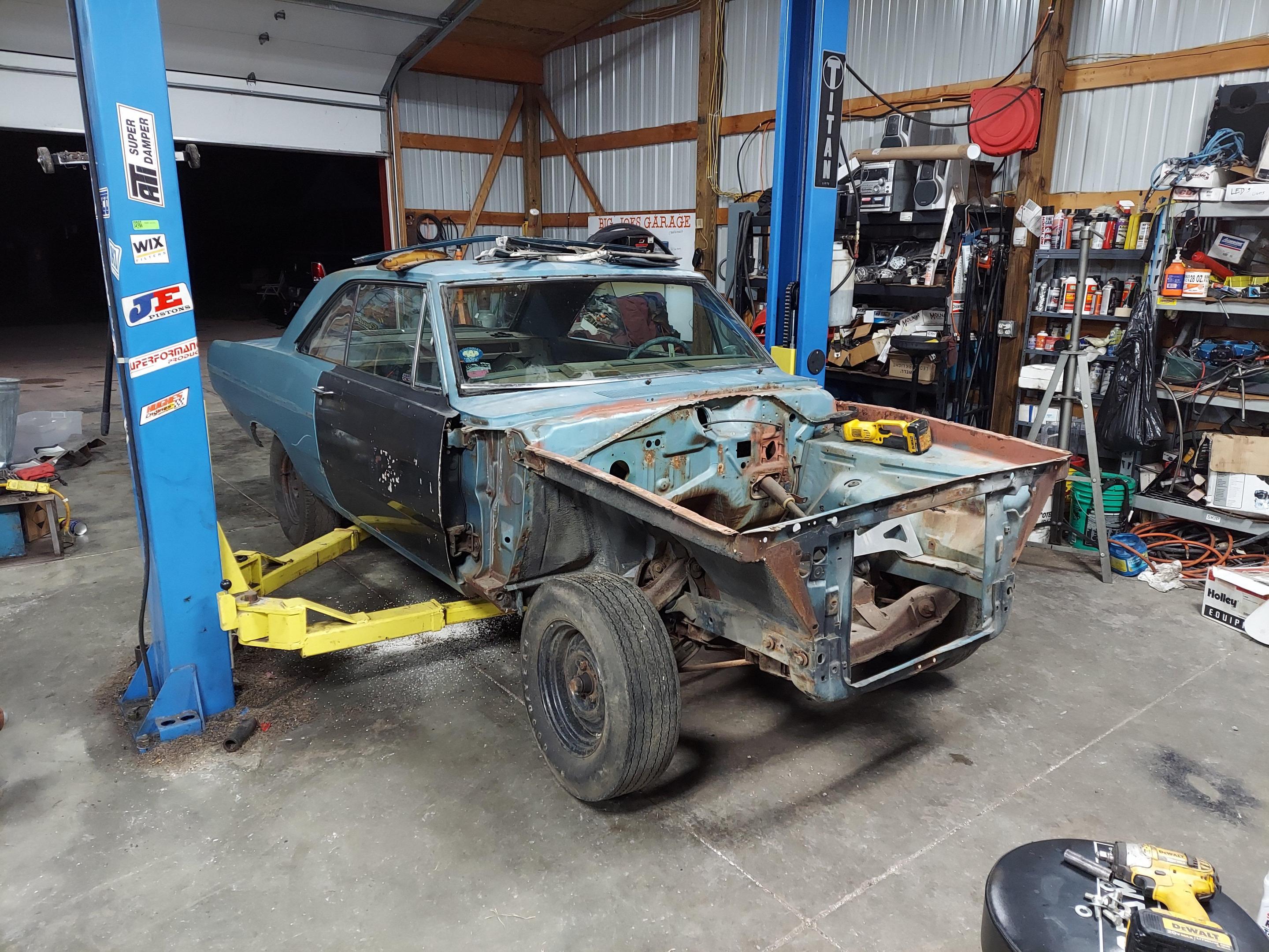

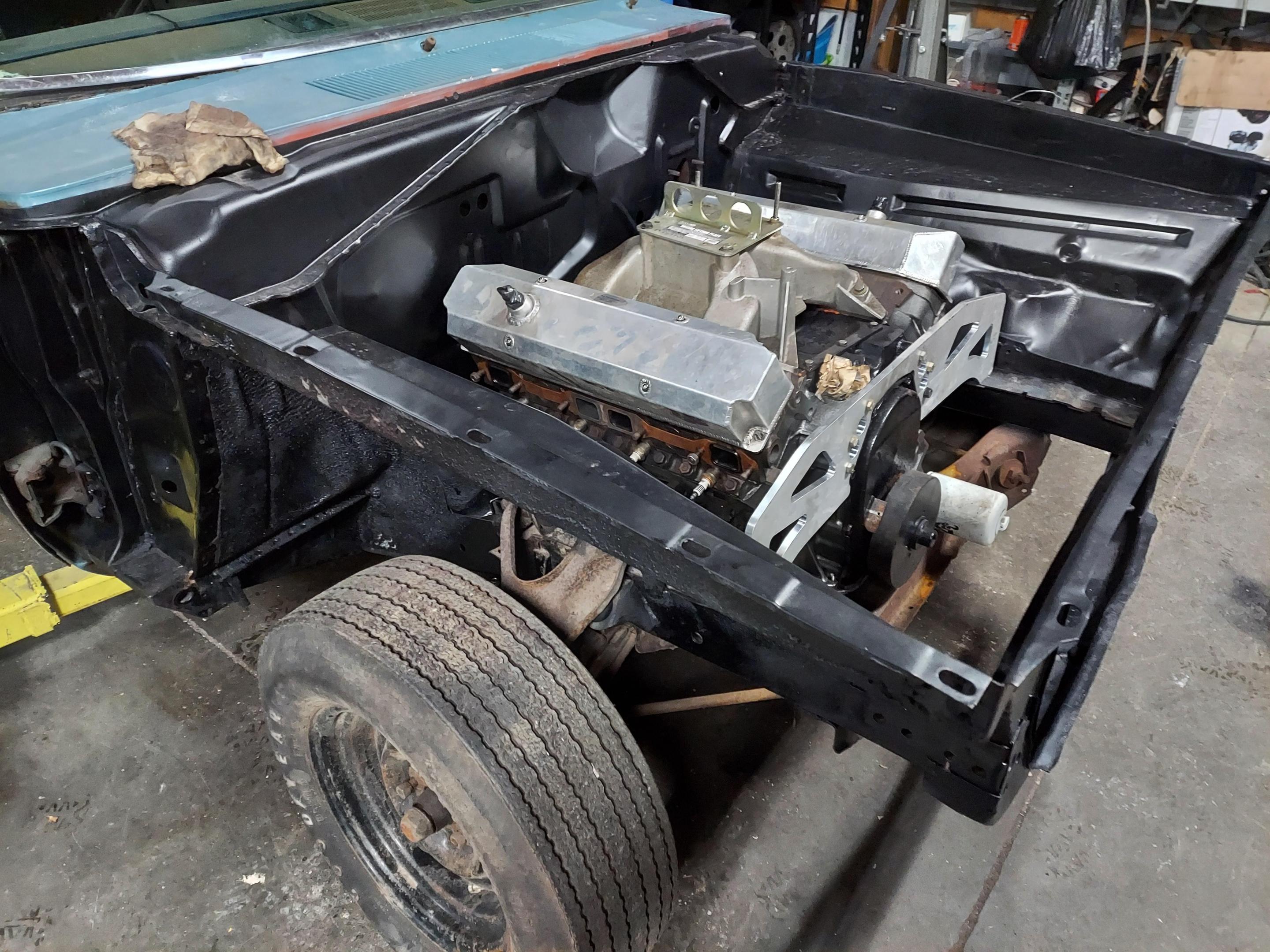

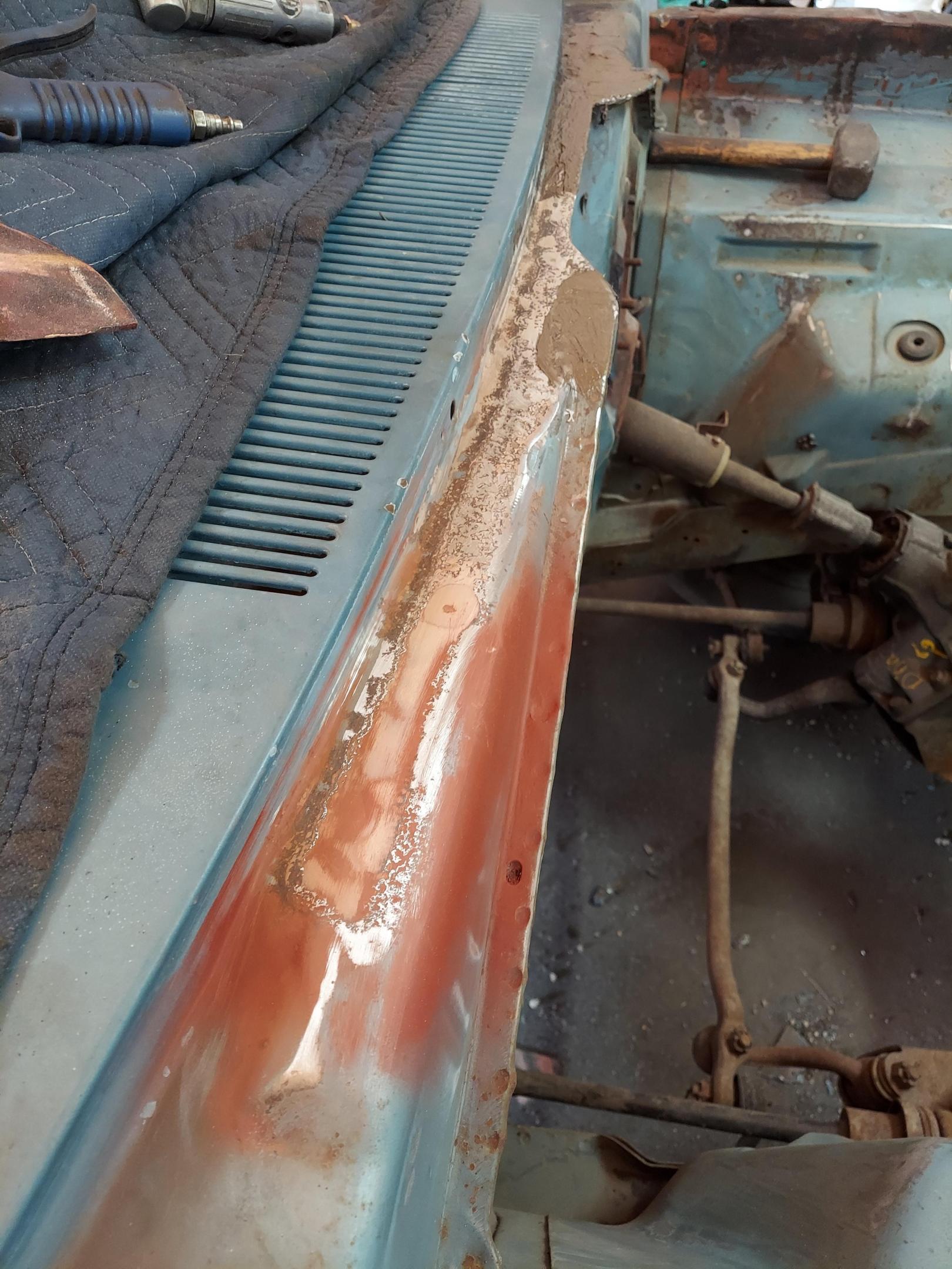

     I began to wire wheel the engine bay, and asses what needed to be replaced/fixed. Luckily nothing has to be replaced, only a few small rust spots which are easily fixed. Once I get the engine bay smoothed out and nice and clean I'll be spraying it with VHT Epoxy Chassis paint, great stuff.

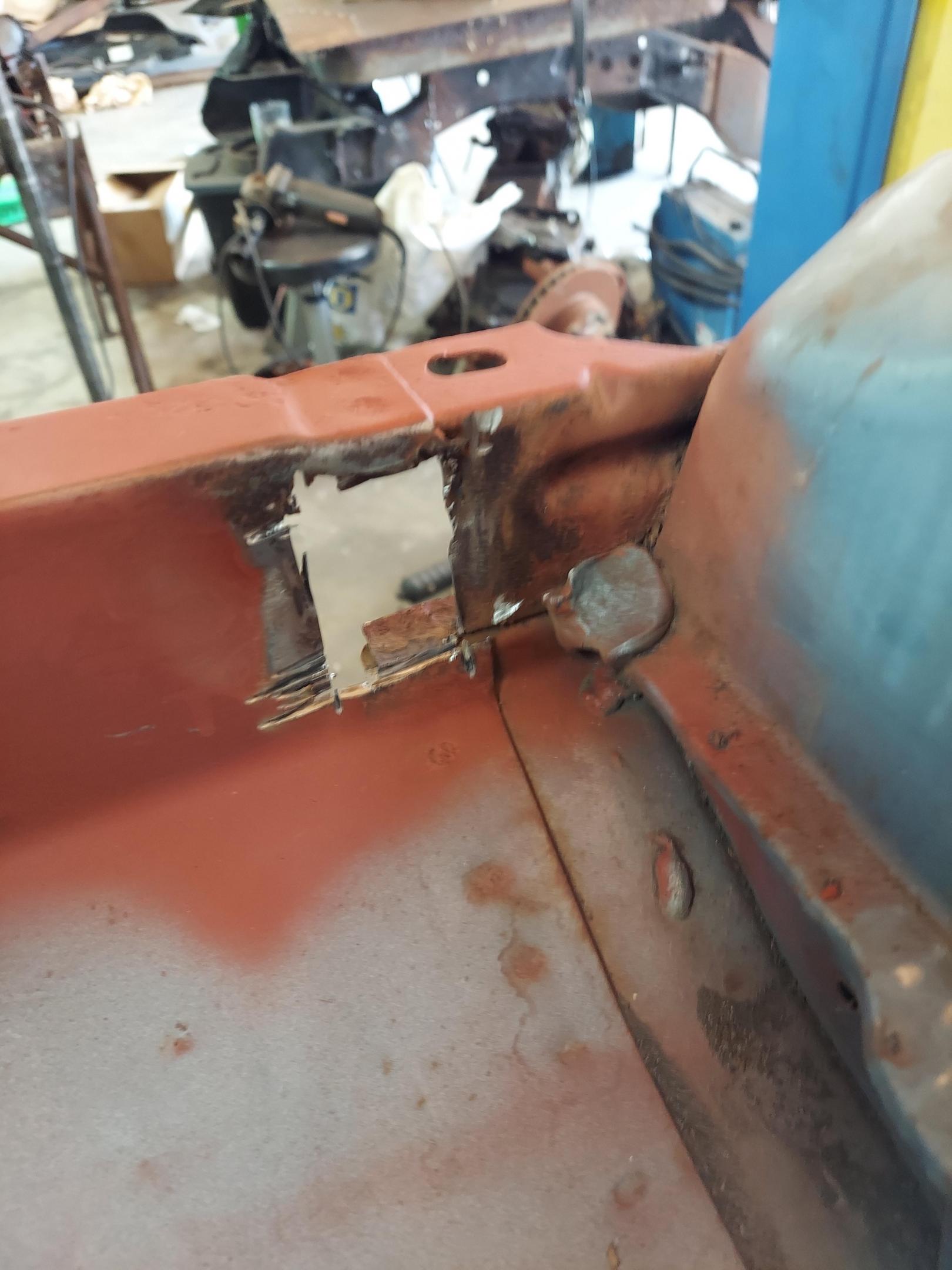

      I cut out the old, rusty metal, made a filler piece, got it as level as I could, and welded it in. I then skimmed it with bondo and sanded it smooth. Then, covering it with the sandable primer I use on everything, I covered it up to prevent further corrosion. I'll let everything cure for a day or so then go back over it with a follow up coat.

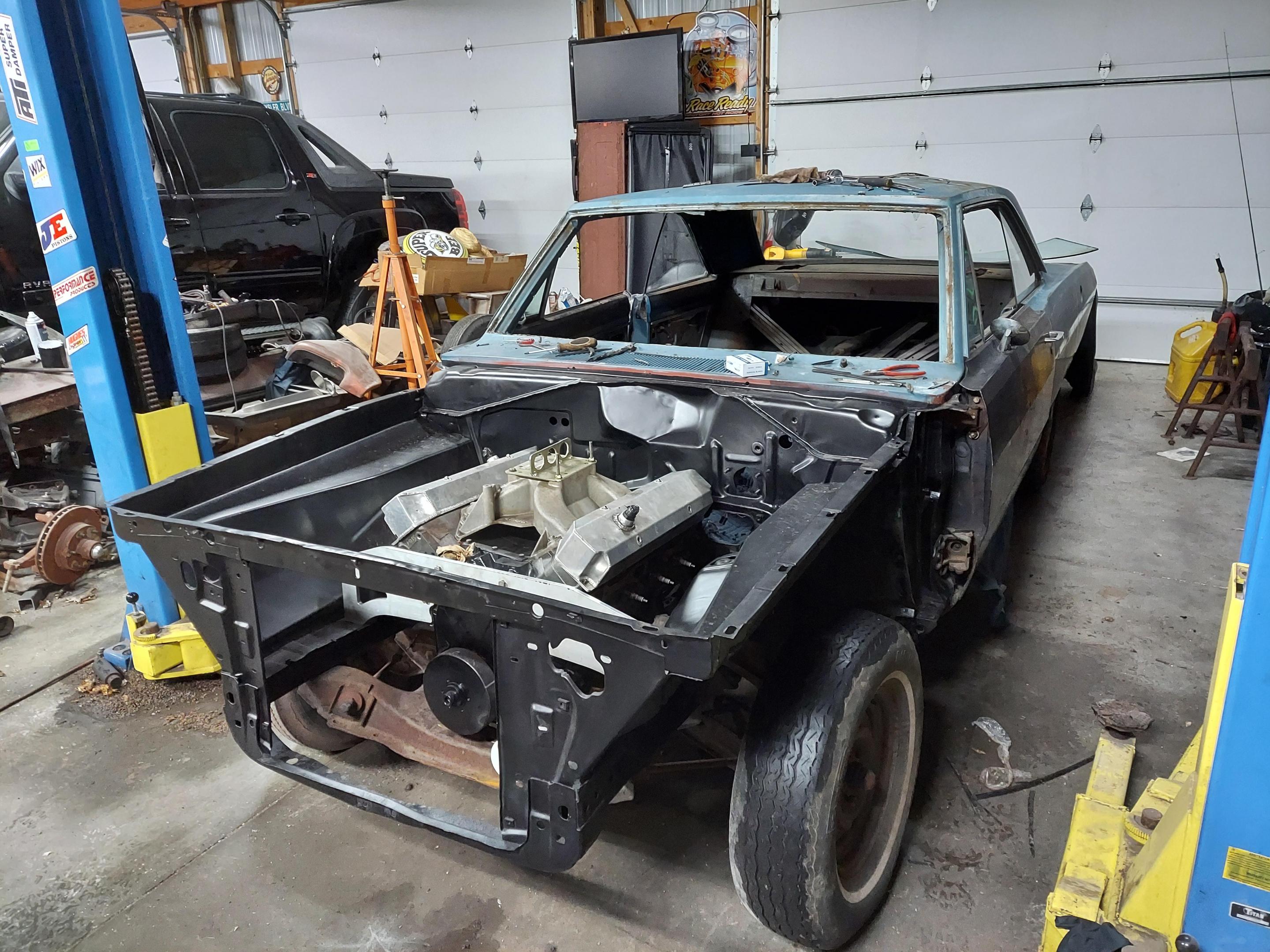

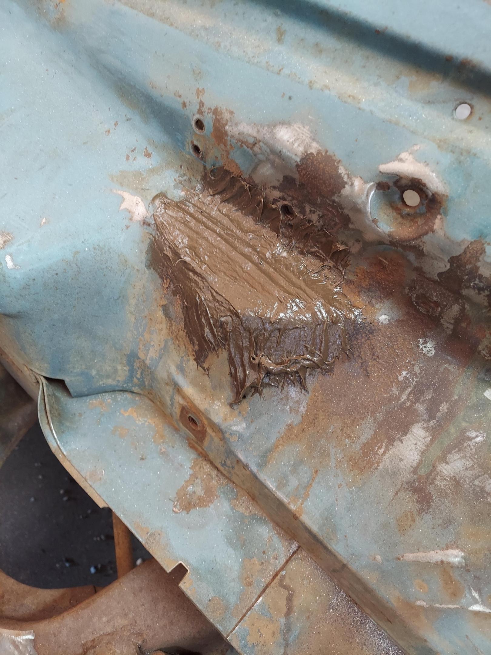

     What a Big hole! Cutting out the rust on the inner fenders and welding in patches, then running over with kitty hair, and then bondo. I want this thing cleeeean. Started welding up all the small holes on the inners and the firewall as well, then my die grinder broke. Oh well, I have errands to run tomorrow anyways.

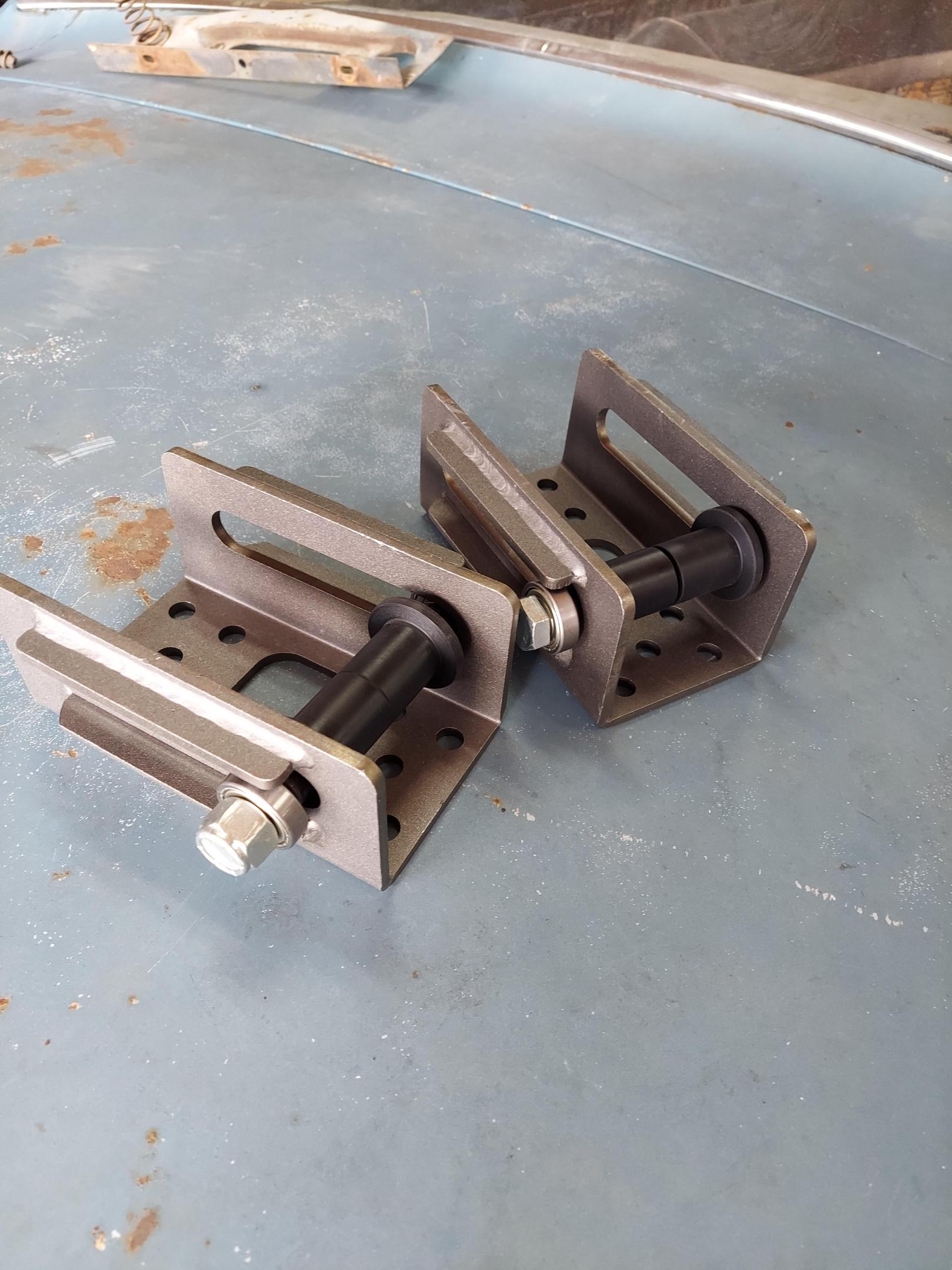

     Today was like Christmas in...September! My Leaf Spring relocation kit came in from RMS suspension. I'll end up mini-tubbing it with split-mono leaf springs and a set of Caltracs. It'll be on a 29.5x10.5 slick. With the 350~ HP it has currently I should have no issue with traction. I wanna build it to be ready for more power down the road.

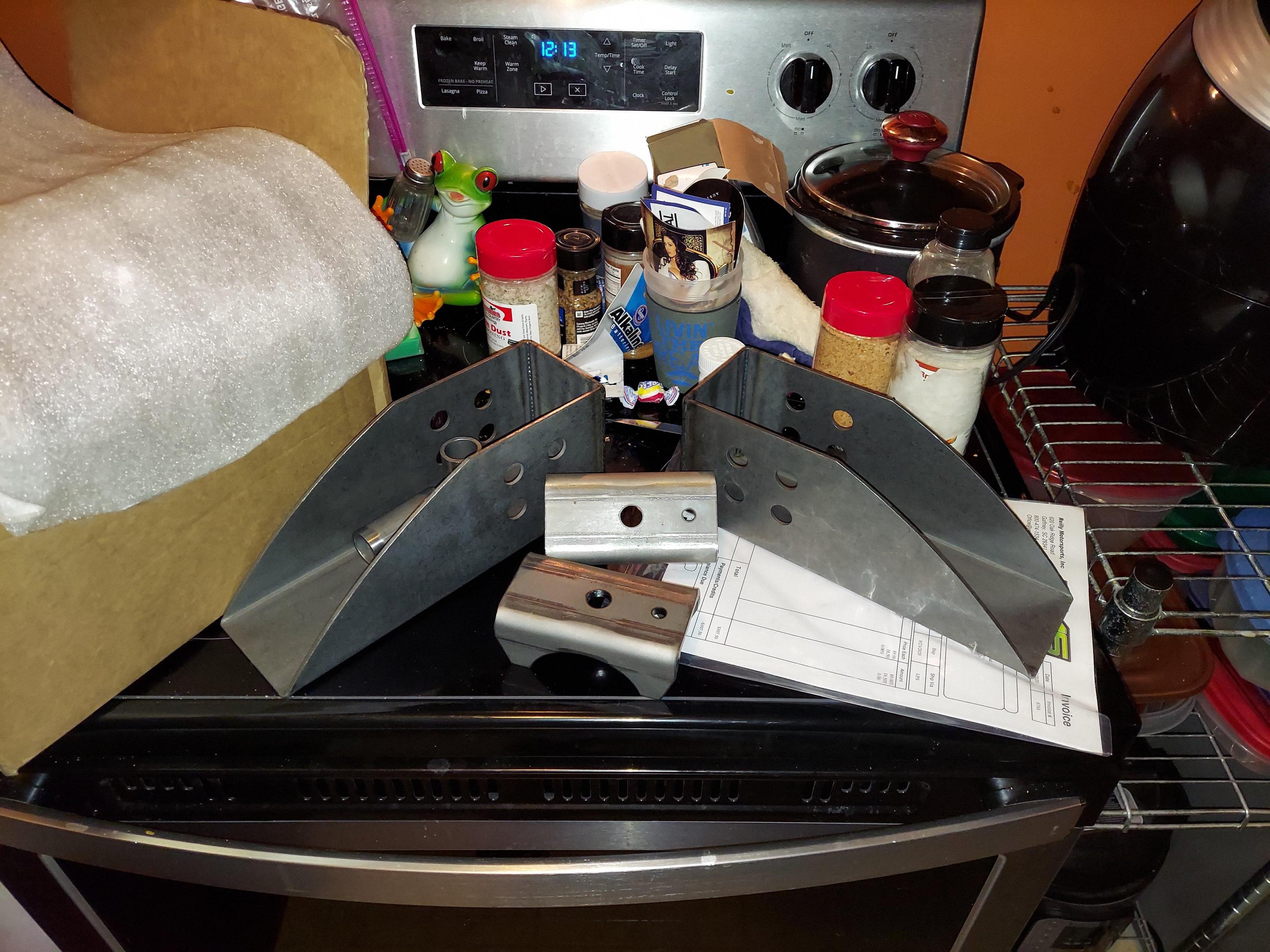

     My spring sliders came! Once I get the engine and tranny together and mocked up I'll get the suspension all together. Engine bay is nearing completion. I should have it done within a few days.

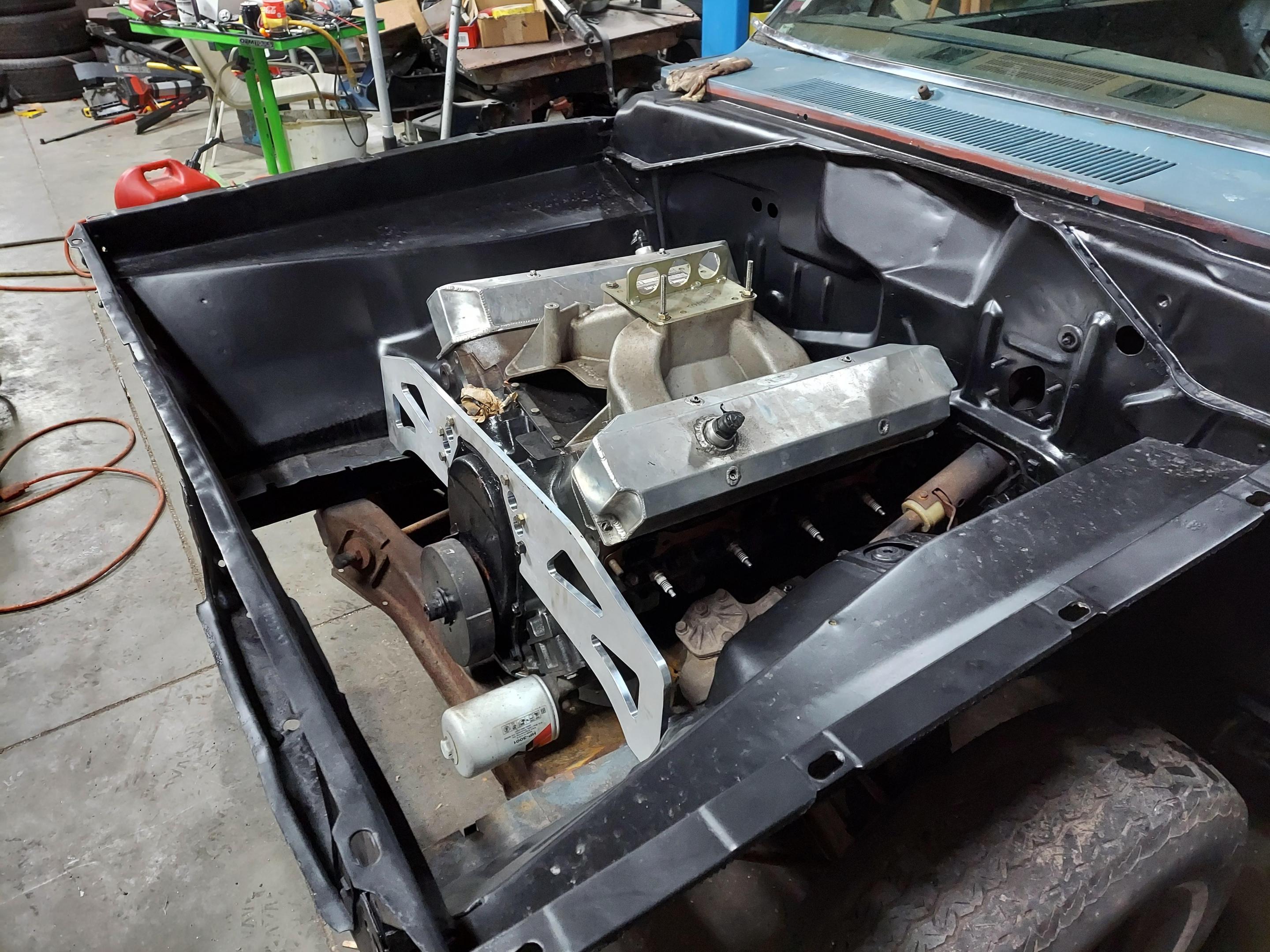

     I'll find a set of headers here soon. The hammer doesn't scare me much, neither did the plug situation. I'll cross that bridge when it arrives though. Engine and Tranny will be going in shortly to be mocked up and mounted with the motor plate.

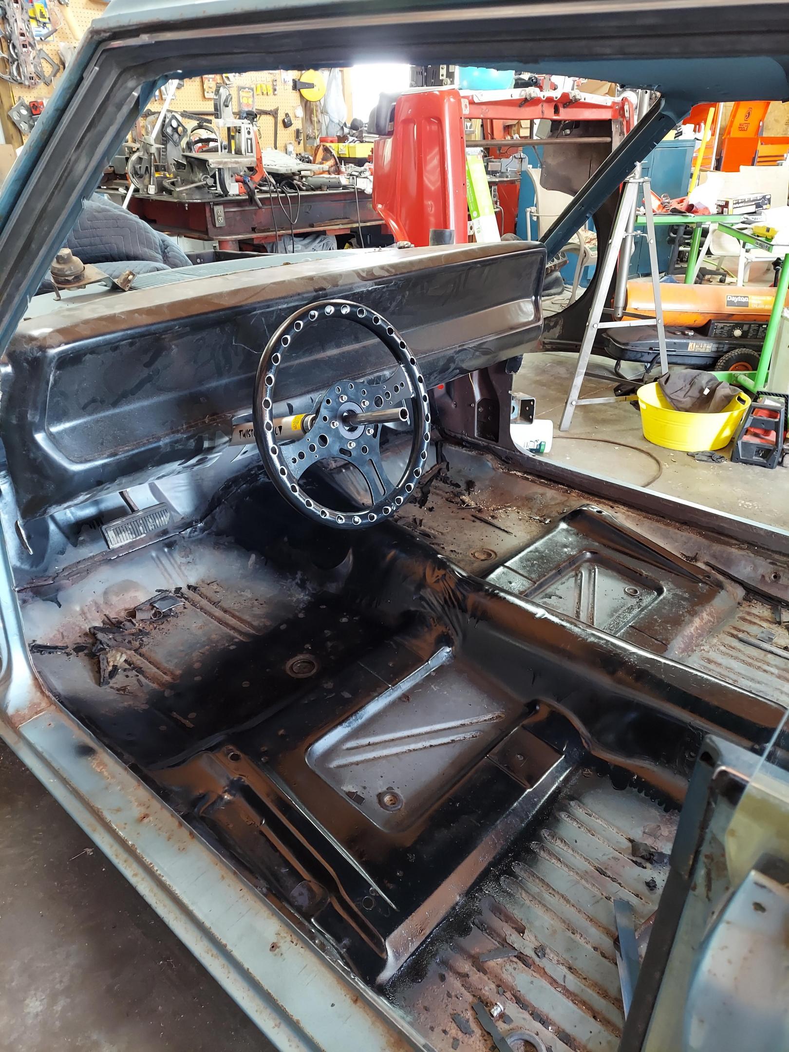

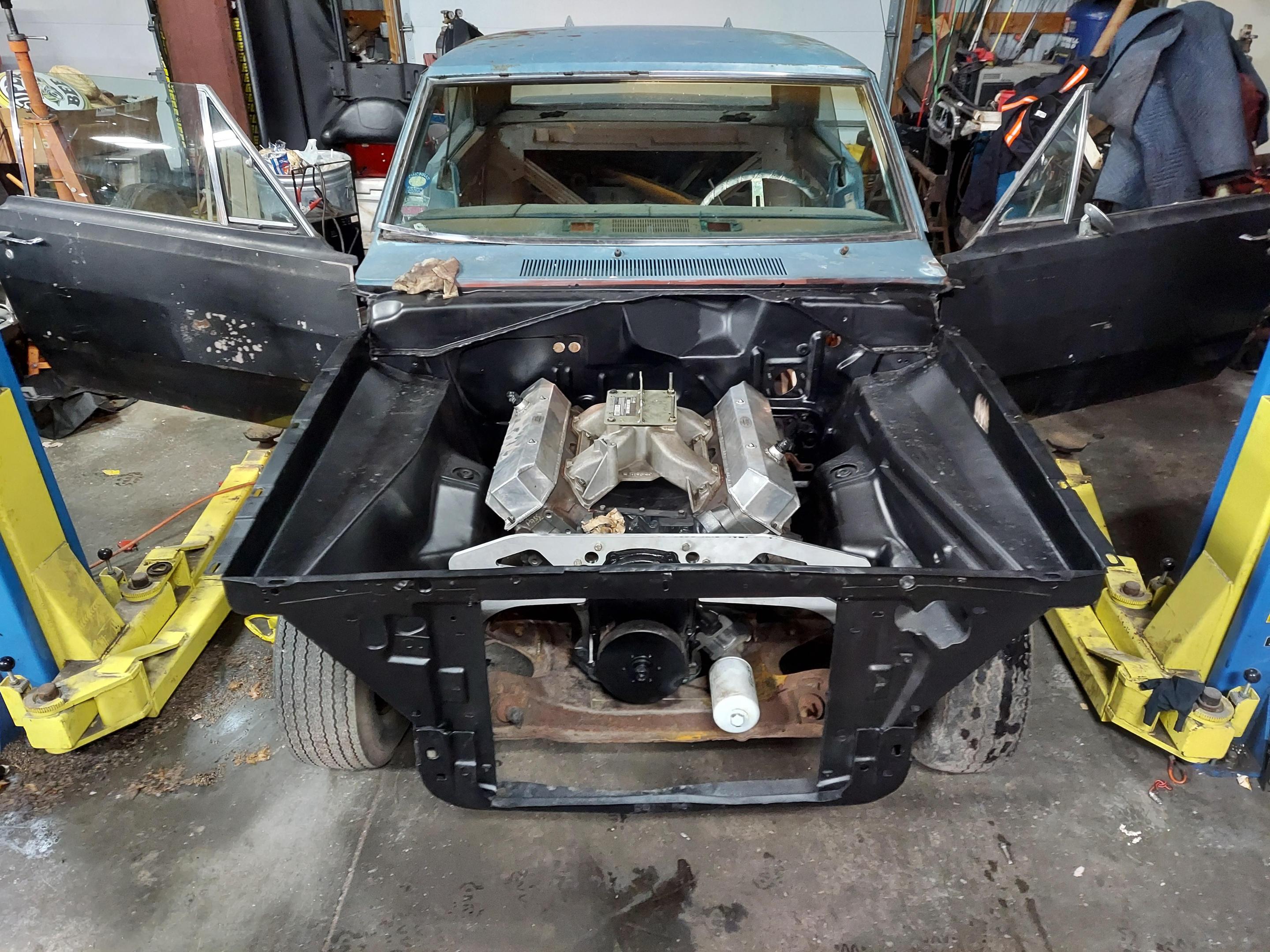

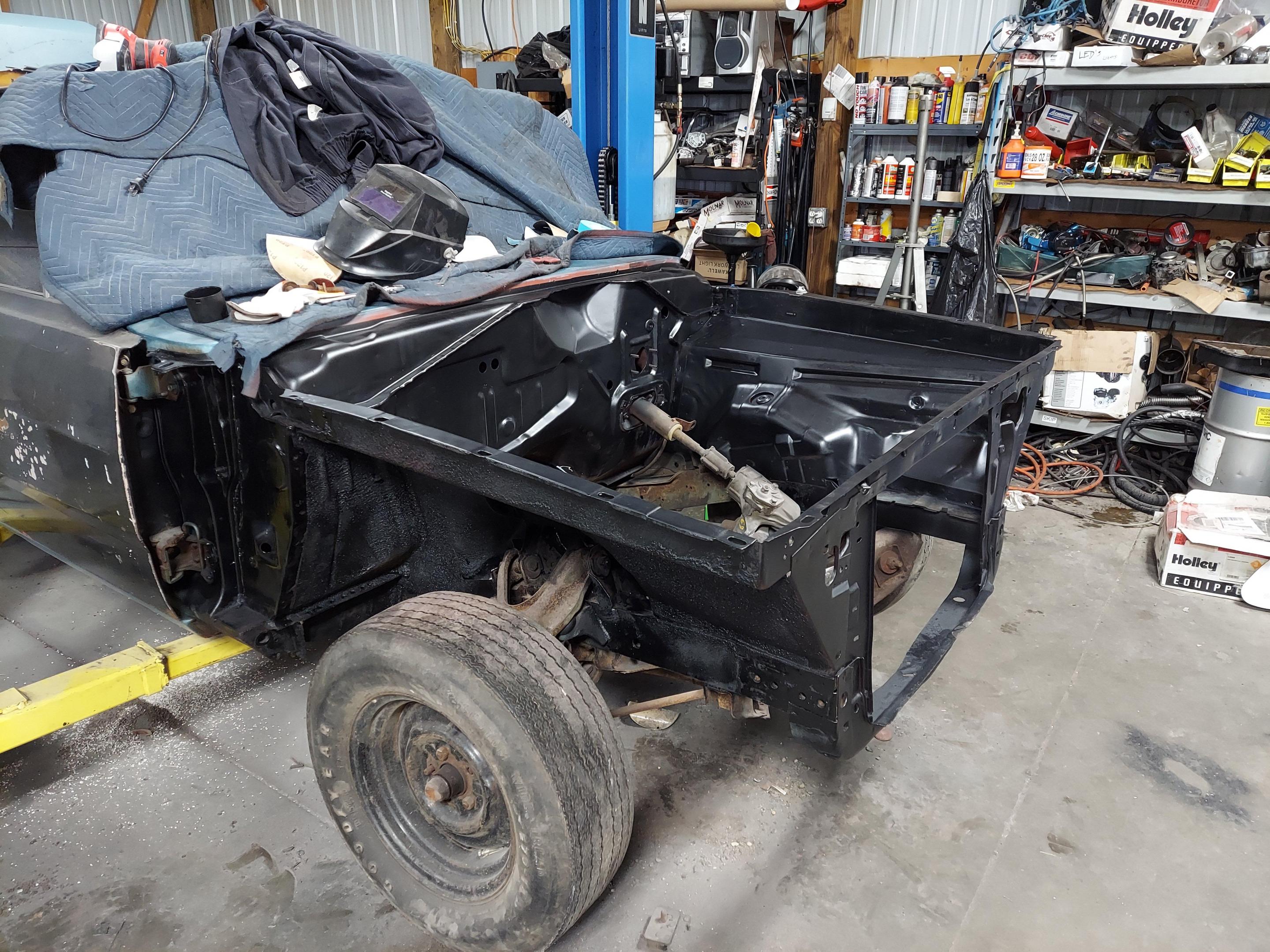

     Finally got the firewall done! There are a few small rough spots, but the majority of them are on the spots that will be cut out for the headers, so no biggie. Got my Calvert Racing Mono-Leafs ordered, and as soon as I get the engine and tranny in, I'll start on the rear end work. I also slapped some paint on the underside of the inner fenders just to make it look pretty.
     Next Paycheck I'll probably order the new steering column and steering wheel. It'll save a little hit of weight too. Went and bought a few sticks of Chromoly to start building the cage with as well. I'm aiming for 2850-ish minus me, but wet.

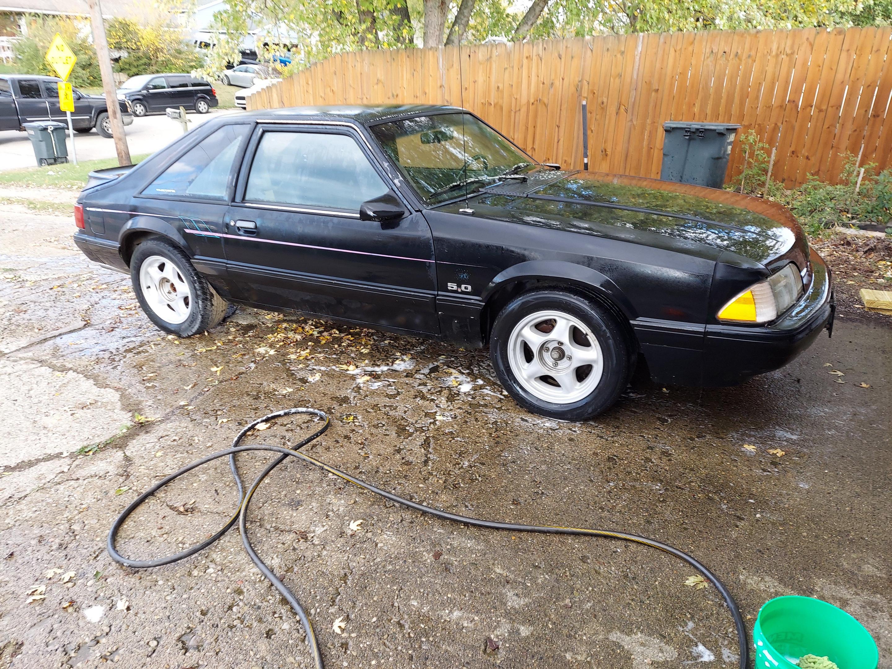

     Also helped my Buddy get a '93 Mustang GT running and moving after 13 years. Cleaned up decent. Next will be brakes and tires. 36,611 Original miles. The sun has taken it's toll on the paint but the interior is IMMACULATE. Still had a Conway Twitty Cassette in the radio. Only had to replace the starter solenoid and put fresh gas in it to get it started.
