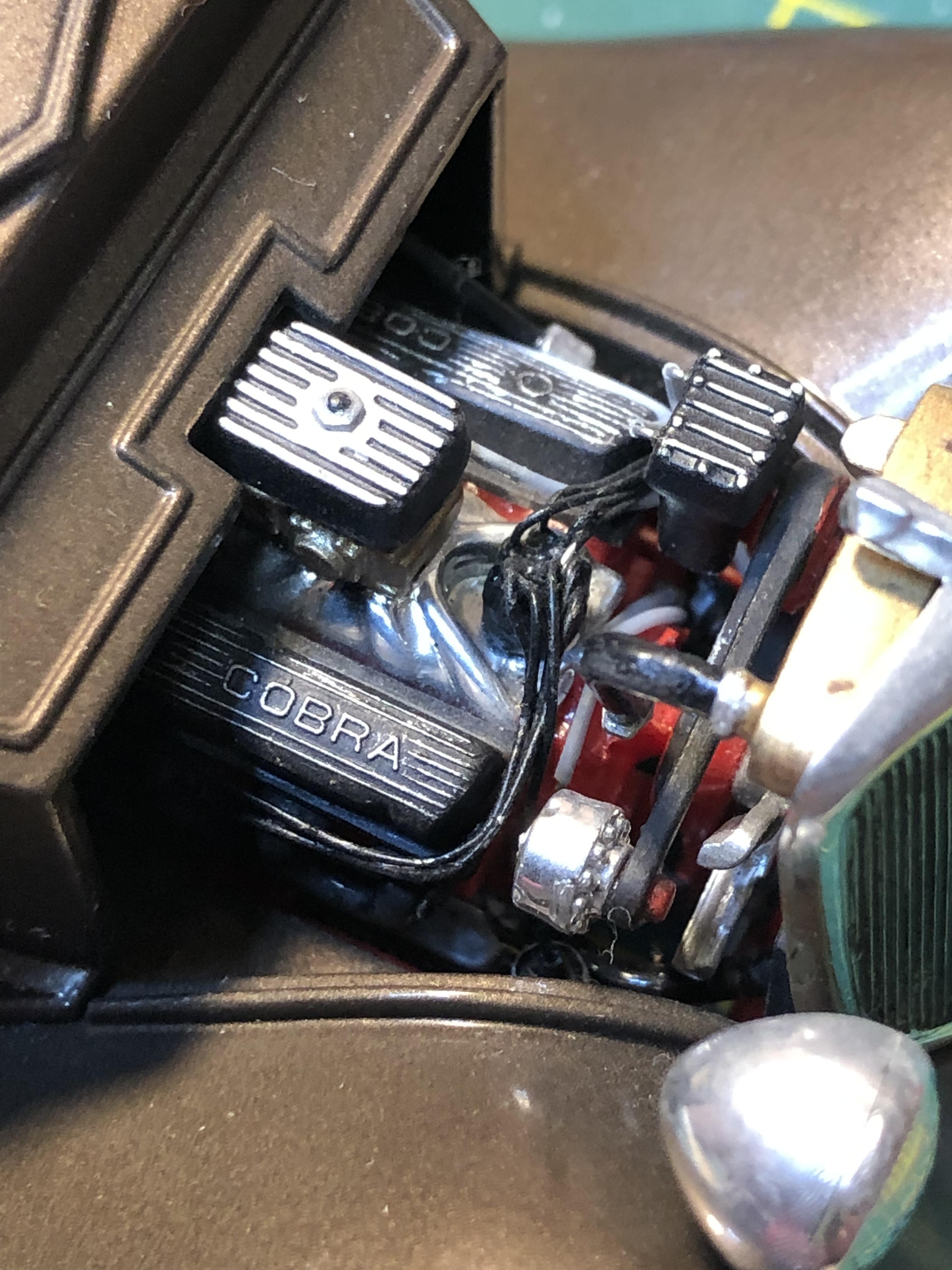

tim boyd Posted March 24, 2021 Share Posted March 24, 2021 Kit.....the triangular shaped "Lynx" air cleaners were also my first choice....good to know Dennis agrees as well.....I wanted one of those for my '70's tribute 1929 A Stake model but wasn't able to find a set that I thought looked good enough....the best ones I remember being in the old AMT/Lesney 1969 Cougar XR=7 Street Machine kit of about 1979....but I already used those on another model. Yours look familiar but I can't place them....do you recall where you got them? Also like your choice of headers and distributor....that M&D Hayes T-Bird kit was a terrific model when it came out around 1990, and remains a great choice for kitbashing even today, in my opinion. Excellent progress and thanks for sharing your updates....TIM : Quote Link to comment Share on other sites More sharing options...
Spex84 Posted March 24, 2021 Share Posted March 24, 2021 Cool stuff! Those "mystery carbs" seem to look a lot like AMT parts pack Carter WCFBs, but those are part number 118. Maybe a Corvette or 50s Mopar kit? Quote Link to comment Share on other sites More sharing options...

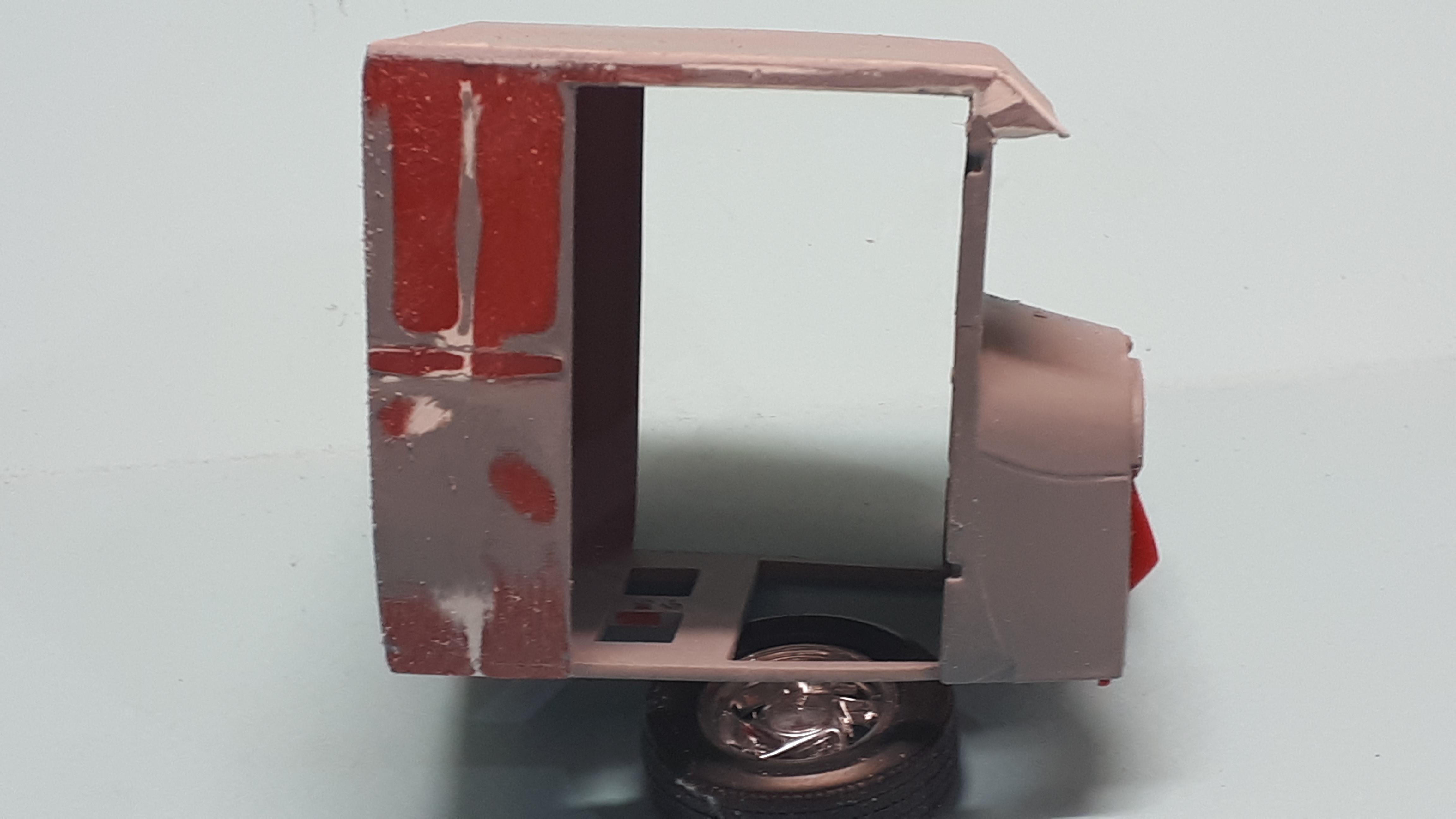

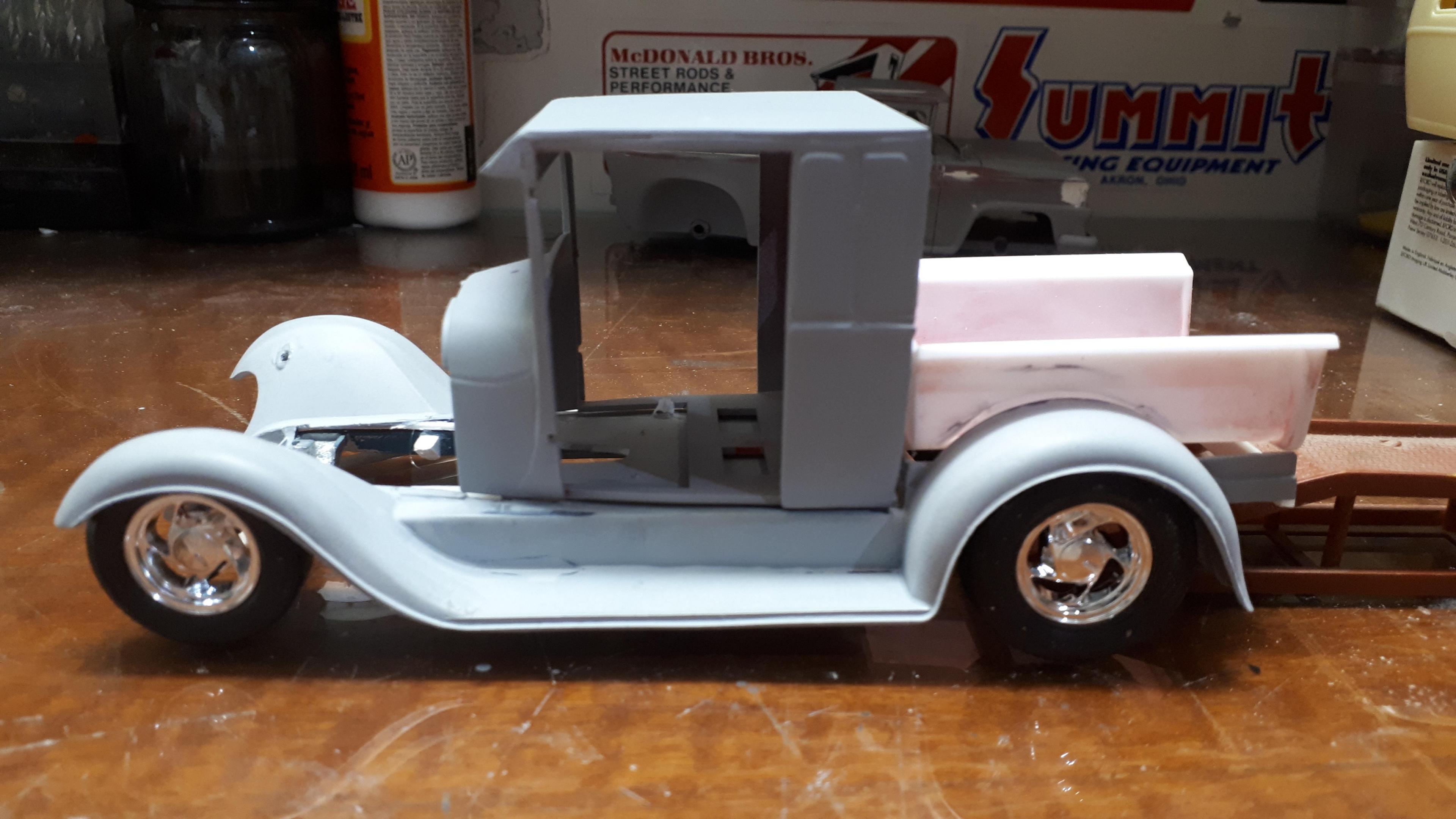

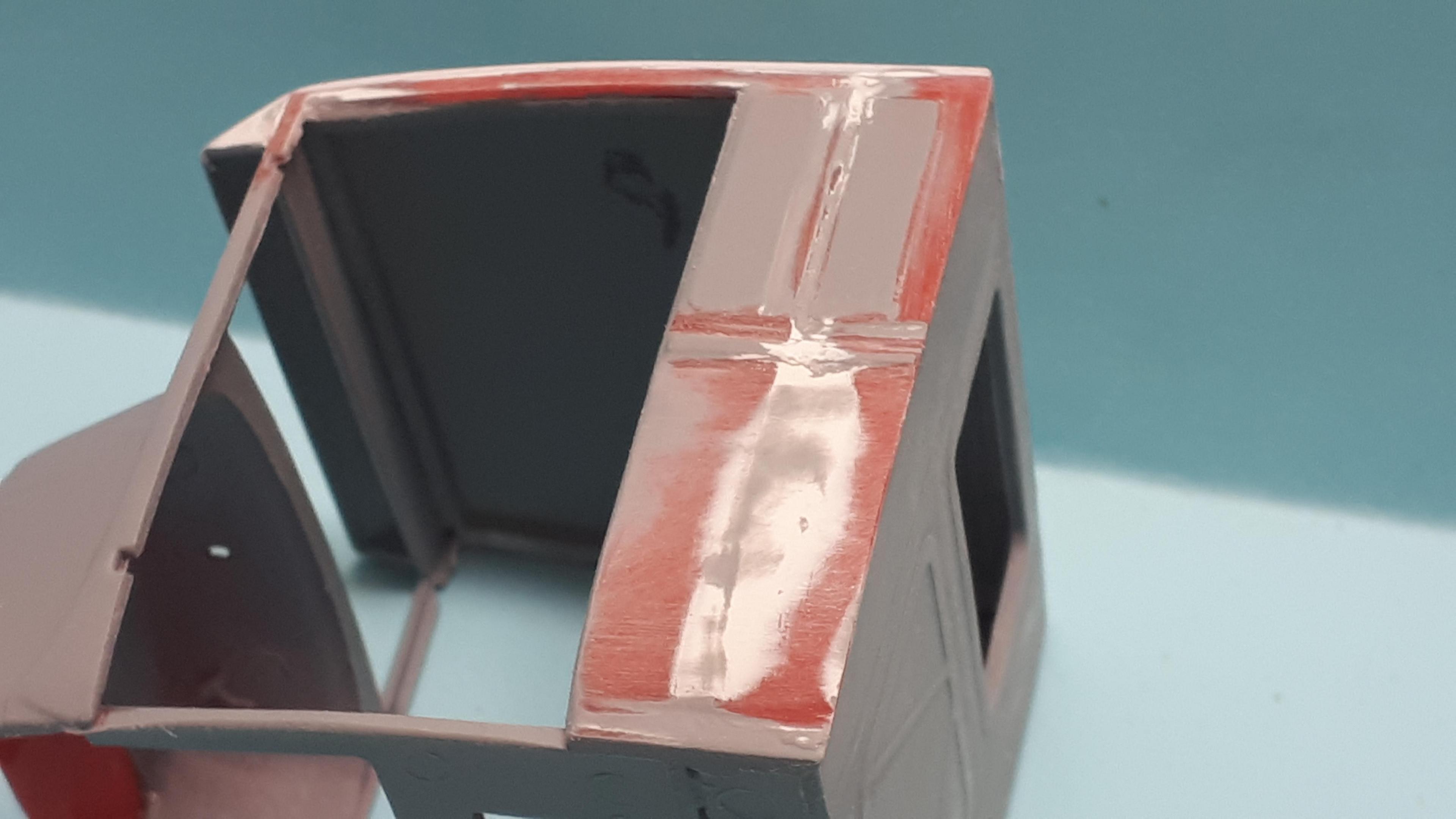

alan barton Posted March 28, 2021 Share Posted March 28, 2021 (edited) Only a small update but I have been pre-occupied with some other projects over the last few weeks. After some basic bodywork, I got the first coat of primer on but I don't think i like the two panels in the rear pillar. The loo is a bit odd and it will be a mongrel to clean up so I am thinking of filing it flat and replacing it with one new raised panel. Meanwhile, a test fit of the shortened version of the pickup bed from the Hot Rod magazine version revealed that it was a very tight fit between the Bandai rear fenders, enough to to spread them at a weird angle. I traced the outline of the fender onto the bed sides and then used a sharp blade to scrape away a recess which is letting it sit a lot nicer. Still need some fine tuning on those rear rails, however, they may get replaced yet by something more h0-tech and smoothie in style. Edited March 28, 2021 by alan barton Quote Link to comment Share on other sites More sharing options...

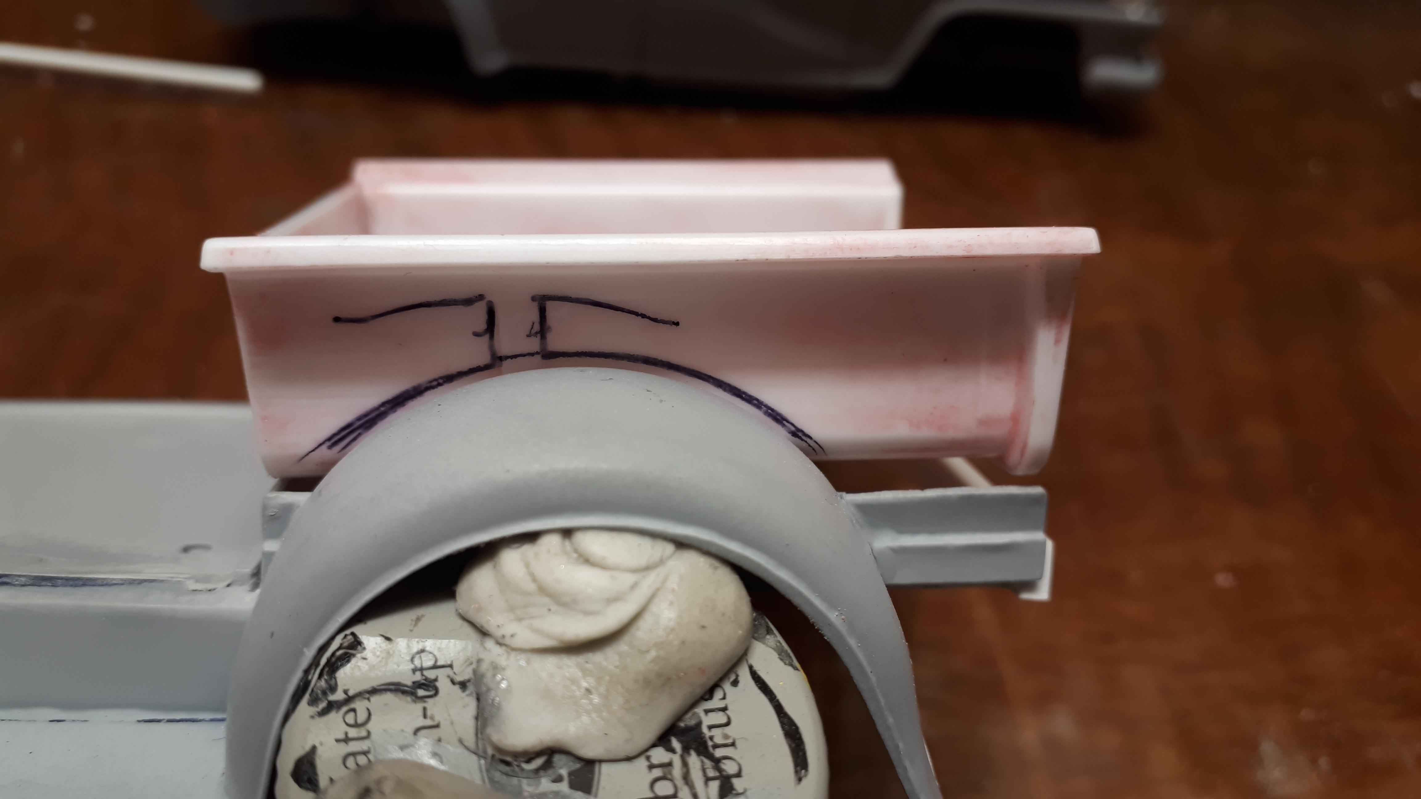

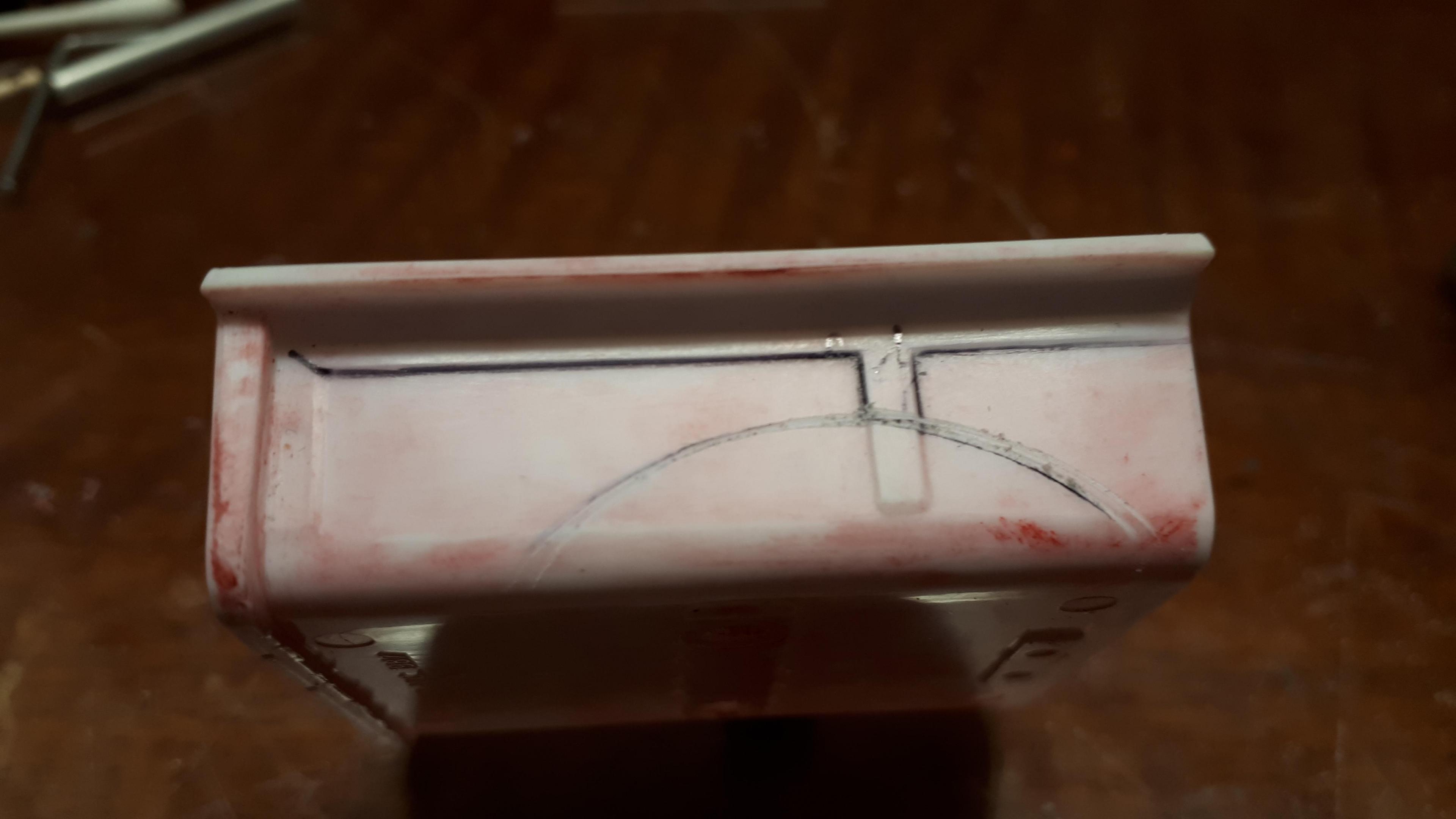

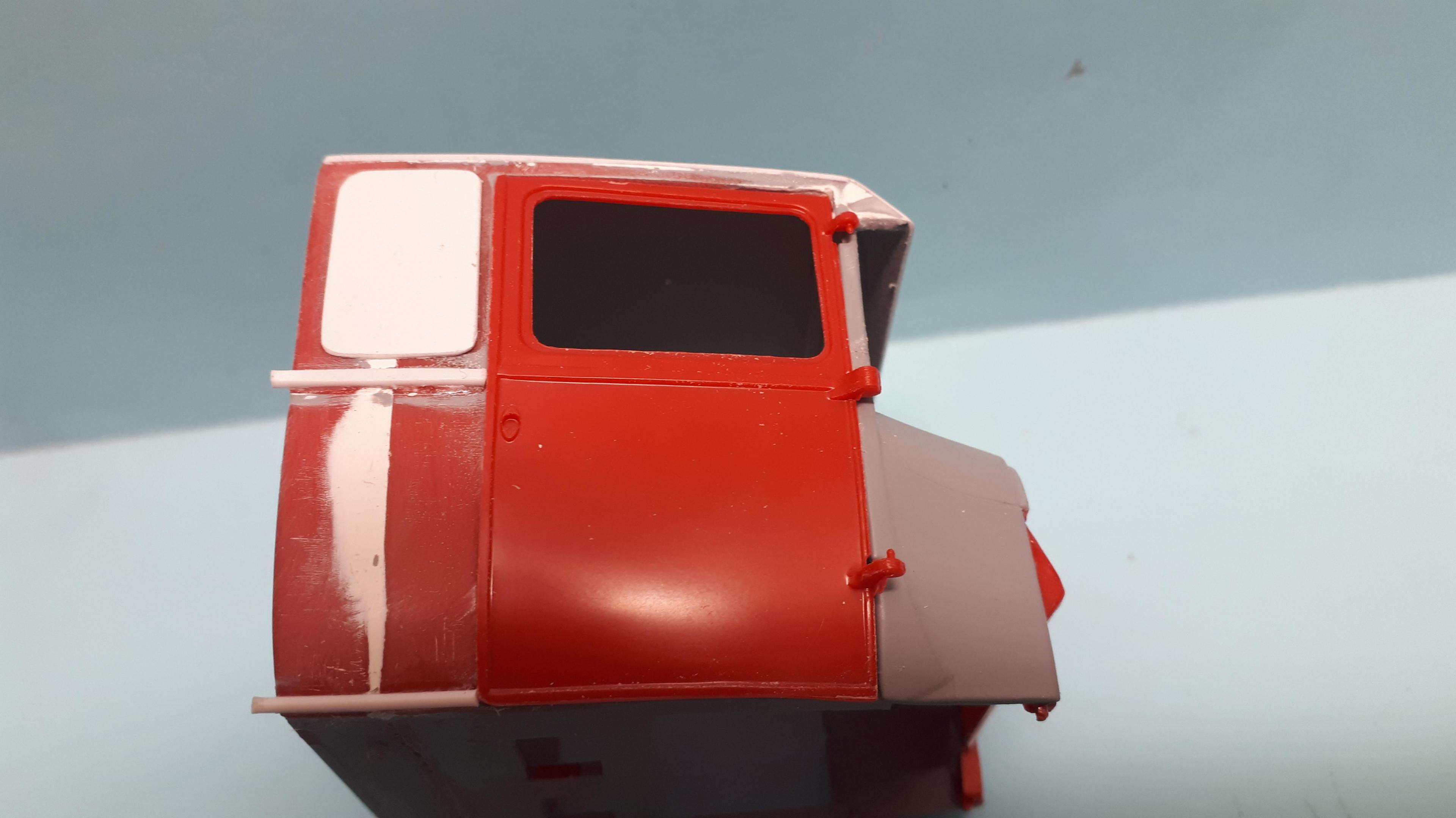

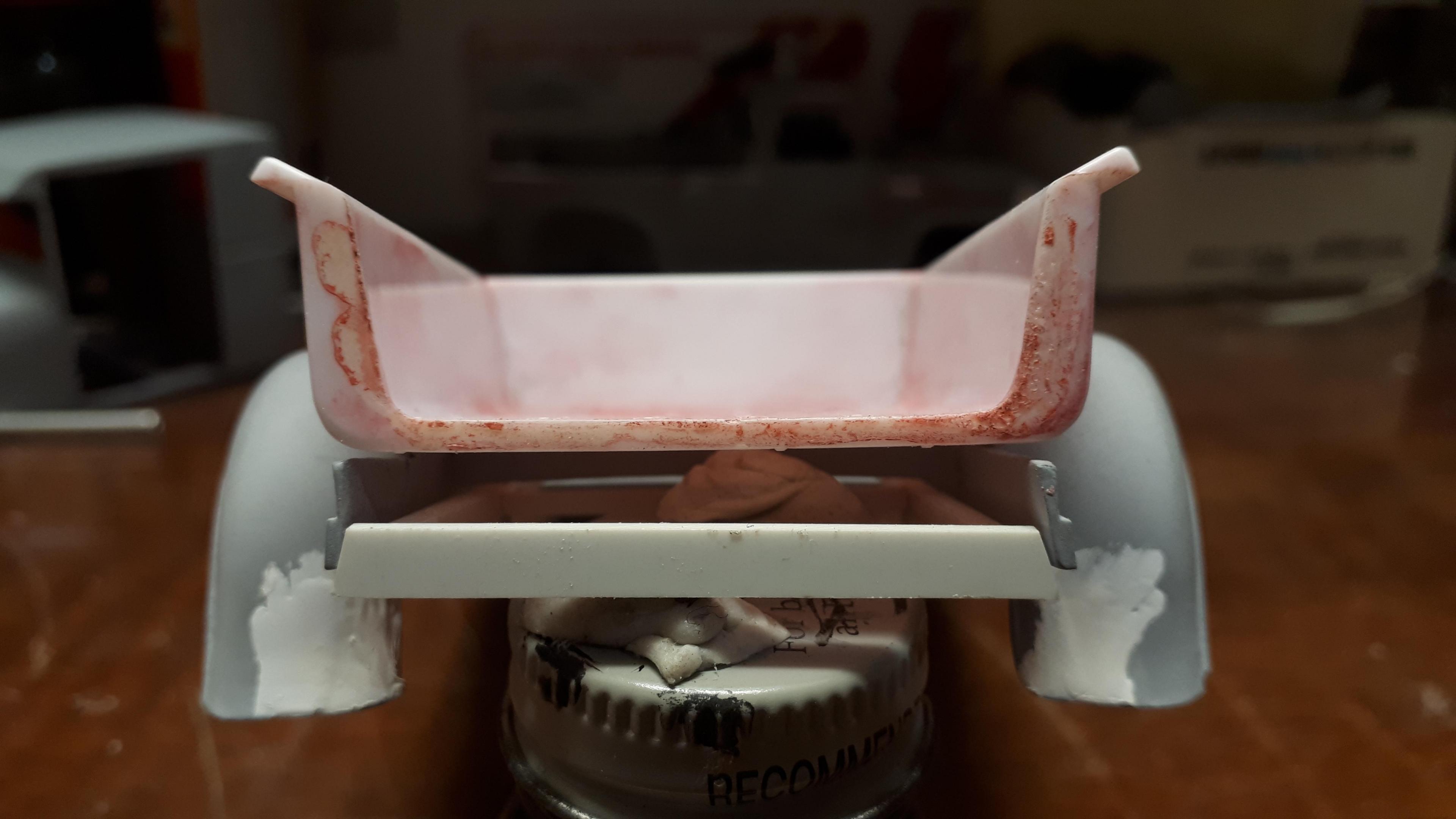

alan barton Posted April 12, 2021 Share Posted April 12, 2021 Still no earth shattering movement but the bodywork is getting closer! Surprisingly, none of the brains trust here noticed my earlier gaff - turns out that shortened smoothie bed up the top is not from a Hot Rod series Revell Model A, but from the Monogram T bucket trailer - I couldn't work out what the odd mounting brackets underneath were all about! Turns out they are the axle and towbar mounts. It is also about 5mm shorter than the stock bed which suits this build perfectly. A happy accident! I seem to be bogged down with a lot of heavy bodywork lately and my efforts to refine the swage lines on this cab were not going well so last night I threw caution to the wind and filed everything off and started again. It will need primer to tell me if it was worth it but so far so good. The roof and the sunvisor were scratchbuilt from flat styrene and the swage lines are down with Evergreen. If I can get the bodywork finished by this weekend I can get back into fabricating the mounts for the Jag rear end and generally tidying up the chassis. Cheers Alan Quote Link to comment Share on other sites More sharing options...

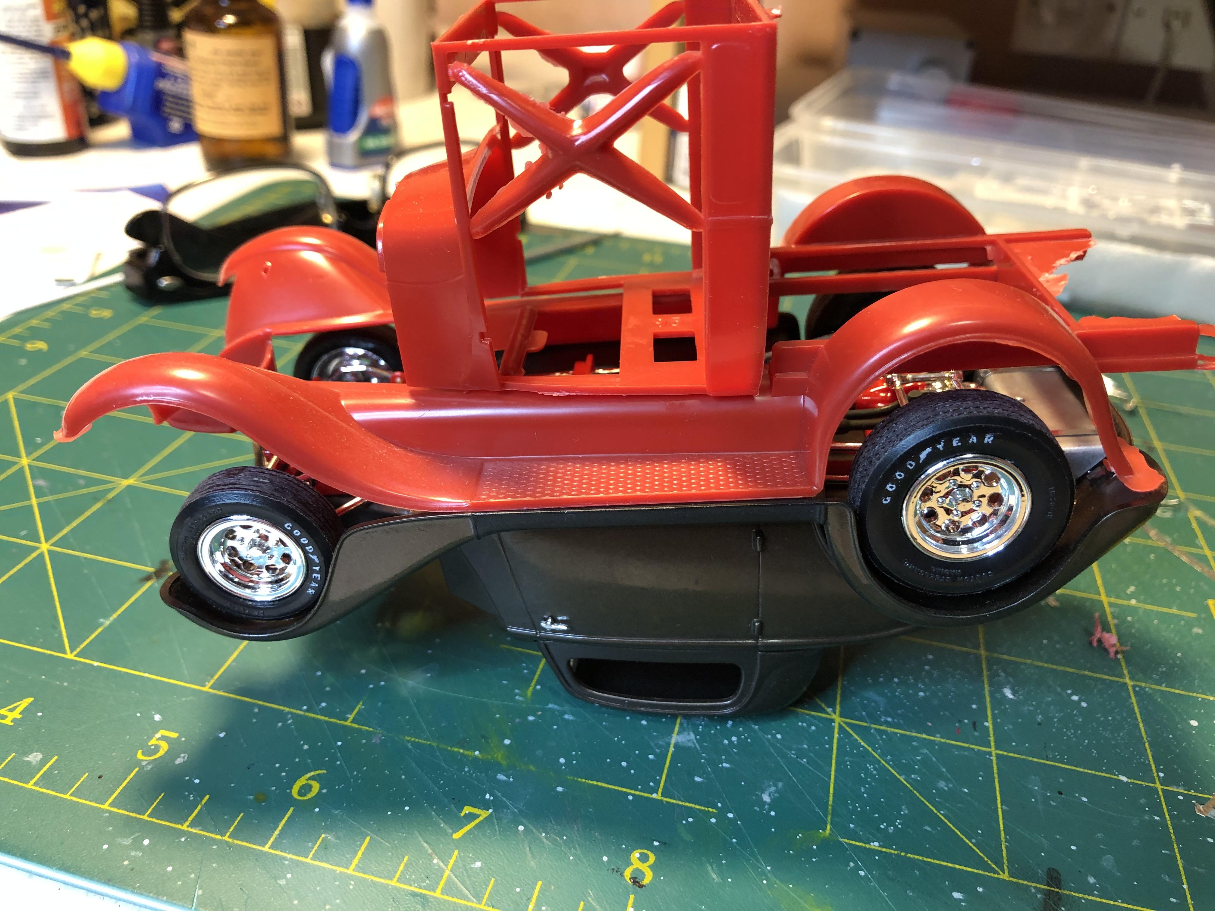

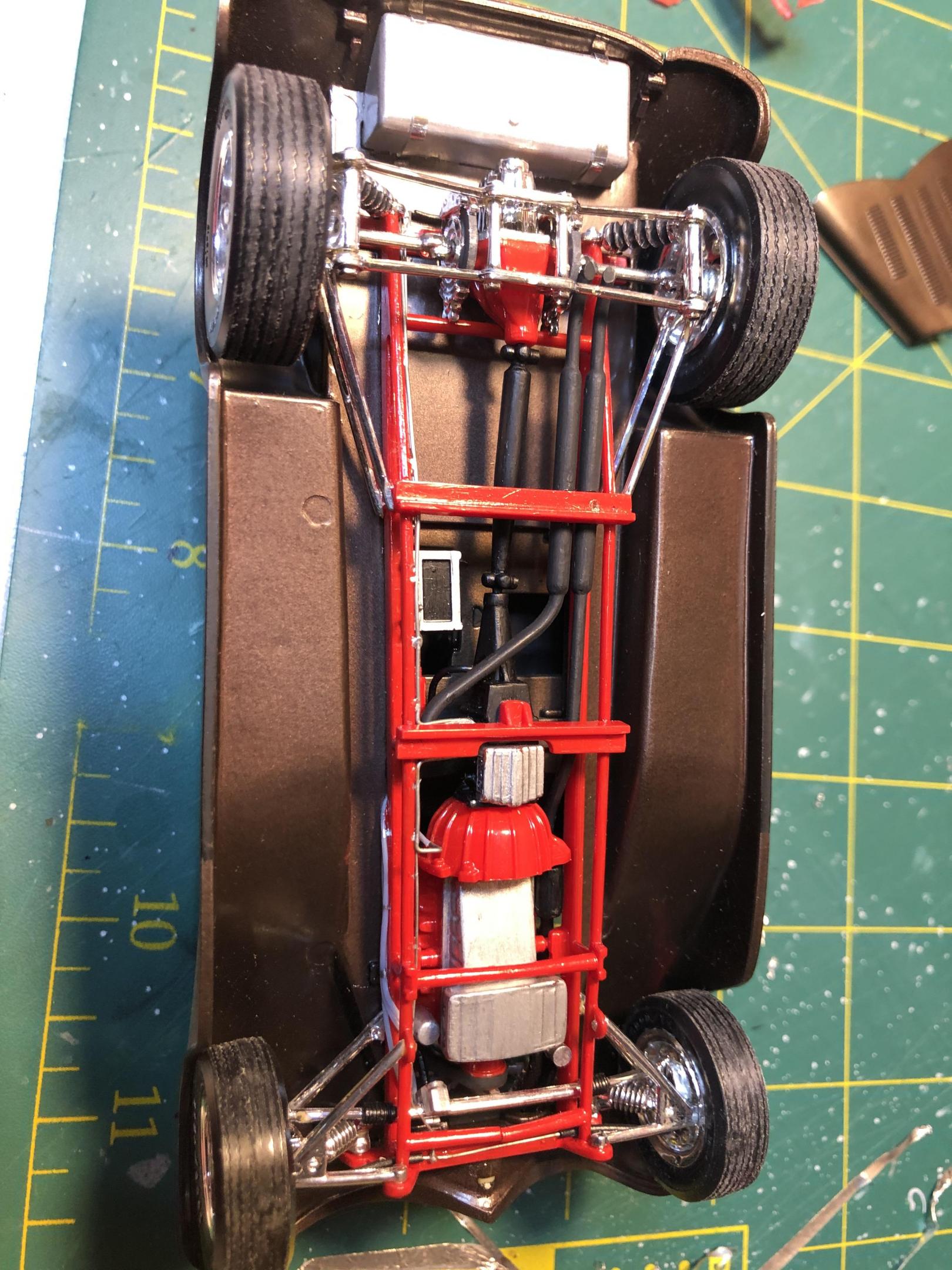

BullysCustomModelParts Posted April 14, 2021 Share Posted April 14, 2021 I pulled my body out the other day to get a start on it and it fell apart in my hands, so after two nights of gluing and sanding I finally got a start on the actual build. the first thing I wanted to do was put in the independent front end out of the AMT 34 coupe kit. with a bit of cutting the front end went in without a problem. I was going to use the vette IRS from the same kit but after searching through my wheel box and finding a set of autodrag wheels and fat radial tires, I decided to tub it and go down the pro street path with a twin carb sbc and a 9inch rear. Quote Link to comment Share on other sites More sharing options...
Dennis Lacy Posted April 14, 2021 Author Share Posted April 14, 2021 @BullysCustomModelParts Pro Street, I freaking love it! I also love the use of the Auto Drag wheels. They were such a staple of the 80’s, people put them on everything. Are you going to fill in the fenders around the upper A arms? I’ve actually seen that done a few times in the full scale world when people would fit Pinto front suspension into an early car. Quote Link to comment Share on other sites More sharing options...
