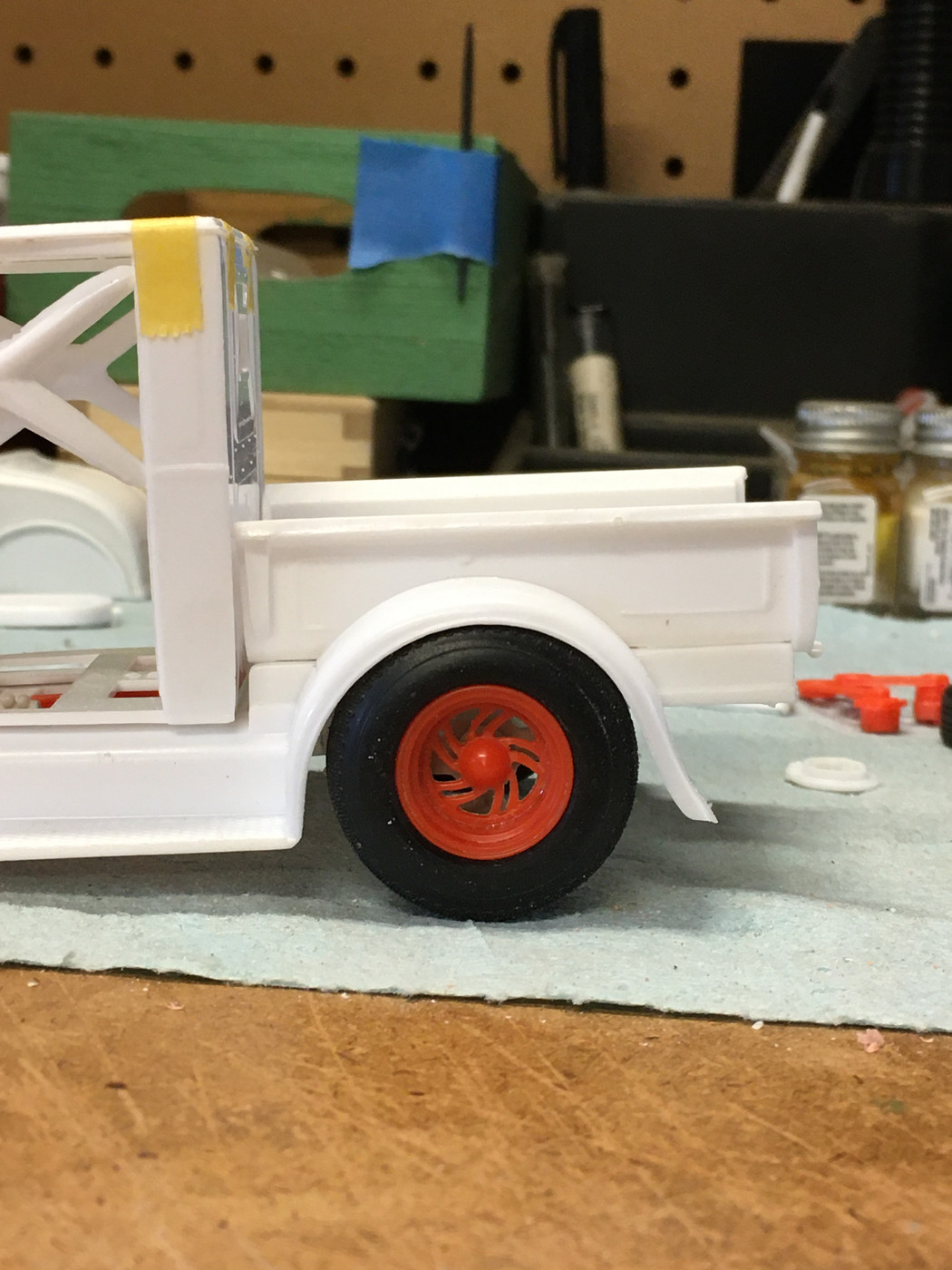

I've been thinking about my response to Tim (just above) all day since I wrote and posted it. In particular my comments about the wheels. I really do want this truck to be recognizable to anyone who remembers his old How-To so tonight I decided to mock the truck back up using the same wheels that Tim used, the Boyd Coddington wheels from Monogram's original release of their 1937 Ford Sedan. As it turns out I already had this set stripped and fit to these tires complete with inner rim halves (from a previous project that I abandoned.) The rear tires are identical to what I was already using and the fronts are the little Dunlop's from Revell's 1932 HiBoy Roadster. The front tires had to be trimmed out to fit these wheels.
I was also able to get the radiator and shell to stay together (thanks to flash on the radiator making them a tight interference fit) and stand up and pop a set of headlights on. After seeing this mock up I'm 100% convinced to go this route. I'll save the first set of wheels and tires for something else. I always envisioned this project using the Coddington wheels so I don't know why I set out with something else...
And for S&G's, how about the view of that fancy Corvette IRS hanging out back!
That's all for now. Let me know what you think of the wheel change. ?

Loved the old wheels but the new ones look perfect too.

My bad. I don't know why I had '36 on the brain. One suggestion for the current wheels: cut the center loose from the rim, narrow it and glue it back to the center to give it less offset.

Got to spend some time at the bench today. First order of business was to finish building the frame center "X" using pieces cut down from Monogram's '37 Ford Sedan just like Tim did. On the rear sections it was necessary to pie cut and taper them where they join with the side rails. When Tim set up his I believe he added material to the frame rails to make them as tall as the rear “X” pieces so he didn’t have to modify them.
And with the engine and trans in place...
Next I needed to adapt the rear wheels to the IRS. I found that the wire wheels from the Monogram Slingster dragster were a perfect fit onto the axle stubs so I cut their hubs out to creat sleeves, drilled the holes in the back of the wheels to a little bigger diameter and glued the sleeves in. I'm also going to use the disc brakes found in all of the Revell '32 kits and they are a perfect fit as-is.
Here are the wheels and tires fit to the fenders. Thankfully my planning worked out and the truck still sits slammed like it did when the fenders were just laying over the tires.
And just for fun I propped the chassis up onto all 4. The front axle is fit to the frame but the wheels are not adapted yet. They're just precariously stuck on the spindle stubs.
