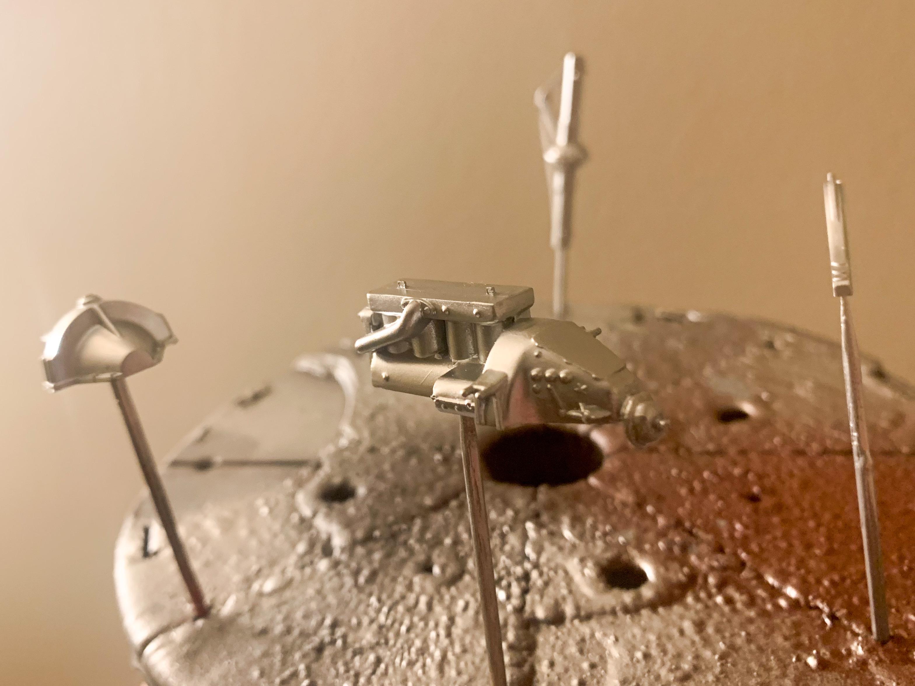

Bugatti Fan Posted September 29, 2020 Share Posted September 29, 2020 (edited) Don't bother with BMF. After priming spray the entire body with a craft chrome aerosol spray and leave it to dry thoroughly. This will be a hell of a lot easier than trying to get BMF to go around any compound curves. When dry buff it up gently with C1 Polishing Powder until the desired finish is obtained. Have a look in 'Can I see some scratch built things' in the WIP Model cars column and have a look at the pictures of my Napier Railton that was finished by this method, If this is the sort of finish you are looking for it worked OK for me. Hope this helps. Edited September 29, 2020 by Bugatti Fan Quote Link to comment Share on other sites More sharing options...

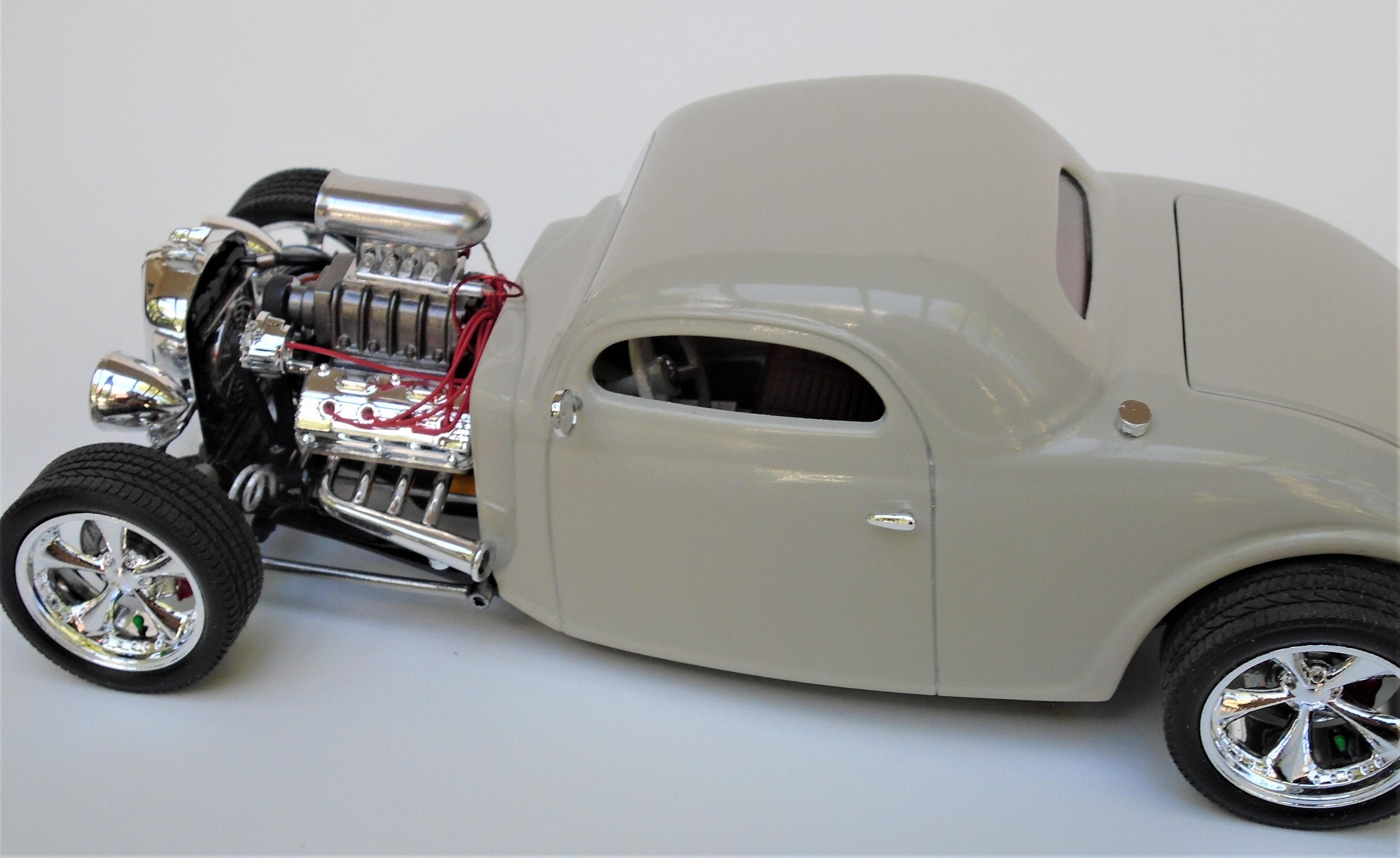

Claude Thibodeau Posted September 30, 2020 Share Posted September 30, 2020 Hi! For what it is worth, the bugcatcher scoop on this coupe was "plated" with Chrome spray paint from Michael's. Not as chrome as Alclad chrome, more like polished aluminium. CT Quote Link to comment Share on other sites More sharing options...
gman Posted October 1, 2020 Share Posted October 1, 2020 That is an impressive, reflective finish on your scoop. I like it. Link to the paint you used? Quote Link to comment Share on other sites More sharing options...
