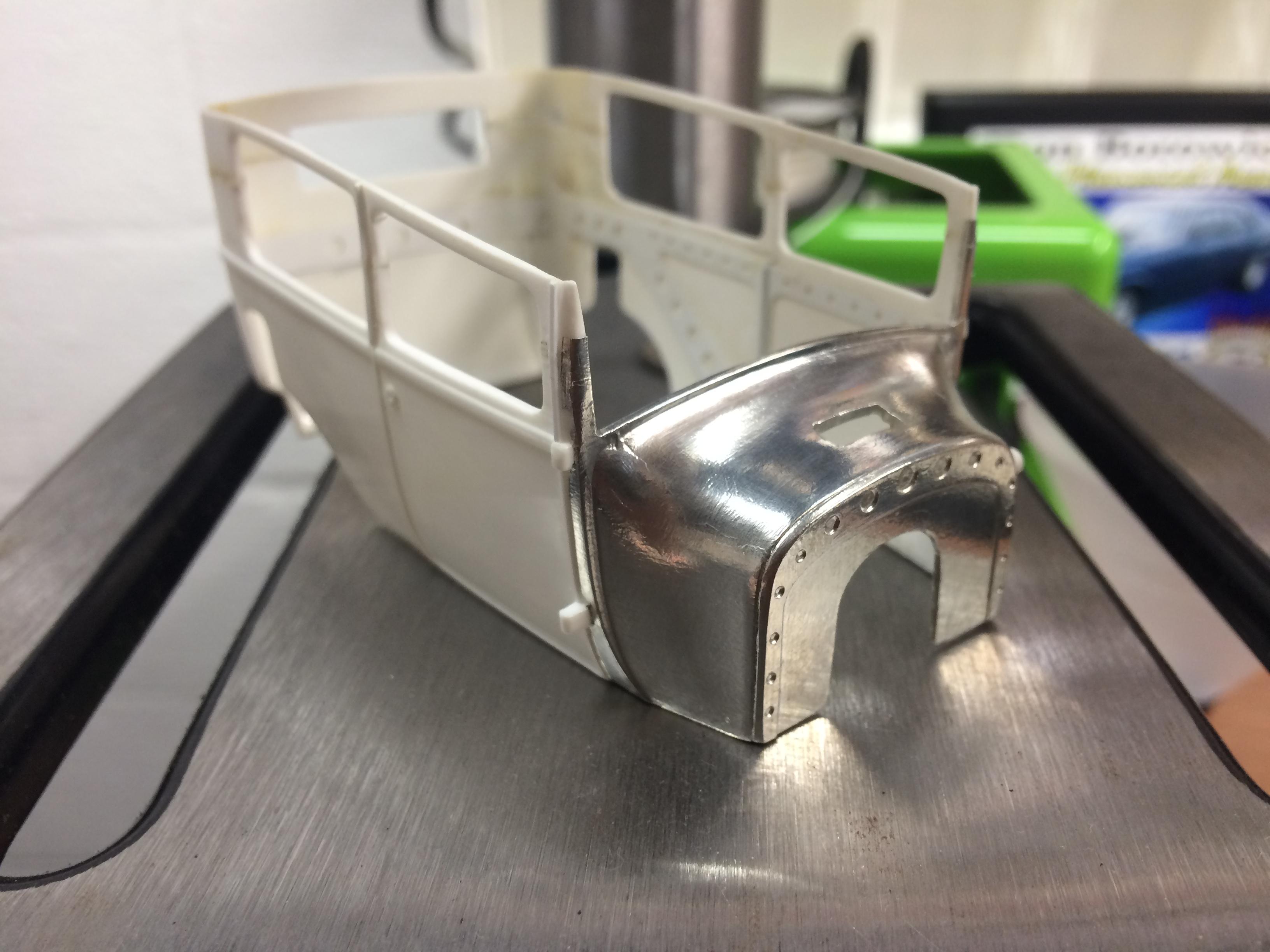

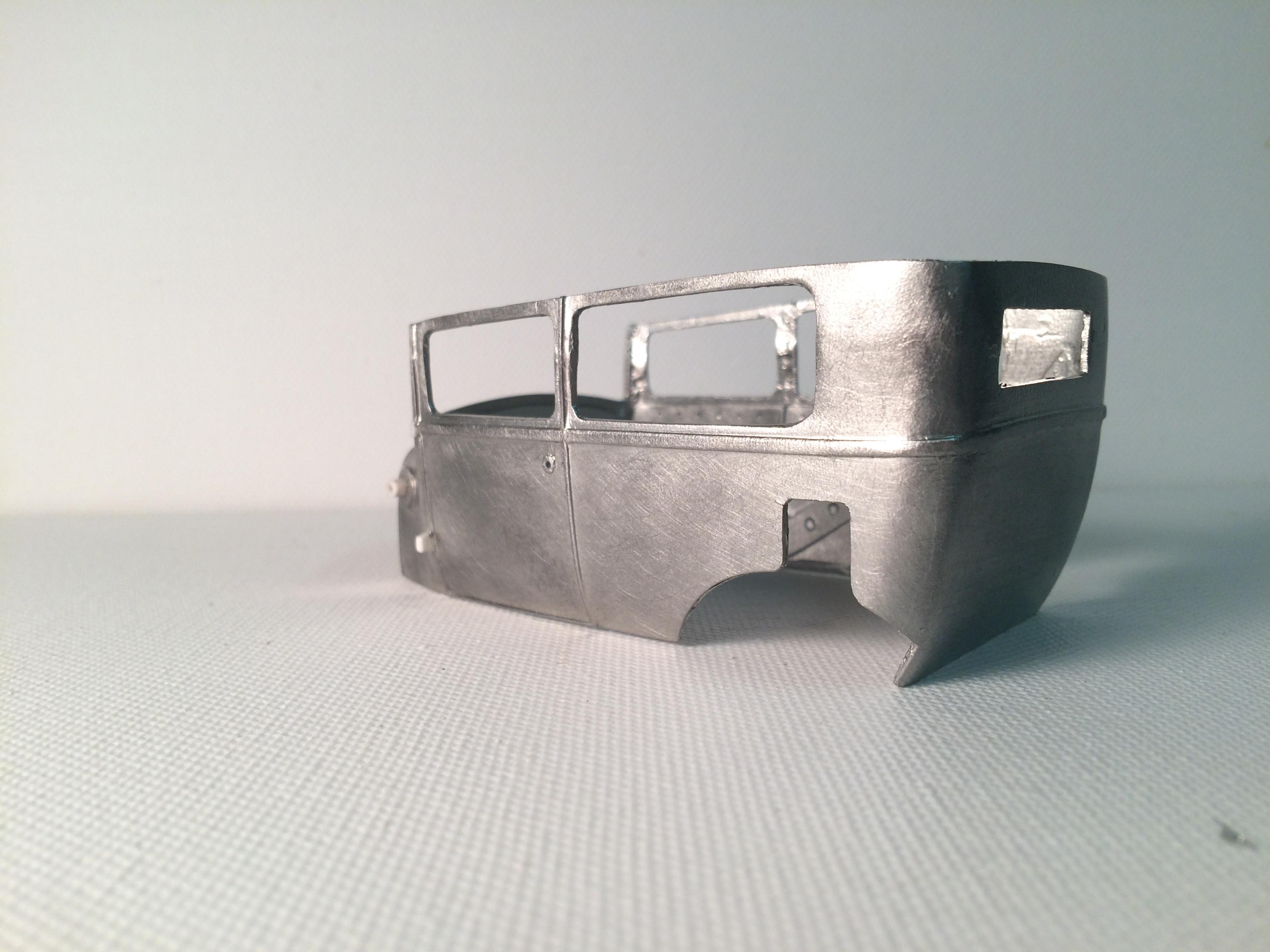

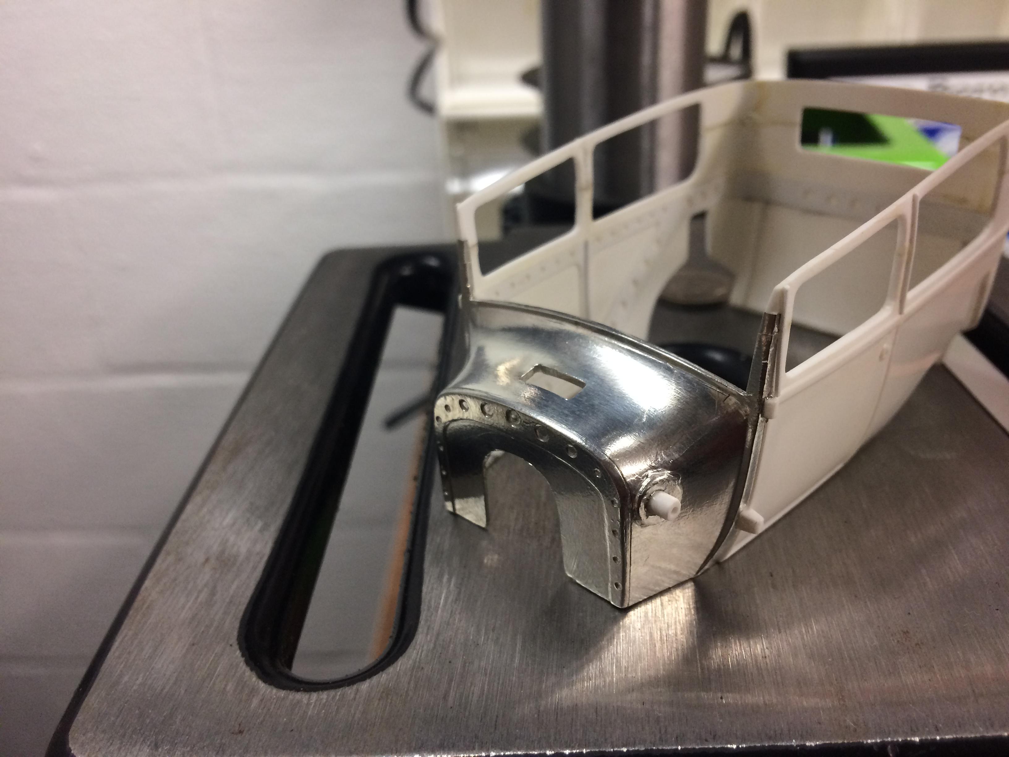

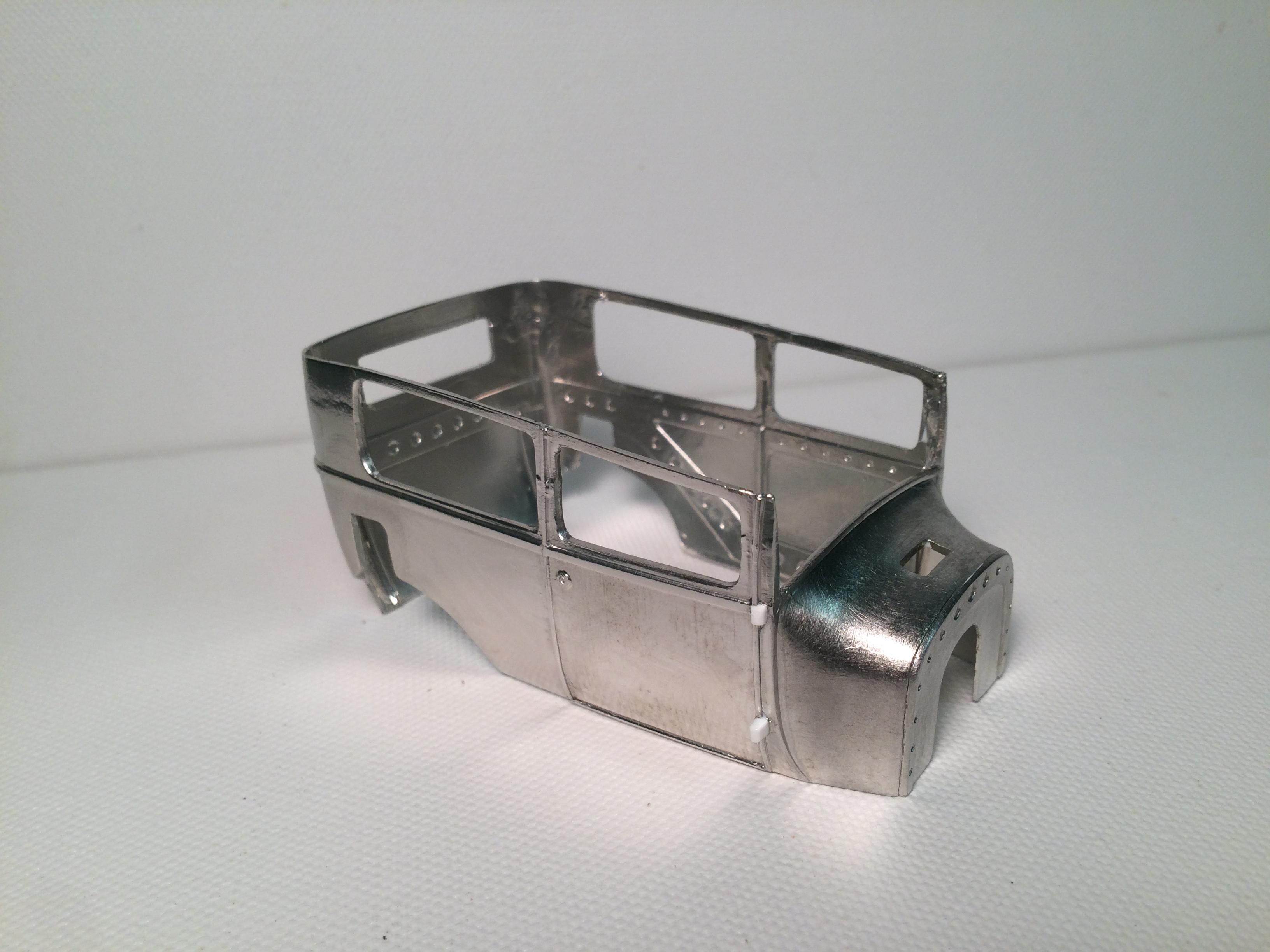

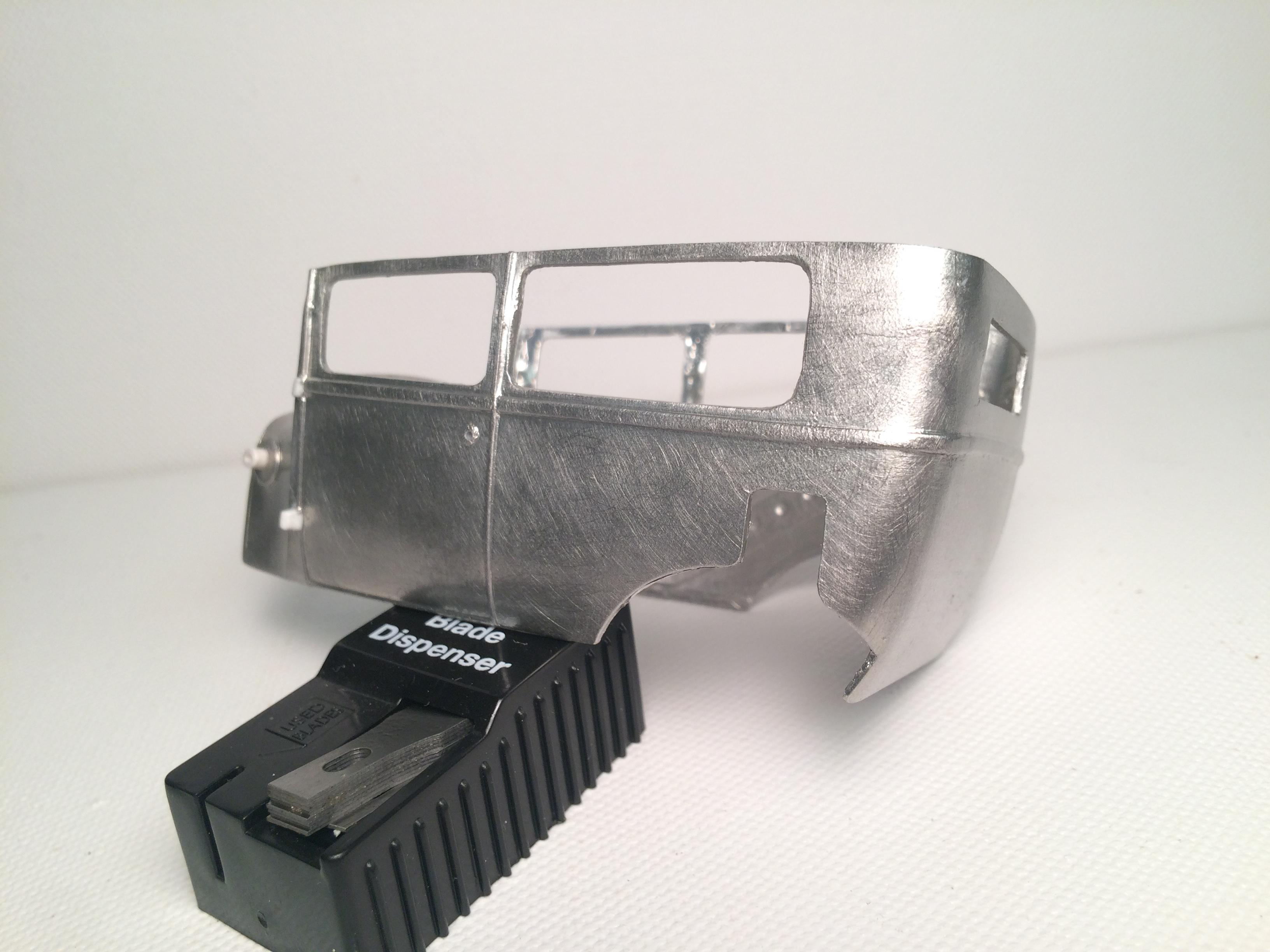

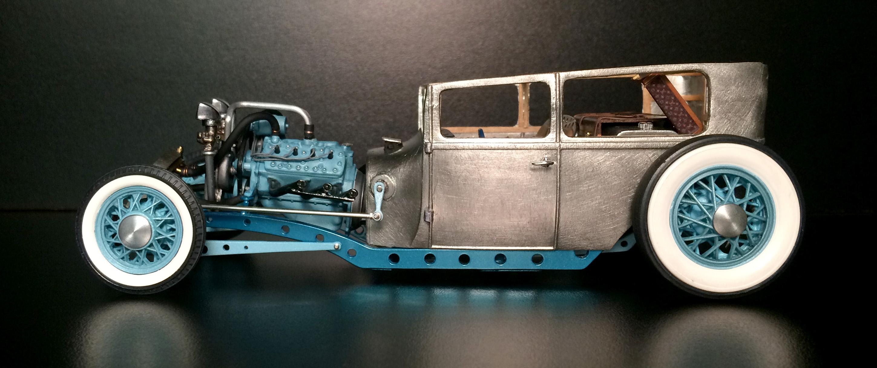

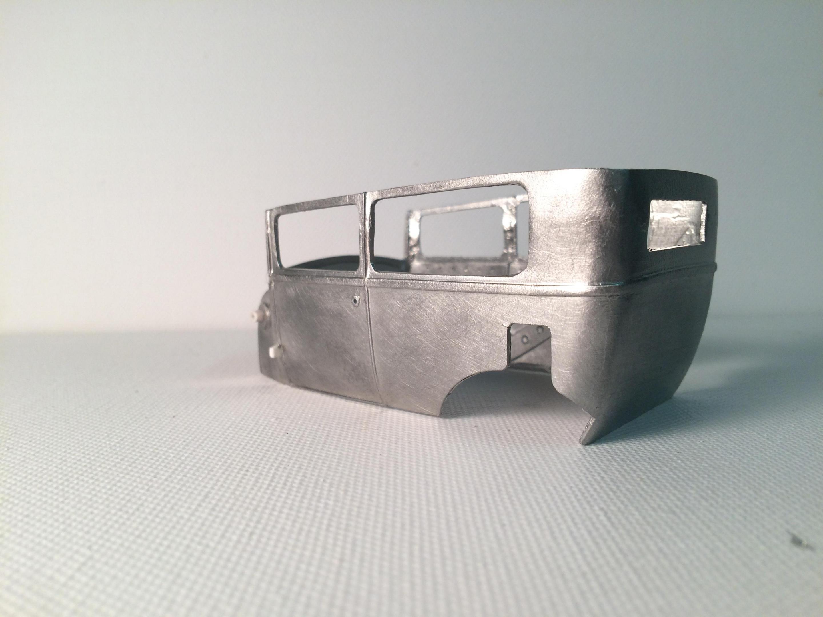

This is bare metal foil applied inside and out of a model T.... once applied i scuffed lightly with a scotch brite pad, and used krylon matte finish on it.
The best tip I have, and I read it from someone on here, is to rip your seams at the corners, instead of a clean knife cut... the ripped irregular edges don't catch the eye as much.
It actually wasnt "that bad"  once I got going..  Go directly to the unpainted plastic and use the door and body lines to break it up the BMF into smaller more manageable pieces.

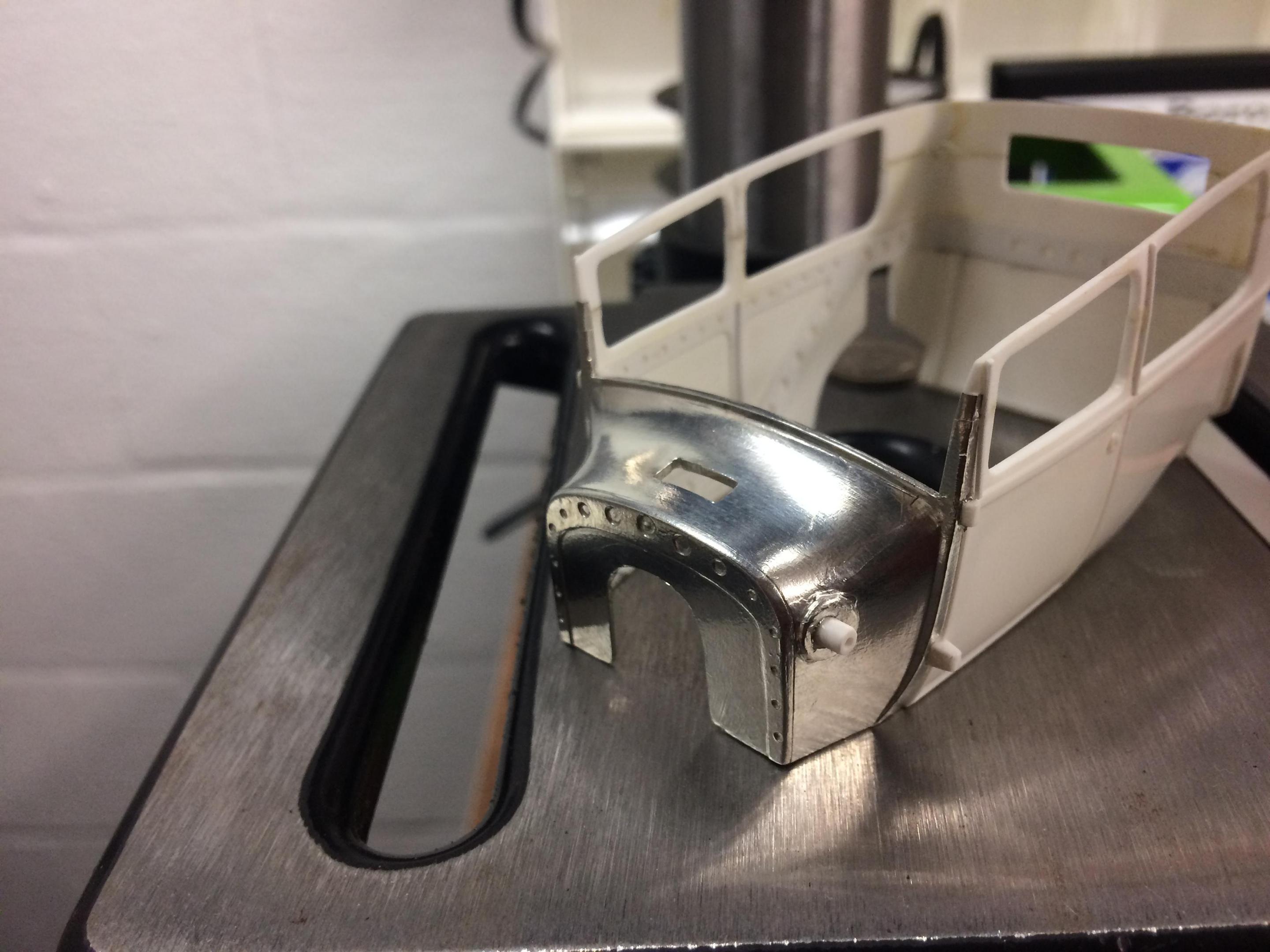

Thanks guys!  I actually just found some in progress pics... you can see on the cowl where I did the ripped seam thing...
Cowl Before Scotchbrite

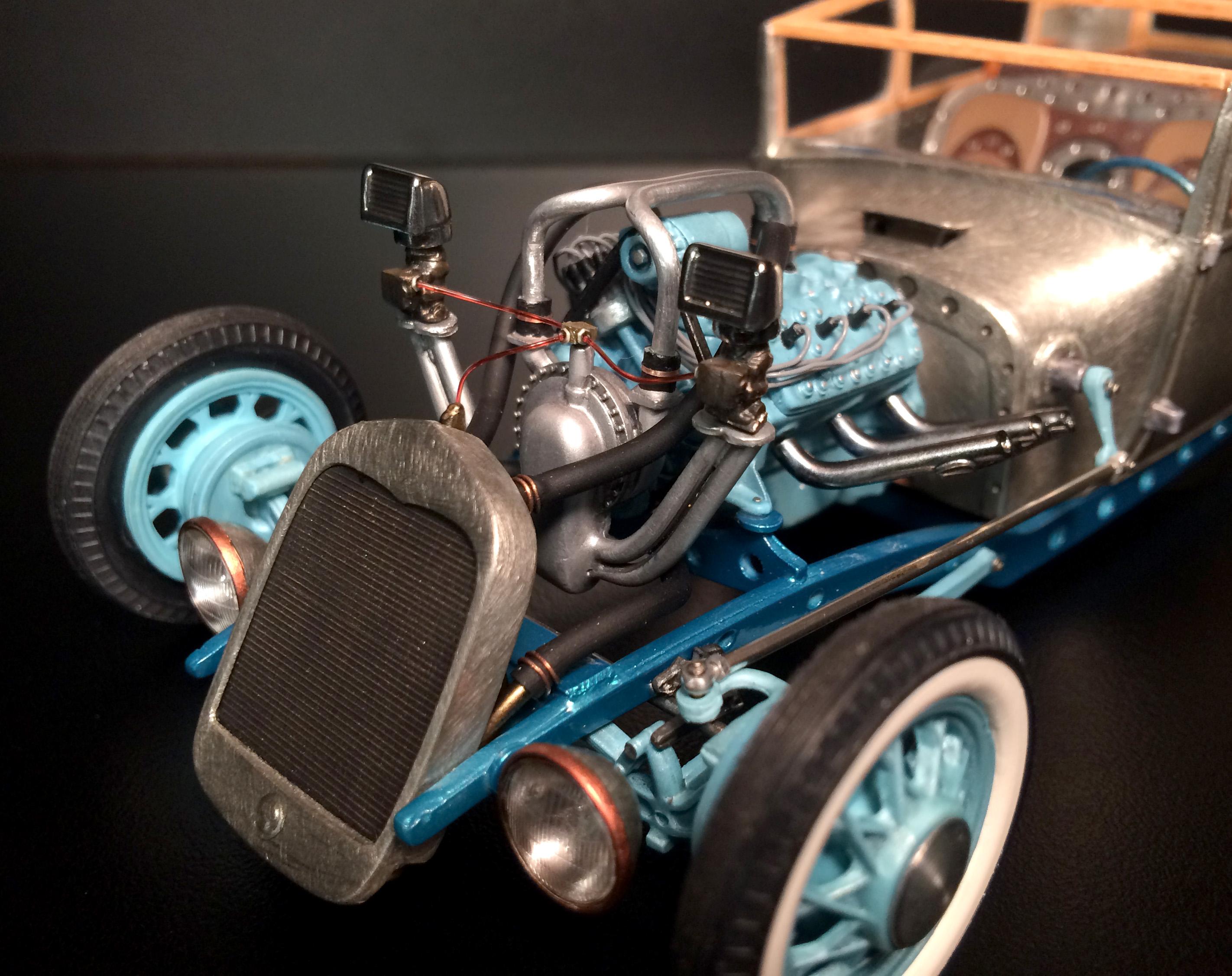

On 10/5/2020 at 2:37 PM, Impalow said:
Thanks for the mention @CabDriver
Hi Eric!
This rod is world class, as all your cars I should say. Bravo!
The bare-metal treatment is outstanding, but what gets me is the Louis Vuiton "luggage" in the back. My wife loves it! She actually wants it...
