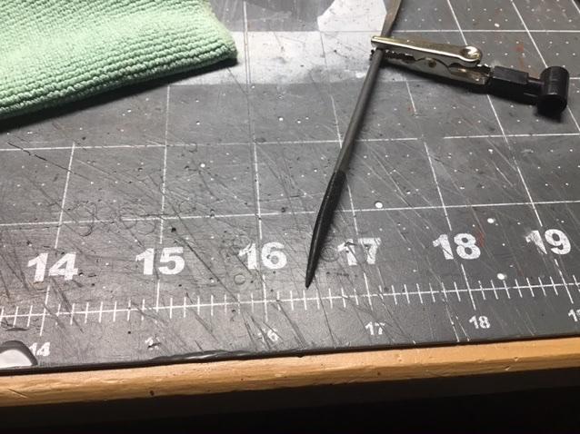

Well it’s coming along nicely, definitely not my best work but surely not my worst. Little more detail work on the scribing and I should be in pretty good shape
