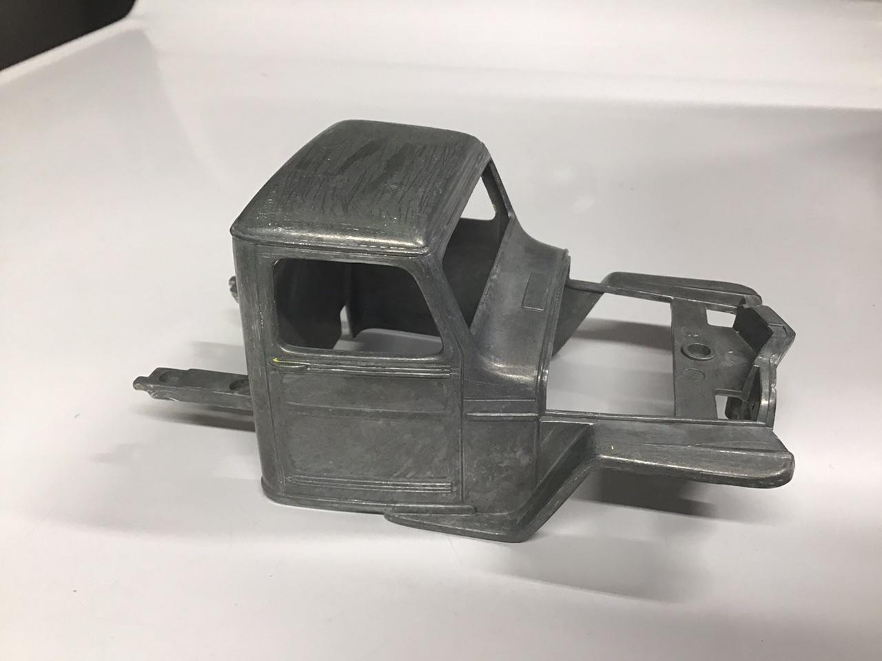

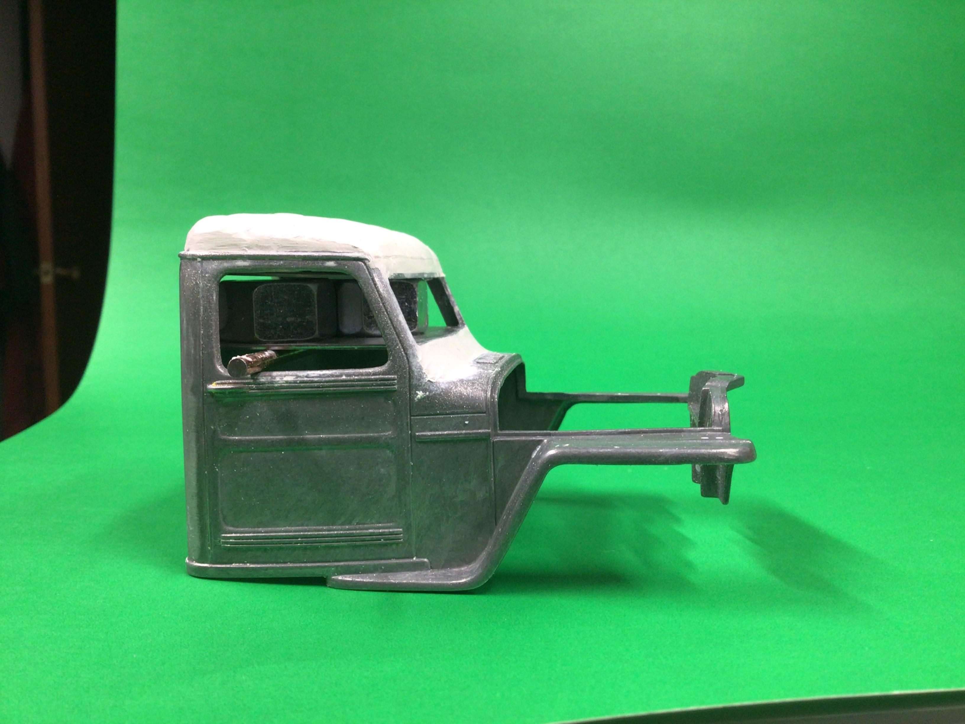

NOBLNG Posted October 6, 2020 Share Posted October 6, 2020 What is the best way to re-shape a body. This Willys pickup has a completely flat windshield. It should have a peak in the center. Will regular solder work? What kind of flux is needed. I saw this stuff on the net and it looks like it may be the ticket if normal solder won’t work. Anyone have any experience with it? Thanks in advance for any insights. Greg https://www.muggyweld.com/product/super-alloy-1/ Quote Link to comment Share on other sites More sharing options...
Snake45 Posted October 6, 2020 Share Posted October 6, 2020 You'd probably be better off with an epoxy such as J-B Weld. Personally, I don't think I'd bother with possibly complicated bodywork over a change of that nature. I think I'd just live with it. Quote Link to comment Share on other sites More sharing options...

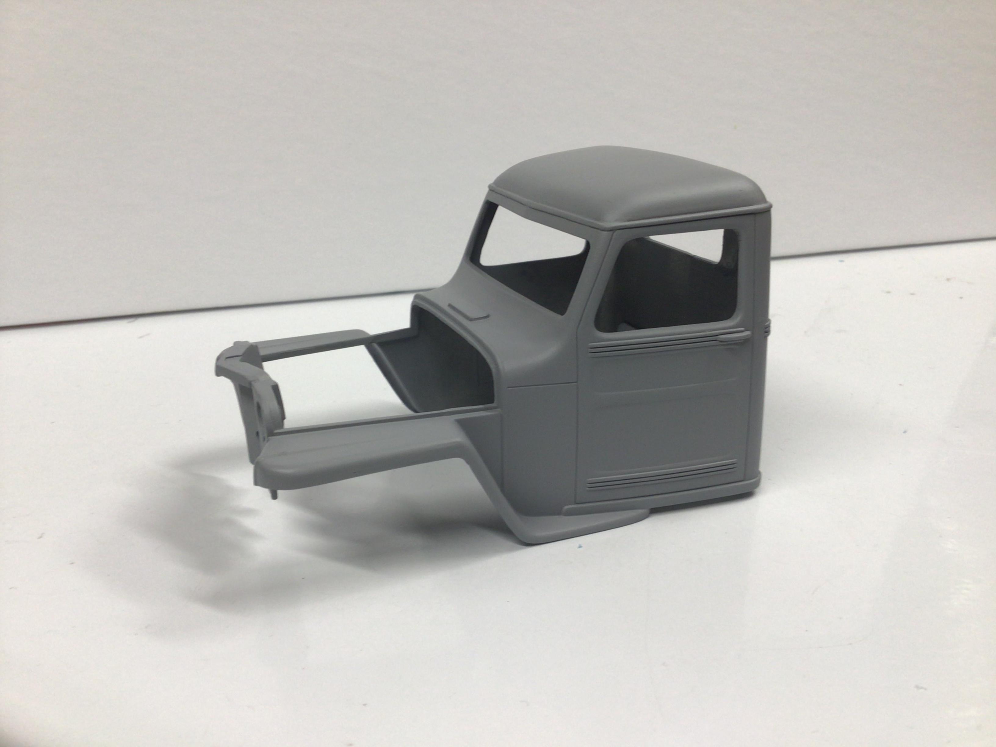

Tom Geiger Posted October 10, 2020 Share Posted October 10, 2020 Here’s the All American resin cab. I know Art mastered this from the Specast sedan delivery before they did the pickup. Judge for yourself, it doesn’t look like he modified the windshield area to me. Quote Link to comment Share on other sites More sharing options...
NOBLNG Posted October 10, 2020 Author Share Posted October 10, 2020 (edited) Thanks Tom. That looks like a really nice casting, but it does look to be a flat windshield too. I think the roof of my die-cast could be lightly coerced out to the proper angle, but the cowl will require some type of filler to build it up. I was hoping for a metal solution, as I am worried about adhesion issues, but that sounds increasingly futile. Edited October 10, 2020 by NOBLNG Quote Link to comment Share on other sites More sharing options...

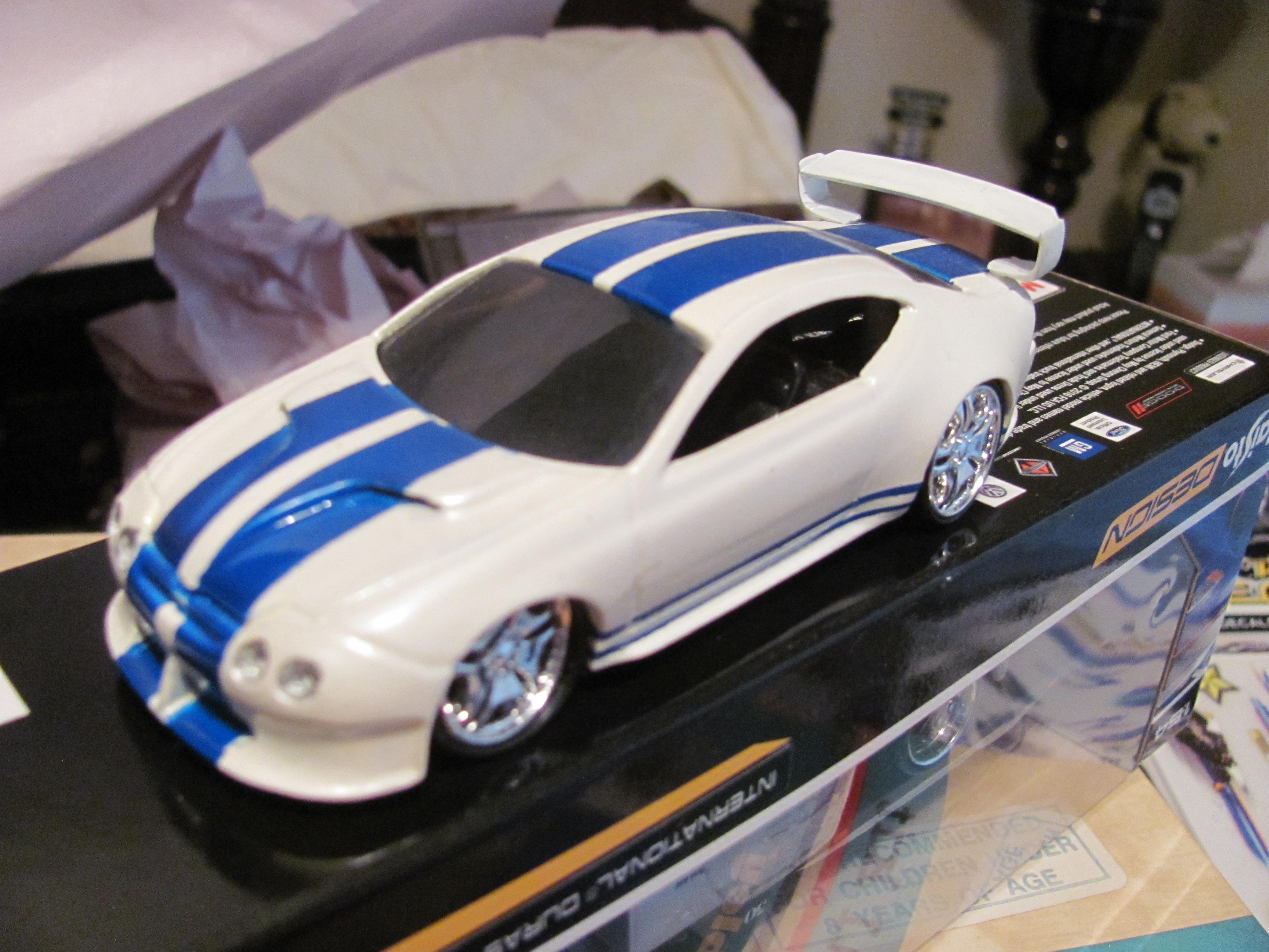

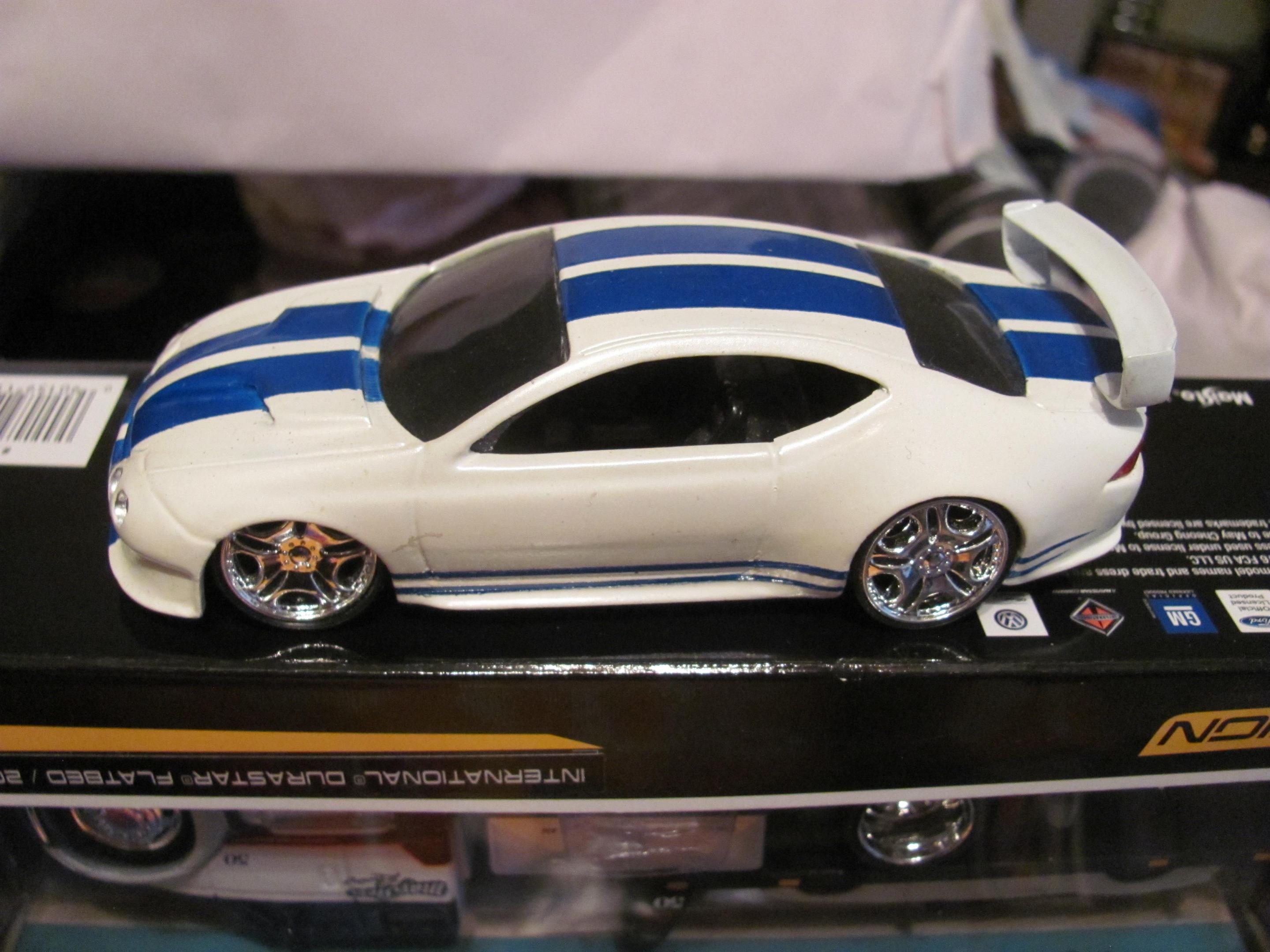

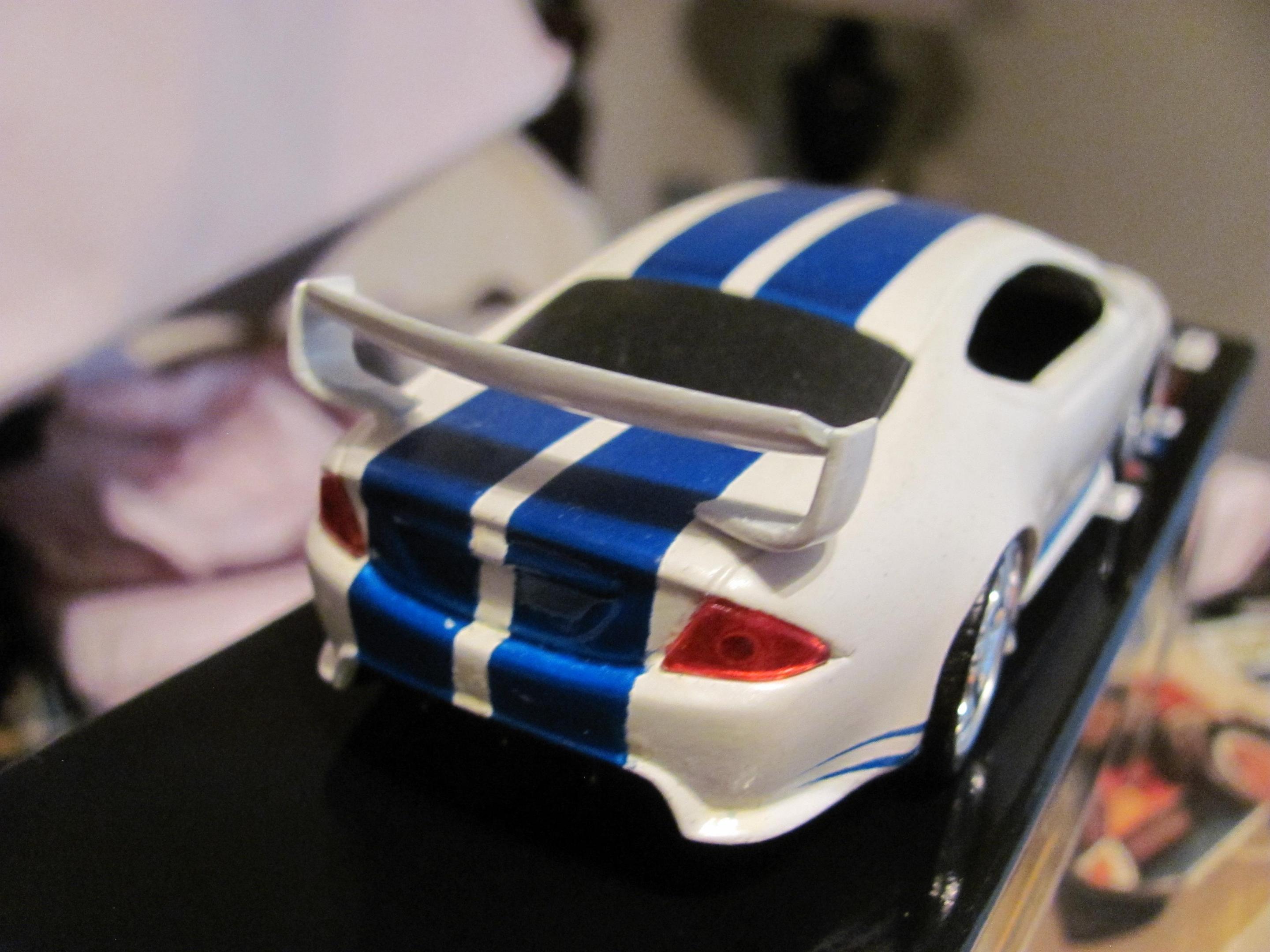

alan barton Posted October 13, 2020 Share Posted October 13, 2020 Greg, JB Weld is your friend. I have done extensive modifications on diecast with JB Weld and it is awesome stuff. It is a metal based epoxy and sticks like you wouldn't believe. You can file it, sand it, paint it and according to some point of sale stuff I read, you can even drill and tap it! Here are some photos of an AU Falcon Cobra that I build for my good friend Dale in Louisville Kentucky. These photos were taken seven years after I finished the model and gave it to him. The model started out as a 1/43 scale diecast replica of the V8 Supercar Falcon four door sedan . The Cobra was a two door hardtop from around 1978 and as Dale lives and breaths Falcons, i wanted to make him this 1998 version. After cutting away the B and C pillars, I put this model in a vice and gently squeezed the roof down until i got the fastback roofline I was after. I then spread the JB Weld around the pillars and left it overnight to dry. The original Cobra is renowned for its bulging, Torino like rear quarters so I then wrapped the rear tyres in sticky tape, mounted them in the right spot and applied more JB weld over the rear quarters. After everything was dry I carefully pried the tyres out of the quarters and then filed and sanded it all to shape. So here it is, over seven years after it was finished ( it would be ten years old now) and the normal Duplicolor primer and Tamiya white paint is still perfect. There are no cracks or shrinkage after all this time. And consider this - the only thing holding the rear of the roof in place, against the tension of its original position, is the JB Weld. Diecast does have some elasticity but everything is still exactly where I glued it. Although this was one of my most dramatic builds, I have built many other smaller models as well and have never had a failure of any sort. You can trust this stuff! Cheers Alan Quote Link to comment Share on other sites More sharing options...
NOBLNG Posted October 13, 2020 Author Share Posted October 13, 2020 Thanks Alan, that makes me feel a lot better about using the stuff. My preliminary experiments with solder have been a total failure, (as predicted) but hey, I had to try. Your job looks great! Quote Link to comment Share on other sites More sharing options...

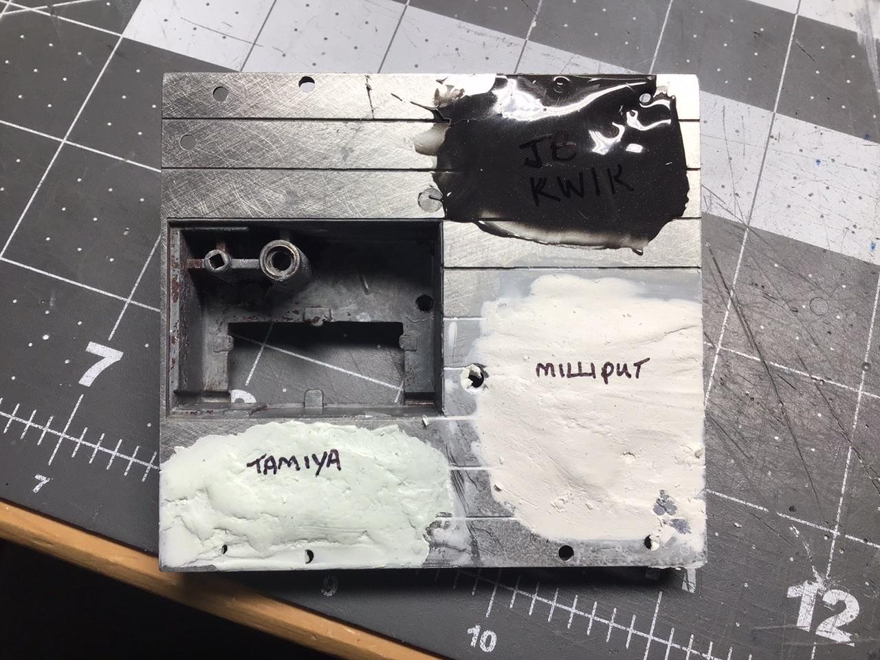

NOBLNG Posted October 27, 2020 Author Share Posted October 27, 2020 (edited) On 10/13/2020 at 9:16 AM, Snake45 said: Huh. You weren't interested when I suggested J-B Weld. Maybe everything sounds better with an Australian accent. This J-B weld you speak of...does it come in two tubes, or is it a two part clay type stuff like Milliput or Tamiya? I have some J-B Kwik in the tubes but it can’t be the same stuff you use. I did a test with the three of them and the JB is still quite soft after 2 days and can be peeled off. It doesn’t adhere well at all. The Milliput is rock hard and sticks well. The Tamiya is still a little soft (I can dent it with my fingernail) but seems to adhere as well or better than the Milliput. Thanks, Greg. Edited October 27, 2020 by NOBLNG Quote Link to comment Share on other sites More sharing options...
Snake45 Posted October 27, 2020 Share Posted October 27, 2020 The J-B Weld comes in 2 tubes, white and black. It's mixed 50-50 and ends up an even medium gray. Takes 12-24 hours to cure to a very hard and adhesive patch. The problem is either your stuff is "Kwik," or you didn't mix it correctly. I suspect the former. What you describe is typical of 5-minute epoxies--they never "dry" enough to be be sanded. Quote Link to comment Share on other sites More sharing options...
NOBLNG Posted October 27, 2020 Author Share Posted October 27, 2020 (edited) Yeah, the stuff I have says it sets in four minutes (gotta out-do the 5 min. epoxy guys?) I will pick up some of the regular stuff and do another test, but I am fairly impressed with the Milliput. Thanks, Greg Edited October 27, 2020 by NOBLNG Quote Link to comment Share on other sites More sharing options...

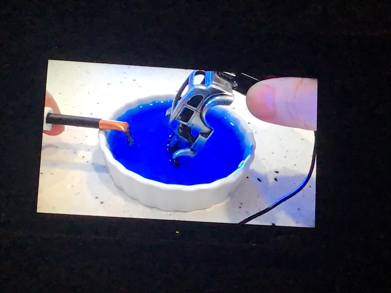

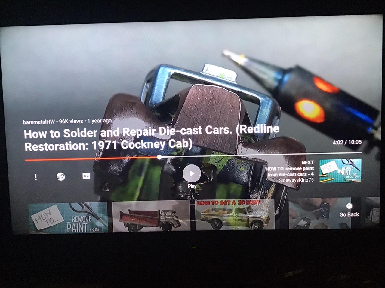

NOBLNG Posted November 4, 2020 Author Share Posted November 4, 2020 (edited) Apparently die cast can be soldered if it is copper plated first. I came across a couple of youtube videos where they used a copper plating kit from Micro Mark and then regular solder. I don’t think it would work very well for the amount I want to add, so I will likely stick with the Milliput or J-B. Edited July 30, 2022 by NOBLNG Quote Link to comment Share on other sites More sharing options...

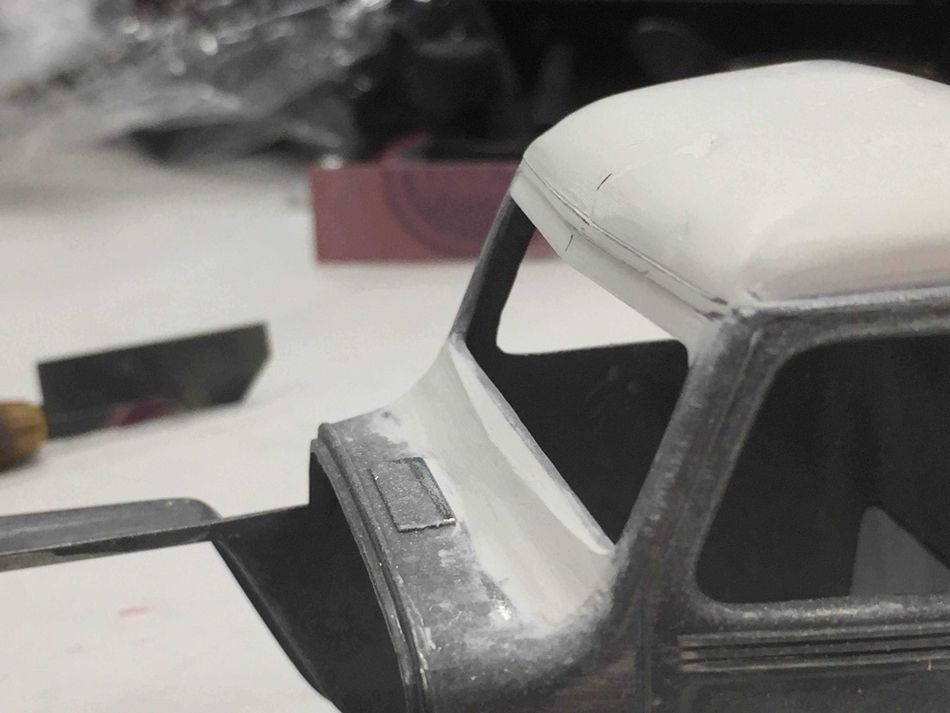

NOBLNG Posted October 24, 2021 Author Share Posted October 24, 2021 Just an update for anyone searching this in the future. I went with the Milliput and it worked great. Quote Link to comment Share on other sites More sharing options...
