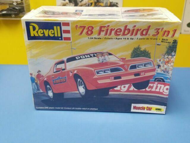

Great looking build, don't envy you those decals but should finish it well. I see this is a Revell kit but it's very different to the Revell Firebird kit I'm familiar with. They obviously have different origins. This is the only Revell one I know:-
