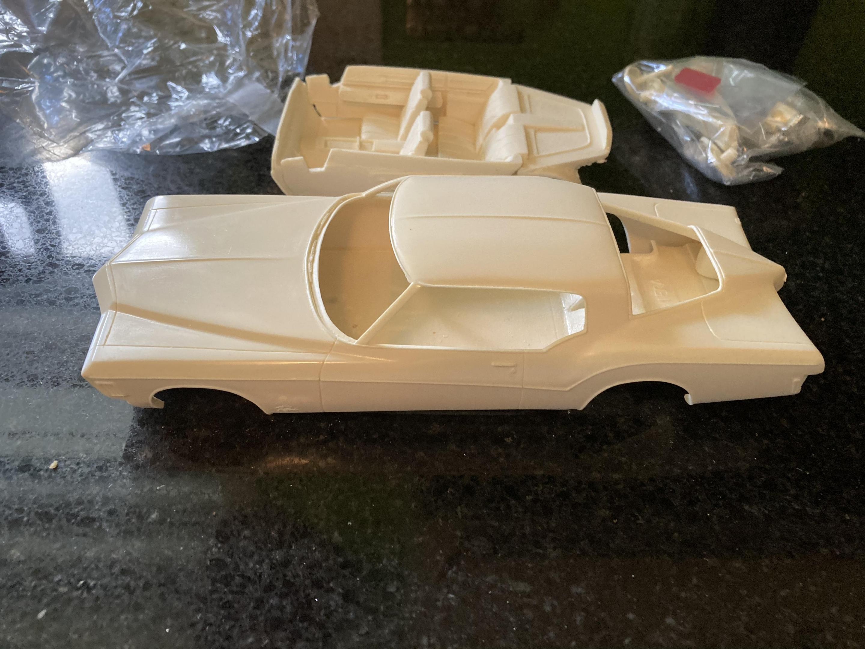

20 hours ago, yellowsportwagon said:
I recently got this and do not want to risk ruining it for any reason!!
I have used many of the suggested ways to clean resin bodies and parts in the past with only a few problems and one very big disaster that turned the body to mush. What I have started using is just plain old Dawn dish soap. I fill a container with enough water and Dawn to to cover the body and let it soak over night. Then rinse with cool water and let dry. This seems to clean the resin parts completely with no damage.  This Riviera looks interesting, where did you get this ??
Link to comment
Ebay it’s a Modelhaus. Got it second hand. It’s sweet.
