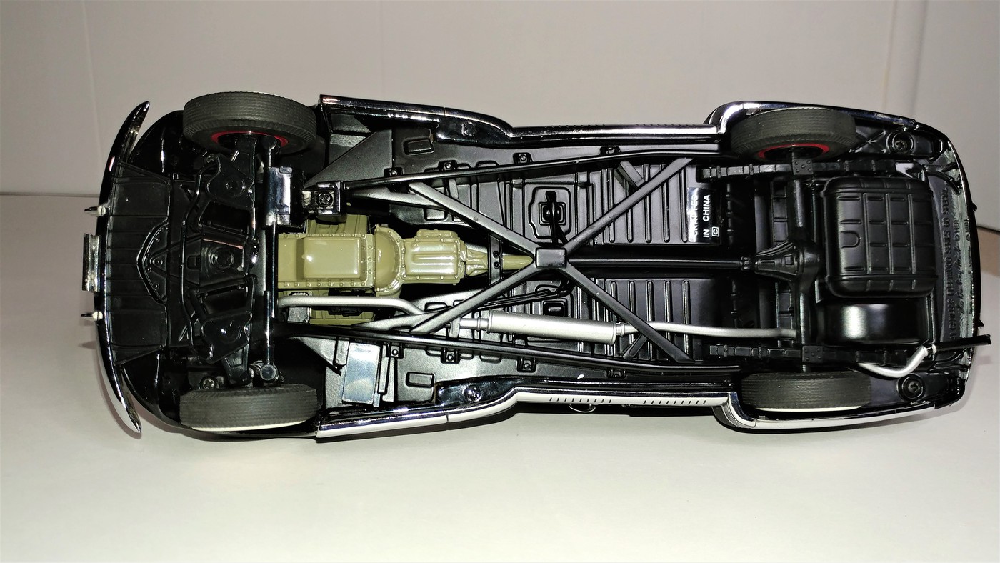

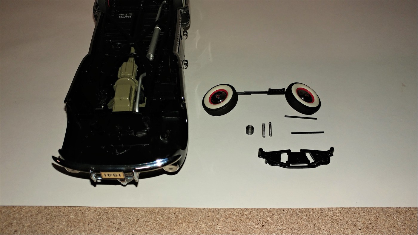

The damaged area and parts I have. Obviously, I'd already fixed the control arms when I took this photo.

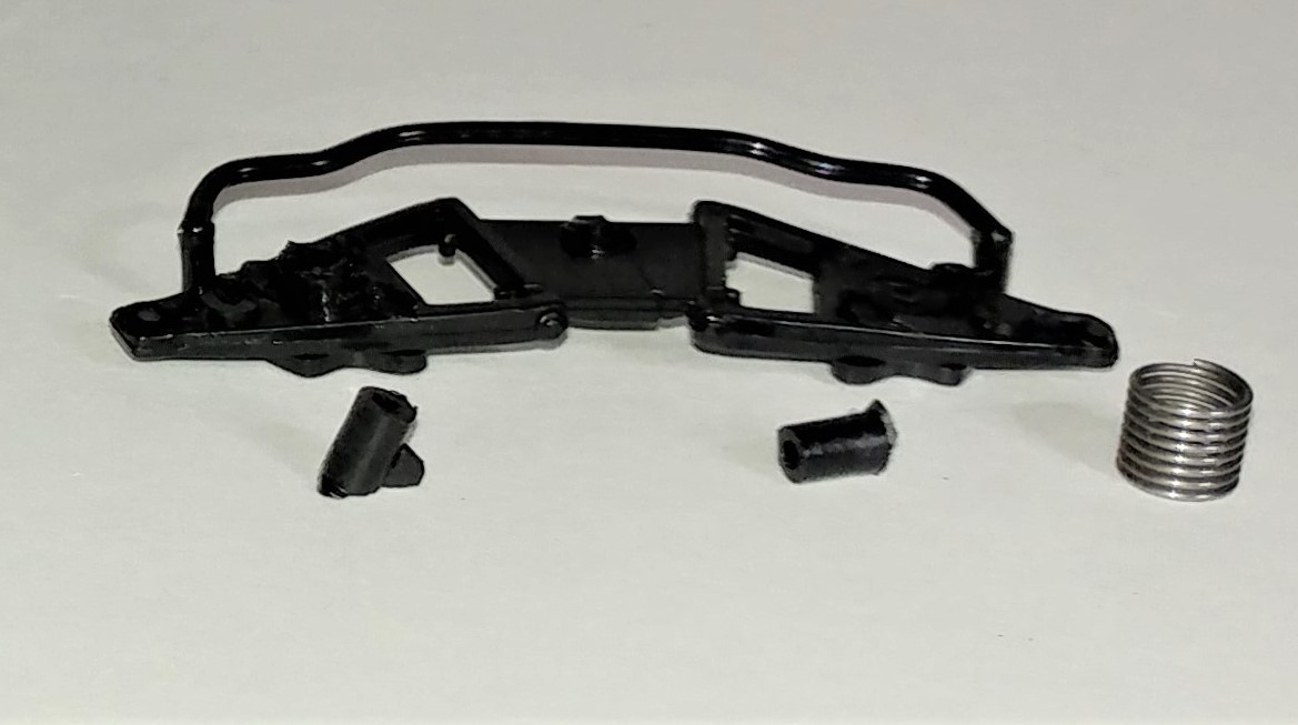

The lower control arm and the outboard points for the steering knuckle pins broken off and the center was cracked.

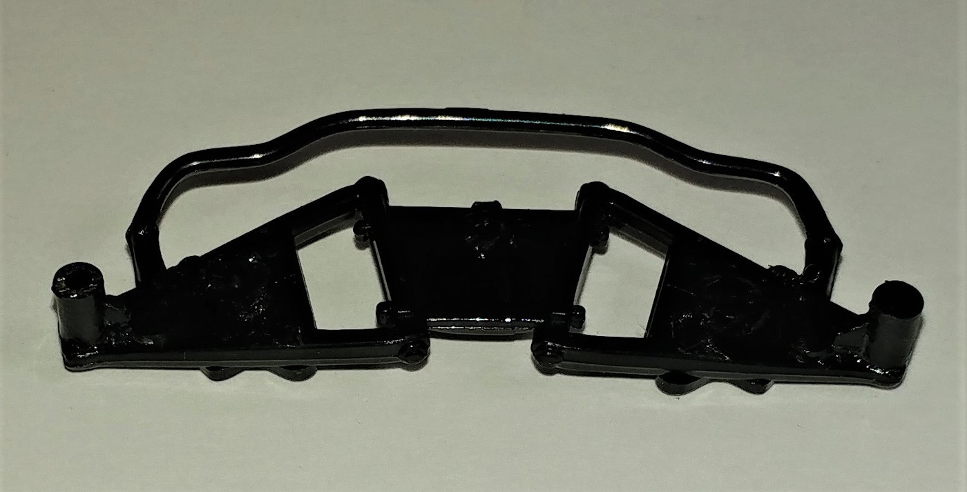

The lower control arm assembly repaired.

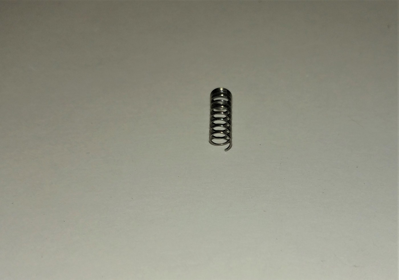

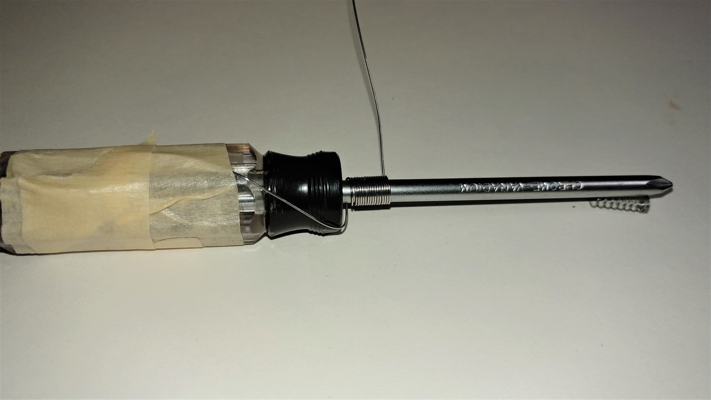

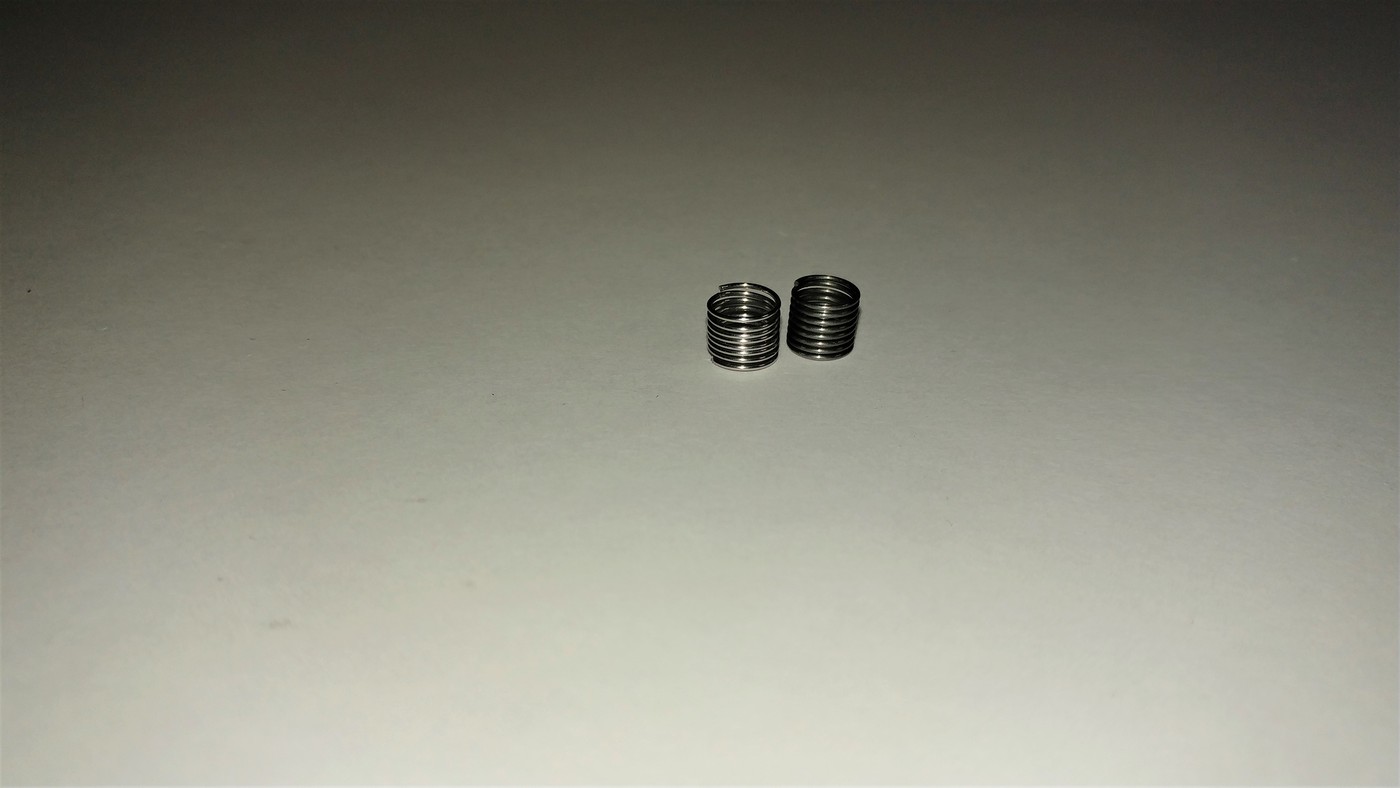

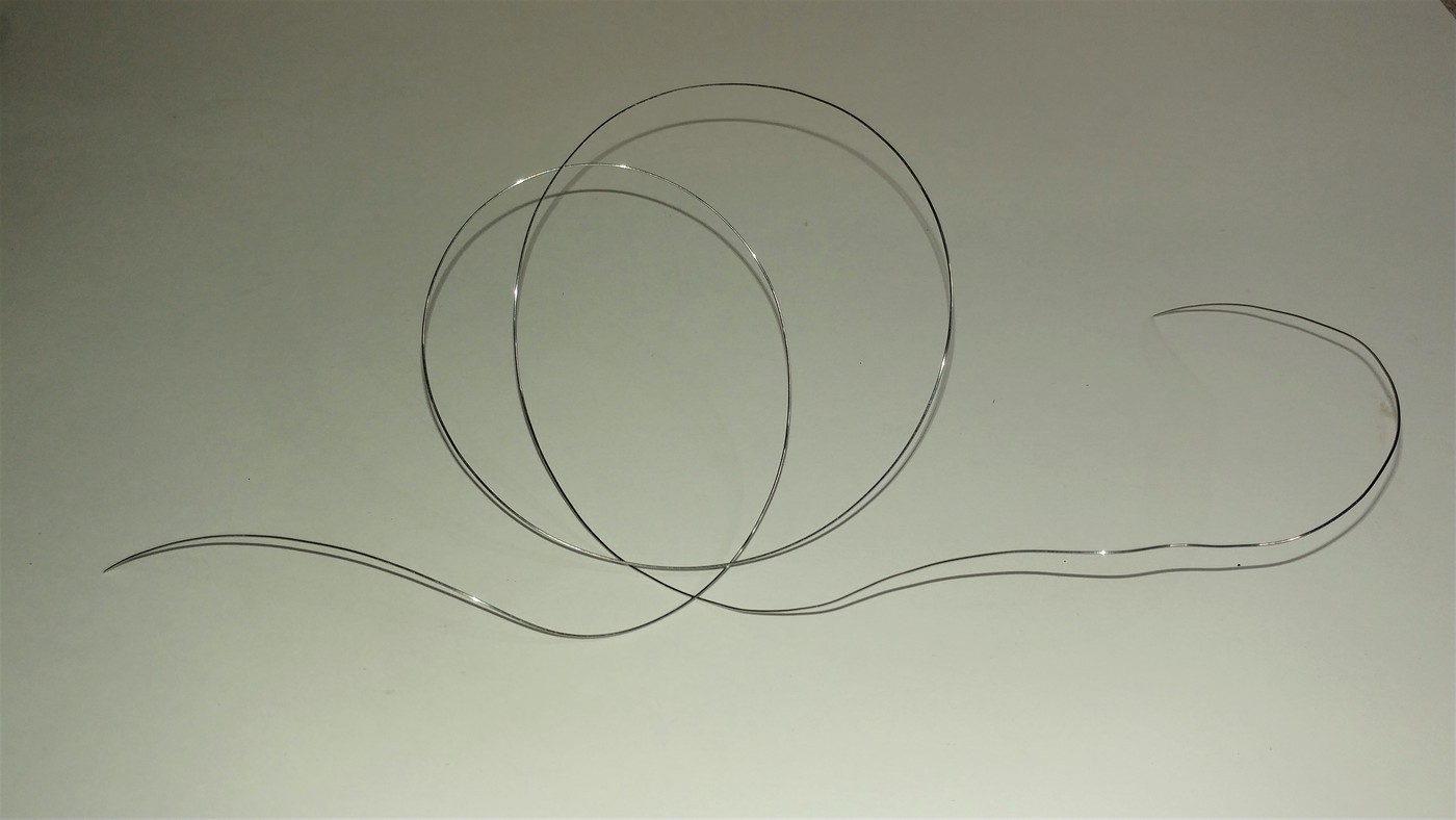

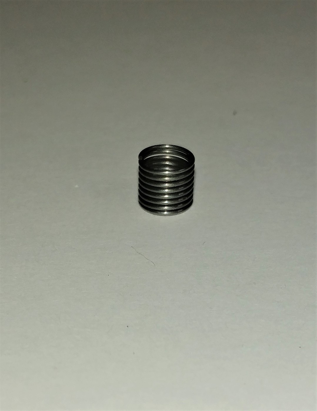

As I said before, this is missing one fake spring, so I took some .020 stainless safety wire and wrapped around a number one Philips screwdriver shank and Voilà, replacement spring

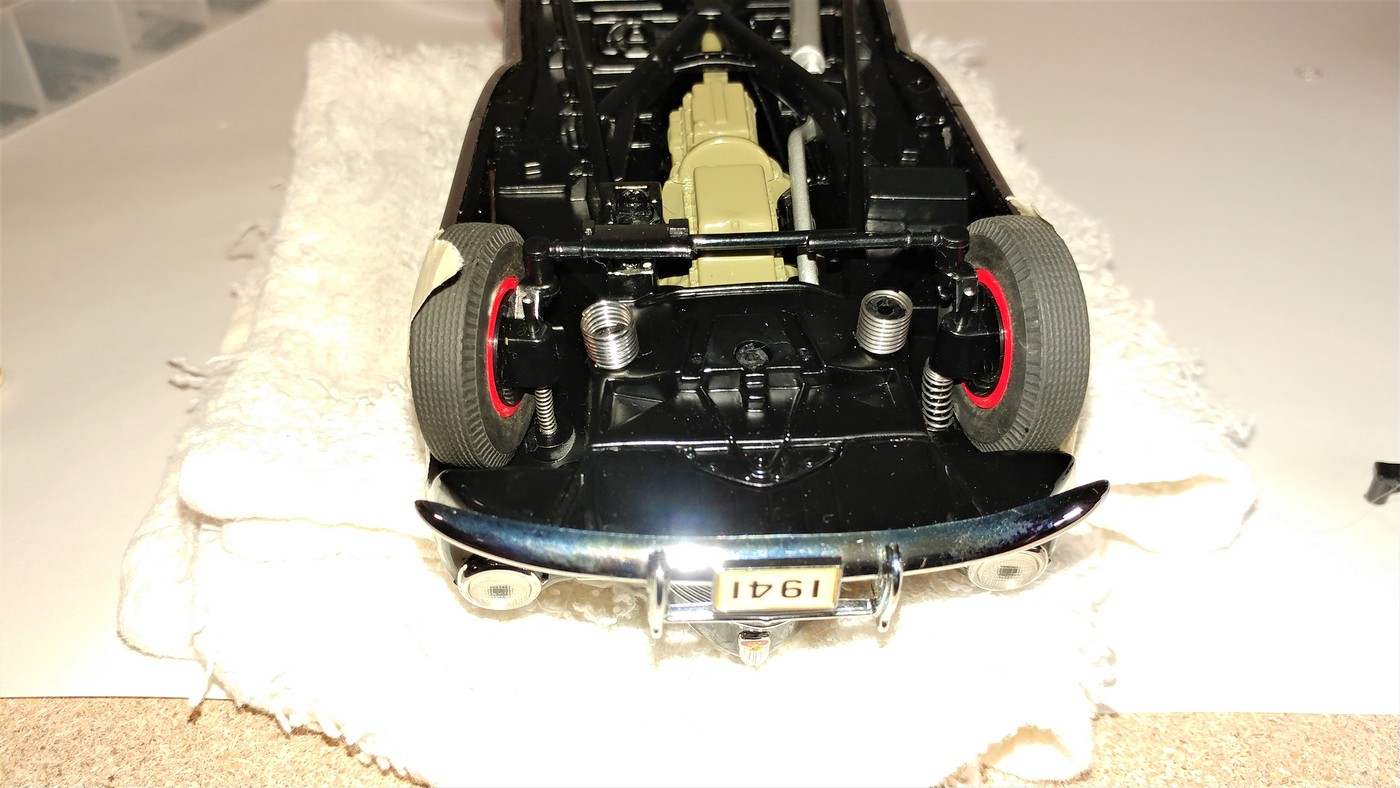

Putting the parts in place and pulling the wheels up so the control arms can be glued in place.

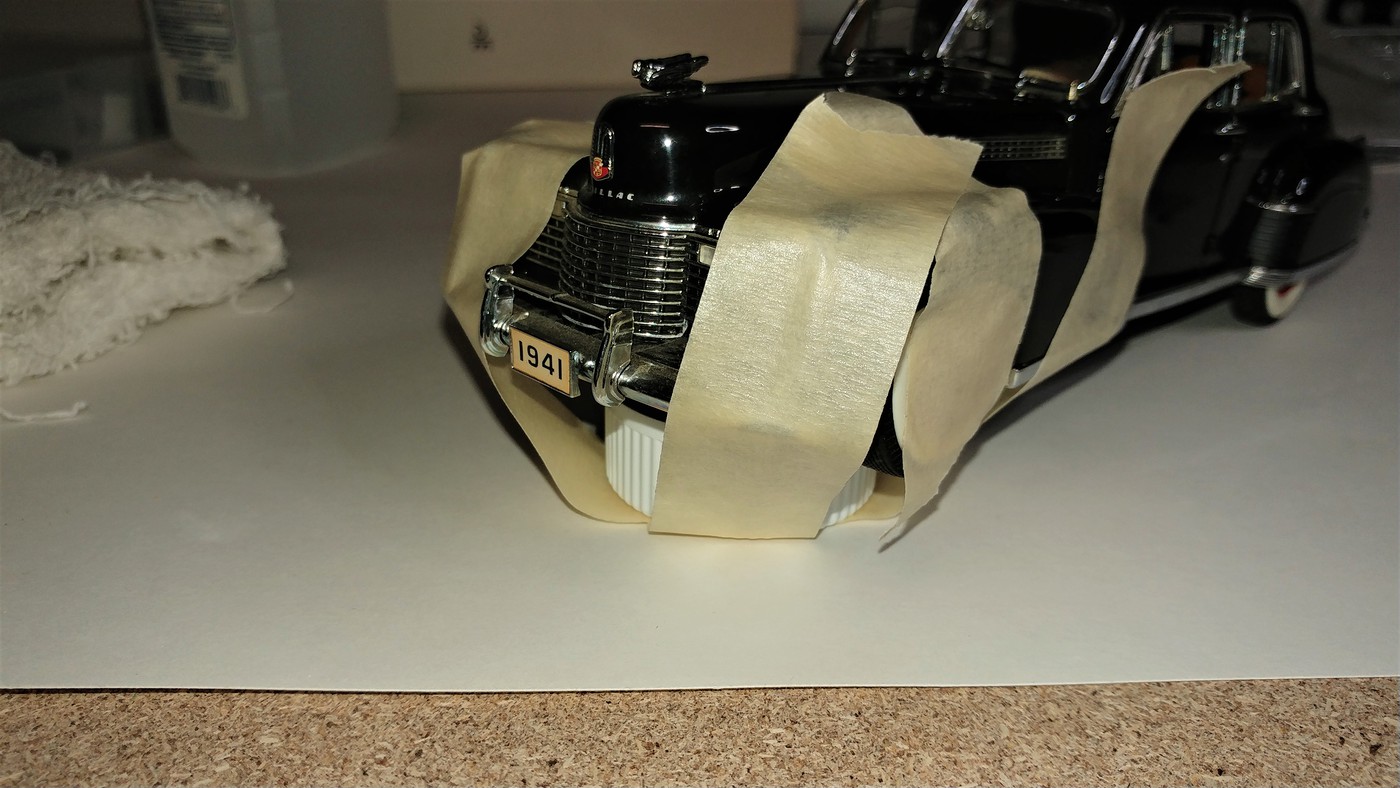

I used 5 minute epoxy and glued all three points where it was originally mounted, then I placed this cap over the control arms and taped it down so the glue could set up.
All fixed!

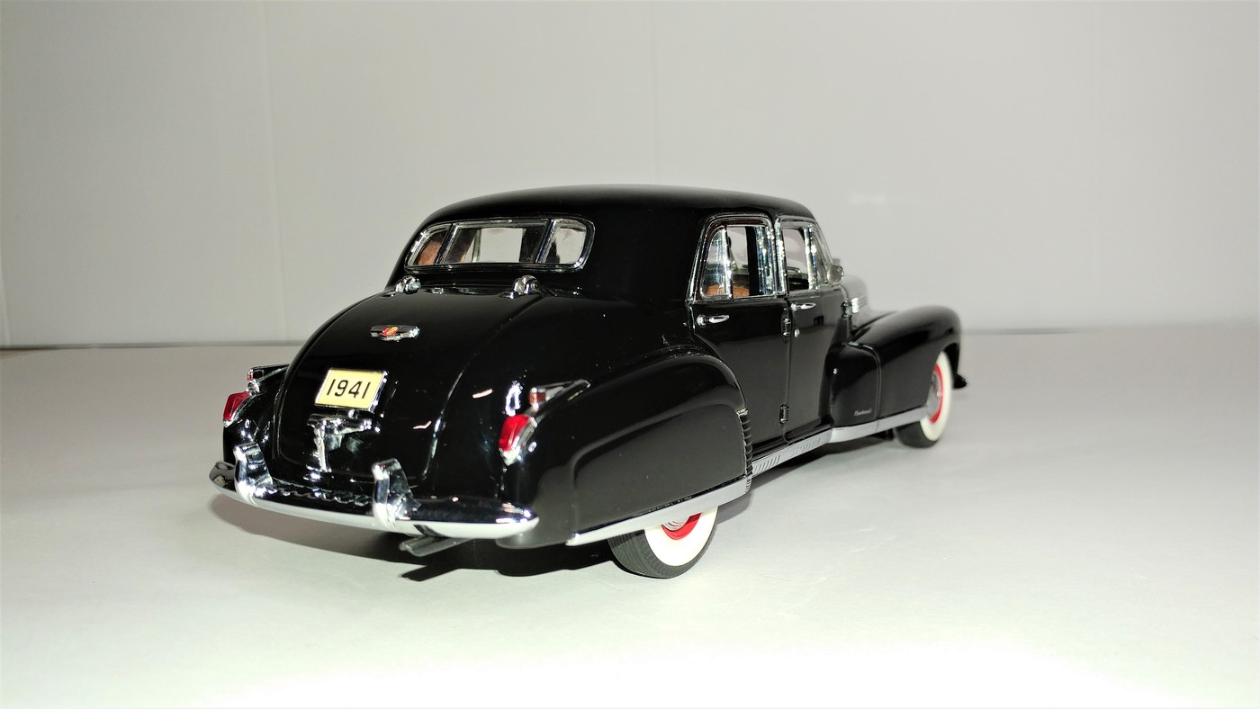

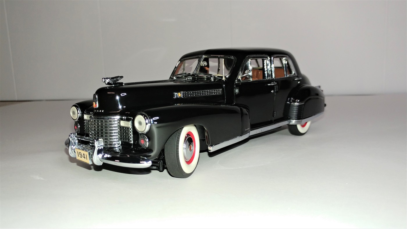

Here's what it looks like after some cleaning and polishing

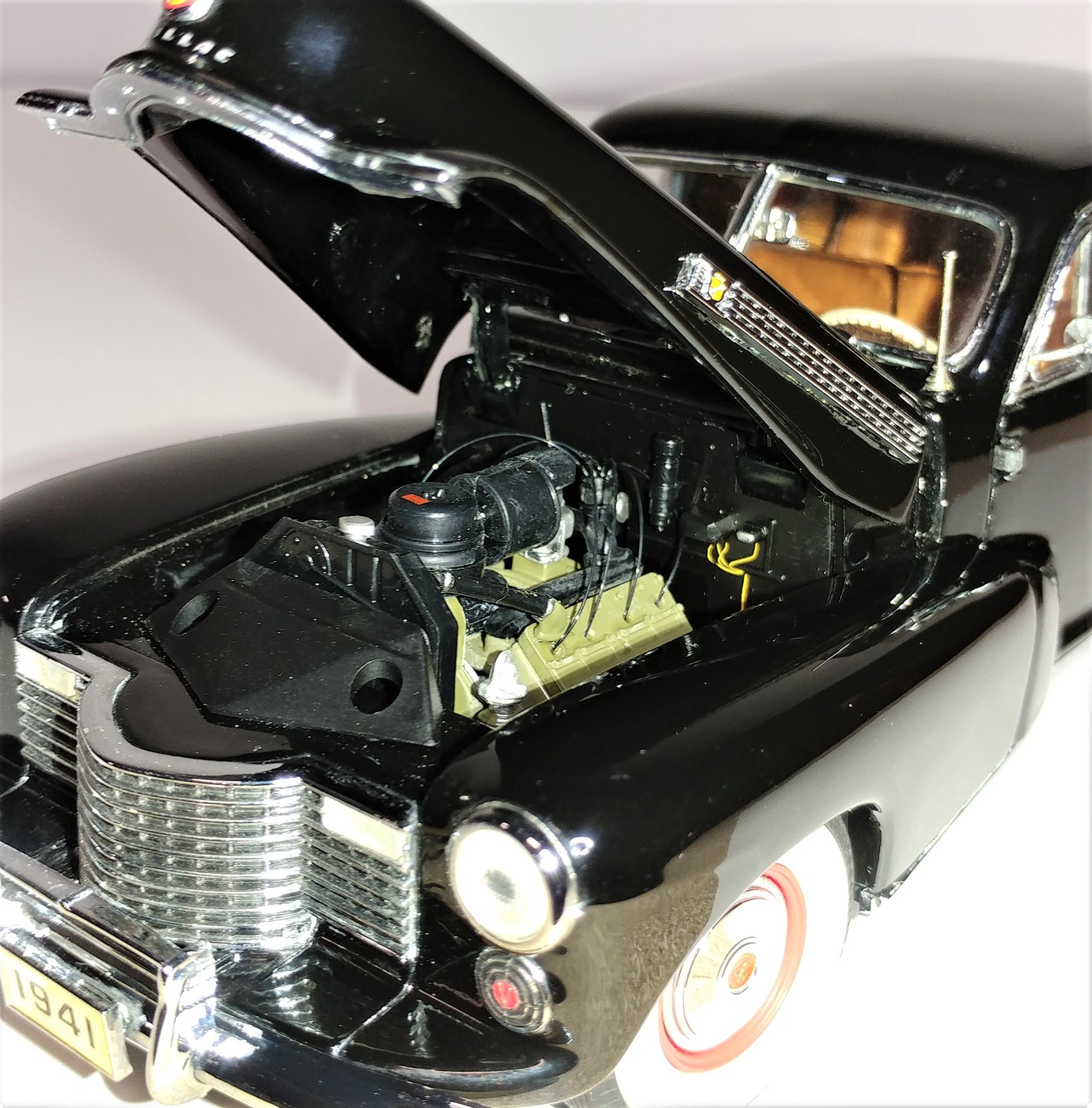

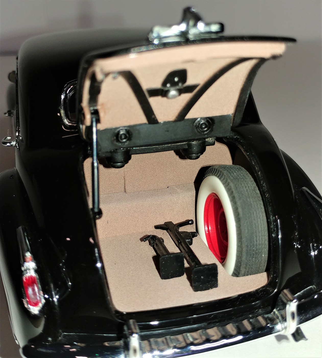

It has a couple more working features, but I didn't photograph them. The left tail light raises up to access the fuel cap and the rear seat armrest can be moved up and down
