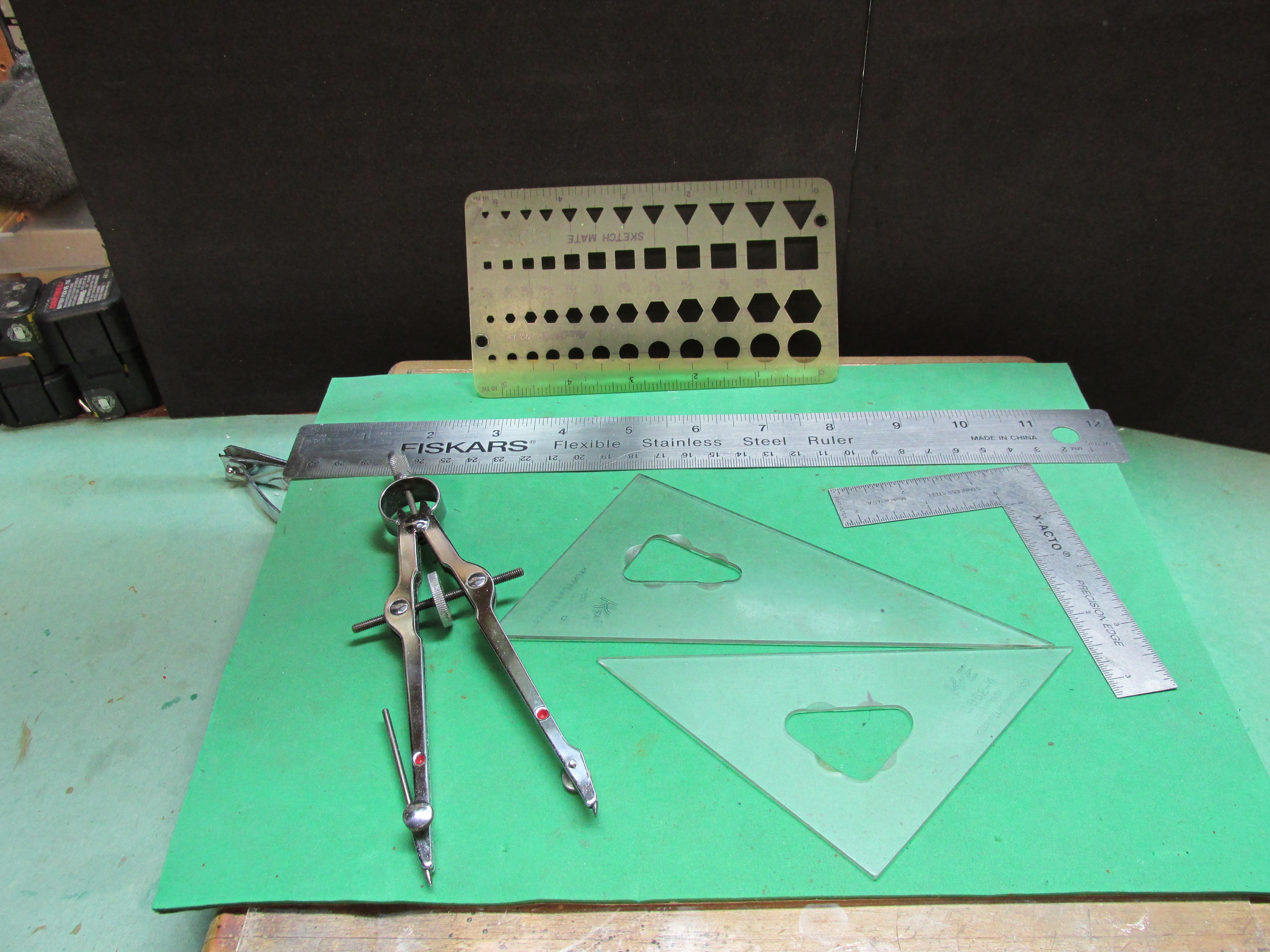

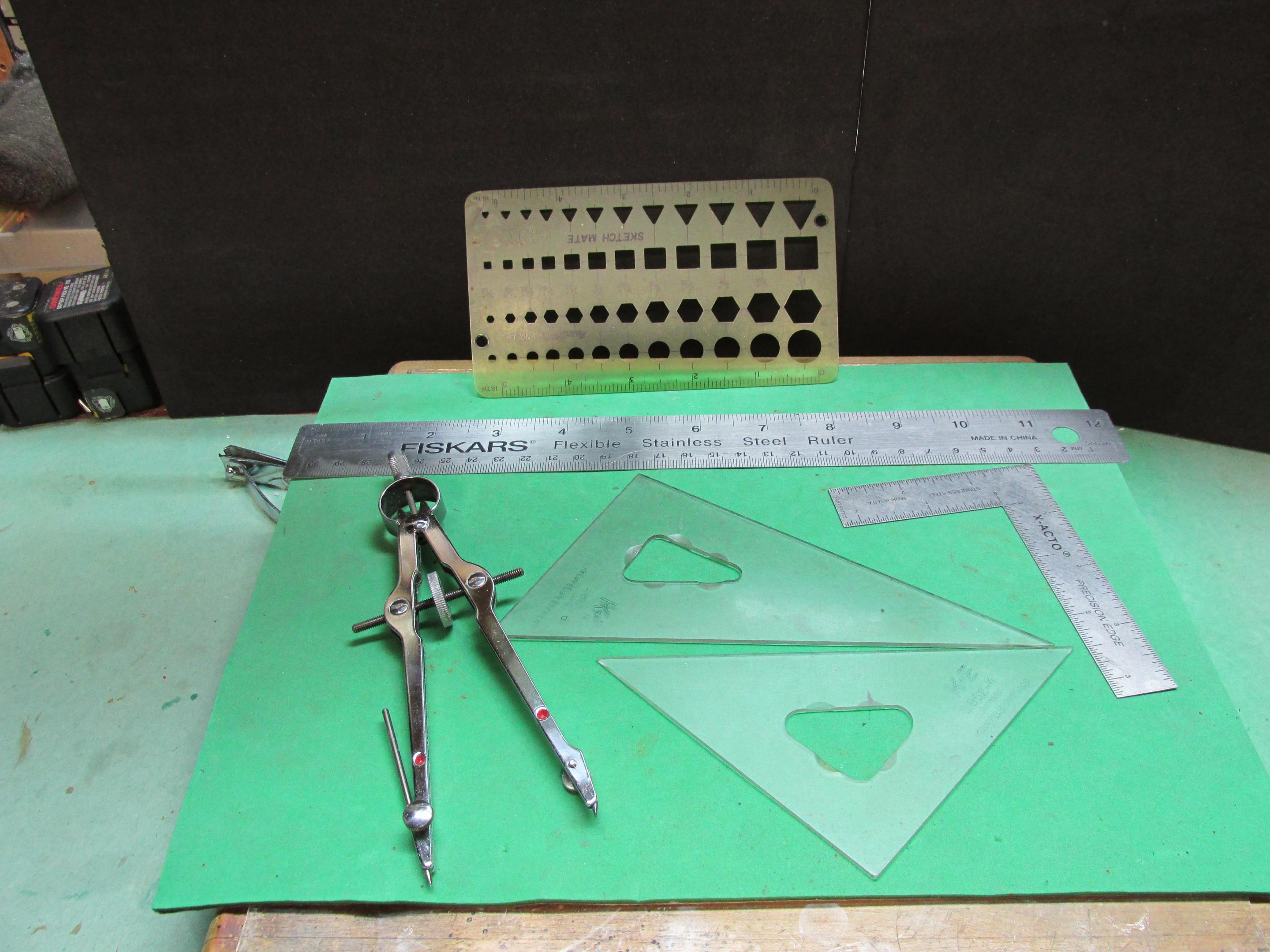

I  had a recent question about what I use in making 90 degree angles when cutting plastic.  Here are some of the tools and techniques you can use in doing that.  In the photo are the following:
A template for triangles, squares circles and hexagons.
An adjustable compass
A steel ruler in inches and millimeters
An Xacto square 3" x 4" marked off in 64ths
30/60/90 and 45/45/90 drafting triangles.
These tools can be used in a number of ways to make cuts square and true.

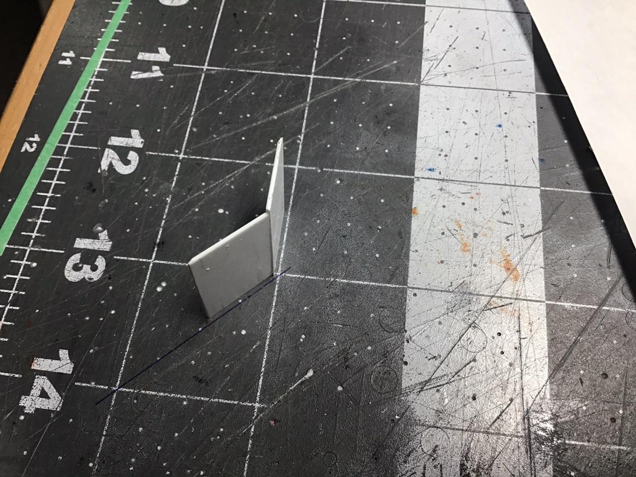

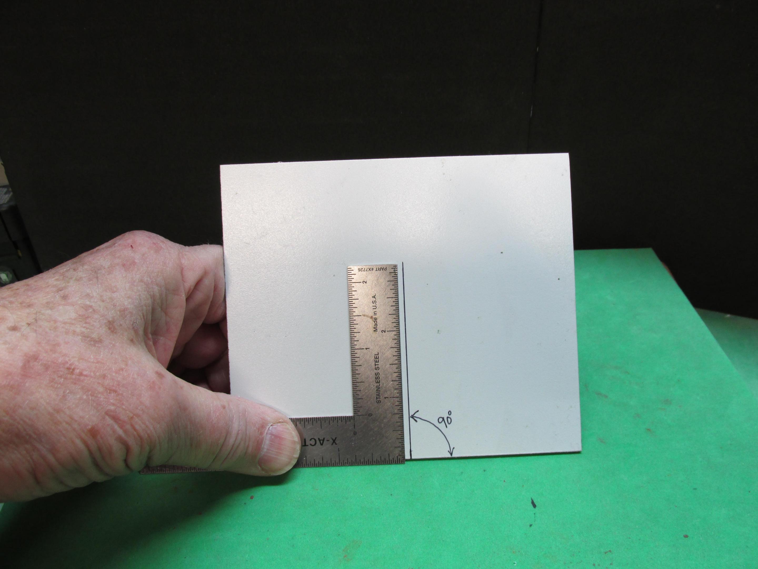

Above I have a piece of plastic sheet stock that is laid on one side and the Xacto square laid next to it.  Holding them together it is easy to draw a line anywhere on the plastic that is 90 degrees to the edge that is laying flat.  Never assume that you have a 90 degree edge on a plastic sheet.  It may look square but it might be off just enough so if you try and make a line 90 degrees to the edge lying flat it will not be parallel to the edge that is standing up.  Check it to be sure and mark it off so that you can trim it to 90 degrees.

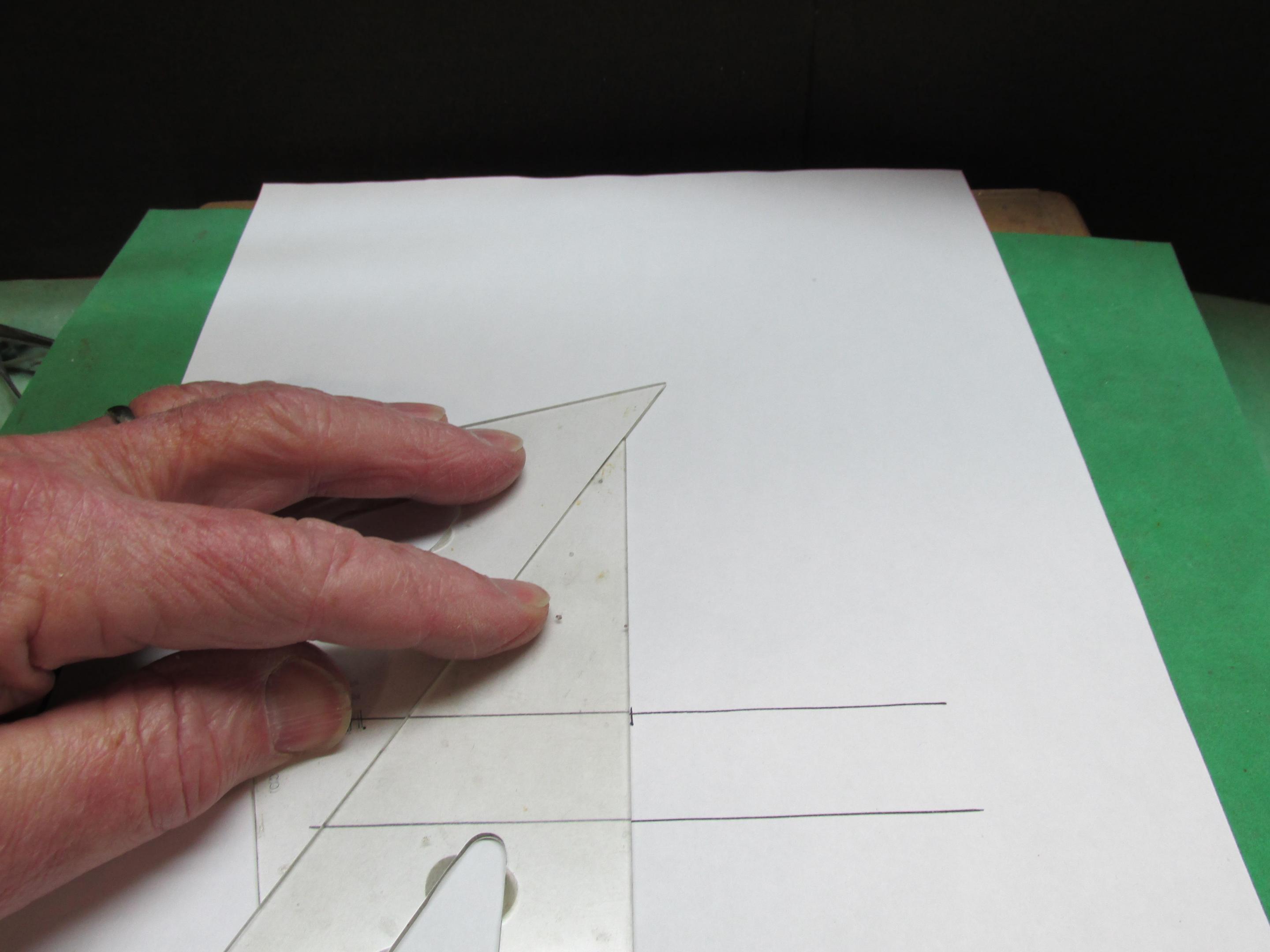

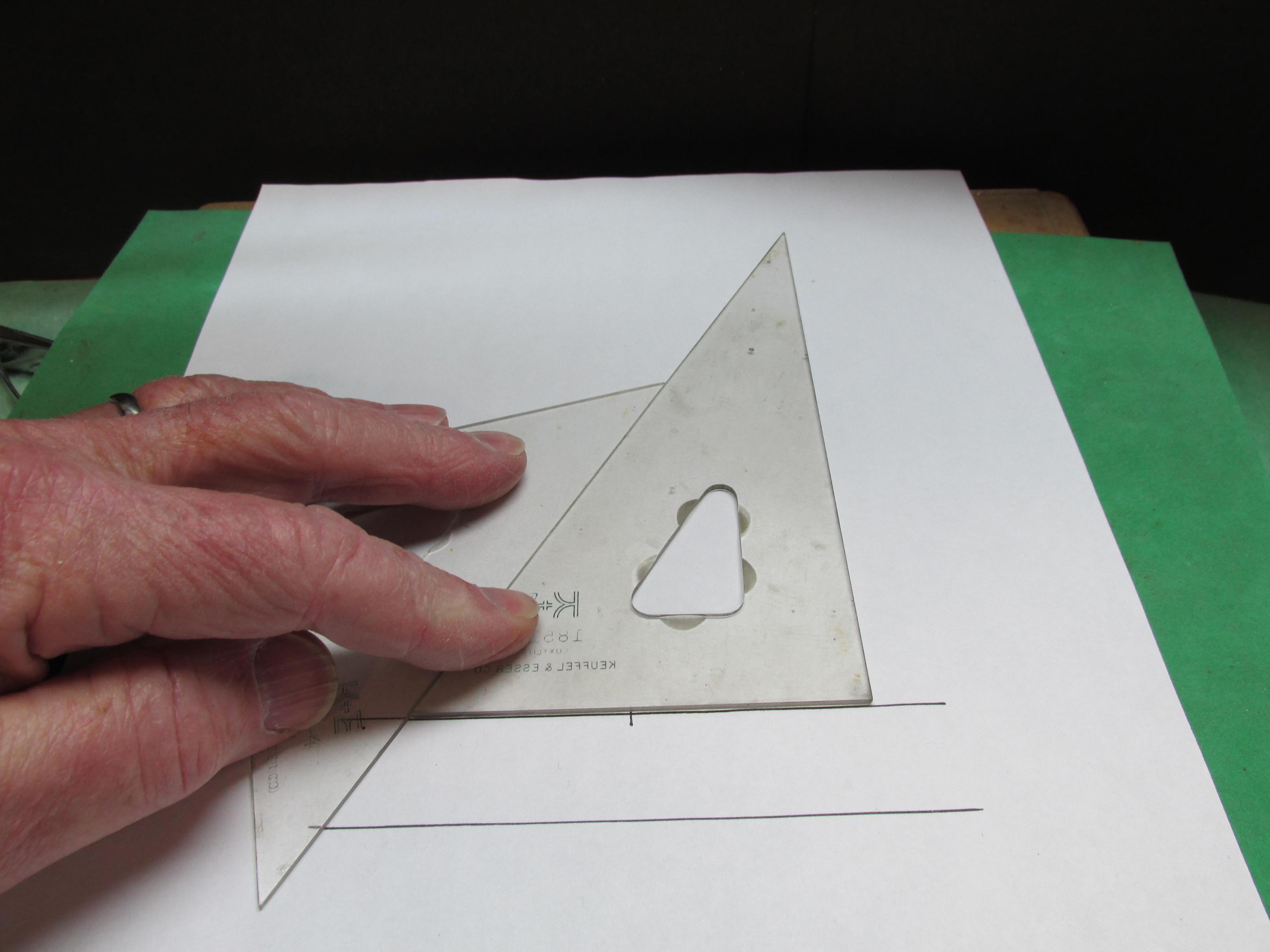

Another way is to use two triangles.  In this case I chose to make a line that is 90 degrees to the two parallel lines and to do so at the tick mark.  Start by laying one triangle against the horizontal line.  Hold it there and put a second triangle against the slanted side of the first triangle.  Hold the second triangle firmly and slide the first one down until the right hand edge is at the tick mark and draw the line.  This works because the triangle has a 90 degree corner.

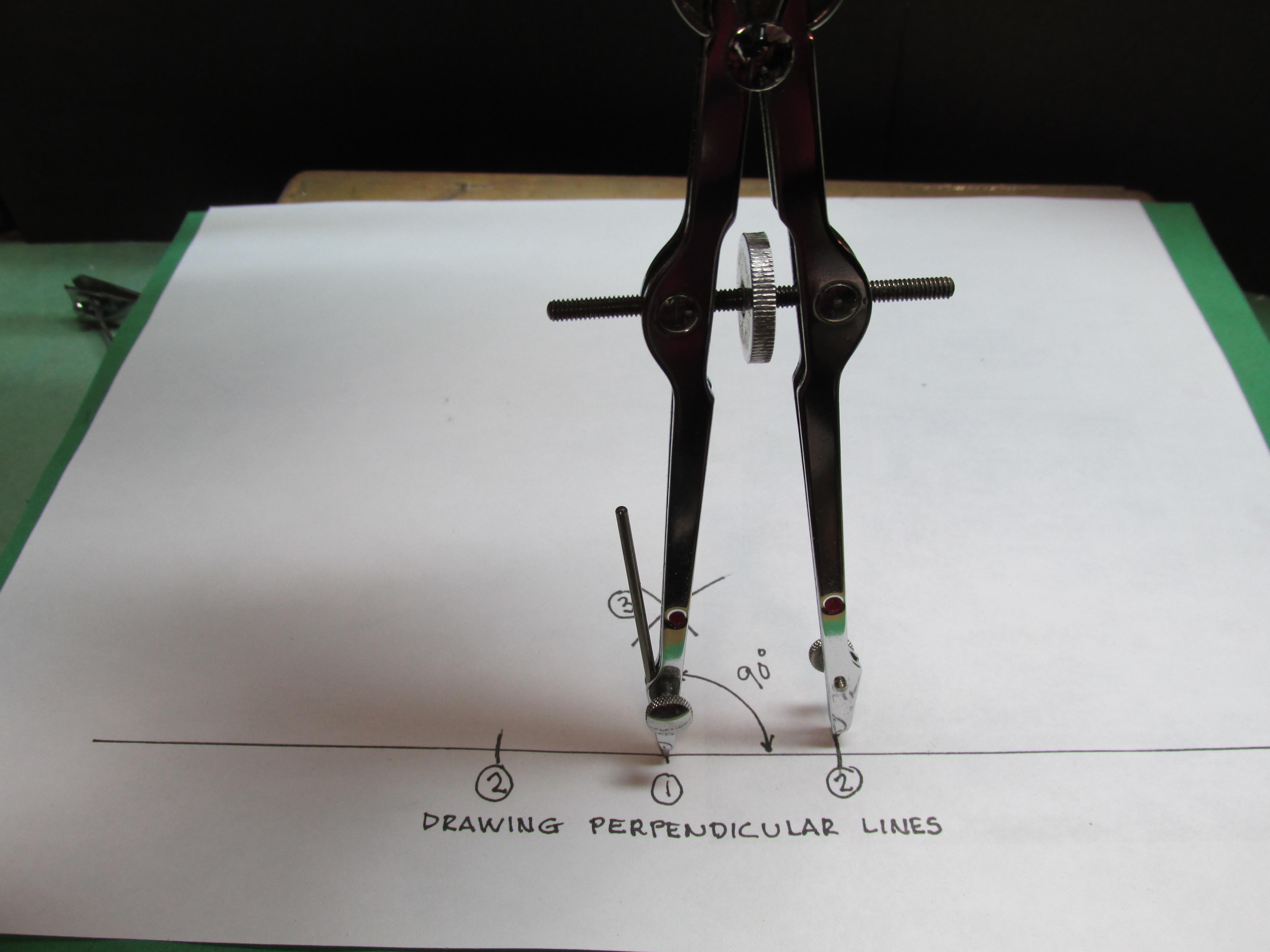

Don't have triangles or a square?  Use a compass.

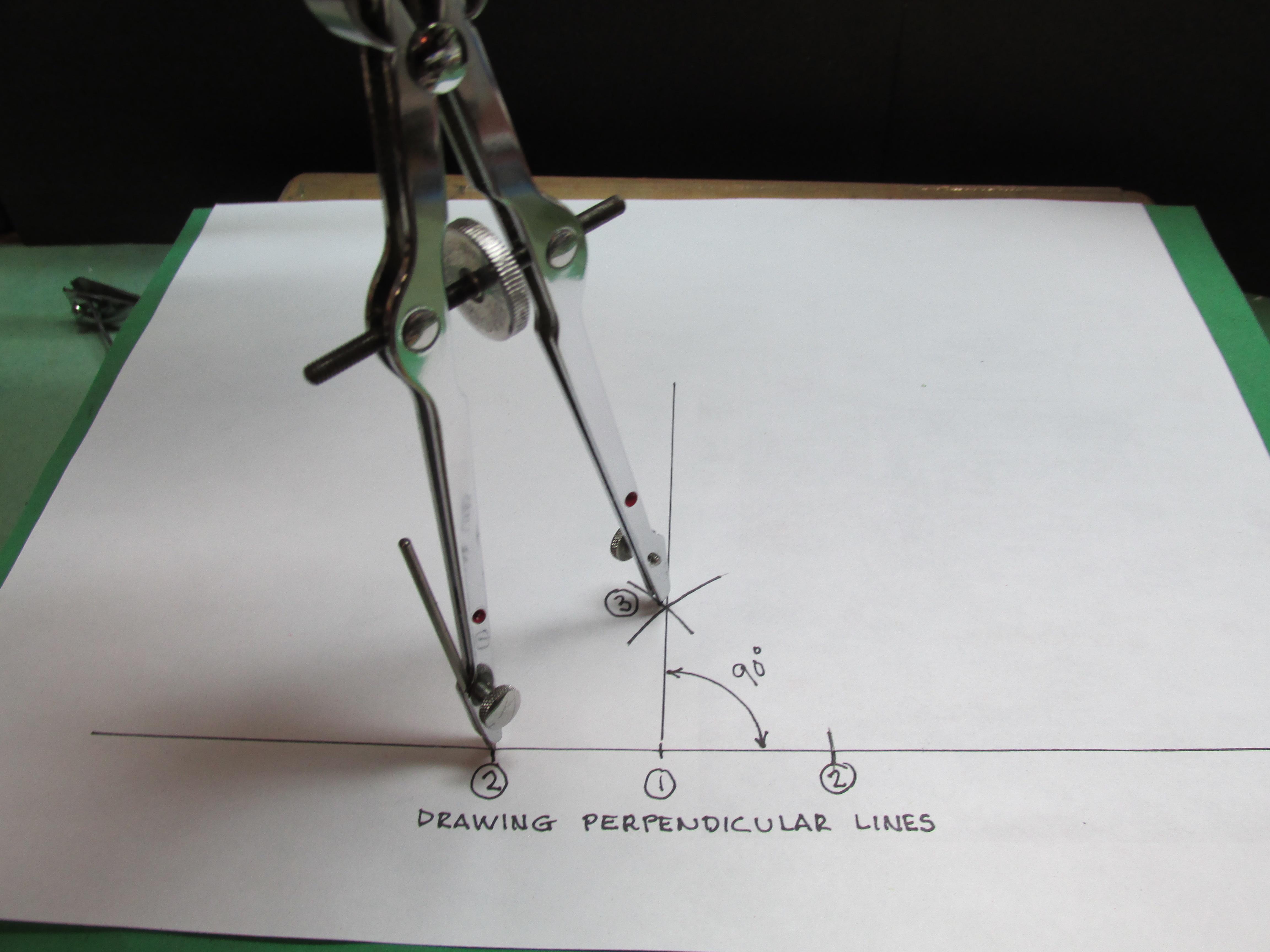

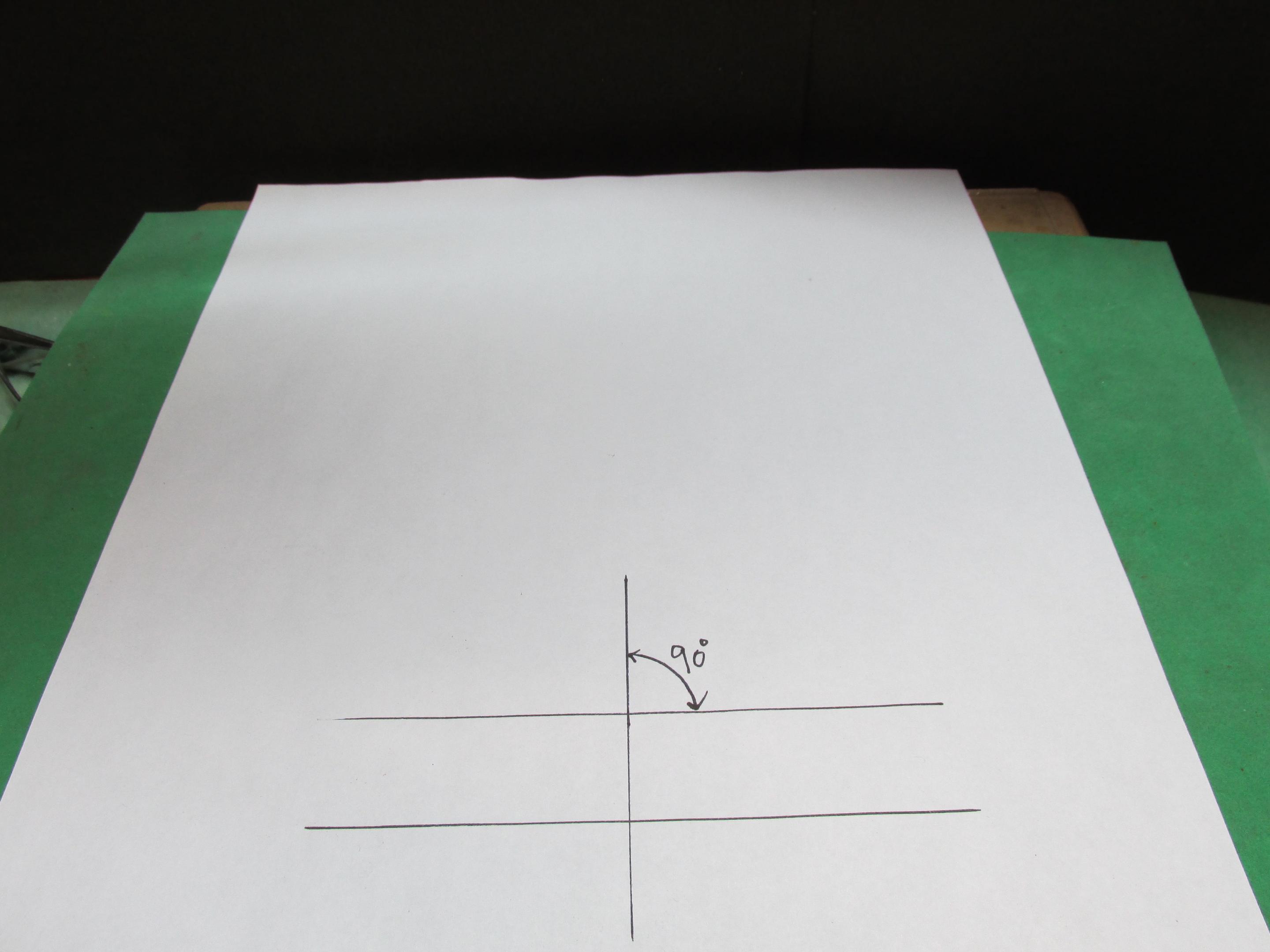

Here we start with laying out a horizontal line and want to make a perpendicular line to it a #1.  Open the compass to any comfortable space and draw a tick mark on each side of mark #1 (2).  Now open up the compass some more so that the space between the point and the pencil lead is greater than between #1 and #2.
Put the point of the compass on #2 left and draw an arc.  Then put the compass point on #2 right and draw another arc so that they cross at #3.  Connect the point where the arcs cross with the tick mark at #1.  The line you draw will be 90 degrees to the horizontal line.

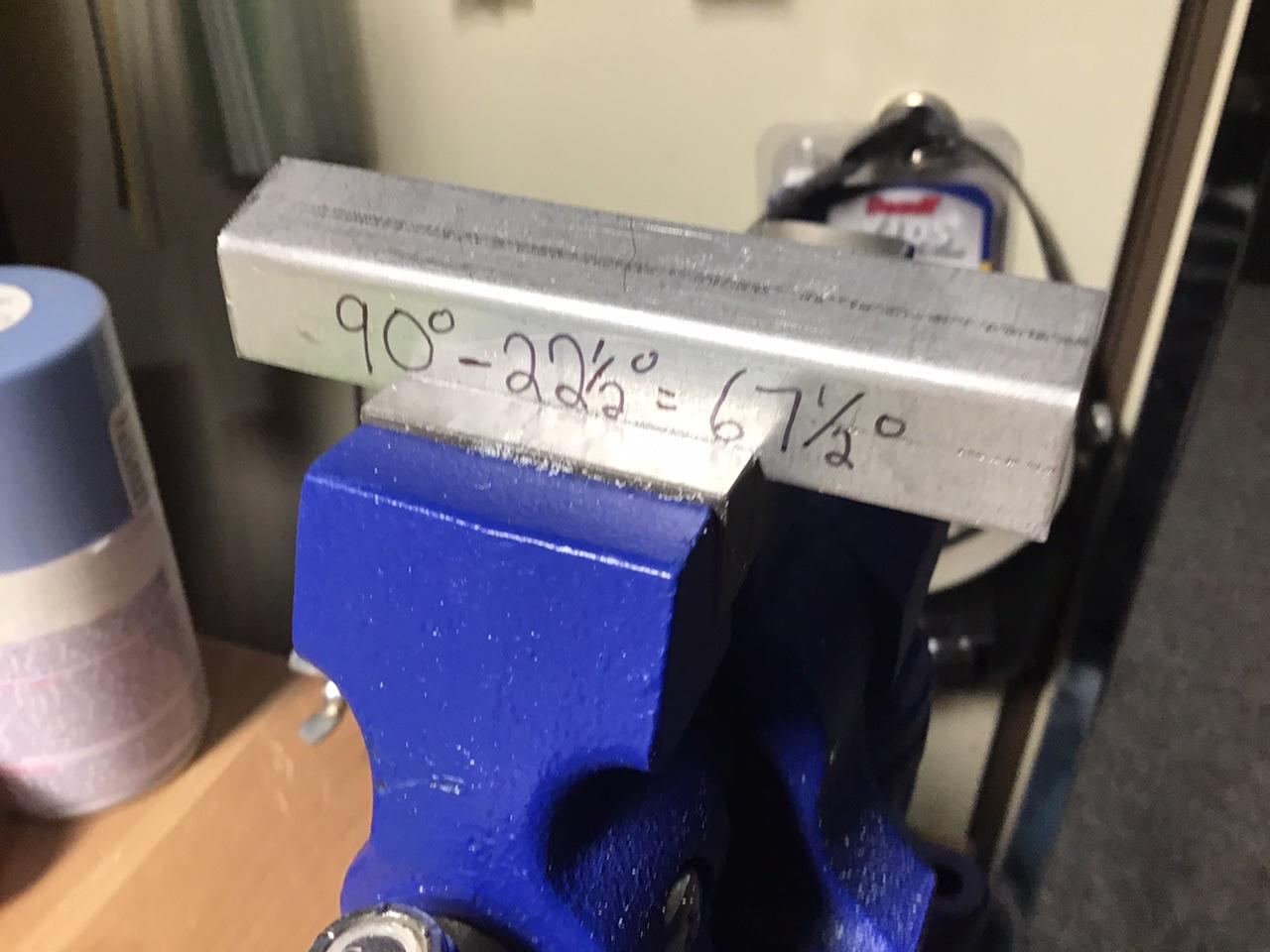

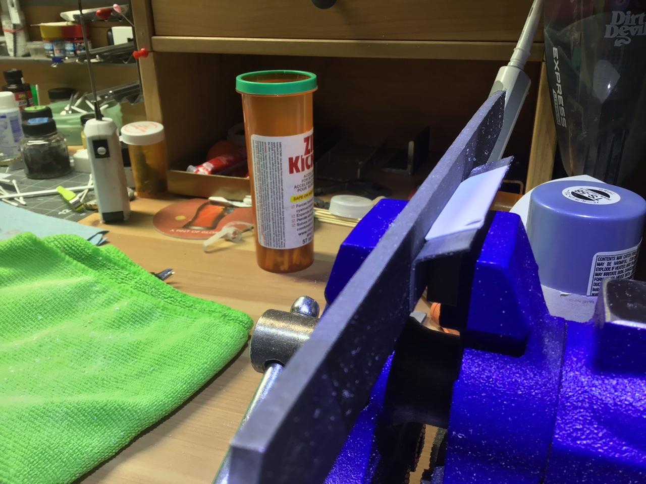

Nice trick with the two triangles Charles, I have not come across that one before. Ok,  Back to layout basics... I need to make a 90 degree angle from 2- 45 degree bends (mitres). I made a simple jig bent from a sheet metal strip. It is bent at 90 degrees- 22.5 degrees = 67.5 degrees. I clamped it in the vise along with a large file. Slide the two edges to be joined against the file at the pre-determined angle and the joint (in this case) will be a perfect 45 degree  angle. Once you have the proper angle bent as a guide, repeating the mitre angle is easy!
Edit: A flat piece of metal in place of the file with your choice of sandpaper clamped between it and the angle may work even better.
Edited by NOBLNG
Share this post
Link to post
Now that's a great tip! And how did you determine the 67.5 deg for bending?  I understand the math but how was it accomplished to make the jig?

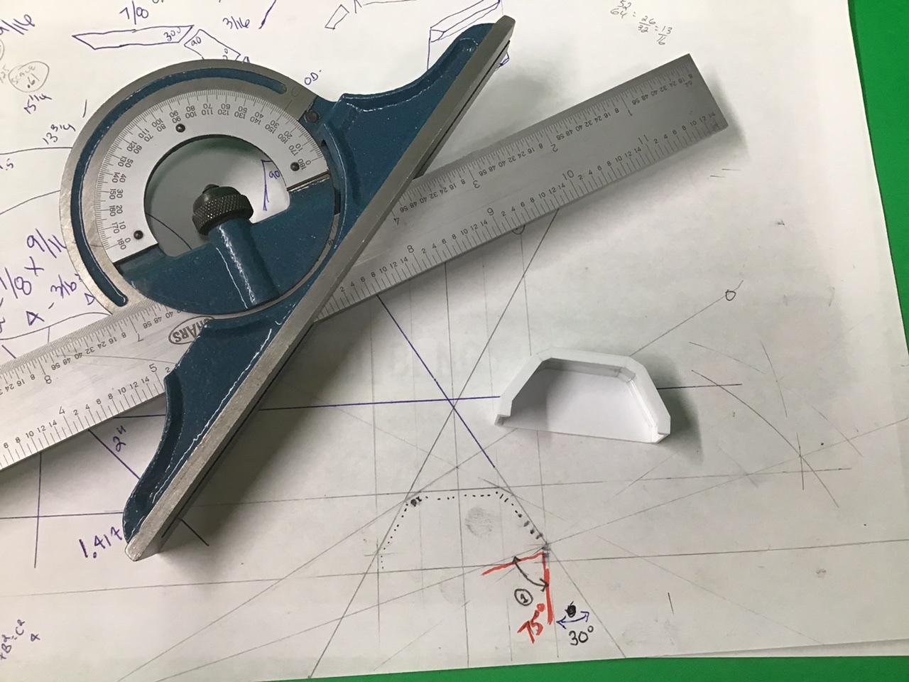

I have a small (12”) press brake/shear/roller that I used to bend the metal. It could possibly be done carefully with just a bench vise and a hammer?😬 To get the angle bang on I used a combo square/protractor. I used the same method with a compass that you used for the perpendicular line to split the mitre angles when laying out these fenders. Here I needed 180 degrees from six 30 degree mitres.

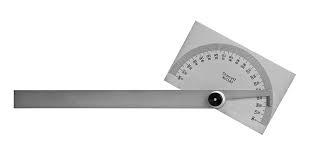

A good quality tool like the one above can get quite expensive, in the high $200 range and may be more that what we need for modeling.  Starrett makes a very precise protractor that can also be used for under $75.  I got one for working on my benchtop mill and lathe.  Very nice tool for the money.
By the way, when working on the small scales that we do, precision is everything.  Good measuring tools will save a ton of frustration.  Don't be afraid to spend the money for quality when it comes to measuring tools.
