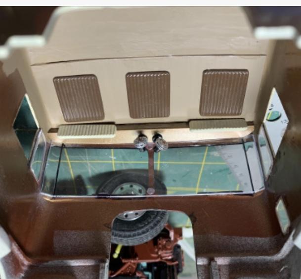

I really like these kits. They are temperamental to say the least. I’m not an expert for sure, but this is what I do.
On the frame, assemble both sides at once. Don’t install crossmembers to one side and let dry. I usually use CA glue and stand the frame on end and check it with a square.
On the windshield I installed a overhead console the the glass stopped against. I also installed pinstripe to separate the corner glass.

Brian thanks. That looks great. I also read that Microscale Krystal Klear may do the trick. Along with Elmers or Canopy Cement. I know that the bigger issues straight frame, straight suspension, and getting the plumbing to fit properly under the cab are the bigger concerns. However in my case it's the smaller issues that bug me more. It's like well a compound fracture is the bigger concern. But the paper cut is more the nuisance. At least in my case it would be.

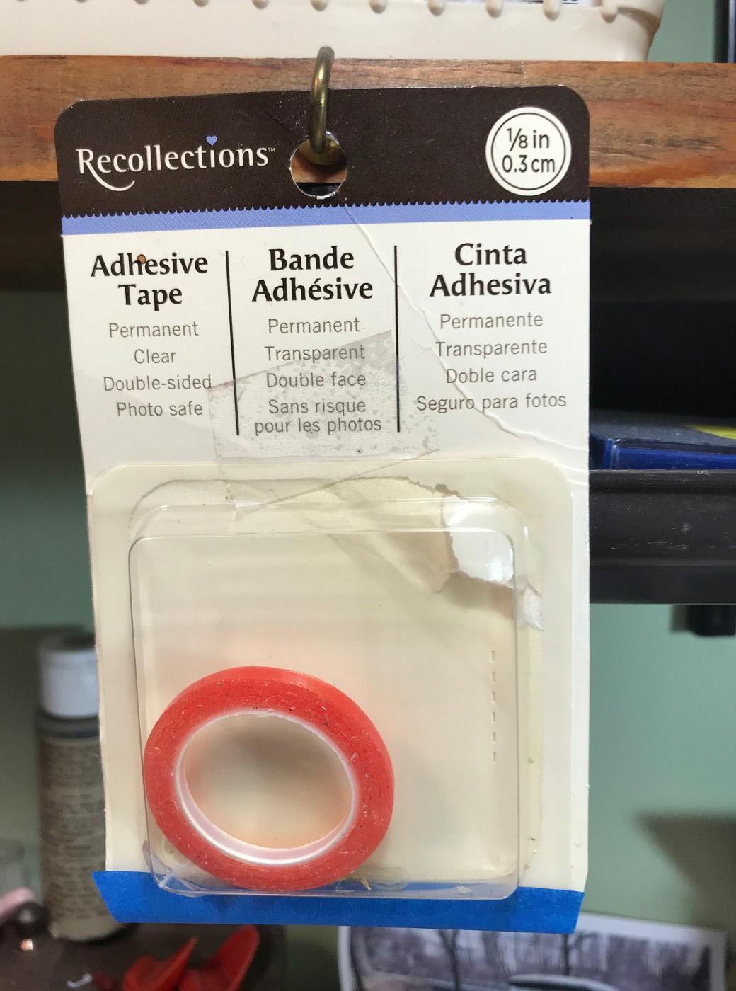

Another option for the glass.. clear double sided tape comes in different widths. Holds glass well, either by itself or in combination with canopy cement
Thanks Tom. Where do you find that tape?
Tom,
Hi hope you're well. That tape is clear correct? The Red is just a backing?
Share this post
Link to post
Yes! As you peel it off the roll, only one sticky side is open. The red is still on the second side. Place the sticky side on your glass, then peel off the red to expose the other sticky side that you then press into the body.
Tom
Hi hope all is well. So as I understand and get the job done right. Apply the tape across the top, and bottom of the glass. Then remove the red and carefully press into place inside the cab. Also is it easily removable in case I make a boo boo.

5 hours ago, JerseeJerry55 said:
Tom
Absolutely!  If you mess up, peel the tape off and try again!
