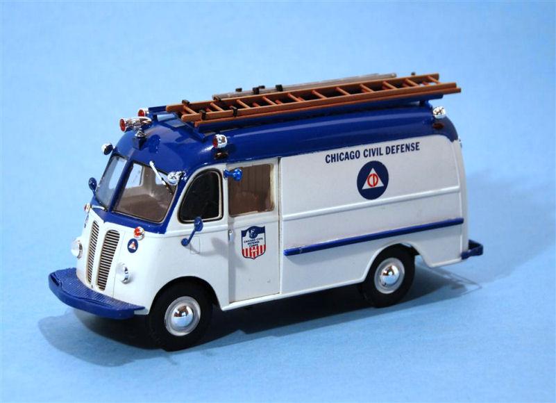

I've used Fred Cady decals since the '80's.  Fred silk screened his decals based on the individual colors, so for things like lettering and logos, you have apply each color layer over the previous to build up to the final decal.  You start with the base or background, then add the other color detail layers one at a time.  I've clear coated these all of the time with no problem.  The key is the thickness of the decal film.  The thinner each layer of the decal is, the easier it will be to blend them into the final surface finish. I've attached a few images of some of the models I've used Fred's decals on.
