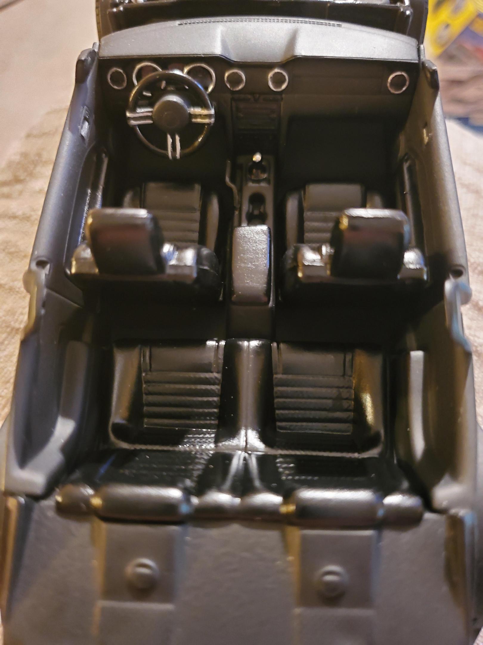

I built the Decepticon Barricade's vehicle form from the first Transformers movie. The kit is the Revell 2007 Shelby Mustang built mostly kit stock except for some Fujimi Advan wheels, decals I had made by Firebird Designs, and the light bar from Spotlight Hobbies.
Most of the work went into lowering the kit about a quarter inch. I had to grind the upper areas of the wheel wells and rebuild parts of the rear due to the wider tires. I also had to shorten the rear coils and grind the top of the axle along with a molded in part on the chassis to get the rear end down. Paint is Duplicolor white and black with about half a dozen coats of Mr. Super Clear gloss.

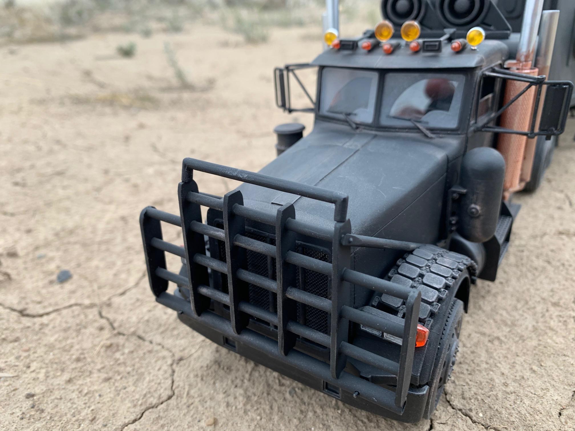

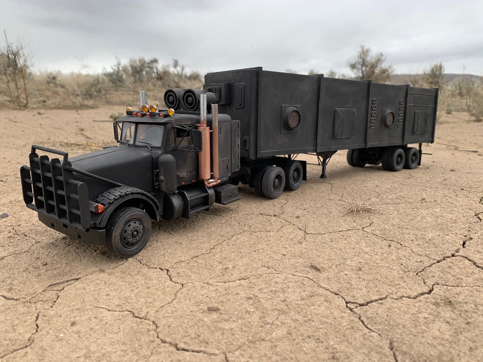

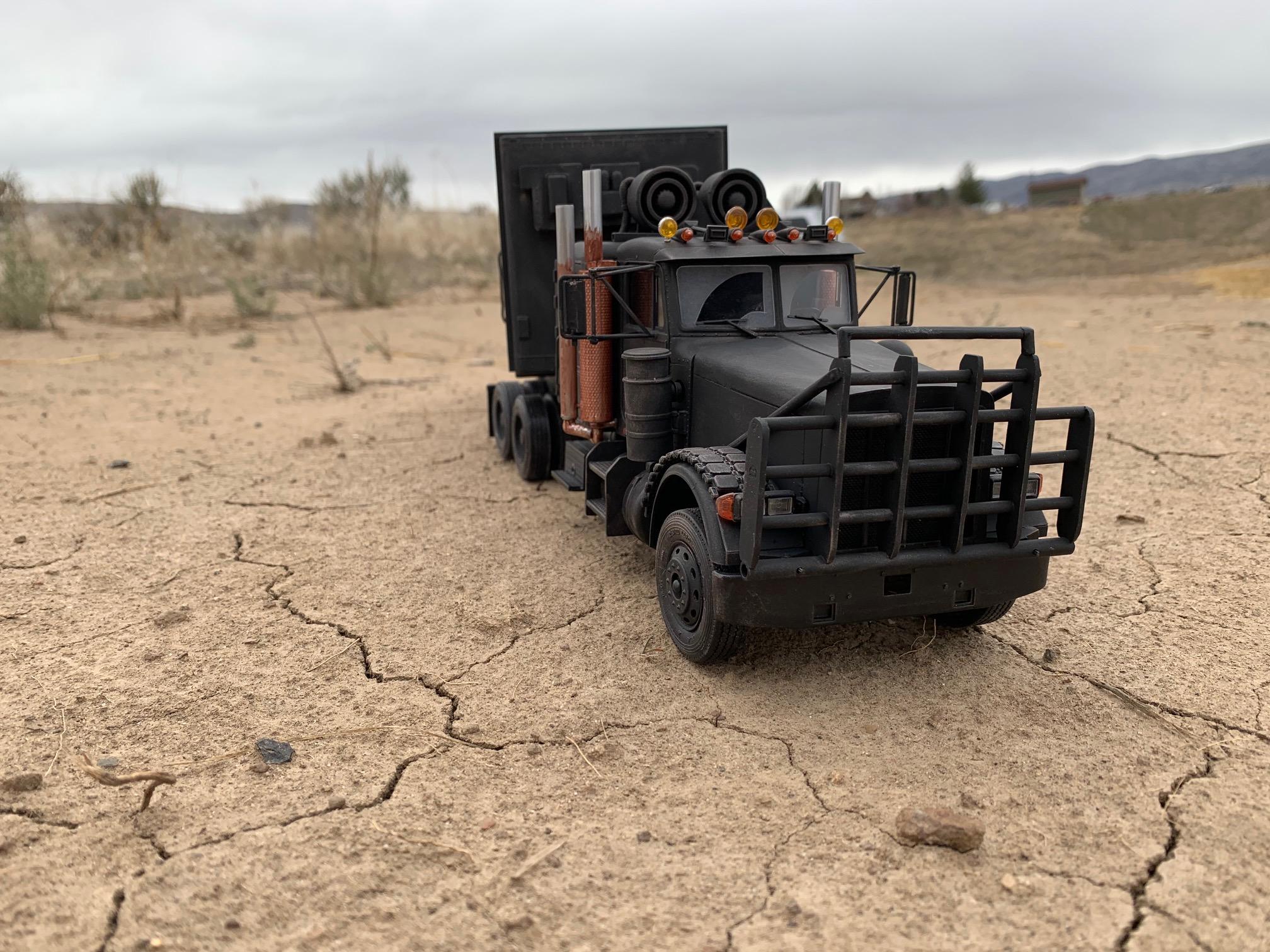

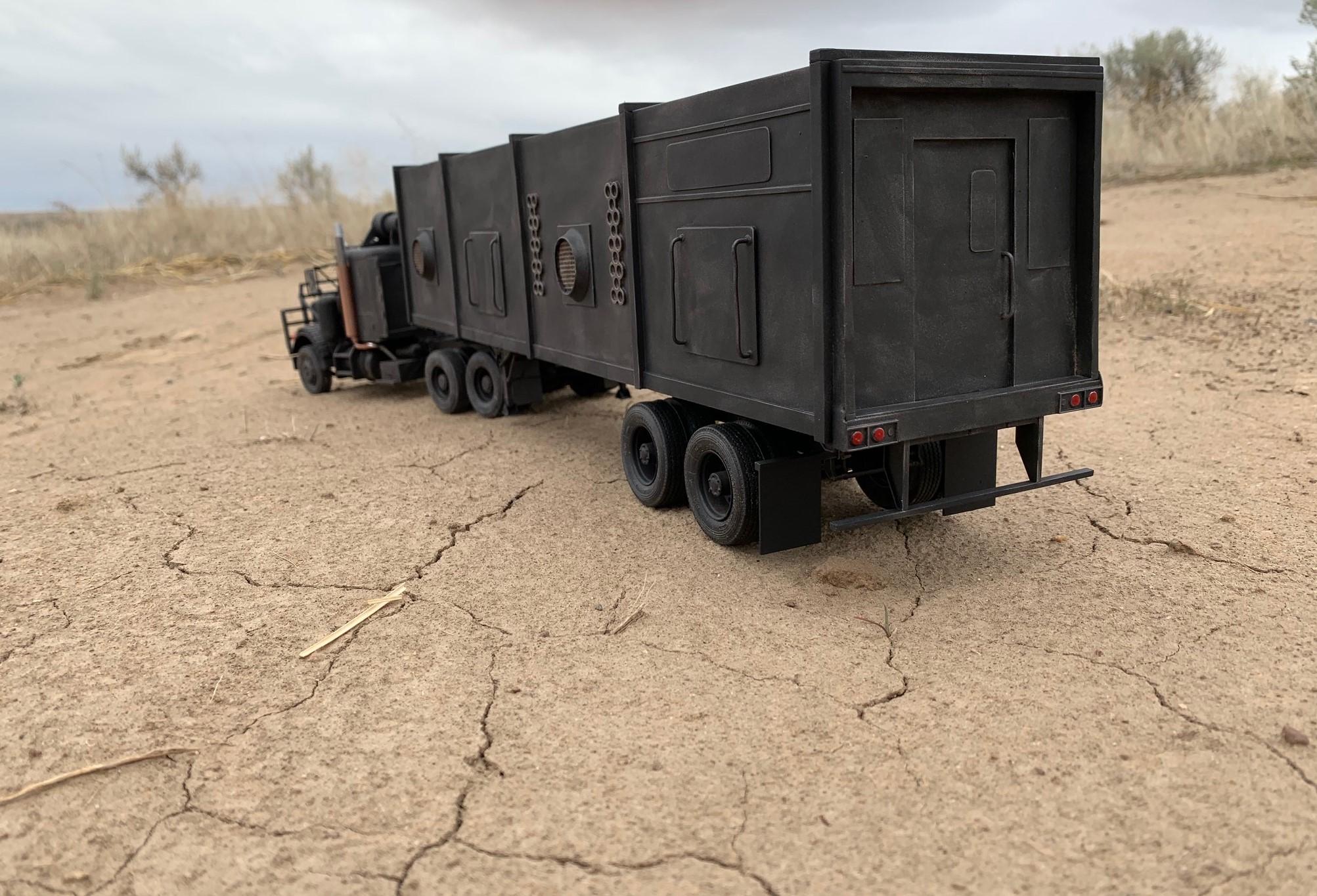

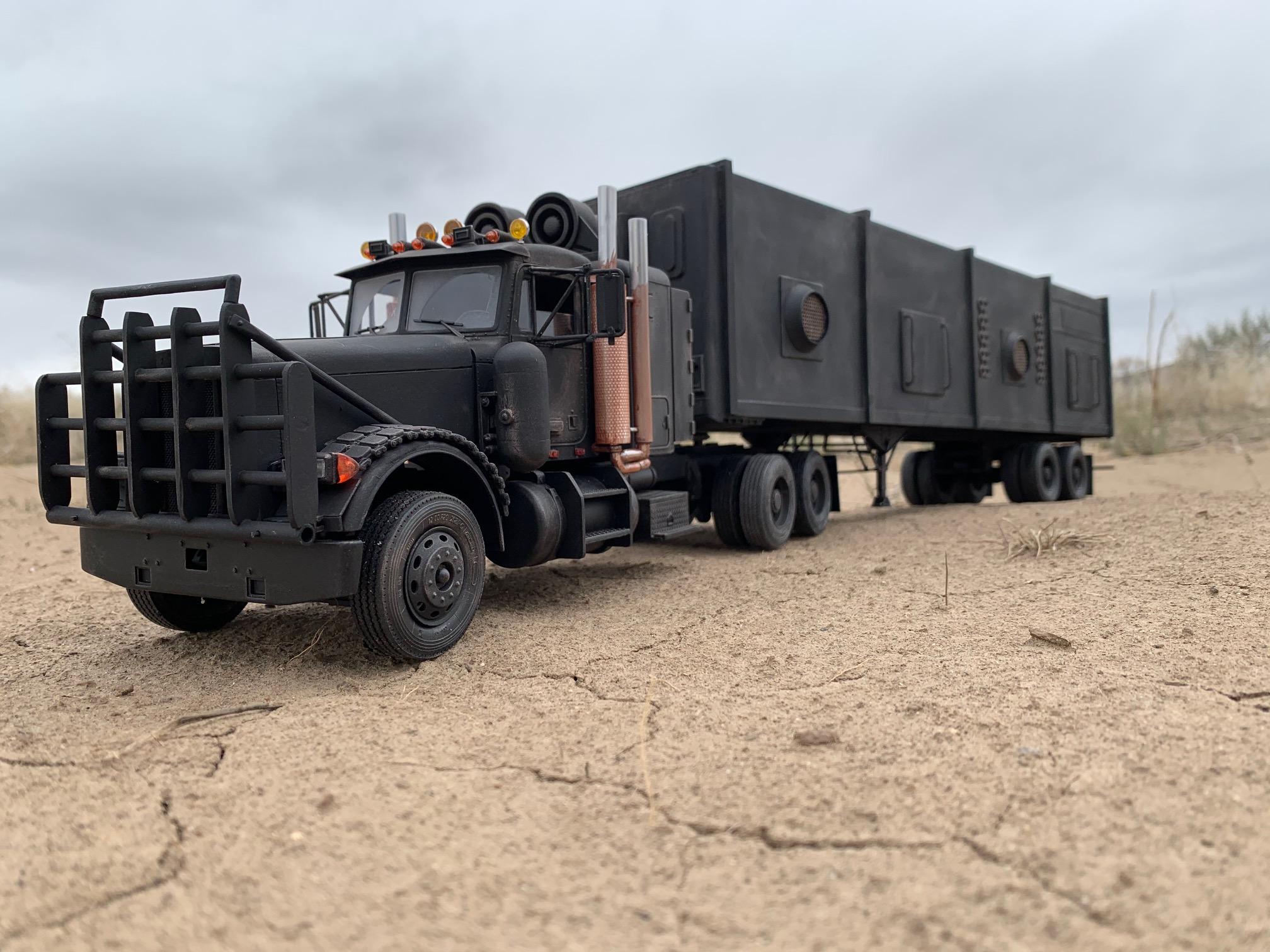

I season 6 of Marvel's Agents of S.H.E.I.L.D Clark Gregg returns as "Sarge" and he is driving a 379 Peterbilt from another dimension. The truck is heavily modified and has a one-off trailer. The truck is a large part of the 6th season and I figured this would be the subject of my build.
I started with the Italeri 378 and extended the hood and moved the cab back to created the 379. I had to find an old issue of the kit as I needed the flat top sleeper and not the high top. I custom built the front bull bar, side tank on the cab, fender details and all other details to match the TV truck.
Nearly all of the trailer was scratch built. with an Italeri trailer donating parts to get the base. The details on the sides were cut on a waterjet to get the correct size, shape and details. Solder hand rails and other details created the look from the show. Lots of scratch built parts and parts bin parts went into this build.

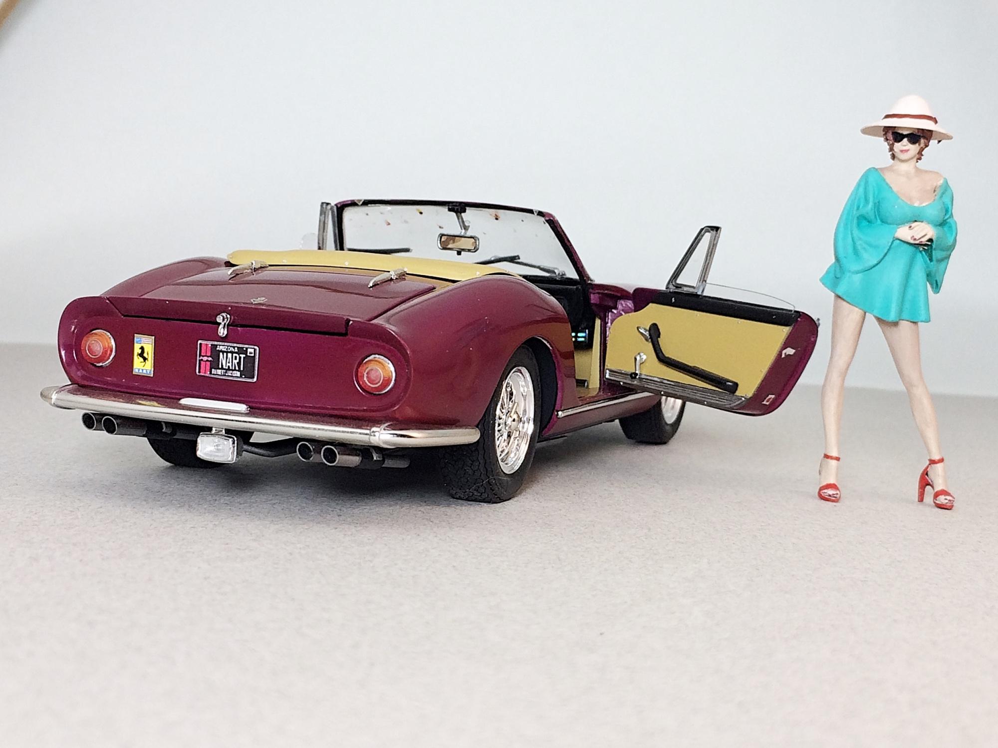

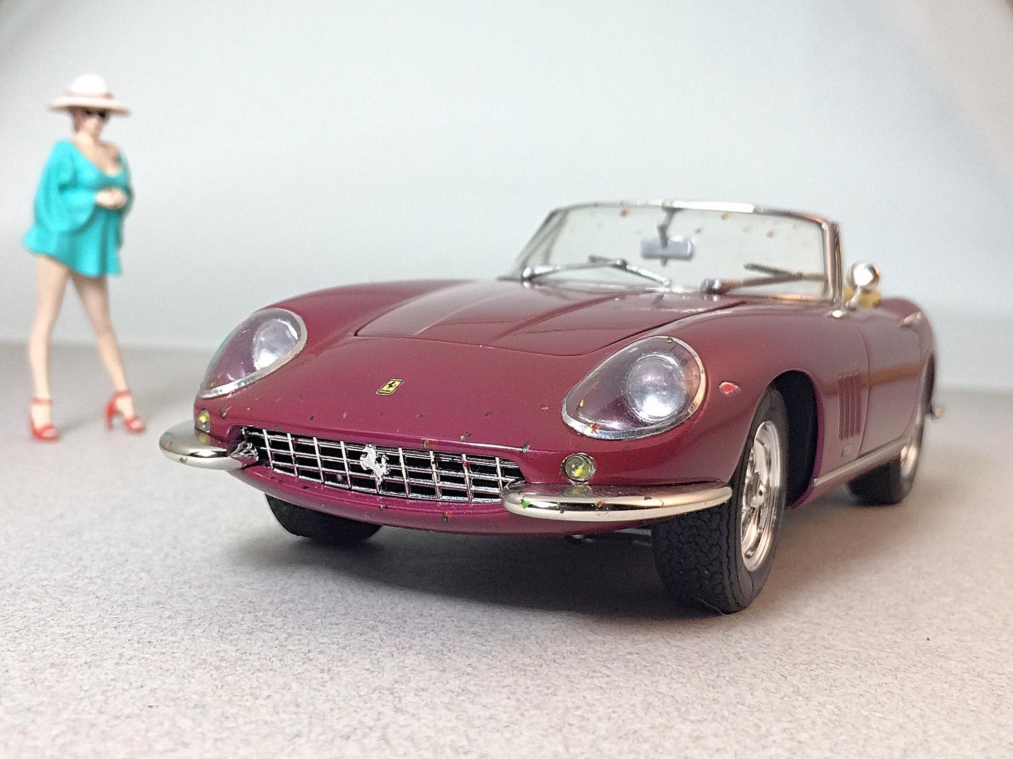

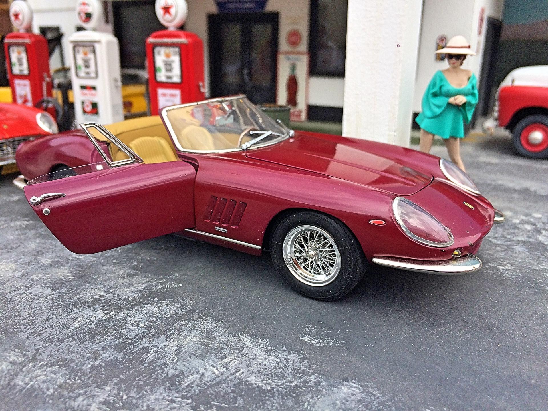

Model kit is the  Italeri - Ferrari 275 GTS (Spyder N.A.R.T.), finished March 11.  Whenever I read about the Spyder, there was usually a reference to the Thomas Crown Affair, starring Steve McQueen and Faye Dunaway.  I rented the movie just for research, felt totally ripped off because the car got about 20 seconds of screen time, and was never started or driven, so no musical V12 sound, no chase, nothing. ?  The movie car has the alloy wheels, so this is not an exact replica, but owners often switched wheels, and repainted and upholstered different colors to suit them, so I could argue it's a later period of ownership.  In fact, Steve McQueen owned a NART.  So it barely qualifies for this group build, but I did it for me.
The most common screenshot from the movie, which came after the following scene:
A much better shot of the whole car:
In situ needing Ethyl.  Fujimi wheels and tires from the Daytona kit.  Most of the cars I researched did not have a radio antenna.

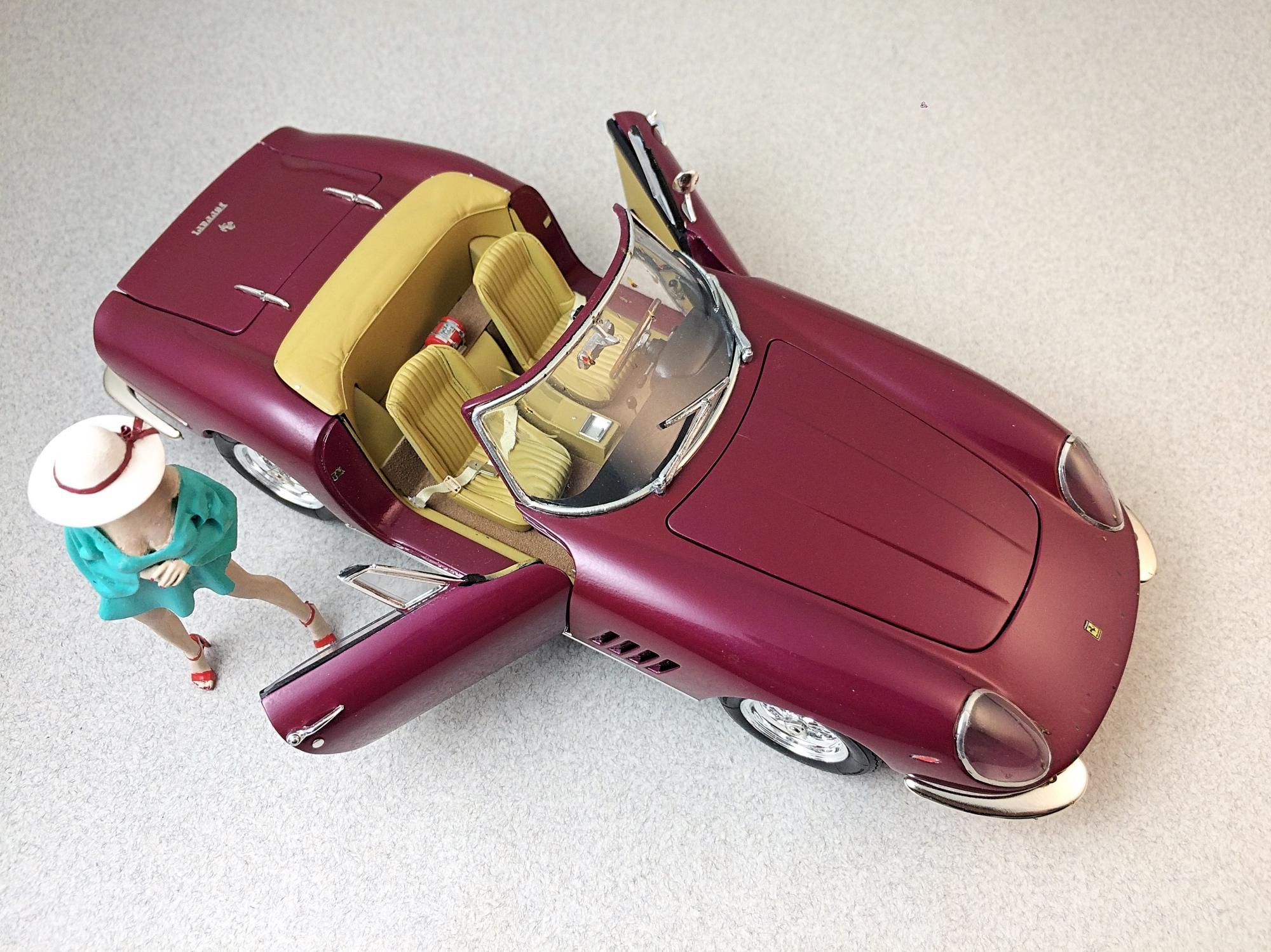

I opened the doors and trunk.  Had paint issues, also didn't like the first result so stripped it, got a better match the second time.  Aftermarket emblems on the trunk.  Added piping to the seats, and belts.  Added a fire extinguisher, because the last one sold for $27.5 million auction! ?
Sent the bumpers, window cranks (which were separated from the door panel), door mirror to get chrome plated.  Current AZ Barrett-Jackson license plate.  Stainless steel exhaust tips.
Vacuum-formed the headlight covers, made reflectors for the headlights.  Made the teardrop side lights.  Added bug splats, because it's driven.

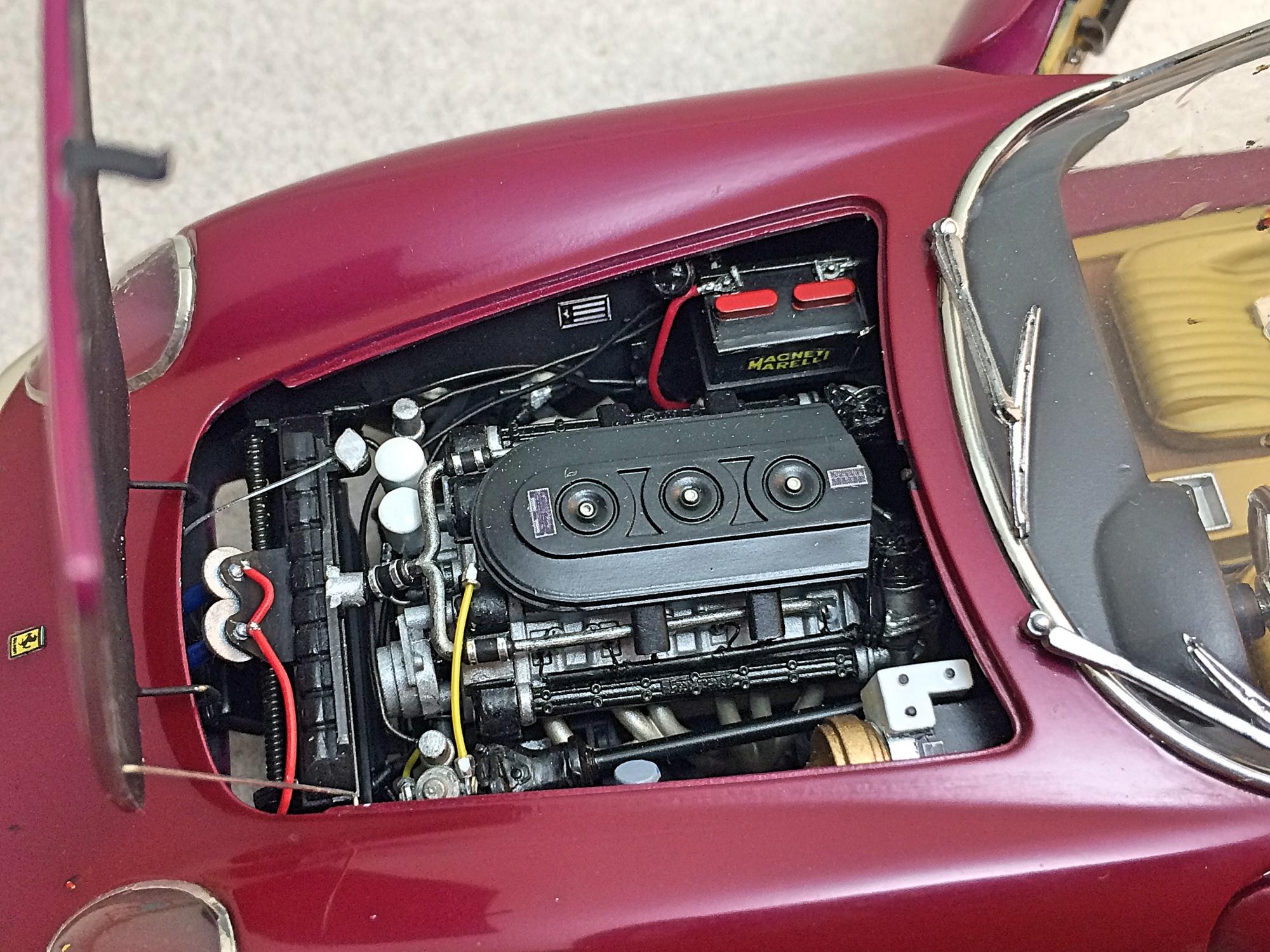

Added plug wires with Historic Racing Miniatures distributors contributed by a forum member. ?  Added fuel pump and lines, radiator hoses, air horns, transmission cooler, battery cables, steering shaft and box, plaques, oil sump tank, washer bag, and hood prop rod.

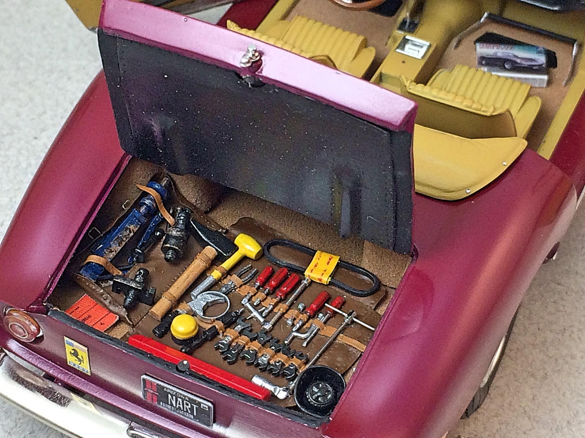

The Fujimi Daytona has most of the tools for the kit, which sells for the price of a decent car!  Made the missing tools such as the wood handle hammer, oil filter wrench, some jack parts, hazard sign box, fan belt, spare fuse box, manual, etc., and the leather bag.  Gas cap, and trunk liner to boot. ?
The interior passenger foot rest was a molded on part, made a separate unit.  Final touch is the model box.

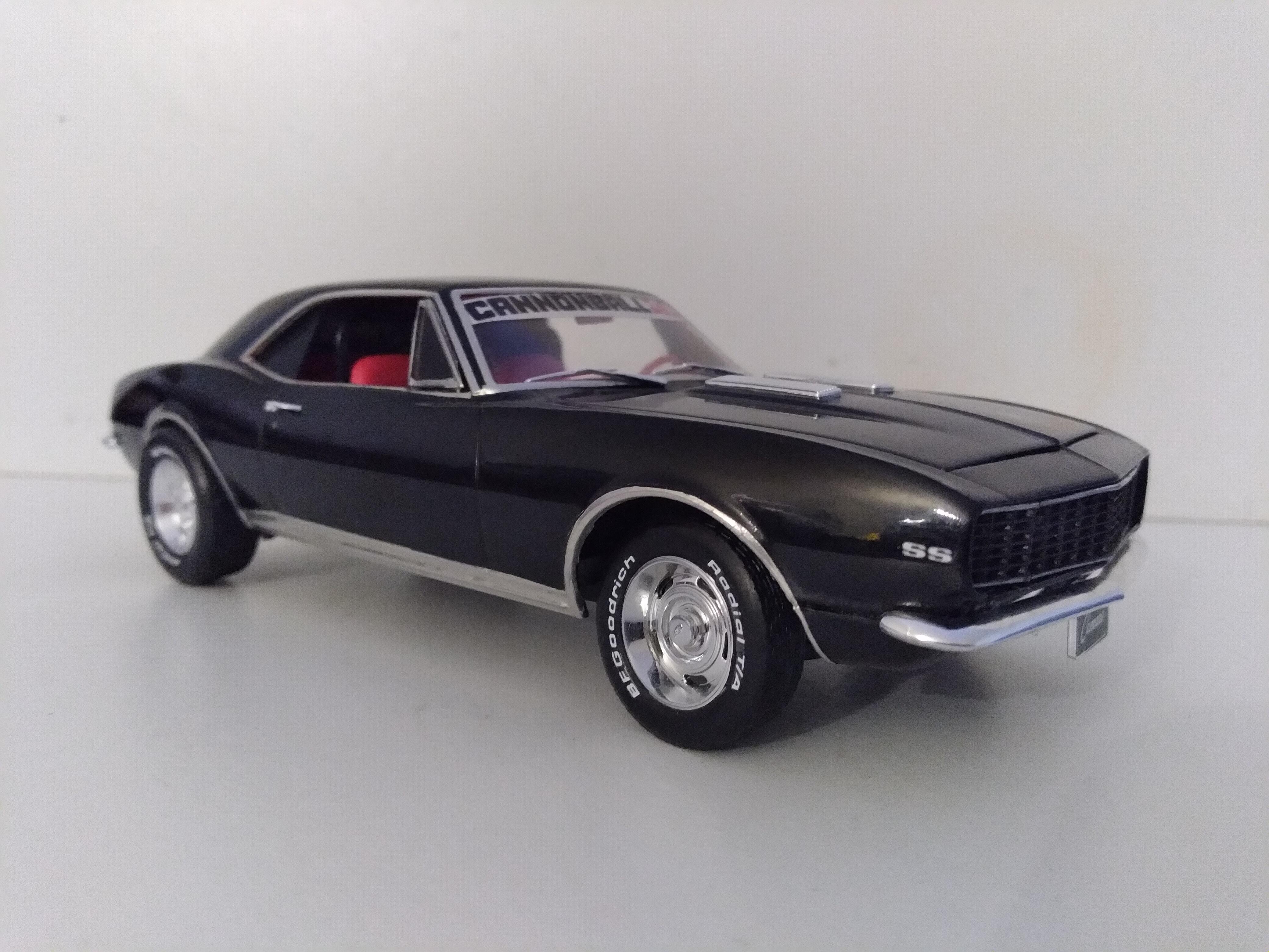

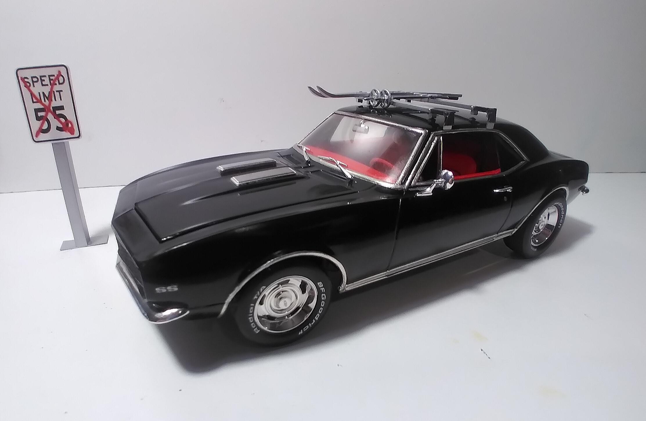

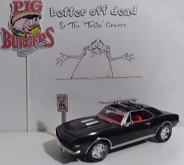

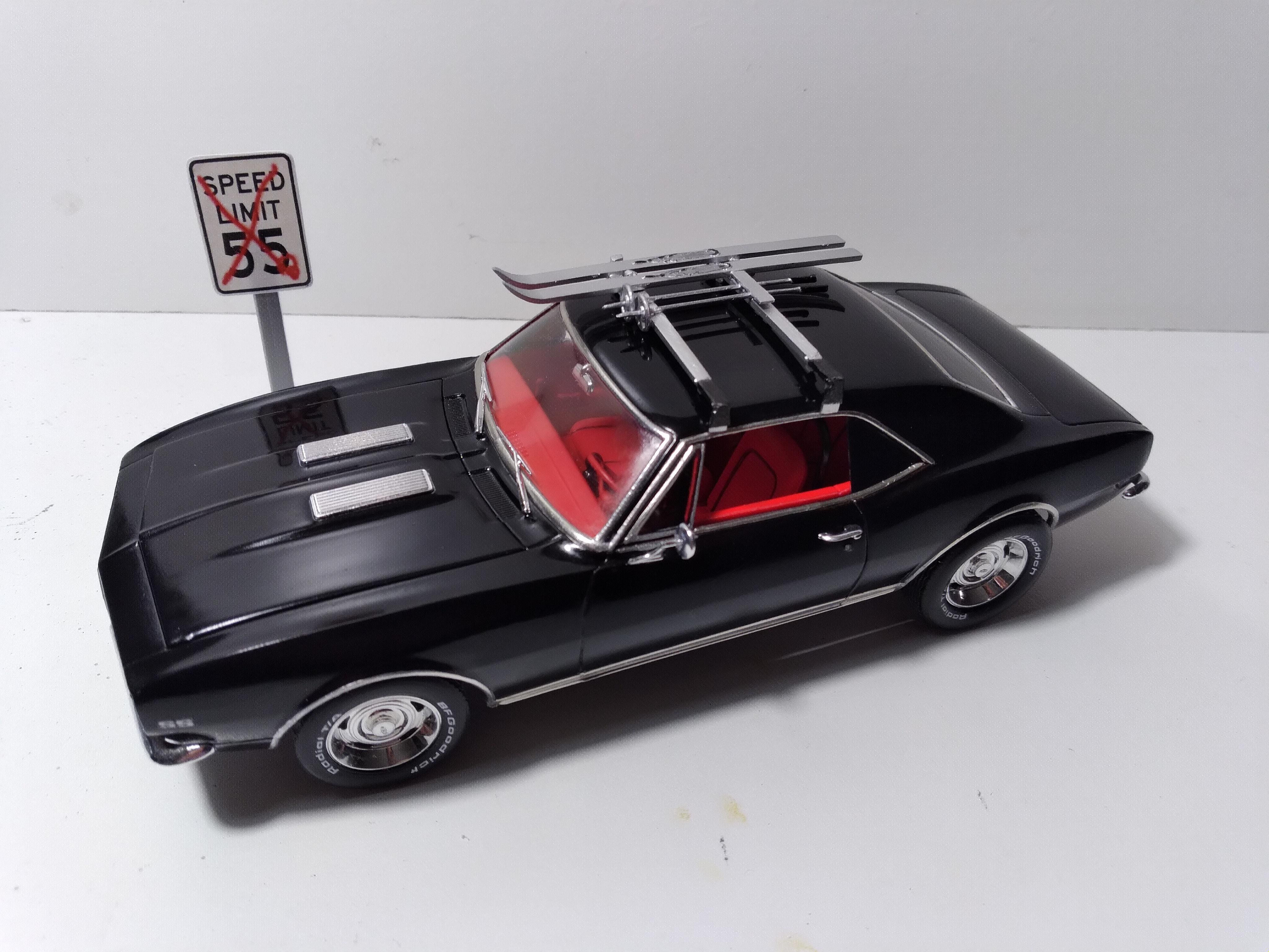

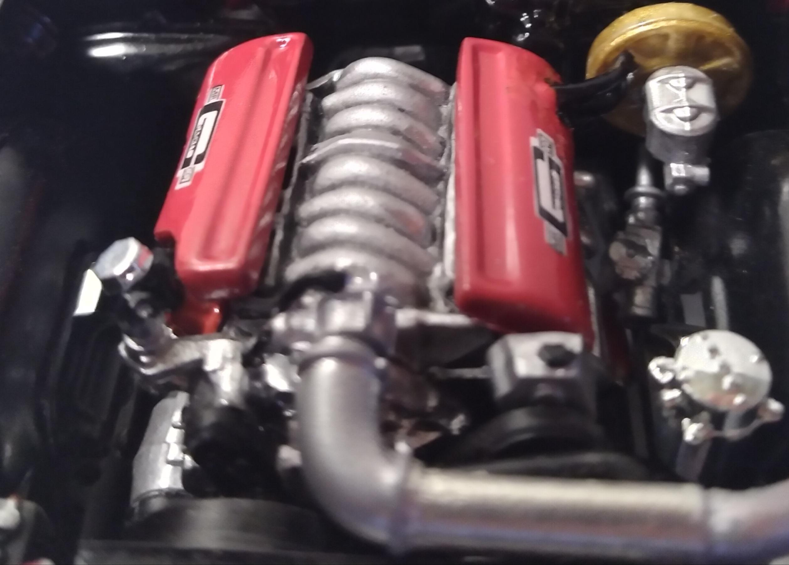

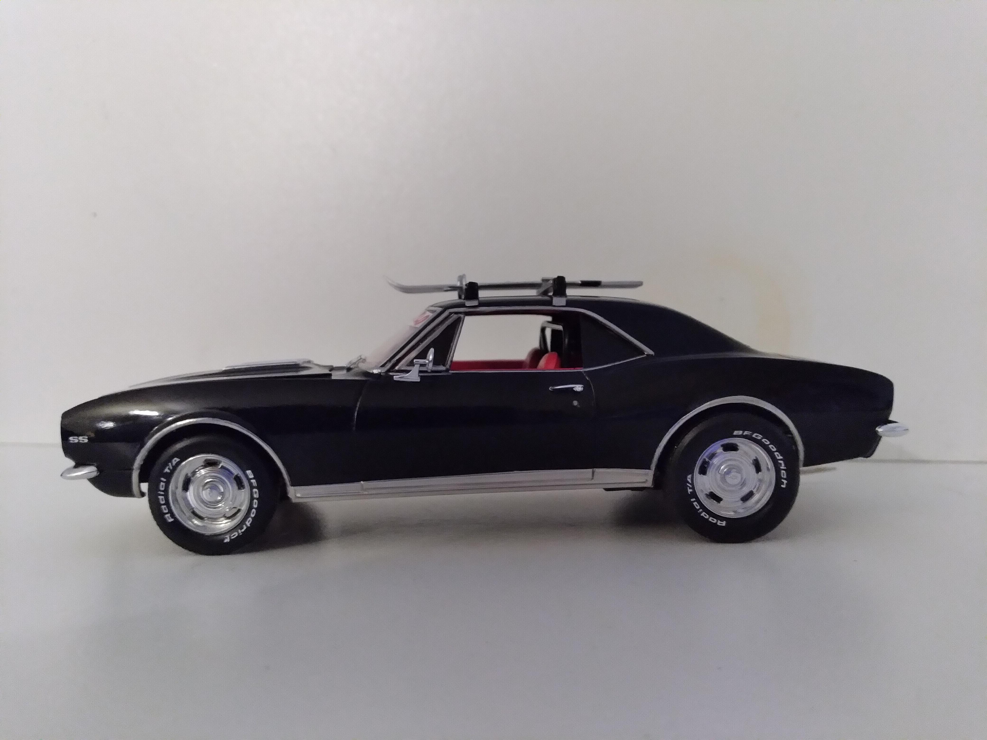

Cue Muddy Waters:  I built Lane Myer's 67 Camaro from better off dead " I started with the Revell 67 Camaro.  It went together very well.  For the "Twist" I swapped out the stock engine for an LS from the Monogram/Revell 2002 Camaro Z28. I figured it would be the most reliable for going the distance and the 6 speed gearbox will be good for interstate cruising. I used BF Goodrich white letter tire decals(as seen on the movie car) from Mike's Decals. I swiped the wheels from the Revell 67 Chevelle and tires from Revell also. The ski rack is from an old MPC Dodge. The Mr. Gasket decals on the coil pack covers is my way of paying tribute to the original engine. In the garage scene Lane and Monique are mounting a "Mr Gasket" air cleaner.
I had alot of fun with this one, I bet I watched  the movie 10 times this year, when I would work on the kit, I had the movie playing in the background.

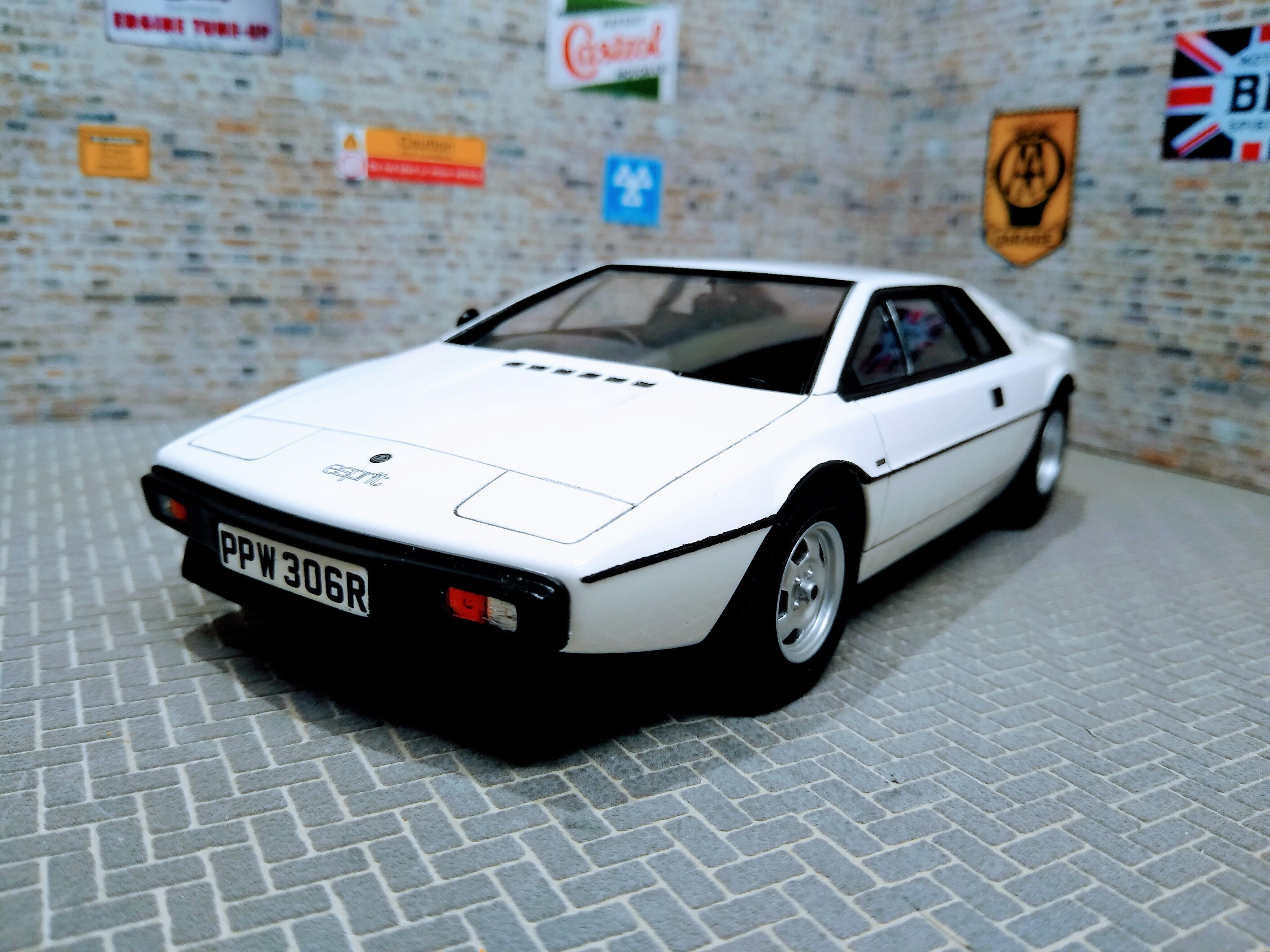

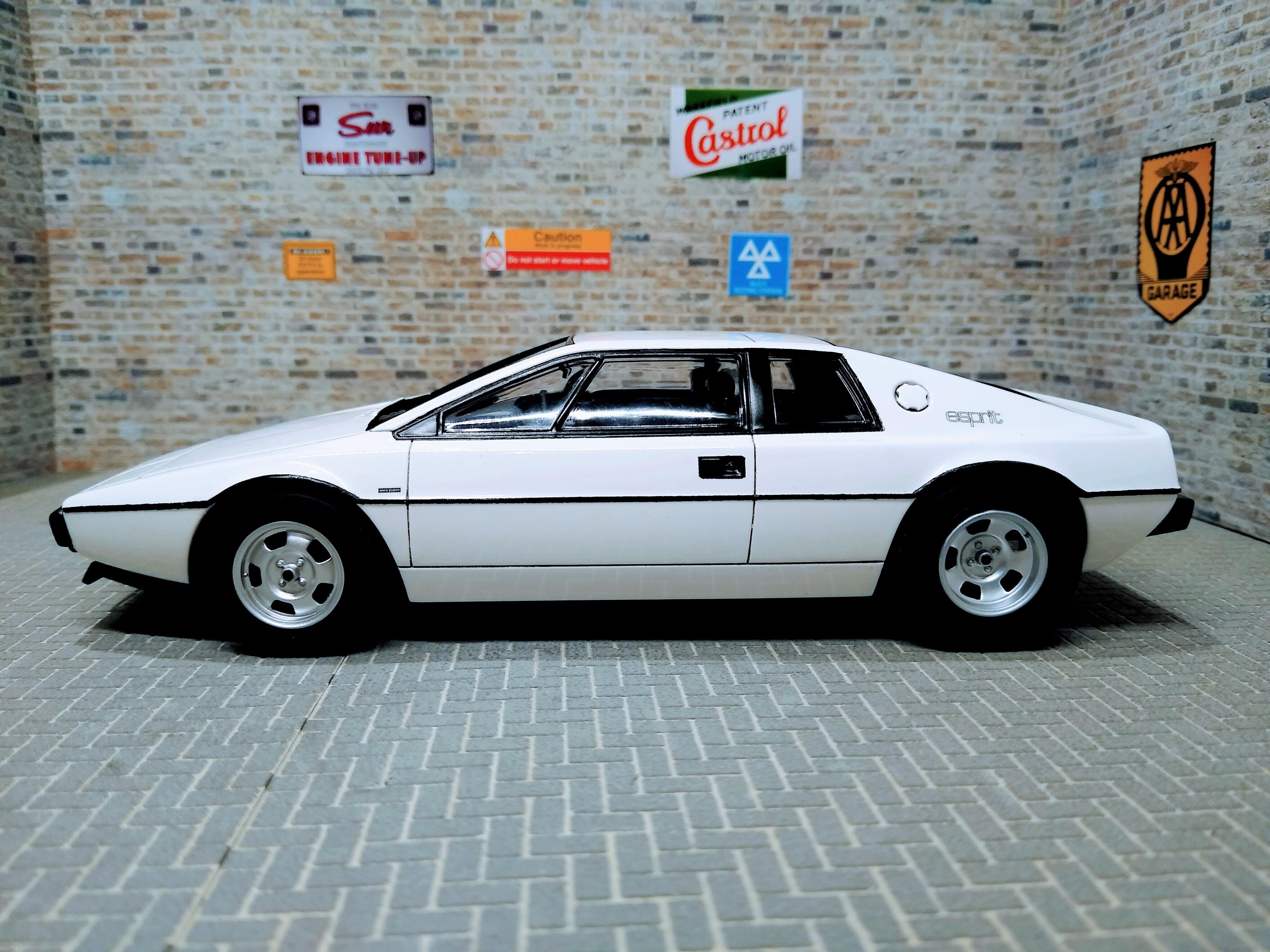

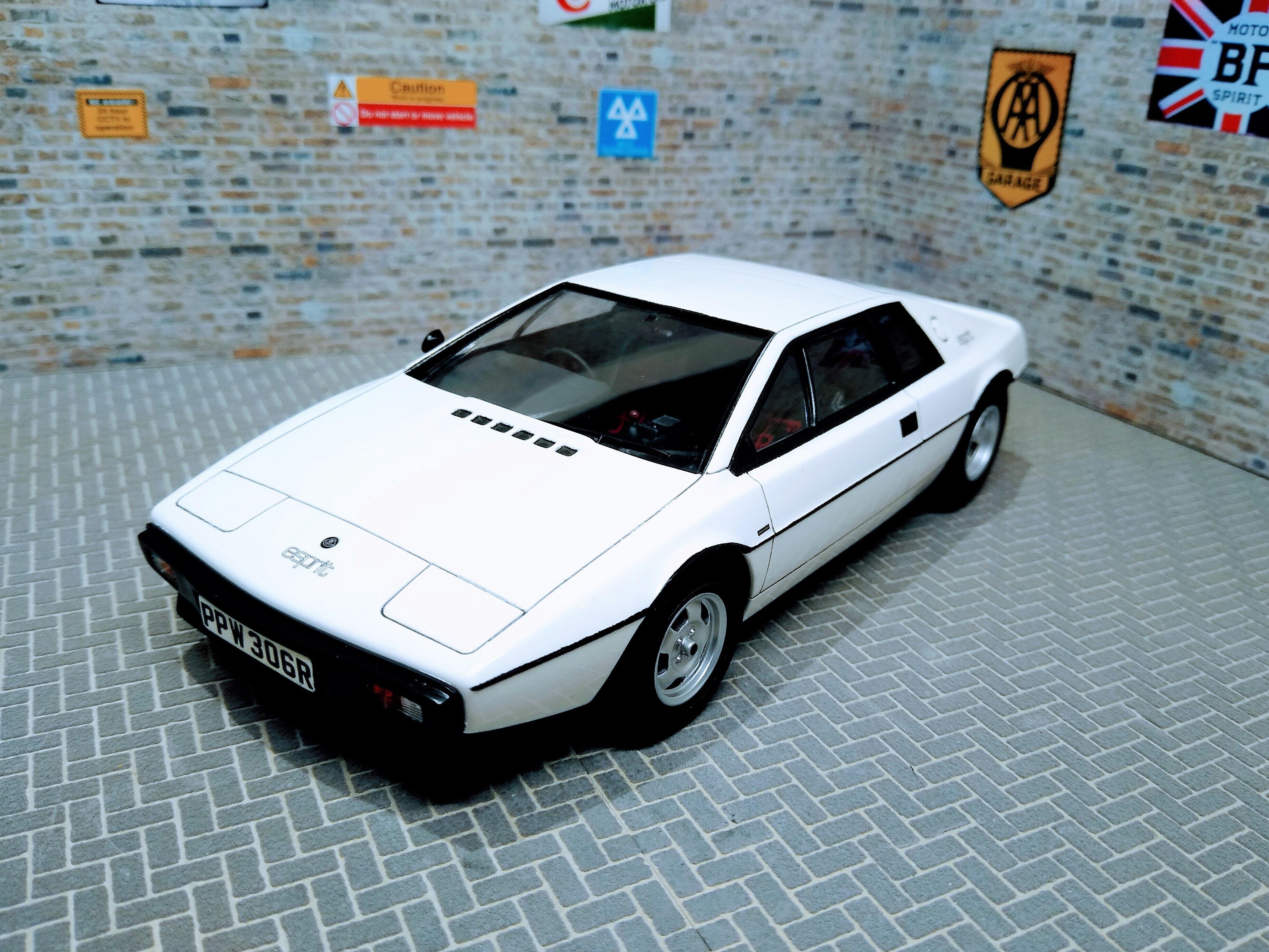

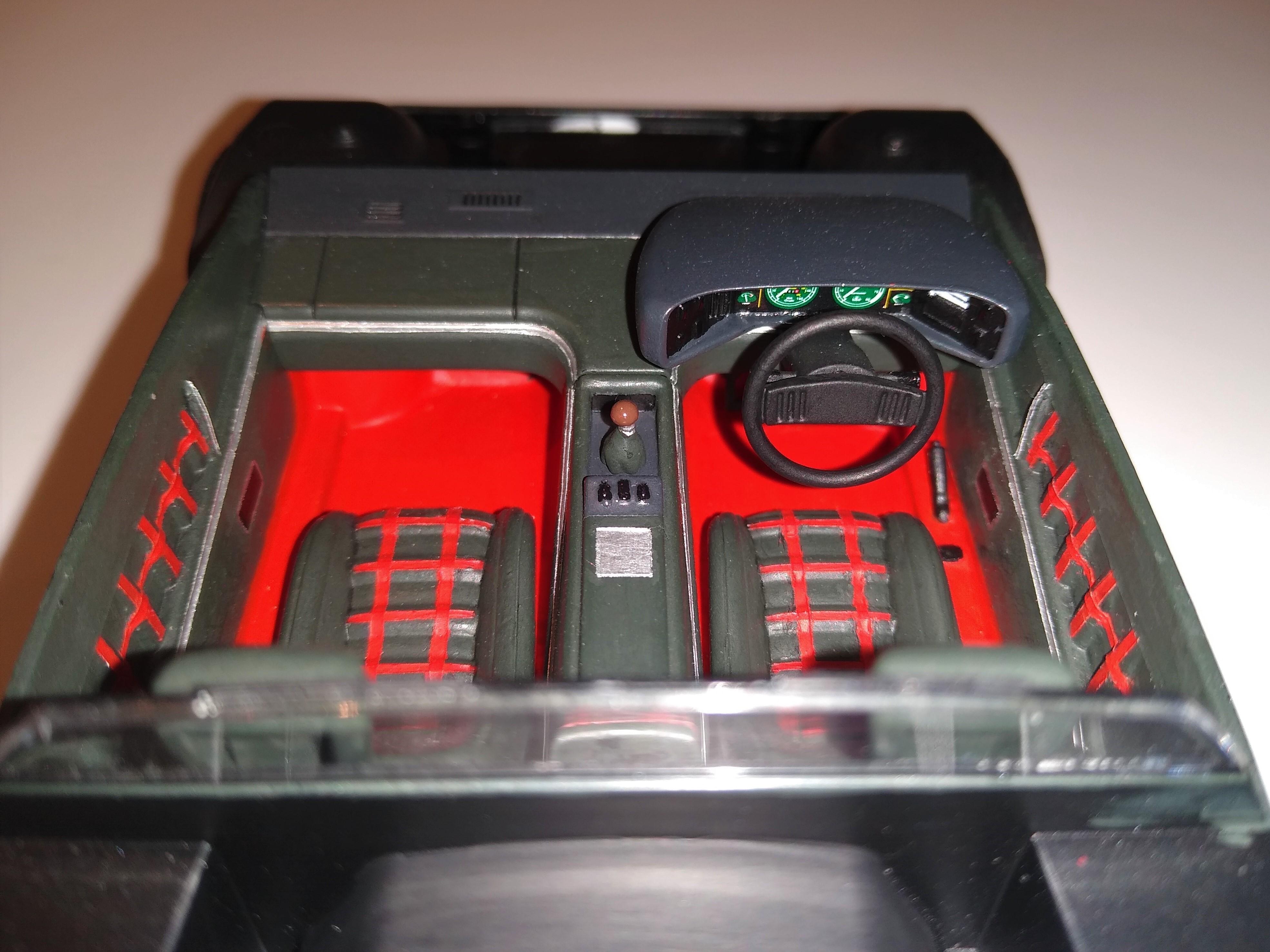

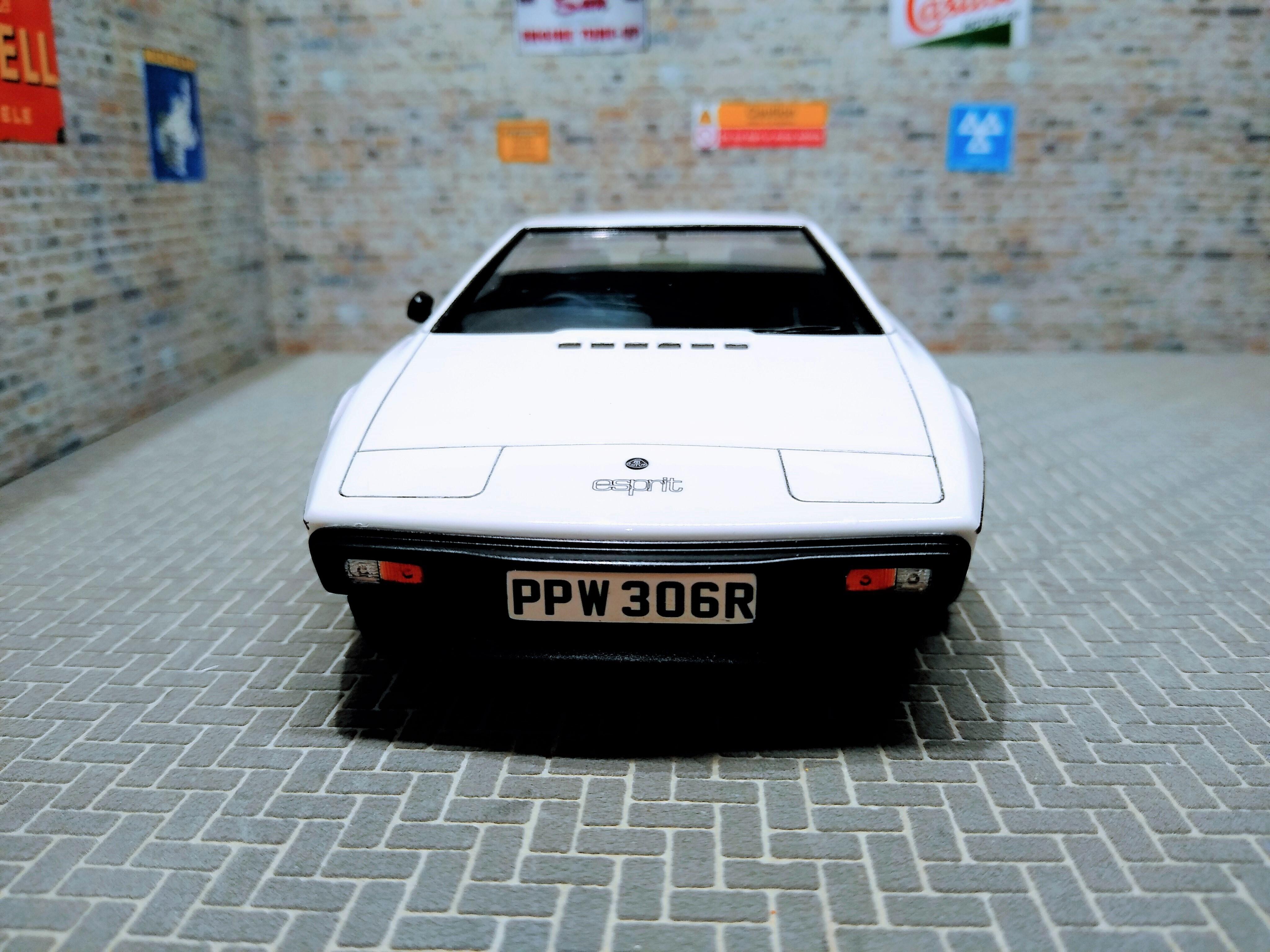

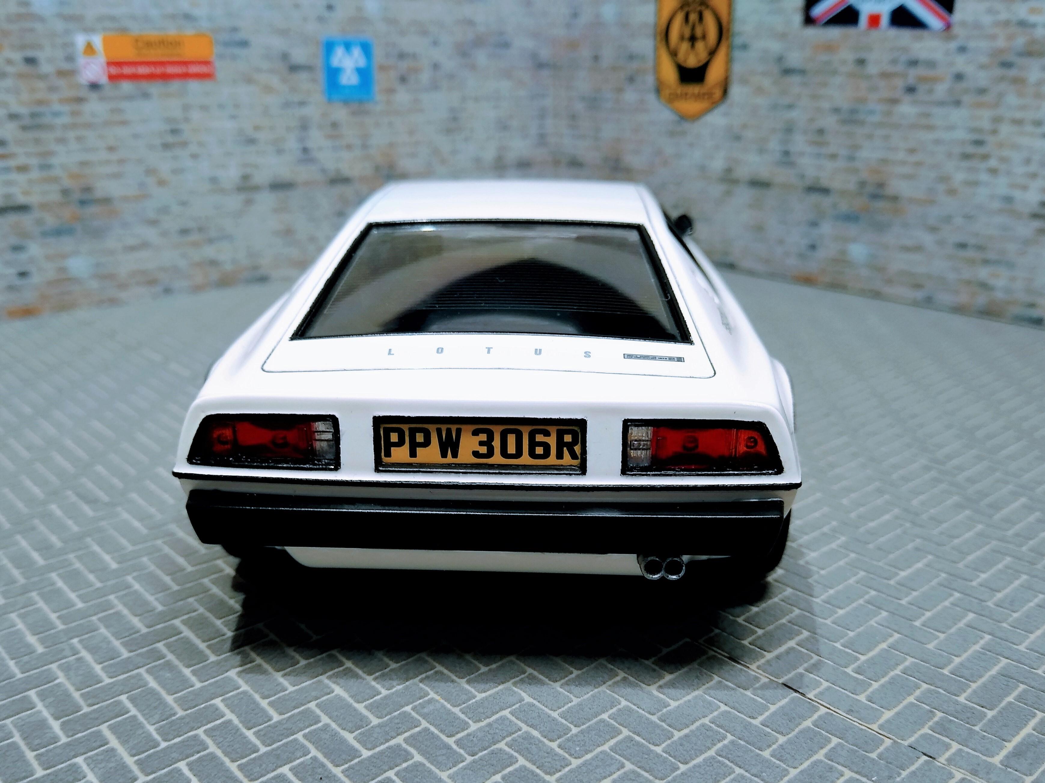

Lotus Esprit S1 from The Spy Who Loved Me (1977).
"Wet Nellie" was amphibious and featured retractable wheels and a revolving dashboard etc., but in land mode she was essentially the same as the first production Esprits that rolled out in 1976. No "twist" here, I've just had fun trying to build a curbside replica using the Fujimi kit.
The exterior was painted and clear coated with Tamiya rattle cans, then sanded & polished before masking off everything for the black details. The interior was painted using a brush and a lot of micro masking tape for the (not quite) tartan and chrome. I mixed the colours to represent the actual car rather than how it appeared on screen. (Although the 007 upholstery looks grey, it’s only because the movie makers messed about with the colour grading of the film: the fabric was actually standard green/red tartan. And, yes, the carpet was orange!).

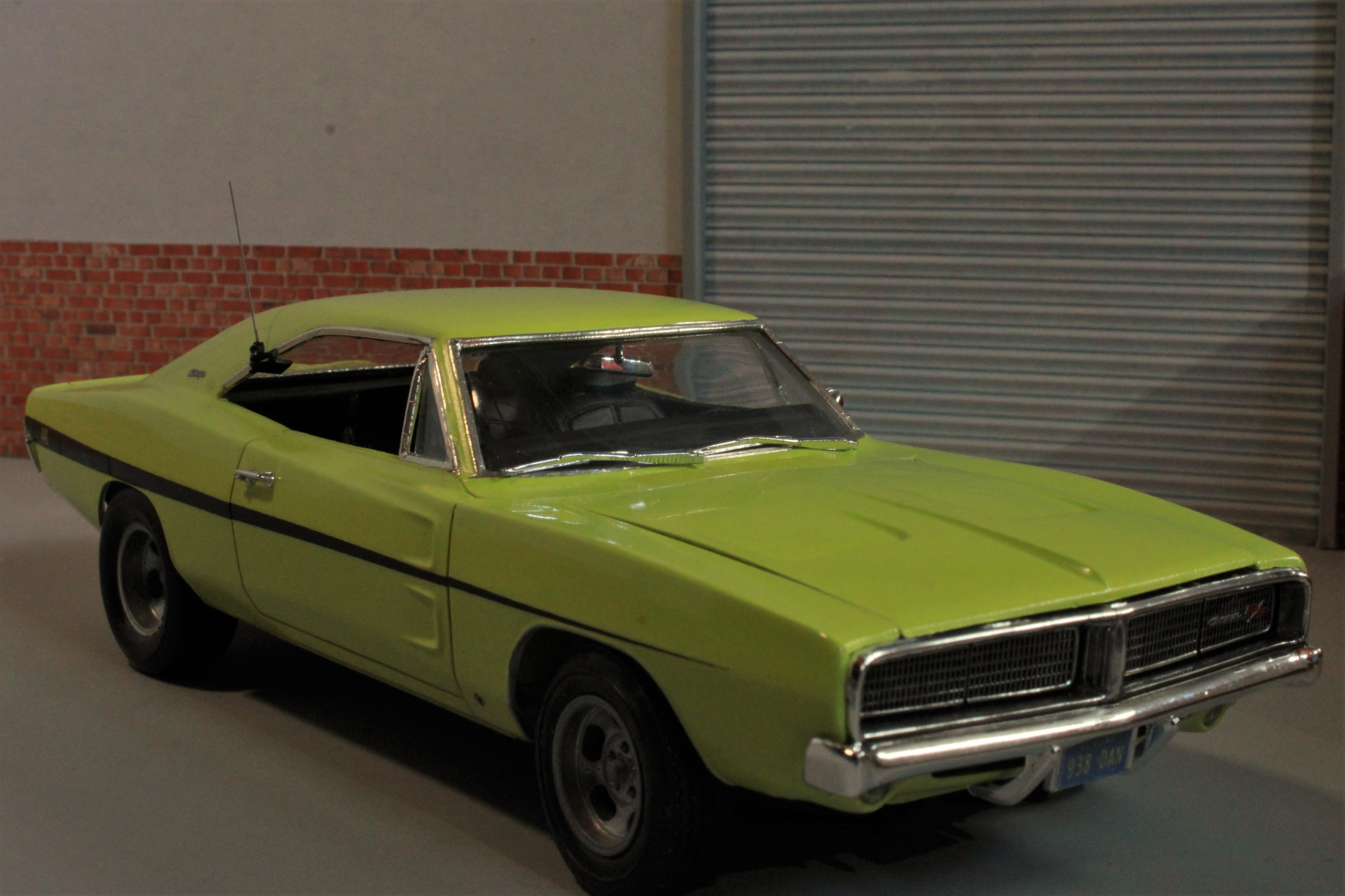

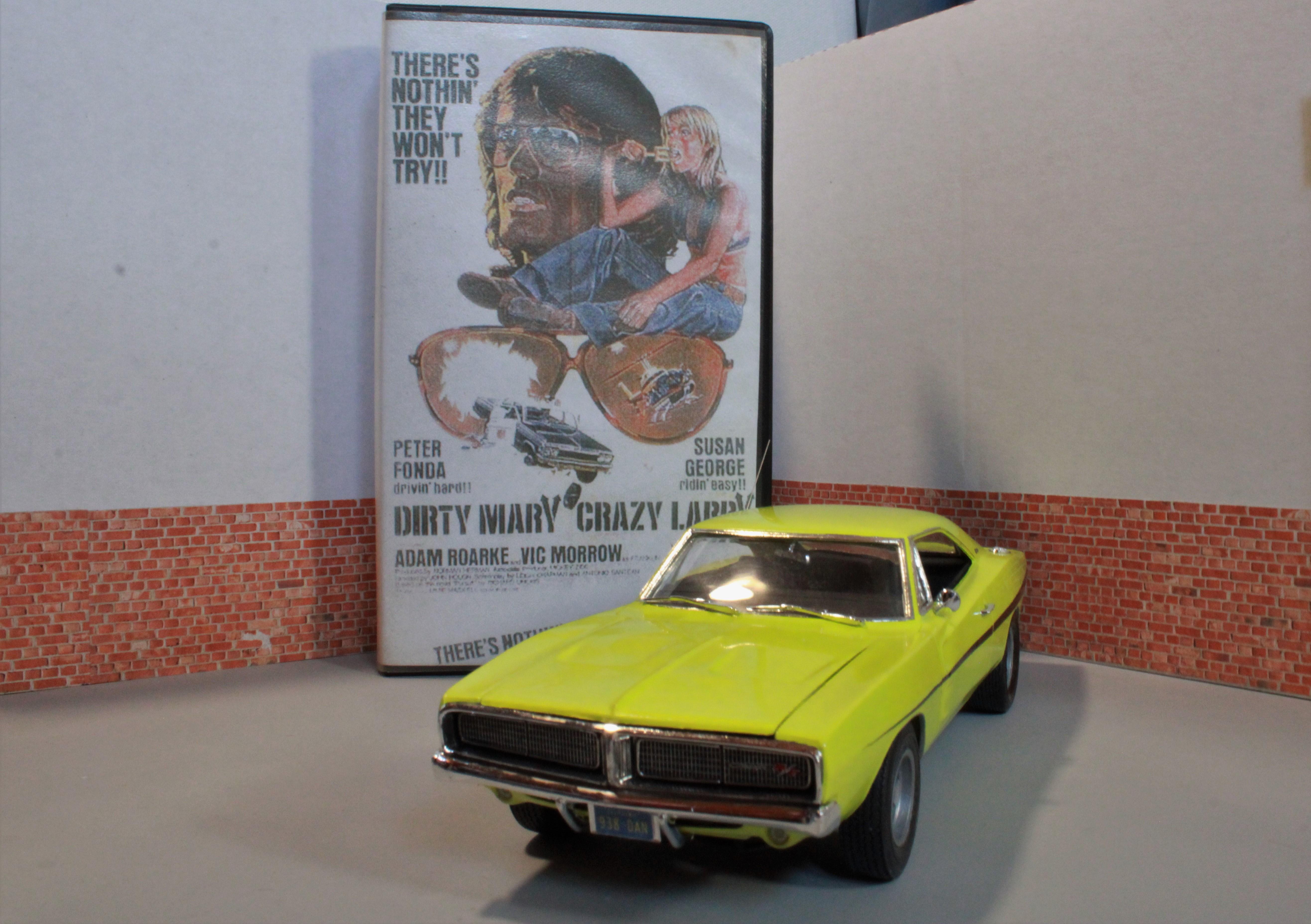

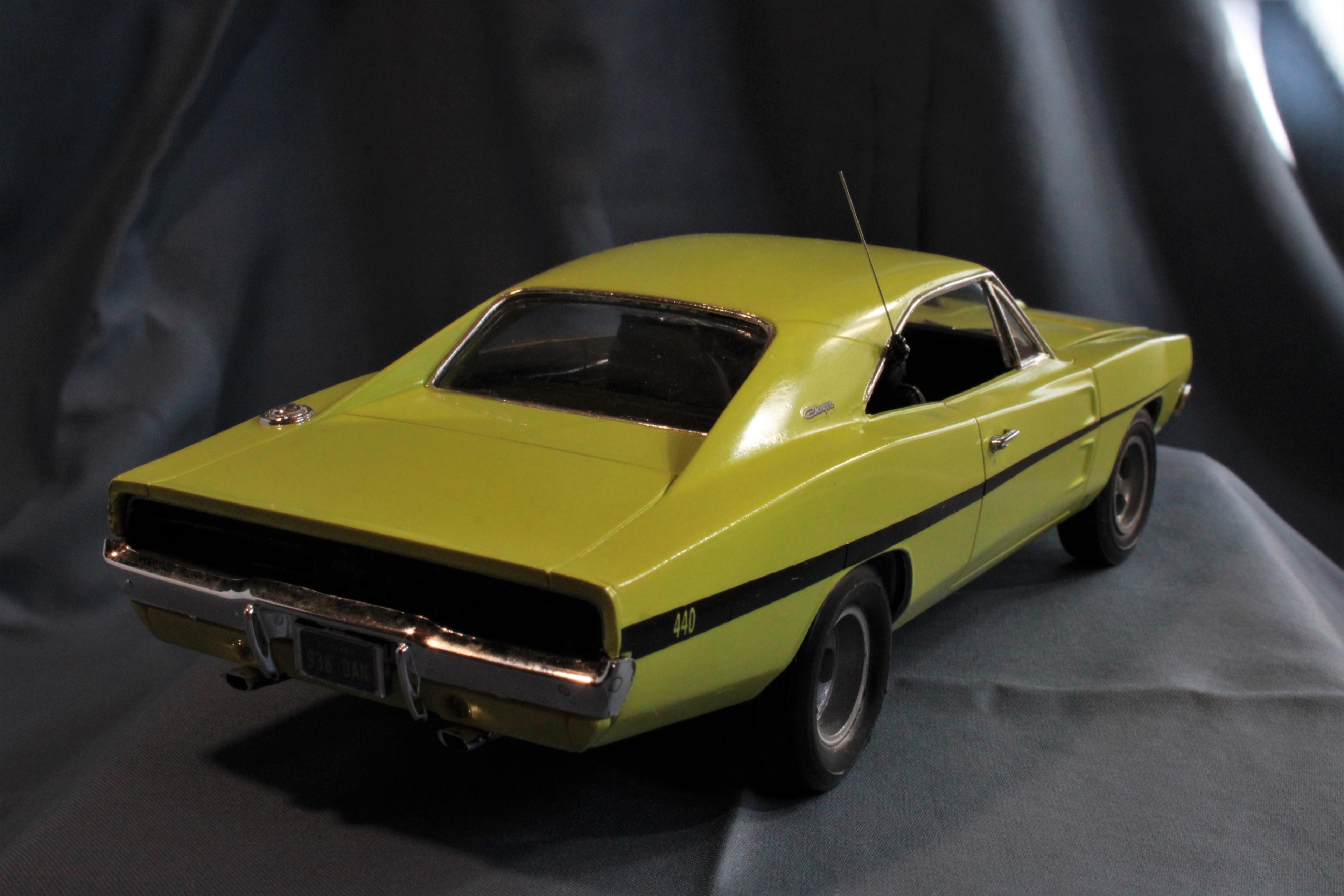

If you love car chase movies, then you must have seen Dirty Mary and Crazy Larry at least once, if not a dozen or so times like I have.  My rendition is mostly stock, the engine is detailed a bit with some wiring (MAD distributor), scratched fuel lines, Fireball Modelworks carburetor, wheels and tires.  CB radio is of course included with a scratch built antenna.  Paint is Vallejo Yellow/Green acrylic and depending on the lighting the car will look one or the other (kinda like the car in the movie).  Decals I think were from Mike's decals.  Turned out to be one of my favorite builds.  Hope you like it.

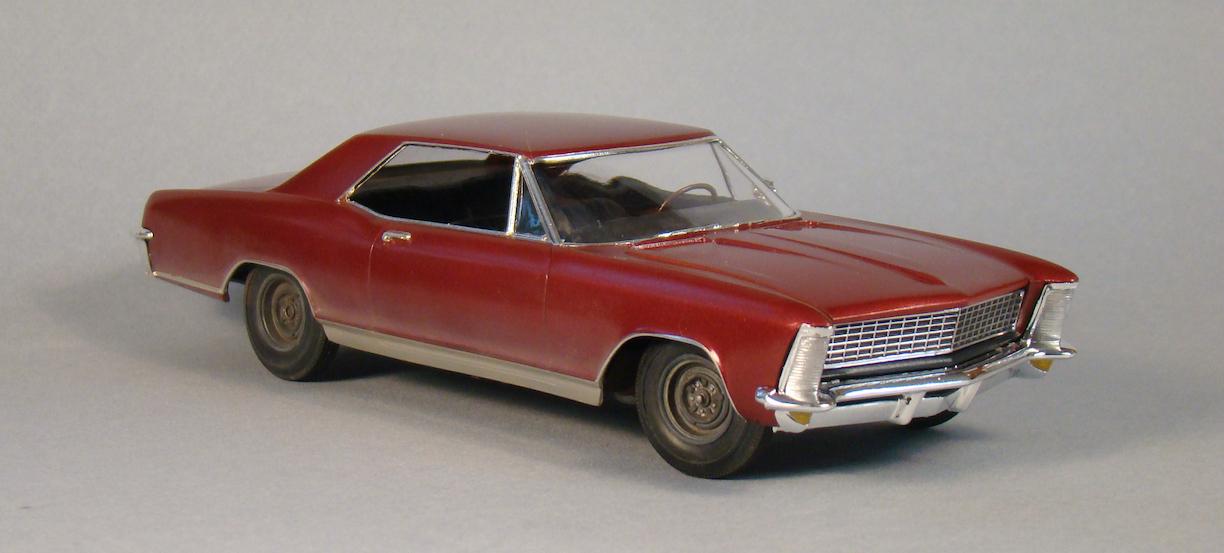

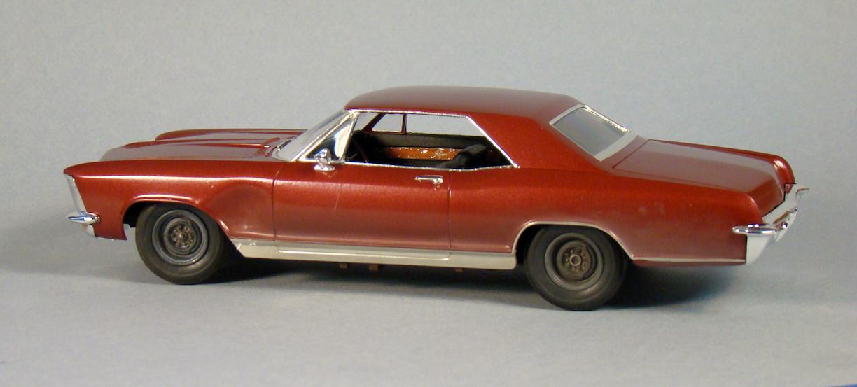

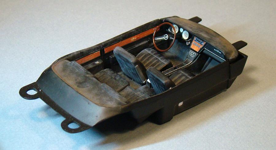

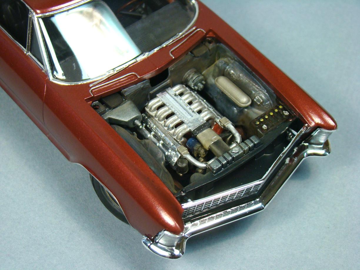

Dalton's 1965 Riviera from the movie Road House.
Early in the movie it has typical Buick rally wheels, but after getting slashed Dalton runs on replacement tires with steel rims. That's the version I've built here.
Rustoleum Dark Cherry paint. Home cast resin rims on parts box tires. Corvette LT5 engine. BMF. Interior trim and gauges designed in Adobe Illustrator, laser printed decals. Weathered and dusted with washes and pastels.

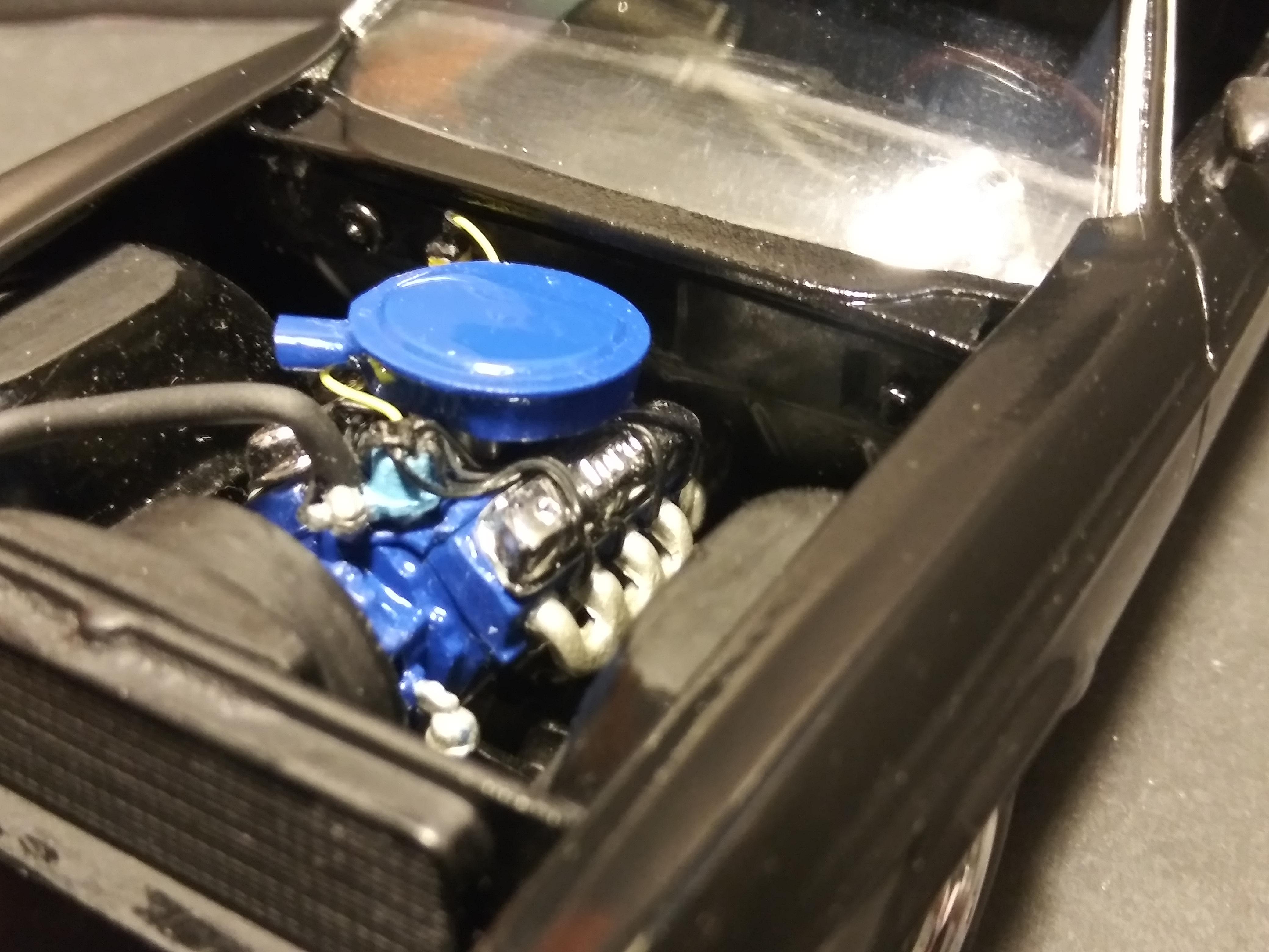

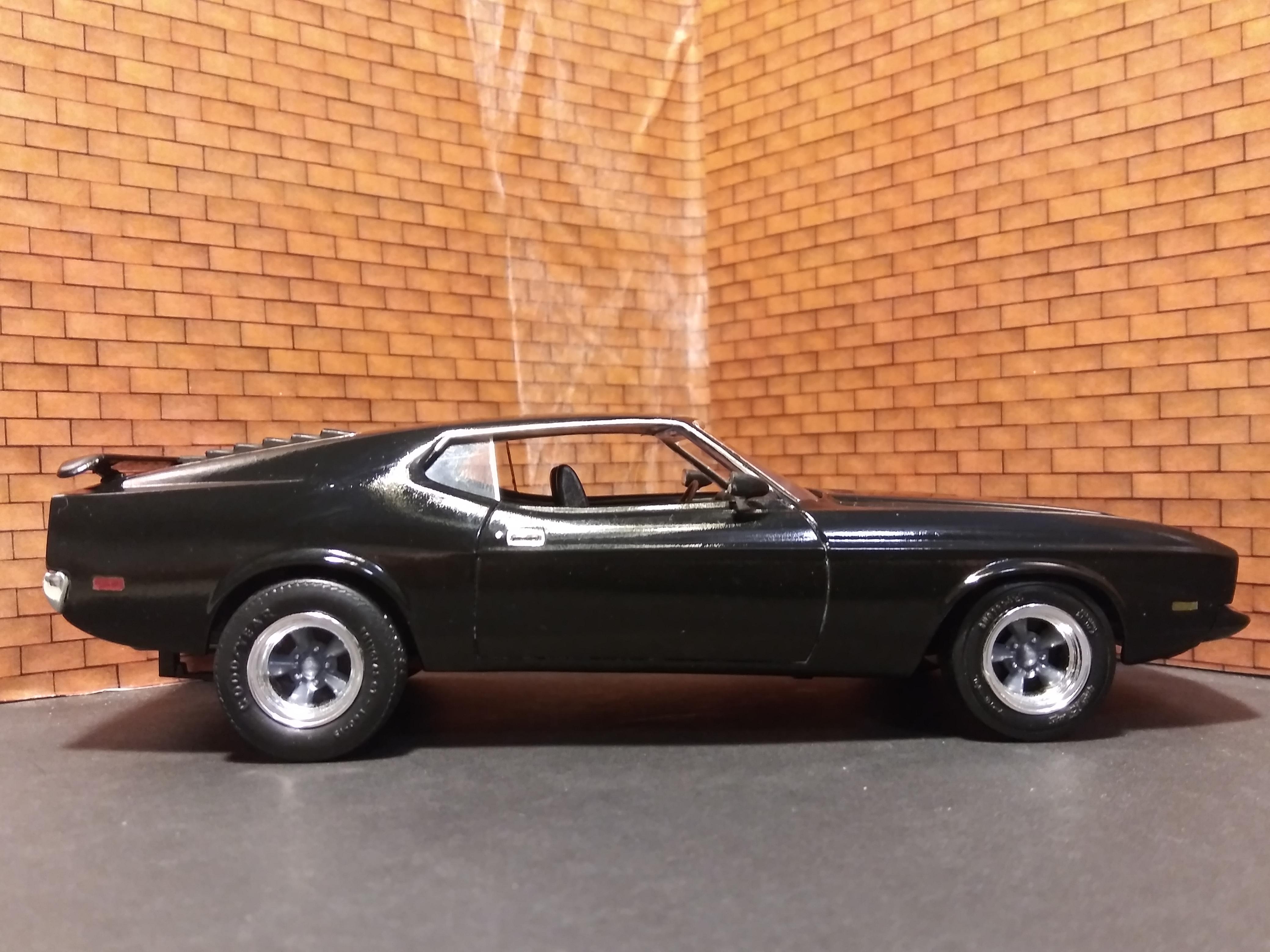

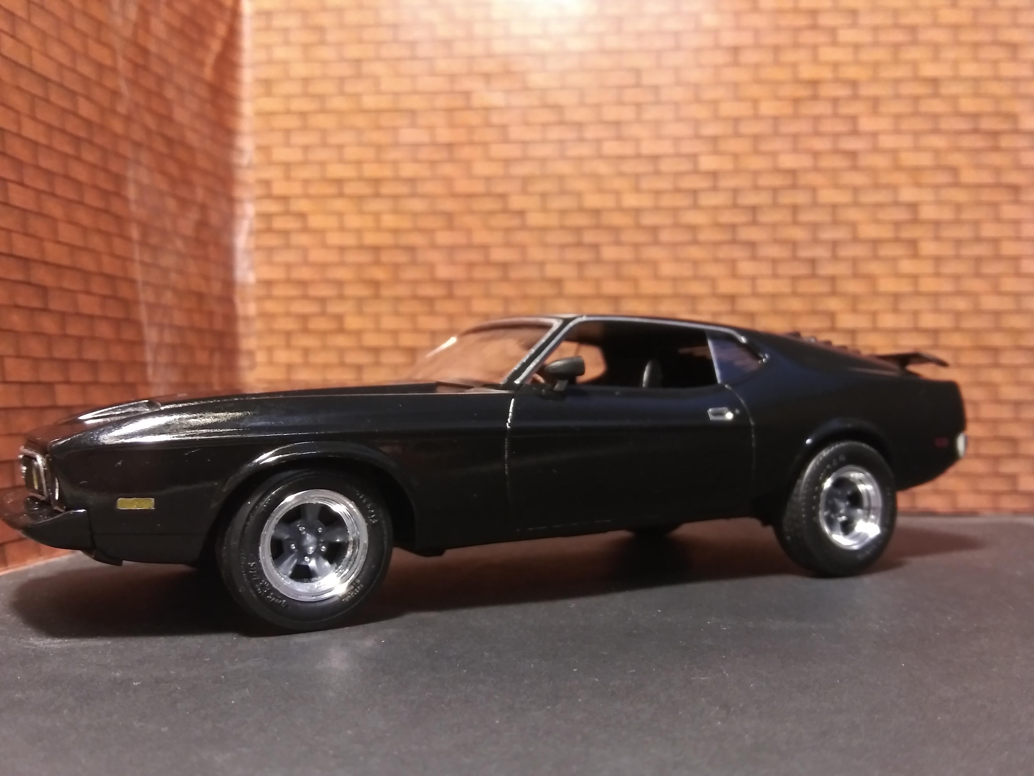

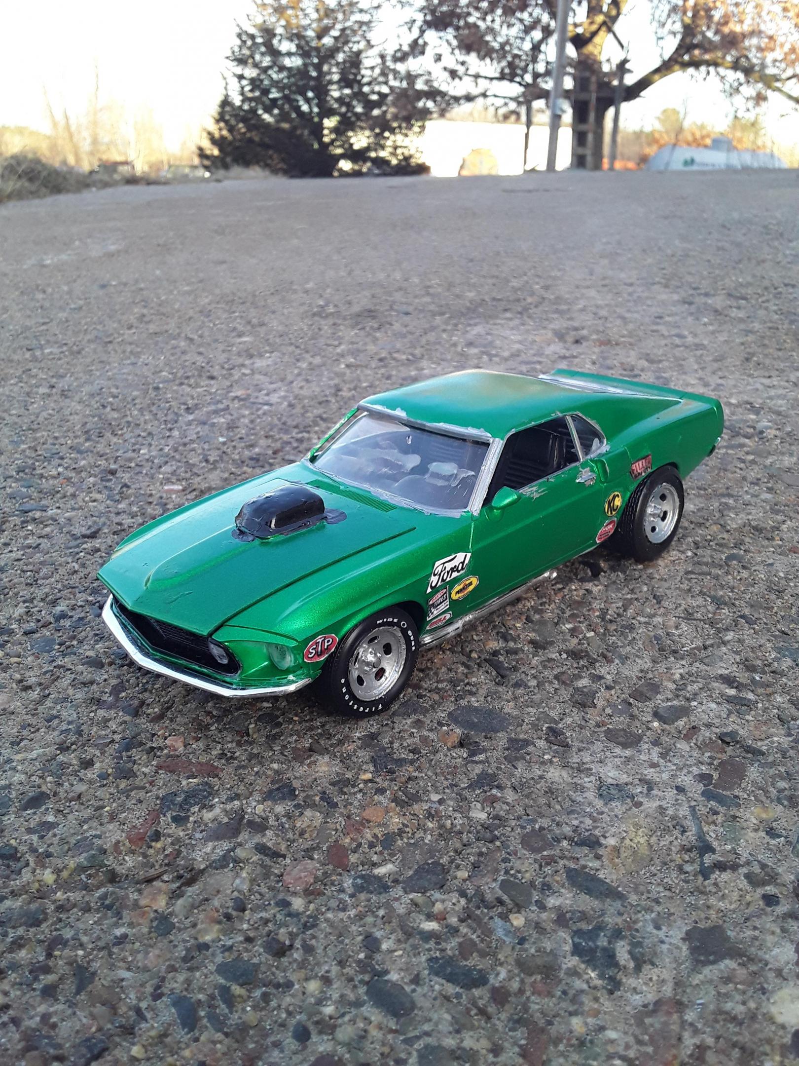

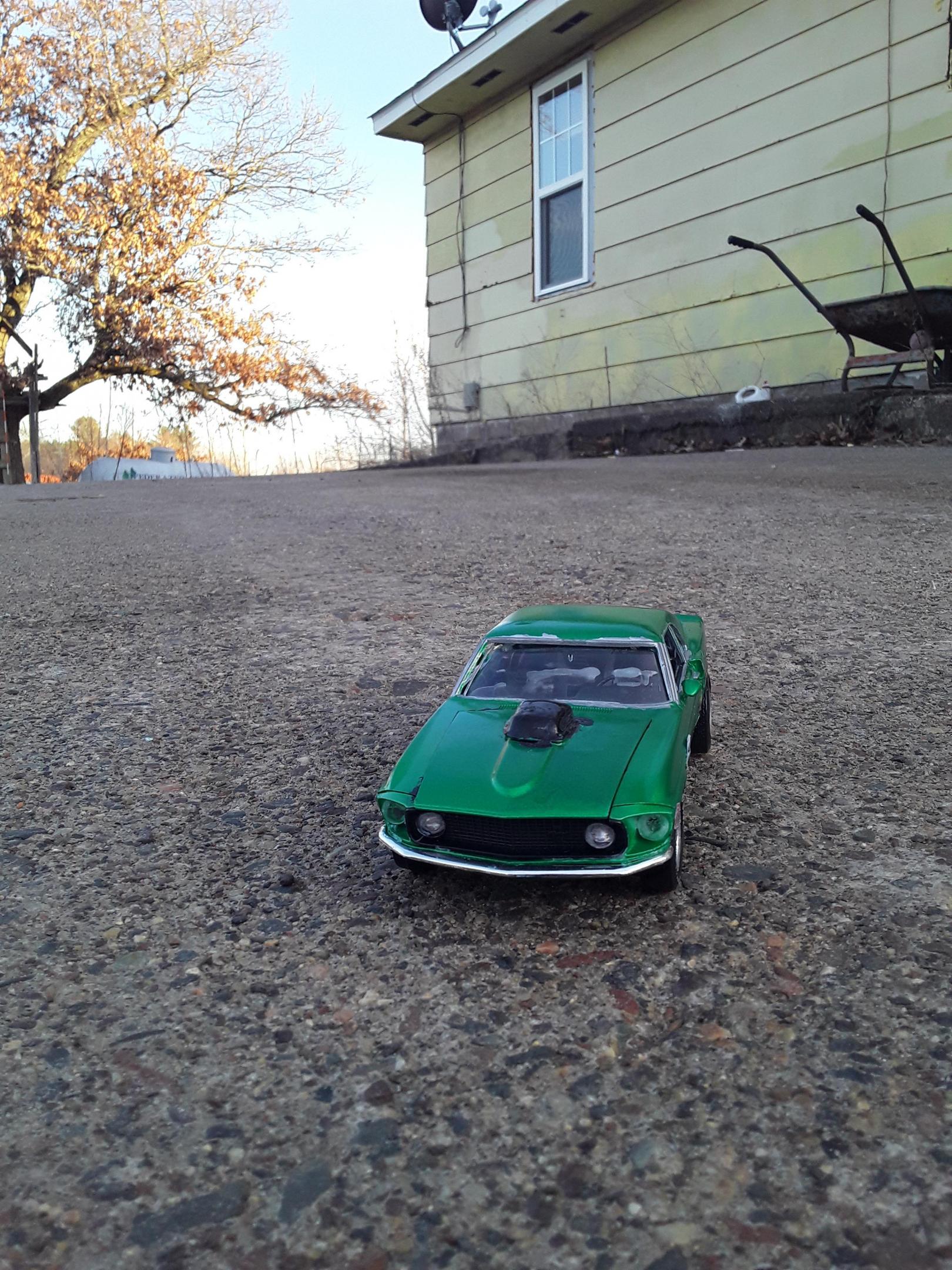

So here is The marked for death Mustang. Got it as close to lookin like the movie car as I could. Wish I would have had the fender badges ?. Aside from that I'm happy with the results. This was a challenging build. The engine is a 351c from another kit as is the fan shroud. The exhaust tips are styrene tubing. Wheels came from the stash. Thanks for lookin. Comments always welcome. Needs a good waxing?.
