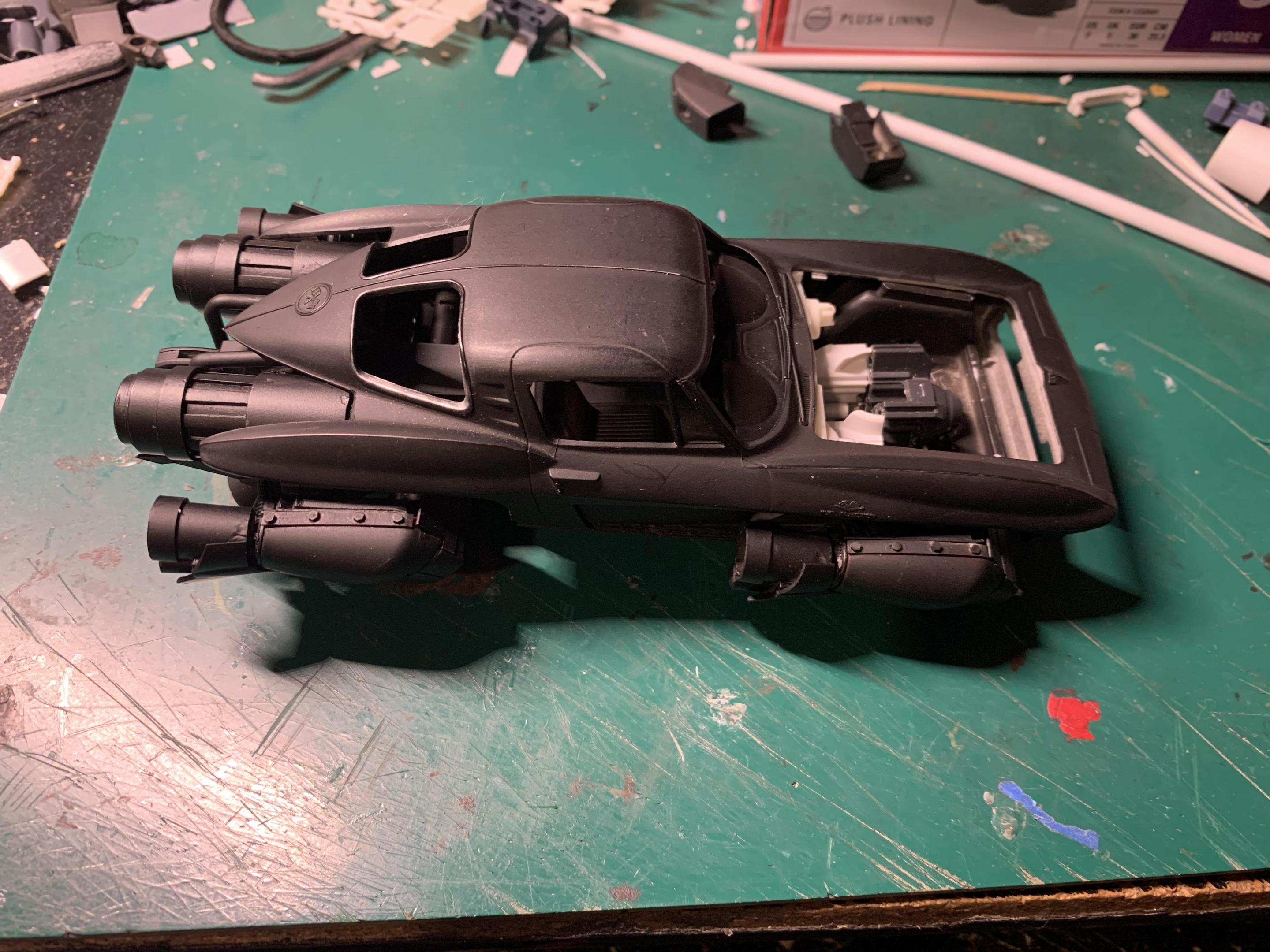

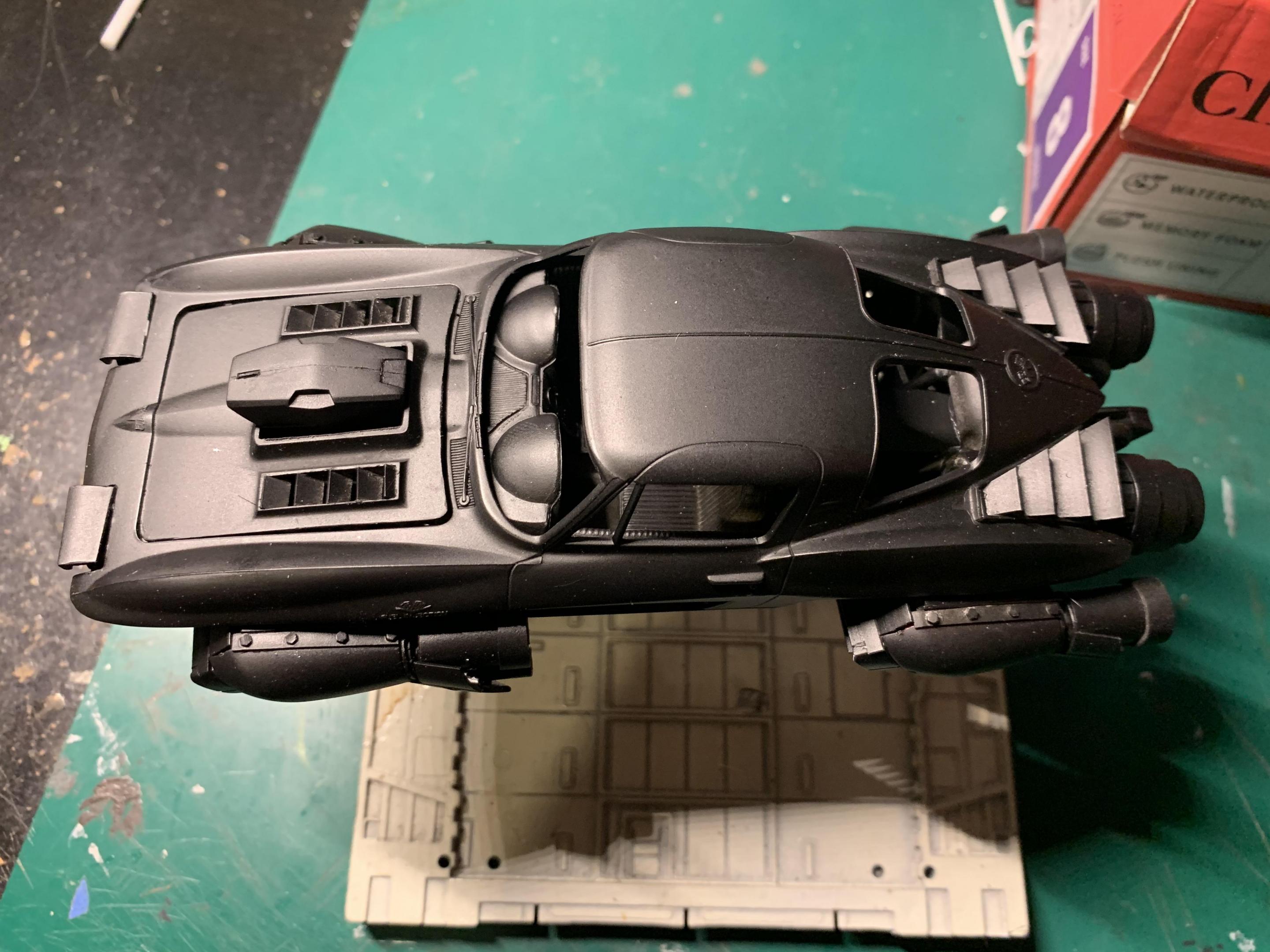

Here is the build of my 63 Jetvette. I hesitated on this one for the longest time. I'm a big fan of weathered and rusted vehicles. Being that the Corvette body is Fiberglass, I had a tough time figuring out what the final product was going to look like.
I just started building it. It's often the way these jet cars work out for me.

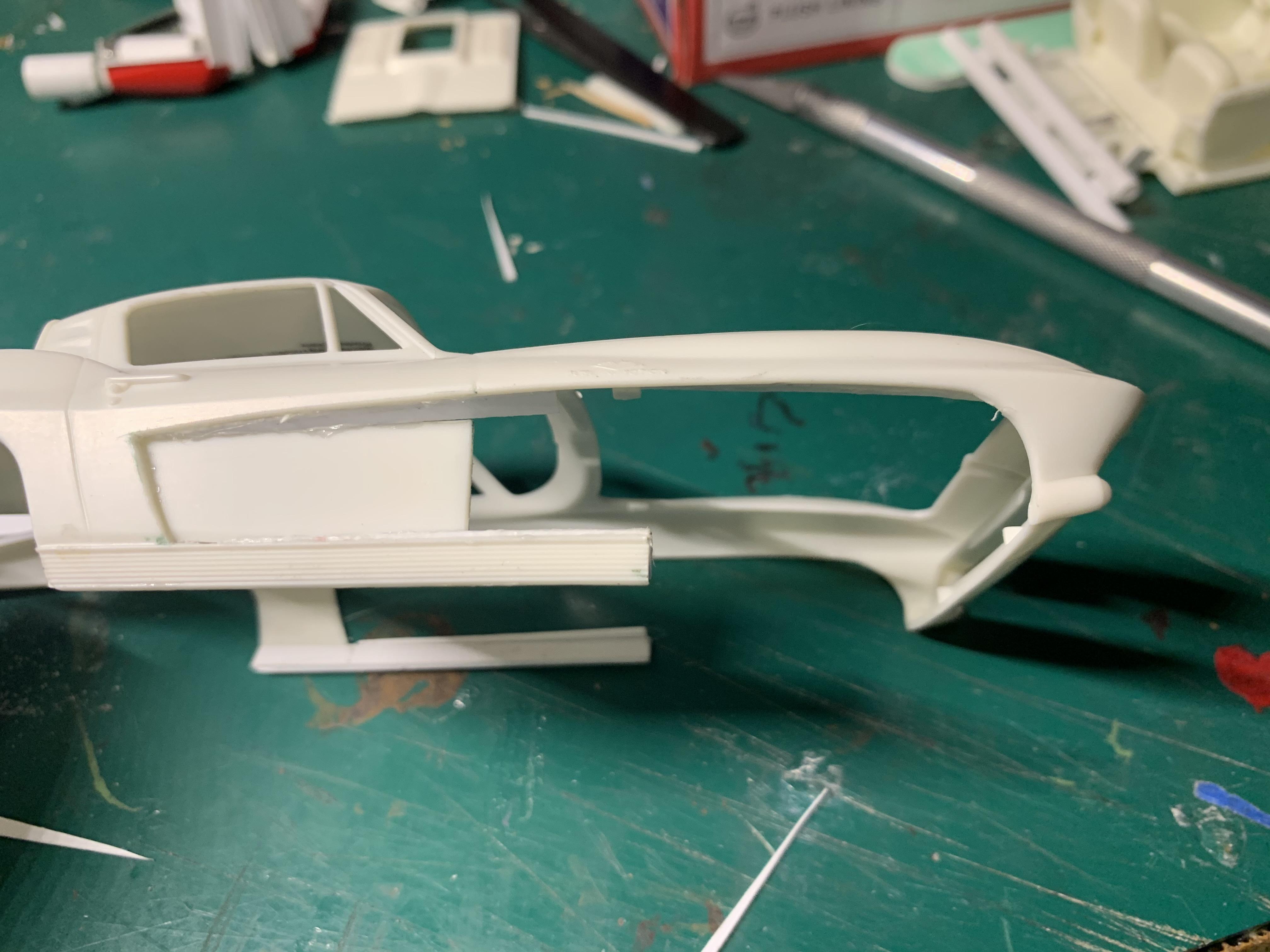

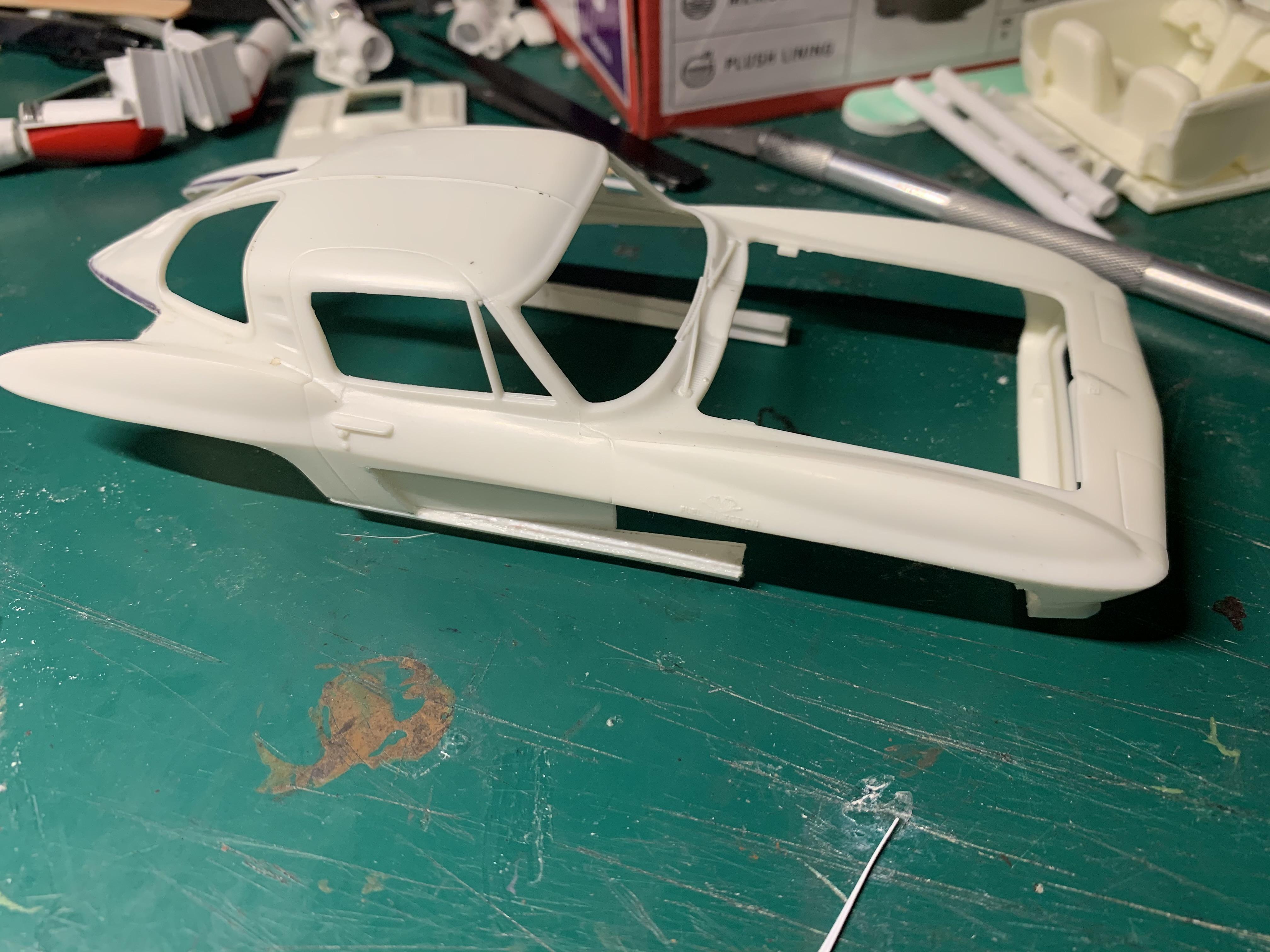

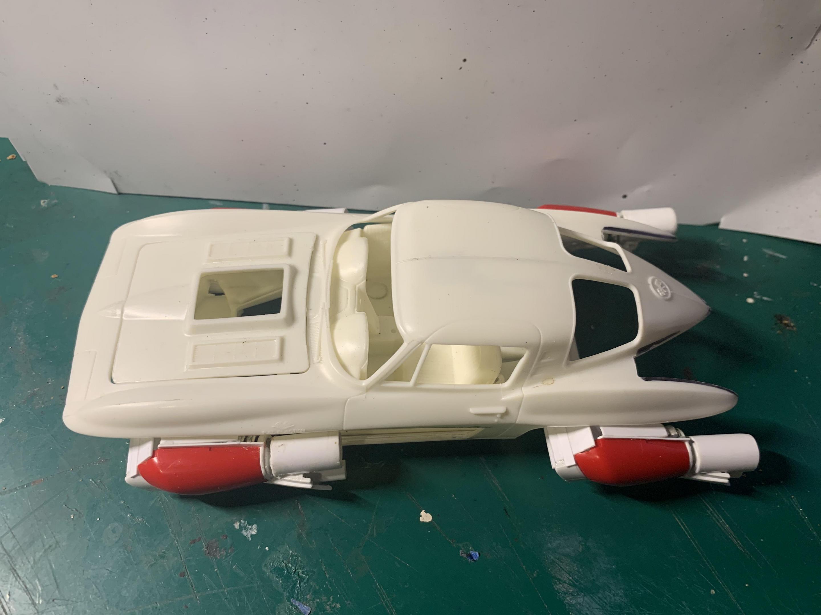

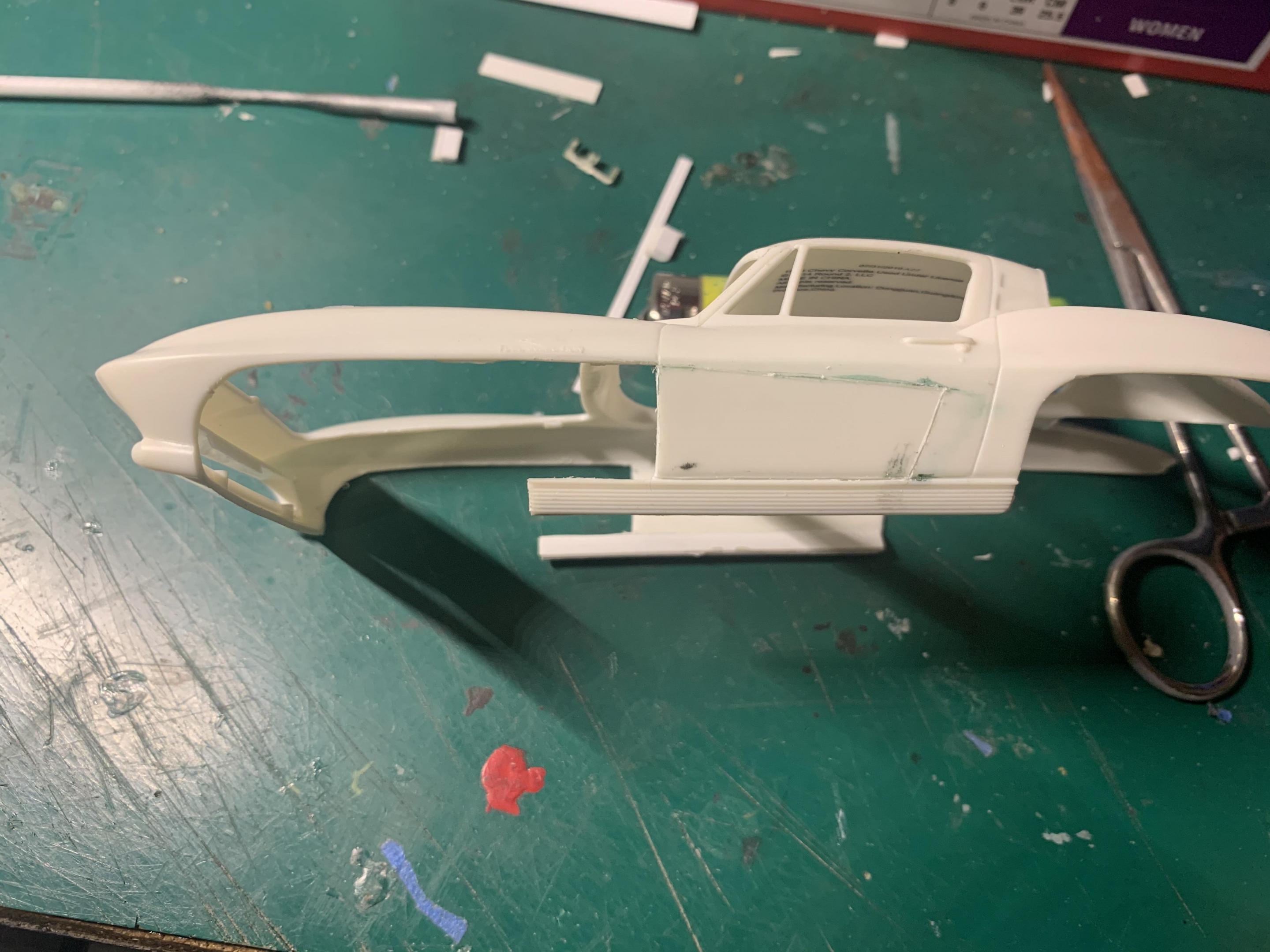

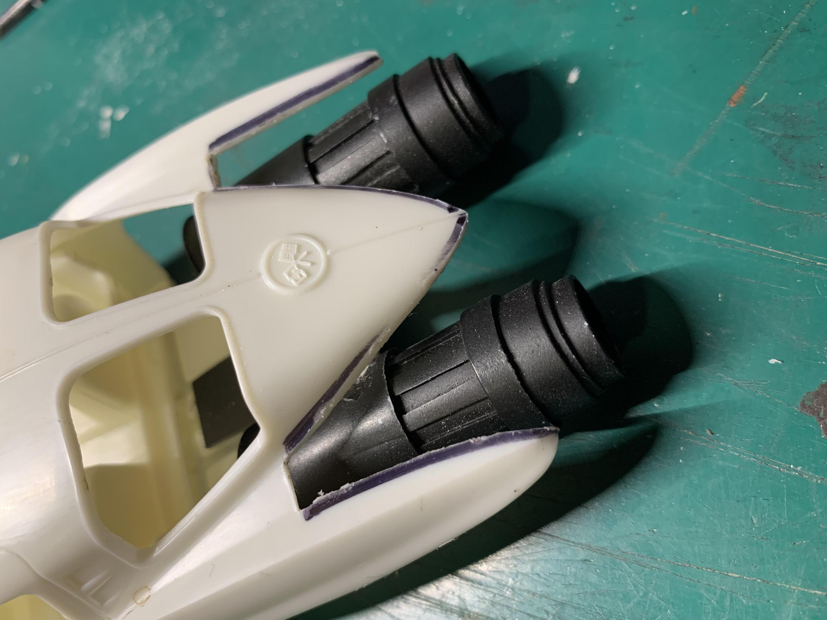

I almost always start by crafting the turbines. These are made from 3/8" and 1/2" Styrene tube. I also cut away the body for some vents that I plan to add.
I also cut  out of each front fender from the top of the wheel arch to the door. I marked where the door relief will be on the photo above.
I used the piece that was removed, along with some Styrene to create the door reliefs. Don't want that Fiberglass to melt!
The front turbine exhaust will fit on the channel of the door.

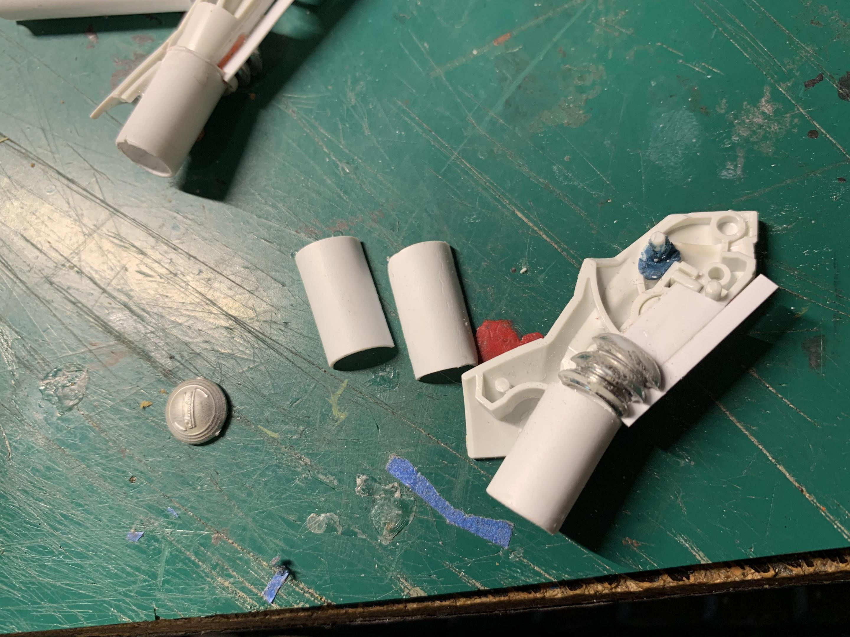

I wish that I had taken better photos of the parts that make up the four "wheel" turbines. They come from the leg/calf section of one of the Gundam kits that I've scavenged. I had two of these legs, which split into 4 usable turbines. 2 right and 2 left.
I doctored them up with some Styrene tubes for exhaust and a front intake grill.

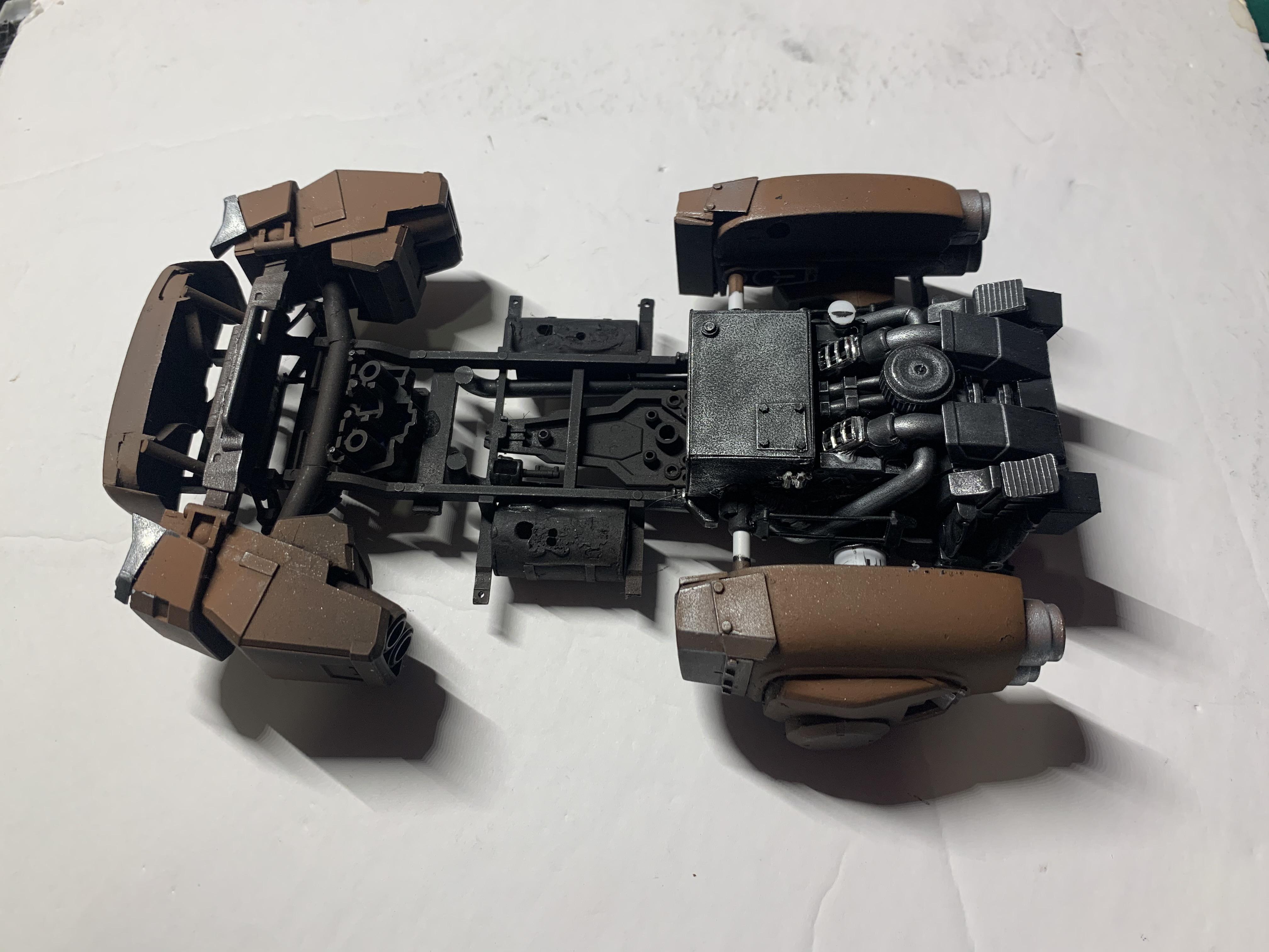

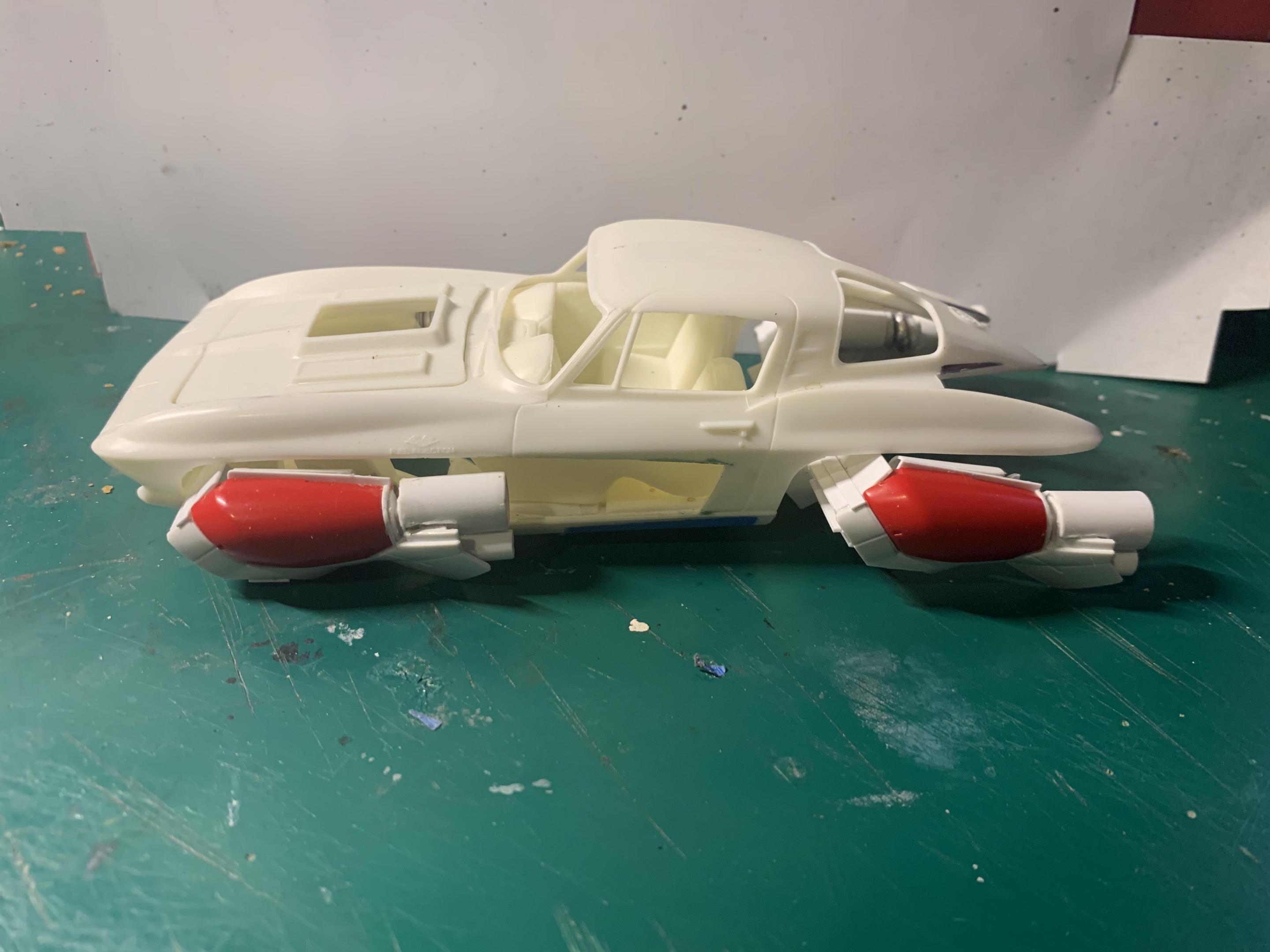

The amount of Gundam parts that I used on the Foose truck was ridiculous. The undercarriage, the front power plant, the front and rear turbines are mostly Gundam. I wish that I could give you the names of each of the kits that I used, but I don't have the original boxes or instructions anymore. Just a bin full of parts. I do know that the front turbines on the Foose truck were from Gundam Virtue. A few parts from Gundam Denial as well.
I always try to build in sub-assemblies. The four corner turbines are removable even on the completed model. Using Styrene tube to hold pegs on it's adjacent part. There's some Mustang tail lights in there as well.
The fuel tanks are blood test strip containers. I'm a type 1 Diabetic. I have plenty of these.

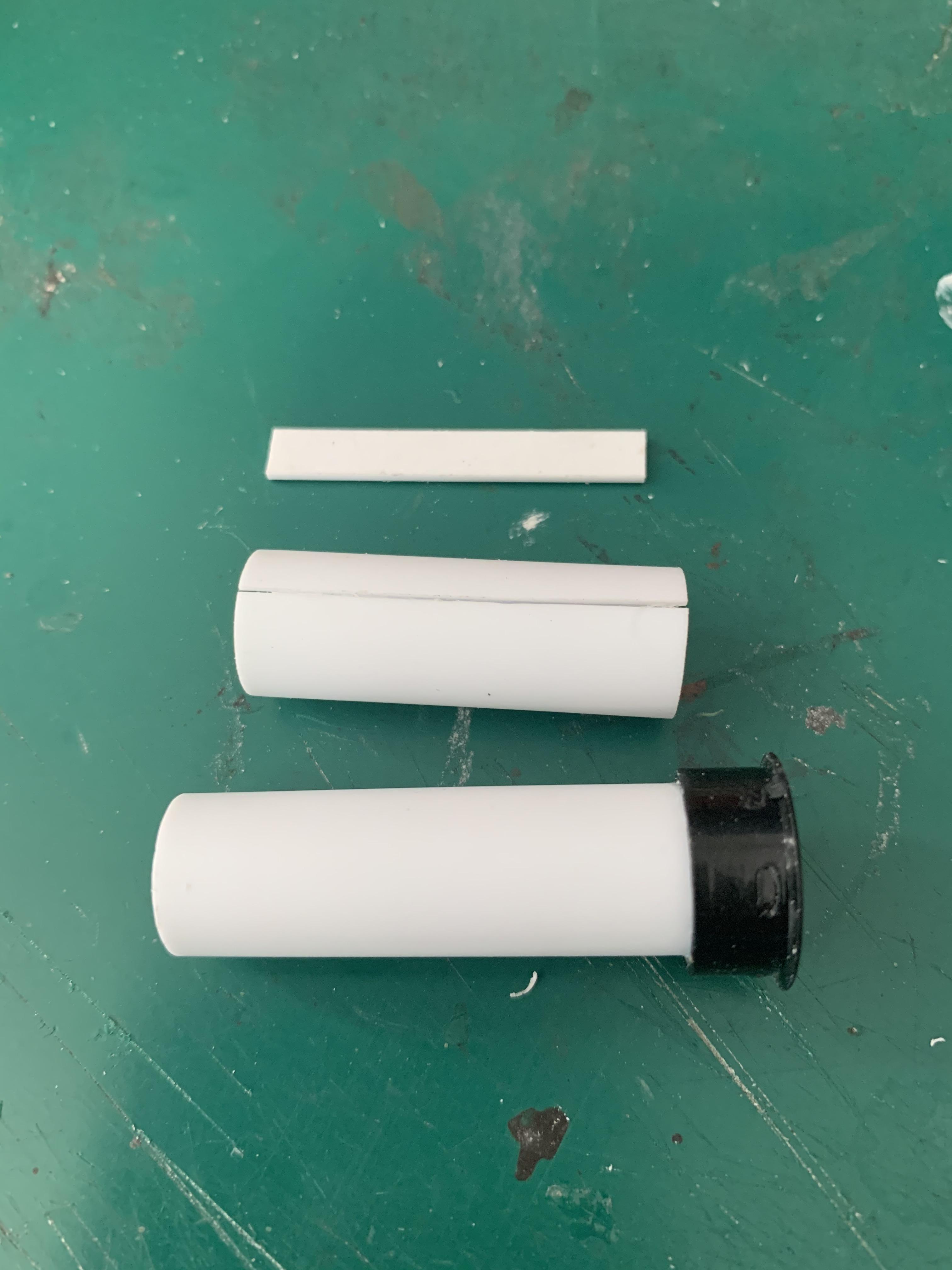

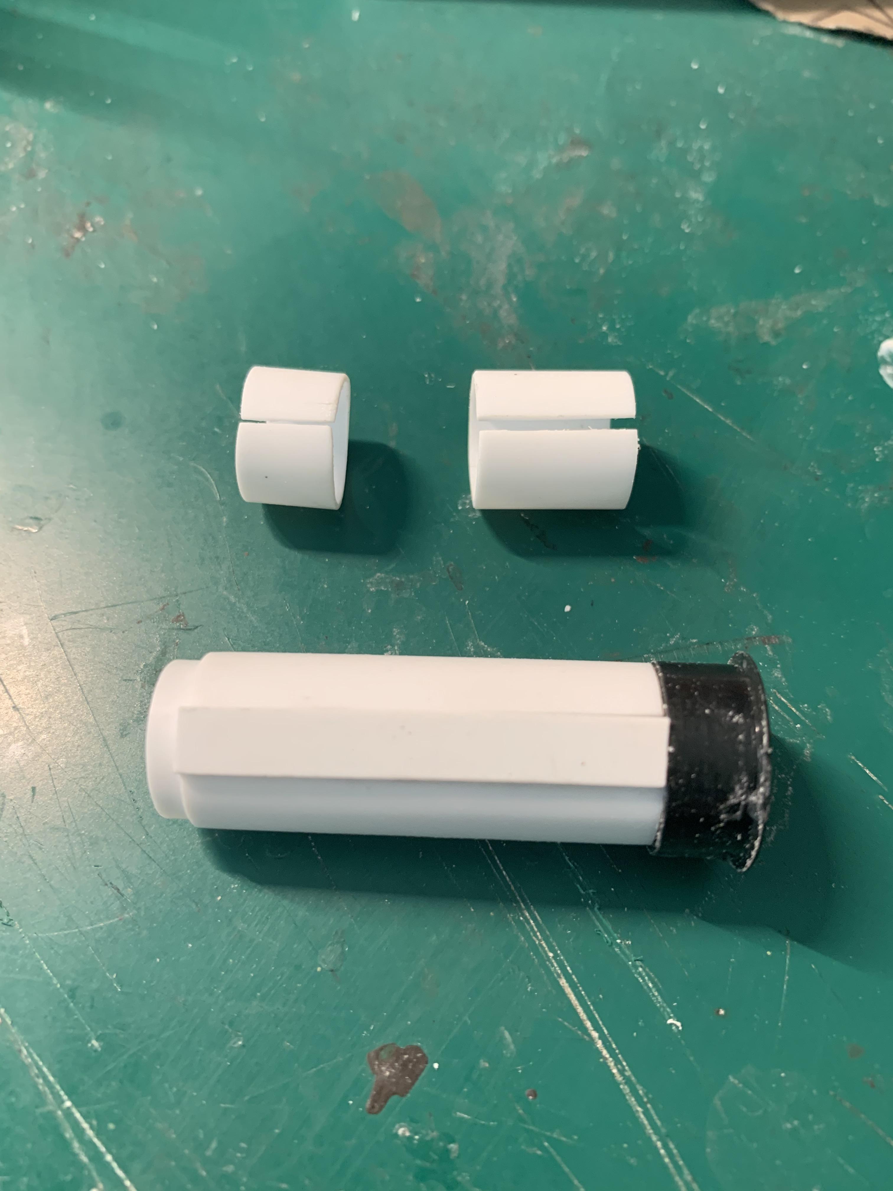

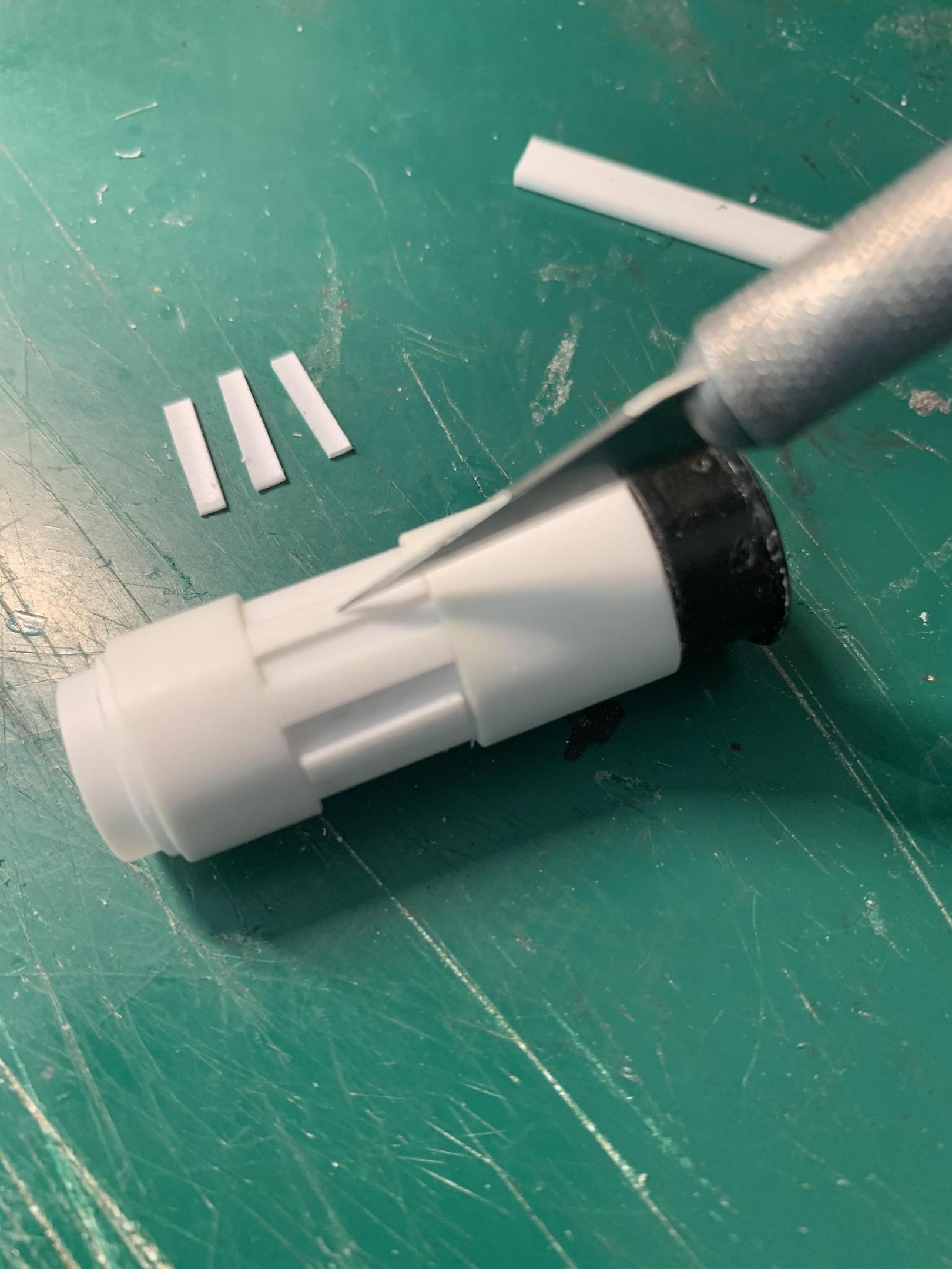

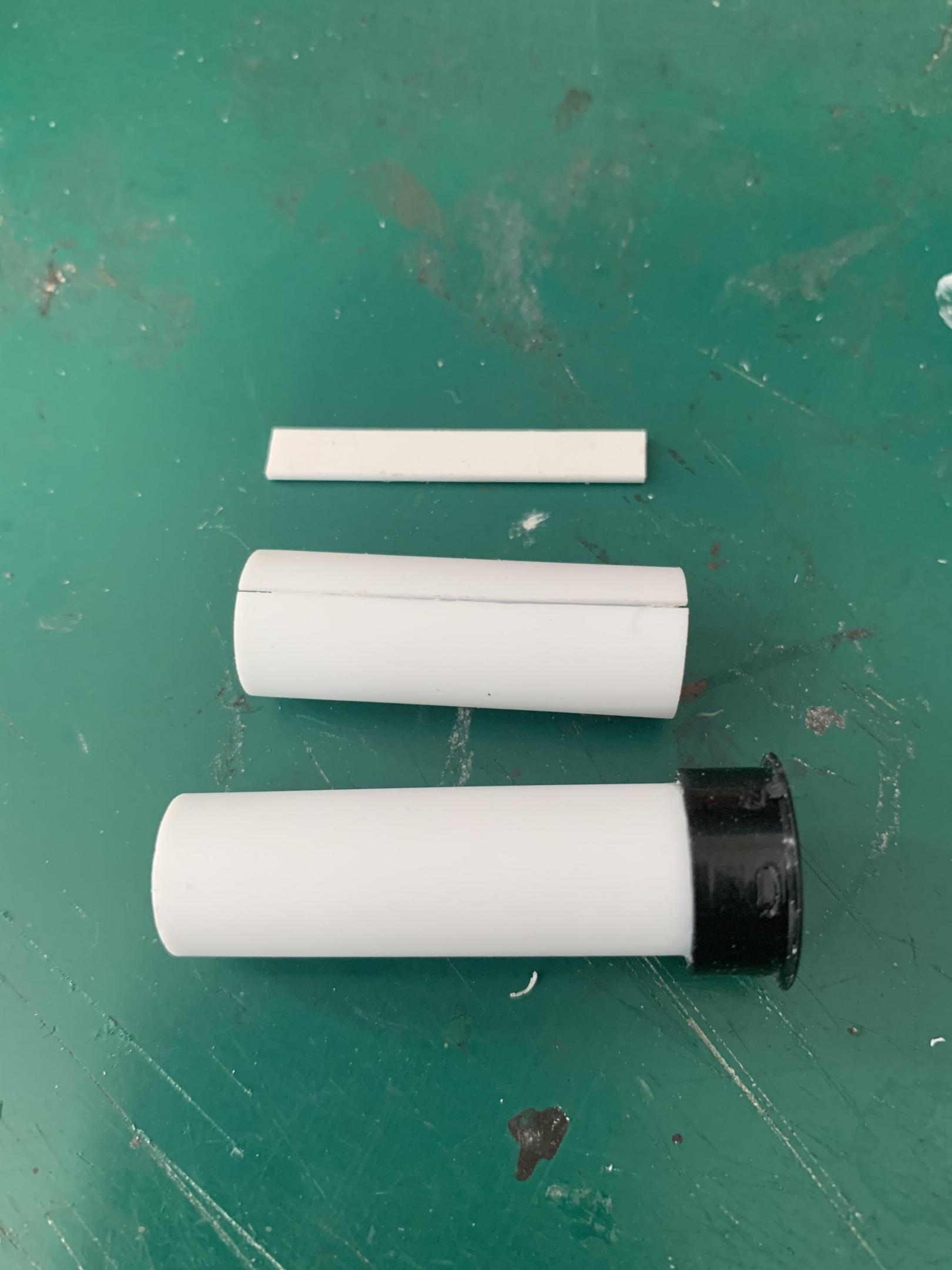

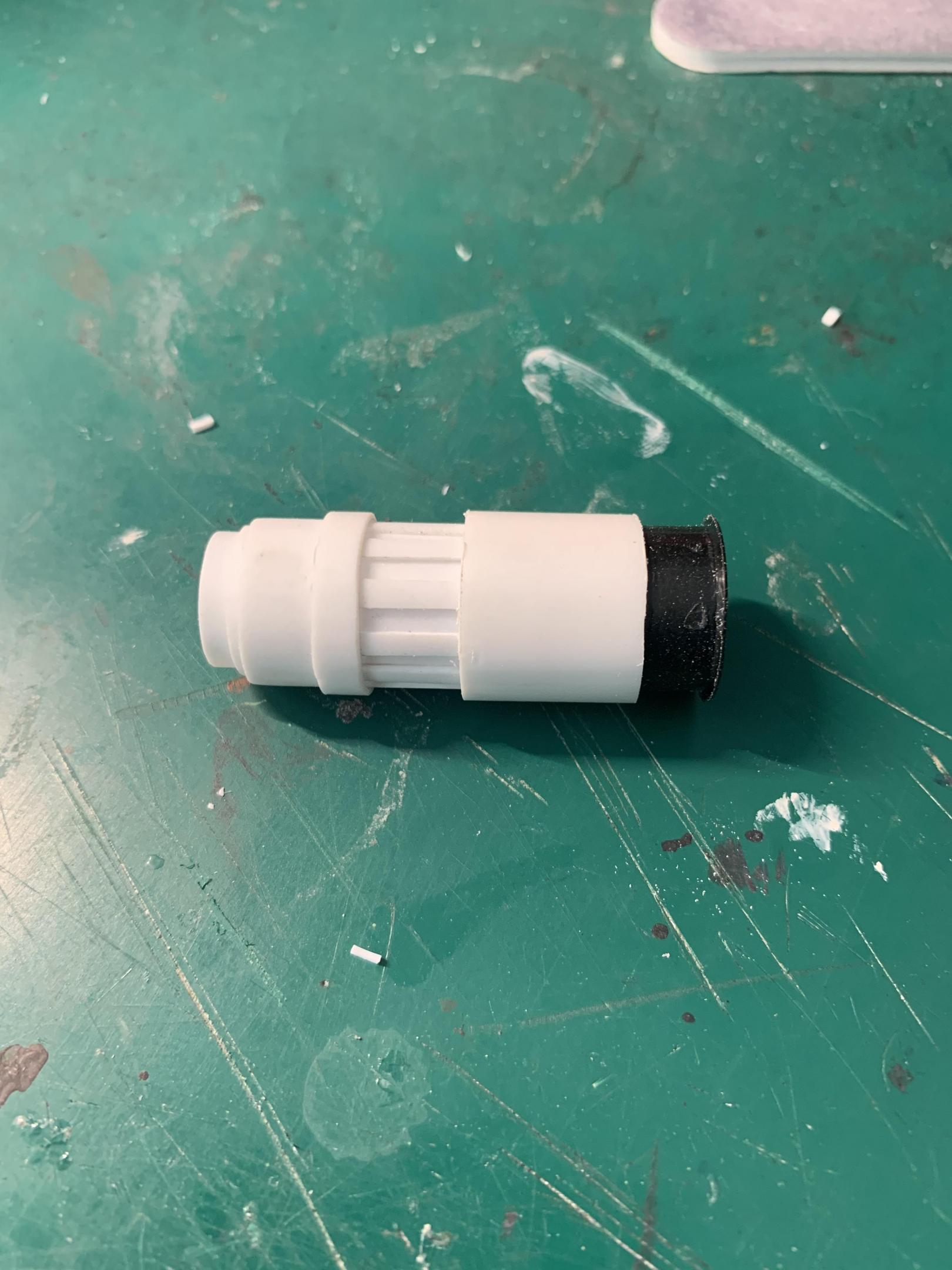

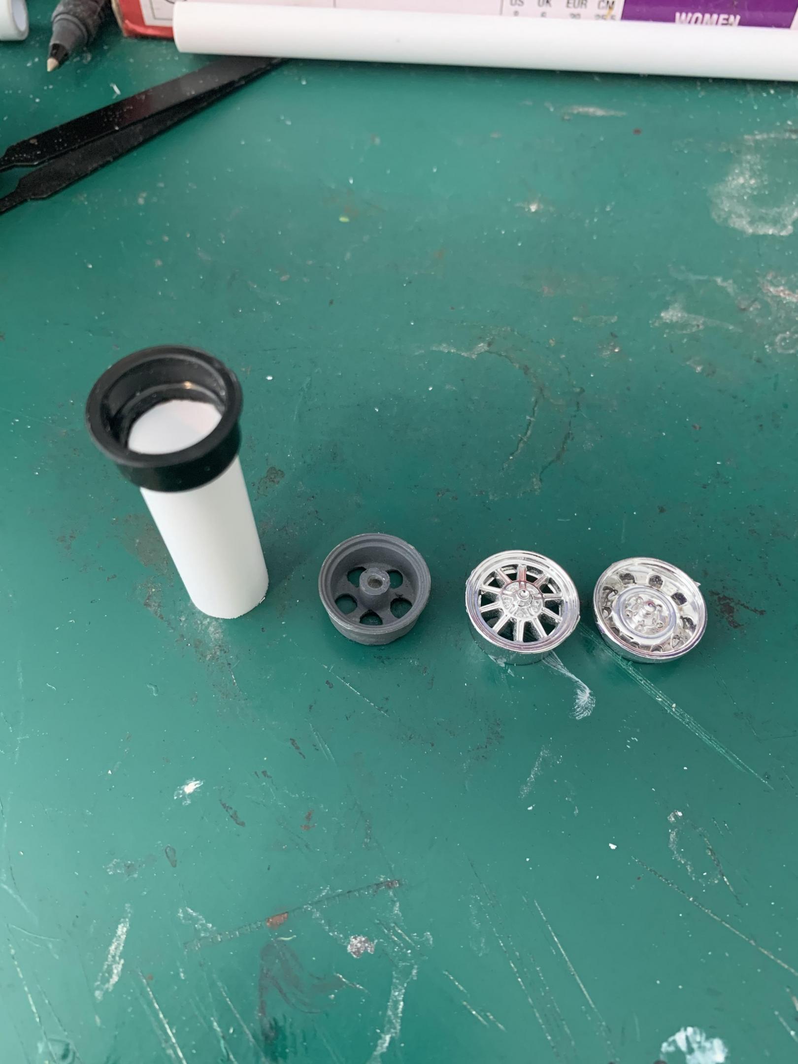

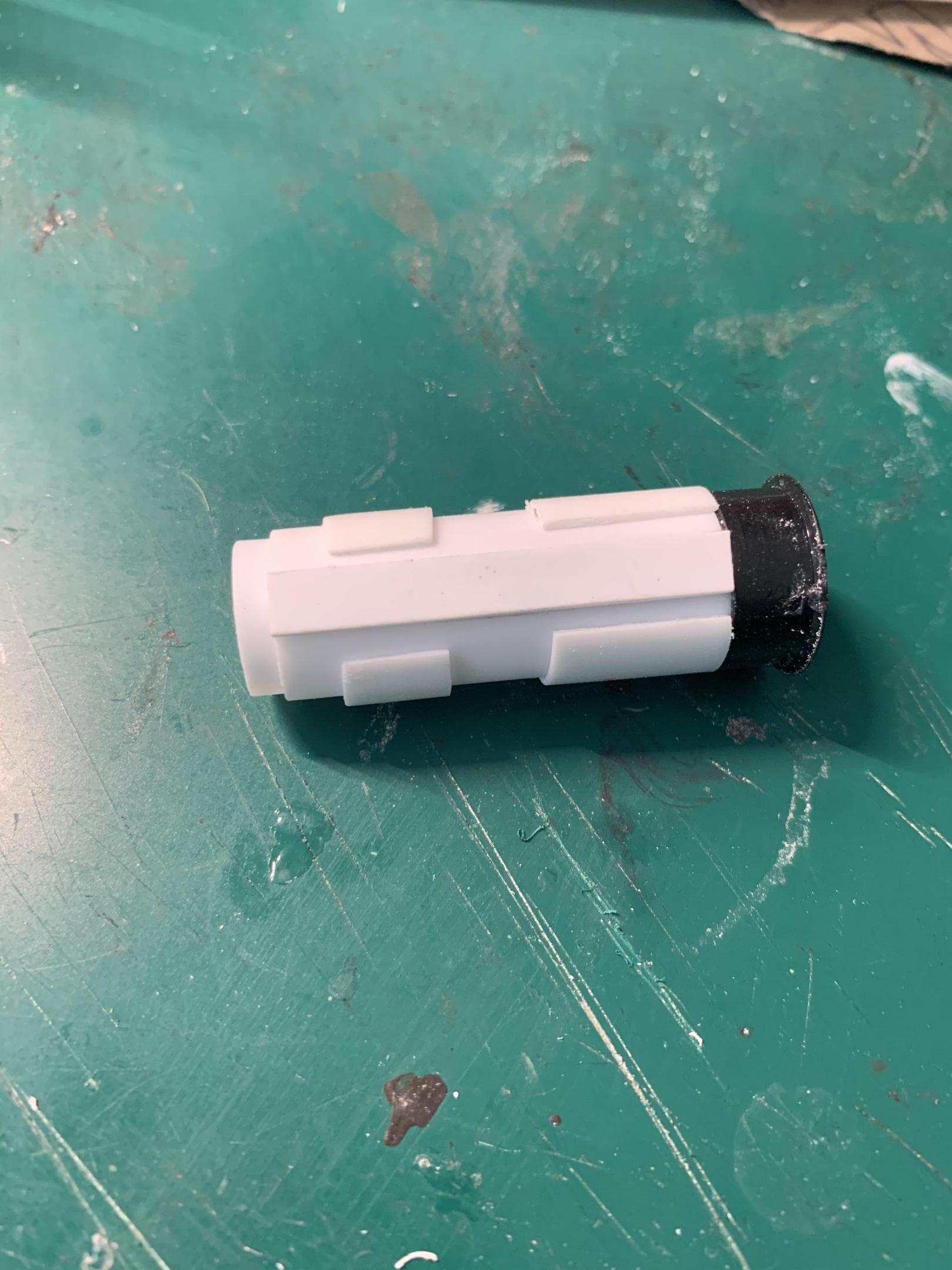

As for the large turbines that are sticking out back of the Jetvette, I've made similar on my last 5 or 6 jet cars. Just use different diameter Styrene tube overlapping each other.
IMG_6693.thumb.JPG.38bc9066300e81bc4eddd06ad3a3d7d7.JPGIMG_6694.thumb.JPG.12fe71f3836921bb280af0c6d667483f.JPG
I cut the center of a rim out for the front of the intake.

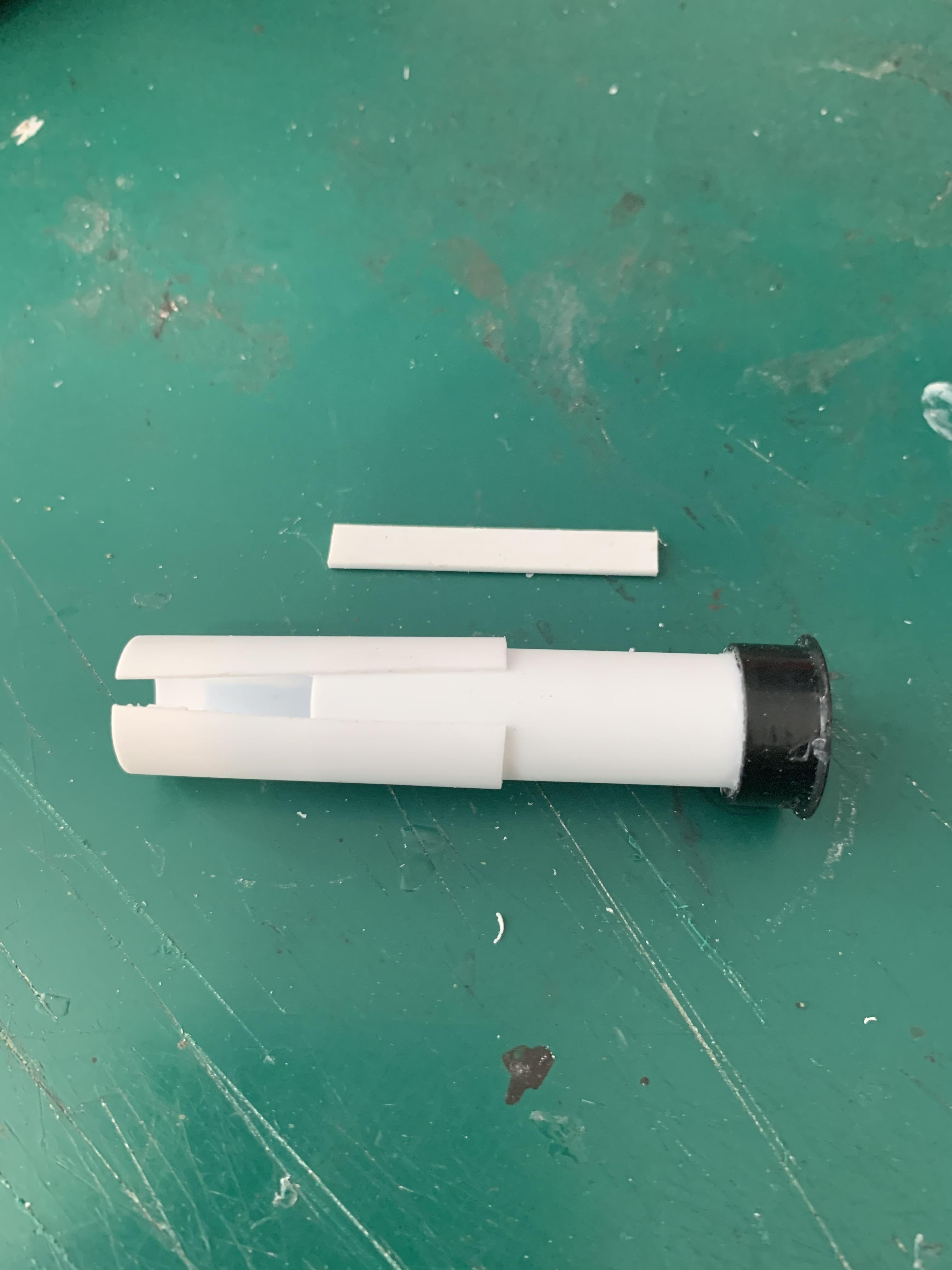

Split some Styrene tube lengthwise to fit over the first.
I'll use the strip of Styrene as a flat gluing surface to mount it to the vehicle..
Split more Styrene tube and fit over the second.

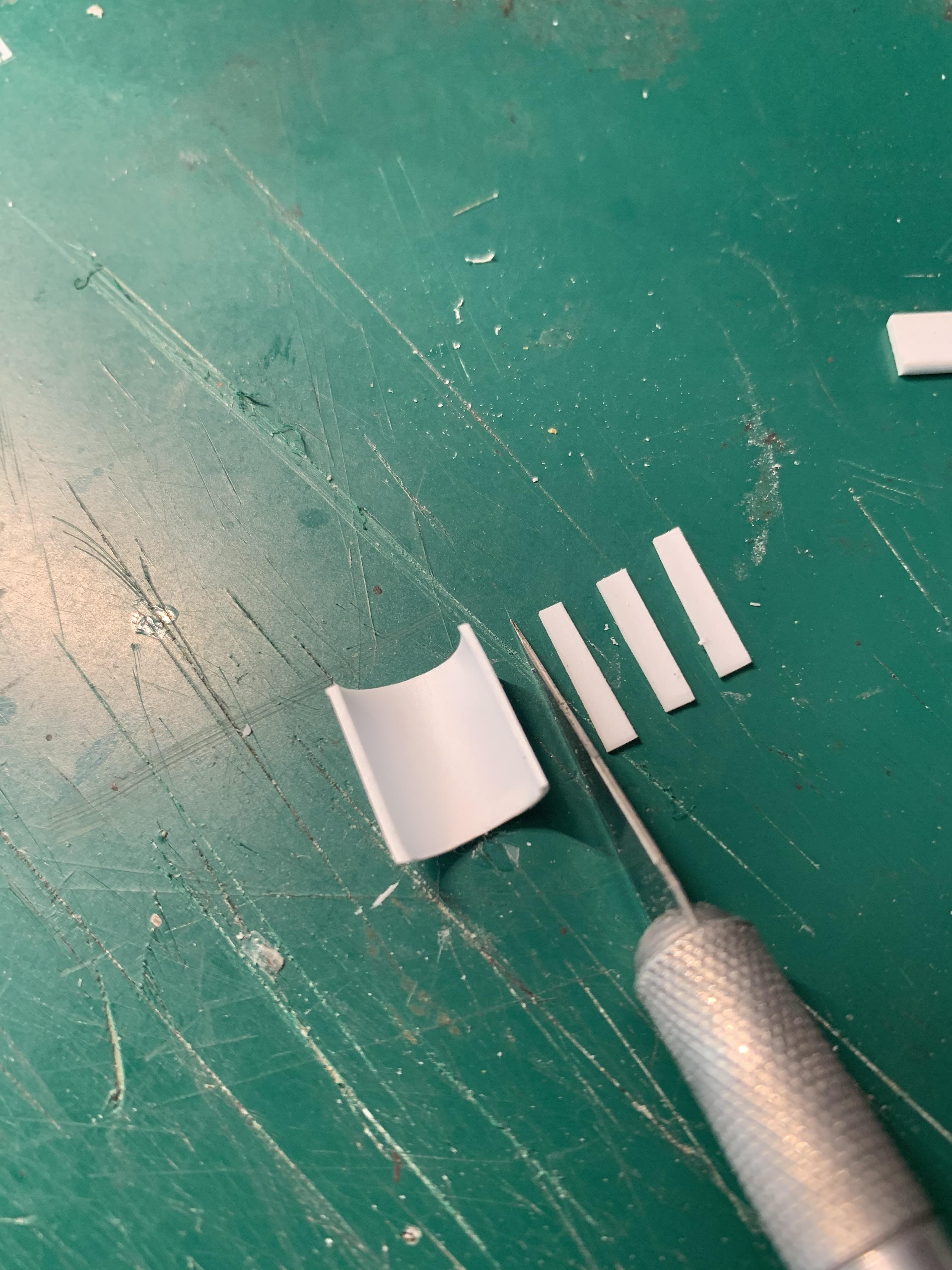

I cut some of the tube into small strips.

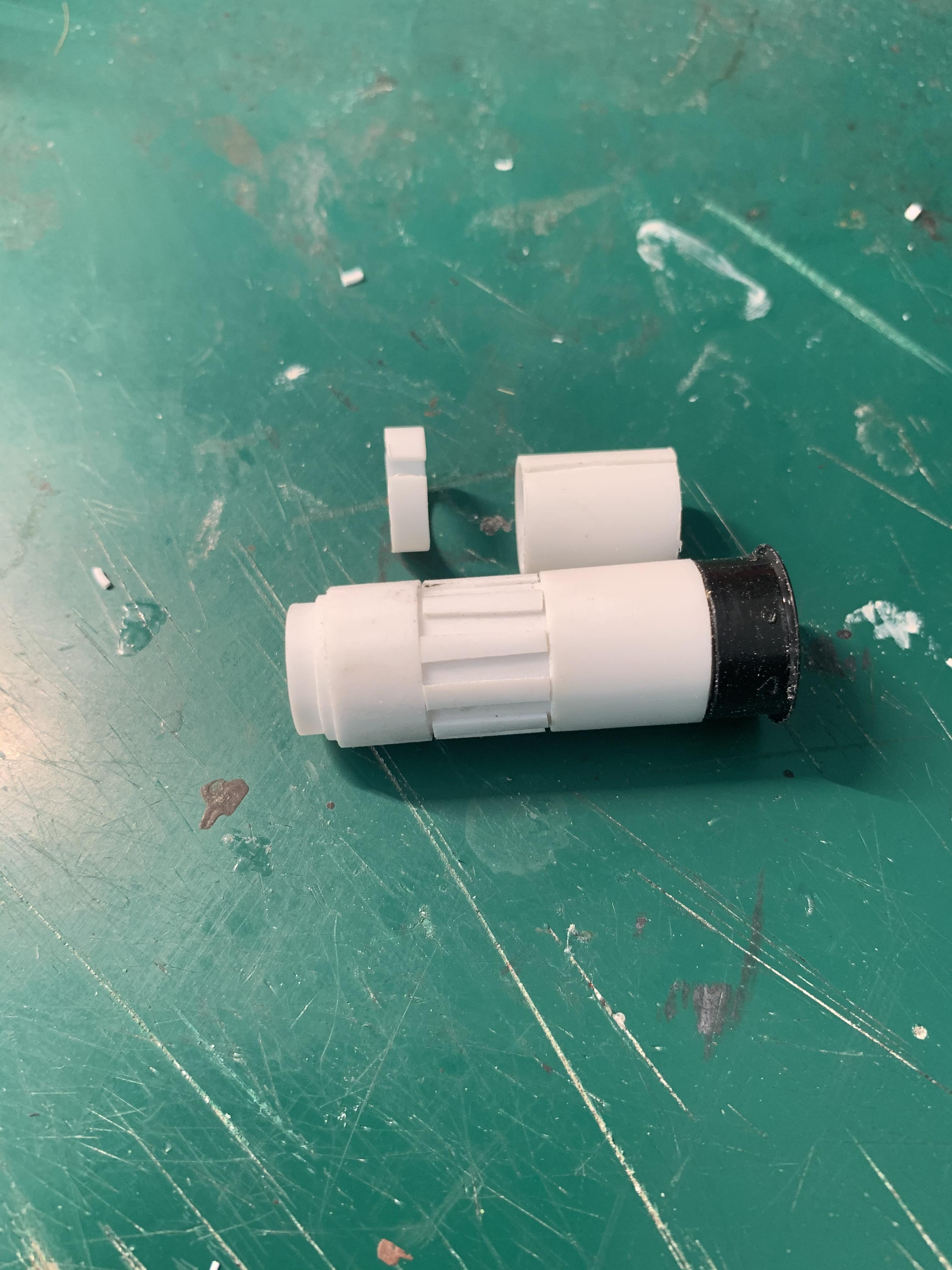

Glued them with even separation between.
The split some more of the tube to hide the seams.
Happy to answer any questions. Thanks guys!!!

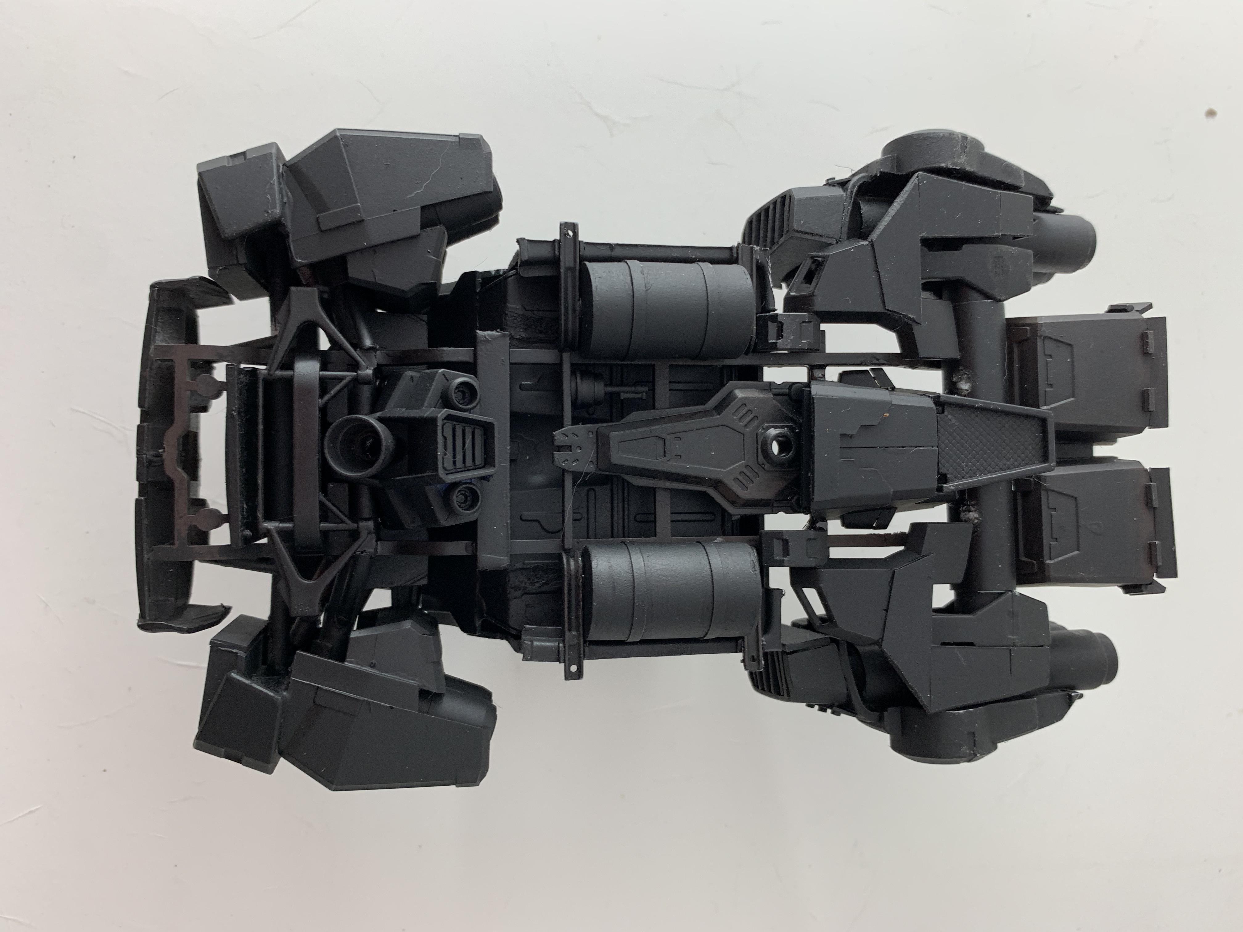

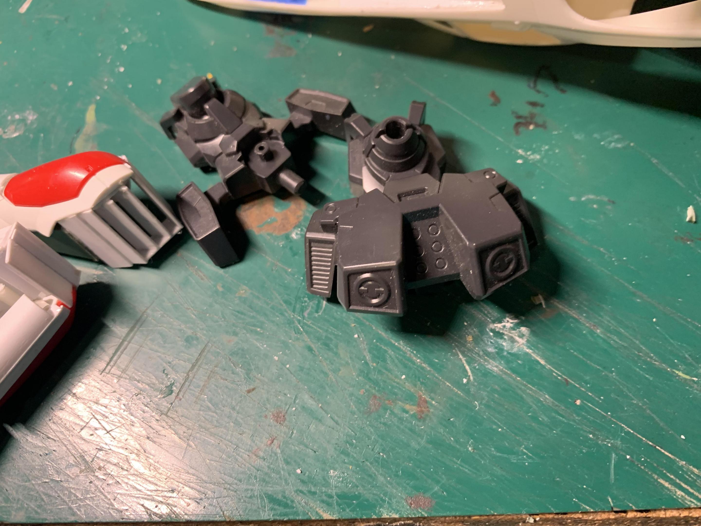

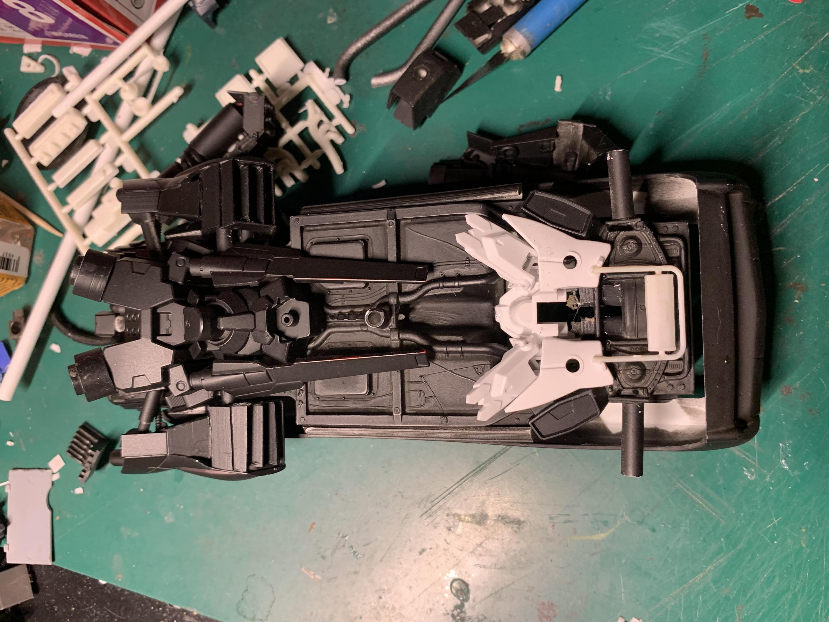

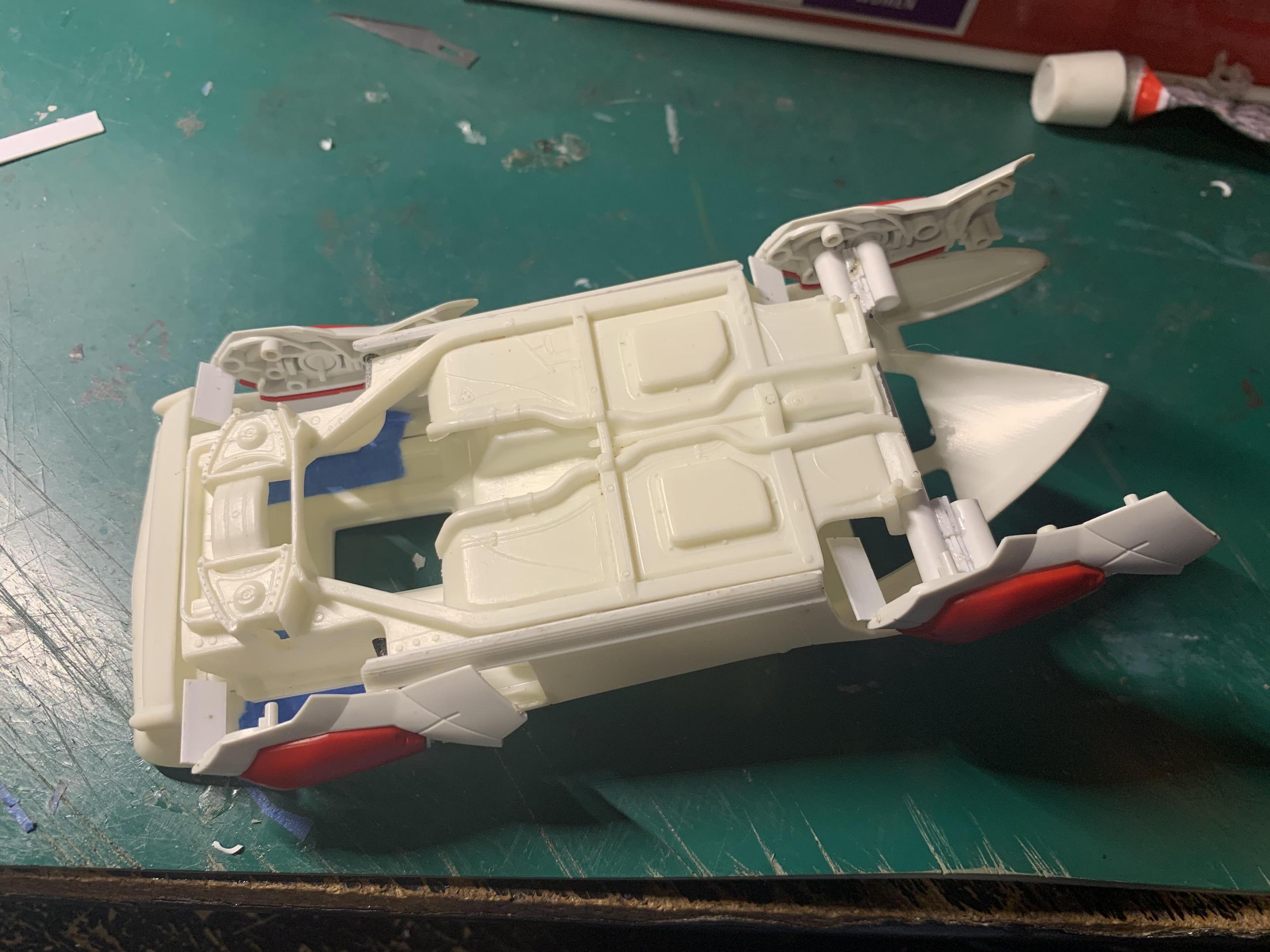

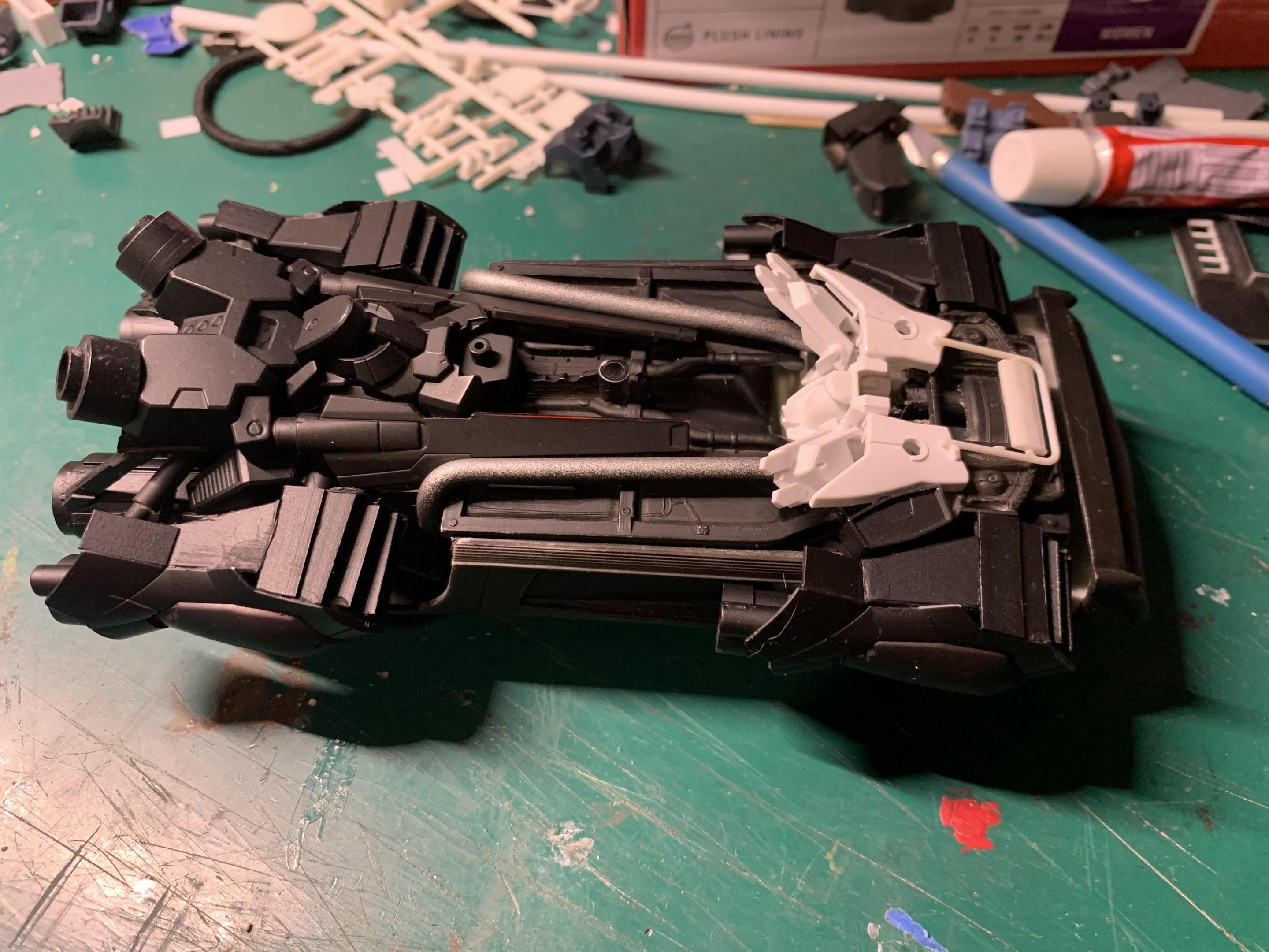

The two grey parts above are used on the undercarriage below. Each had to be modified.
I do modify most of the Gundam parts that I use. I'd prefer that they weren't recognizable. Lots of parts covering up other parts.
The undercarriage is one of my favorite areas to scratchbuild.
The four identical turbines under each wheel well are unique to this model. All of my other builds have different turbines from the front to the back.
Vents, vents and more vents. It's gotta breathe.

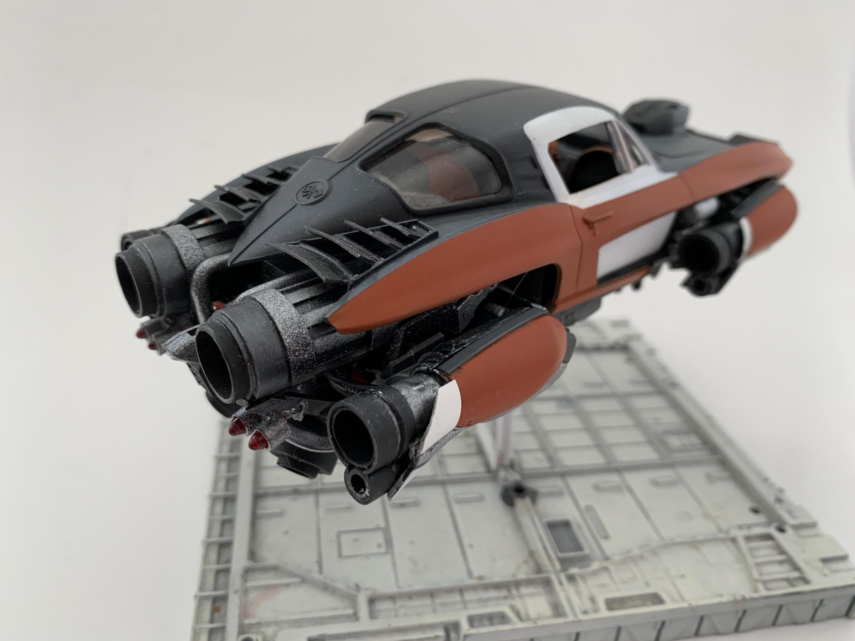

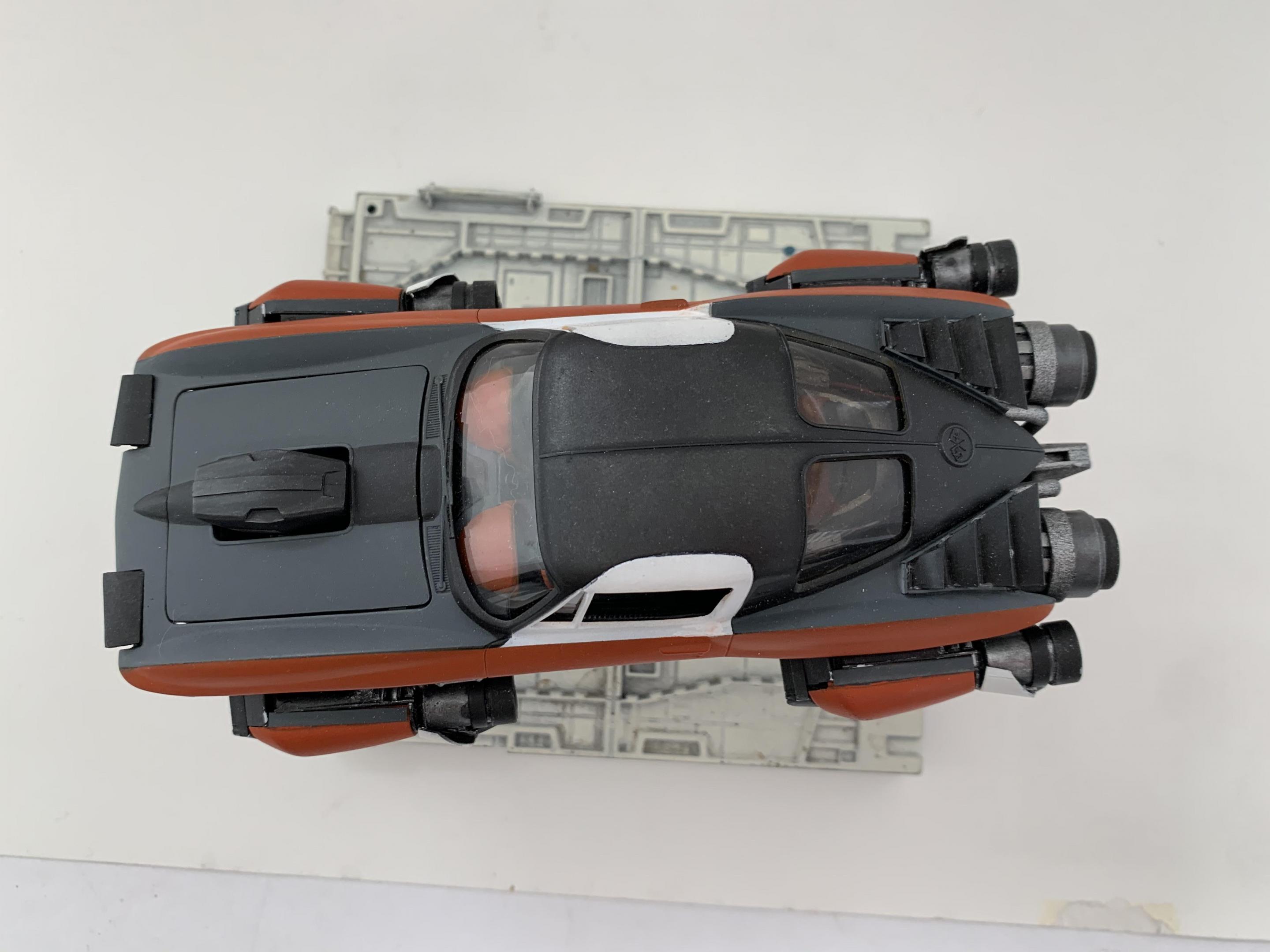

My son gave me around 6 Gundam kits that were brand new. Plus a few more that had been built. I've used the majority of the usable parts, but still keeping the extras just in case. At my local hobby shop they carry Gundam kits that are under $20. I'm getting to the point where I'm going to have to start buying new kits. I'll be posting more photos soon. I'll try to get a few pictures of the type of parts that I look for when kitbashing.

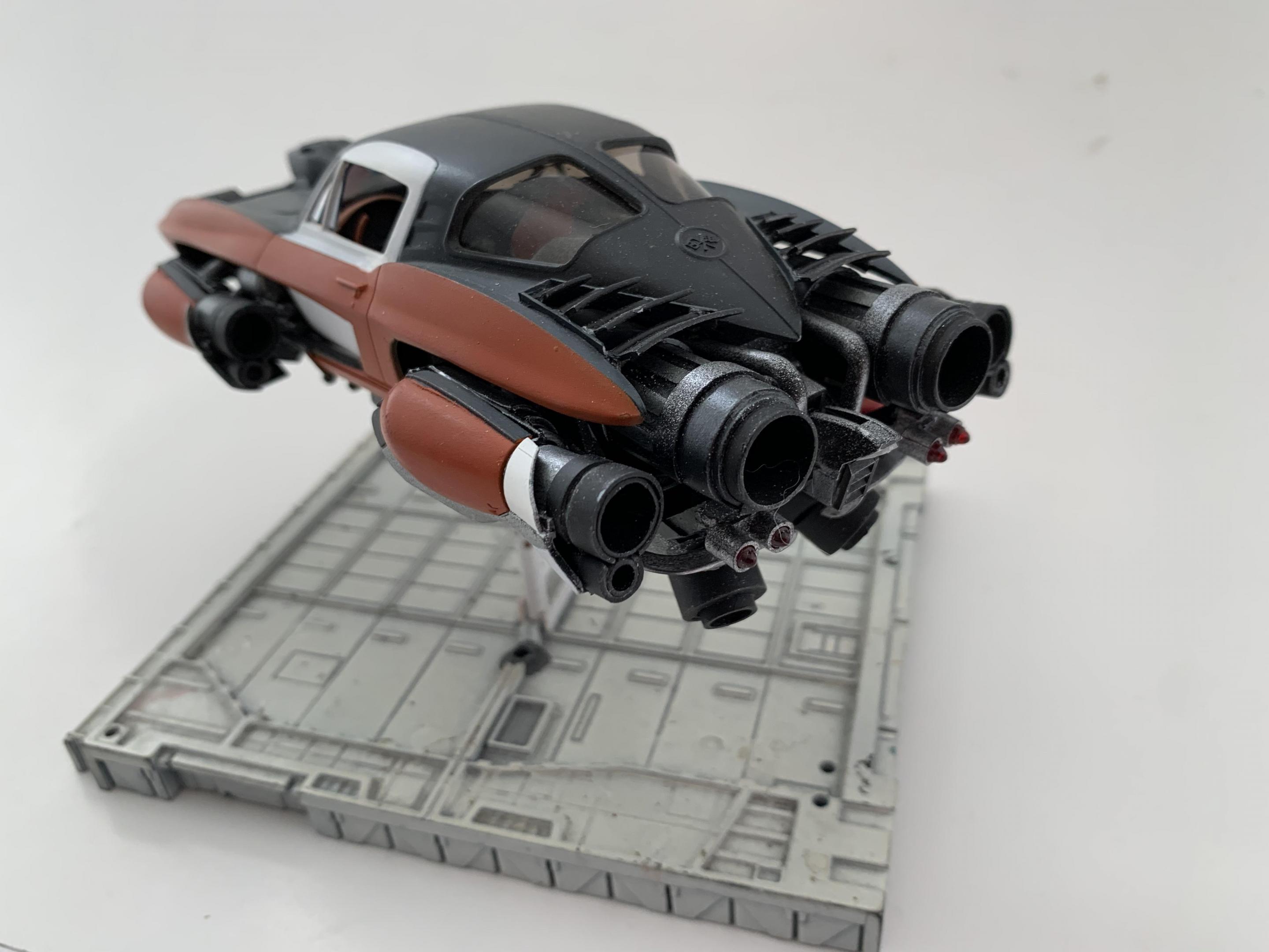

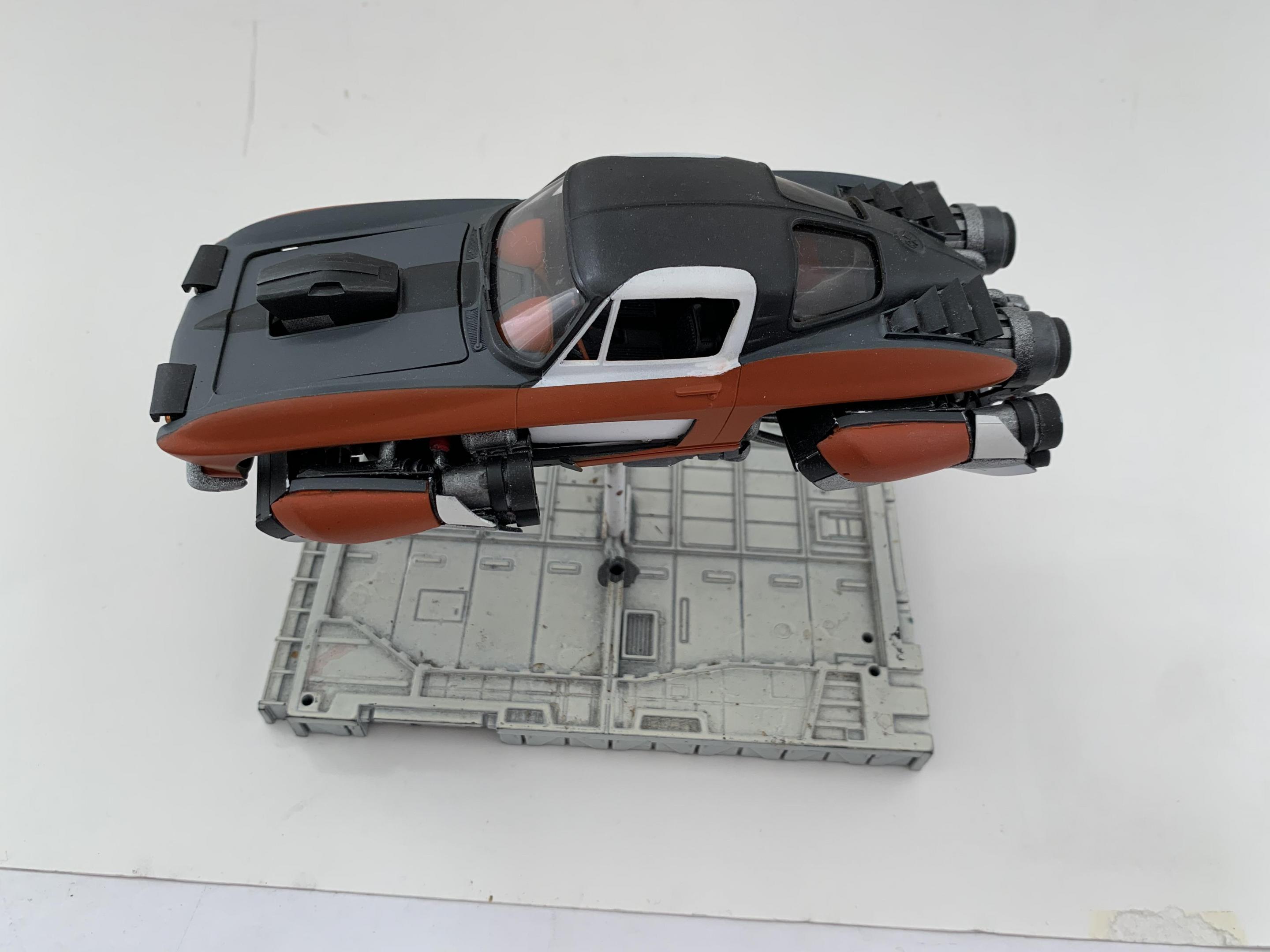

I just posted all my jet cars in one post. In the finished models section. 10 jet cars including this one.

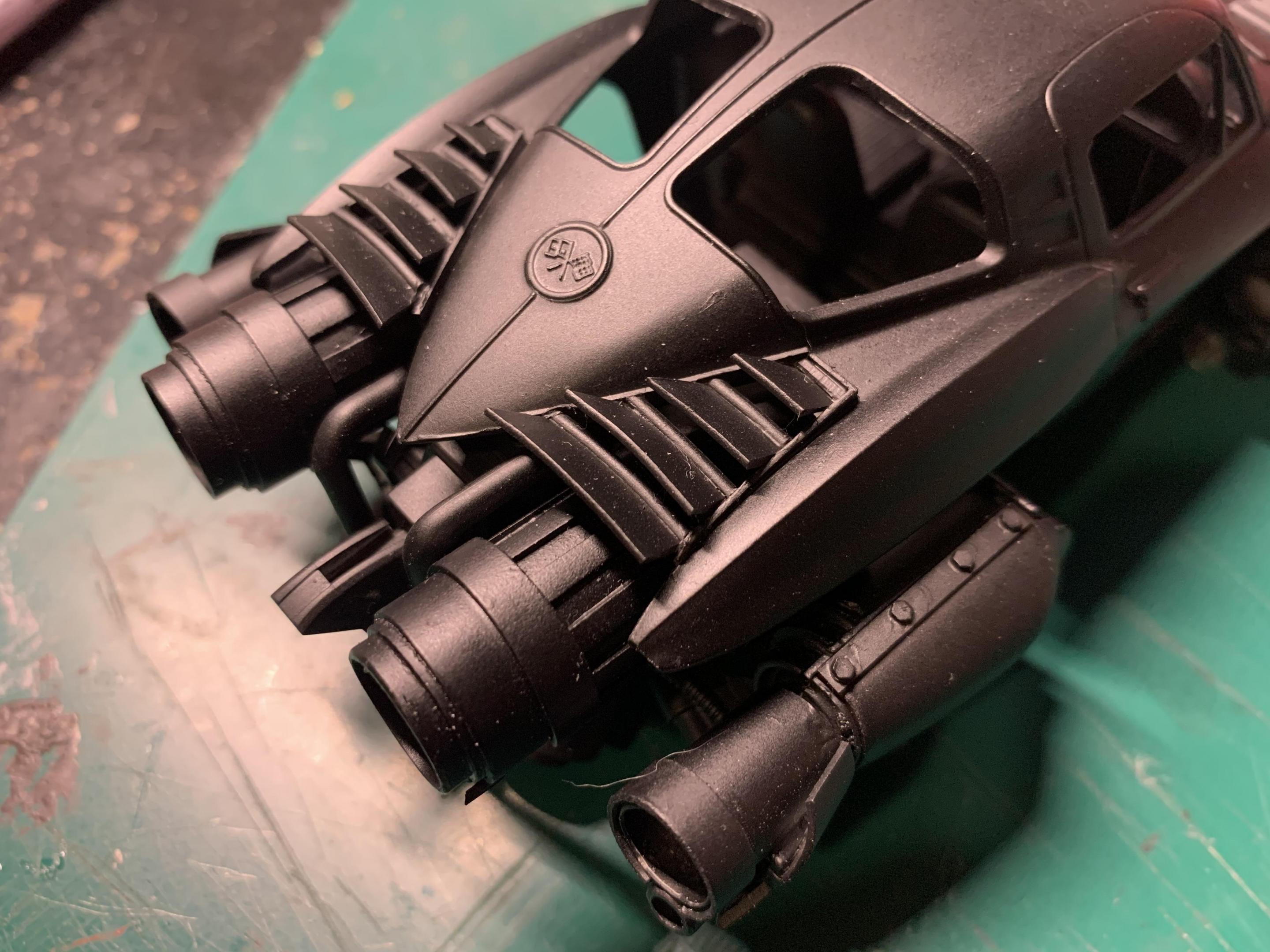

I'm trying my first race livery.
IMG_8570.thumb.JPG.99905ae4e4e1e7f386ac3cf34fe735ef.JPGIMG_8567.thumb.JPG.7f3c814249314450a417a7dda5995fbe.JPGIMG_8563.thumb.JPG.97e7c0d2cebccb7147756981d955fb51.JPGIMG_8556.thumb.JPG.f05c8adc64eb82ae431f8bd37f8cbd2d.JPG
I need to start making my own futuristic sponsor decals. I'm procrastinating......
