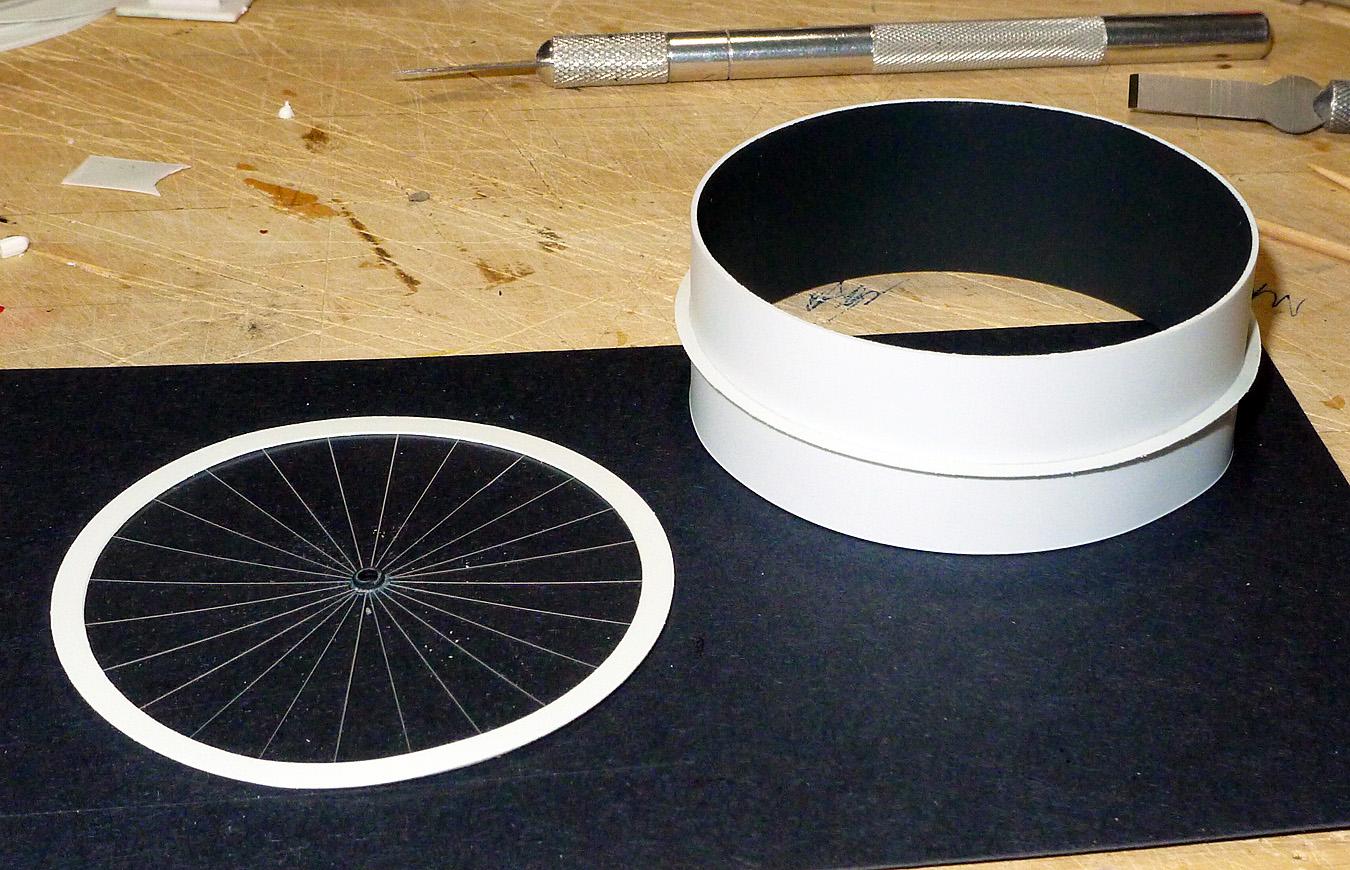

I finally figured out how to do the flange in the middle of the light housing barrel.  I dug out my old compass and loaded a scribe in place of the lead.  I cut the outer diameter first then the inner one.  Took 3 tries to get the fit right.  I used the same technique to make the front lens retaining ring as well as cutting out the lens disk.  The lens shown has too many segments etched into it so a second one is in the works.
This seems to work well with thinner sheet stock, this is 0.010 thickness.

Amazing scratch building Warren and appreciate that you are sharing with us here your techniques on how to do it. Looking forward to seeing more.
