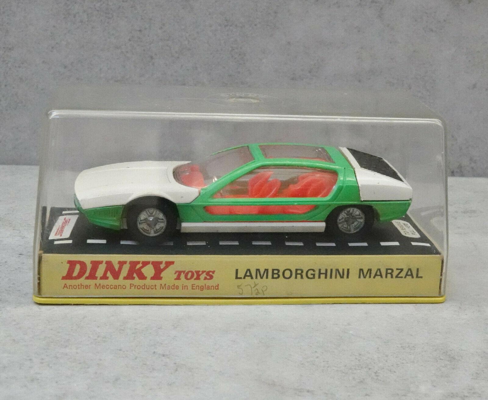

happy you have nice memories with Lamborghini Marzal. I know a similar one as yours was manufactured by Dinky Toys 1:43 with hinged front and rear. This is probably the best toy Marzal !
And here is a photo:
