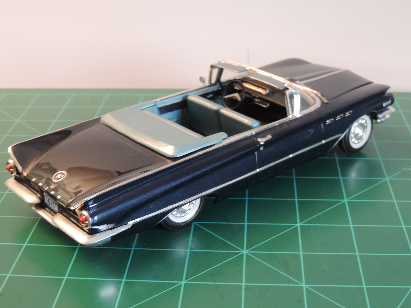

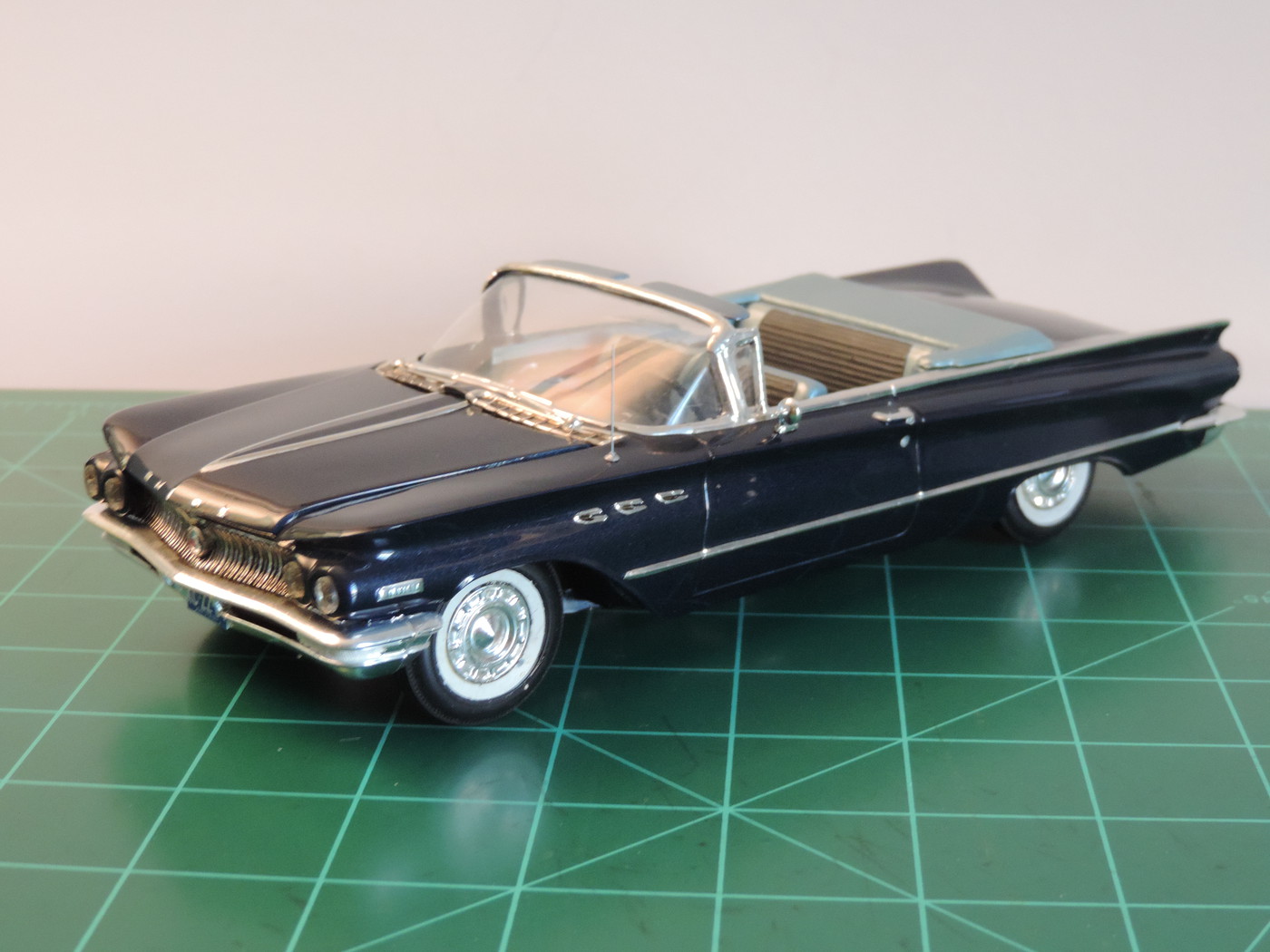

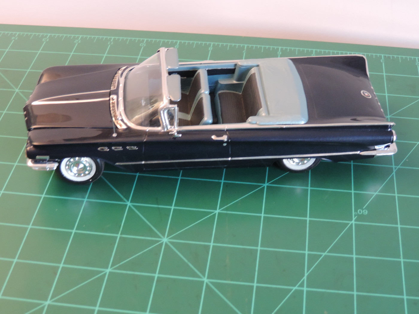

I bought a builder from one of our club members as he was thinning his collection. He is a really good builder and pays attention to detail as well, depending on the subject matter. Well he had this built up car in good shape and I wanted it for my shelf and knew they would be hard to find and probably expensive as well. So I was happy to purchase it at a reasonable price and I had added an antenna, side view mirror, and license plates. I'm happy I bought this builder.................................................................................
