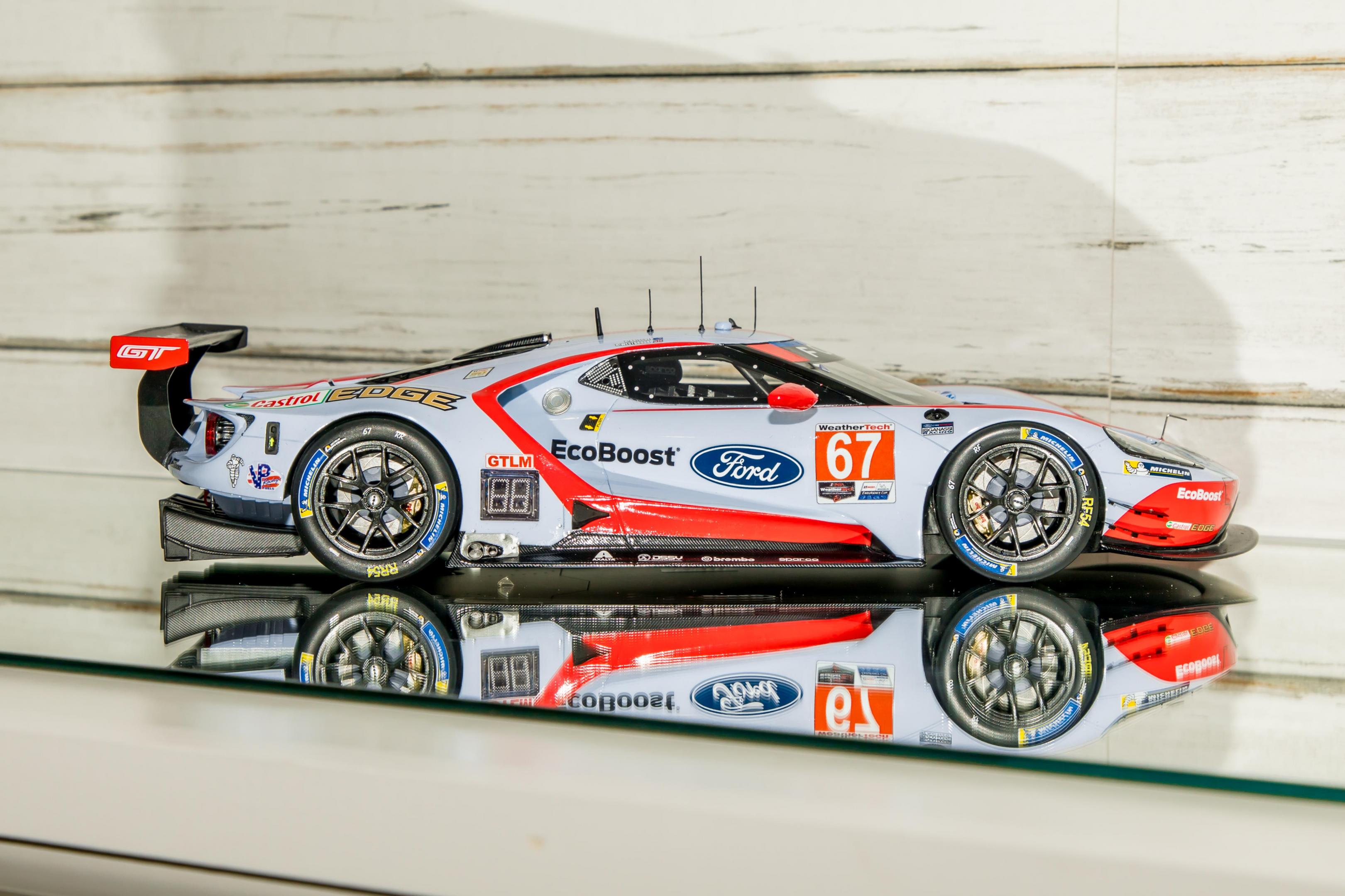

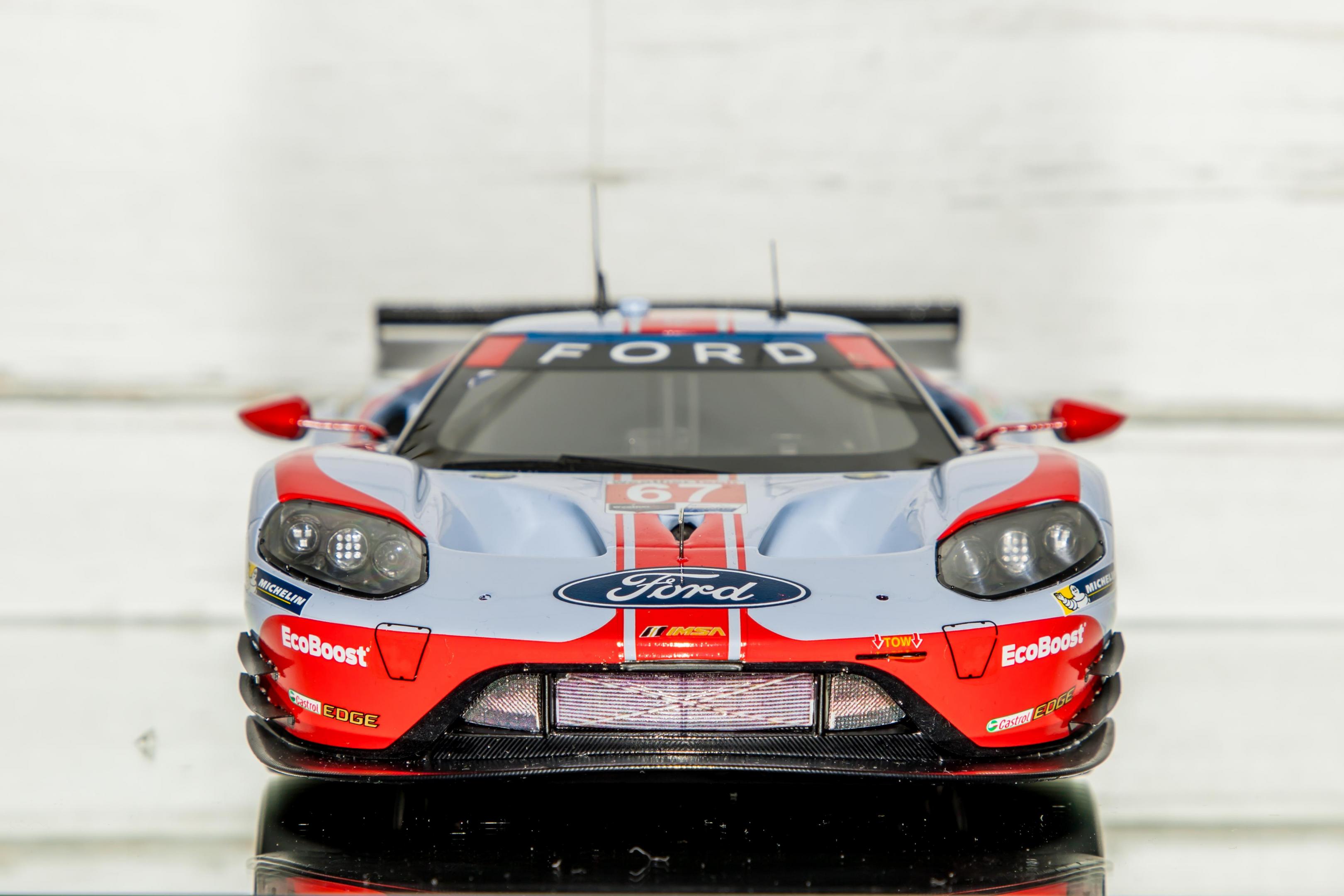

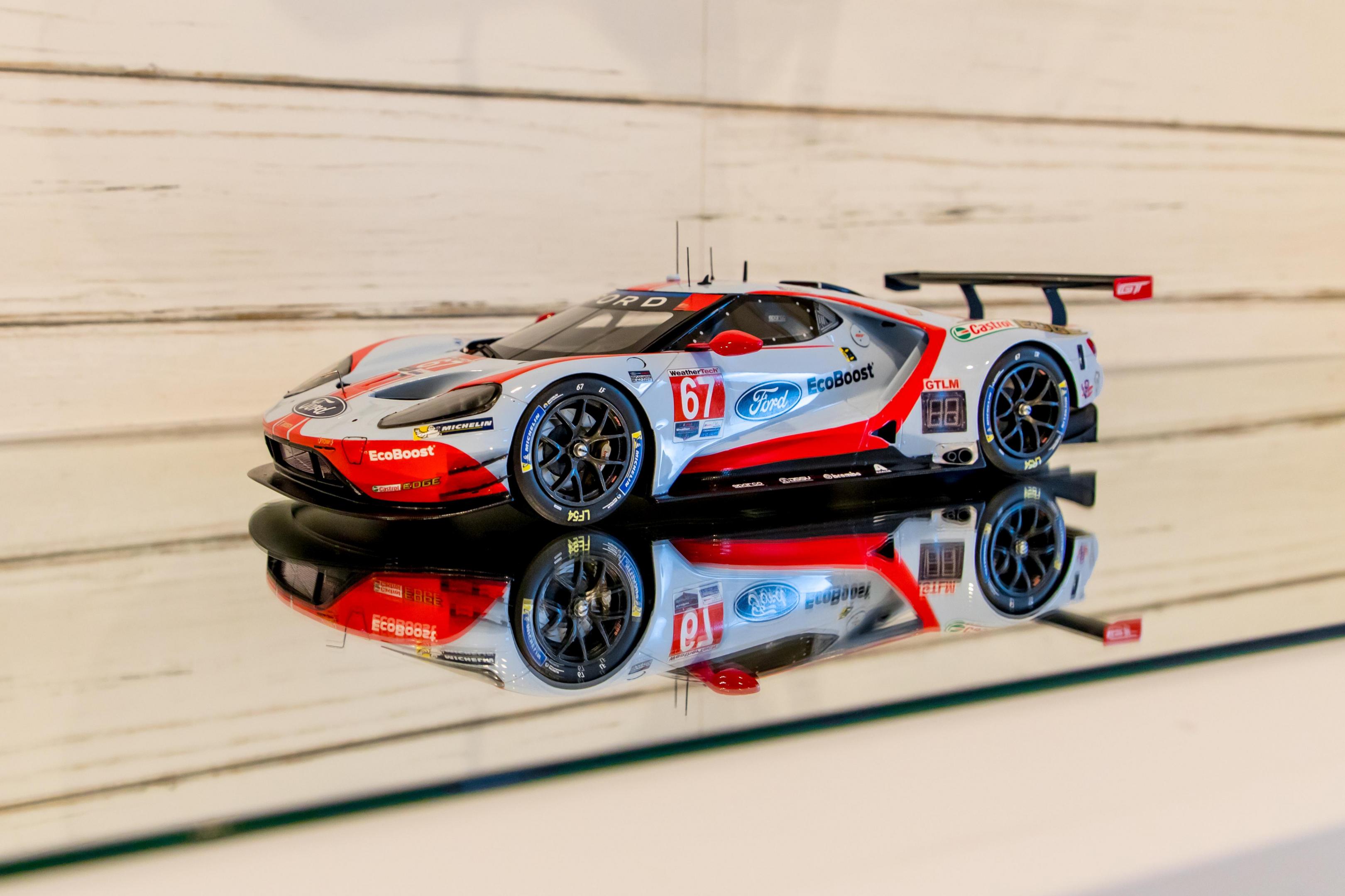

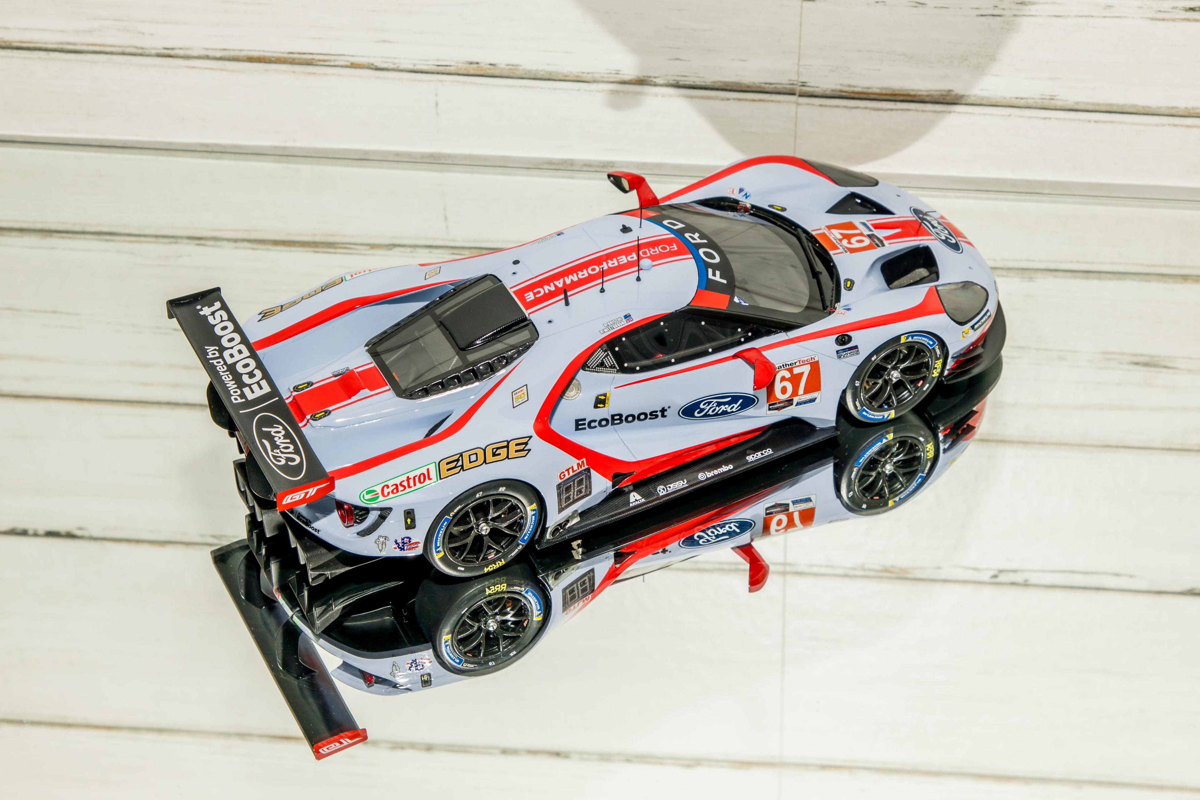

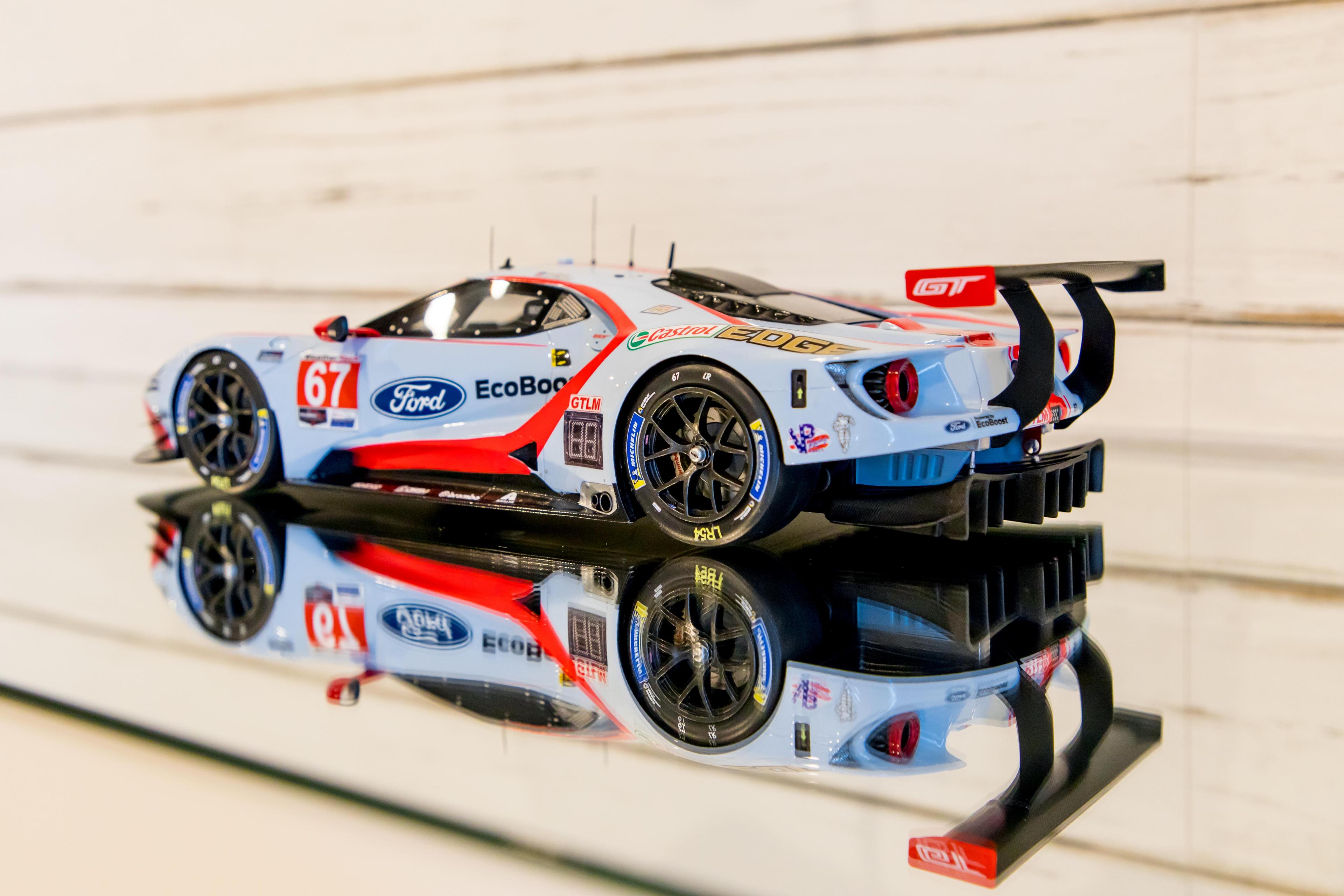

JP Models Posted January 7, 2021 Posted January 7, 2021 Finished up this project I’ve been working on for a little while. Took the 1/18 scale Top Speed 2019 Ford GT model and converted it to as close of an exact replica of the 2019 Six hours of the Glen. Removed all of the WEC Le Mans decals and livery pieces. Whatever setting solution Top Speed uses is good stuff! I found after struggling for a while with removing some of the decals that De-Solv-It actually worked the best without harming the paint. Almost all of the decals I installed, ~81 in total, I created in GIMP & Corel and had printed by Highball Graphics. Pretty pleased with the end result!

JP Models Posted January 12, 2021 Author Posted January 12, 2021 Yeah - here's a few shots of how the model comes from Top Speed. In the decal removal process, salvaged most of the main livery and paint (light blue and red), then touched up, painted the mirrors and made covers for the left side fuel connection and air jack, added the roof camera pod, and decaled according to how it ran in IMSA at the Sahlen's Six Hours. The models are light on the finer details from Top Speed like grill and extractor vent details and the tires and wheels.
