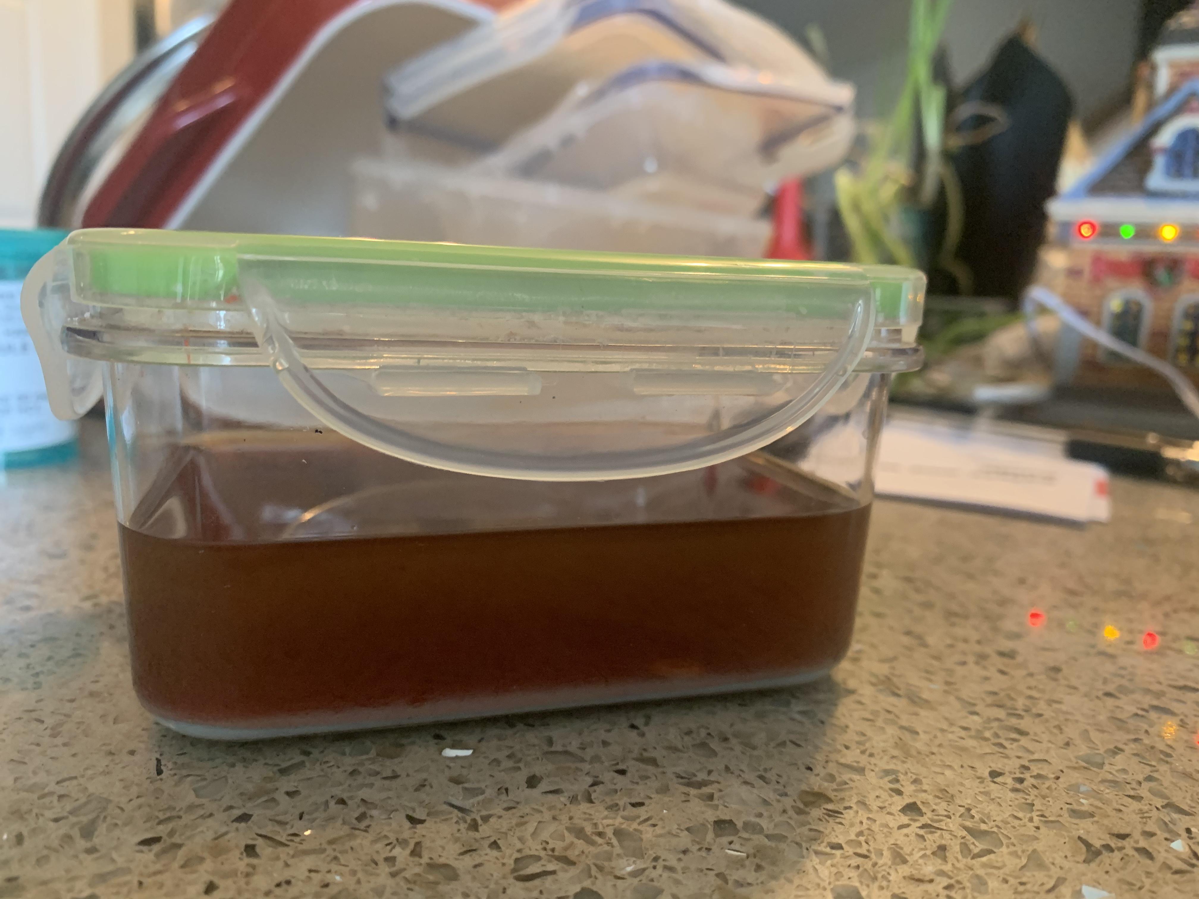

I’ve stripped about a dozen rebuilders in the same batch of super clean over the past month, some were rapid, some had to “bake” a little longer, I keep it in a sealed tub under the kitchen sink, so it’s always the same temperature.
one thing I have done is to strain it with cheap coffee filters, over one of those cheapo fine mesh strainers from the dolla store, mostly so that I can find the parts easier of find the small
ones that I may have missed.
I do have a smaller container that I use for smaller parts like engines and the like.
the rubber seals help keep the odour down and so far the wifey has not complained ??
