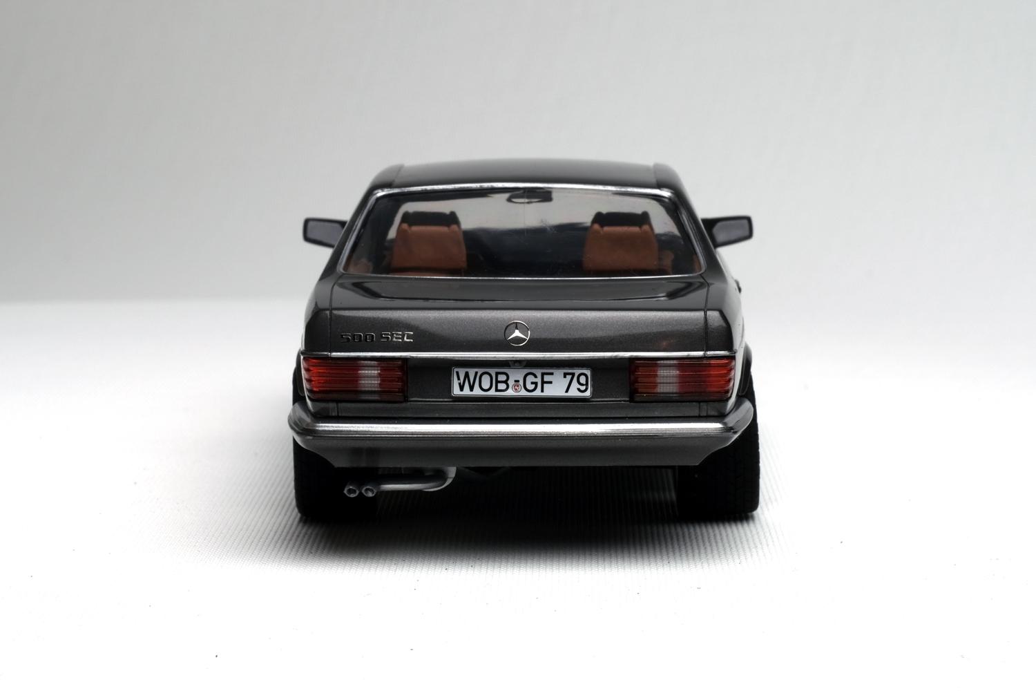

1982 Mercedes 500SEC 1/24 Tamiya vintage
I recently won this old Tamiya kit(issued in 82’) from Ebay and decide to kick off 2021 with it.
Overall it needed zero correction on the body except for mold lines, and everything fit perfectly. Apart from the wheels and metal transfers, it's a box straight build. I wish they ever released widebody AMG version!
Build details are:
  • Primed with Tamiya grey surfacer
  • Sanded off all molded emblems then applied aftermarket metal transfers
  • Two coats of Mr. Color metallic black and aluminum mixed to simulate the black pearl metallic which has very, very subtle metallic flakes.
  • Mix of Tamiya acrylics (red, yellow, brown and tan) to simulate Palomino leather interior
  • Airbrushed 2 thin coats of Tamiya lacquer clear then went 3000 grit > 6000 grit > Tamiya fine > finish compounds to keep the body lines leveled and sharp.
  • Applied BMF for the front window and light housings and masked rest of chrome trims then sprayed with Mr. color aluminum
  • Added staggered AMG OZ aero wheels from Tamiya 500SL AMG kit
  • Lowered suspension (I wanted to achieve lower ride height and when I dry fitted they were great, but somehow it turned out to be higher than I thought)

Super clean and neat. Looks like an actual car.

Those emblem transfers really help, where did they come from?  Awesome build!

Thank you! Once I finished the chrome trims, it was a breeze to finish it off

Those kits with V12 are great! I had built S600 coupe way back. As for the transfers, I used from an assorted Mercedes emblems from hobby design.

Another nice build Chang!! That interior is beautiful?
Thanks Mike! Red/Caramel are my favourite interior colors!

I just looked again at the interior color Chang and I just love it!!  Equal parts of each color or just random mix until color achieved??   Unless its a propriatory mixture (?Just kidding)

Thank you! It's my second build using airbrush and I love that I can mix colors!
7 hours ago, grodudulle77 said:
It looks like a real car , your paint job is very awesome . Outstanding work !!! ???
It was hard to polish avoiding sharp edges (ended up using q-tips for final polish) but it turned out pretty good. Thank you!

It was random mix of those tamiya acrylics! I started with brown and tan, then added small amount of red and yellow to get the right hue.
