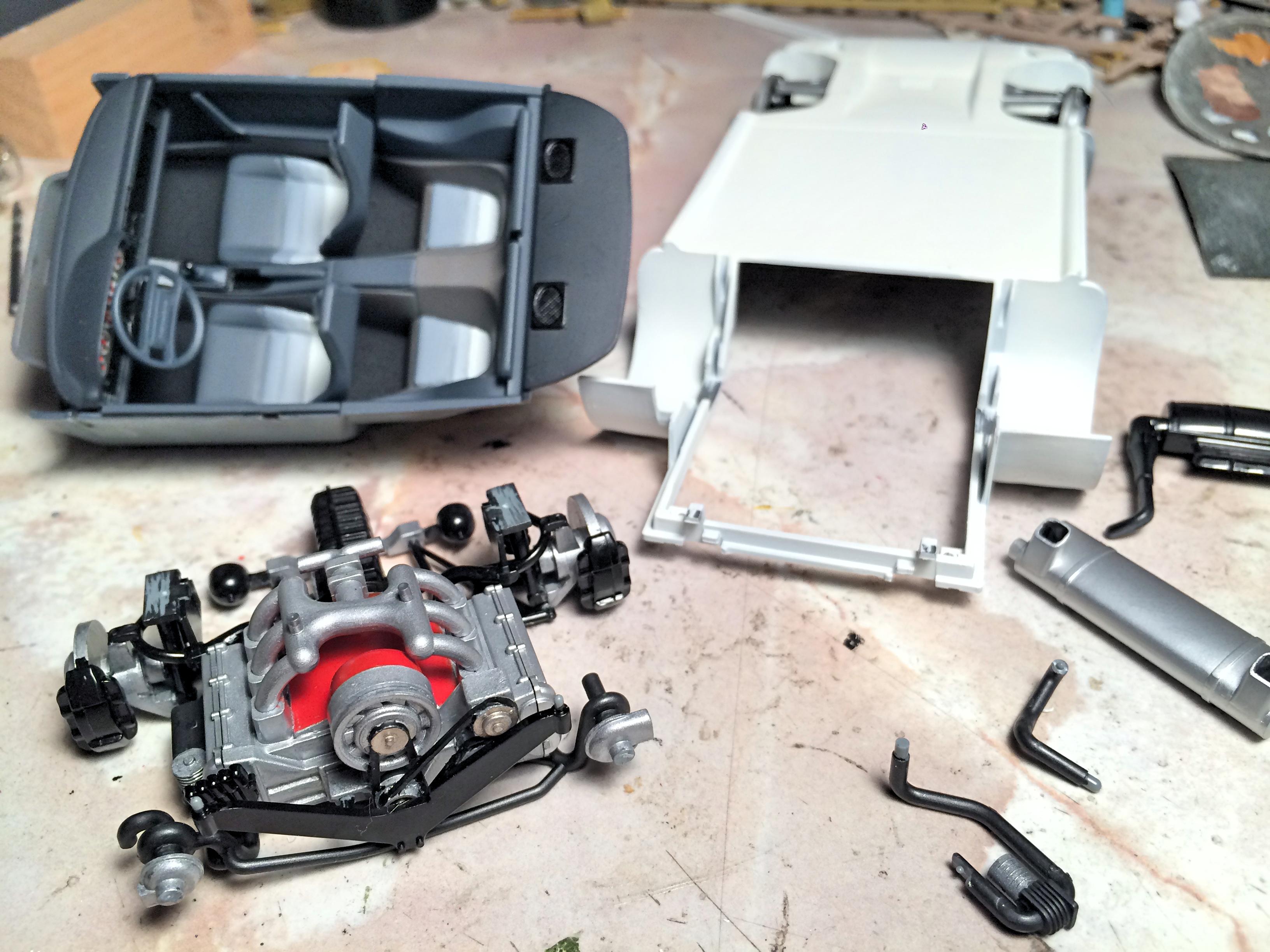

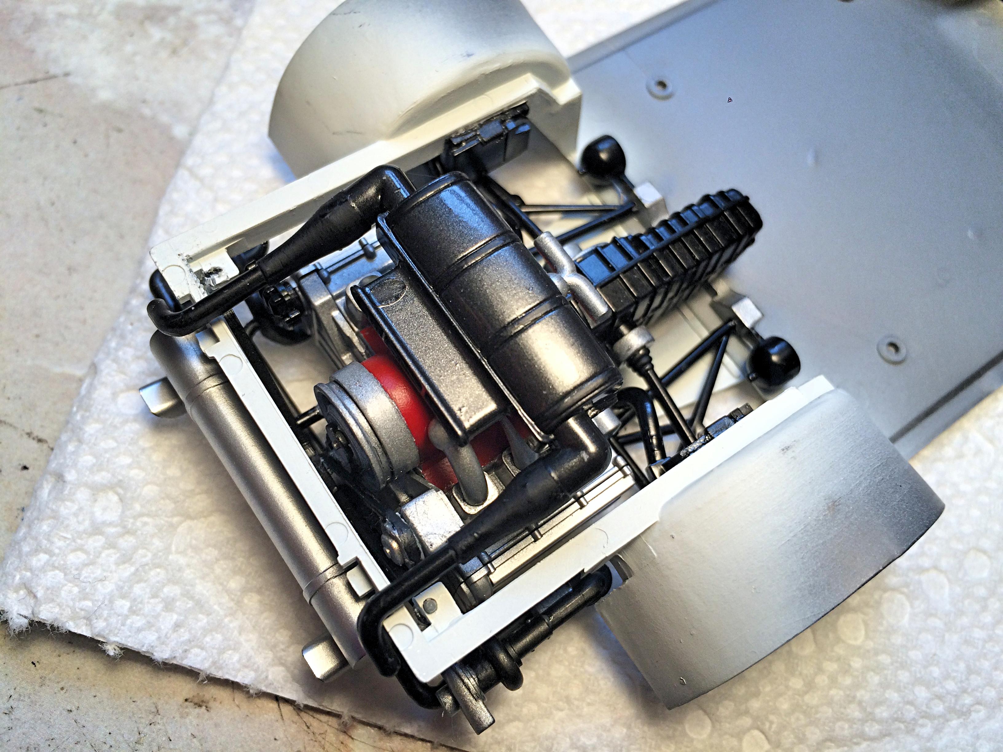

JollySipper Posted January 14, 2021 Share Posted January 14, 2021 I'm excited to be working on this kit...... it's the well-known Tamiya Porsche 959. If I had a Porsche, I would want it to be one of these..... Got this kit in a trade with a good friend on here and started on it the day it arrived. I'm just working on the engine now, this is the first two steps of the build. Looking at reference pics, the block and cylinders are a dull aluminum, where the cam covers and front plate are a more shiny silver aluminum, I tried to replicate that....... also washed the cam covers a bit to bring out the detail in them some..... This is going to be a fun build! I hope you guys follow along....... Quote Link to comment Share on other sites More sharing options...

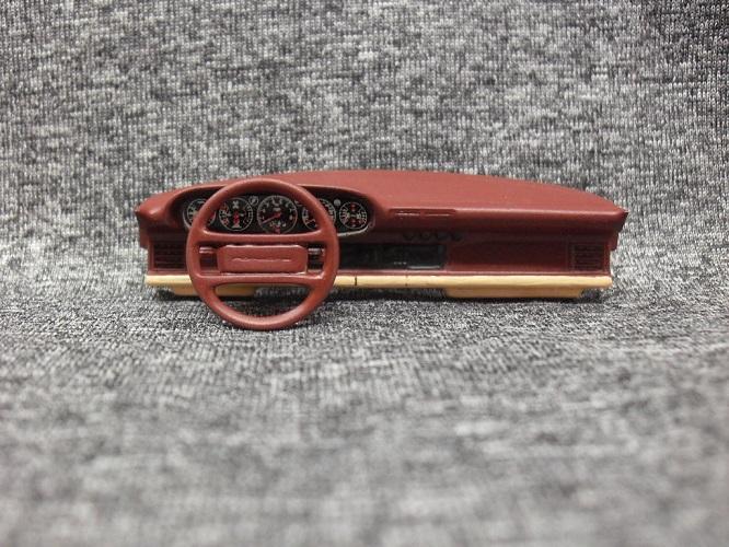

JollySipper Posted January 17, 2021 Author Share Posted January 17, 2021 Thanks, Fellas! Got some more done on this. The next few steps, anyway... Also decided on the interior color! I found a pic online of a two-tone ruddy brown and tan that I thought looked good, so I'm going with that. Still need to put some satin clear over this dash to give it a sheen........ Thanks, and comment freely... Quote Link to comment Share on other sites More sharing options...

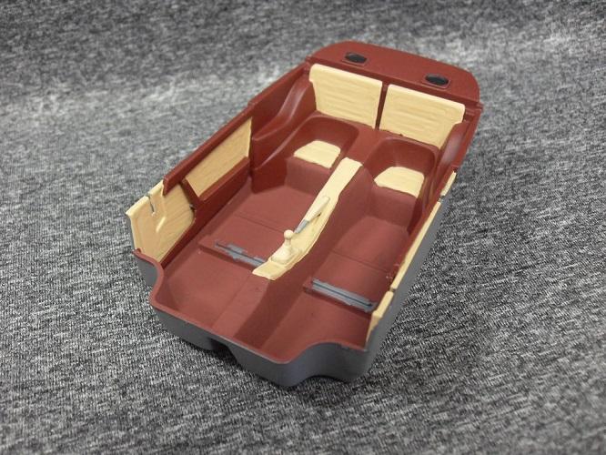

JollySipper Posted January 20, 2021 Author Share Posted January 20, 2021 On 1/17/2021 at 8:09 PM, 89AKurt said: it's a sweet kit of an iconic groundbreaking car, Porsche's first foray into supercar'ness, is what I've read about this car...... Got the interior pretty much done! It's just two Folk Art colors cleared with a matte clear...... still need to paint the seats, there's some ejector pin marks on them that need to be fixed first. Thank you, and feel free to comment/make suggestions........ Quote Link to comment Share on other sites More sharing options...

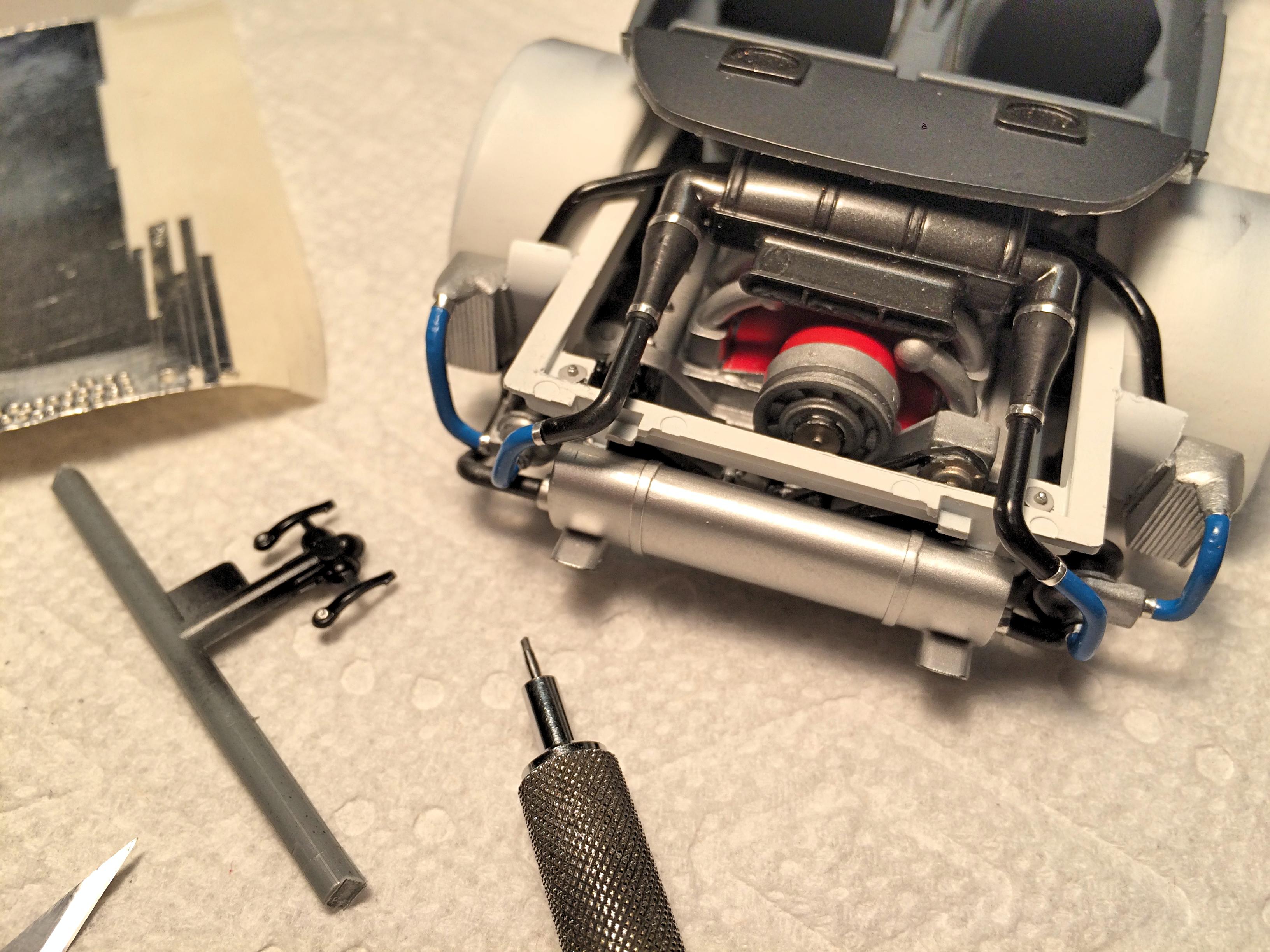

89AKurt Posted January 22, 2021 Share Posted January 22, 2021 1 hour ago, JollySipper said: Thanks for following along, guys! Question for you Kurt...... Is it going to be possible to get this back apart once I try to test fit? or Is it a one and done kind of deal? I'm thinking I should try to fit it together once it's time for it to stay together...... if that makes sense? Going from (fading) memory, typical Tamiya snap fit, it can be undone. Start with fitting only the chassis into the body. The cross member behind the engine, it's like an angle iron, that's where the issue is. I deleted the a/c pump, irrelevant for this. The black Y member, getting it into the holes is the problem. I think taking a sanding stick or file to the cross member, on the engine side, will give some clearance. I had to take drastic action to clamp when gluing together. You can see where I boogered up the left pin mount hole. It's up to you to try this, drill those holes bigger, so there is leeway to slop the engine in. I punched aluminum washers to hide the mess, you could drill and then shape from plastic sheet. (ignore the intercooler piping) When I built the Paris-Dakar, the resin kit had a mediocre copy of the cross member. I cut it out, and made a new aluminum angle. Bottom line, lots of test fitting this area of the kit. Do it before installing the interior and glass. Hope this helps. Quote Link to comment Share on other sites More sharing options...

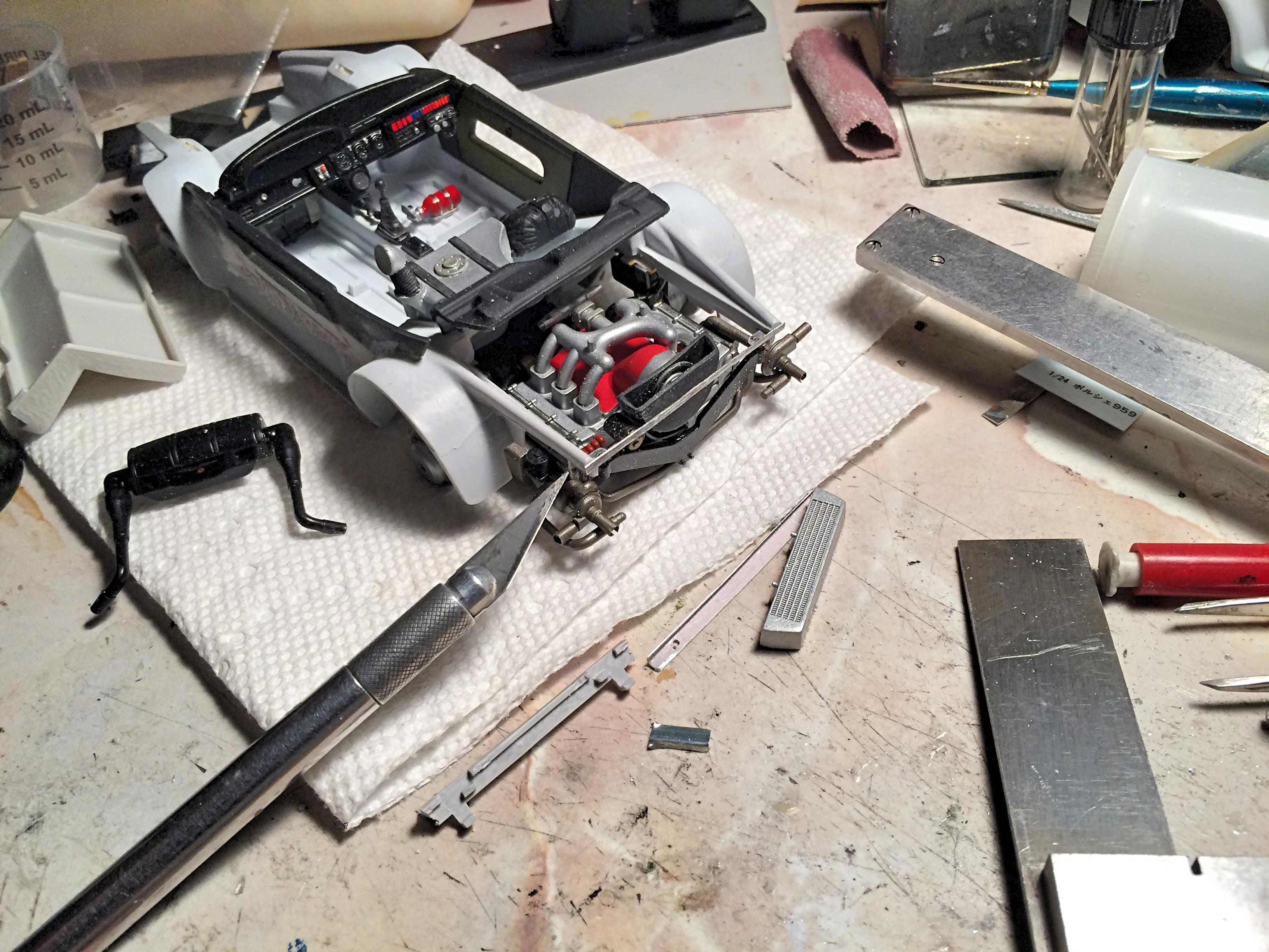

JollySipper Posted January 31, 2021 Author Share Posted January 31, 2021 I just wanted to give you guys an update on this..... I managed to get the engine assembly to fit into the engine bay! It took some trimming at a few places. First, I had to trim up in the wheel well some (area in yellow circle)..... Then some trimming was needed at the ends of the stabilizer and the front edge of the shock tower.... (yellow arrows) I'll touch those up, and the whole assembly should relax into the engine bay...... The only damage during the test fit was that I broke off one of the tabs that supports the engine in the bay. Gotta figure out how to repair that...... Anywhoo, that's the progress for now! Thanks for looking, and feel free to comment.... Quote Link to comment Share on other sites More sharing options...
