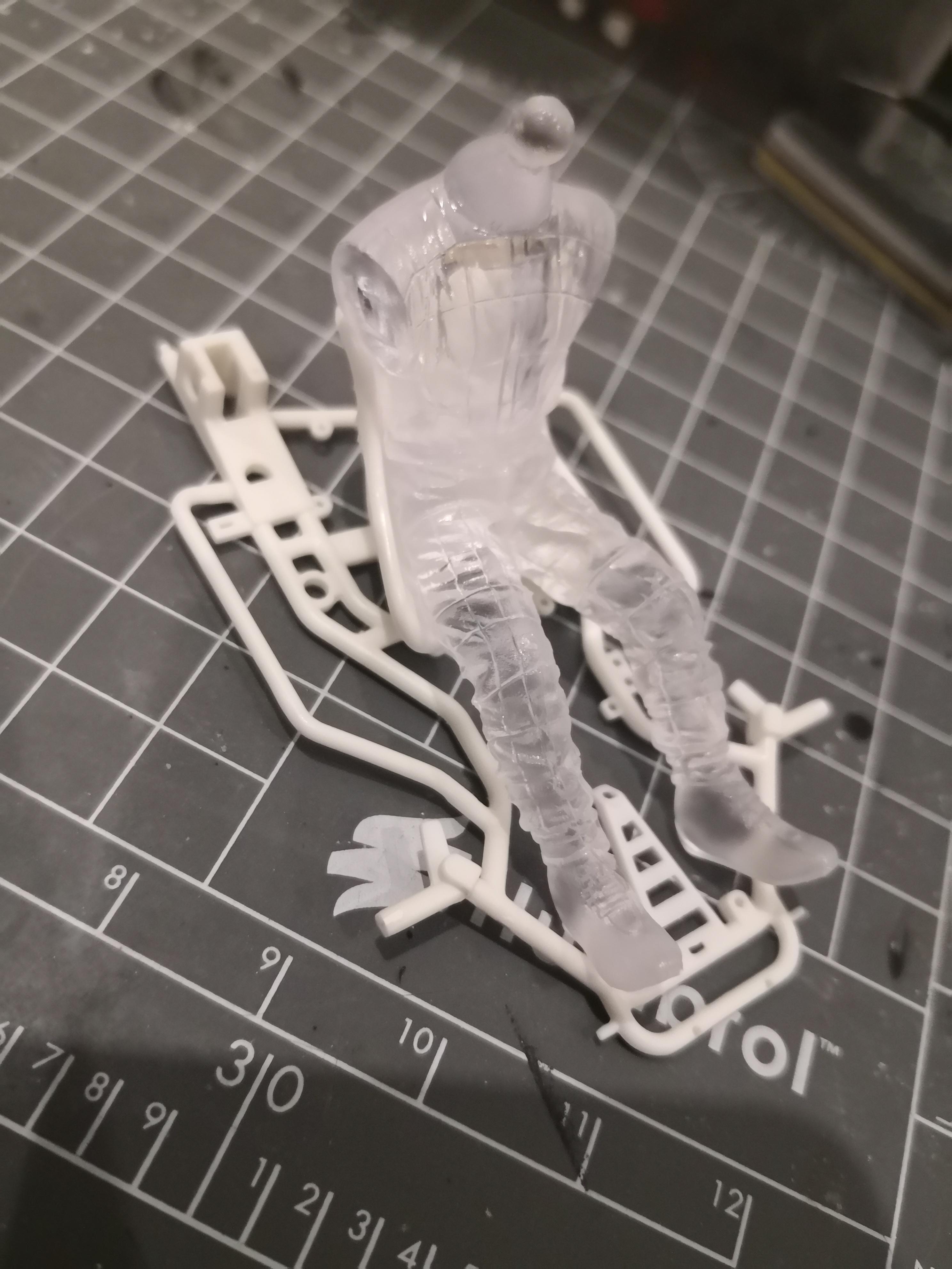

IanH Posted January 31, 2021 Author Share Posted January 31, 2021 4 minutes ago, Rich Chernosky said: This is a facinating project and I had no idea Fujimi even made this kit. What scale is it and is the driver figure included. Look forward to seeing it completed. This is 1/20 scale, Fujimi even have the 1993 kart as well (I have both 😁). Yes, the driver figure is included. Quote Link to comment Share on other sites More sharing options...
Rich Chernosky Posted January 31, 2021 Share Posted January 31, 2021 3 hours ago, IanH said: This is 1/20 scale, Fujimi even have the 1993 kart as well (I have both 😁). Yes, the driver figure is included. Thank you Ian, looks like I will have to go searching. This should fit in well with my 1/20 F-1 collection. I am a big Senna fan. You are doing a great job with both your WIP's.I am following them now. Quote Link to comment Share on other sites More sharing options...

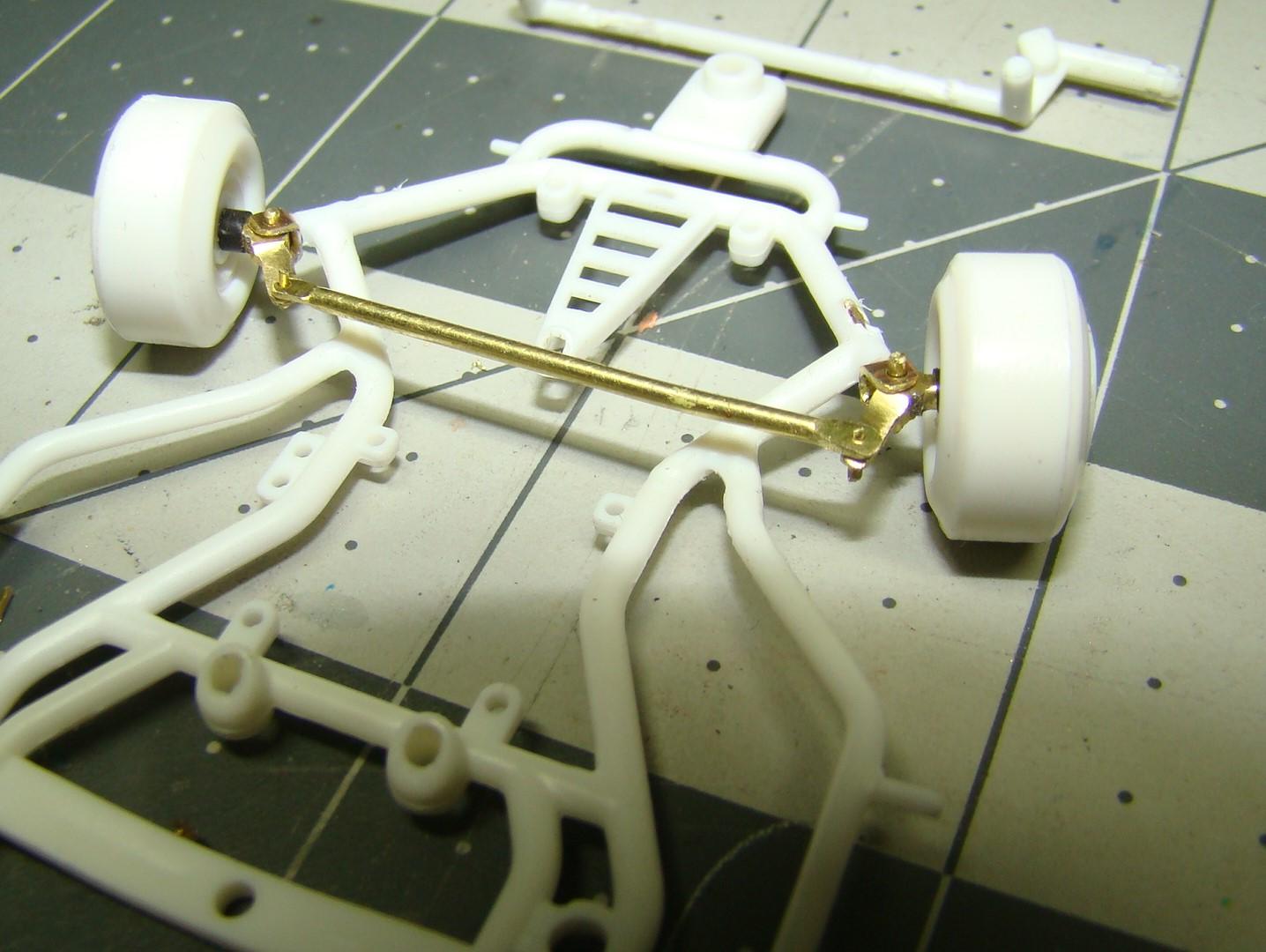

Rich Chernosky Posted March 9, 2021 Share Posted March 9, 2021 Ian...found one of these kits and couldn't wait to start it. I really liked your idea about the tie rod but as you can see I took it a step further. One of my pet peeves on models is non steering wheels. If it can be done I will do it. I am going to leave all the parts in brass. Not prototypical but I like to show off my handiwork. How is yours coming ?? Cheers Rich Quote Link to comment Share on other sites More sharing options...

IanH Posted March 9, 2021 Author Share Posted March 9, 2021 3 hours ago, Rich Chernosky said: Ian...found one of these kits and couldn't wait to start it. I really liked your idea about the tie rod but as you can see I took it a step further. One of my pet peeves on models is non steering wheels. If it can be done I will do it. I am going to leave all the parts in brass. Not prototypical but I like to show off my handiwork. How is yours coming ?? Cheers Rich Wow Rich, that's amazing skills and craft with the steering 👌 I haven't done much for a while now on mine. Quote Link to comment Share on other sites More sharing options...

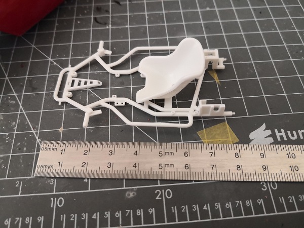

IanH Posted April 27, 2021 Author Share Posted April 27, 2021 On 3/9/2021 at 6:23 AM, CabDriver said: Great start! I’ll be following! I’ve wondered about building one of these but I can’t quite visualize how big a 1:20 kart is...is it kinda 1:25 car size-ish? Apologies for the lack of response... Here is a photo of the kart against a ruler... Length of 8cm, which is just over 3inches depending on which side of the pond you are on... Quote Link to comment Share on other sites More sharing options...
CabDriver Posted April 27, 2021 Share Posted April 27, 2021 2 hours ago, IanH said: Apologies for the lack of response... Here is a photo of the kart against a ruler... Length of 8cm, which is just over 3inches depending on which side of the pond you are on... Interesting! I just couldn't picture how big one of these would be - thank you for the response and photo! Quote Link to comment Share on other sites More sharing options...

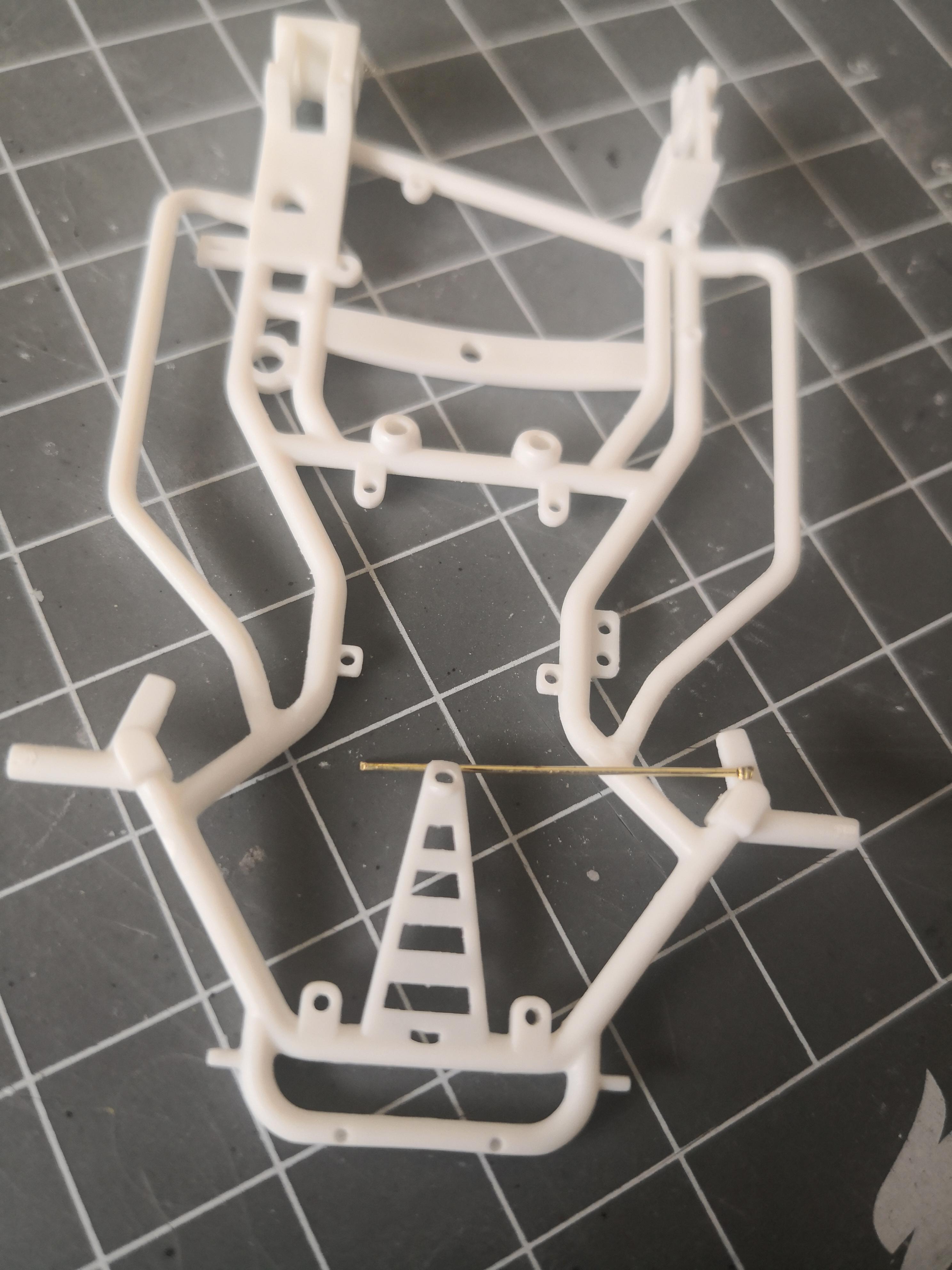

IanH Posted December 7, 2023 Author Share Posted December 7, 2023 Been working on a few things, here's a quick update on the steering column and fuel bottle. The kit parts shown below are for a more modern kart, and not how this DAP kart was raced. I cut the steering column and used 1mm brass to create the bars which look a lot closer to the real thing. Still some work to do on it, but much happier with the look already. I've also been playing around with some designs for the fuel bottle, here's an almost done prototype, not 100% happy with it, but hopefully the next version will be as I intend it. Quote Link to comment Share on other sites More sharing options...

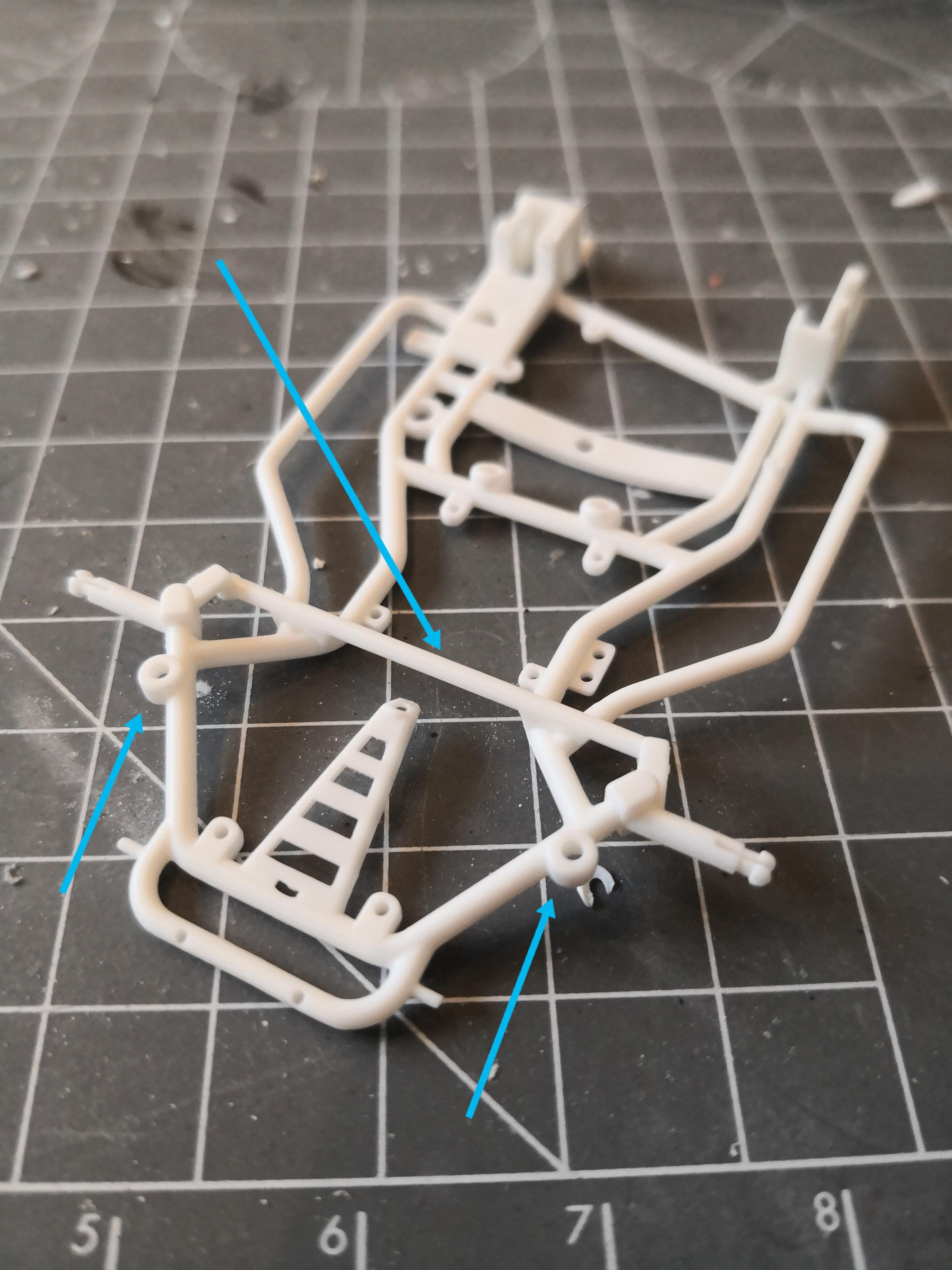

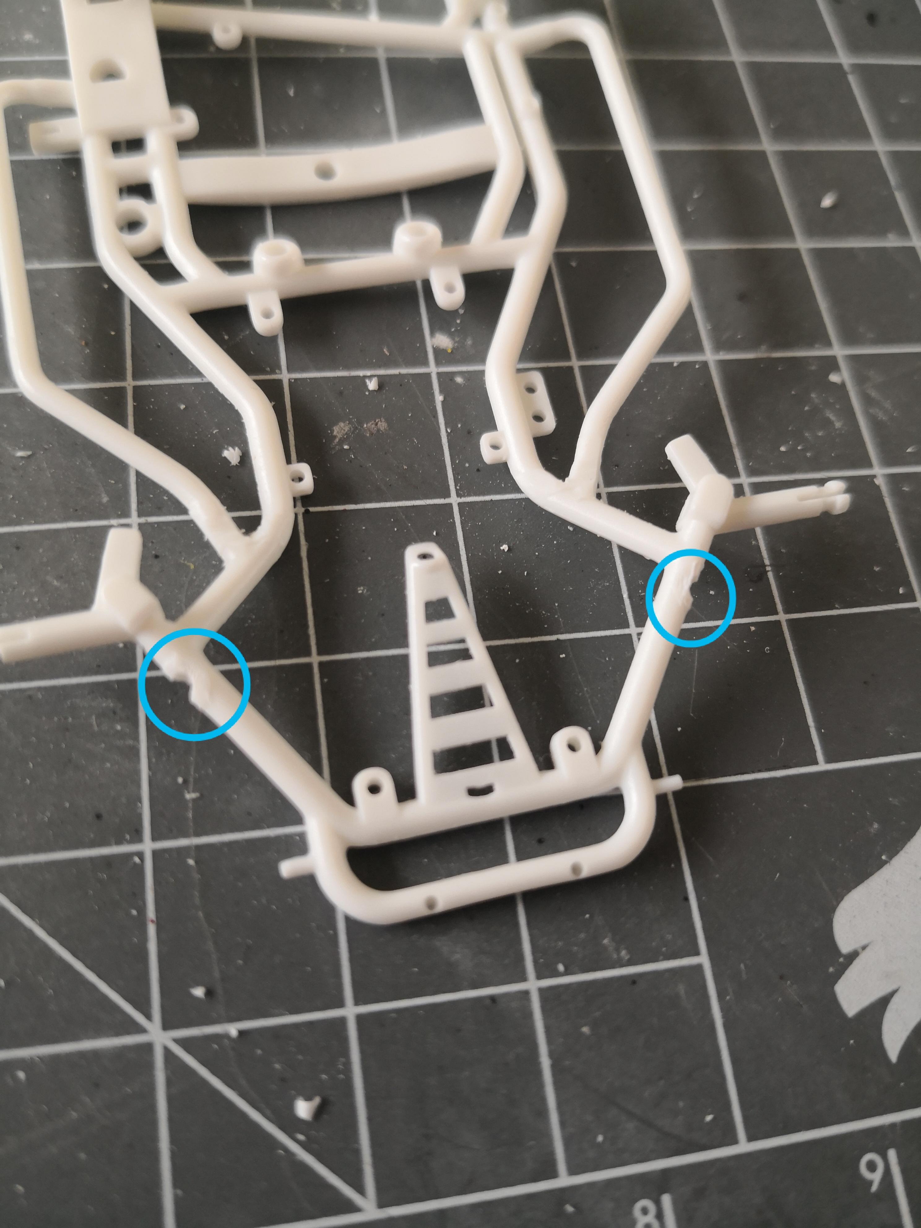

IanH Posted December 8, 2023 Author Share Posted December 8, 2023 The frame of this kit is also not quite right according to the reference photos, with the main difference being these bars on the side which the side pods of a more modern kart would fit to. These did not exist on the original, but had these smaller bars extending out towards the rear wheels. Removed the side bars, and busy recreating the smaller ones.... Still in progress, but trying to get this right. Quote Link to comment Share on other sites More sharing options...
IanH Posted December 8, 2023 Author Share Posted December 8, 2023 Pretty much satisfied with the modifications made to the frame. Need to now focus on the motor, then hopefully can start laying down some paint 😁 Quote Link to comment Share on other sites More sharing options...
