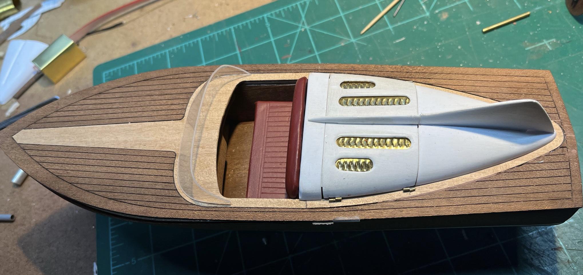

Truck, boat and trailer done! Teaser pic! More pix in under glass!

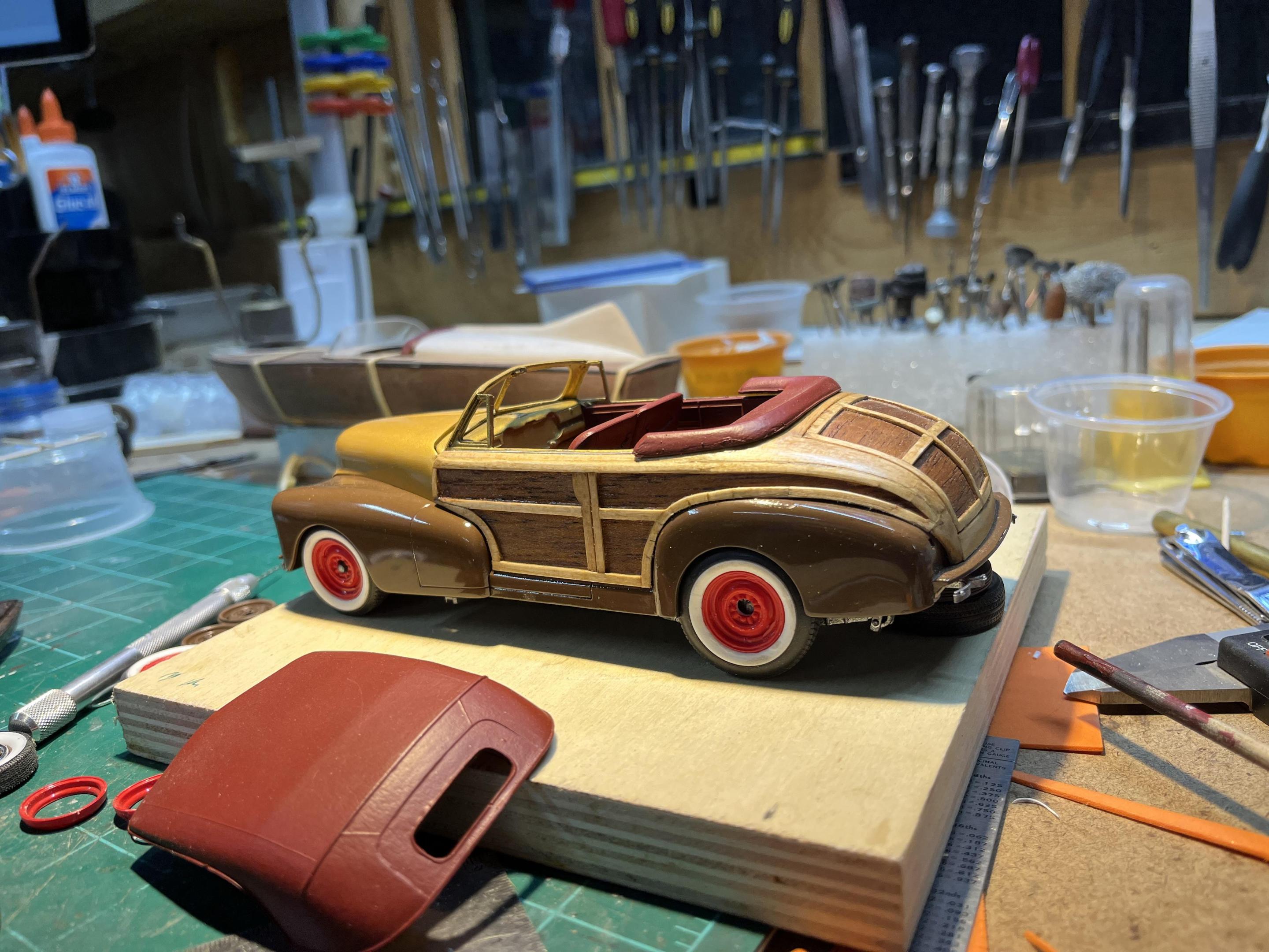

Got the wood done on the Chevy, and applied a couple coats of satin spar varnish.  Put a couple coats of Mr. Color gloss clear coat on the paint.  Needs to be wet sanded and rubbed on the paint yet, and some BMF around the windshield frame and vent windows.  Found a set of wheels and tires in the parts box, that I’ll paint either brown or gold to match the body.  Going to paint the uptop, boot cover, and interior a deep burgundy, then on to all three engines for the car and boat together.

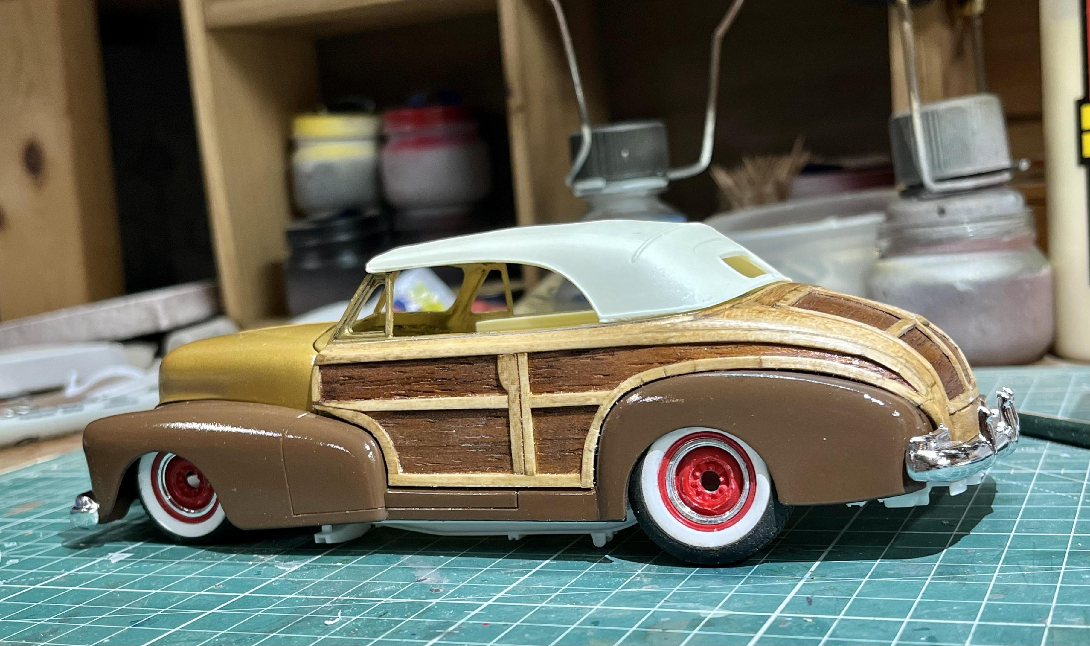

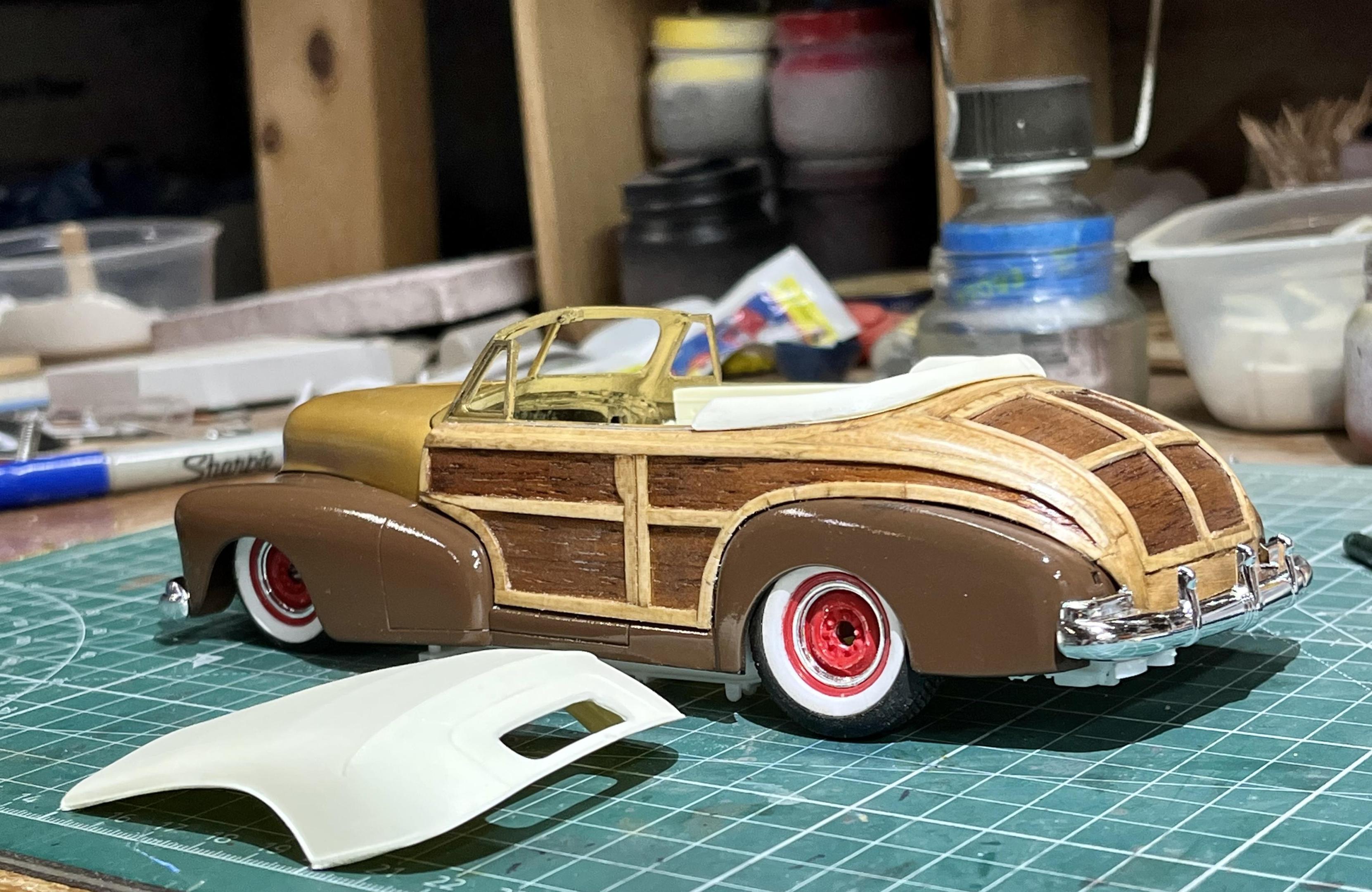

Well, it’s been a while since my last update.  Now that Paul has finished his amazing combination, I guess it’s been left up to me to carry on this thread, and I am a notoriously slow builder, so the updates sometimes are spread out quite a bit.

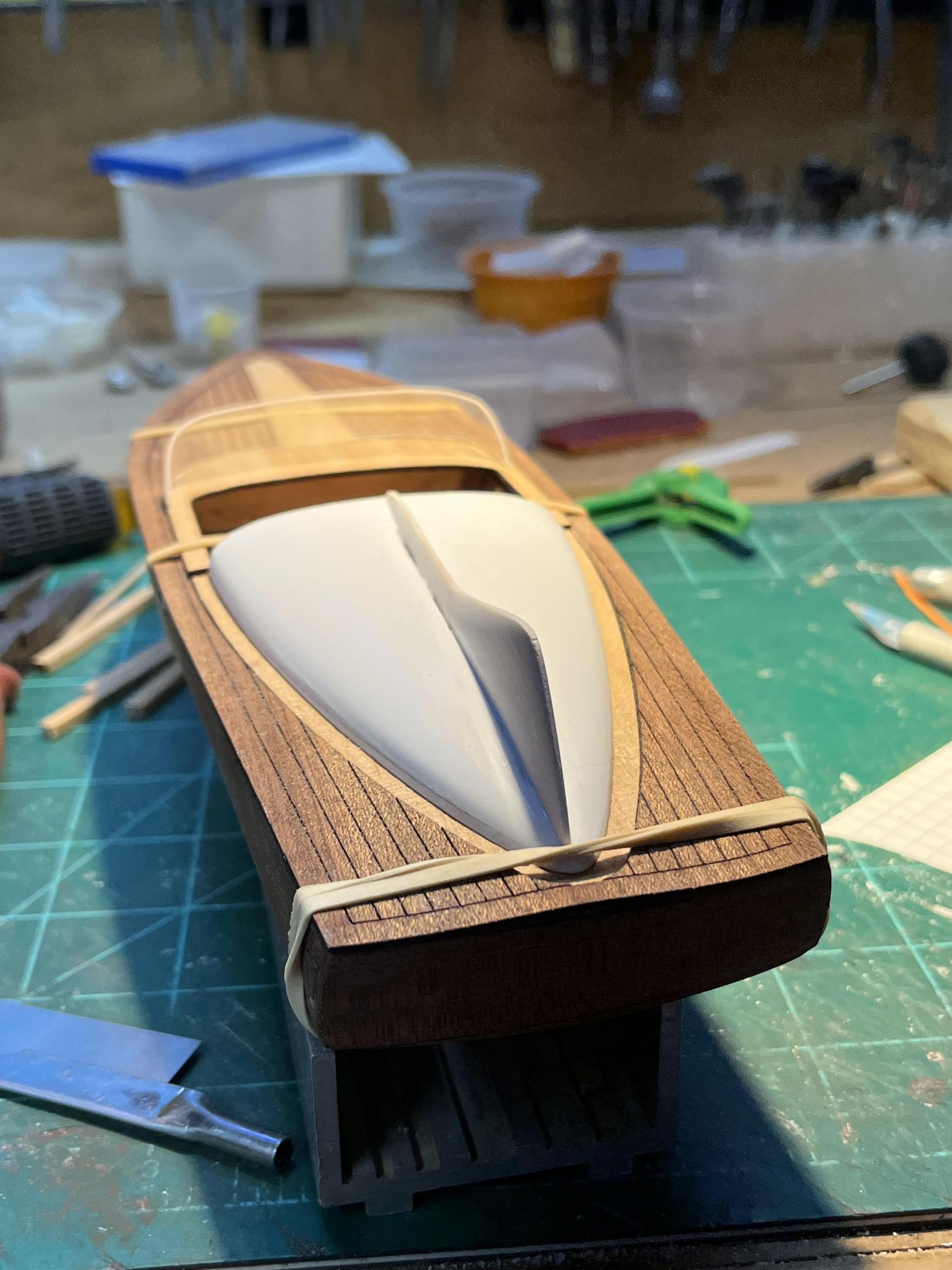

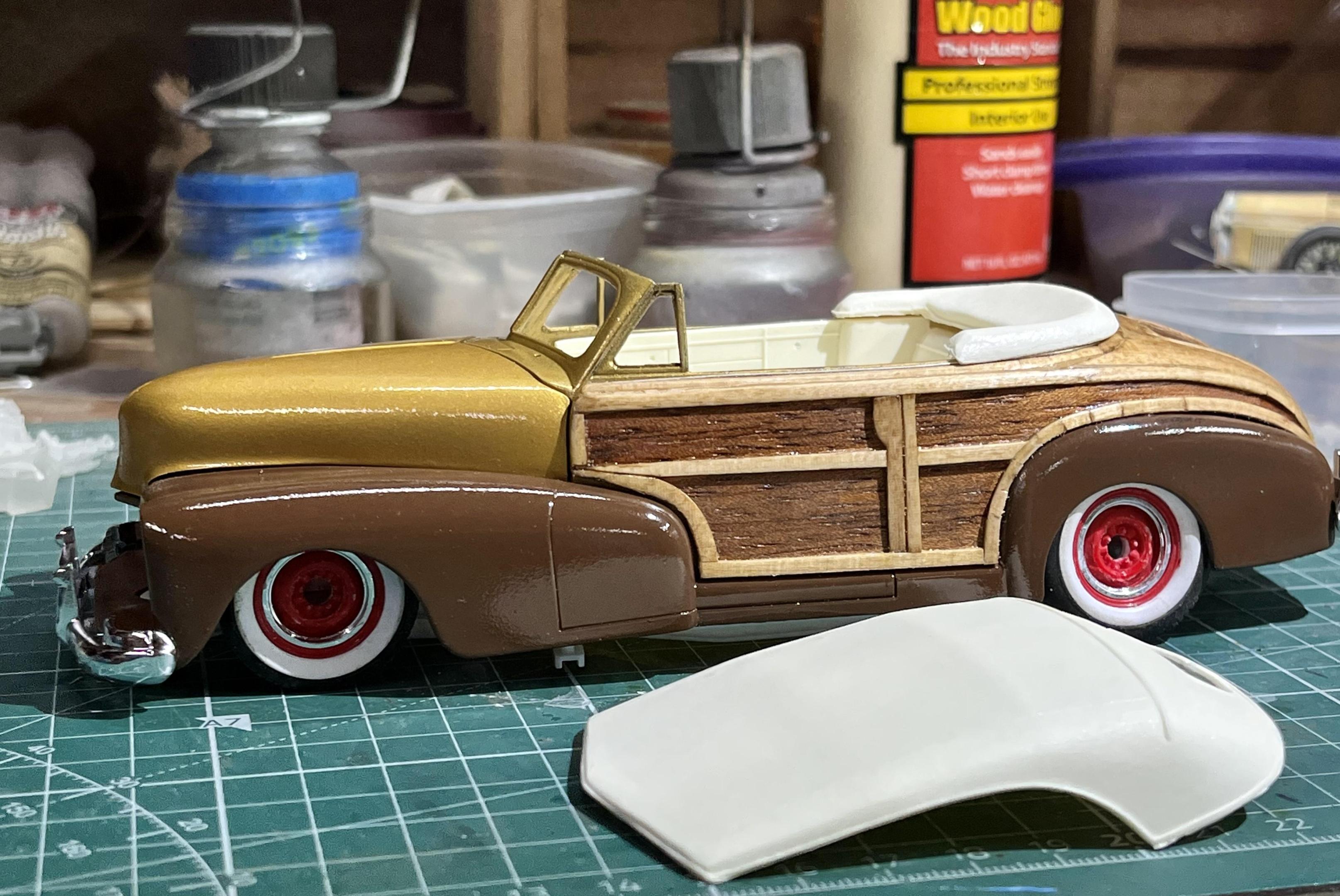

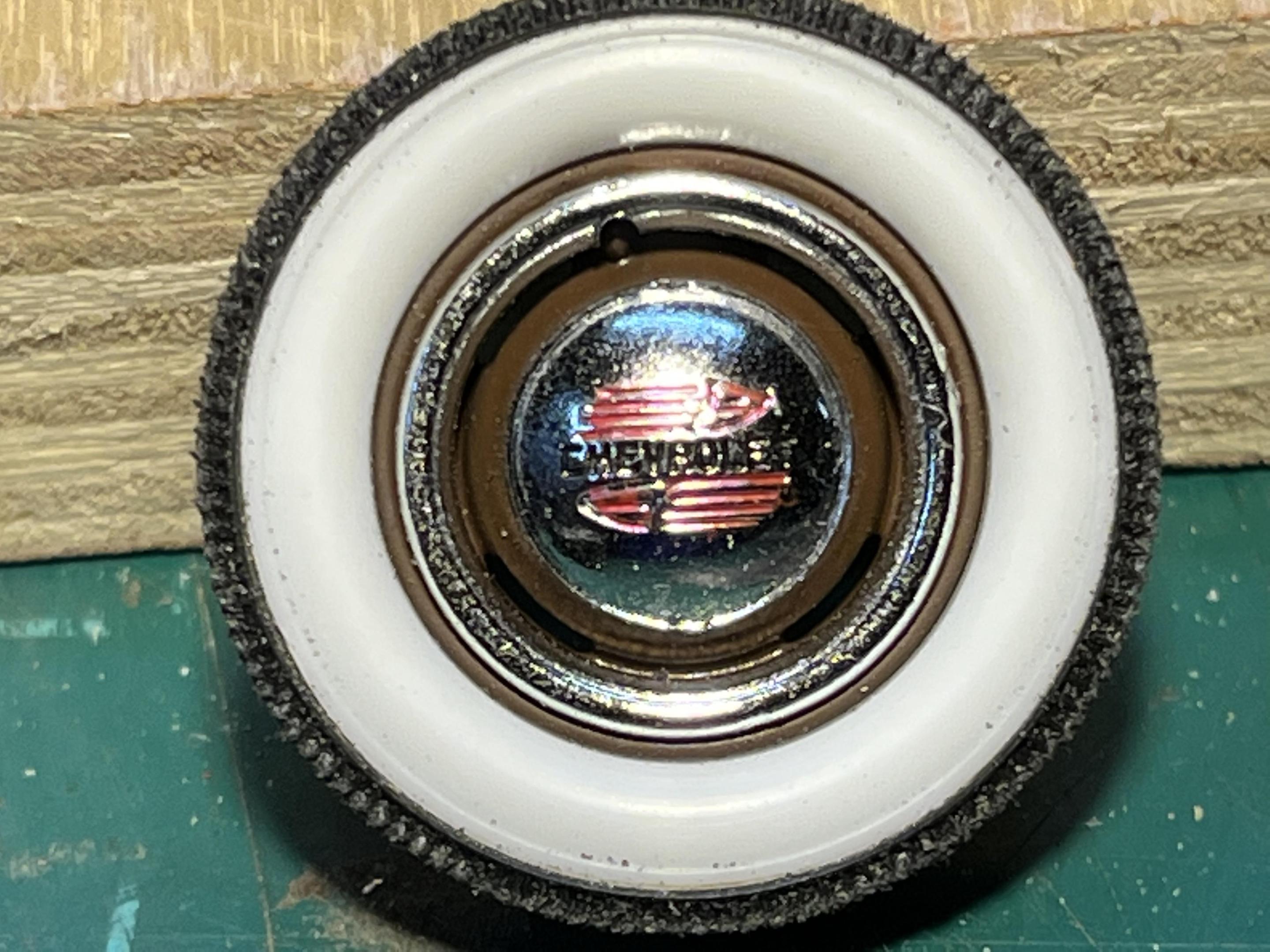

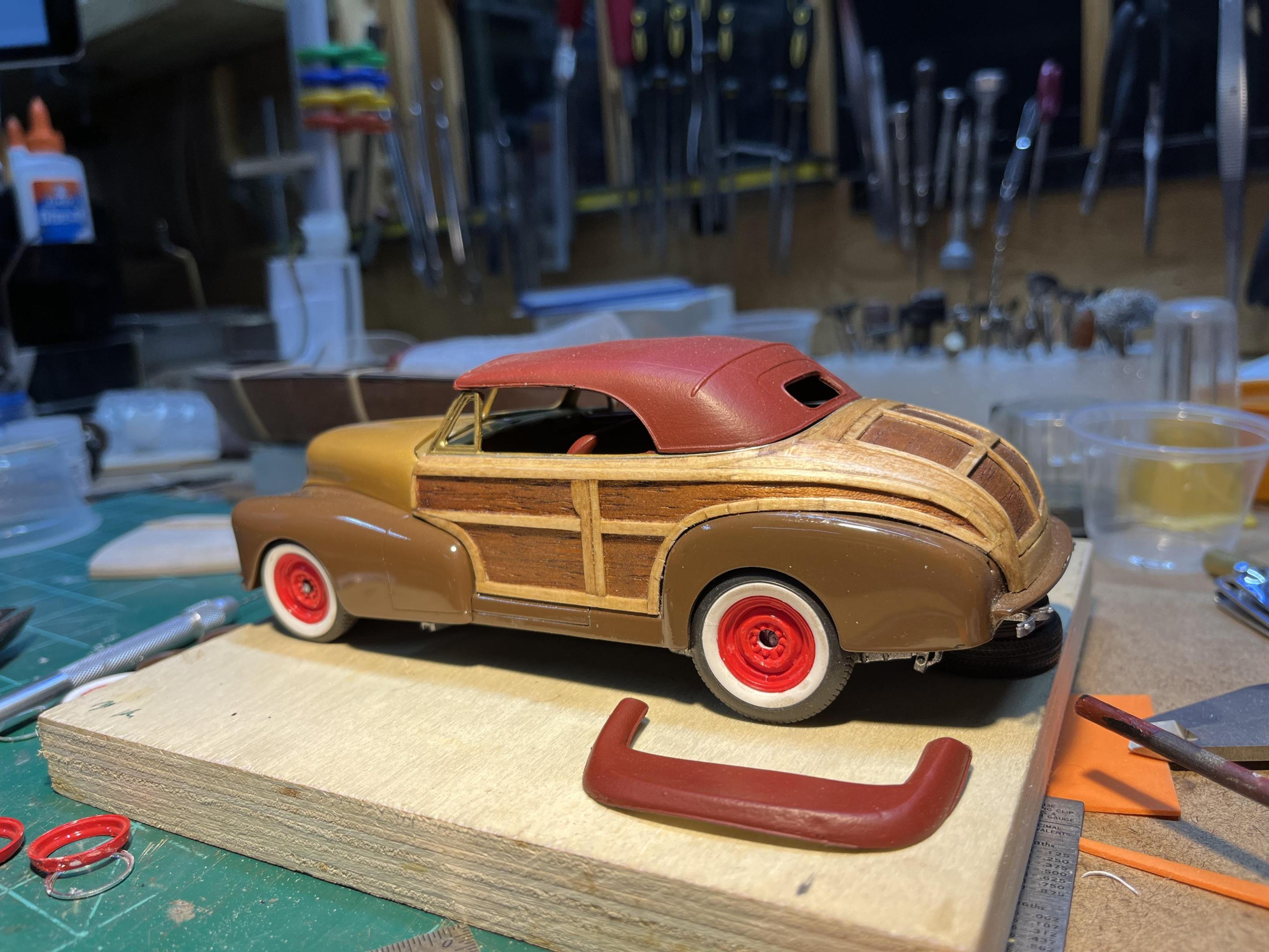

Since my last update, I have finished the wood, and the paint on the body for the Chevy, and painted the interior and top.  The pics here show the car still in mockup with different wheels and tires than I will ultimately be using.CD20992A-B034-4044-A881-713D25EDA8BD.thumb.jpeg.d23d1e5e5b89b08eeb6ab792ae7309e6.jpeg5805EA47-2423-45D4-AF28-01DC48A18577.thumb.jpeg.76577b4f7a475f1db5653c4d48cbee7c.jpeg  This pic shows the wheel/tire combo that I intend to use.  9CDAB4D0-BE06-4893-873C-AE21B8A30461.thumb.jpeg.2177f826ded7dc81653881cfb1709f14.jpegI still haven’t done anything with the engines other than to rough one of them together to check fitment in the car and boat, but they will be coming soon.

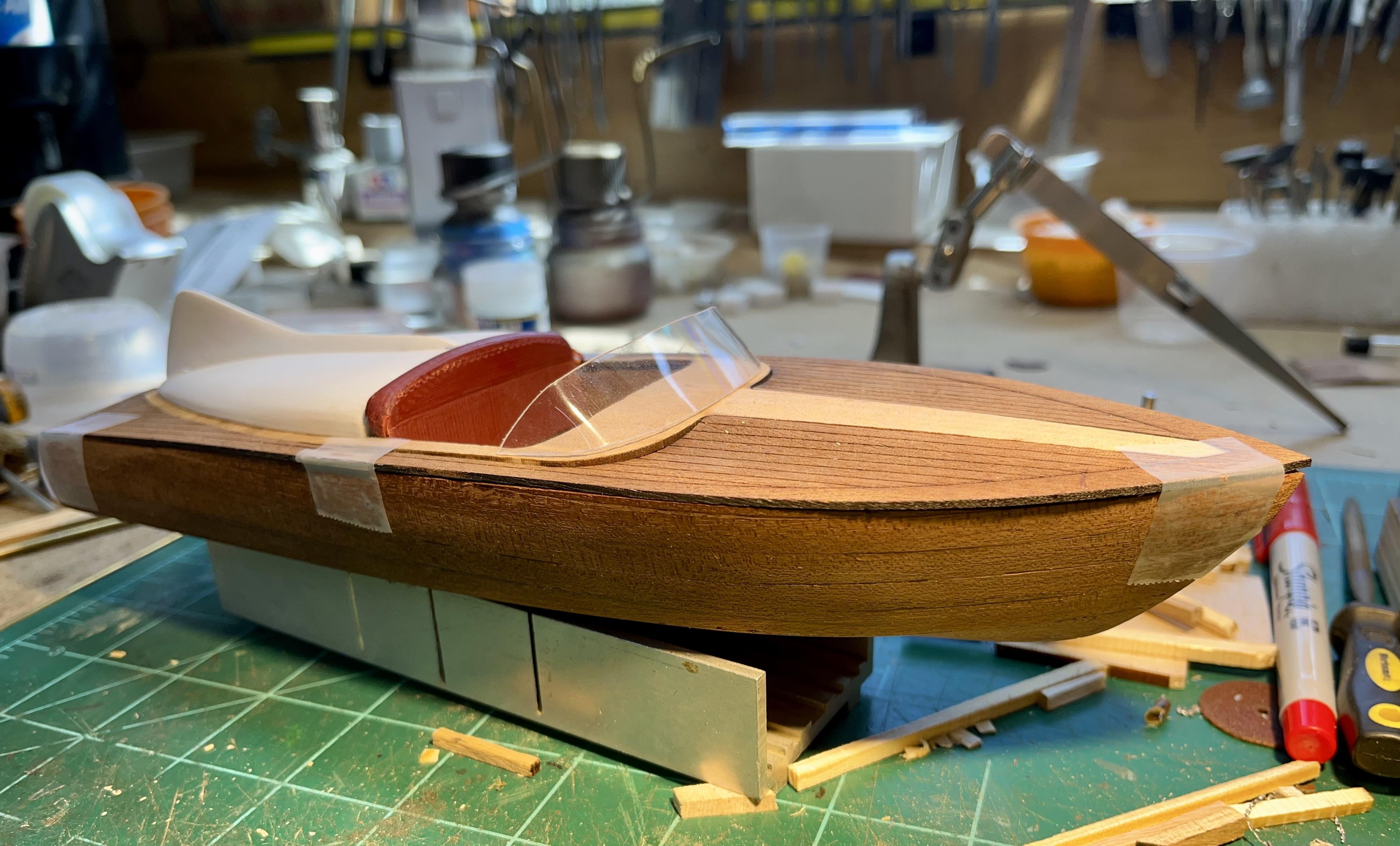

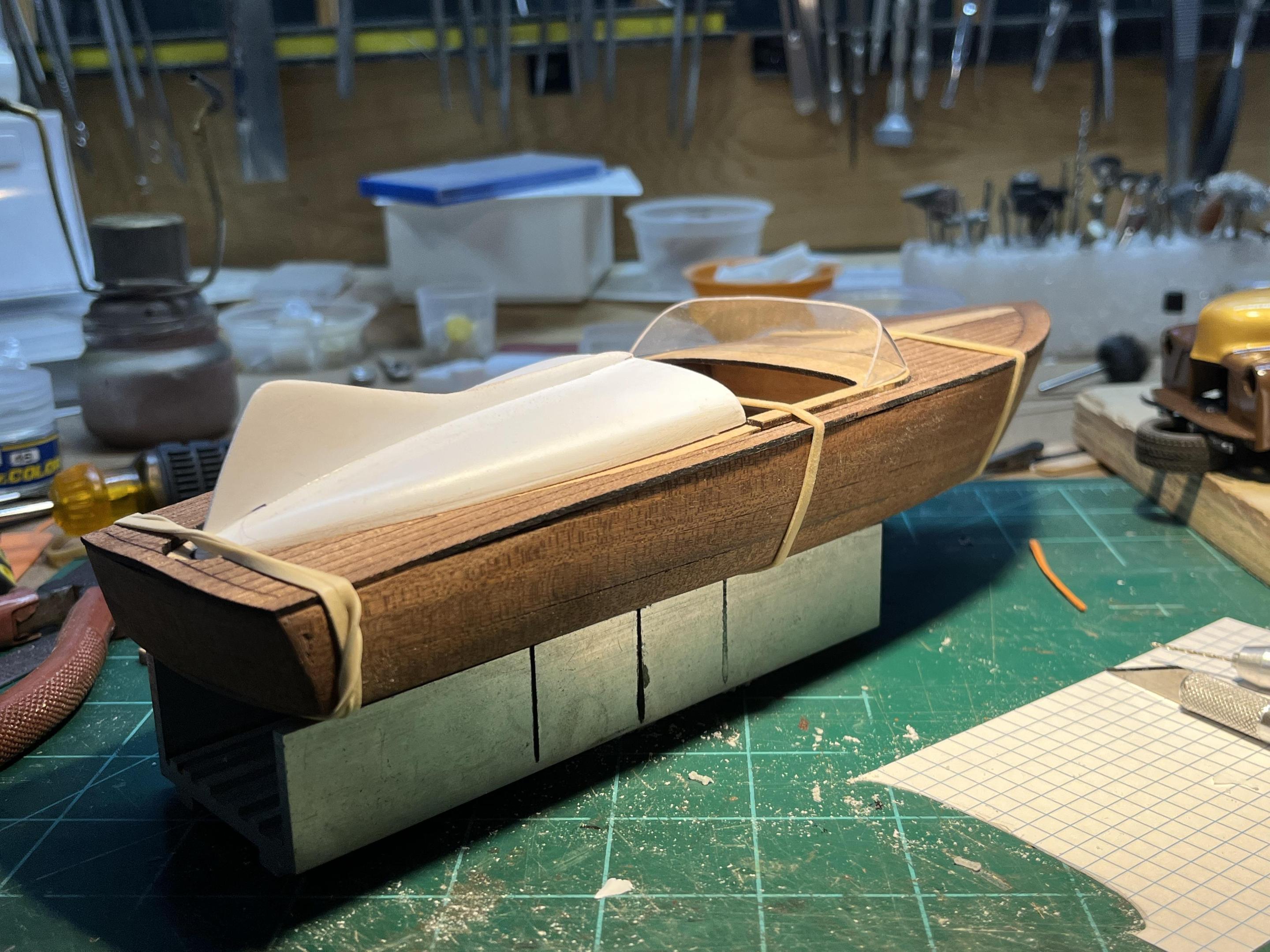

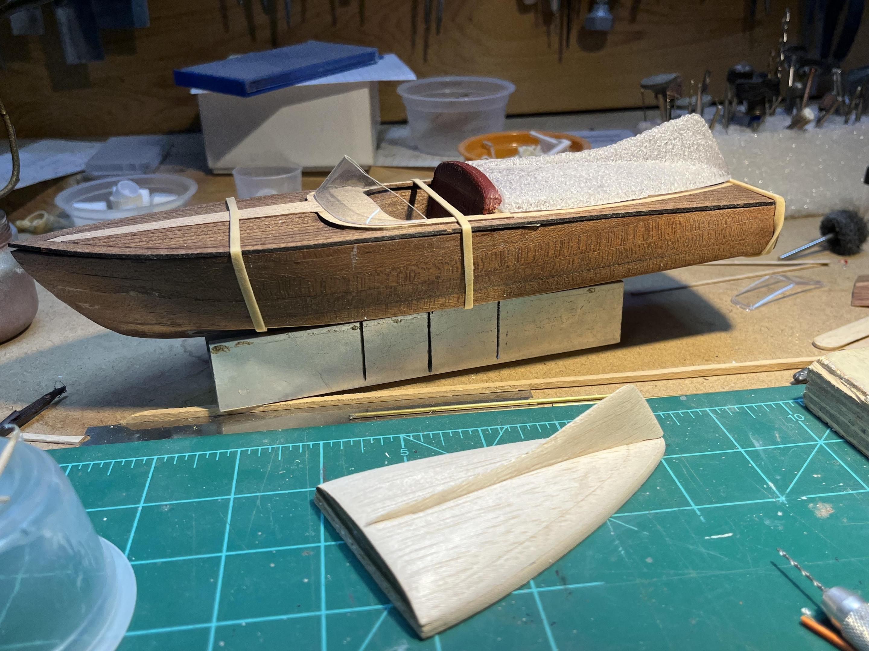

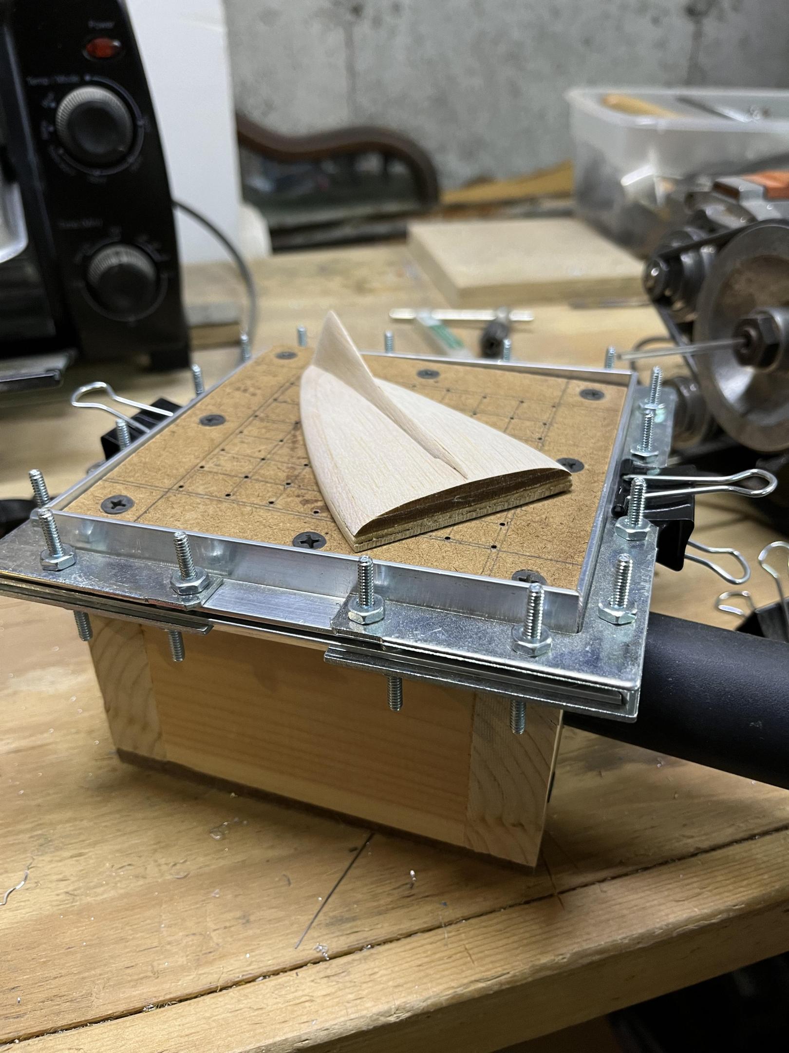

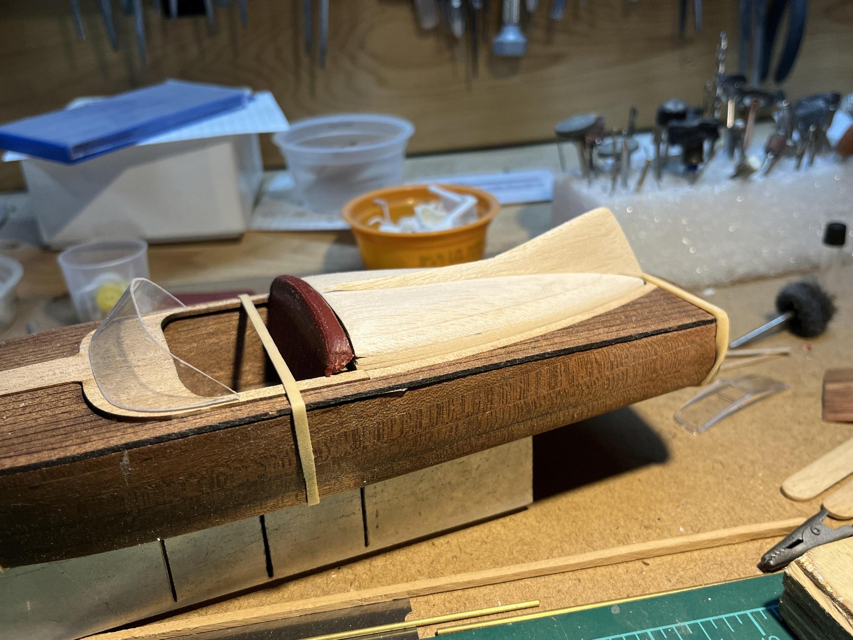

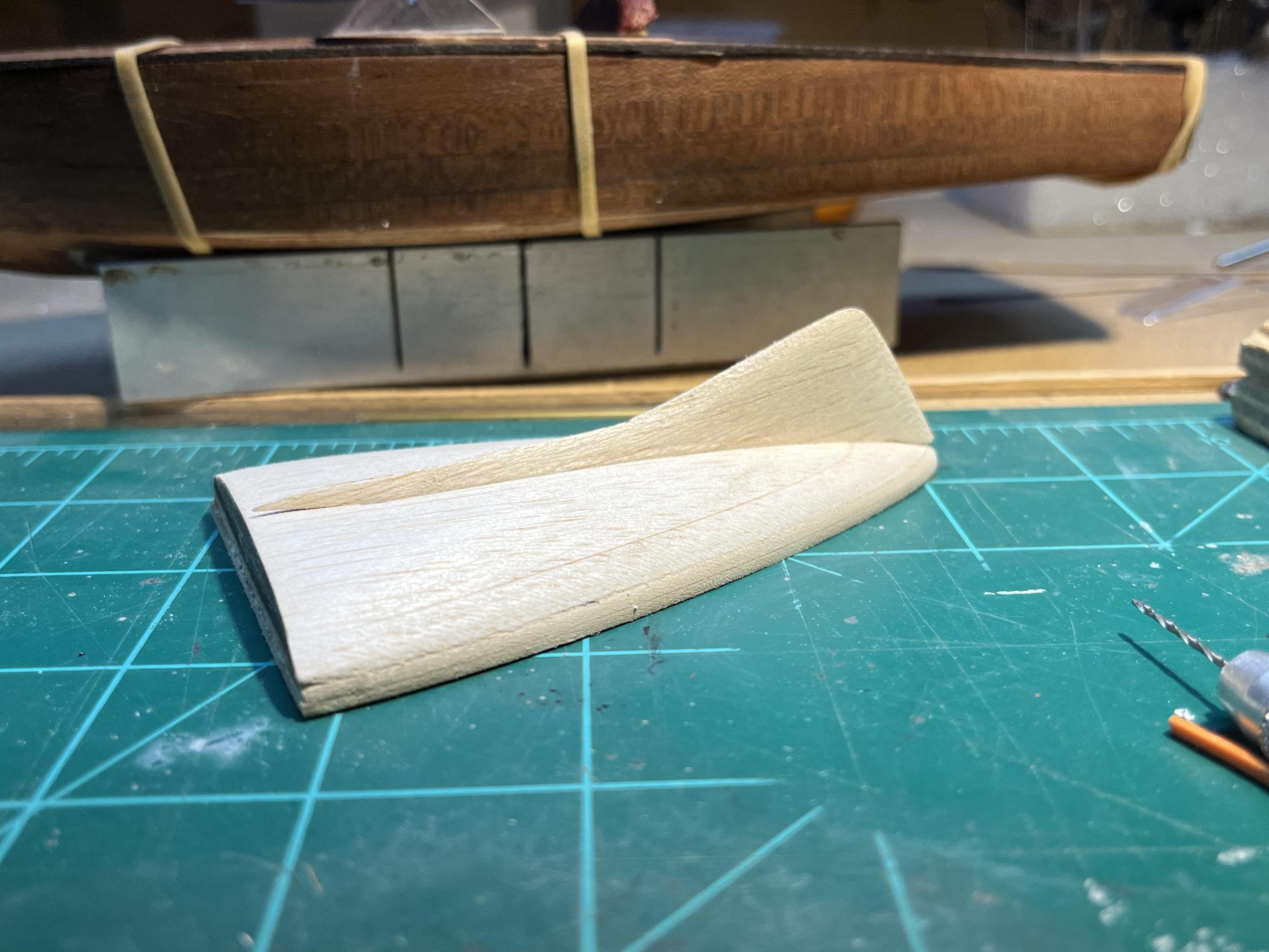

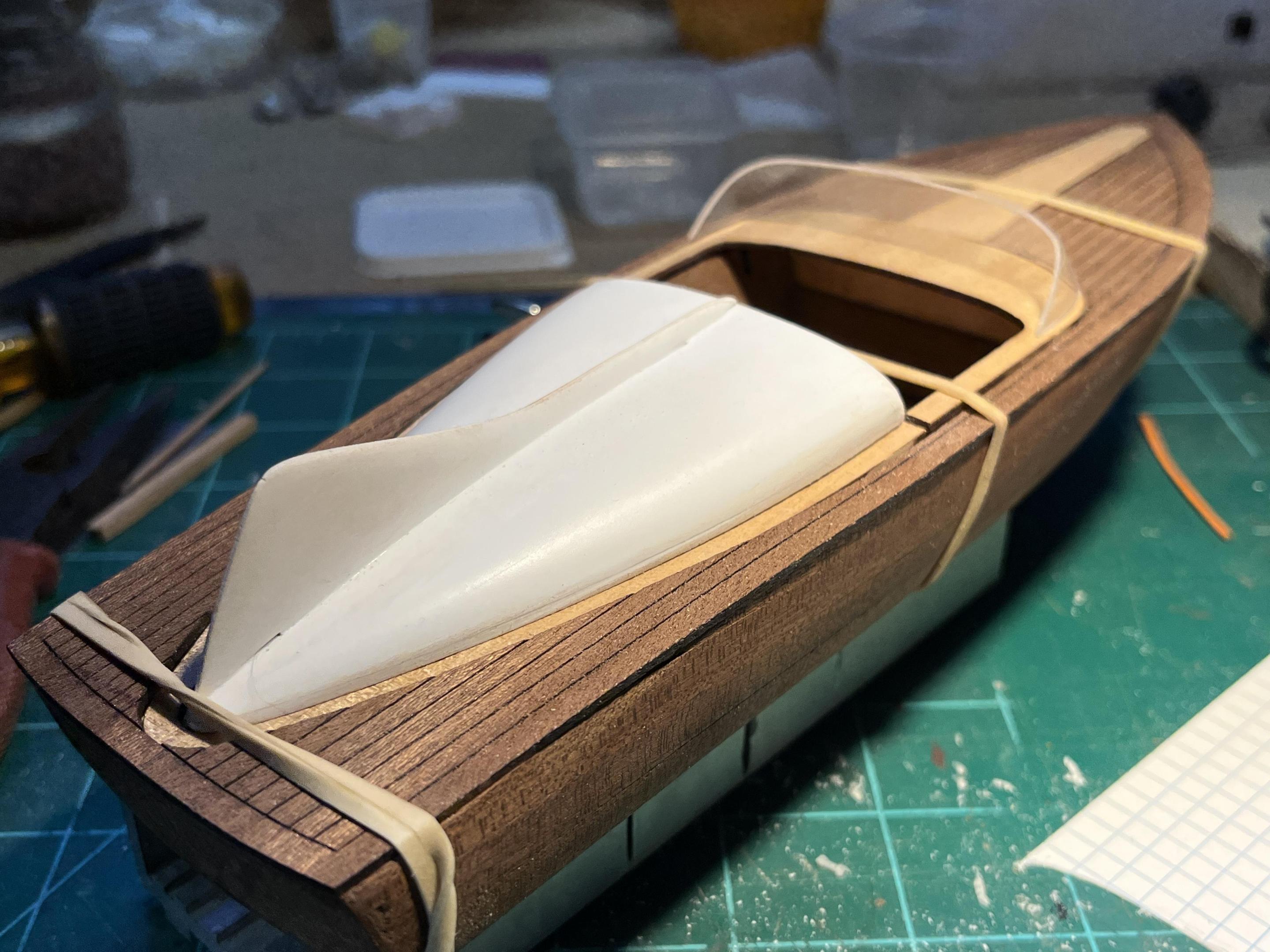

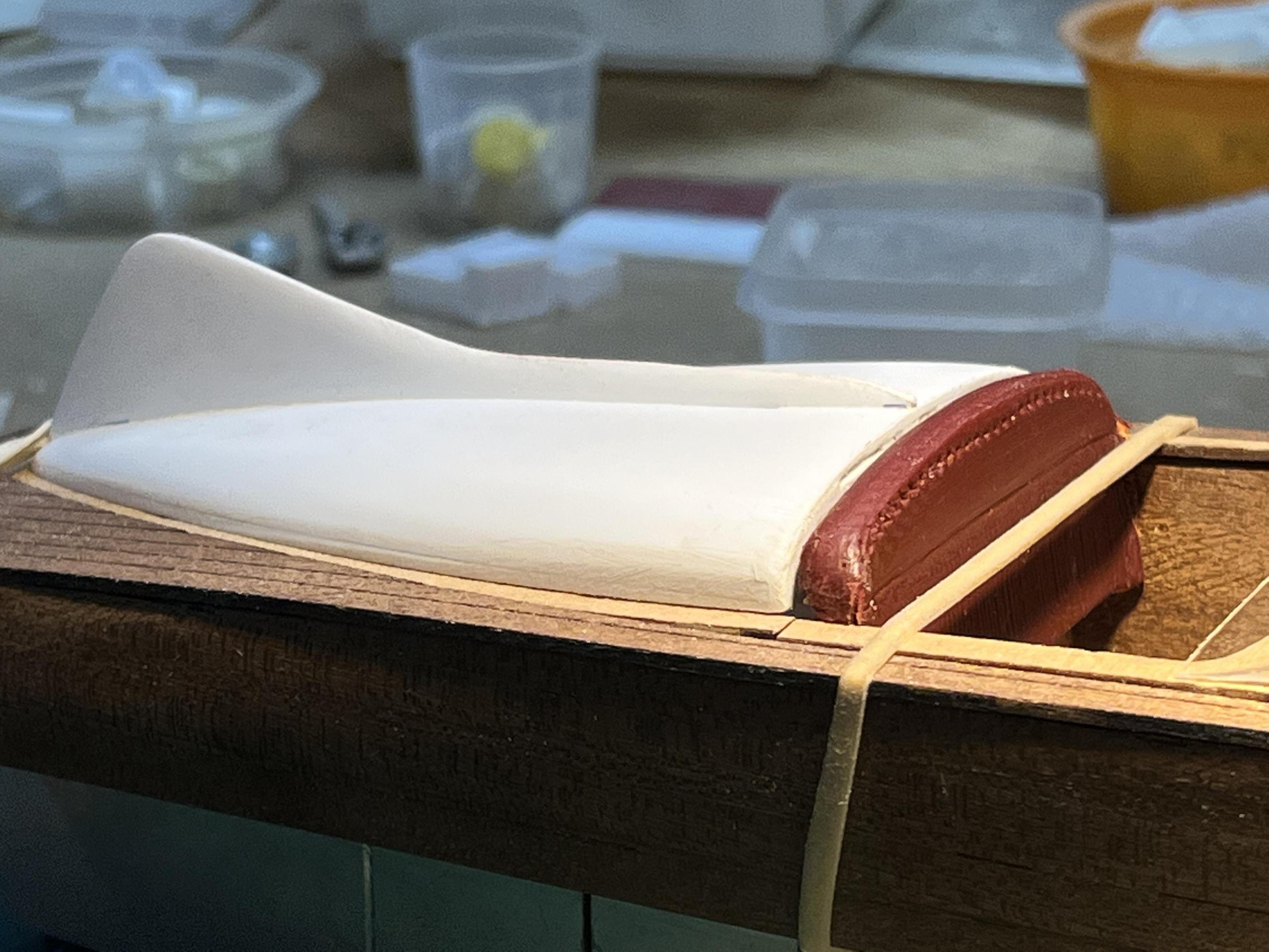

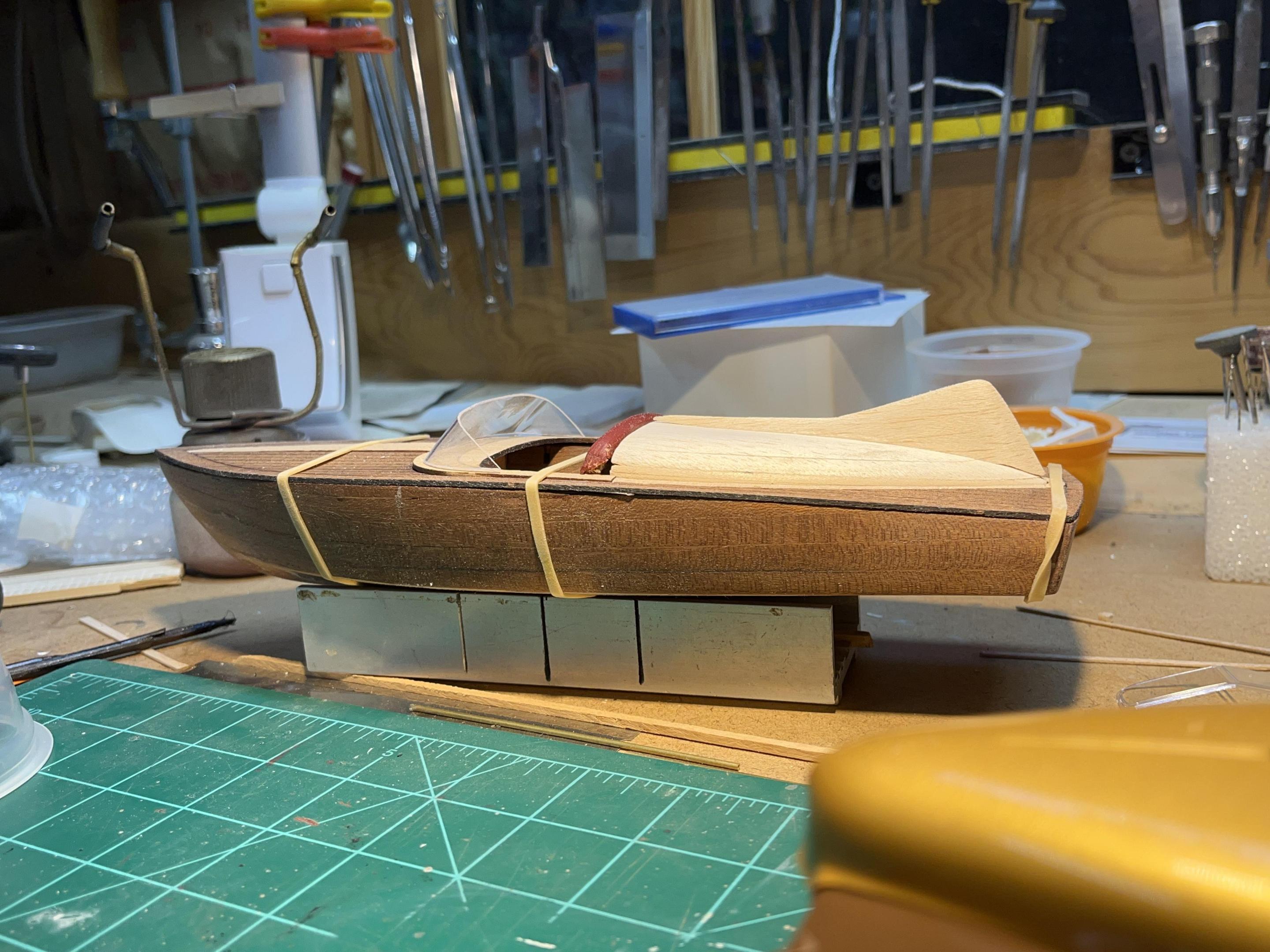

I decided to turn a little attention back to the boat, and more specifically the engine cover and rear fin.  The Dumas kit just provides two pieces of balsa wood and says to glue them together and sand them to shape for the engine cover, and another piece for the fin. 6096EFEB-2C82-4CF8-9C92-ECBFB46DF421.thumb.jpeg.ec48ce3601d73a45f486376ae80727b0.jpegAEA791DA-B649-43C9-9D41-BE1F14D41430.thumb.jpeg.851c2fd4c37dfd75c402d747942e0efc.jpeg6965E676-5068-4C6E-93D0-A5735449FD24.thumb.jpeg.46cbabb3ac922eab0183cd28c0371a2b.jpeg Since I am going to be detailing the engine bay, and adding two 3D printed LS3 V12s, I decided I want to make a engine cover out of plastic, with hinged hatches that open up to reveal the two engines.  I thought about making a rubber mold and casting it in resin using the balsa piece as a form, but I don’t have much experience with that, so I thought I’d try vacuuforming, mainly because I have some stuff to do that with.543AD90A-AA33-4182-83CF-8B14705C0AB2.thumb.jpeg.9af72c9572bfe0268e7377279b0e8dfc.jpeg

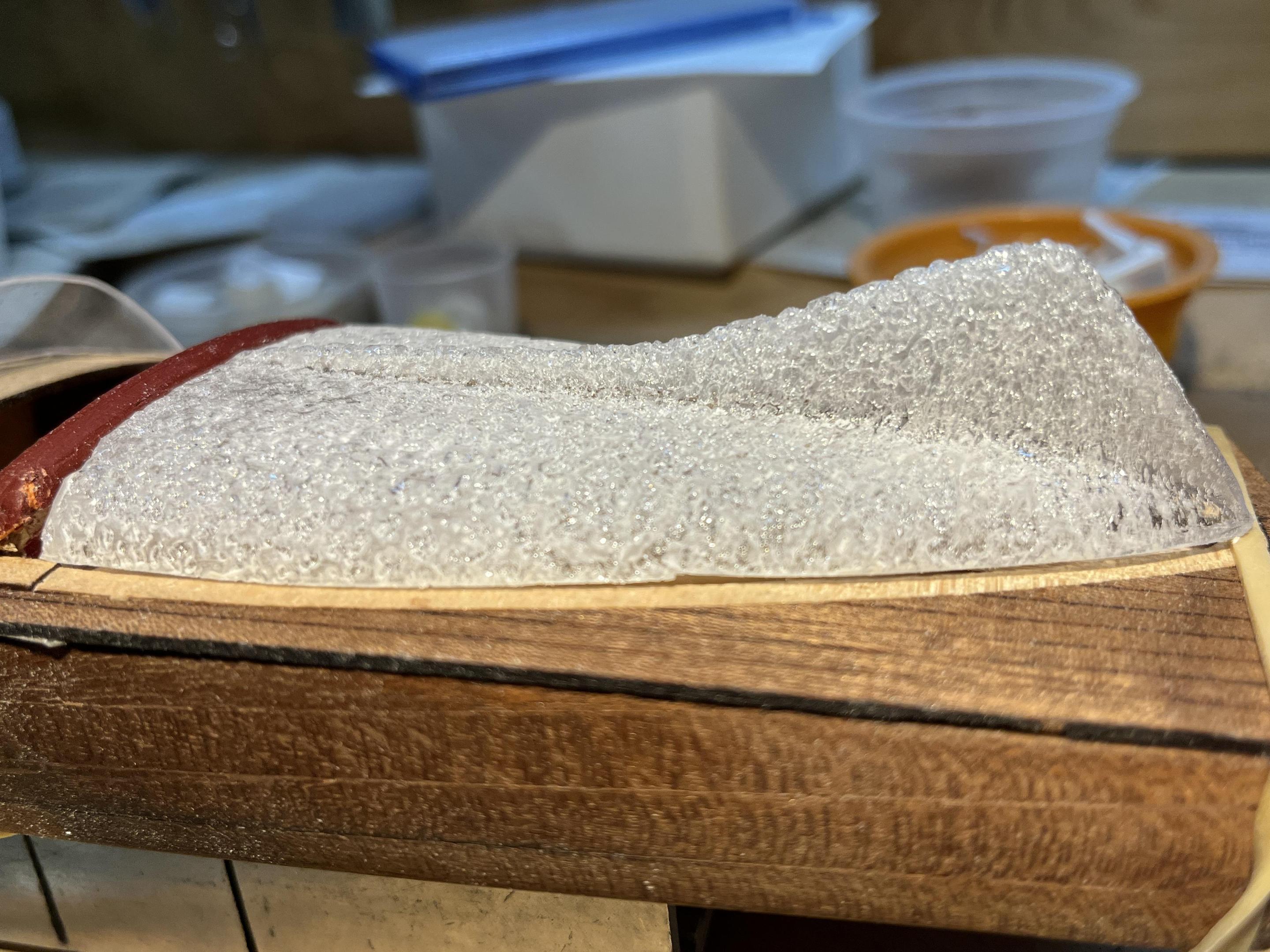

I didn’t have any styrene on hand, so on my first attempt, I used a piece of PETG (acrylic Polycarbonate), which I use to make windows.  It is very hard, and strong, but does not sand well due to it’s hardness.  Unfortunately, the piece that I was using was too thick, and I think I had it too close to the heat elements in my oven, and it blistered badly, looking like obscure shower glass.  279D2669-745F-4EE3-A704-201A947C4FC7.thumb.jpeg.ef432a6afde071dc330fb7876ab2c5d4.jpegI thought about trying to sand it, but as I said, this stuff is very hard, and does not sand well.  I thought about spreading a coat of Bondo over it, but I think I’ll try again moving the next piece more central in the oven, and heating it slower.  If that doesn’t work, I’ll try using thinner stock, or getting a sheet of styrene, or both.  If none of those work, I can still go the resin casting route.  The good news is that the vacuum former worked well, and the plastic took the shape nicely, and it fits pretty well.  Ultimately, I’ll need to sand the buck a little smaller to allow for the thickness of the plastic, and the correct fitment.  E99368DF-CA9B-49A0-B58E-A1DFD0A9F5B3.thumb.jpeg.197b3e56ef97d1d98df3340d337cd7c9.jpeg

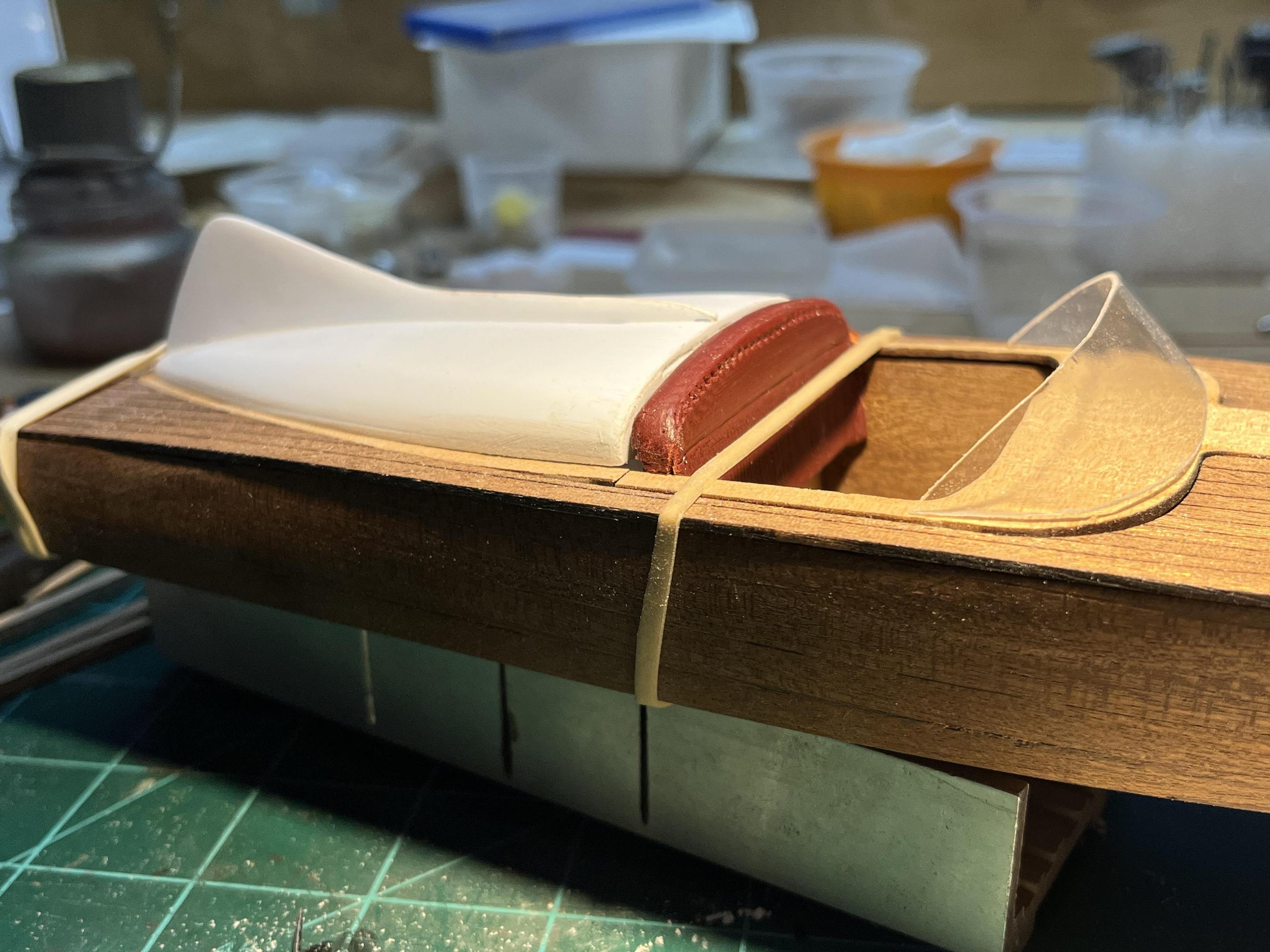

I’ve had some success with vacuum forming the tonneau cover and fin, out of styrene.  I’m pretty happy with how that came out, and I’ll cut hinged hatches into it for engine access, after I get a little further along with the engines, and get ready to install the cover.CCE6978C-503B-416B-ABB2-E22E620E496A.thumb.jpeg.e9db4a68567eaea9db9ad4d002922d9e.jpeg27D49B3E-24F9-4FF0-AEB1-5E22CE833A45.thumb.jpeg.9fbfdec6410bf3deae4b0abc182b107d.jpeg56AC290F-E5B8-4008-960B-BA2C55B6B38E.thumb.jpeg.7c3b63c2dc9802735377a4ebeb871b11.jpegDE94F816-2864-44AB-BF2A-9D30CD31F09B.thumb.jpeg.0880c996d894274118f2f47f83a155c2.jpeg8D2815EA-C9D8-40F9-ACBF-C83D03D6531D.thumb.jpeg.acfaccf1c325d524dd775ba263209c74.jpeg

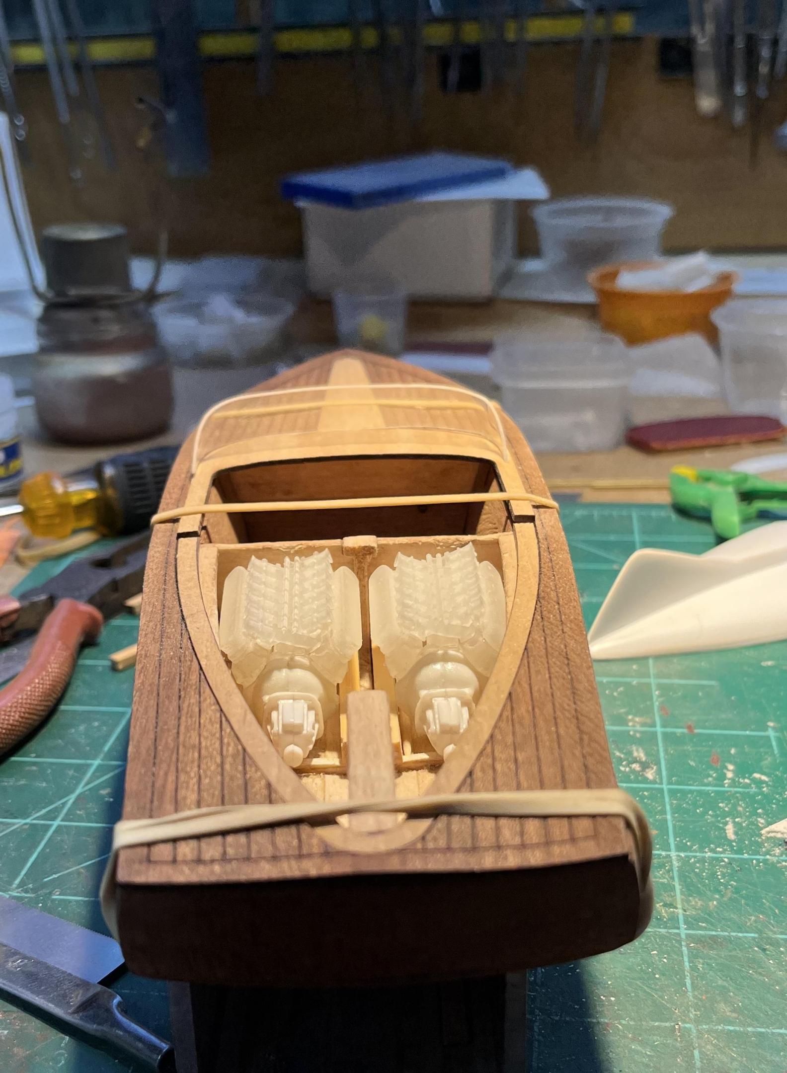

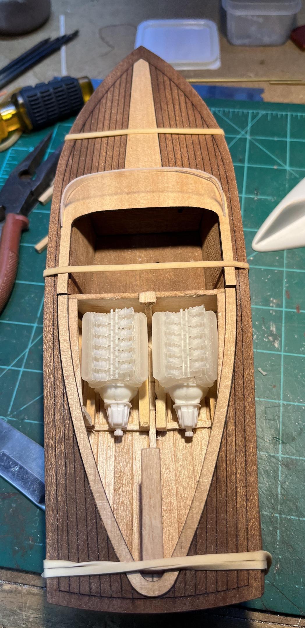

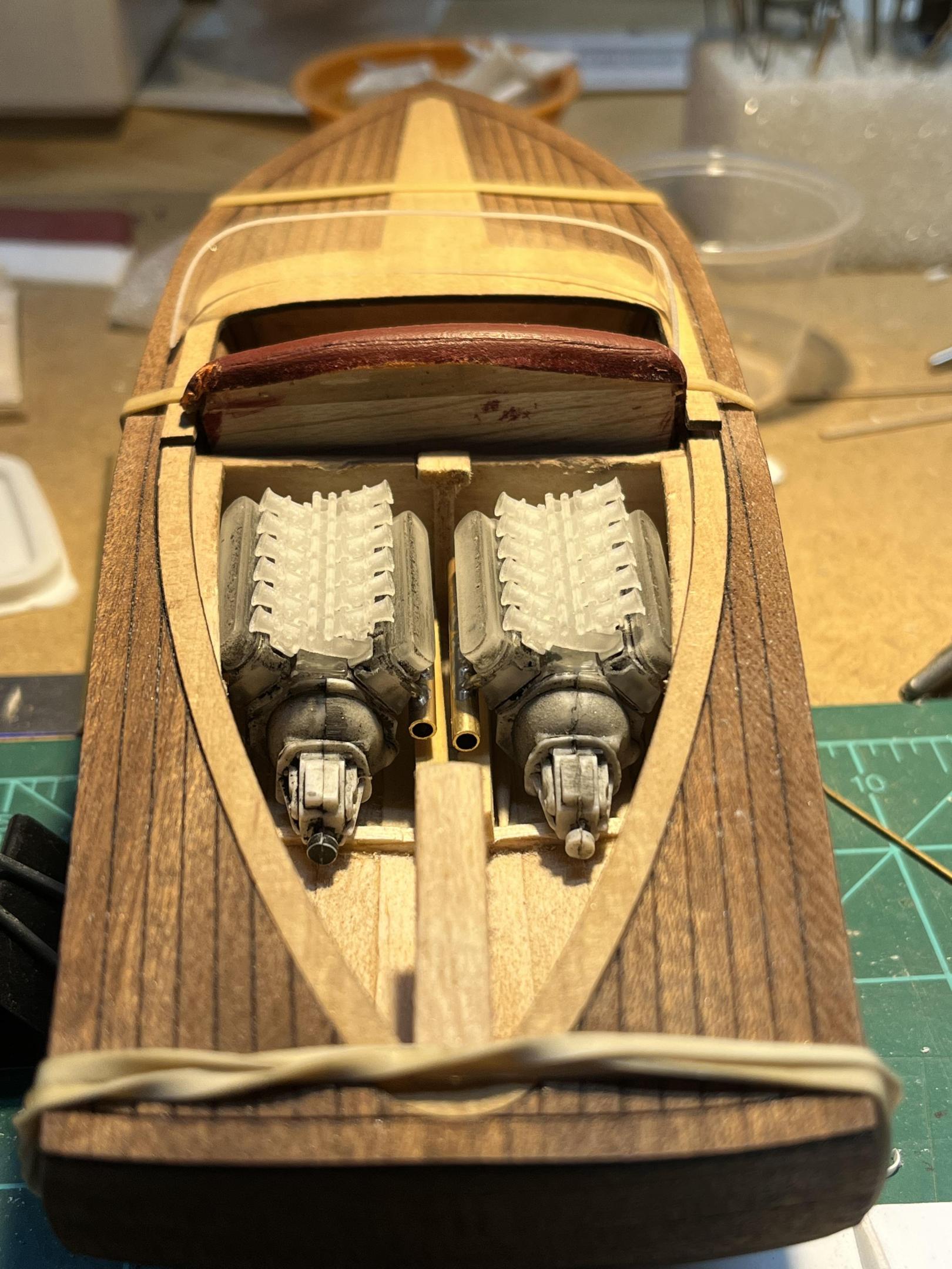

Speaking of the engines, I have roughed together the two V12 LS3s, and roughed in the timbers where they will be mounted. So far, so good.AA551BB3-F38F-44E3-A580-658EEF1241A0.thumb.jpeg.c94518303d7483348b0d5fb18672cd48.jpeg9CE55E40-3B79-45AC-B3B2-42E87B74A3BE.thumb.jpeg.12faa0d29f6f0850fd60c307b7bb6933.jpeg

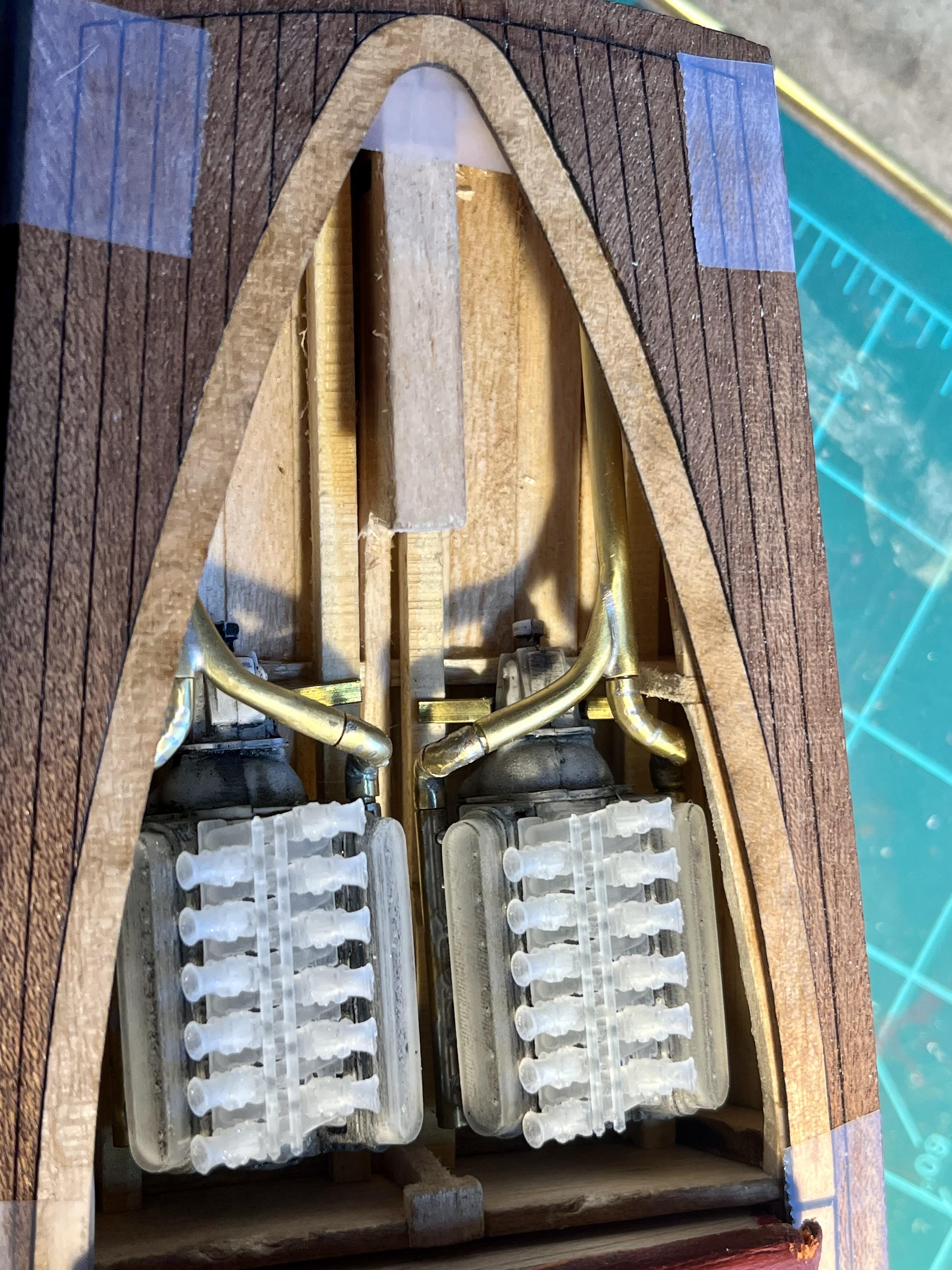

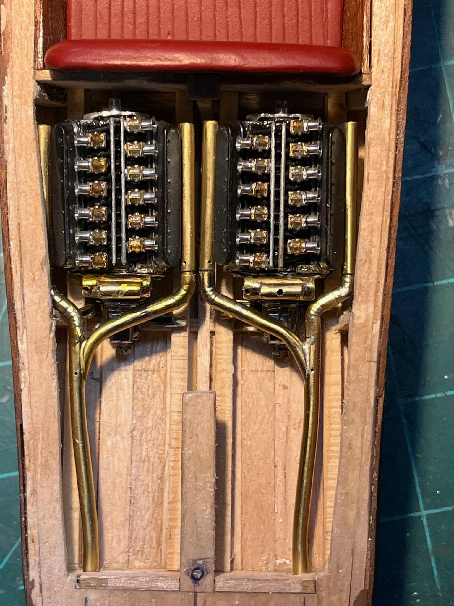

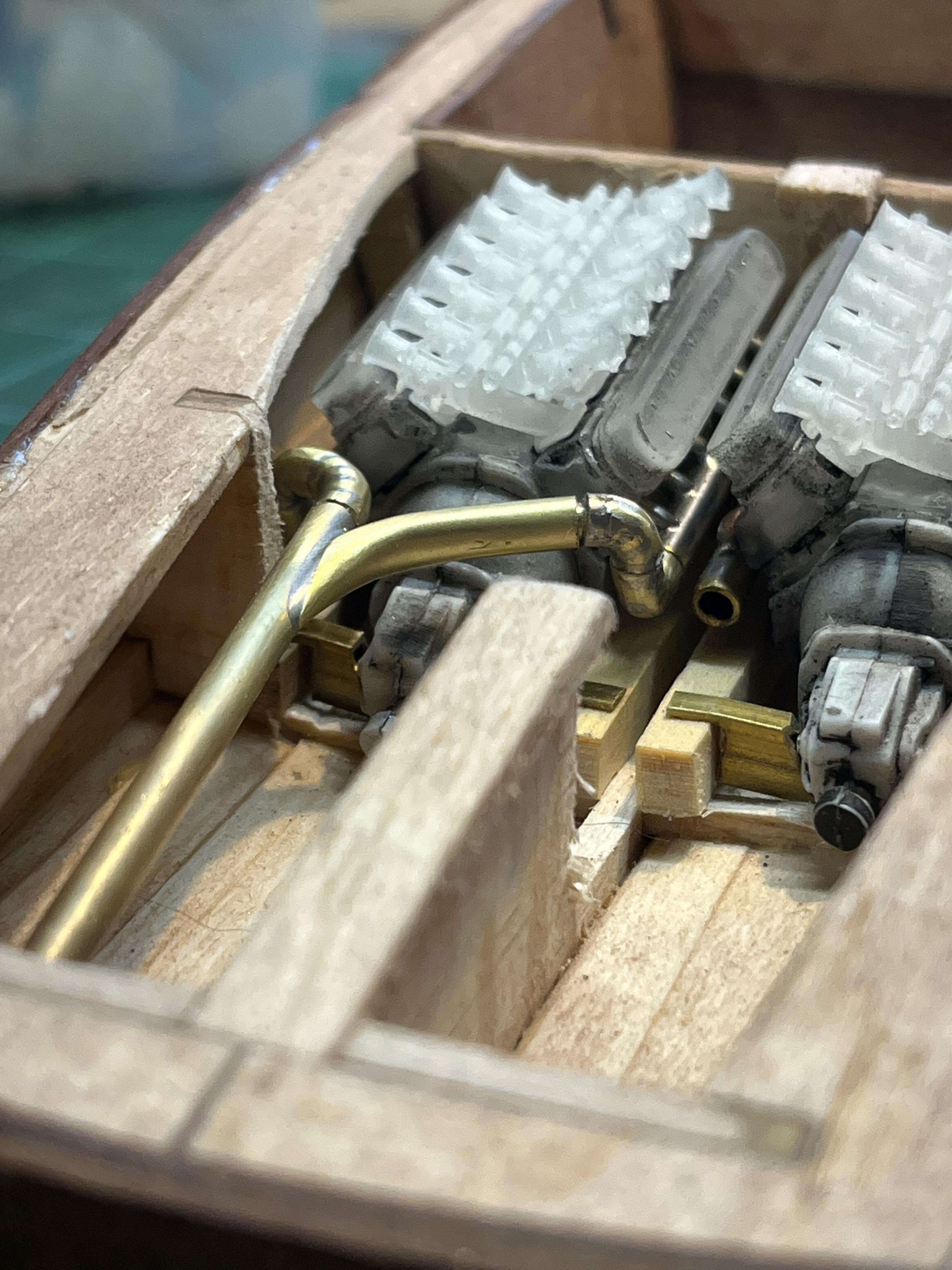

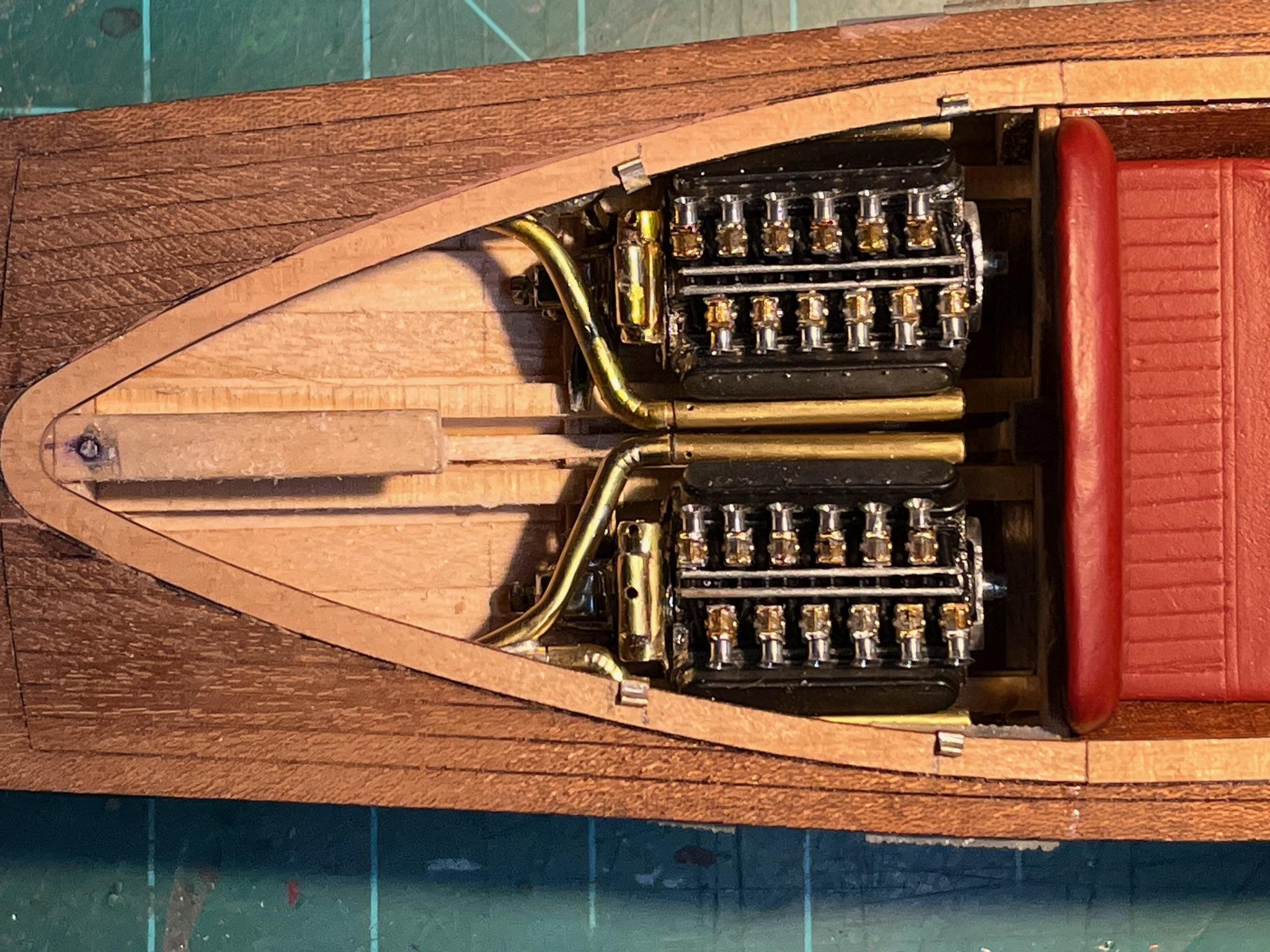

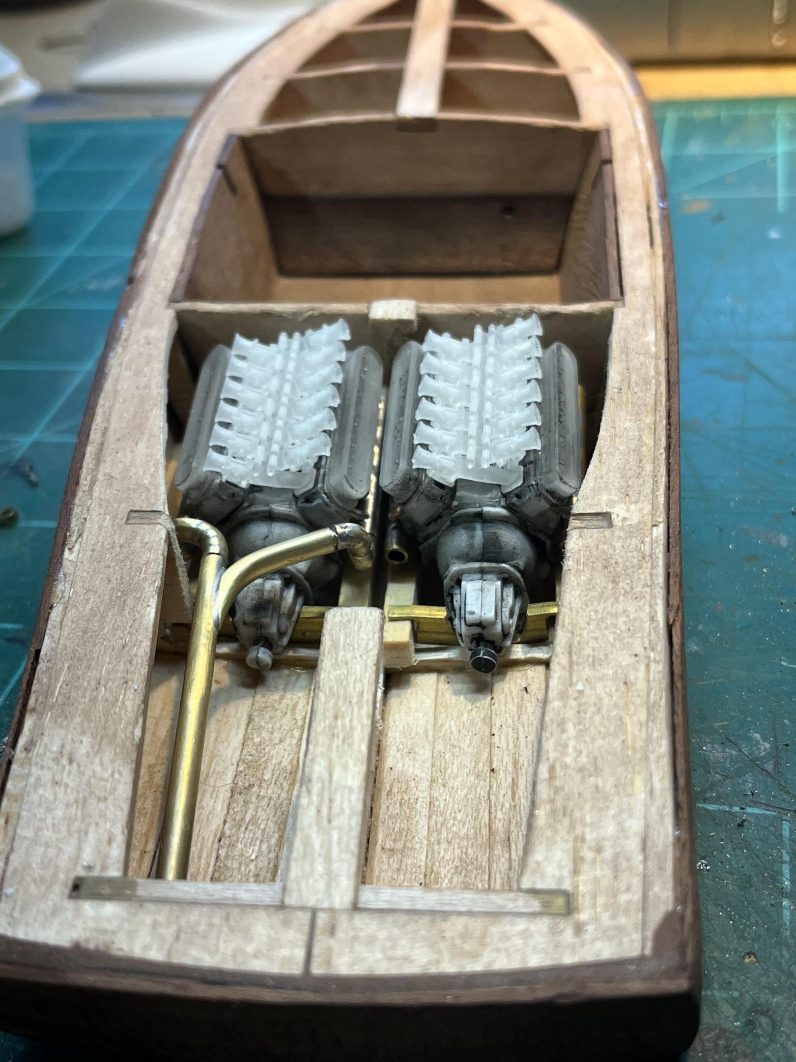

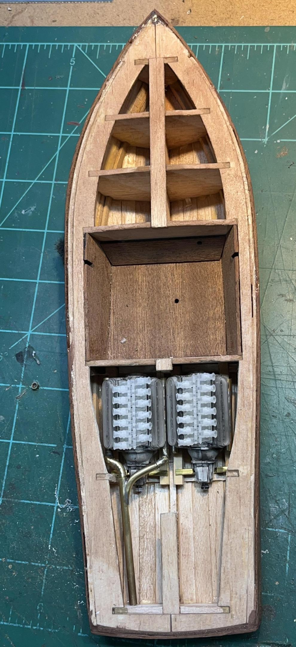

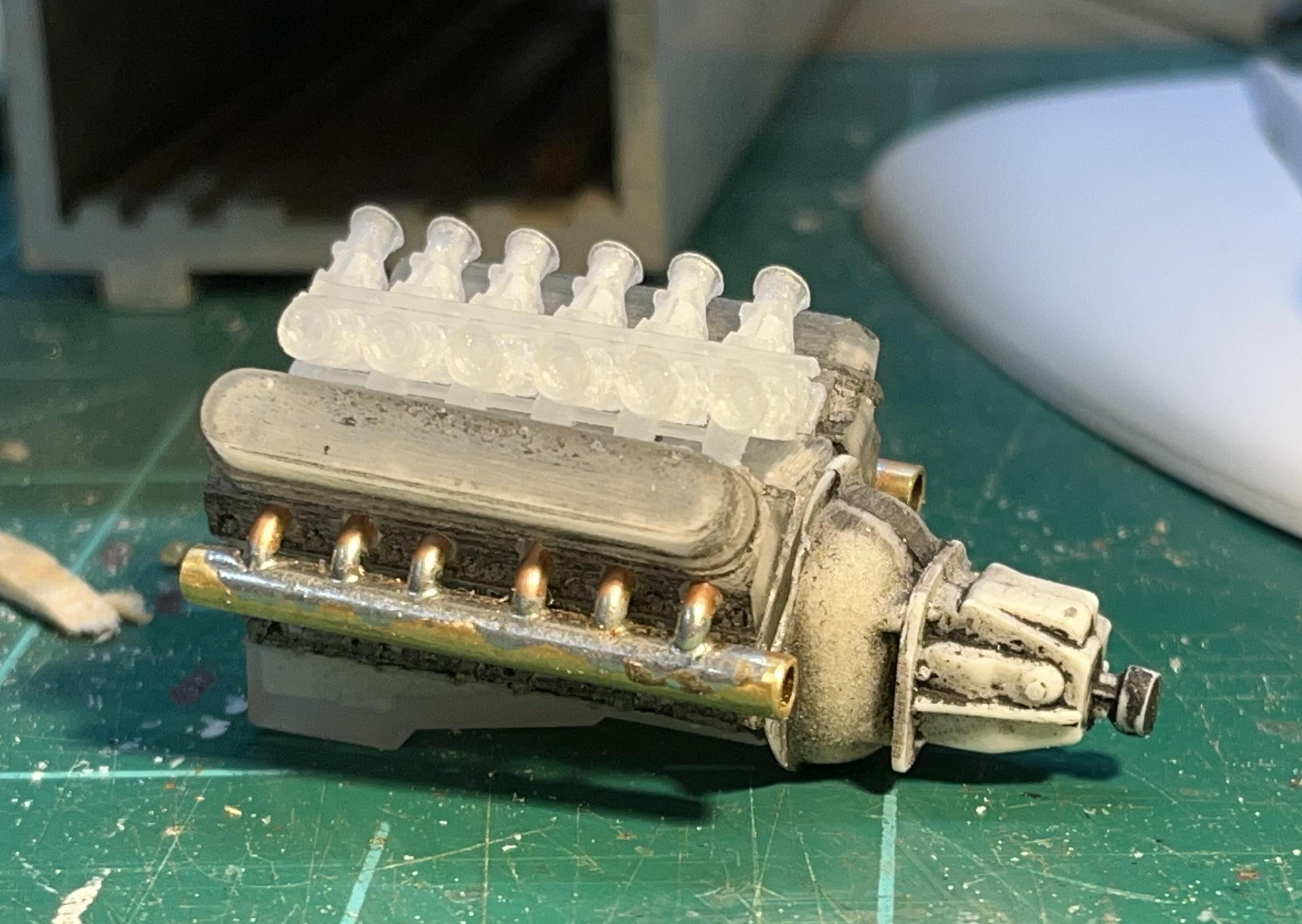

Thanks Paul!  Not sure what I was thinking!  Not one, but two V12s, plus one in the tow car.  36 cylinders in all, with 36 fuel injectors to detail, 36 spark plug wires to run, 36 exhaust ports to fabricate.  This thing is going to take a while! E1845F6D-18A8-4064-8410-EFCB4A6576EB.thumb.jpeg.4fab69408d17d008f62dae7e8db7ab4f.jpegI’ve got the exhaust ports for the boat engines fabed. 2380AAC1-D269-4C97-A23B-23668C7168A8.thumb.jpeg.93604d9dd4e92a49f72d5b47d220b452.jpegI am planning to do the full marine cooling system and exhaust, like in the attached picture of the Lambo Riva, which is my inspiration for this build.  I’ll give all of the brass a shiny polish before final assembly and installation.0EC47AB9-E785-4444-AB2D-AD1A2EA0609A.jpeg.31bb5f442d2187c97c61fd763ea206c7.jpeg

Magnificent brass work! Never did learn to solder- I assume you used a jig, then attached to the engine?
Thanks Paul!  I’ve been soldering brass since I was about ten years old, building slot car chassis to run on our local hobby shop track.  I generally don’t use jigs, although I probably would save myself a lot of headaches if I did.  These were all done freehand.
