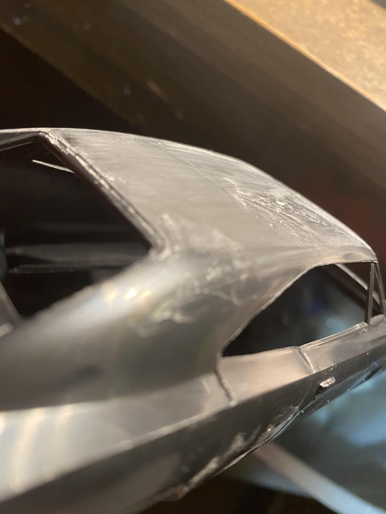

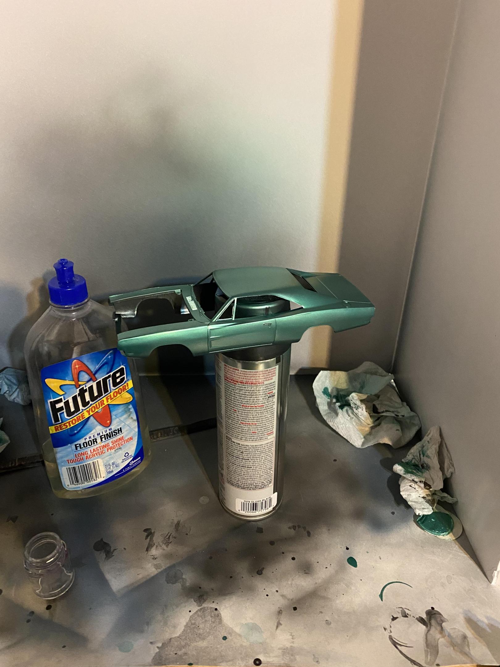

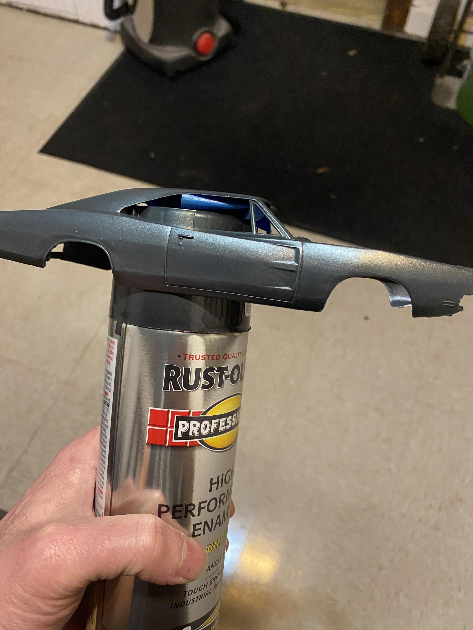

This body is pretty bad.  Lots of seems to sand out and the fenders are kinda wavy!
I wet sanded the the body with 600 grit auto sandpaper to get the seems out and try to straighte the fenders a bit.
Here is the paint I bought from Hobby Lobby

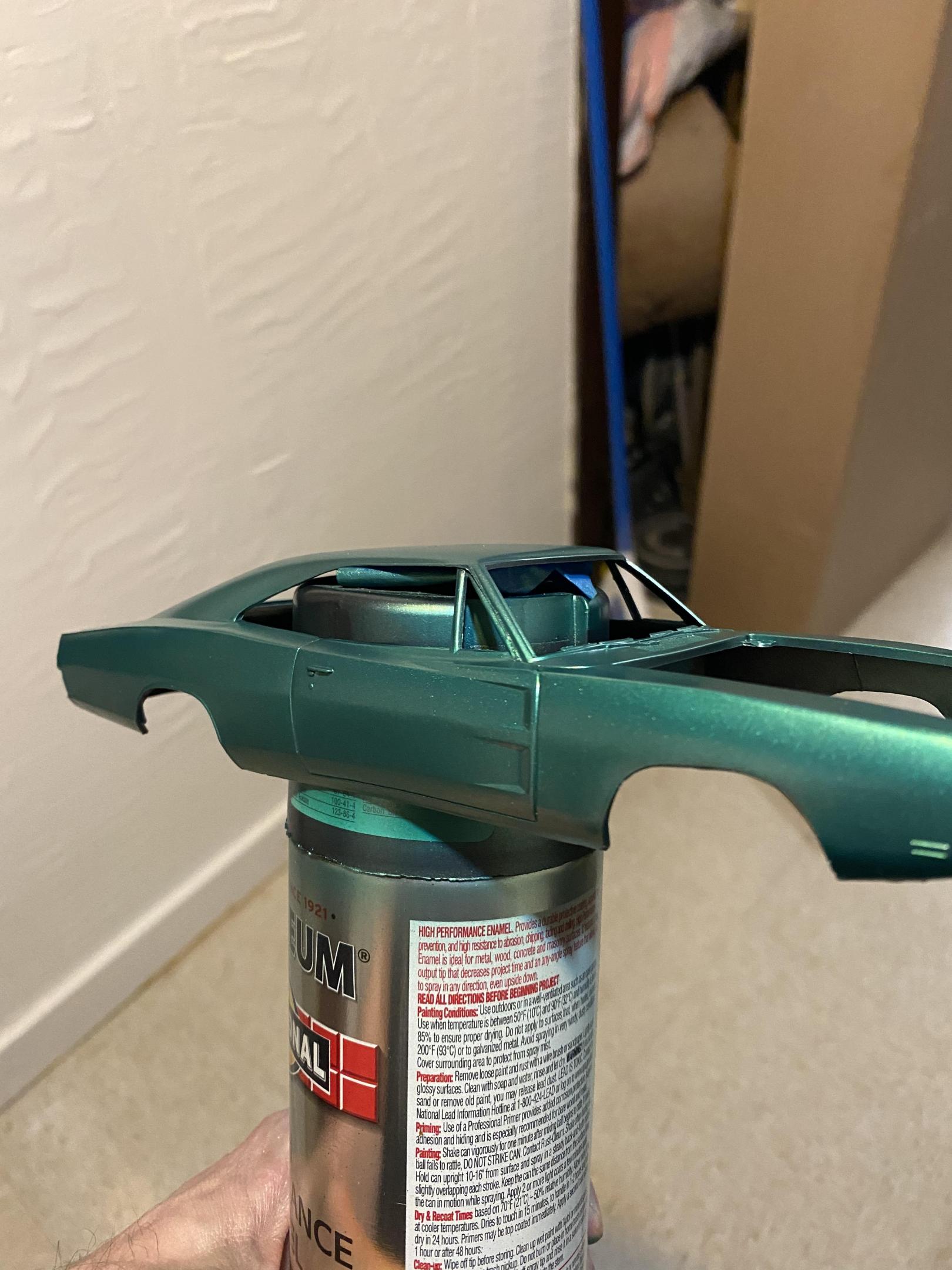

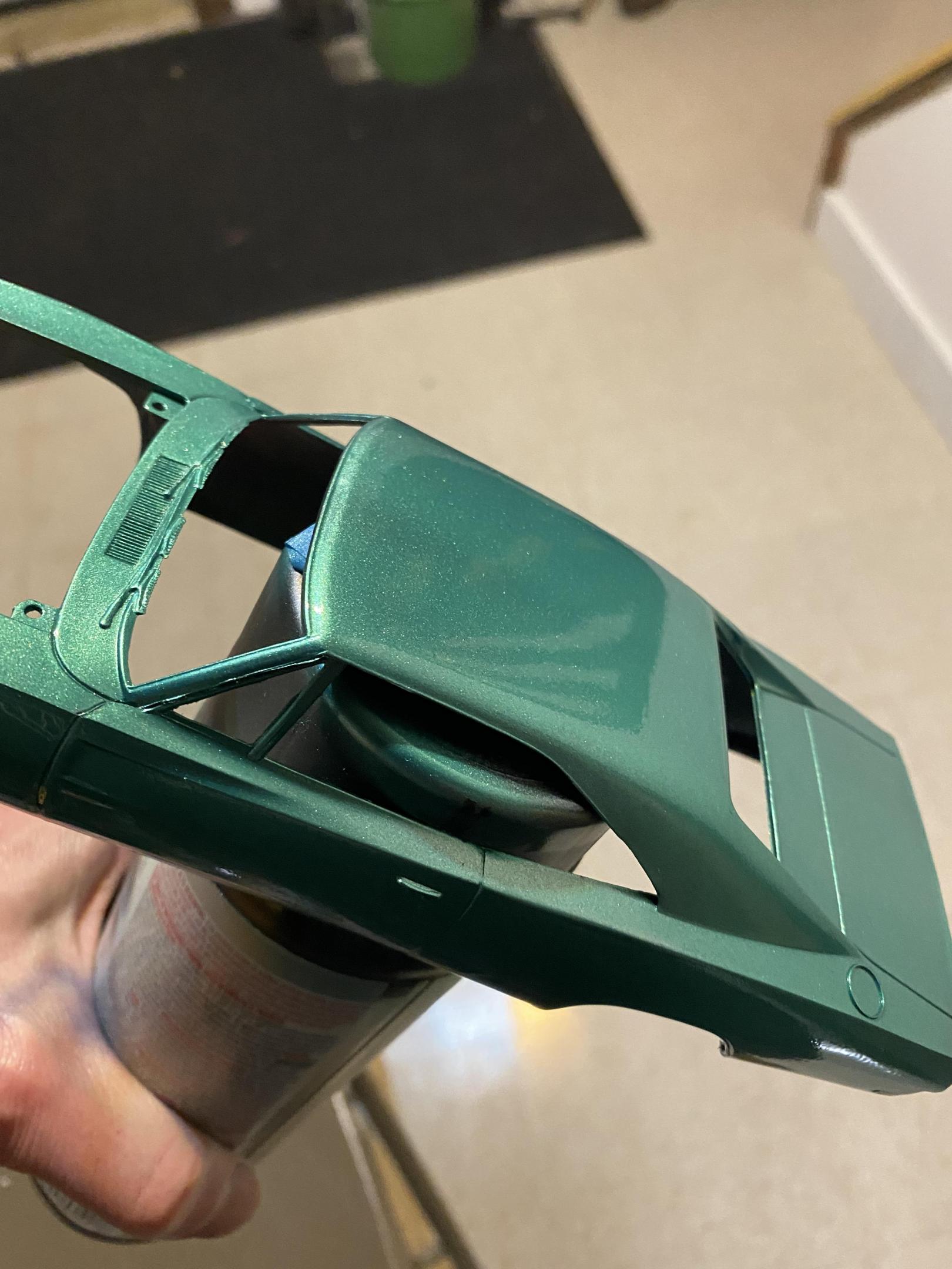

I mixed it with regular windshield washer fluid and sprayed a light mist coat
Then just misted on a couple more coats

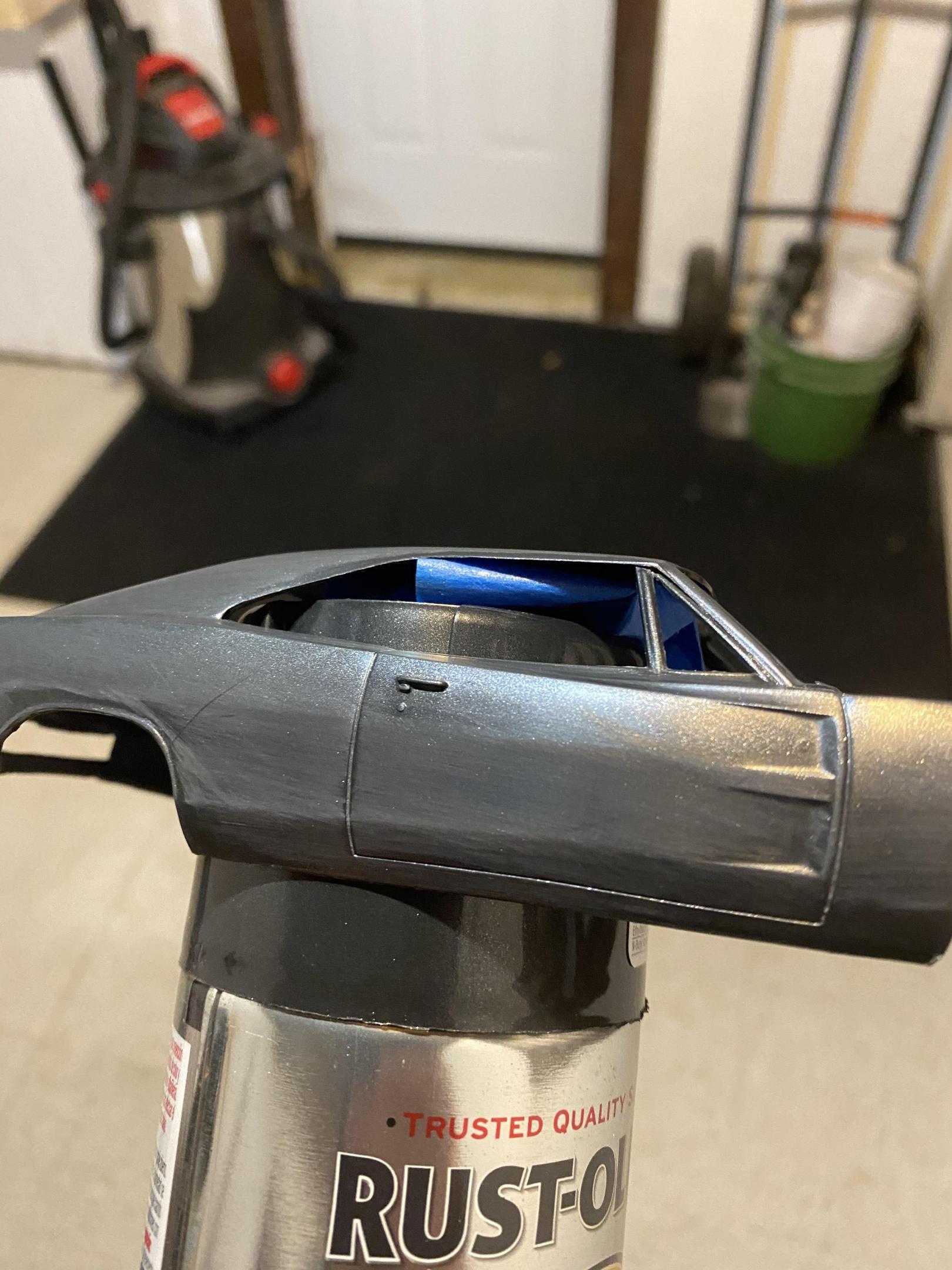

Third coat- finally starting to cover

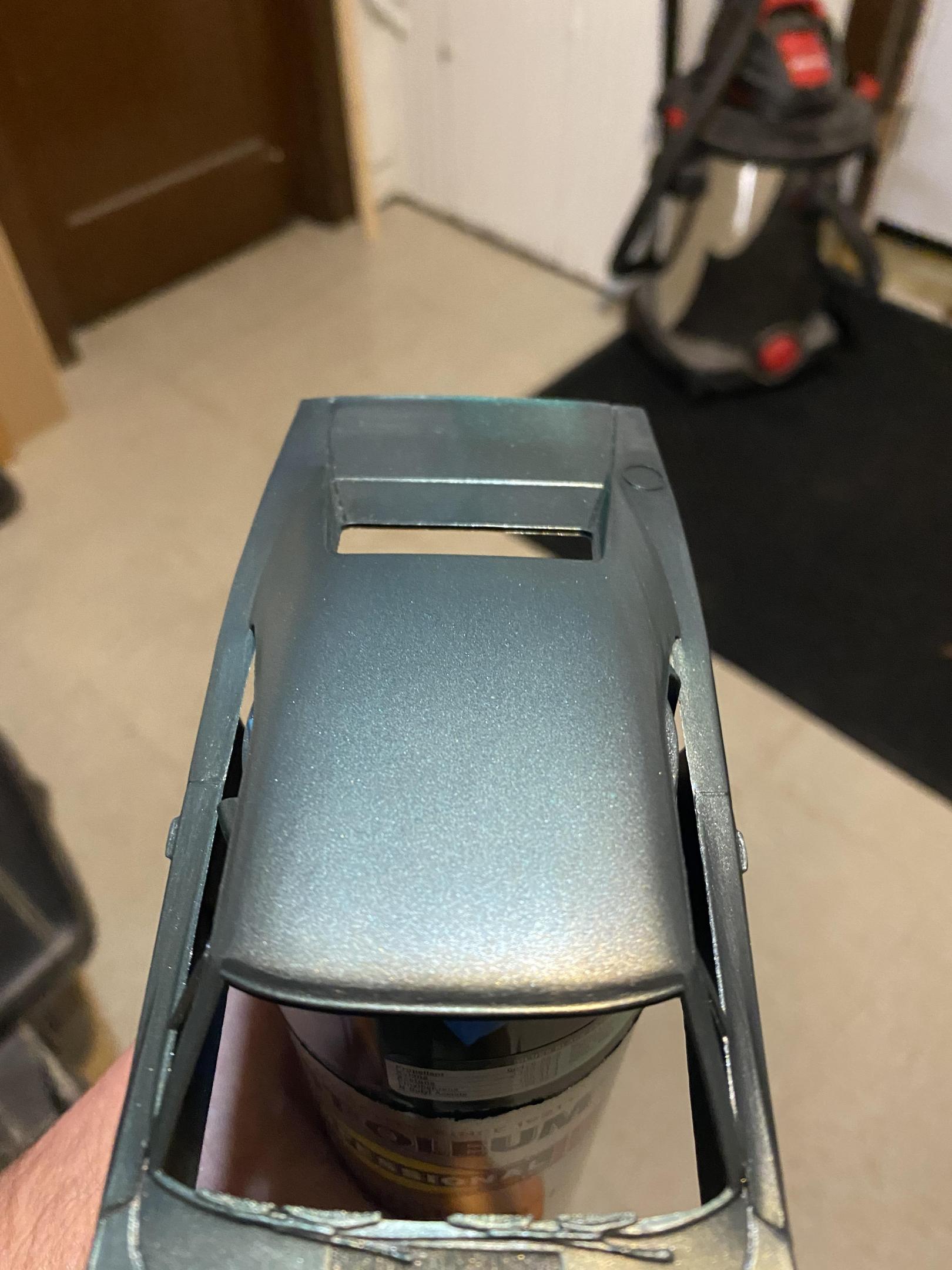

final coat sprayed pretty wet
I dried each coat with a hairdryer until it was dry to the touch. Tthen I started spraying the Future

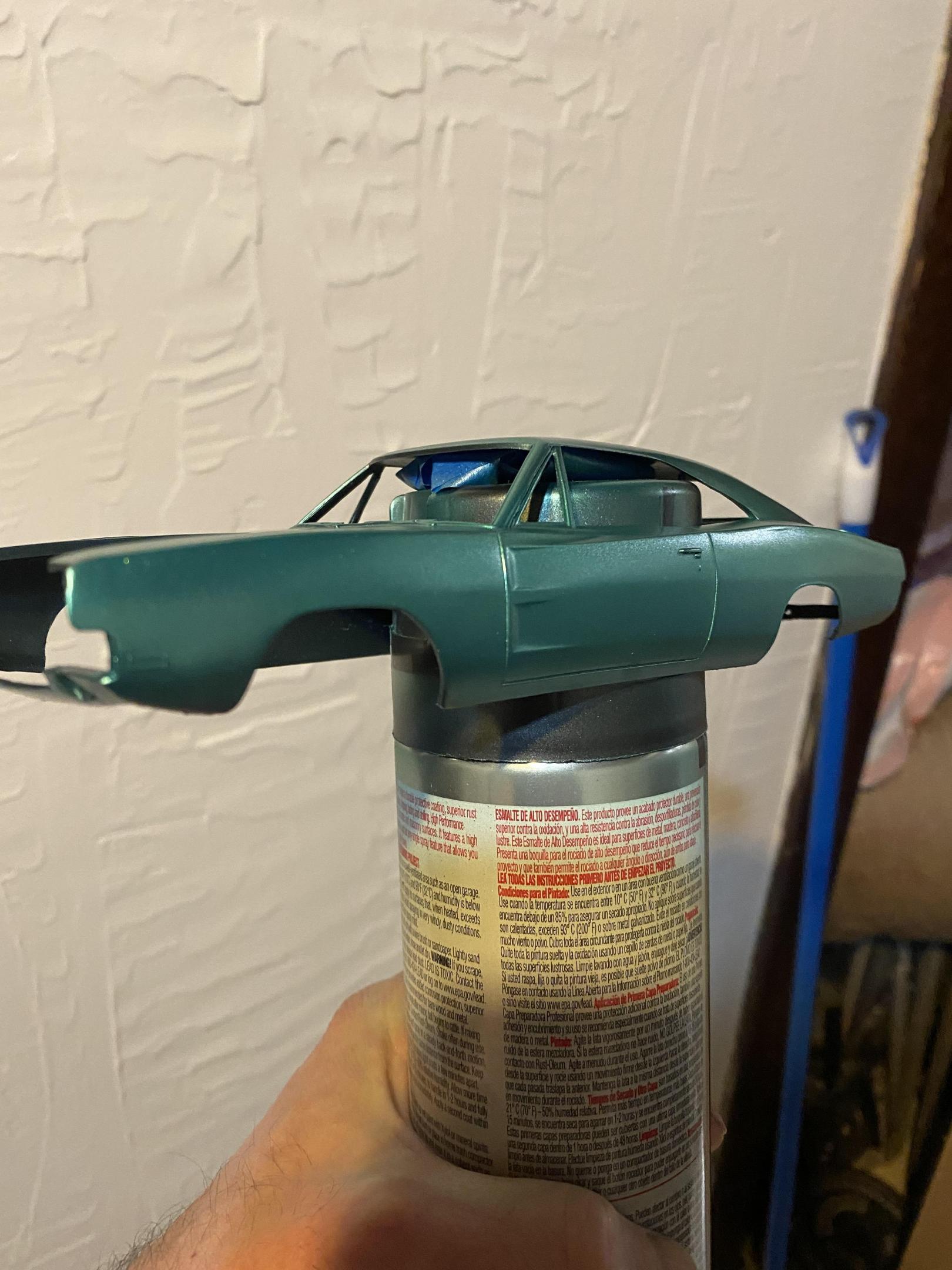

Frst couple coats of Future misted on to act as a tack coat486929454_1stcoatfuture.thumb.jpg.6e89100f5bab5ef1df49ad3e51004265.jpg

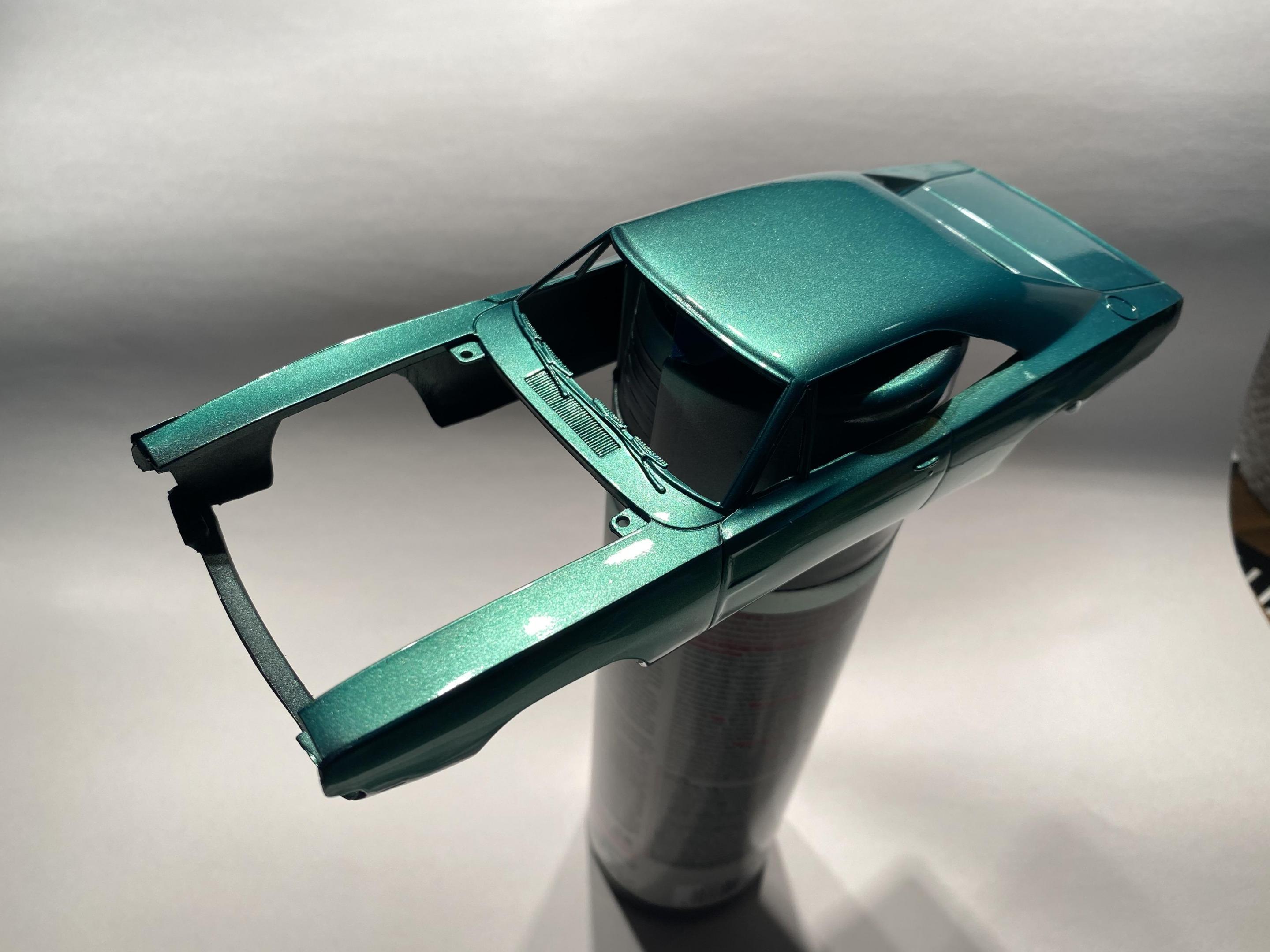

Final and wet coat of Future
Here it is dry to the touch but not cured.
Total spray time including drying between coats was about 25 minutes. then let sit 15 minutes before I sprayed the Future.
I'll let this sit for a few days and wax it.  I'll post some more pics I'l also address the flash I missed on the right front fender
What do you guys/girls think of this color?  I'm going to build this as a regular muscle car.

I like the color also and the finish is already looking good.

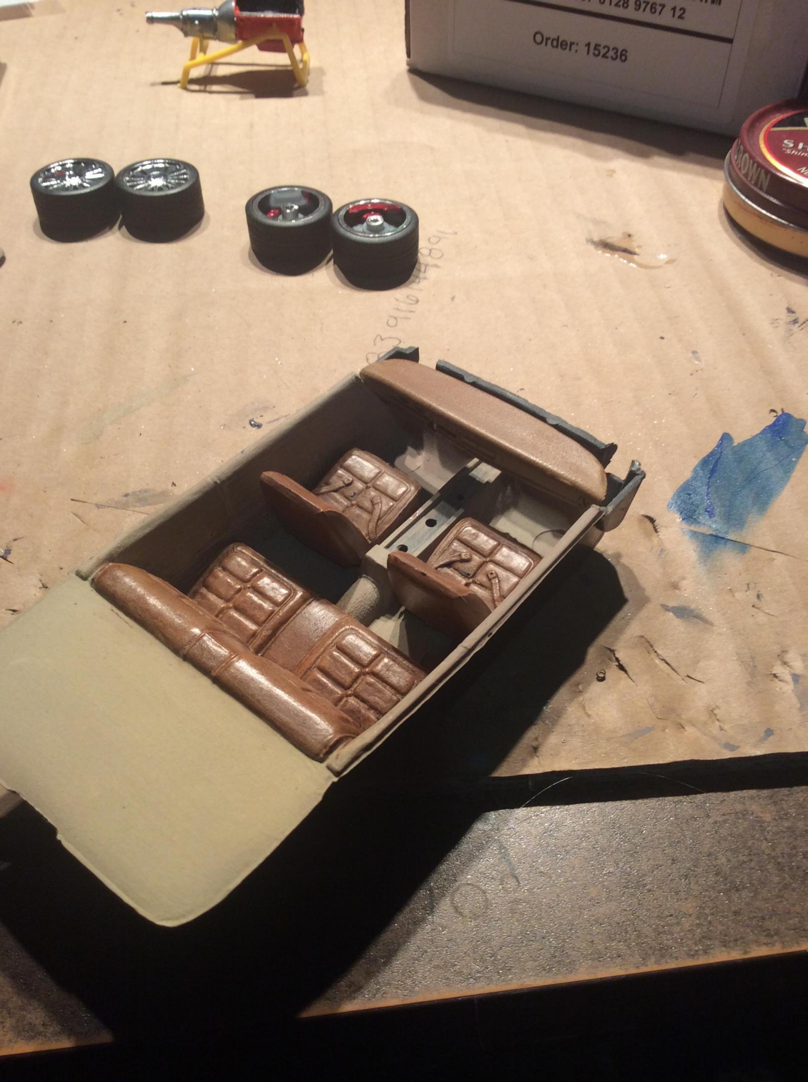

Been working away at the interior of the charger and got the new wheels together9C7A1B31-9AF6-412A-B3EB-87934EC2CF60.jpeg.2888b63a78af825dddc2a74d68a5ceff.jpegCC895A33-40F3-44EA-B9AD-98B1637897AF.thumb.jpeg.5da02061f3346ce46590d33c11f51d1d.jpeg
i think it is kind of an odd color, but I also think is looks good with the green body

Looking good.  How did you get that leather effect for the upholstery?
Share this post
Link to post
Thanks.  I used satin paint and then brown shoe polish over the seats and dash.  I used a soft thick brush to apply it, then once it had dried, I used the same brush to polish it
