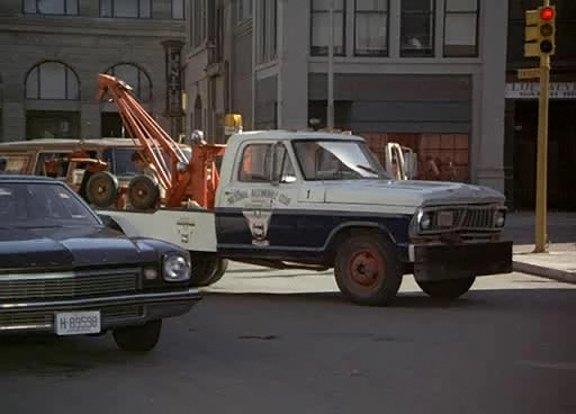

Andrew D the Jolly Roger Posted February 21, 2021 Author Share Posted February 21, 2021 (edited) Thank you! The real nightmare of this project was the wrecker. I knew almost nothing about tow trucks, and there are no tow truck models or conversion sets for anything even close to this type. I was told it was a Holmes wrecker, in the 400 series....but amazingly, Google searches with that info yielded nothing! So I went the hard route. I went through countless Dukes episodes on DVD, pausing them to photograph any good views of the unit. Yep, that's right, I photographed the TV screen, and had photo prints made. The dozens of photos I took gave just enough reference material to build this. Although dozens of episodes provided good material, by far the most useful episodes were "Play It Again Luke" (S6 E15) and "The Fortune Tellers" (S6 E21). I was able to find sheet styrene with Diamond Tread pattern molded in. It was shockingly brittle, but I was able to fabricate the bulkheads and decking. I also used photoetched metal Diamond Tread for the curved wheel well tops and other details. Also detailed the rear with openings for the tail lights and more. A turkey roasting pan provided more sheet metal for the wheel bays. Edited February 21, 2021 by Andrew D the Jolly Roger Quote Link to comment Share on other sites More sharing options...
Andrew D the Jolly Roger Posted February 21, 2021 Author Share Posted February 21, 2021 (edited) Scratchbuilding the winch was a challenge since a lot of it was guesswork. As far as the brace/frame (not sure the correct terminology), I discovered I didn't have to guess the width; apparently it should be the same width as the chassis frame, which makes sense from an engineering standpoint. Then, the more I built, the more extra details I'd discover in the photos. This was a long, long process. The tow booms were heavily modified from those in the MPC Datsun Monster Truck kit. Both ends were totally scratchbuilt to bring it all together, after careful study of my reference photos. The booms will be removable until after painting. The thin bar atop which will support the rotating beacon also has two round "shoulder" lights. These were made from slices from a clear styrene rod of the appropriate diameter. Wires were added from various thicknesses of copper wire. Edited February 21, 2021 by Andrew D the Jolly Roger Quote Link to comment Share on other sites More sharing options...

Andrew D the Jolly Roger Posted February 21, 2021 Author Share Posted February 21, 2021 Thanks y'all, really appreciate the very kind words! Next was scratchbuilding the sling/cradle structures. Absolutely the best views of this came from the episode "Play It Again Luke." Quote Link to comment Share on other sites More sharing options...
