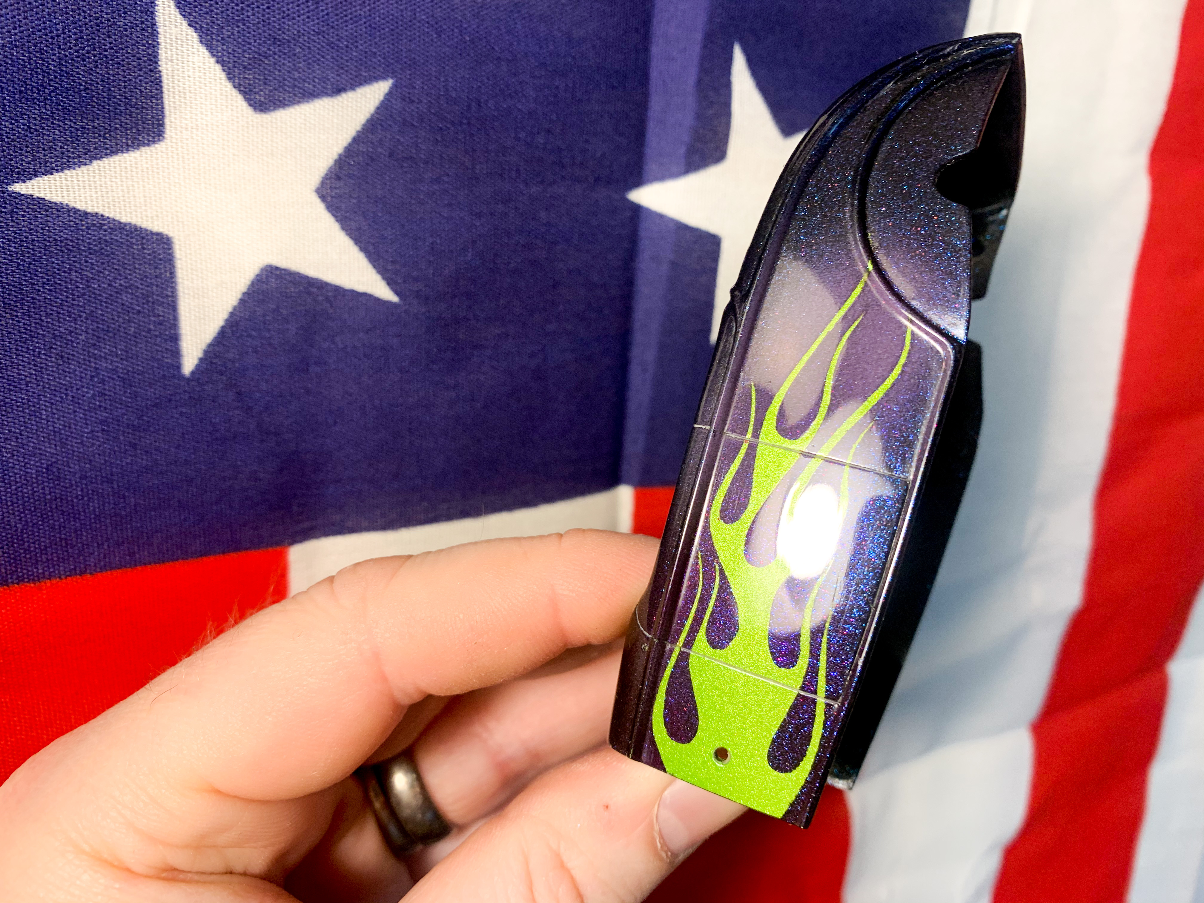

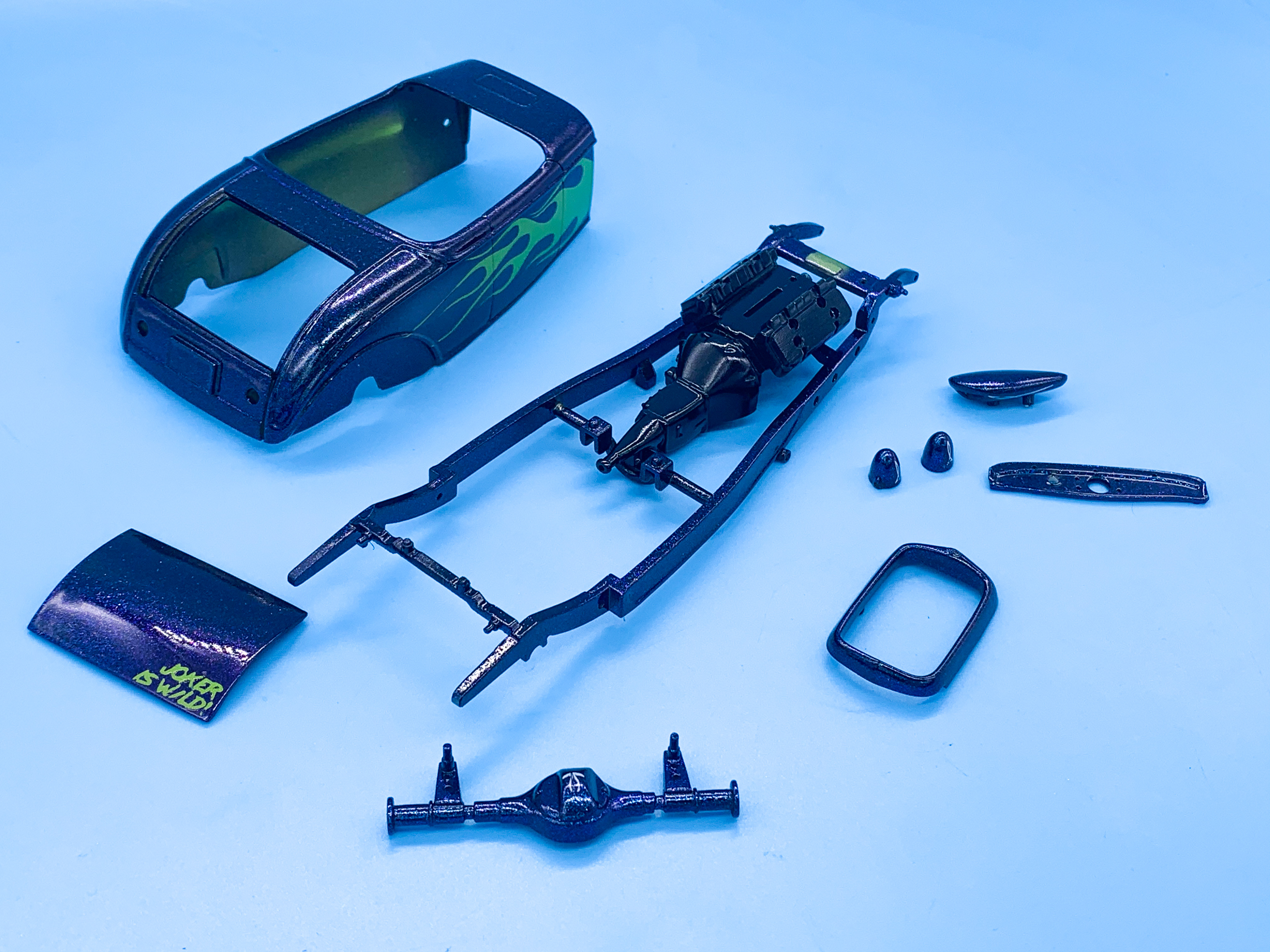

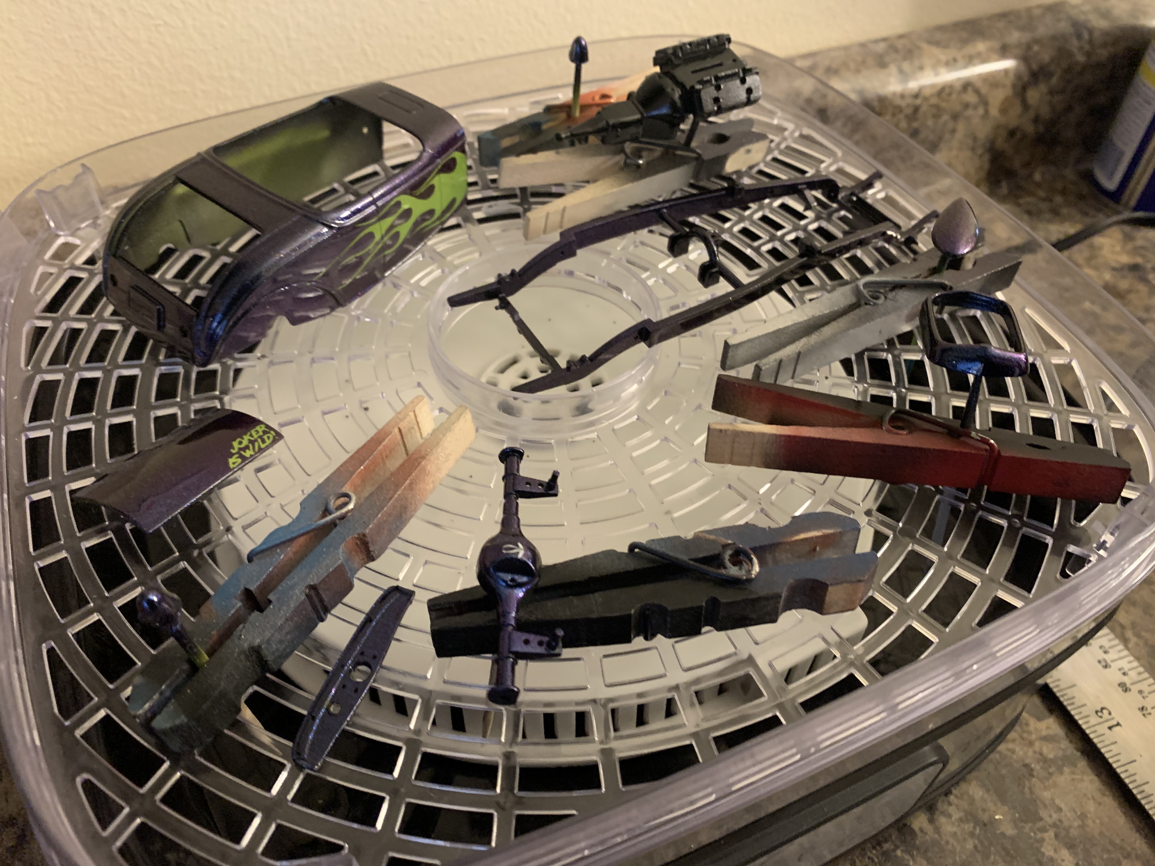

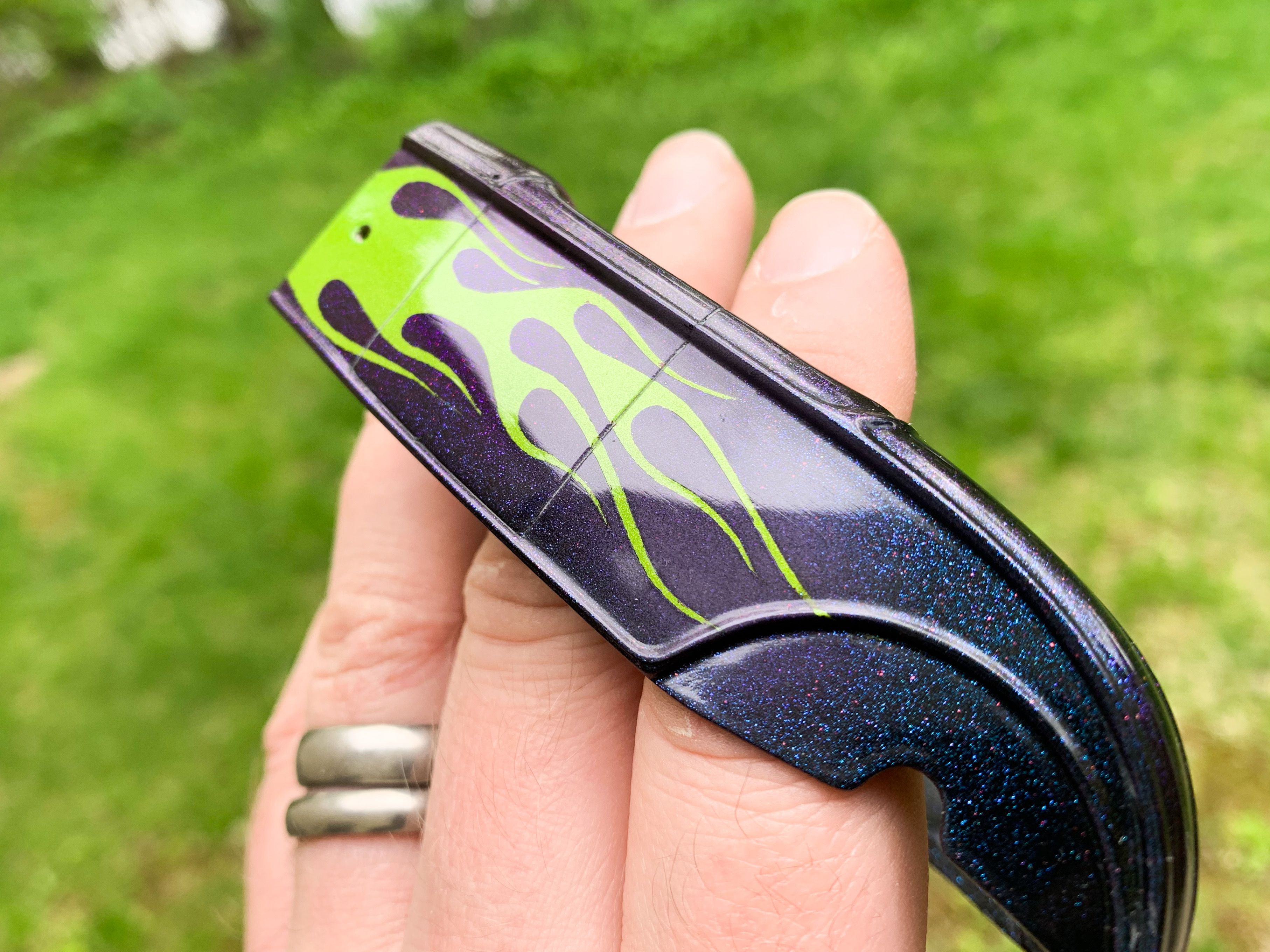

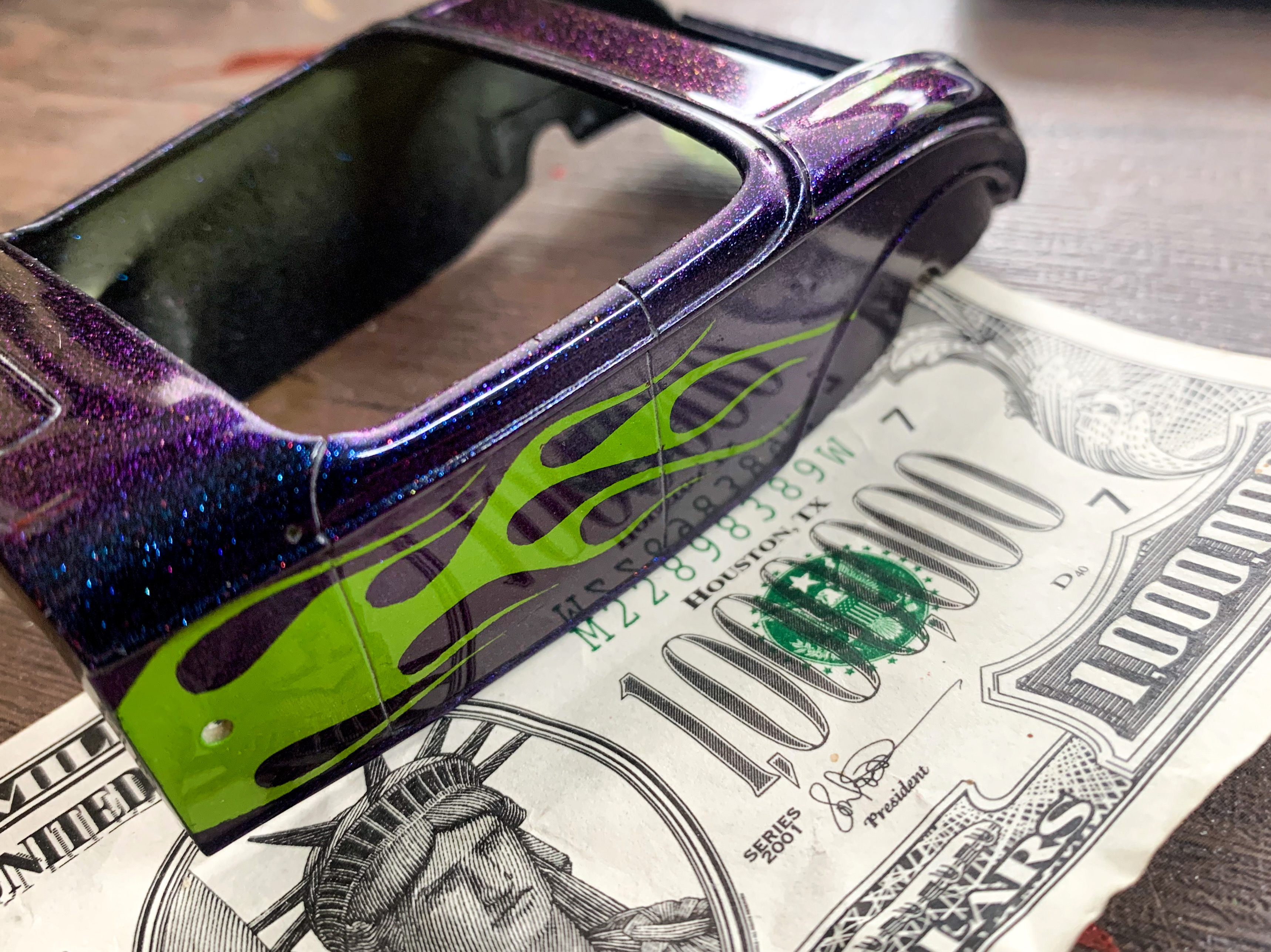

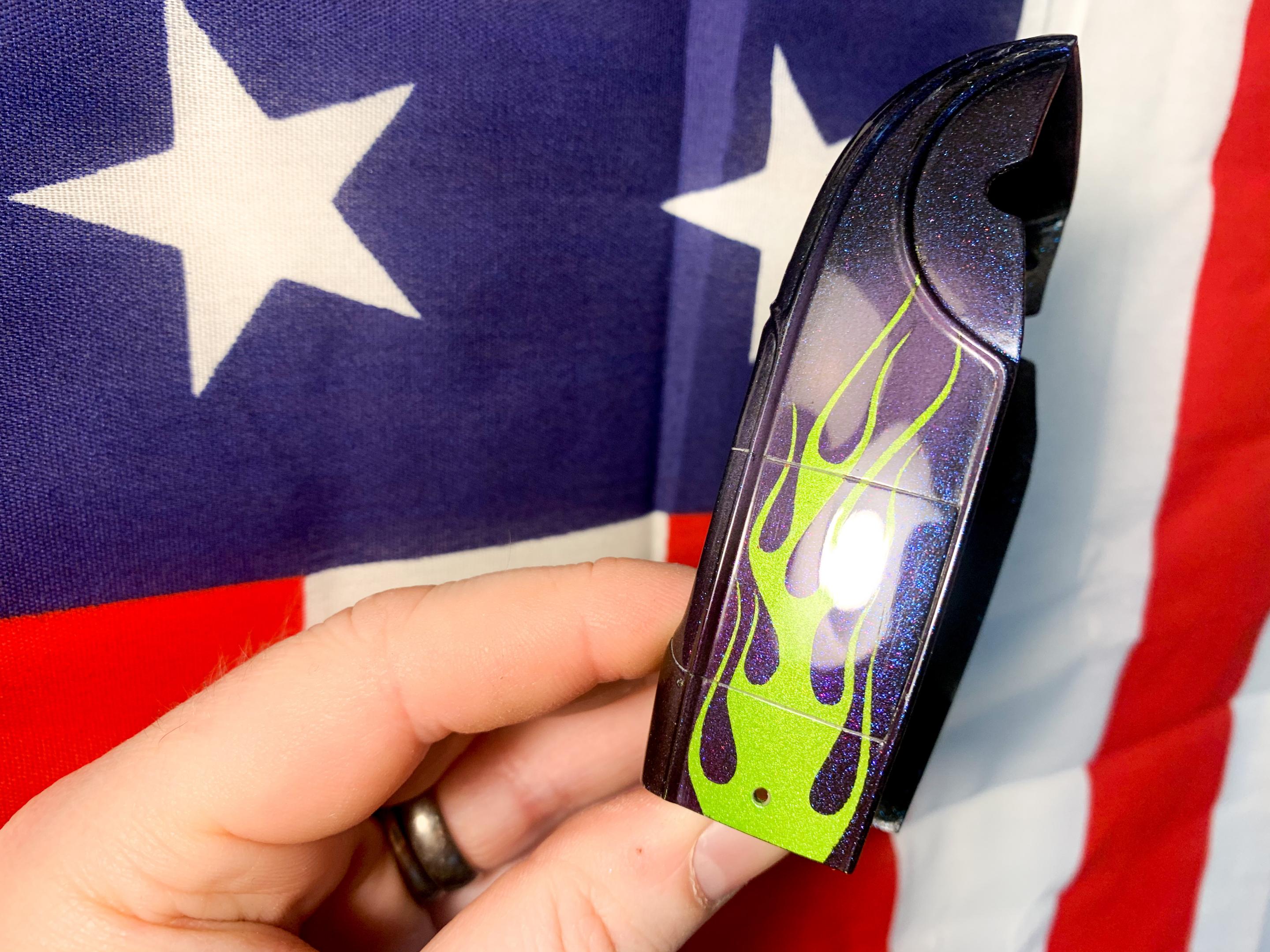

Got some clear down this weekend!  I sealed in the topcoat with Future so I could lay down a few decals and little details and then shot Testors enamel on the whole shebang:
Let the parts set-up an hour or so then put them in the magic paint bake machine:
And 24 hours later - shiny parts!
They’ll need polishing and maybe one extra coat on the body depending on how initial sanding goes - those big flakes are a little lumpy naturally and the edge around the flames is a little pronounced - but no major disasters anyway!

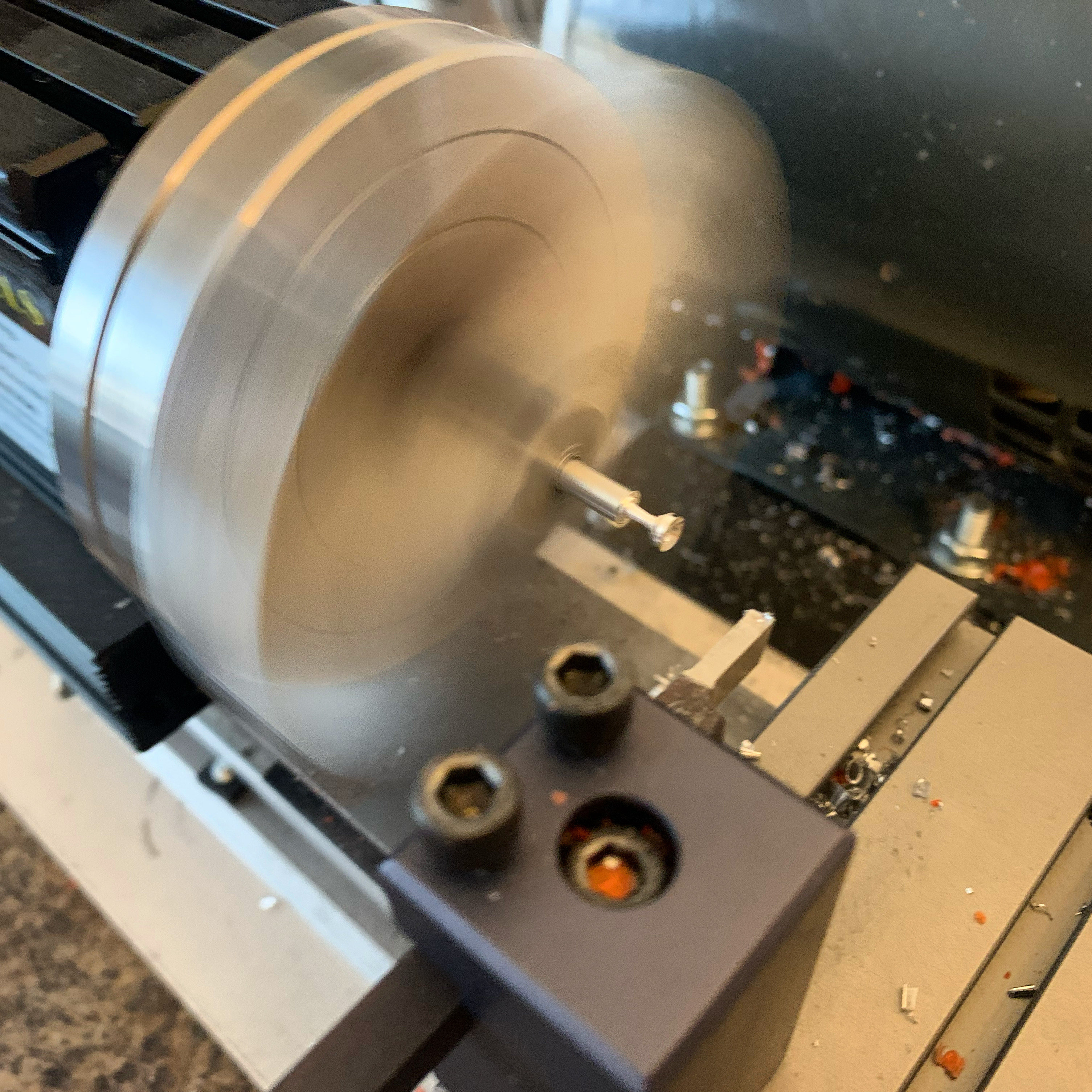

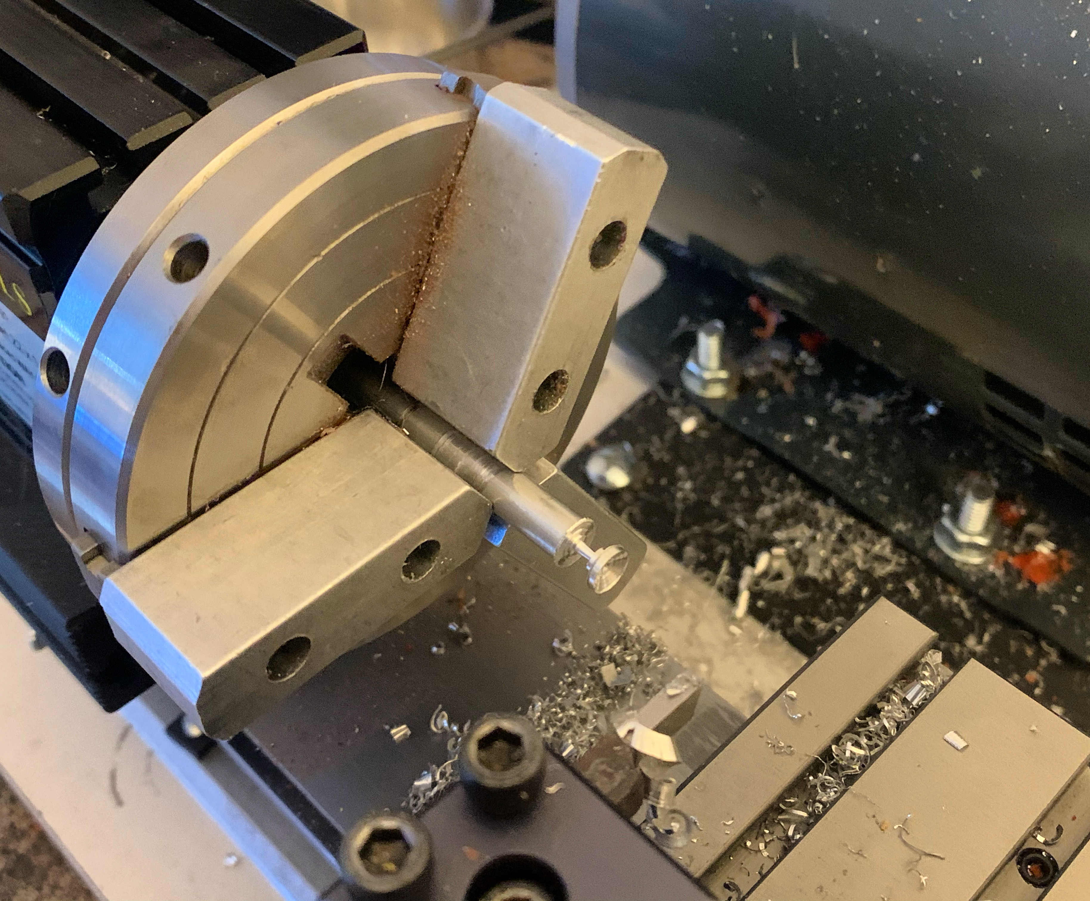

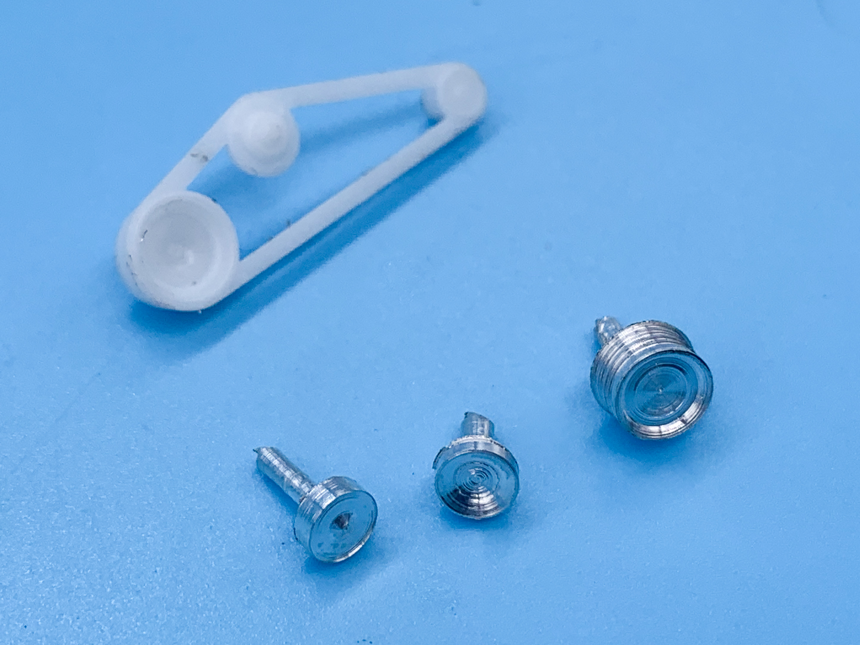

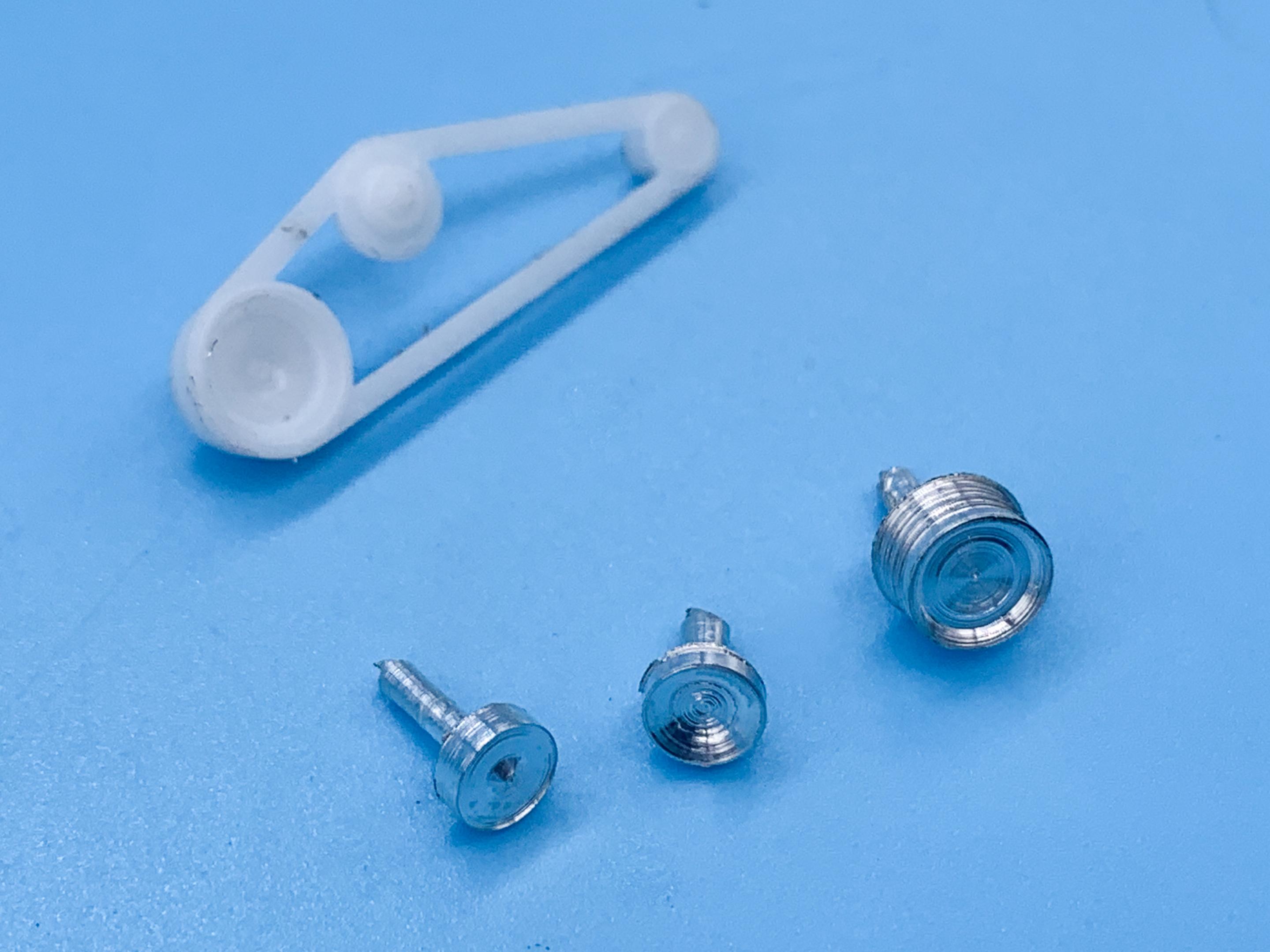

Meanwhile, spun up the lathe to make some pulleys to replace the kit parts:
Need to clean them up (they were small enough that I nipped the ends off with wire cutters rather than part them off properly and risk them flying off into space) and then polish them up but that’s another little project accomplished:
I’ll add some photo etch bolt detail to these and use some sign vinyl for a belt - way better than the kit part (hopefully...)

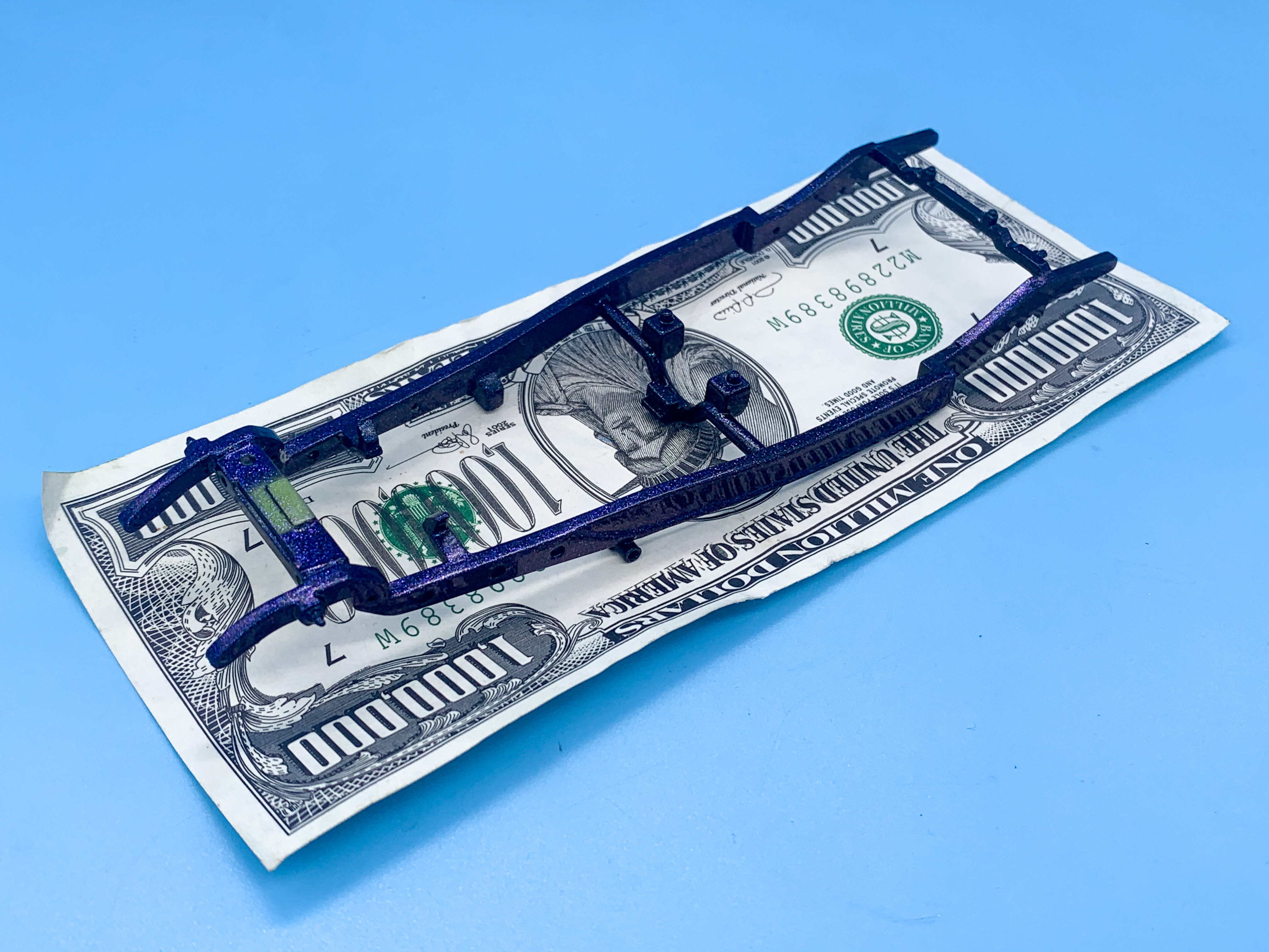

I don’t usually polish my frames but I thought I should start, so I spend an hour or so on this one this week - came out pretty nice!
Need to do a little more to it, but I’m pretty pleased with it as it stands...

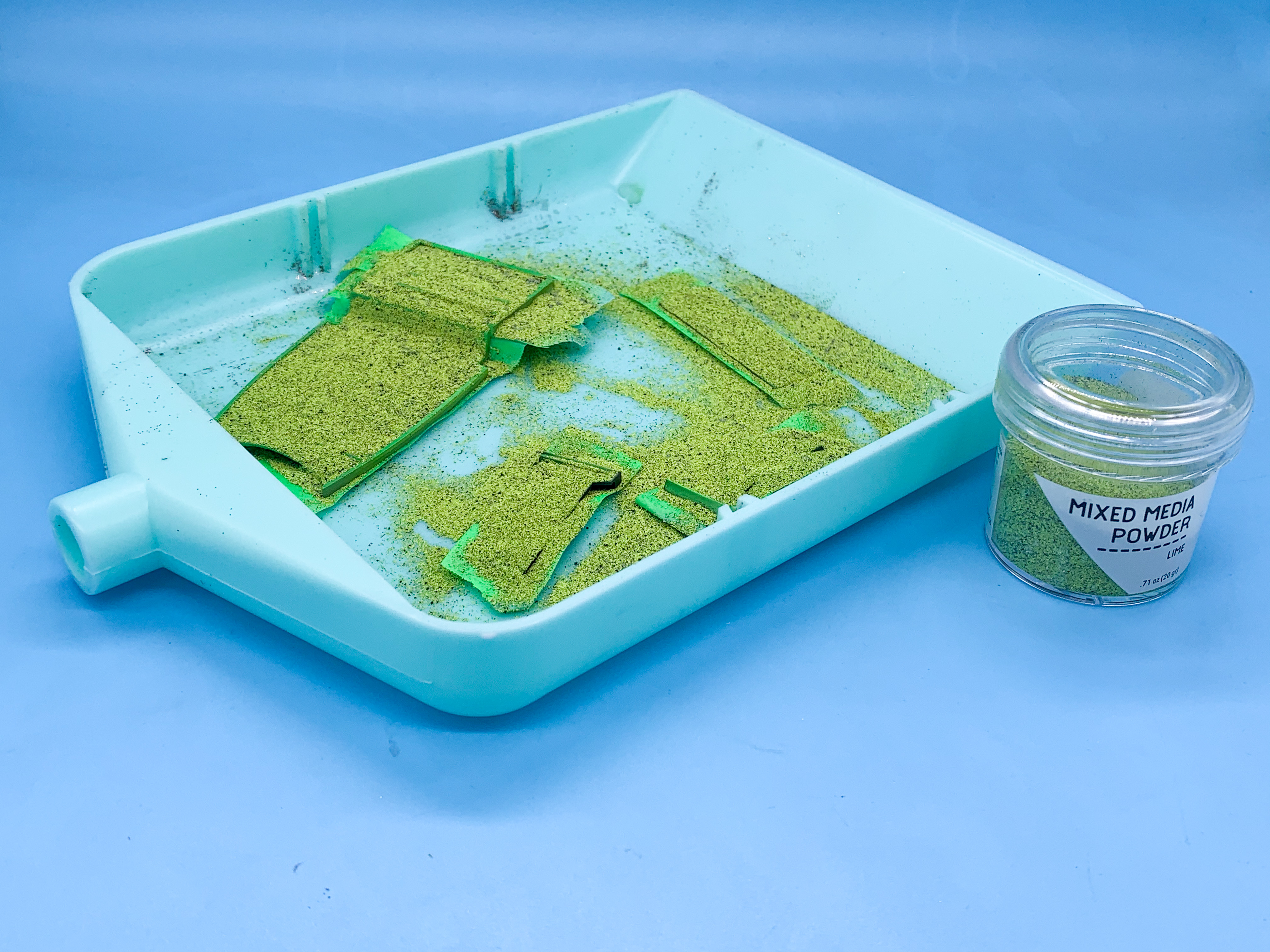

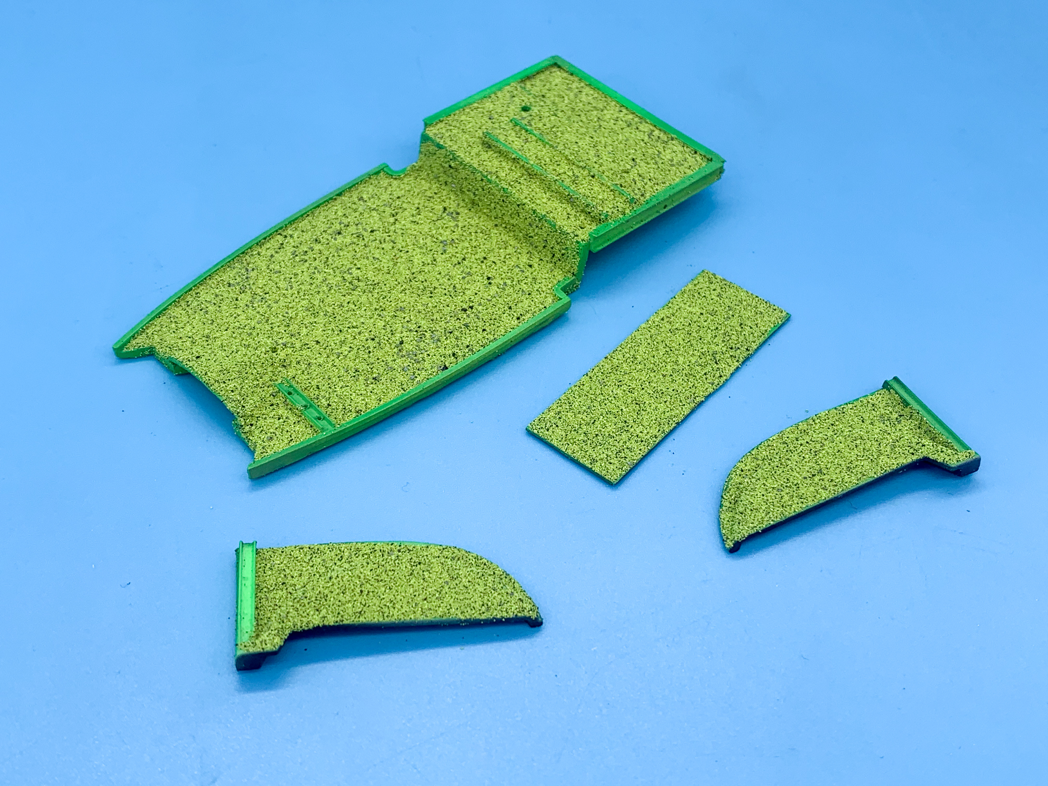

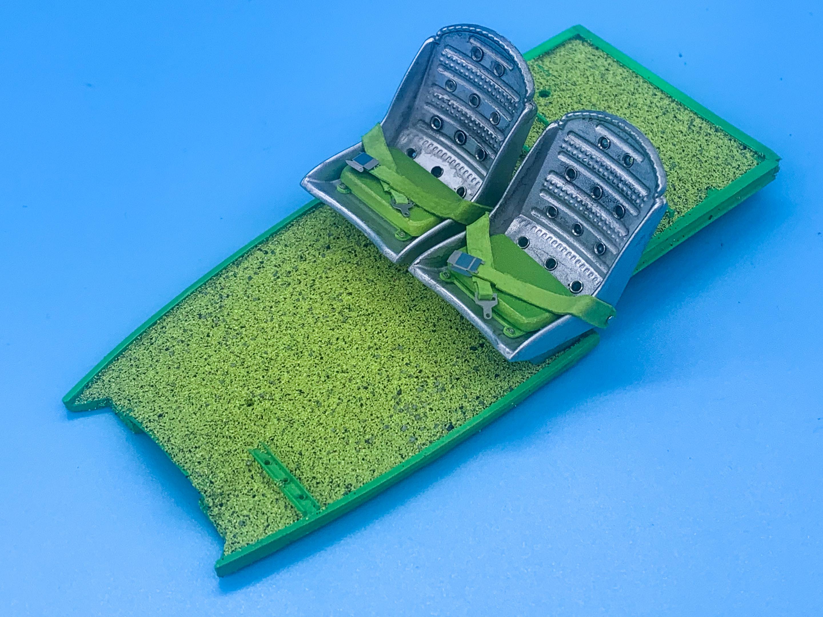

Needed to get some ‘carpet’ on the interior parts before I get too much further so I found some speckled lime-green embossing powder in Hobby Lobby and laid that down over a neon green base (just because I HAD neon green 🤪)
Came out nice I think, although it looks like a mini-golf course 🤷‍♂️😂

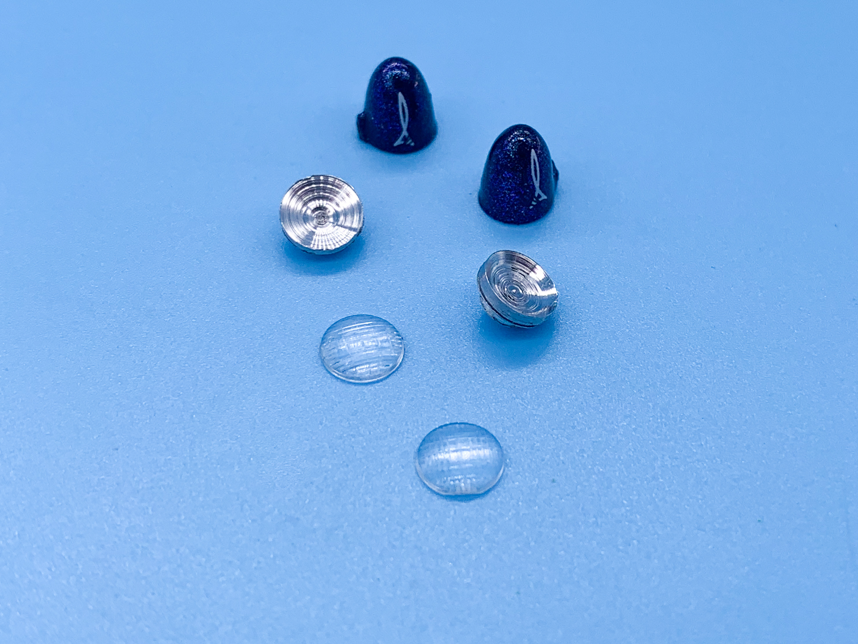

And finally, fired up the metal-roundener to to make some headlight buckets for those little AMT headlamps - they still need some clean-up and finishing off but they’ll look cool when they’re all shiny I think:

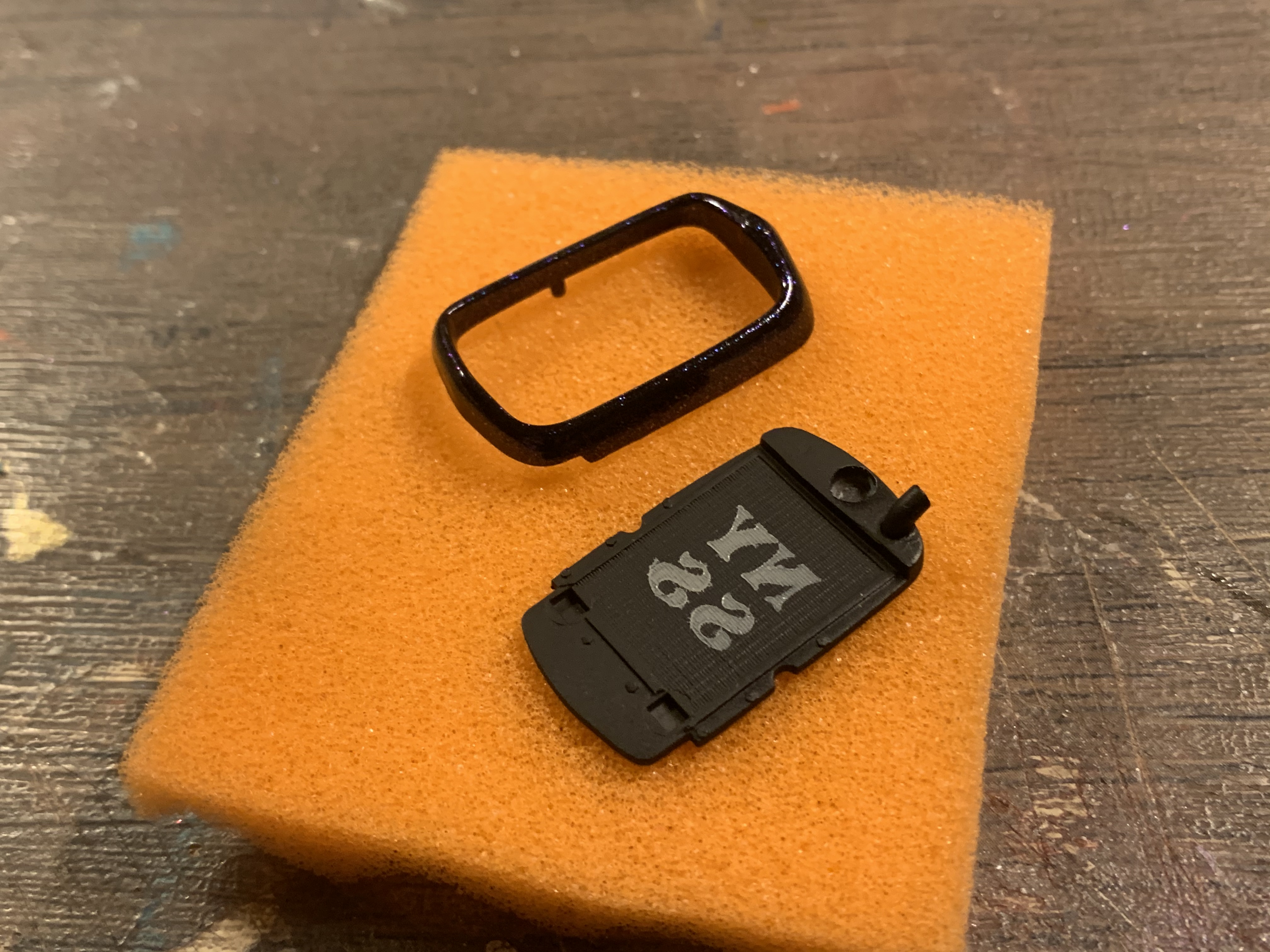

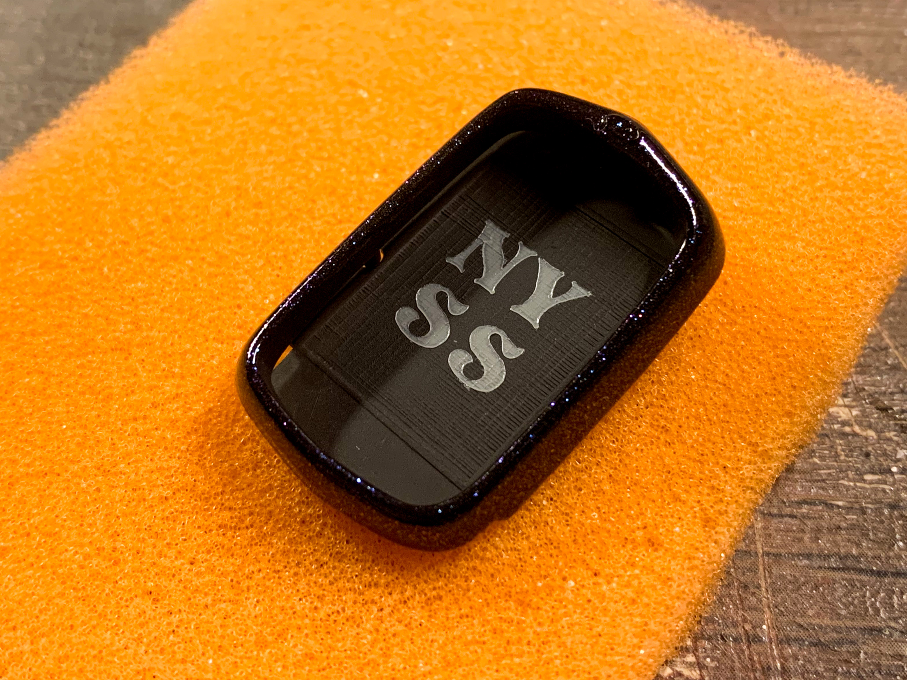

Painted some lettering on the rad:
...with a reverse version on the backside, for my own amusement...

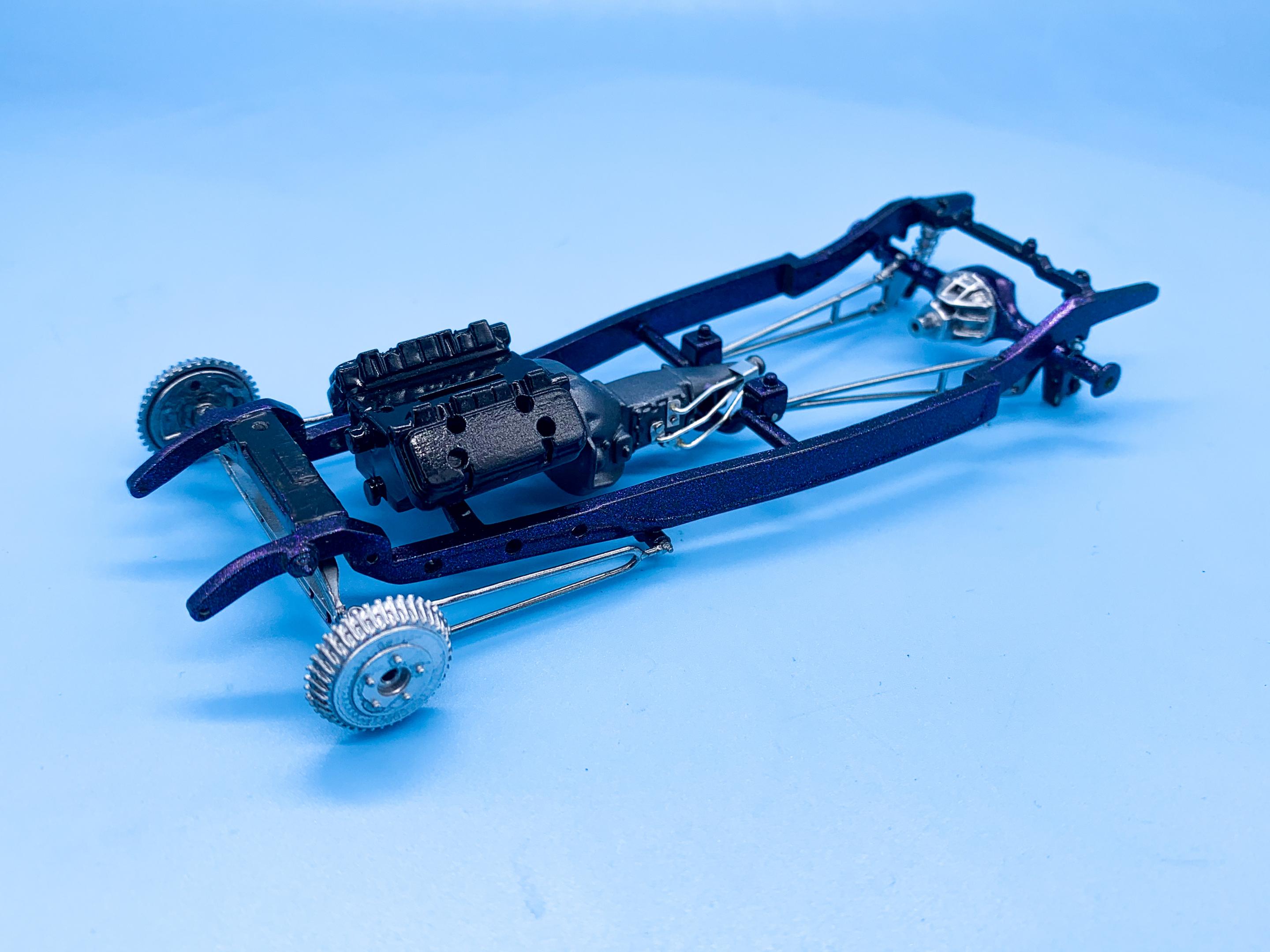

Then scratchbuilt some linkages for the shifter and started getting the frame assembled:

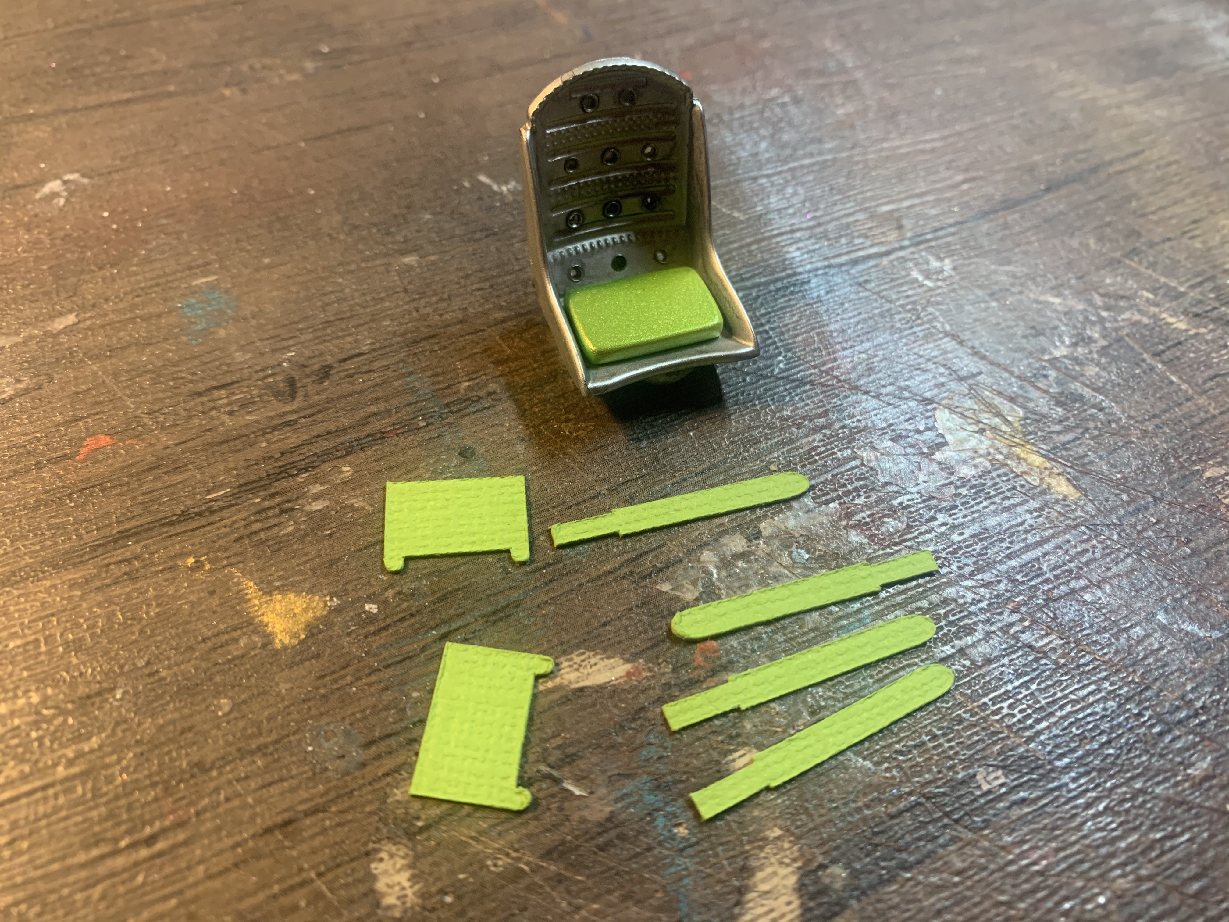

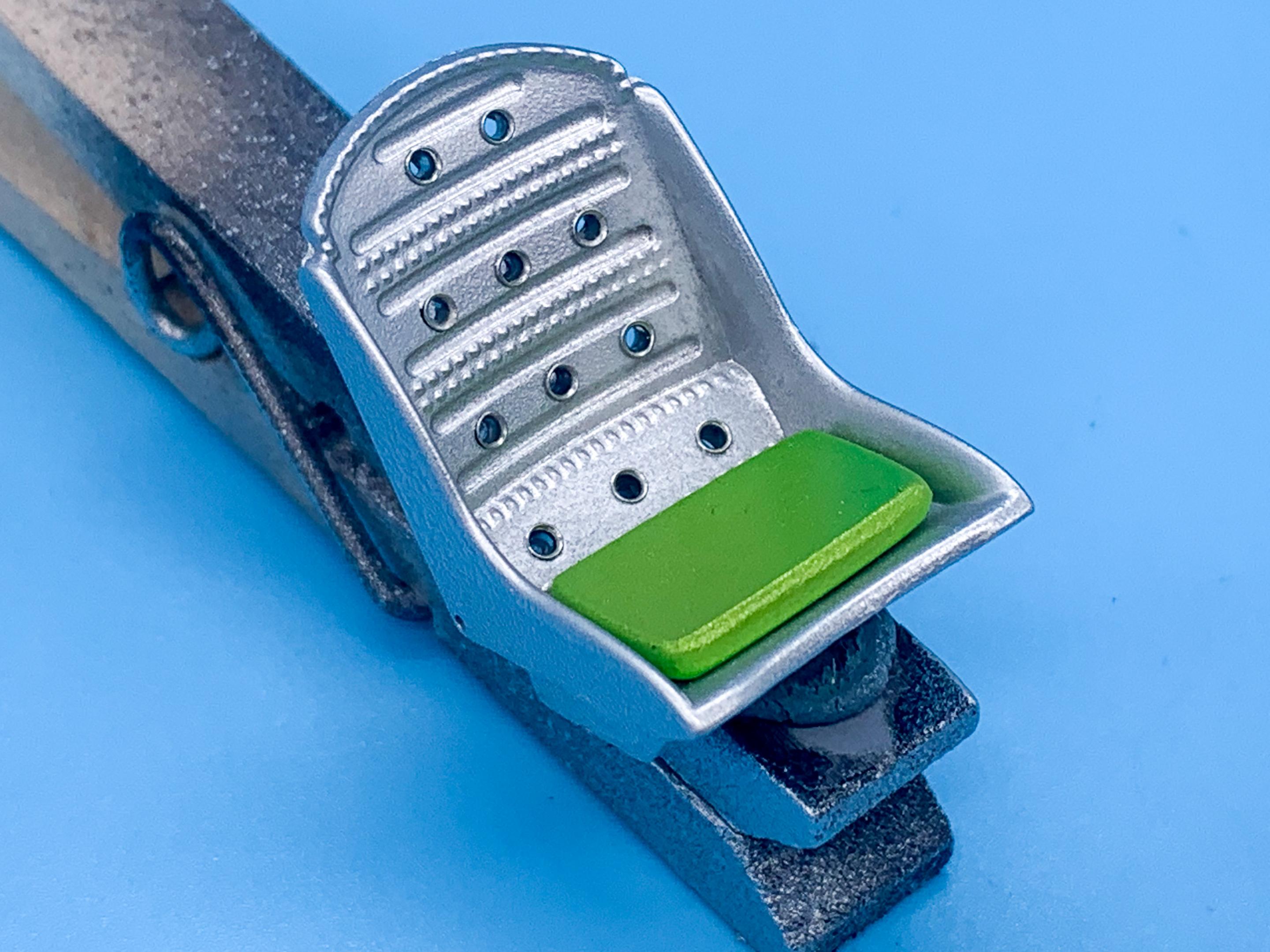

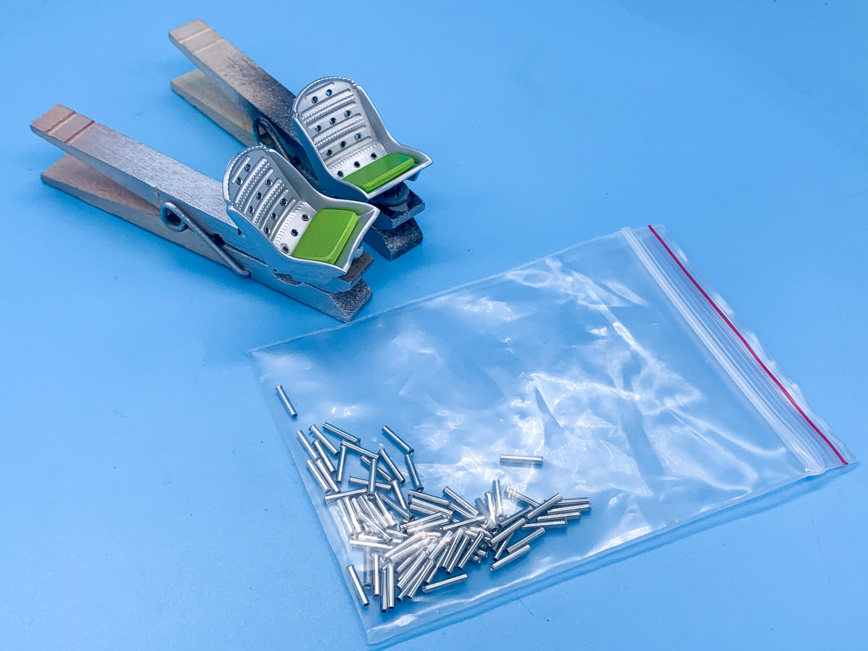

I’m waiting for some little photoetched brackets to arrive so I can start plumbing the brake lines nicely but the USPS is currently taking them on their third trip of the mid-west so that’s holding me up a little...so today I shortened up a bunch of these micro ferrules to make some little inserts to finish the holes in the bomber seats nicely:
Like so!
Then I gave them a black wash to add a little character and make them look less flat and plain-looking, and cut some seatbelts from some textured card:
And finished them off with some PE buckles:

May I ask where you got the micro ferrules? I'm looking for something like that for a project.
A company named Baomain sells a set on Amazon - you get five sizes for $8 or something...super useful for all kinds of things!

Using those ferrules was a great way to further detail the seats. There is a bunch of them, how did you cut them down? Did you make a jig so they're all the same length?
I just cut them about as close as I could get to the flared end - took a while but I managed to make them all without one pinging off into space 🤪

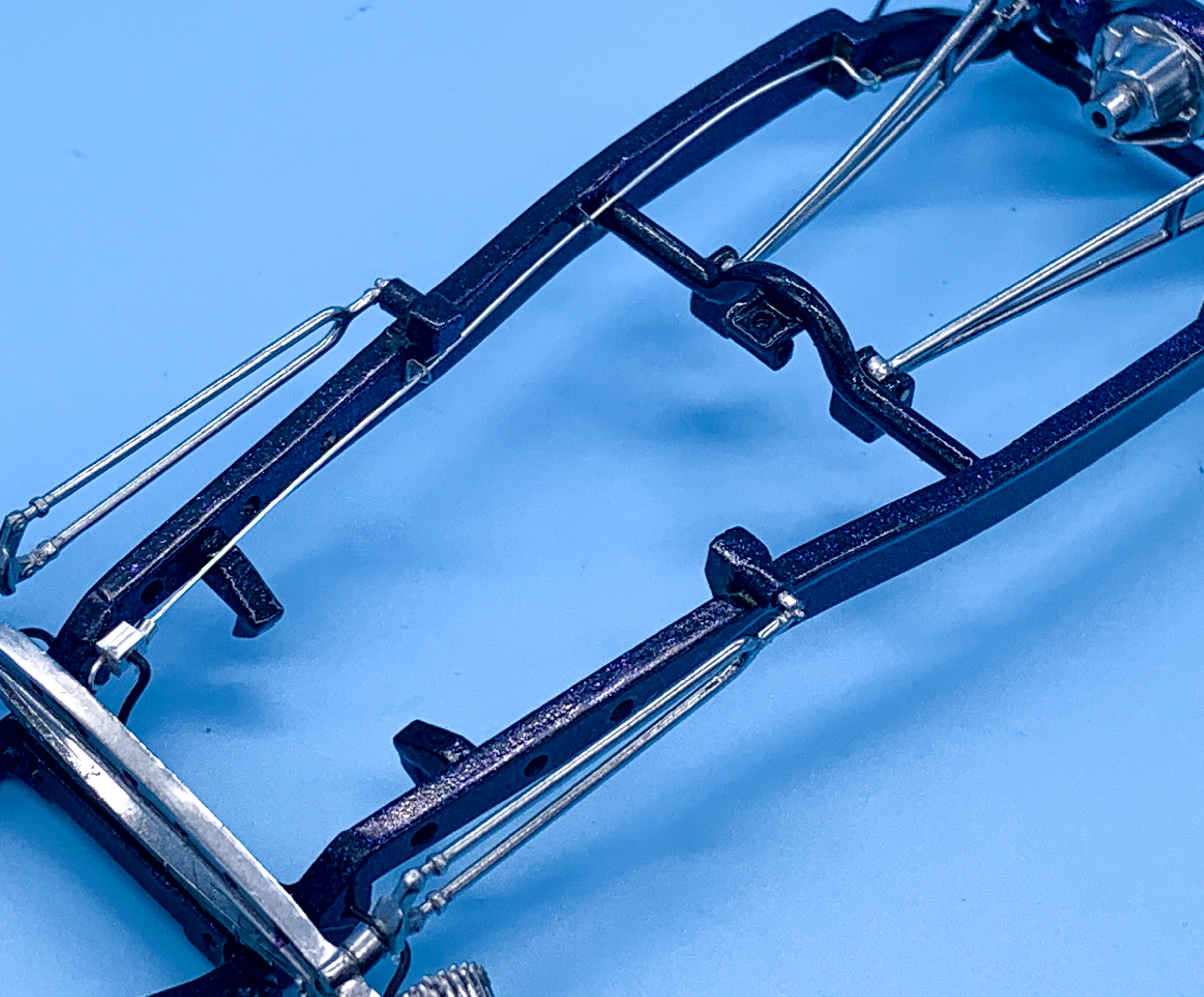

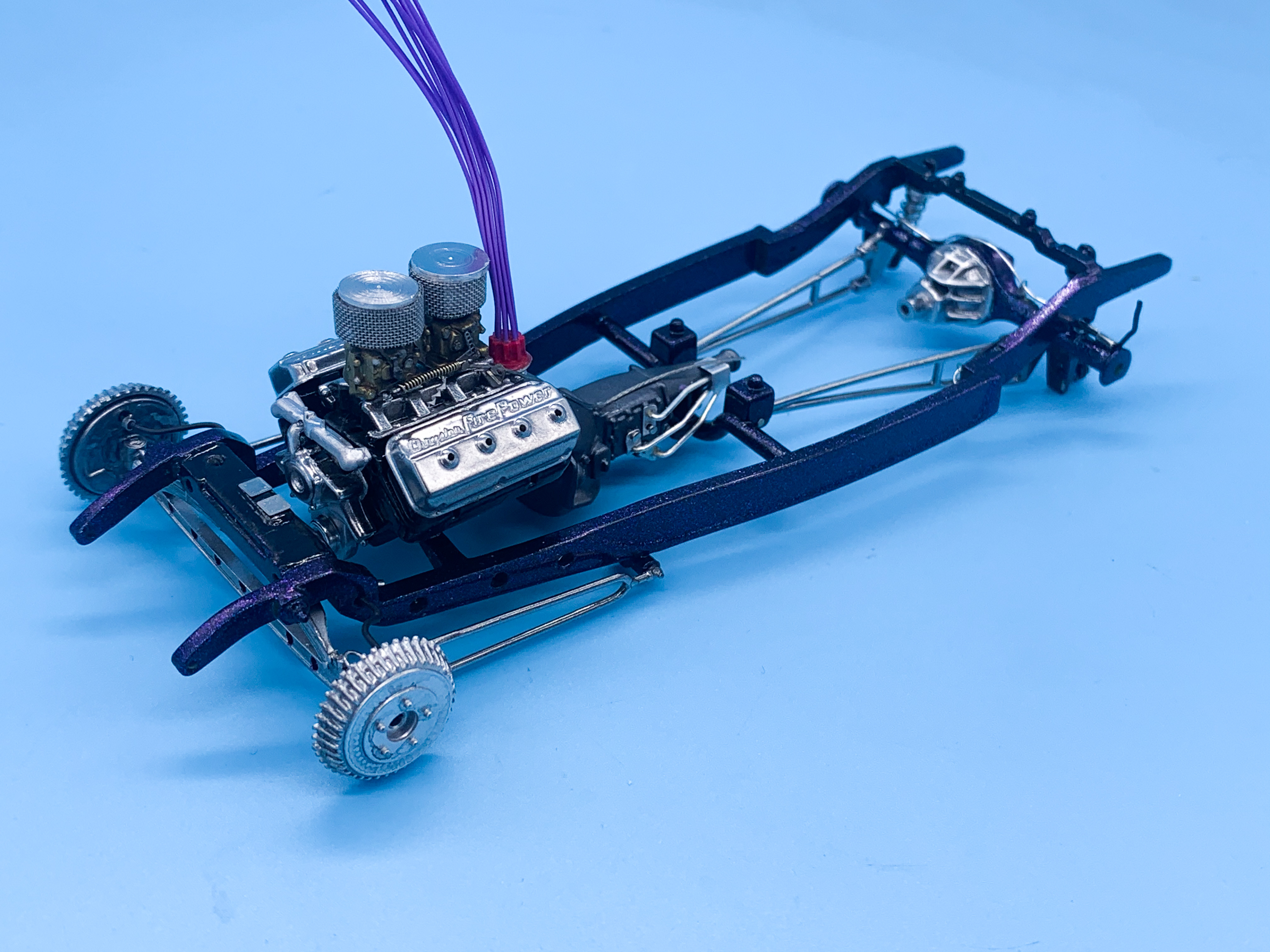

Made some brake lines, secured with some little photo etched brackets:

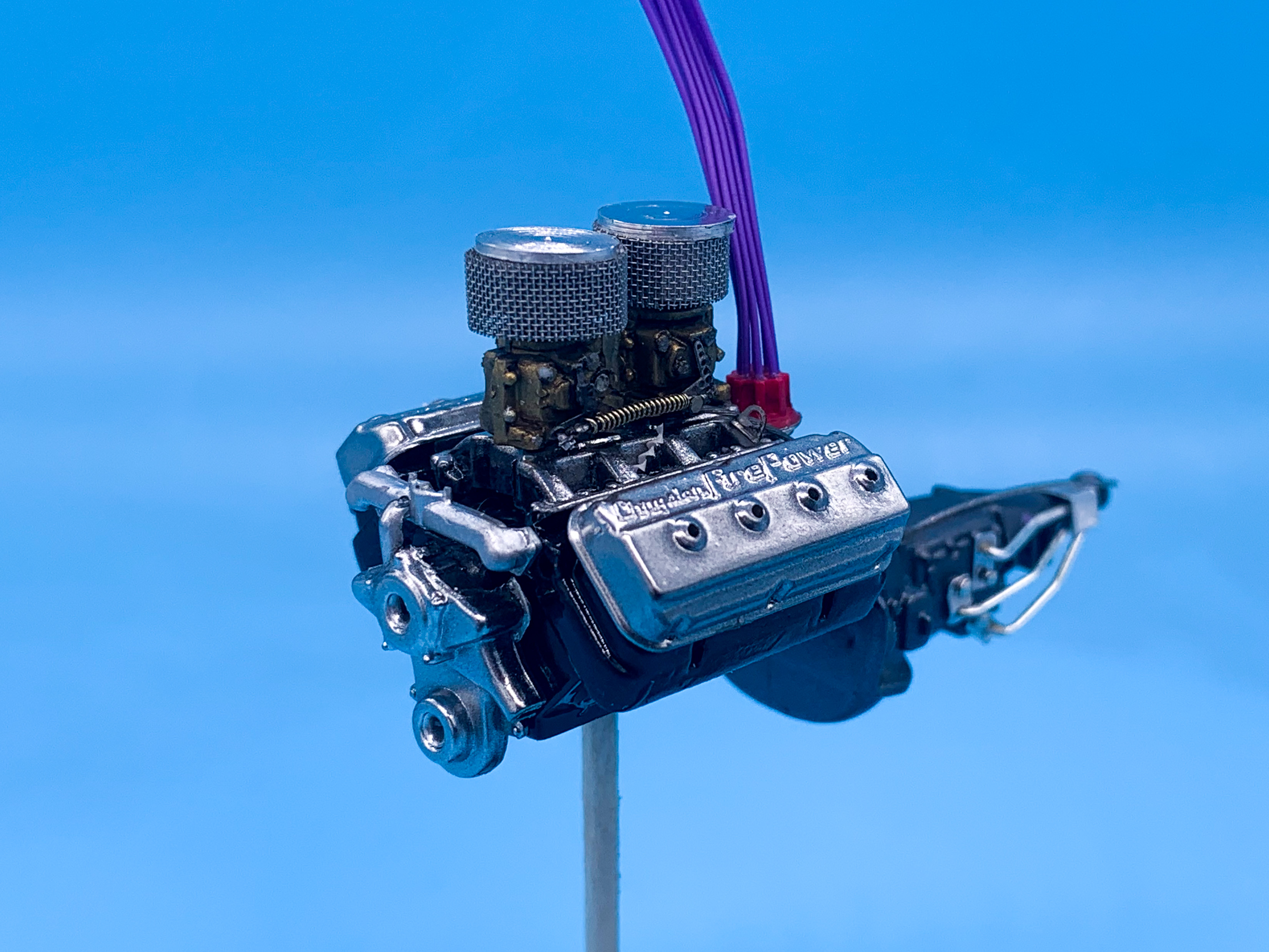

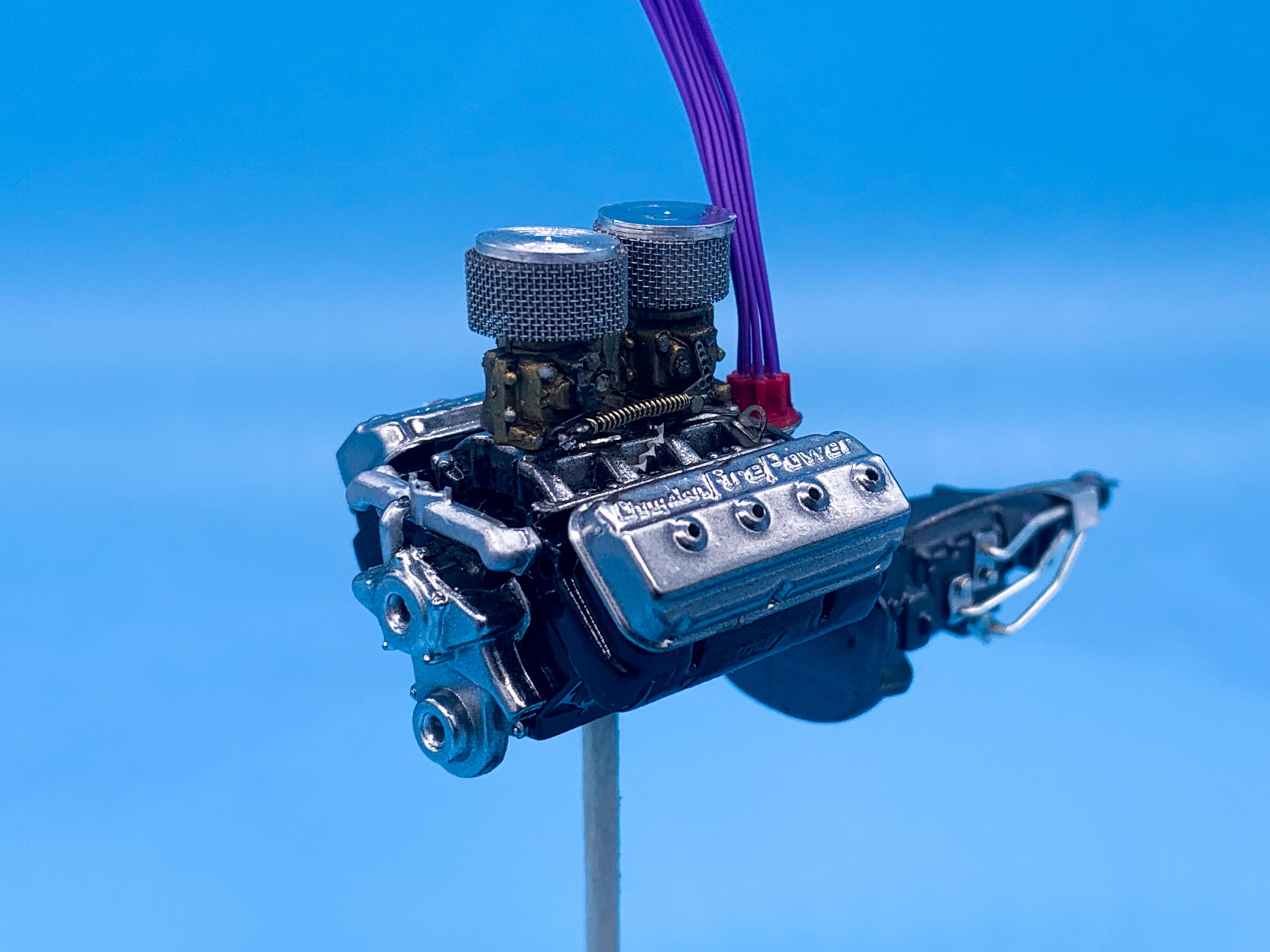

Machined some air filters and a bracket for the distributor and started on the engine:
Doesn’t look much like a car that will be ready for DSC in two weeks - I’m pleased with how the frame’s coming together tho!
