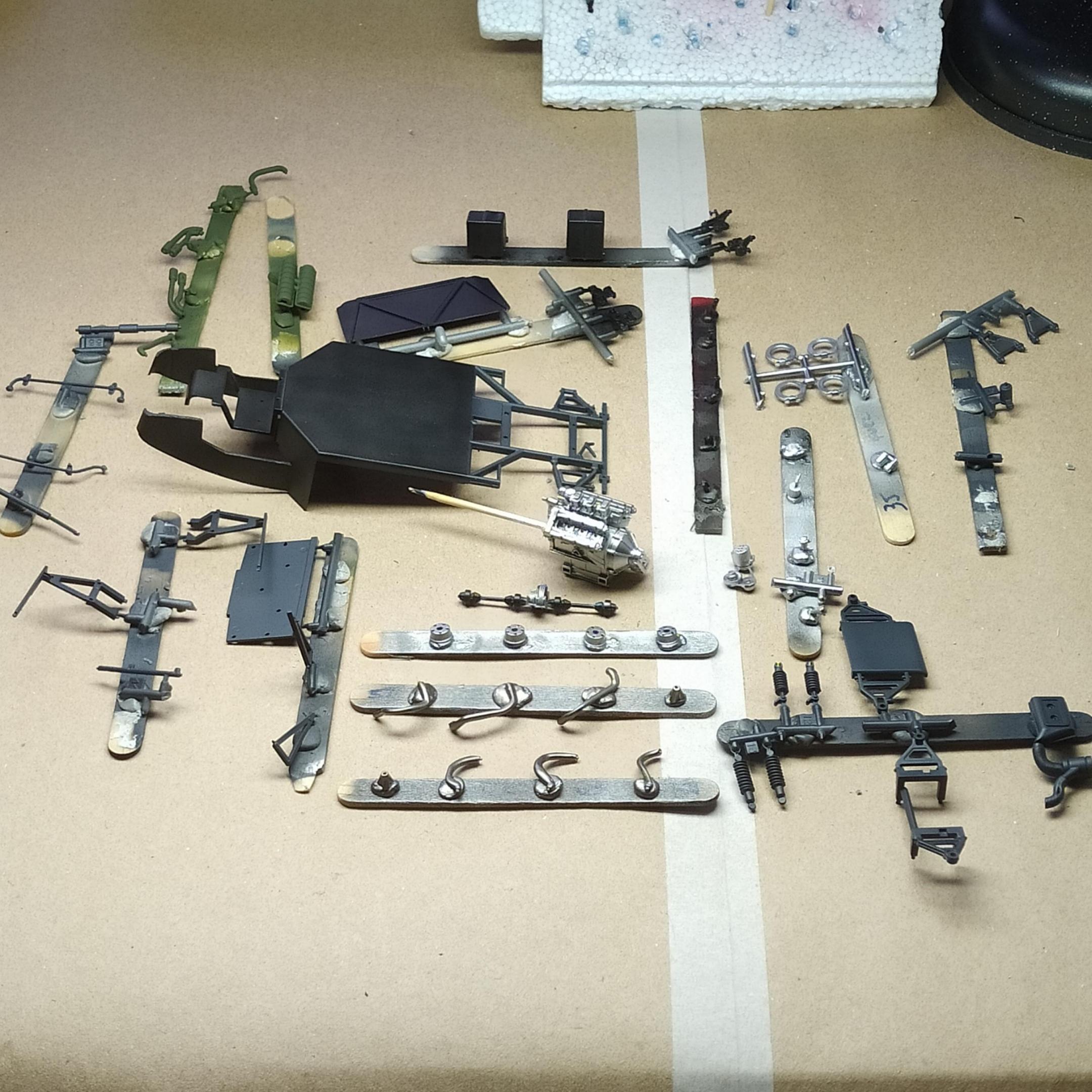

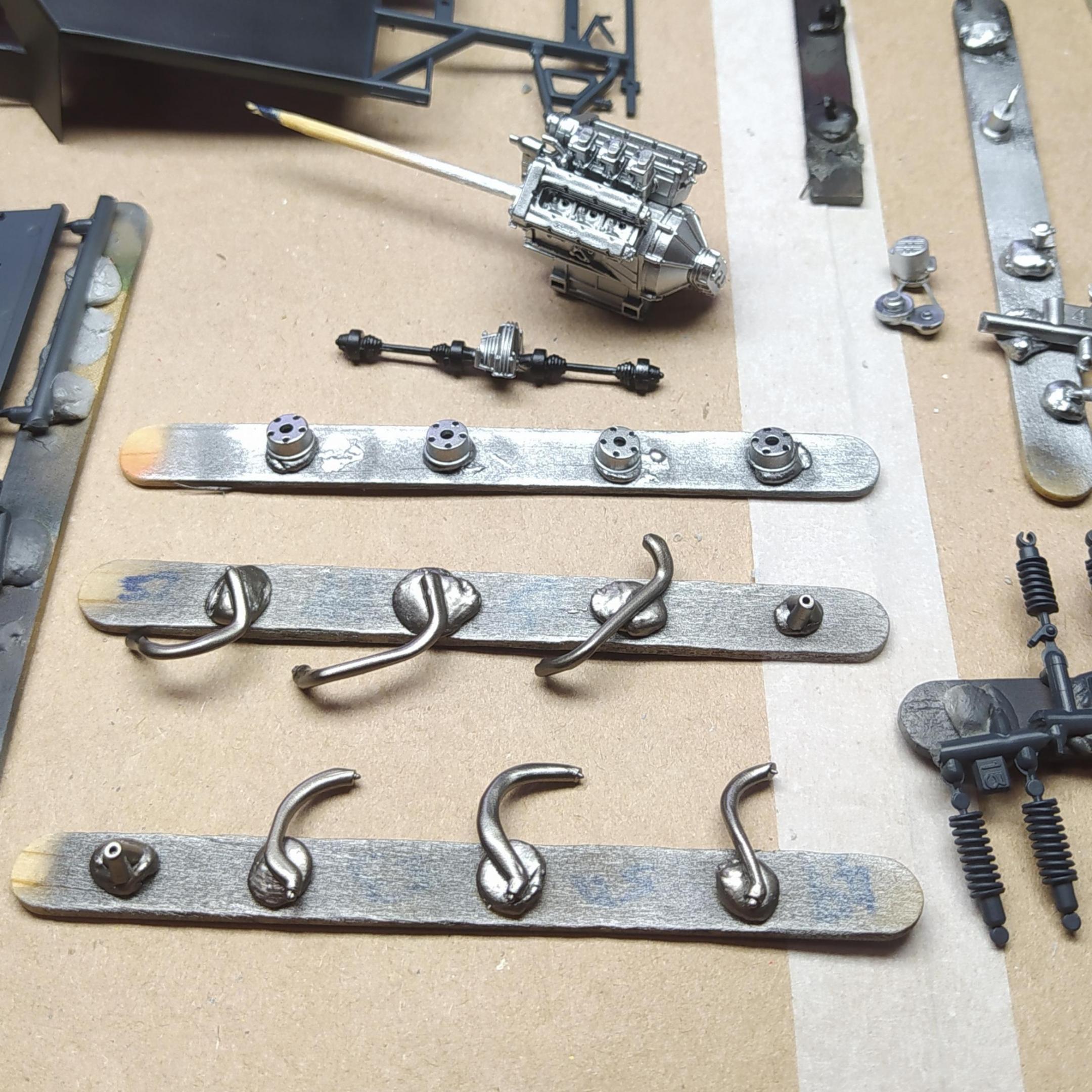

MarcoTJ Posted March 23, 2021 Author Share Posted March 23, 2021 Started building the parts of the engine, chassis and axles. Then primed and painted with auto base coat. Metallic parts were first painted black then metal. This engine must have about 20 pieces to it. That's all for today!😊 Quote Link to comment Share on other sites More sharing options...

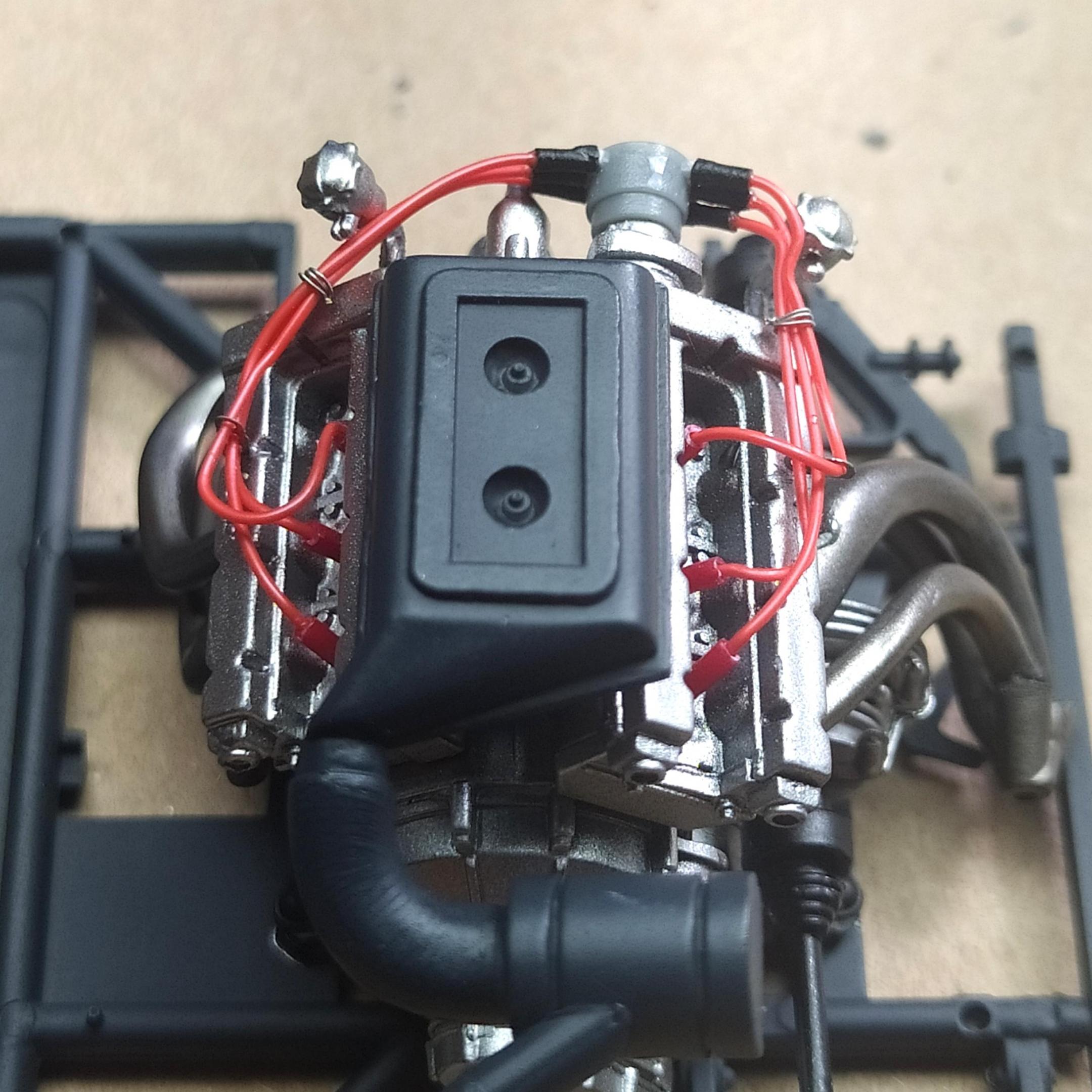

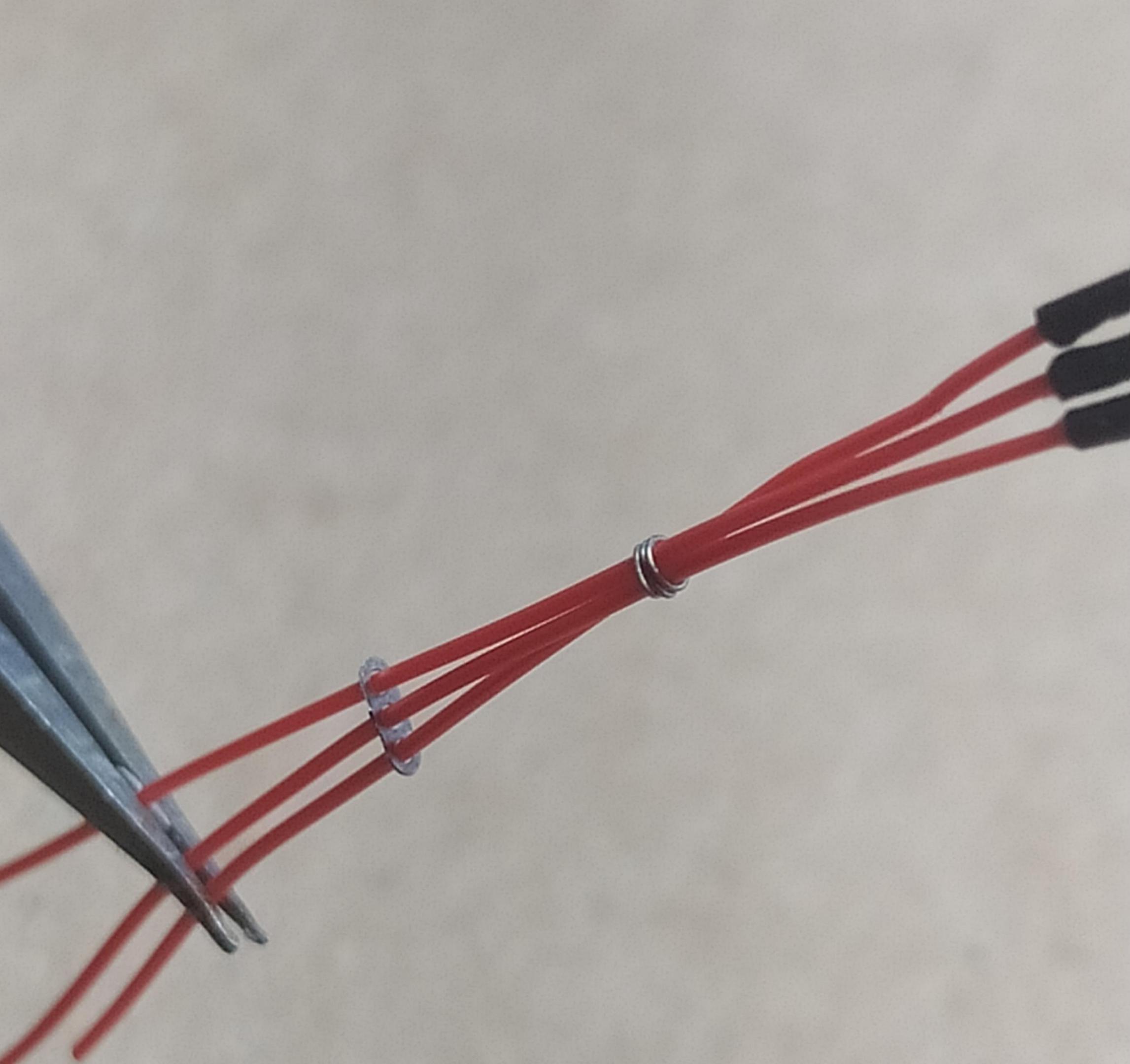

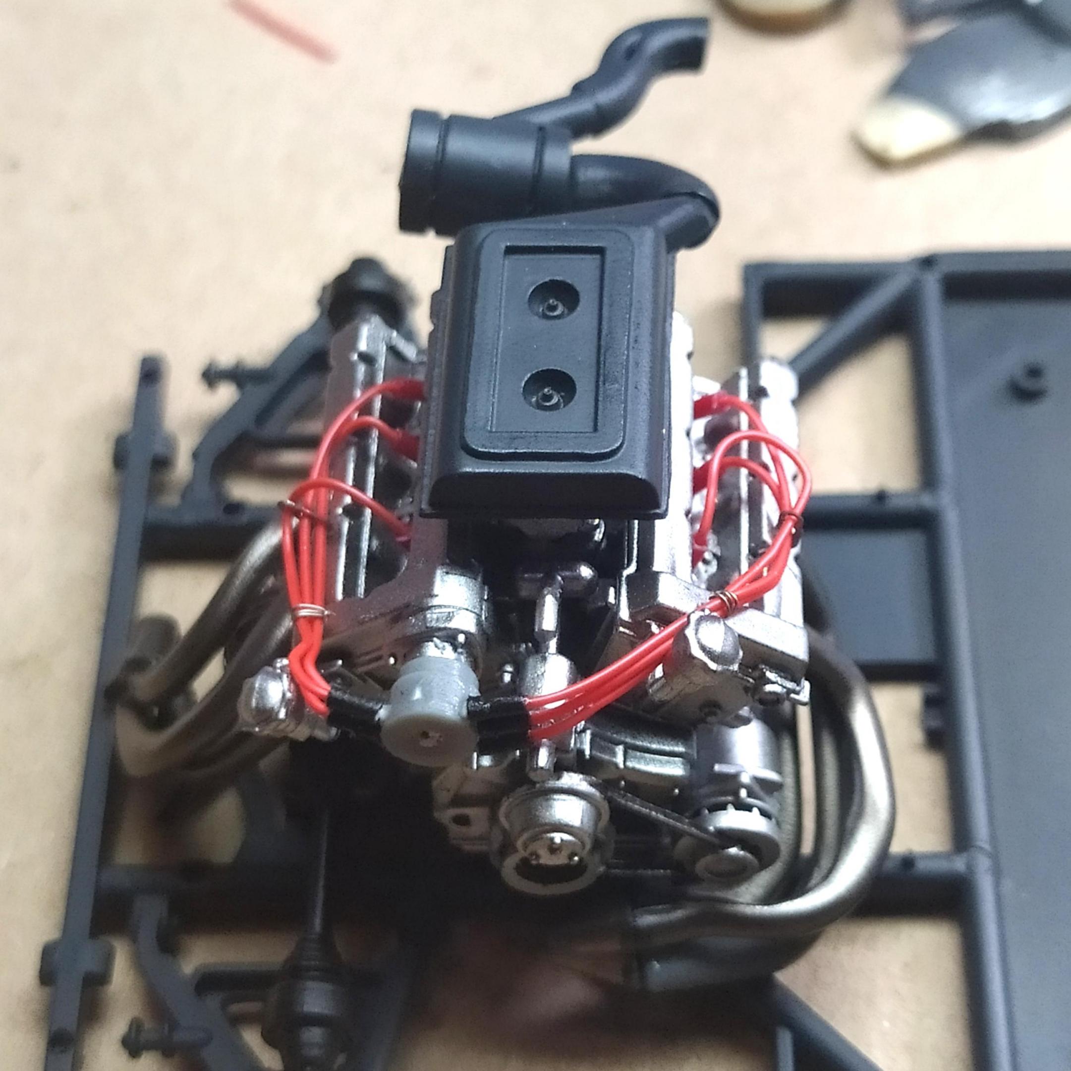

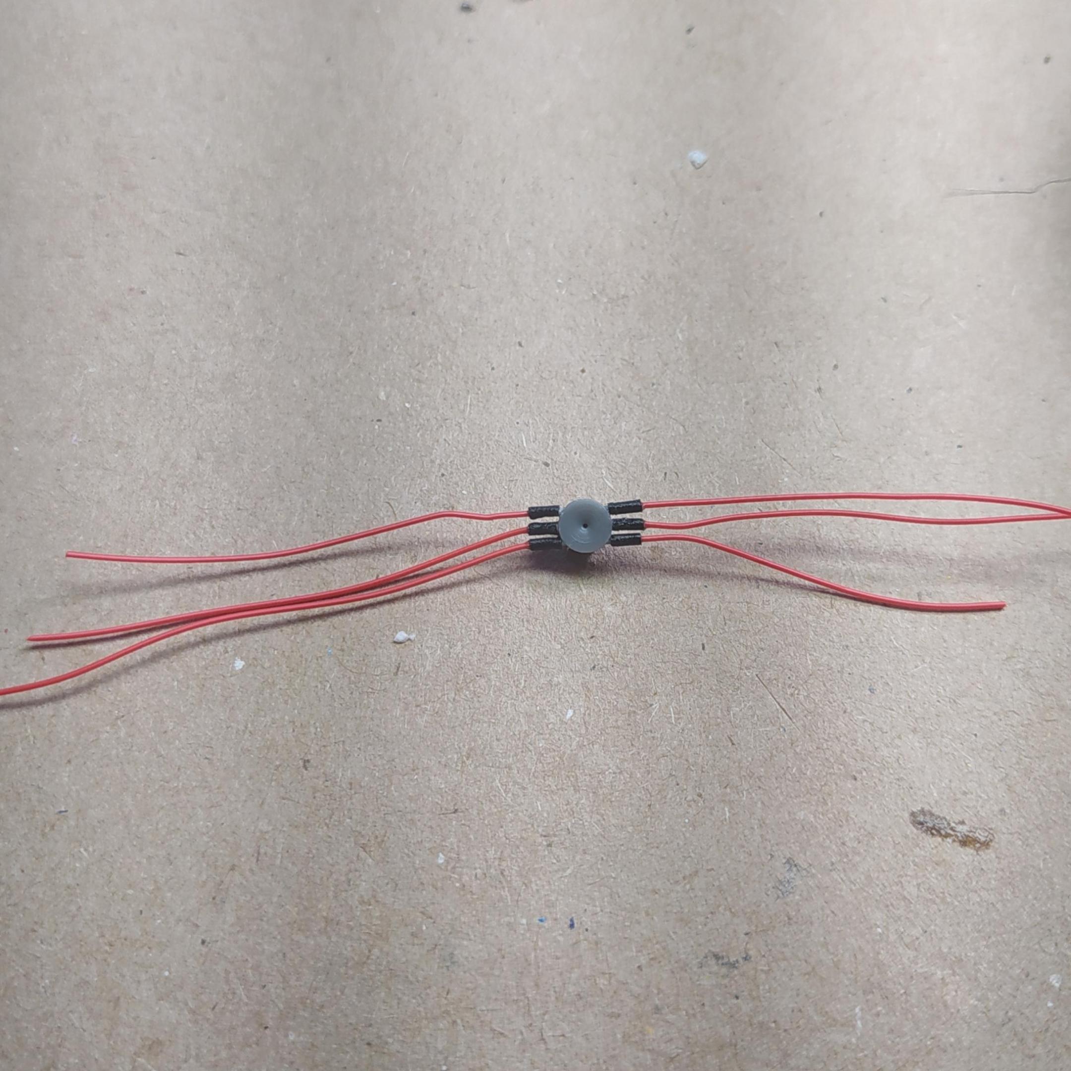

MarcoTJ Posted March 24, 2021 Author Share Posted March 24, 2021 Did some engine detailing. Got these nice accessories: added larger wire sleeves on the distribuir The red wire fits nicely More details On the other end I added a red sleeve. Also from a larger gauge wire I liked the effect Now I have to rest my eyes 😁😎😎 Quote Link to comment Share on other sites More sharing options...
Bainford Posted March 24, 2021 Share Posted March 24, 2021 Nice work. Looks great. Quote Link to comment Share on other sites More sharing options...
Italianhorses Posted March 25, 2021 Share Posted March 25, 2021 Nice! Quote Link to comment Share on other sites More sharing options...
89AKurt Posted March 25, 2021 Share Posted March 25, 2021 I have the GTS kit, so will watch this build! Looking good so far. Quote Link to comment Share on other sites More sharing options...

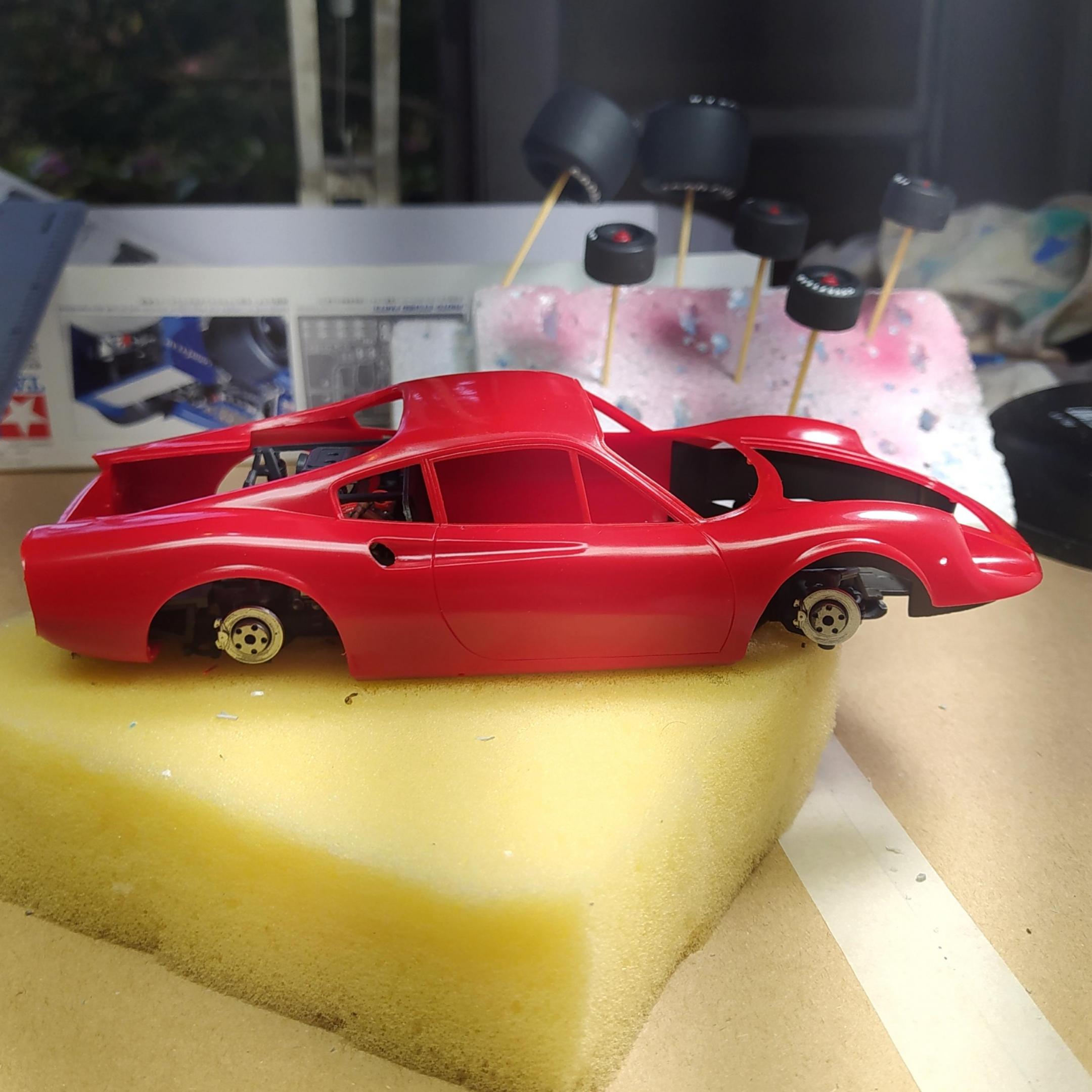

MarcoTJ Posted March 25, 2021 Author Share Posted March 25, 2021 Engine area almost done. First test fit succesful! Quote Link to comment Share on other sites More sharing options...

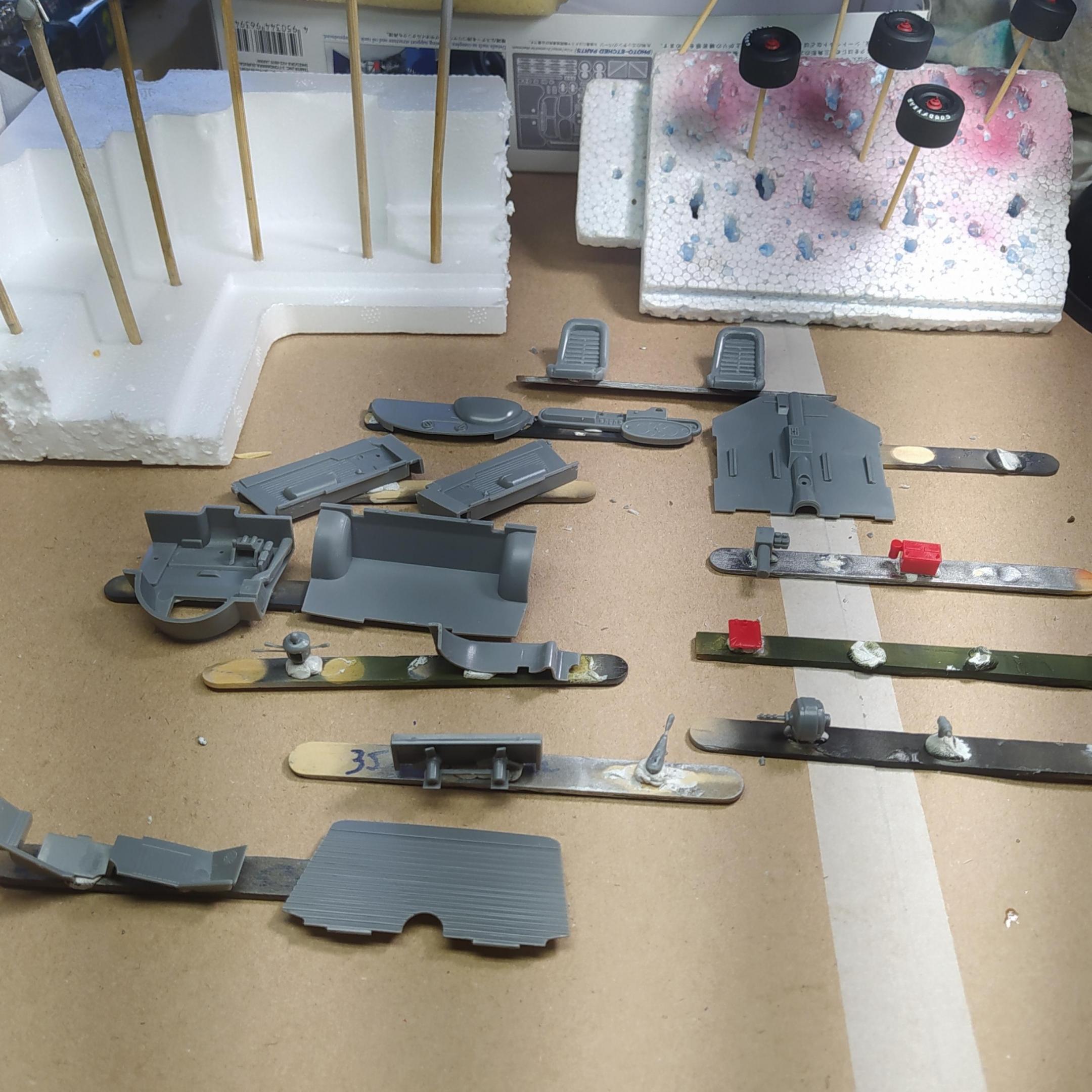

MarcoTJ Posted March 26, 2021 Author Share Posted March 26, 2021 Second round. Getting the cabin parts ready for painting. And made holes in the steering wheels. Quote Link to comment Share on other sites More sharing options...

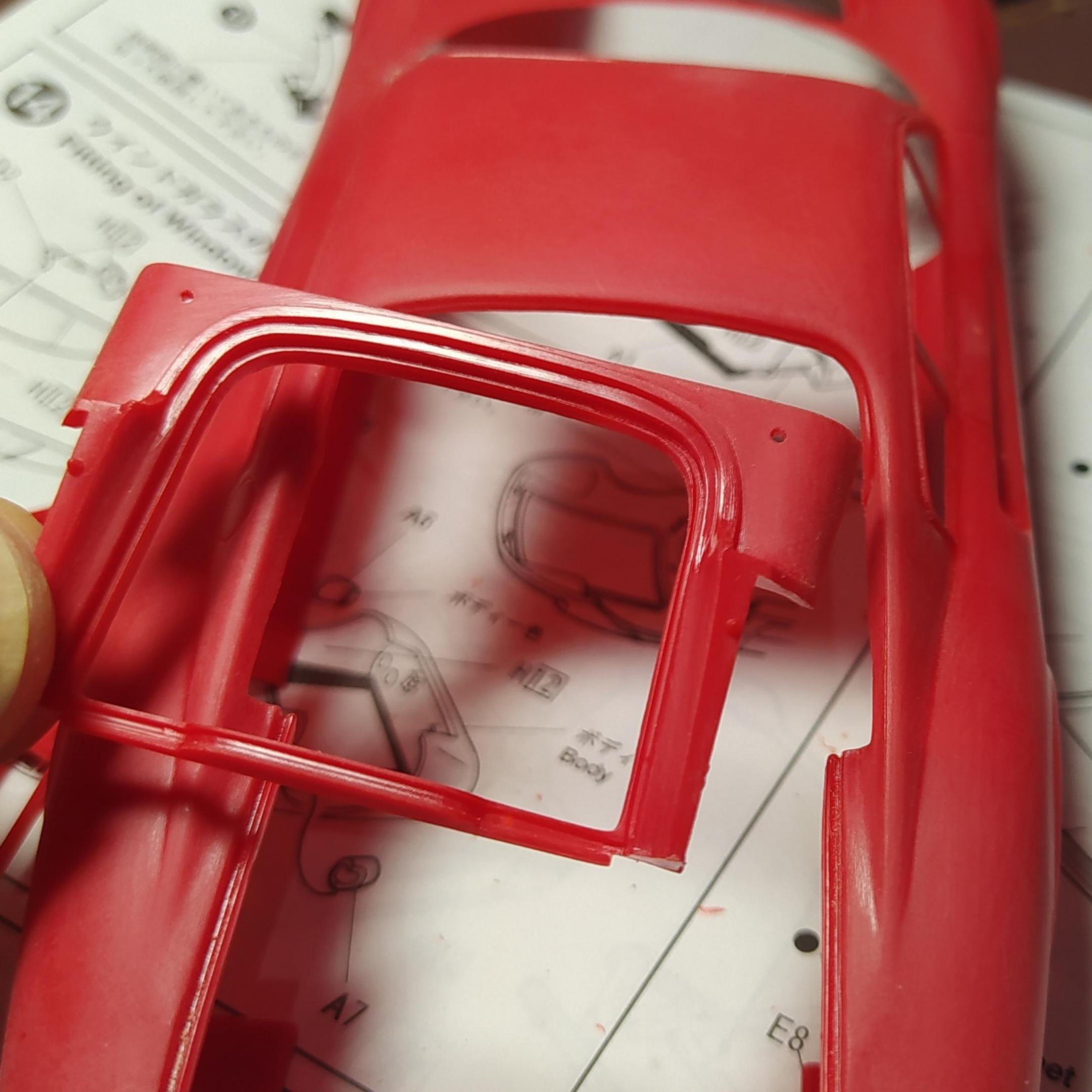

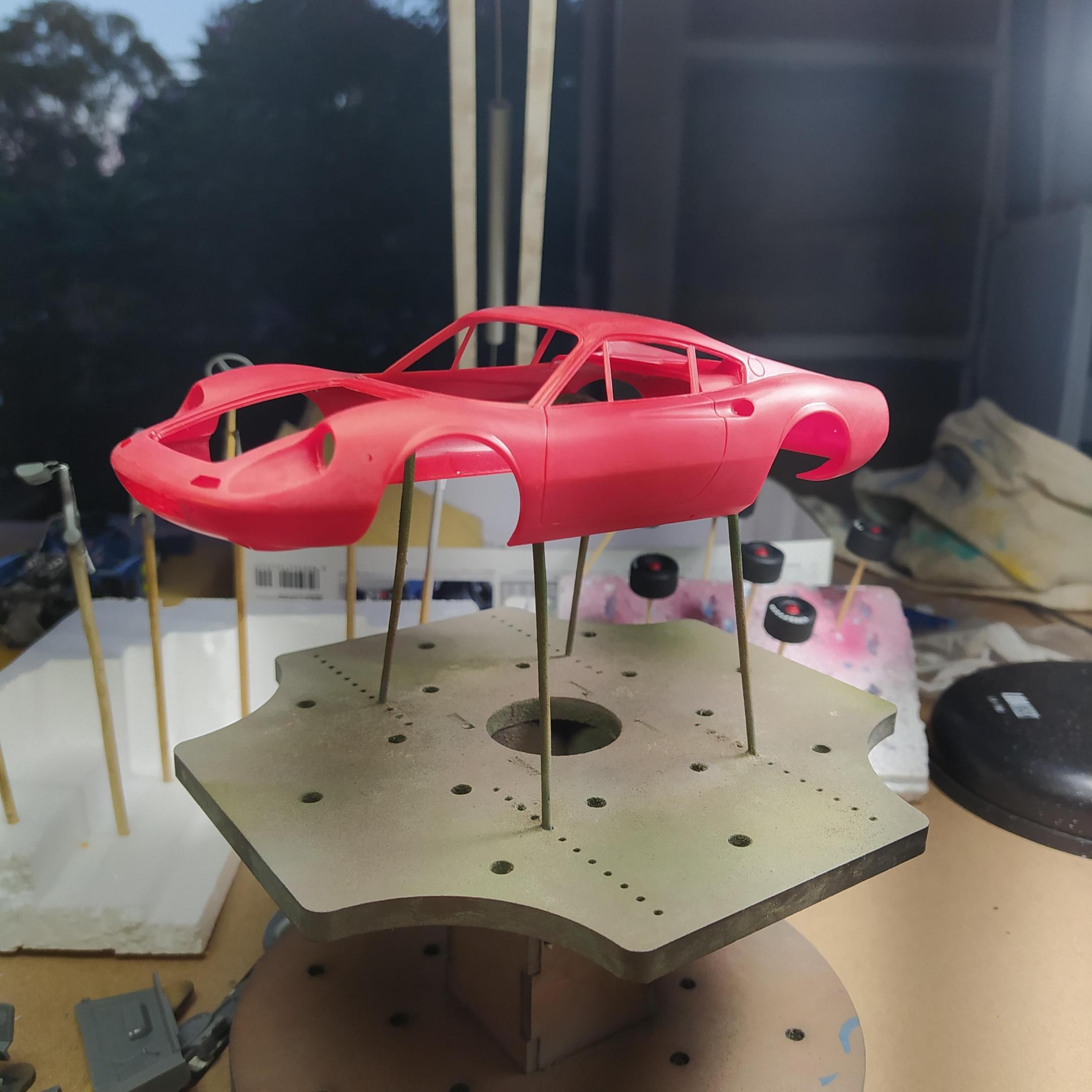

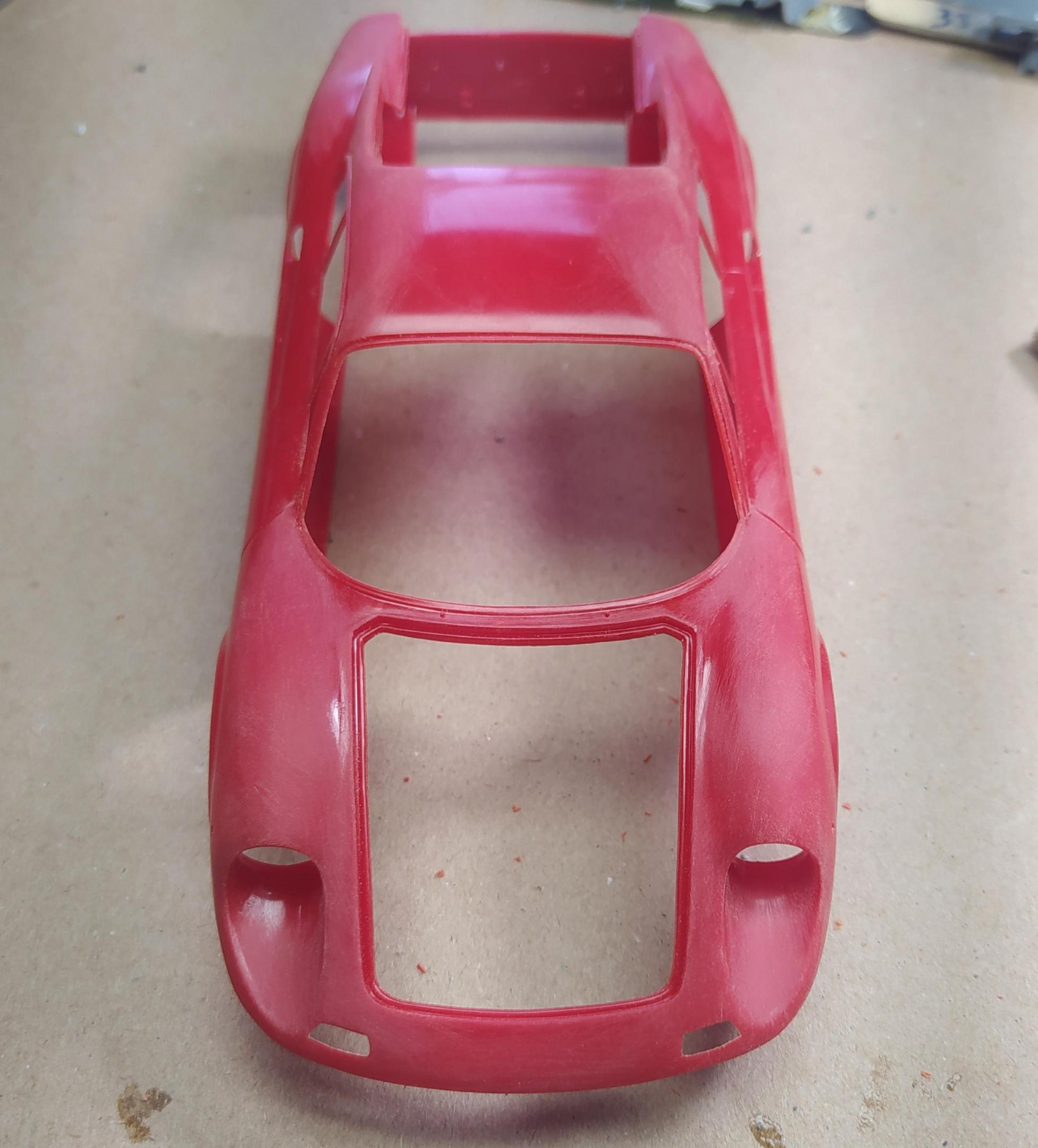

MarcoTJ Posted March 27, 2021 Author Share Posted March 27, 2021 Sanded the mold lines This one was ugly Got it off All the covers fit nicely. The whole body was sanded down to 1000 grit. I find this way best for primer anchoring. Tricky part. Stick it and covered the gap with superglue. Did the same on the front Quote Link to comment Share on other sites More sharing options...
MarcoTJ Posted March 27, 2021 Author Share Posted March 27, 2021 Sanded down the superglue. Looks good. Washed the kit to remove the dust and residues. Ready for priming! Quote Link to comment Share on other sites More sharing options...
Bainford Posted March 28, 2021 Share Posted March 28, 2021 Nice work. Just got to love the shape of that body. Quote Link to comment Share on other sites More sharing options...

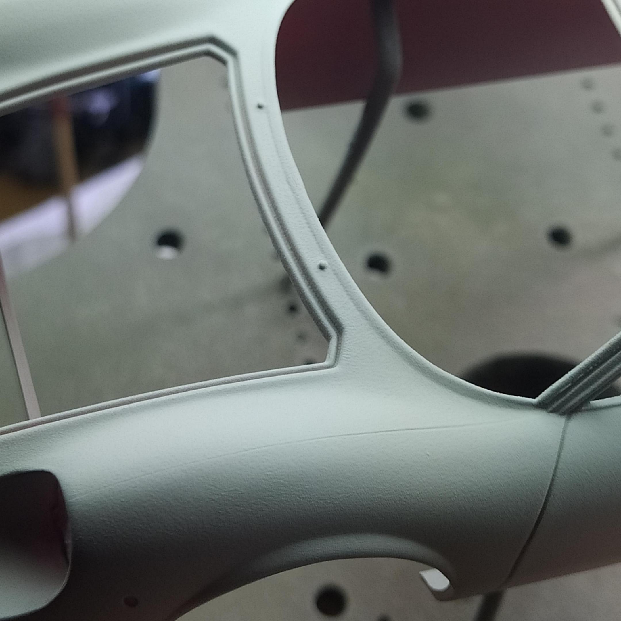

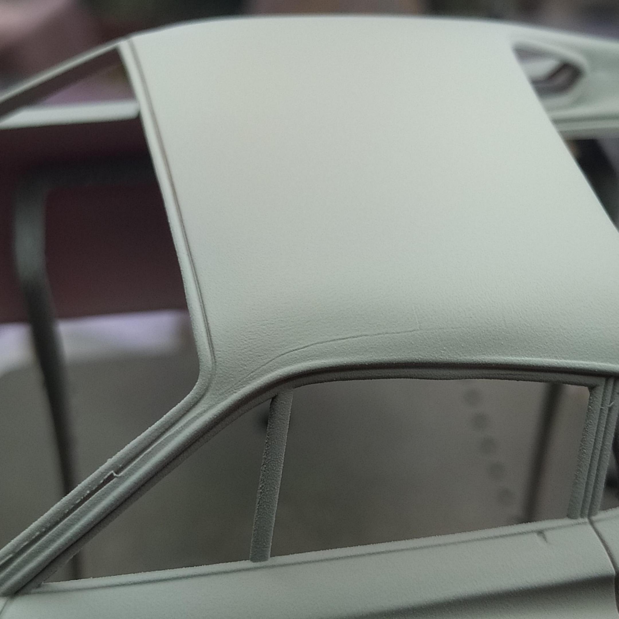

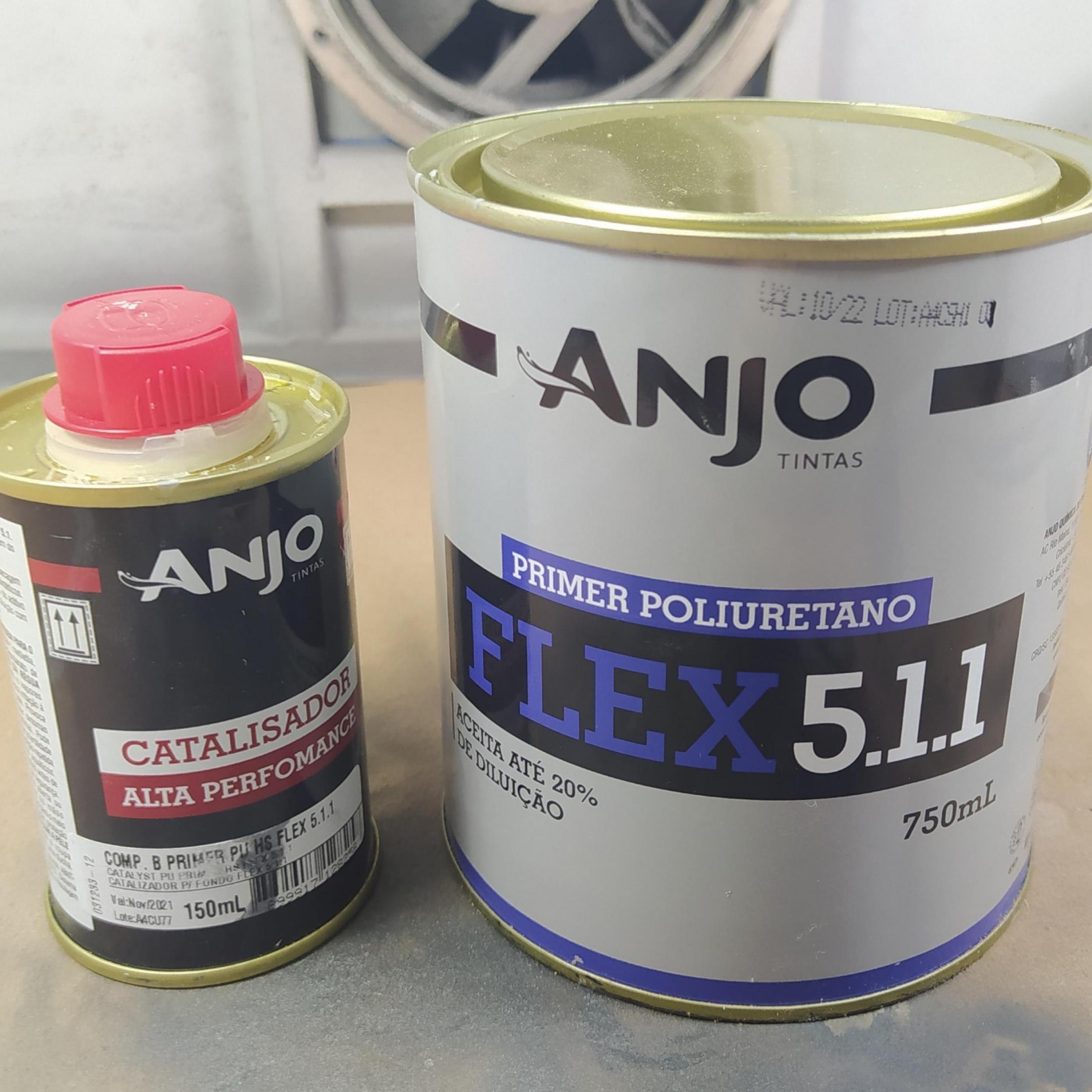

MarcoTJ Posted March 28, 2021 Author Share Posted March 28, 2021 2k primer time. I love the way this primer goes on. Still some sanding to do. Stubborn mold lines. Primer reveals everything. But that's OK. Better see these lines now than after the paint.😁 Quote Link to comment Share on other sites More sharing options...
Dann Tier Posted March 28, 2021 Share Posted March 28, 2021 Looks like a nice filler primer... Quote Link to comment Share on other sites More sharing options...
MarcoTJ Posted March 31, 2021 Author Share Posted March 31, 2021 On 3/28/2021 at 5:37 PM, Dann Tier said: Looks like a nice filler primer... Works really well Quote Link to comment Share on other sites More sharing options...
