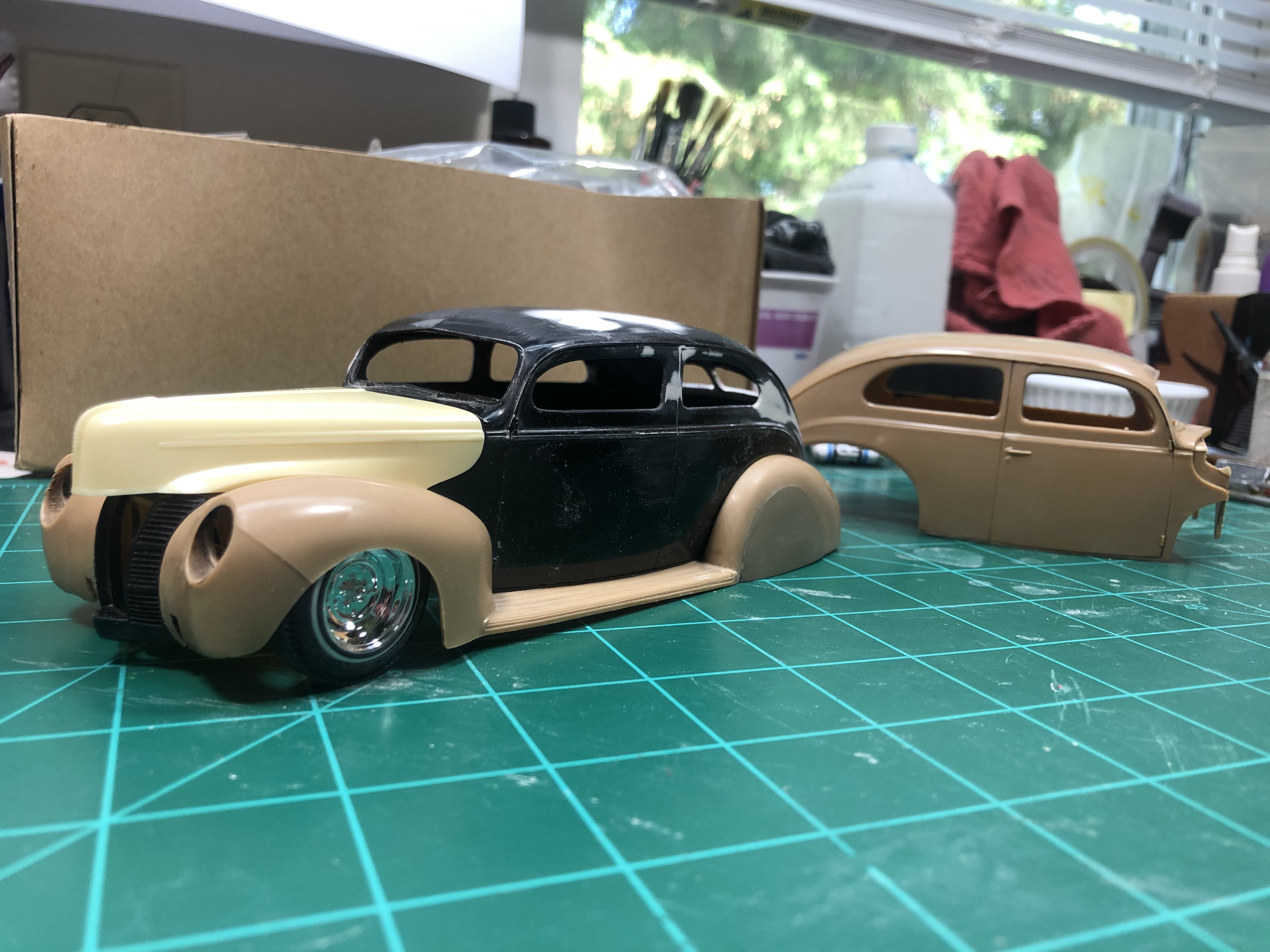

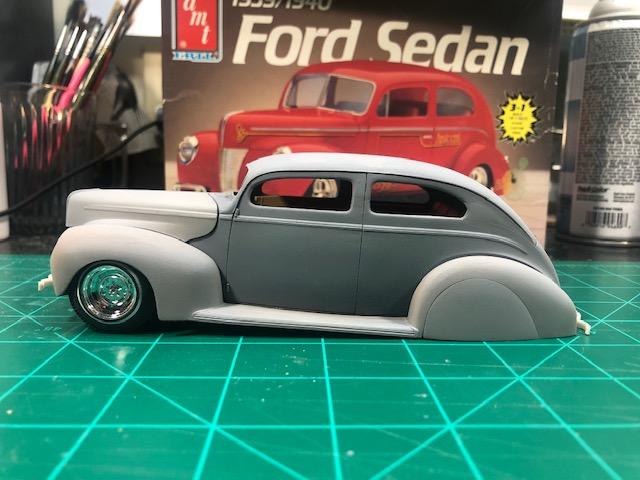

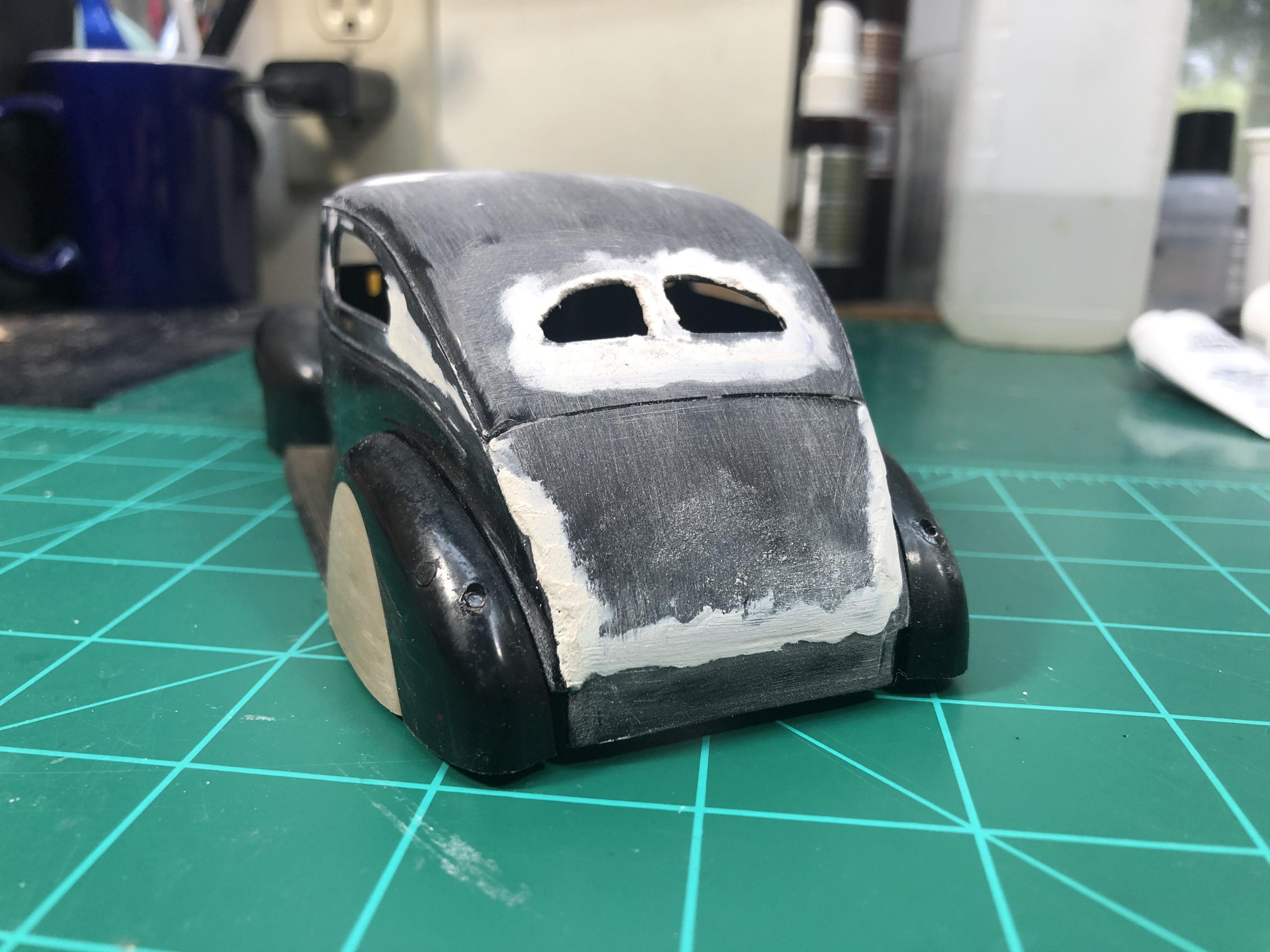

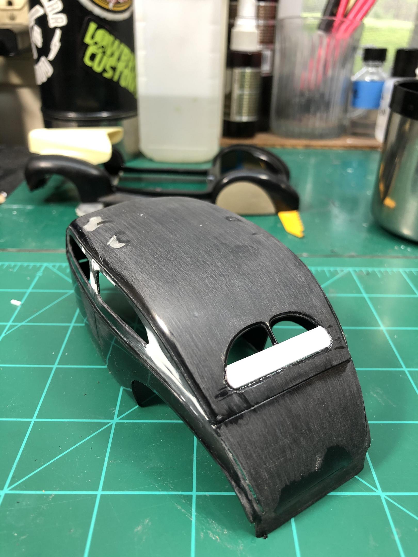

On the bench, 40 Ford Sedan glue bomb special, donated by Al's Junk Yard. About a 3 1/2" scale chop, flush fender skirts and a lot of body repair. Let's see where this leads...

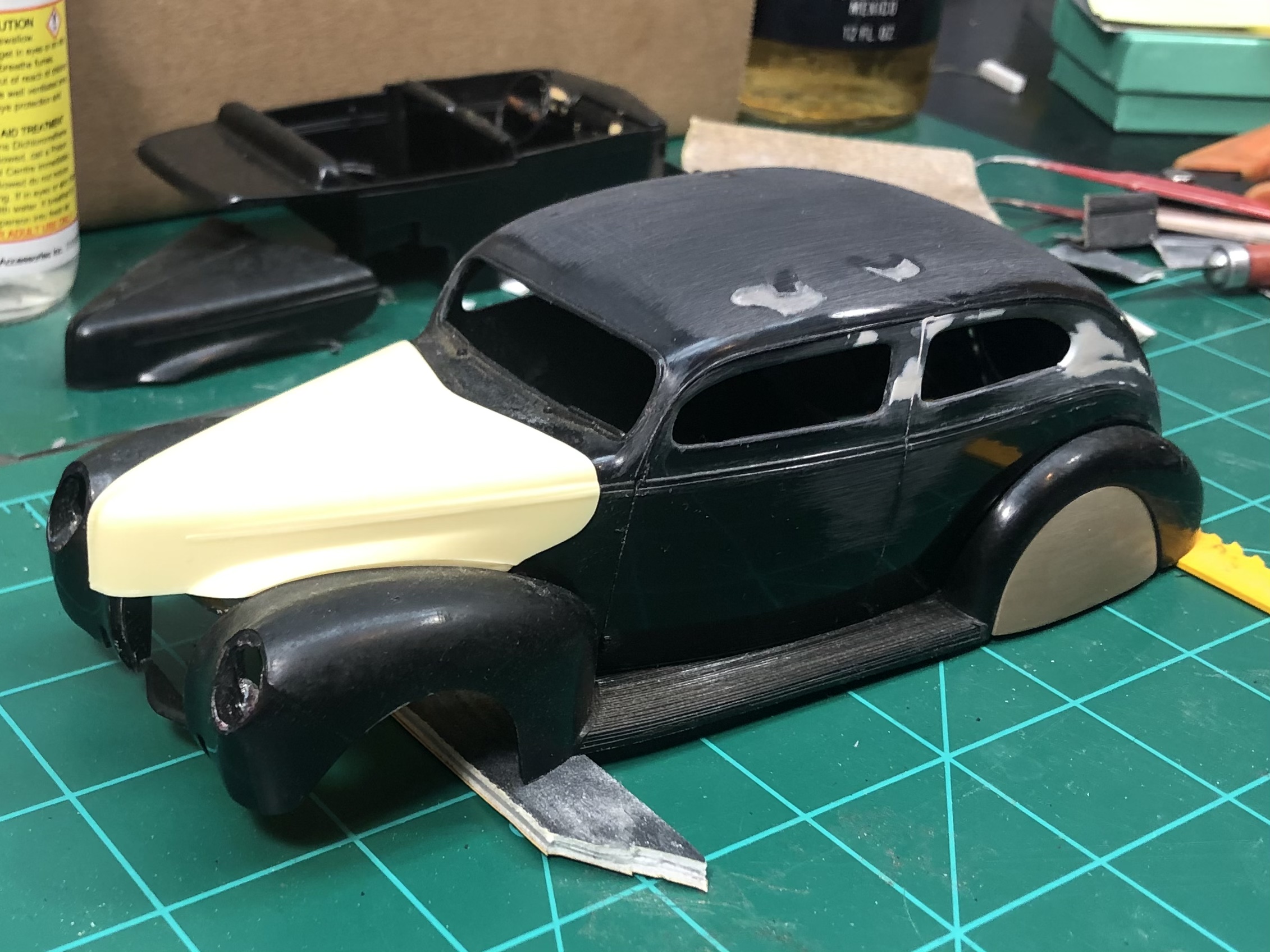

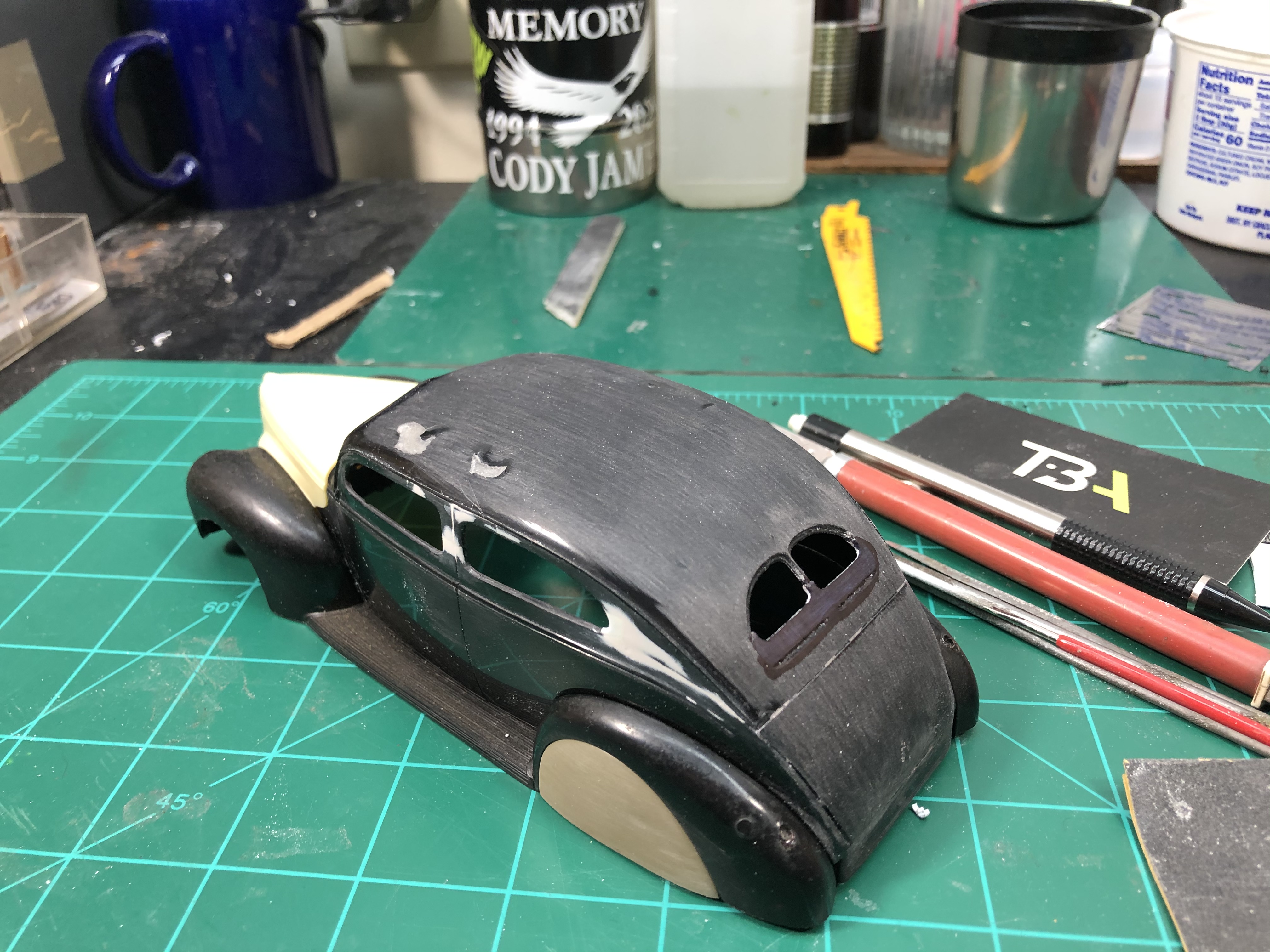

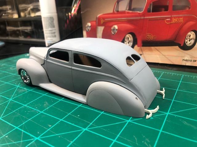

Very clever chop! I see what you mean about the rear window. It kinda looks like it needs to be raised as well as some height taken out of it. Did you cut the top edge of the trunk down to lower the rear of the roof? I chopped one of these a couple of years ago and thought about cutting it there. But, I decided to cut the window down instead.
Link to comment

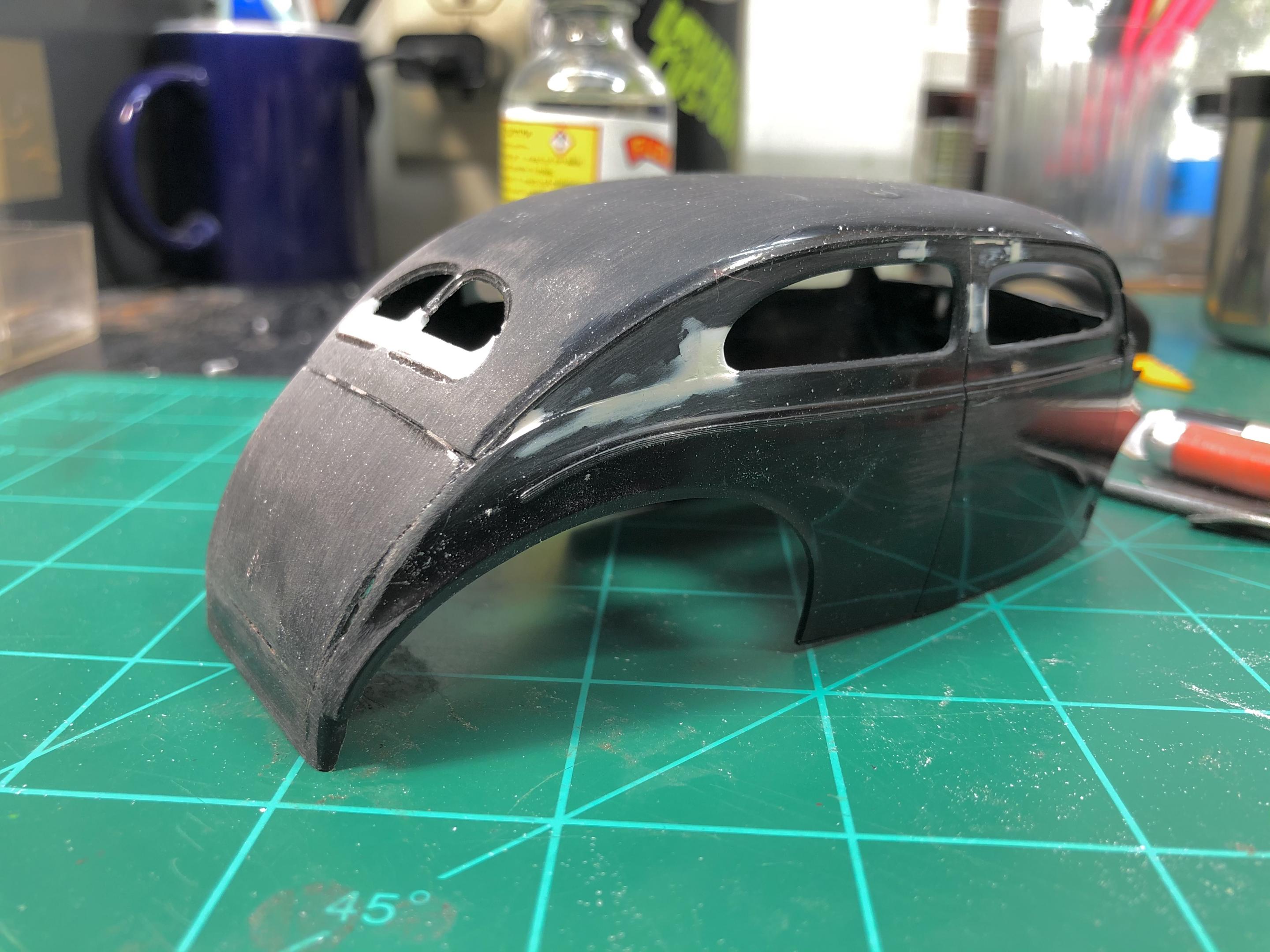

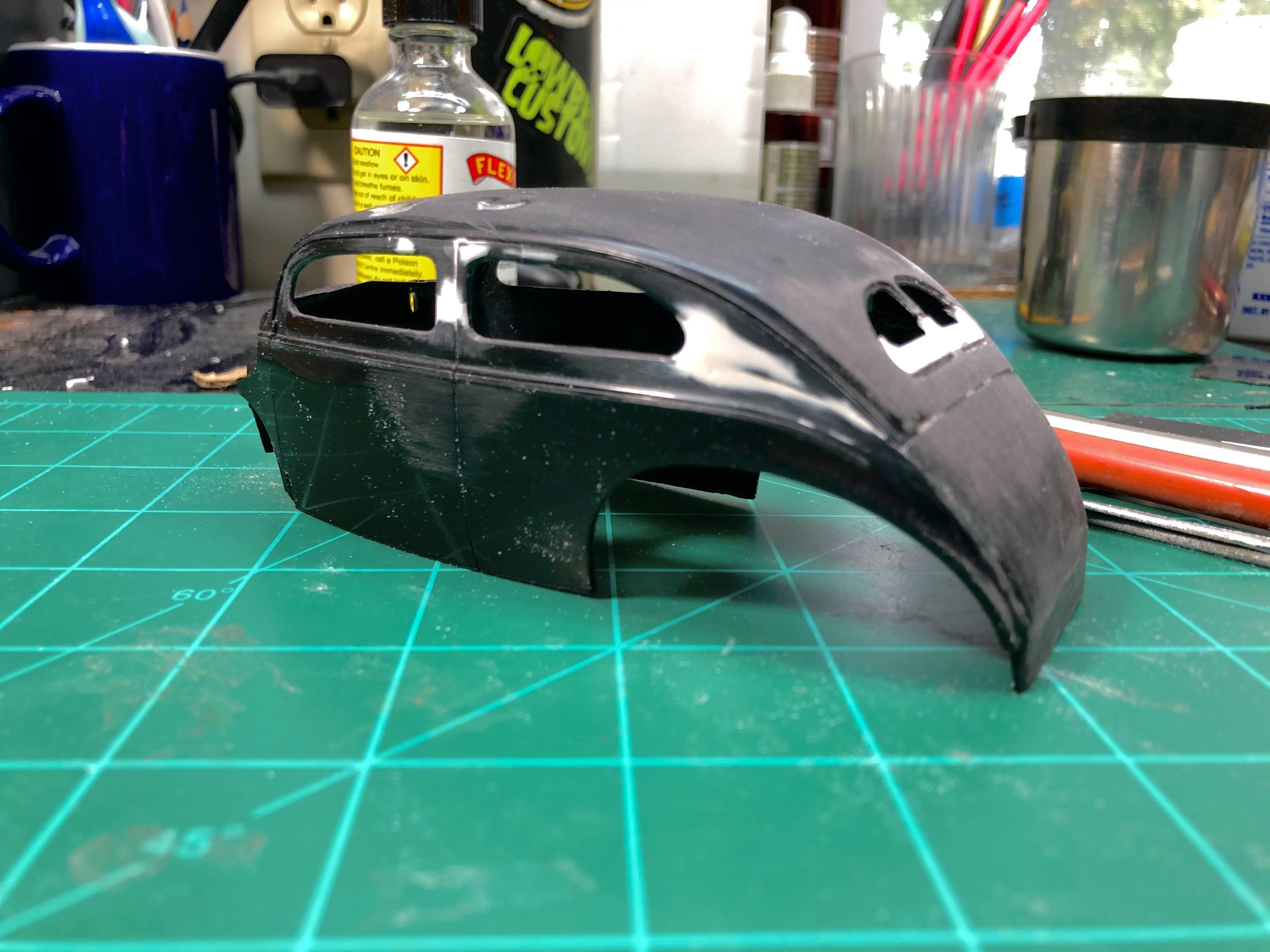

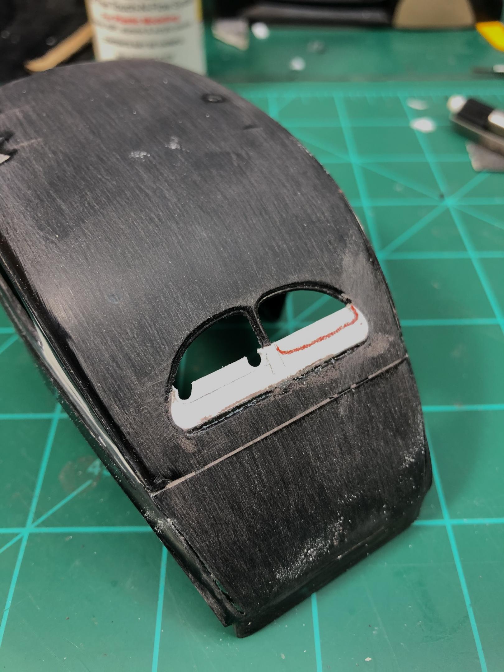

I thought about that and then the new seam would have had two widths to blend. Since the curved cuts follow the sides of the trunk lid, I waited until I was happy with the fit. And then cut the bottom of the trunk lid and narrowed the sides to fit.  Also I scored the top back side of the lid and bent it some. I think I hurt my brain thinking about this chop, before ever making a cut!
Thanks...
What's a little strain on the brain? It worked great! I like how you were able to keep from having to lengthen the roof. This is definitely not an easy chop!
Link to comment
Nice chop! I applaud your effort on the rear window, looks good!  But I have seen several 1:1 Tudors and Coupes chopped like yours where they laid the roof forward and the rear window was left stock height.

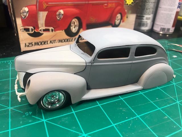

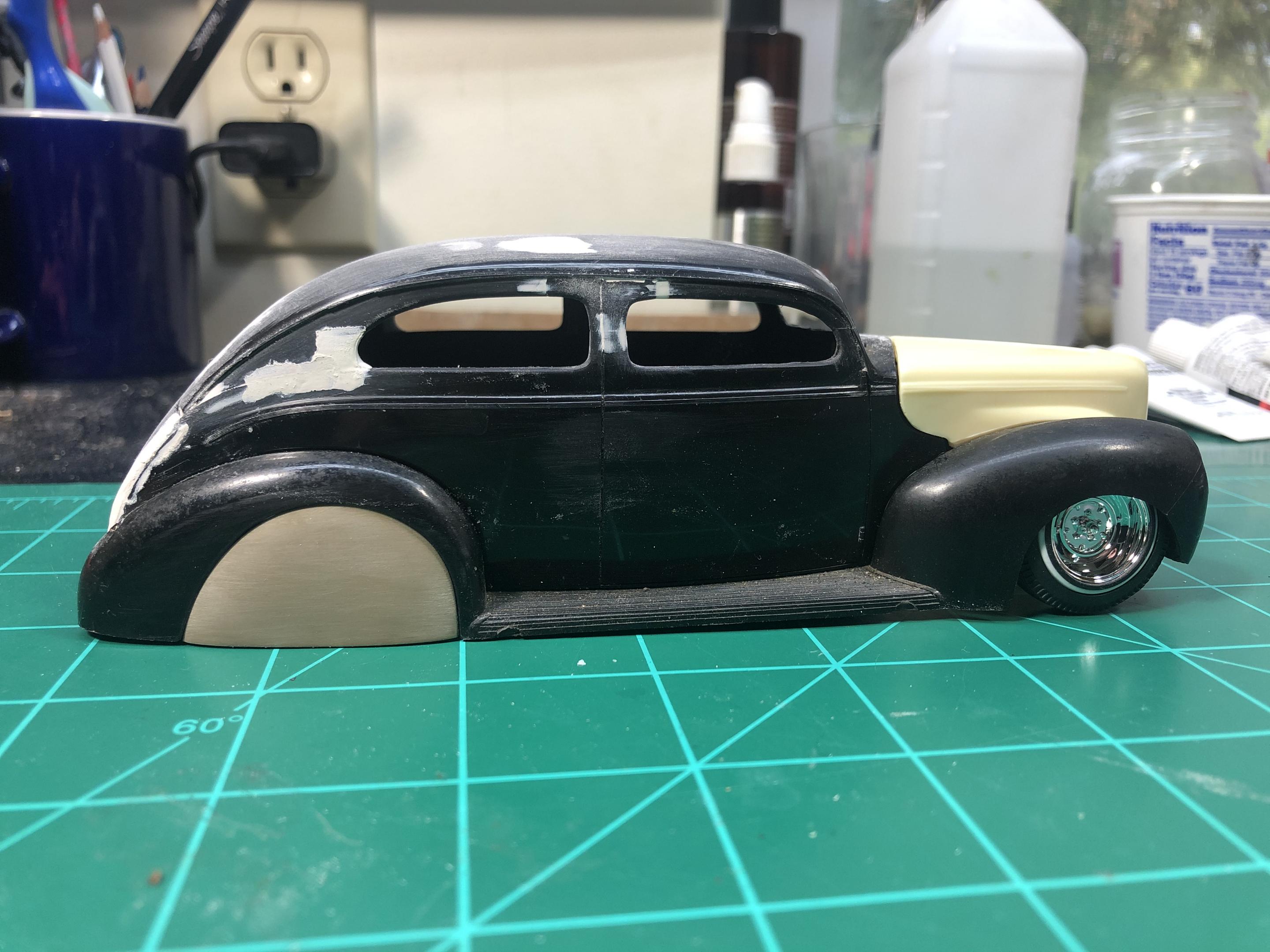

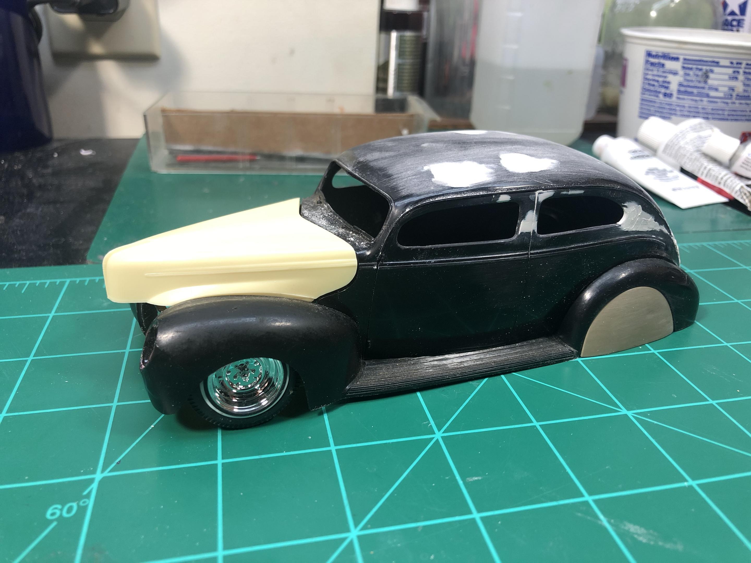

Fitment!
Cleaning things up little by little. The other fender assembly was cracked so I started another. Flush skirts are glued in place and I’m scribing in the connection  point for definition. I’m somewhat surprised at pulling off this chop.
