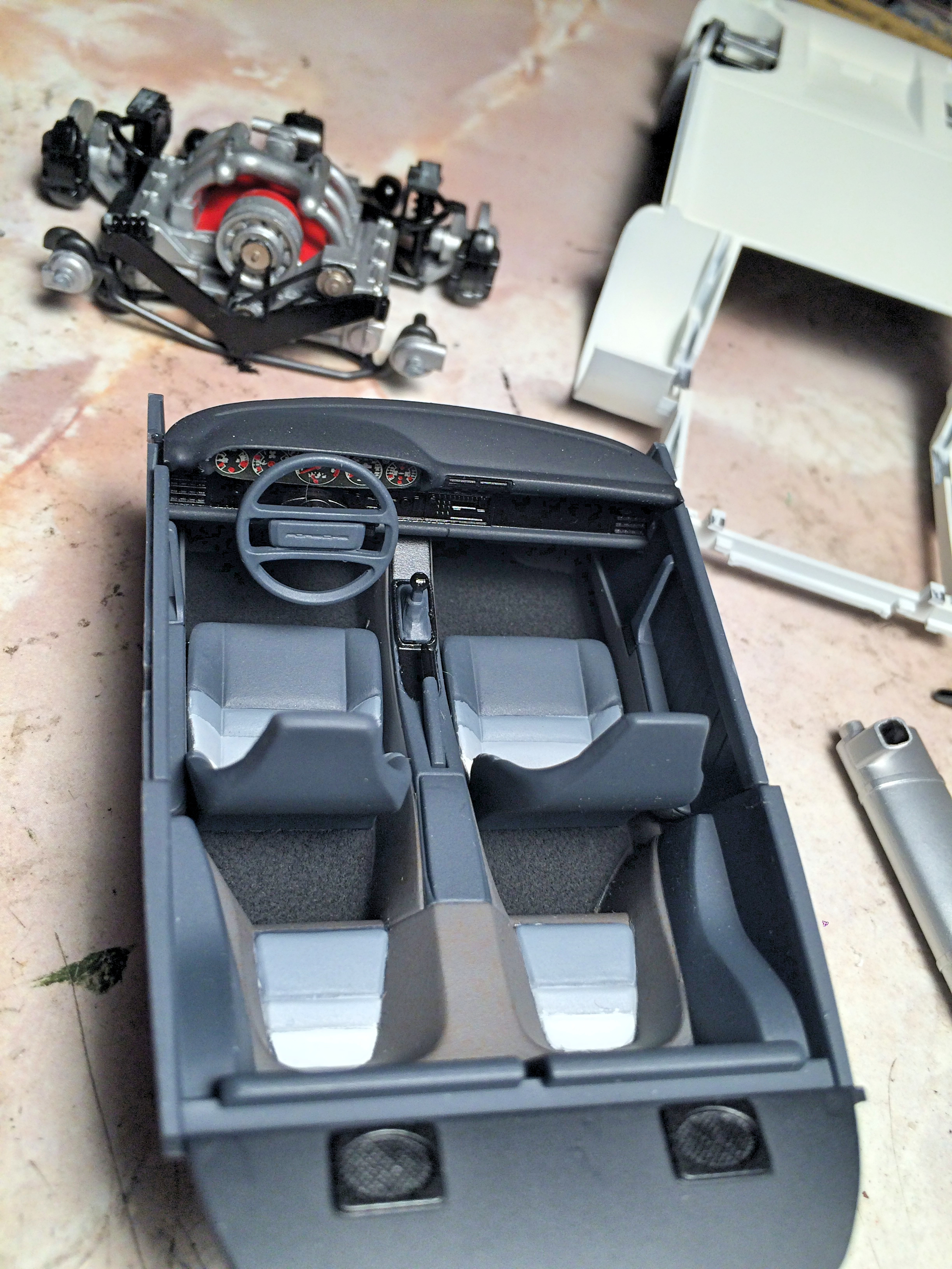

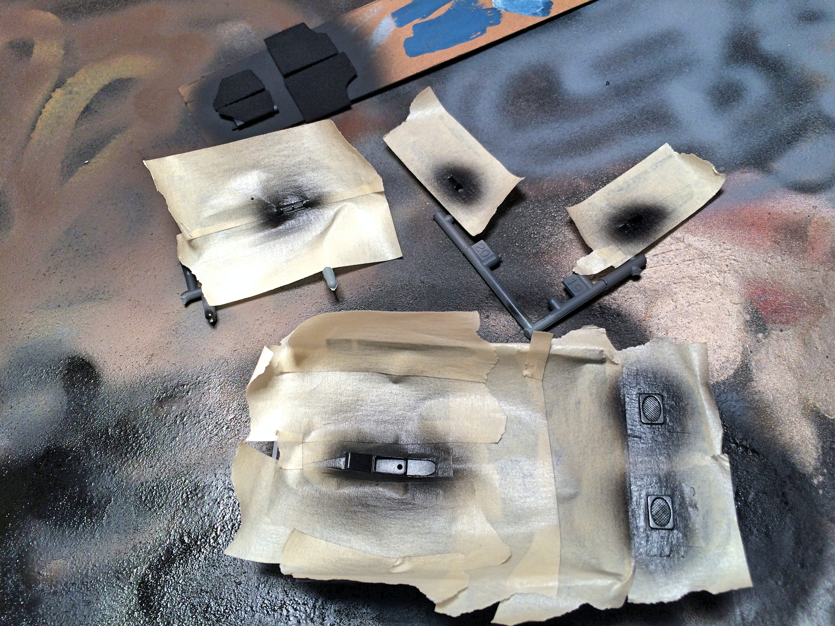

Masking tape, the old-fashioned type (not the purple for house painting, I hate that) is my most used, sometimes use Scotch tape.  Use a new #11 blade to cut.  This Porsche 959 required 7 colors (if I recall correctly), hate brush painting so even the speakers got masked and painted.
