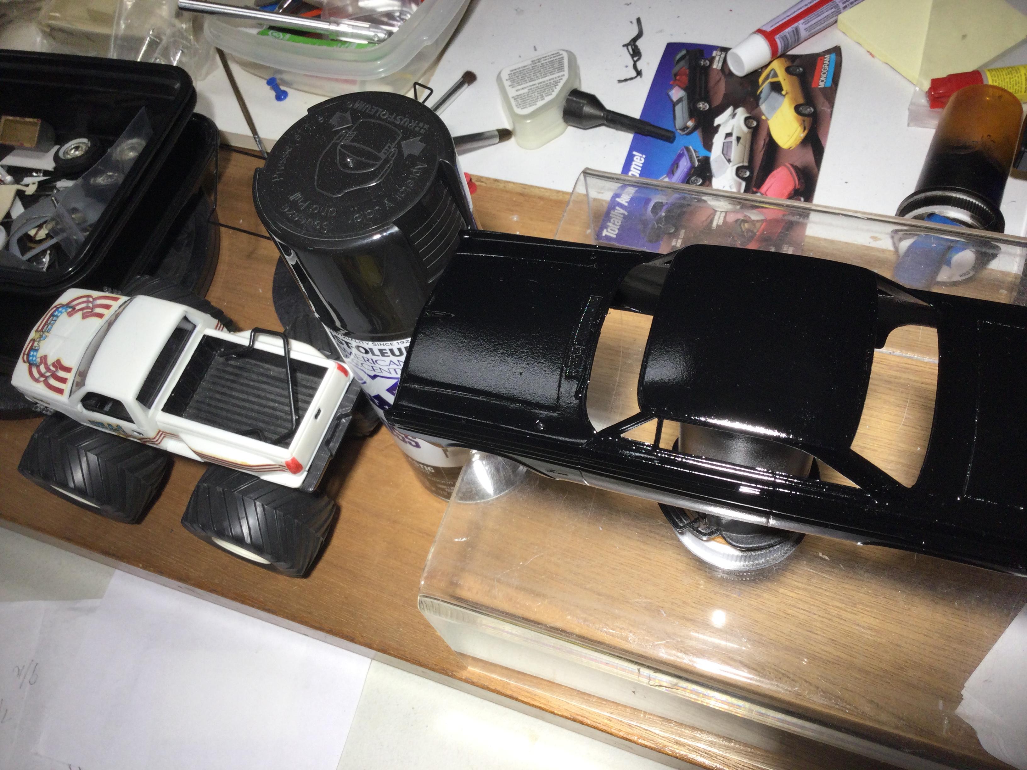

image1.thumb.jpeg.534a5888d5d2ba199b22218e2a53b2cf.jpegOK. After weeks of the Comet and the Nova soaking in the Purple Pond. I primed them and then sprayed the Duplicolor Black paint. Looked good. Then I sprayed the Duplicolor Clear Coat and they look like BLAH_BLAH_BLAH_BLAH. But I will build them and coat them in Pledge Revive which I always used. Done with clear coating. image2.thumb.jpeg.08874804ebe6c9aa6996d150220b6b79.jpeg

It's a shame you're having problems with the Duplicolor on the Comet David.  That would make a nice model in black. How 'bout wet sanding out the body then another clear like my go to Rustoleum Auto Clear Acrylic Lacquer.  I very recently did that on a Chevelle build i'm in the process of and it came out just fine. In fact, I didn't even reclear it, just compounded and polished it out.Wasn't Duplicolor but it's worth a try.

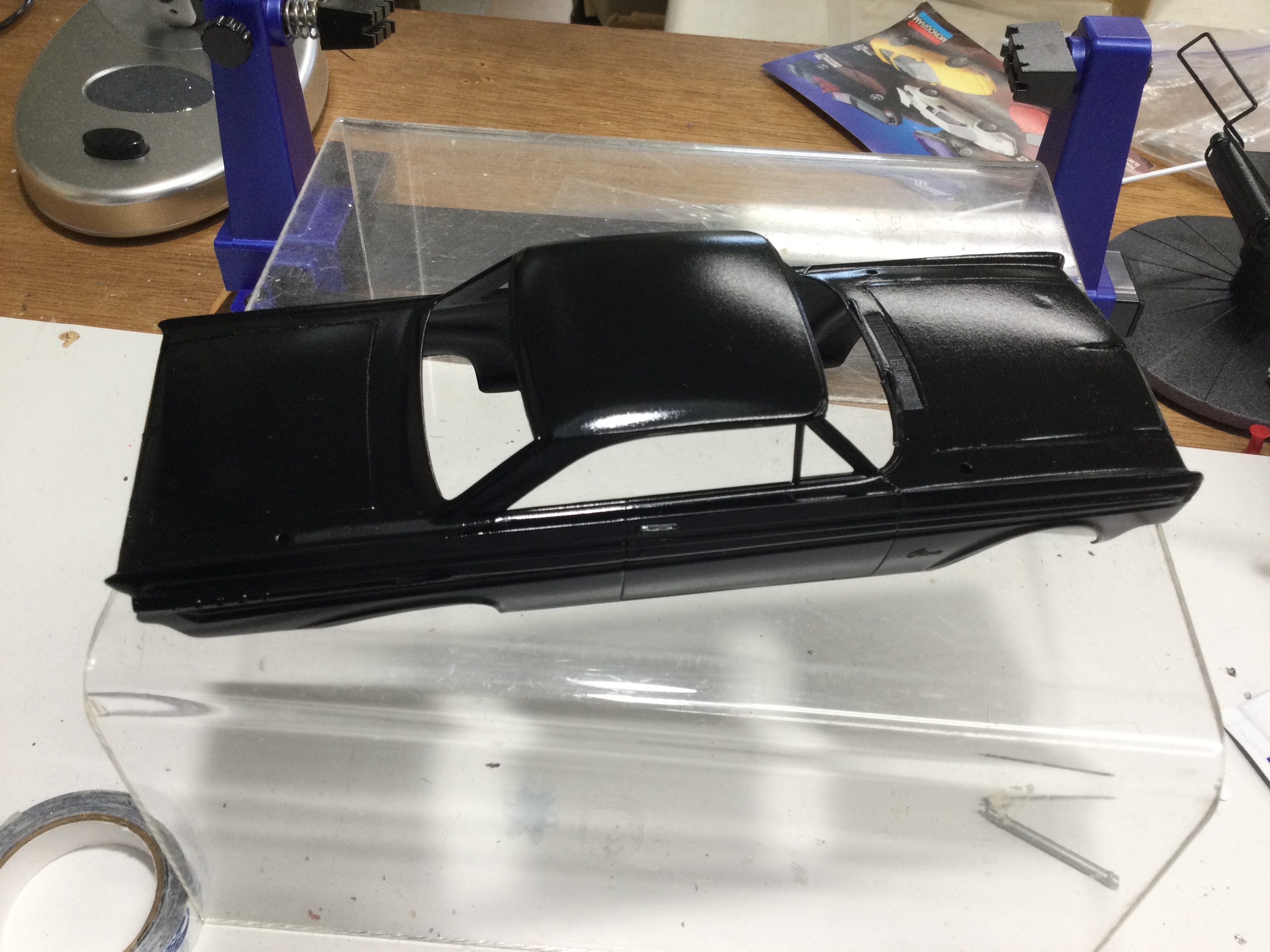

After more than a month the black paint is off the Comet and the Nova. I'm wondering about my paint issues. I used Duplicolor primer and Duplicolor black paint. The black paint came off in sheets sort of. . Sign that the black must be lacquer. But is the Duplicator primer I am using meant for lacquer paint? When the paint peeled off then the primer started to just wash away?

It's seeming that clear coating is becomming an issue with several on here.  I have only used two clear coatings in my last 5-6 years of modelling cars and those in only the last maybe 2 years.

The problem is often that too many people have the impression that one coat of primer, one coat of paint and one coat of clear is all that's needed to get a beautiful paint job.
That might work with some paints, but in my experience, Duplicolor paint requires a little more attention.
First of all, the primer is a little hotter than many others, so light coats that get progressively heavier will work the best.
You will also want to remember that more coats of primer are better than fewer because with the hot automotive lacquer to follow, you will want as much protection from crazing as possible.
When putting on the color, several lighter coats are always better than 1 heavy one as well.
One heavy coat is much more likely to eat through the primer to the plastic and craze it than several light coats, plus, building the color will add more richness to the color itself, not to mention, avoid some weird striations in the metallic particles with metallic paints.
With Duplicolor clear, you will get much better results if you use several coats, followed by cutting and polishing.
Each successive coat of clear will give you a bit more shine than achieved with just the previous coat.
I use as many as 5 coats of clear, and then it still needs polishing to give a deep, rich shine.
Too often, I feel like people are in too much of a hurry to spend the time required to get an exceptional paint job.
Sometimes you have to put in the work if you want it to look like you "put in the work".
Another thing to remember with Duplicolor lacquers is that like most automotive lacquers, they are designed as "base coat/clear coat" paints.
In other words, they require clear for a gloss finish.
You can polish a solid color without clear, but I wouldn't try it with a metallic.
You are just as likely to end up with an irreparable mess than not.
Steve

5 hours ago, ewetwo said:
After more than a month the black paint is off the Comet and the Nova. I'm wondering about my paint issues. I used Duplicolor primer and Duplicolor black paint. The black paint came off in sheets sort of. . Sign that the black must be lacquer. But is the Duplicator primer I am using meant for lacquer paint? When the paint peeled off then the primer started to just wash away.
Nothing wrong with the paint or primer in this instance.
That's exactly how it should react to Super Clean.
The lacquer paint itself will be entirely unaffected by the stripper.
Super Clean will only work in this circumstance by seeping it's way under the color and dissolving the primer.
This causes the paint to come off in sheets, and the primer to just wash off.
Perfectly natural and normal, and as a matter of fact, very desirable!
If you have to strip a lacquer paint job and you have used a primer that is unaffected by the solution, you're SOL with most of these products used for removing paint.
Steve
Link to comment
By the way, just from looking at your above pictures David, it appears to me that if these photos were taken after clear coat, you were exactly on the right track.
It appears that the surface is fairly smooth, and with a few more light coats of clear and a little polishing you would have been exactly where you wanted to be.
Steve

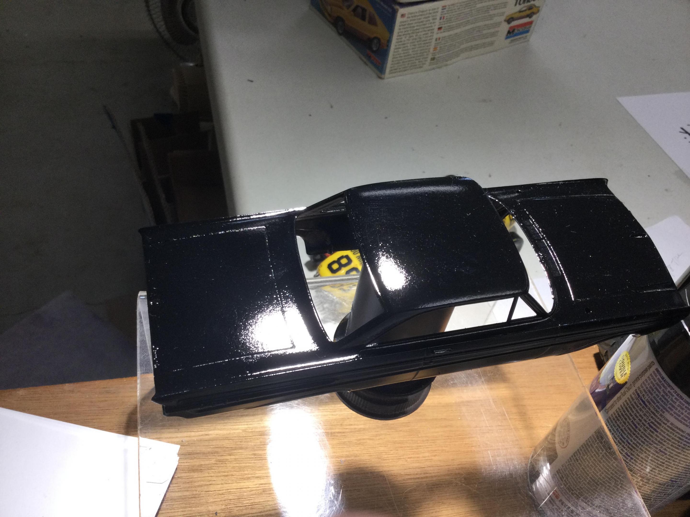

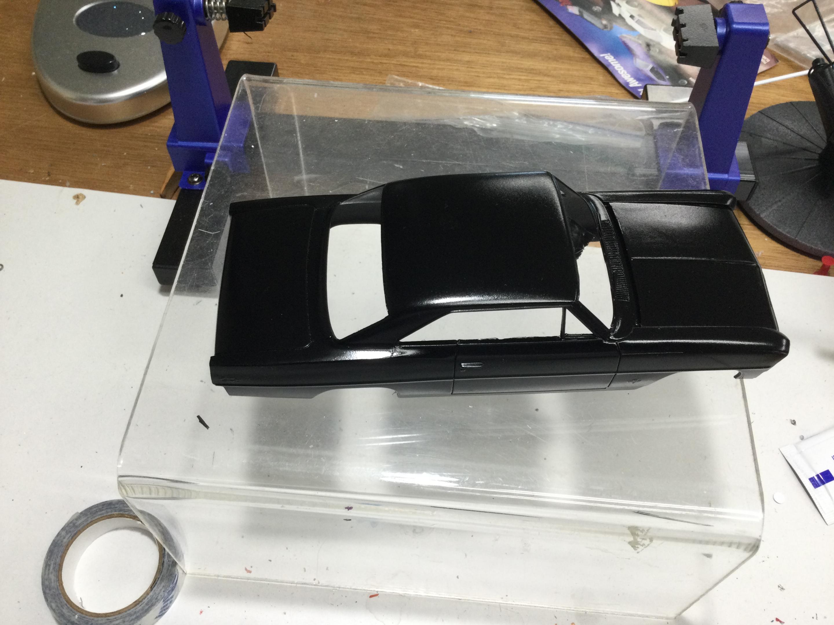

5th attempt. 3 light coats or primer. 3 light coats of Duplicolor black paint. 2 light coats of Duplicolor clear cost. Why does it keep coming out looking so horrible? I can't figure out what it isn't smooth. I might have to resort to Rustoleum 2X gloss black.

Looks like you're fairly close on this one. As Mr Guthmiller suggested, maybe a few more light coats of clear, let it cure out a few days, and then go at it with a polishing system. I wouldn't toss it in the stripper until I tried to polish it out, first.

From the look of it, you could be going too light with the clear.
You’re getting more orange peel than what should be normally associated with Duplicolor clear.
I am going to tell you that you are not likely to get a super high gloss with Duplicolor clear, but if you’re spraying it light, you’re just piling orange peel upon orange peel.
Your clear coats should be sprayed pretty heavily so that it can level.
lacquer clear dries so quickly that if you spray it lightly, it will have a grainy look, and if subsequent coats are sprayed in the same way, it will not level, it will just add more graininess.
You probably need to go a lot heavier with the clear coats, and don’t worry too much about it getting too thick.
I usually spray around 5 pretty heavy coats of Duplicolor clear on my projects, and the product shrinks down to such a thin layer, that even with that many coats, it still doesn’t hide any detail.
Warm you clear coat can, spray it wet and you will likely be much happier with the smoothness of the finish.
Now, even with that said, you’re not going to get the type of high gloss as you would with something like a 2K clear.
If you want it to have a nice, smooth, shiny and “realistic” looking sheen, you are very likely going to have to polish at the end.
Steve

2 hours ago, ewetwo said:
I didn't see your comments until just now.
Steve. It wasn't orange peel looking. It looked like sandpaper. But the problem is the black paint looks like sandpaper after 3 light coats.
Too late Carl.. It's in the soaker. Future in the future. LOL
You probably need to go heavier with the black too.
The black is lacquer as well, and just like the clear, it will get grainy if sprayed too lightly.
Steve
