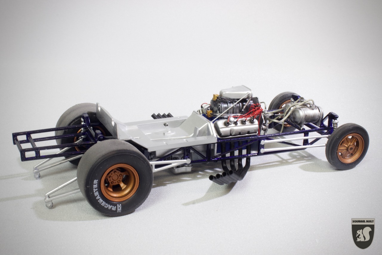

Dan Cooper Posted June 1, 2021 Author Share Posted June 1, 2021 Progress; A bunch of lead wire, some plastic scraps and some vinyl fly tying tubing and the basic wirings done. I have some braided fuel line coming in the post so we'll see what I can make with that. More painting to do, but I think it's okay. Need to buckle up and just finish the body so I won't be waiting ages once the chassis is finished. Thanks for looking in. Dan Quote Link to comment Share on other sites More sharing options...
Dan Cooper Posted June 2, 2021 Author Share Posted June 2, 2021 (edited) I worked hard to finish the motor today. First time using the braided fuel lines, much to learn but I think it looks okay. A pity it will hide under the body but good practice. I tried adding a few more details and I'm calling this one done. Progress; Lots of room to improve on the next one. Thanks for looking in. Dan Edited June 2, 2021 by Dan Cooper Quote Link to comment Share on other sites More sharing options...
dragcarz Posted June 2, 2021 Share Posted June 2, 2021 Nice clean detailing! Quote Link to comment Share on other sites More sharing options...
Tortuga Kustomz Posted June 2, 2021 Share Posted June 2, 2021 Nice and clean job , well done on the fuel lines Quote Link to comment Share on other sites More sharing options...
oldscool Posted June 2, 2021 Share Posted June 2, 2021 Beautiful work. Quote Link to comment Share on other sites More sharing options...
Dan Cooper Posted June 5, 2021 Author Share Posted June 5, 2021 Thank you gentlemen for your kind comments. I'm glad you like my little efforts. One thing I note from looking at other work is that I need to work on keeping everything clean and tidy. I don't know how some of you guys build such super sharp models. For me the dents and paint muck ups seem to pile up one upon another. Progress; I couldn't get the exhaust pipes to stay round so I cut some brass tube and soldered four bits together and grafted them on to the ends. Not perfect but learned enough that I can do it better next time. The plumbing is all in but I'm not super happy with it( I'm sure I could do better next time). Once again learned more about what not to do rather than what to do. I can't imagine using the tiny hose fittings as even without them my nerves are shot to pieces. I had ordered some seat bets but the ones that came were, for me, unworkable so I have some others on order to see if they are better/easier. A few more bits to do on the chassis but it's time to address the elephant in the room and tackle the body work. So far so good and I'm looking to do mid 70's funny car next. Anyone have a suggestion for a good kit to try? Preferably one that you can still get a hold of. Thanks for looking in and your comments and encouragement are most appreciated. Dan Quote Link to comment Share on other sites More sharing options...

Dan Cooper Posted June 8, 2021 Author Share Posted June 8, 2021 22 hours ago, marv13 said: Awesome build, where did you get your barrel valve and fuel lines? Thanks Vi, I'm glad you like my little efforts. As for the barrel valve and throttle linkages. They are all just bits of Evergreen styrene rod, strip and brass wire. I just try and break the part down into the simplest shape and then glue little bits together until I get something that looks close. The Optvisor helps with being able to see close up and doing each part in lots of small steps / subassemblies to let it dry helps. The Fuel lines are 0.15 lead fly tying wire for the injectors( As are the spark plug wires) and little drilled blocks of 2mm square Evergreen strip. The braided line is from Top studio ( 0.6mm) IHTH. Quote Link to comment Share on other sites More sharing options...
