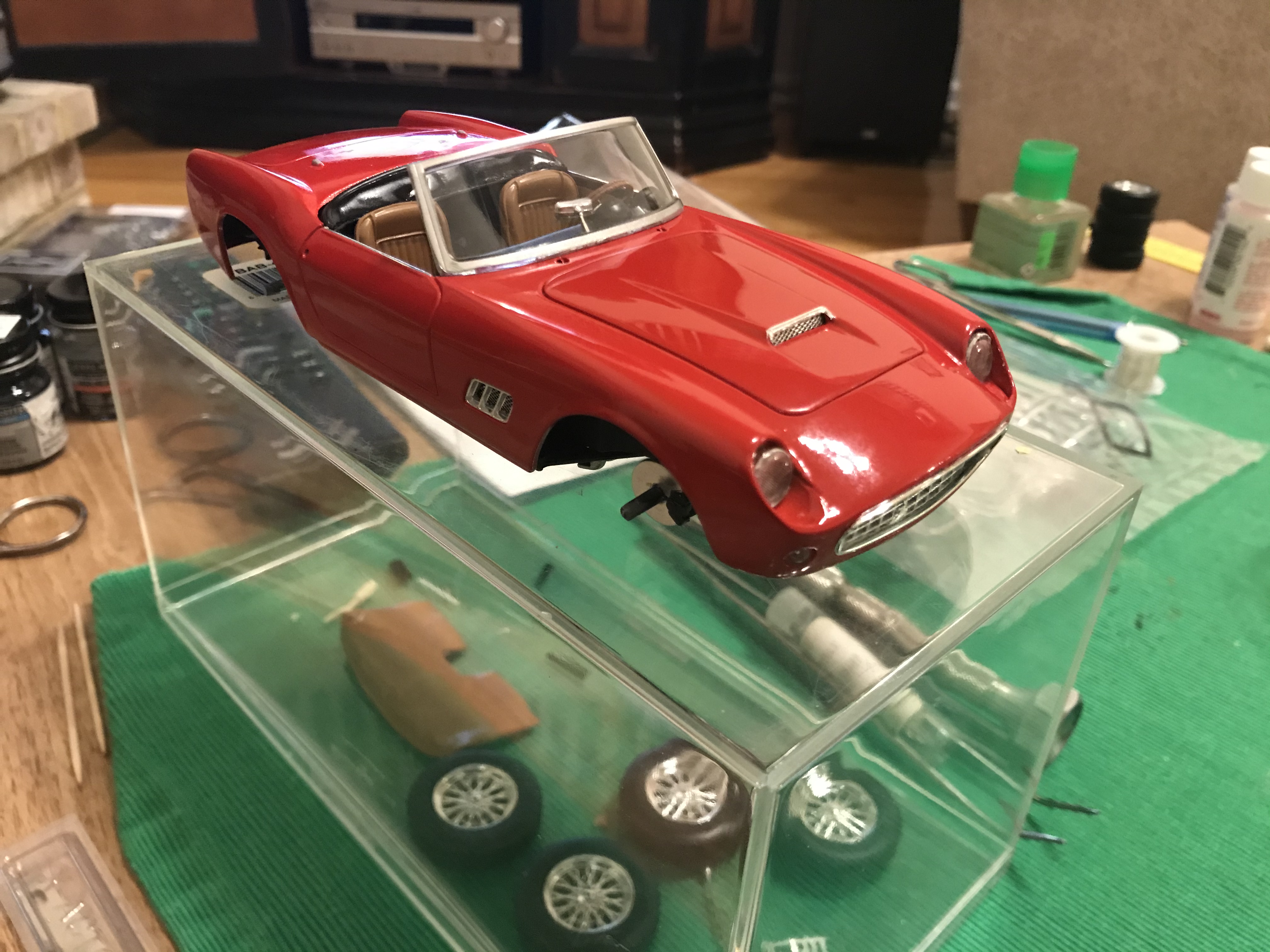

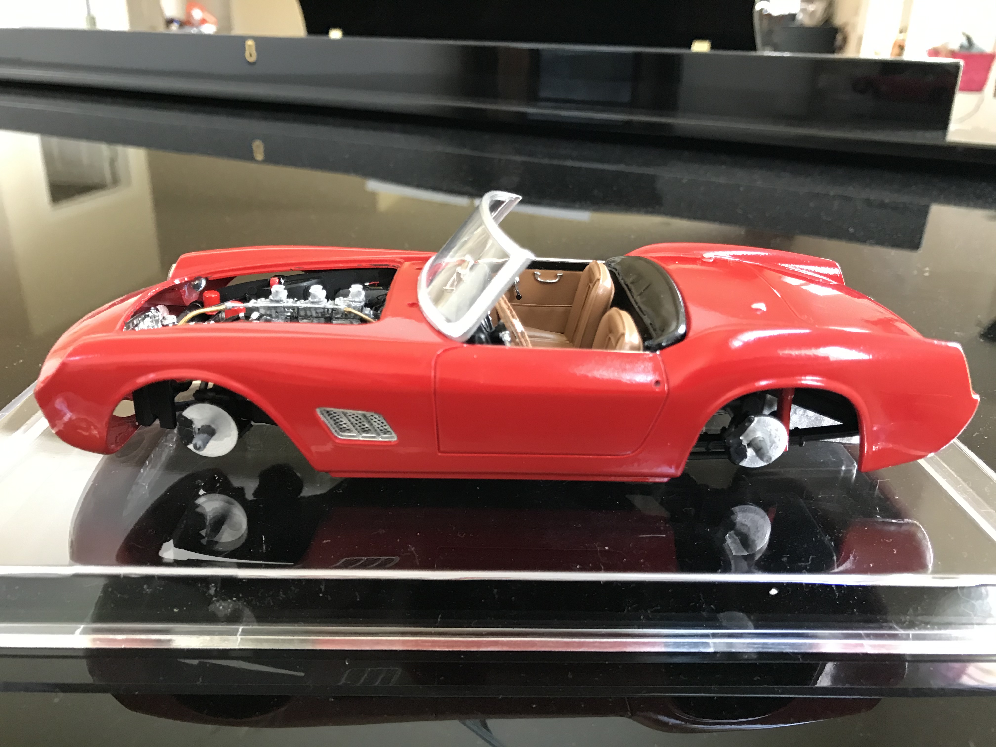

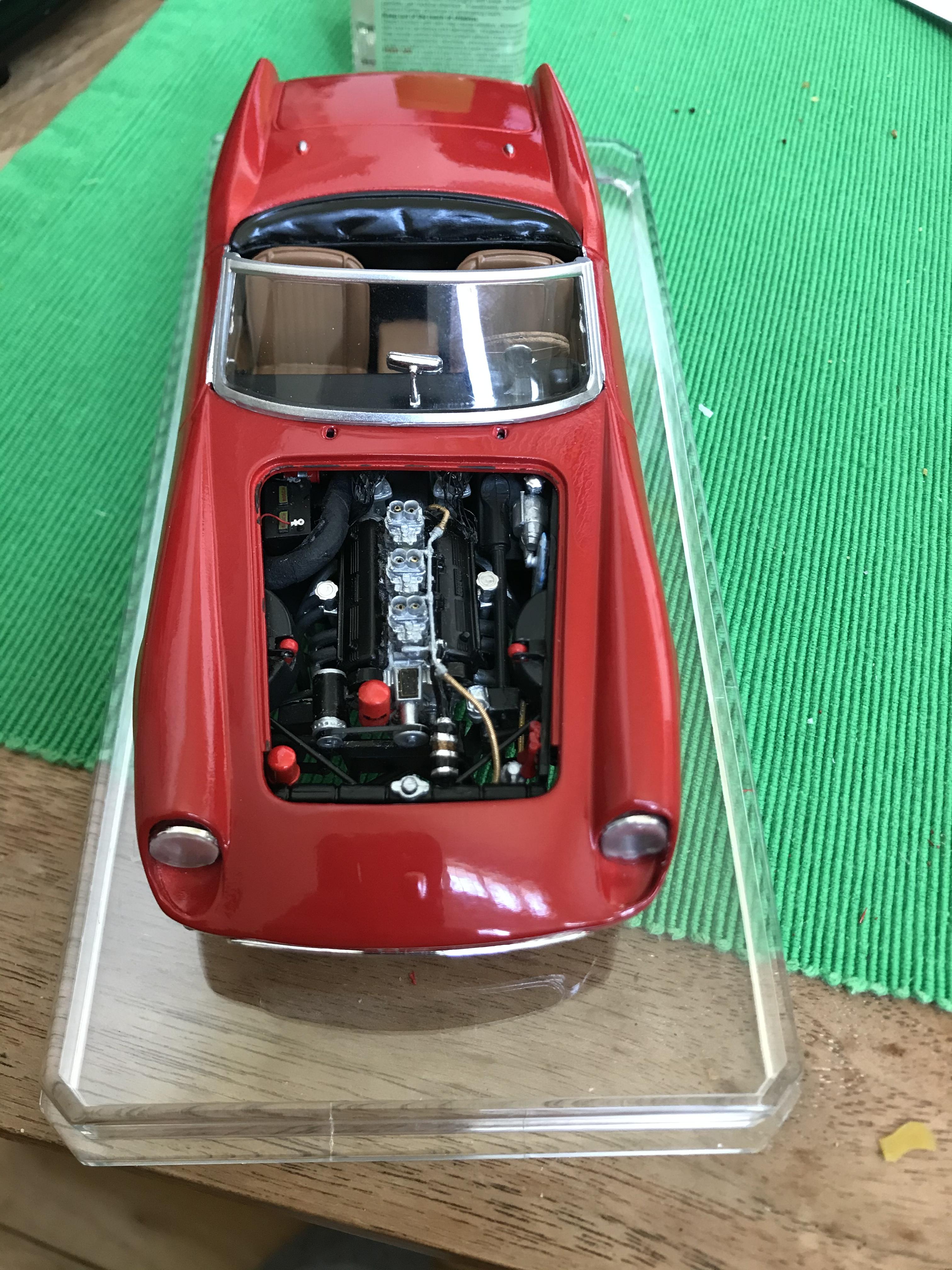

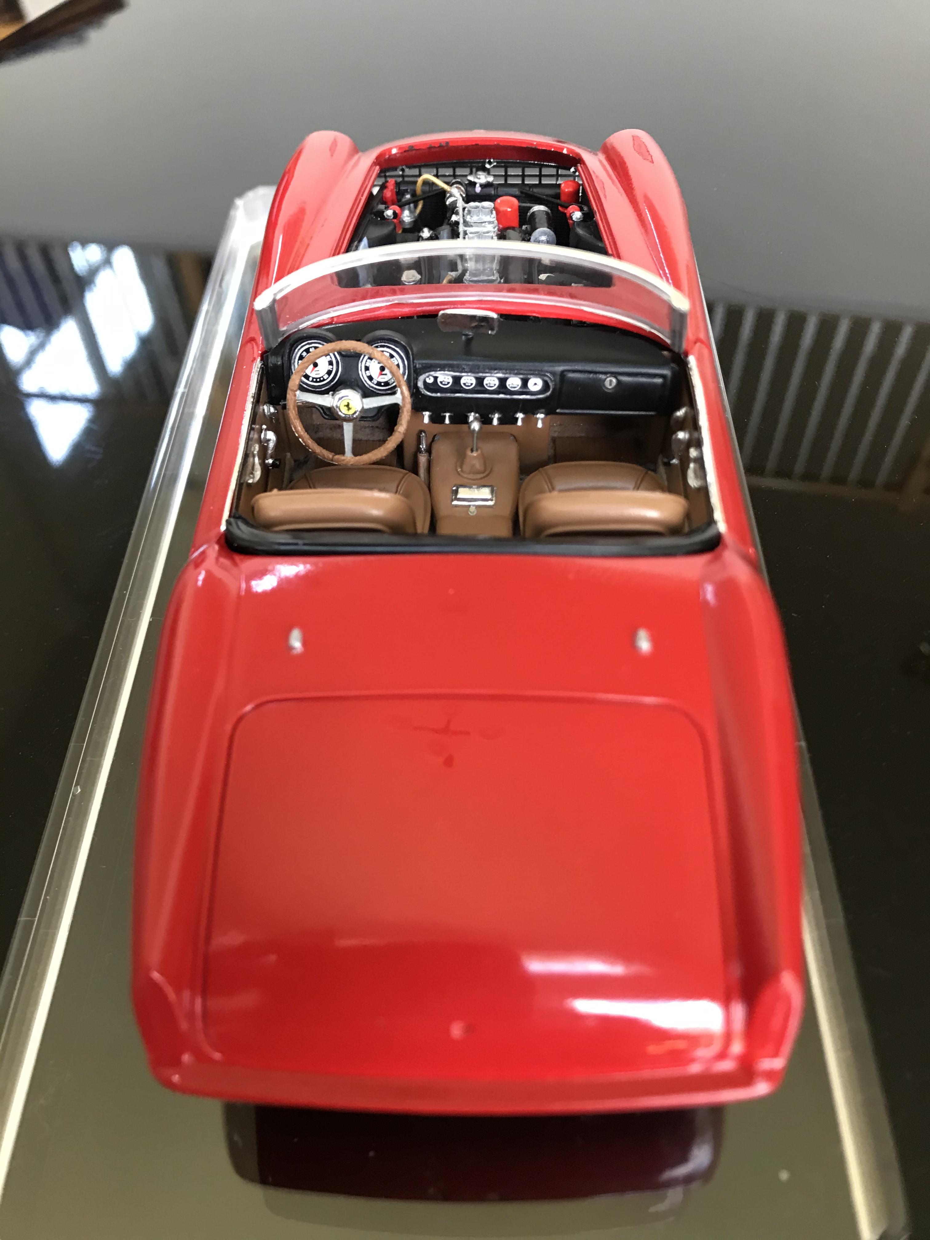

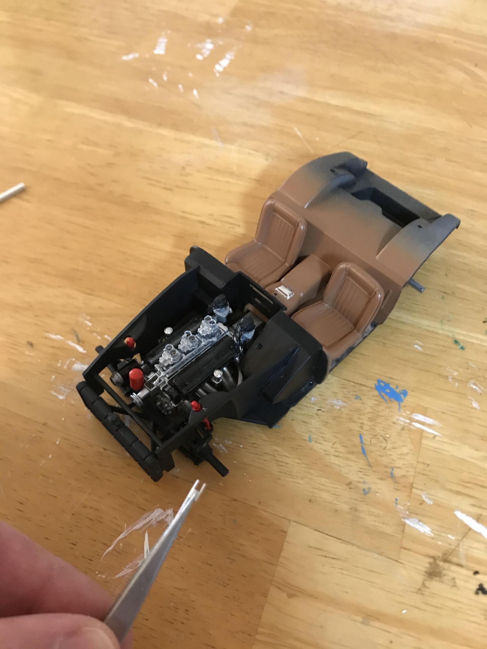

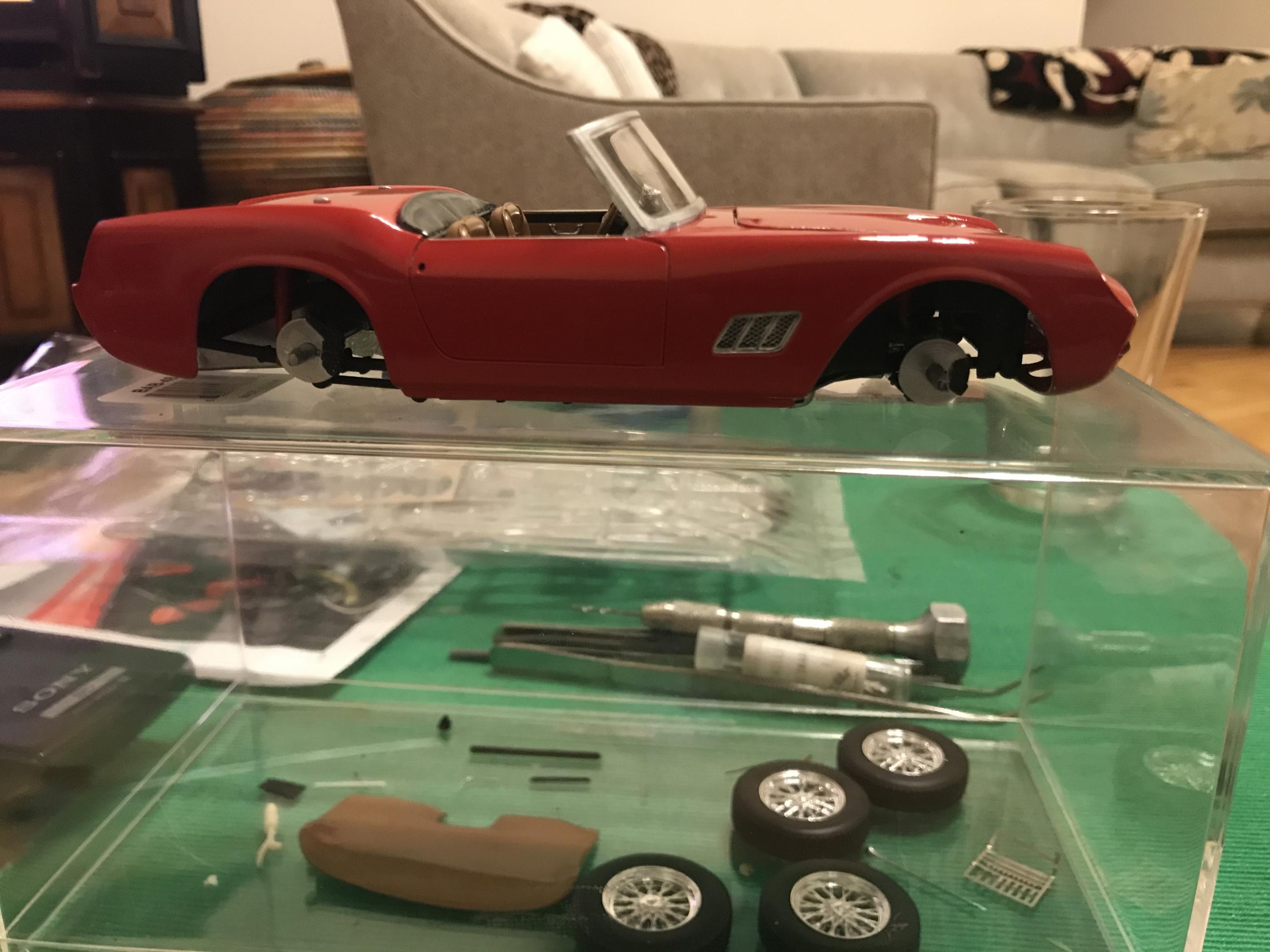

TC Posted May 23, 2021 Share Posted May 23, 2021 Italeri Ferrari model with replicas and miniatures of maryland interior, and carbs. Reshaped fenders. Headlights from Fujimi Dino. Windshield taken from burago 250 gt California kit Quote Link to comment Share on other sites More sharing options...

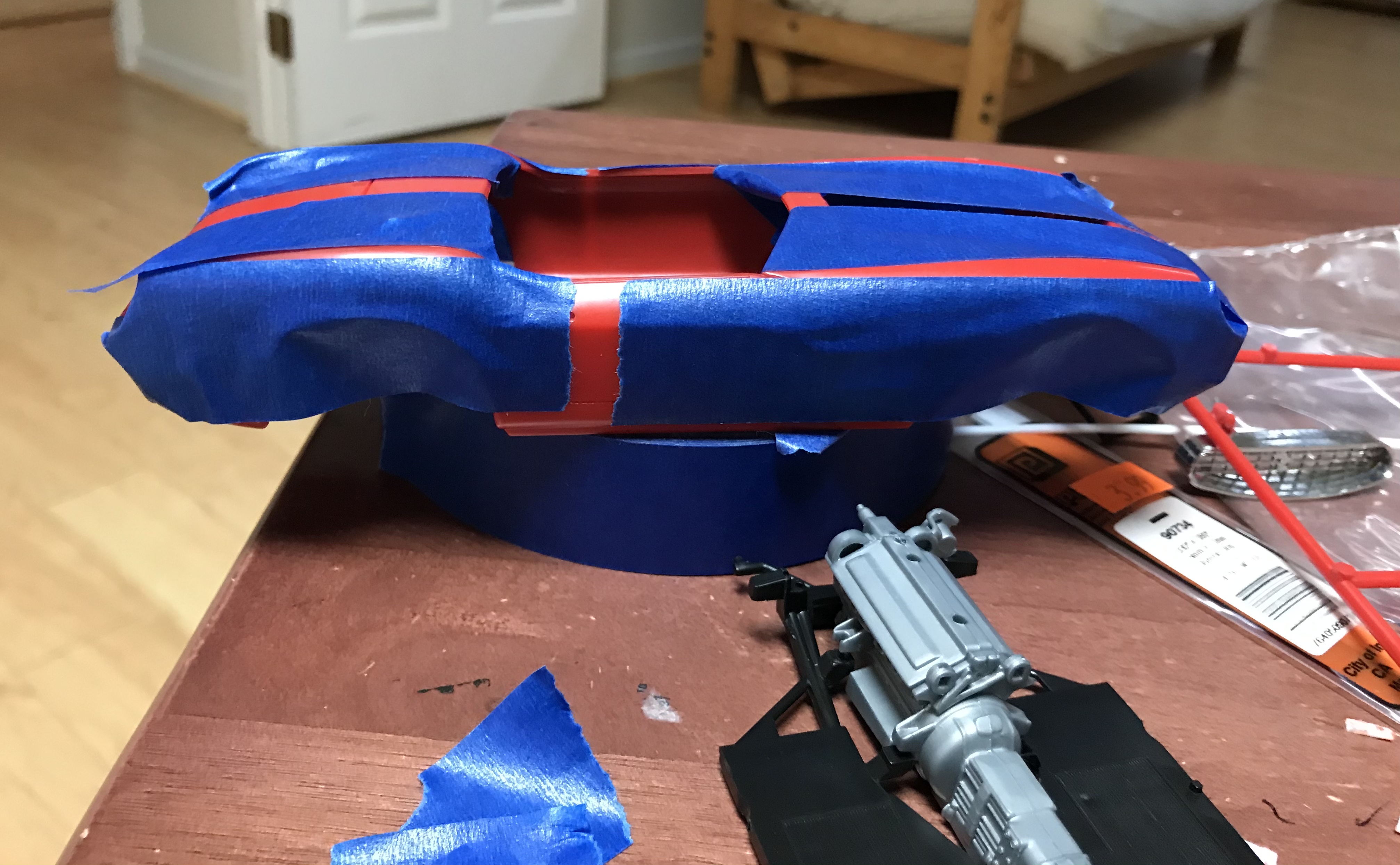

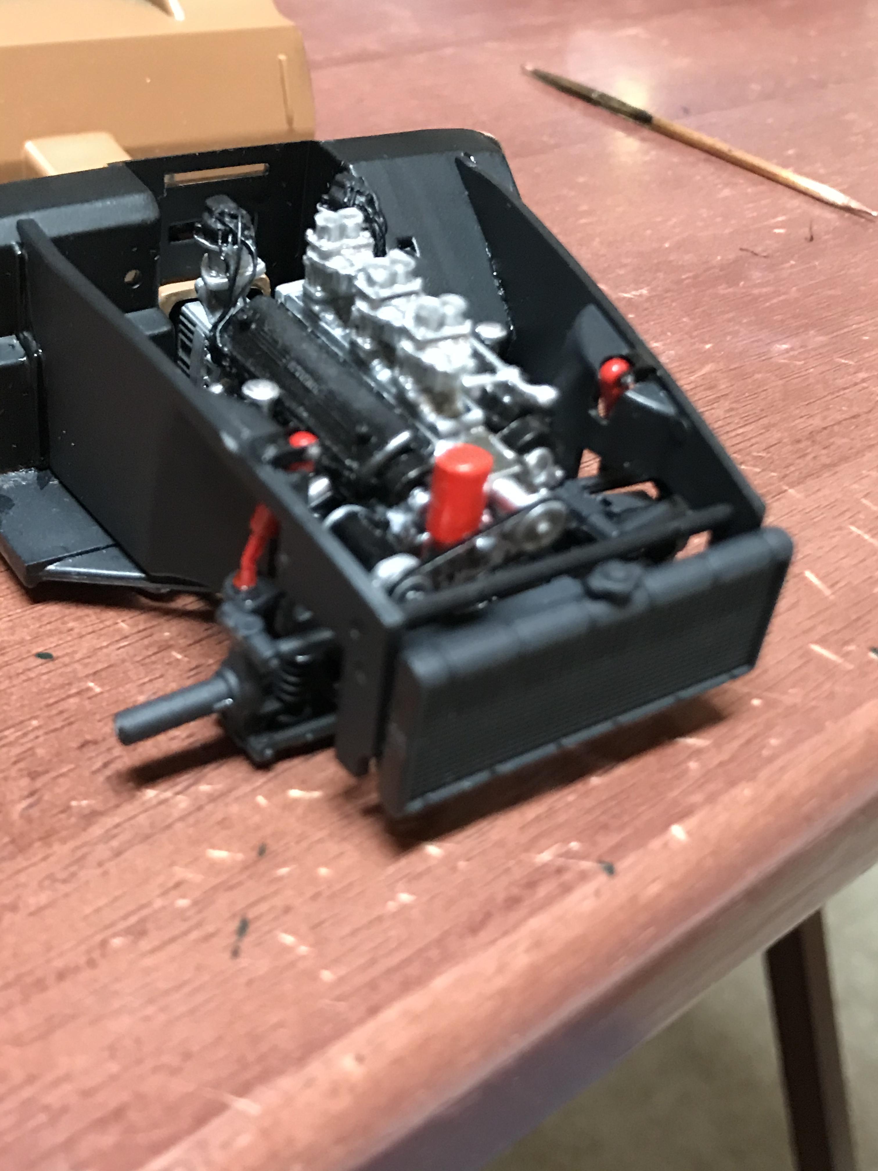

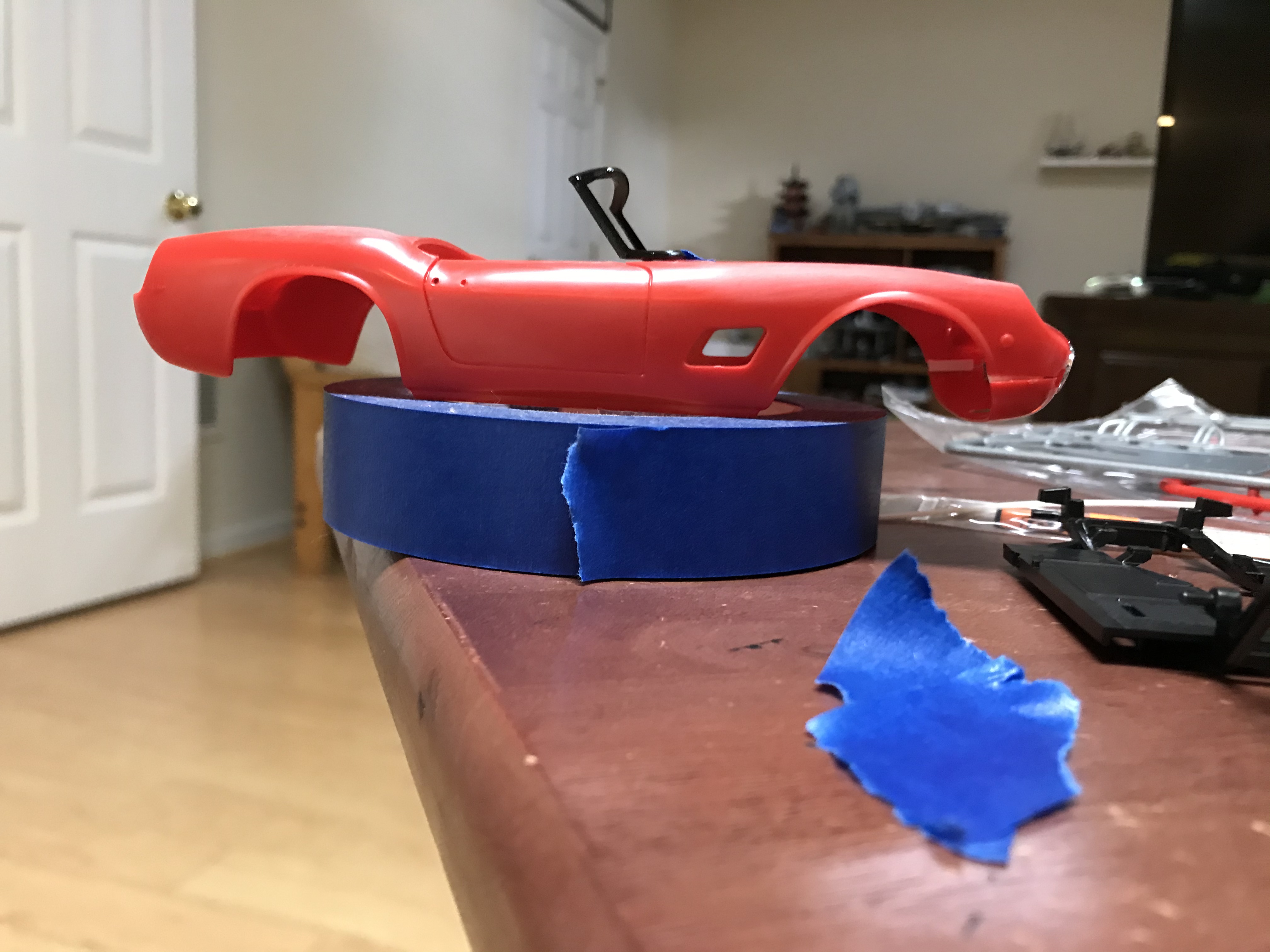

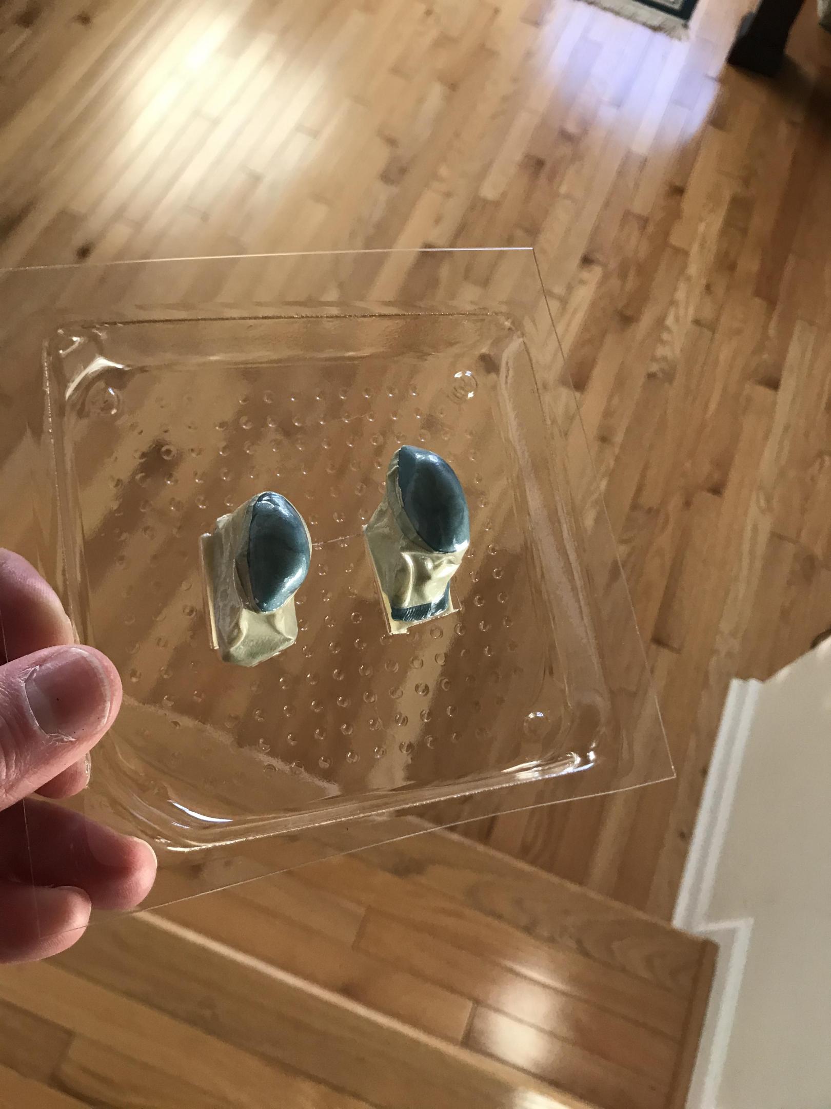

TC Posted May 23, 2021 Author Share Posted May 23, 2021 Pictures taken along the way. Shaping body, making shock “towers”, linkage Quote Link to comment Share on other sites More sharing options...

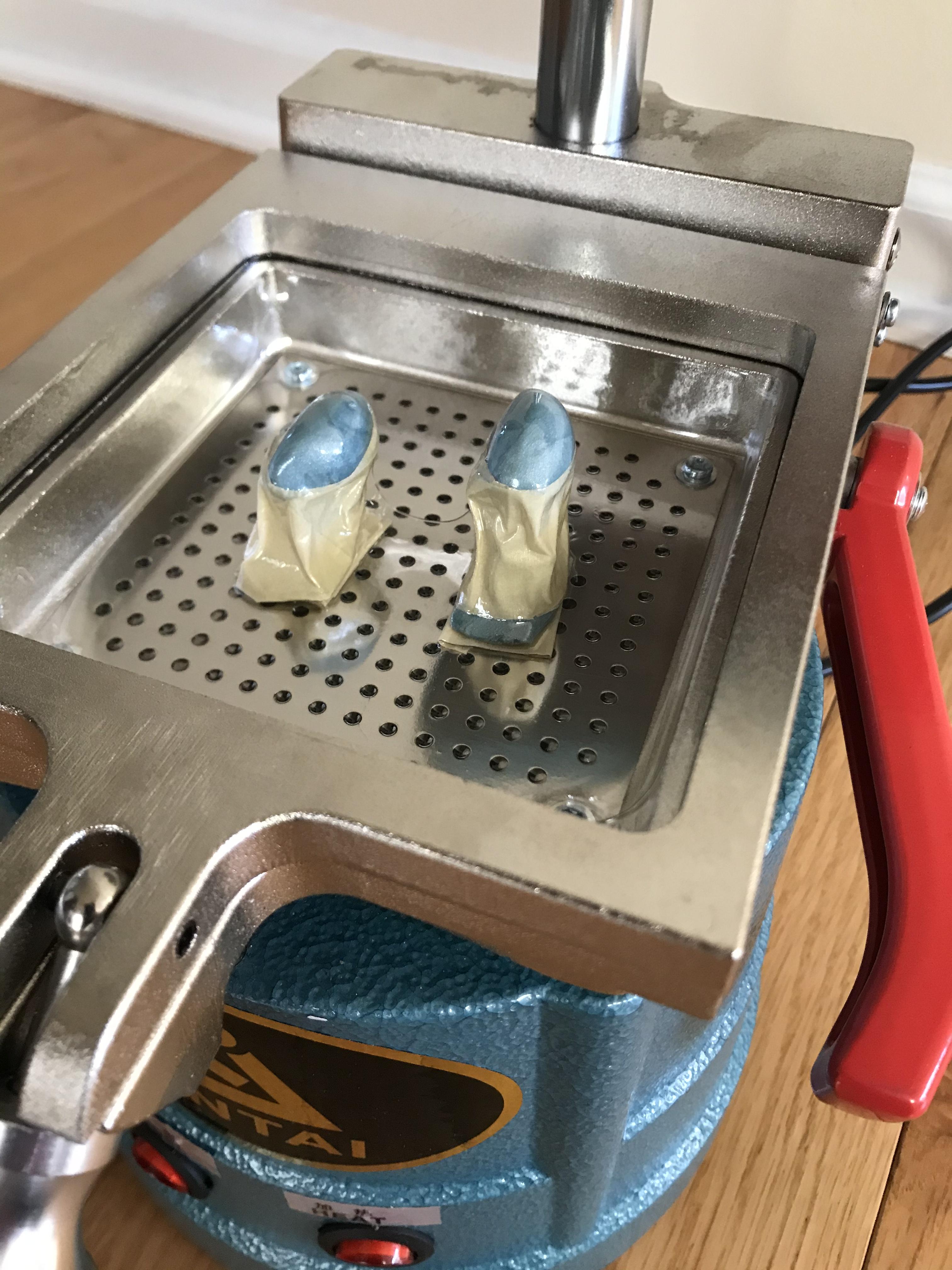

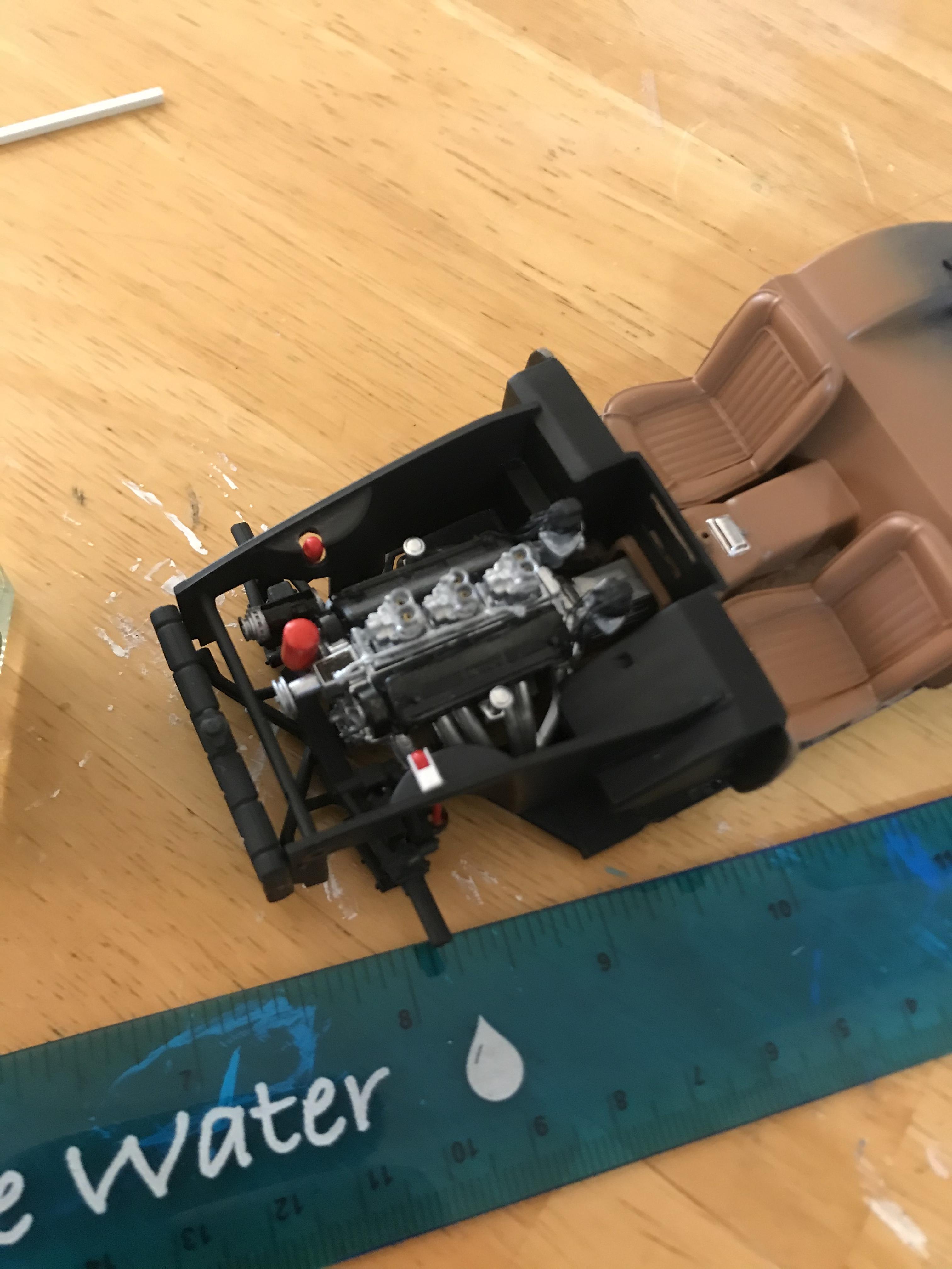

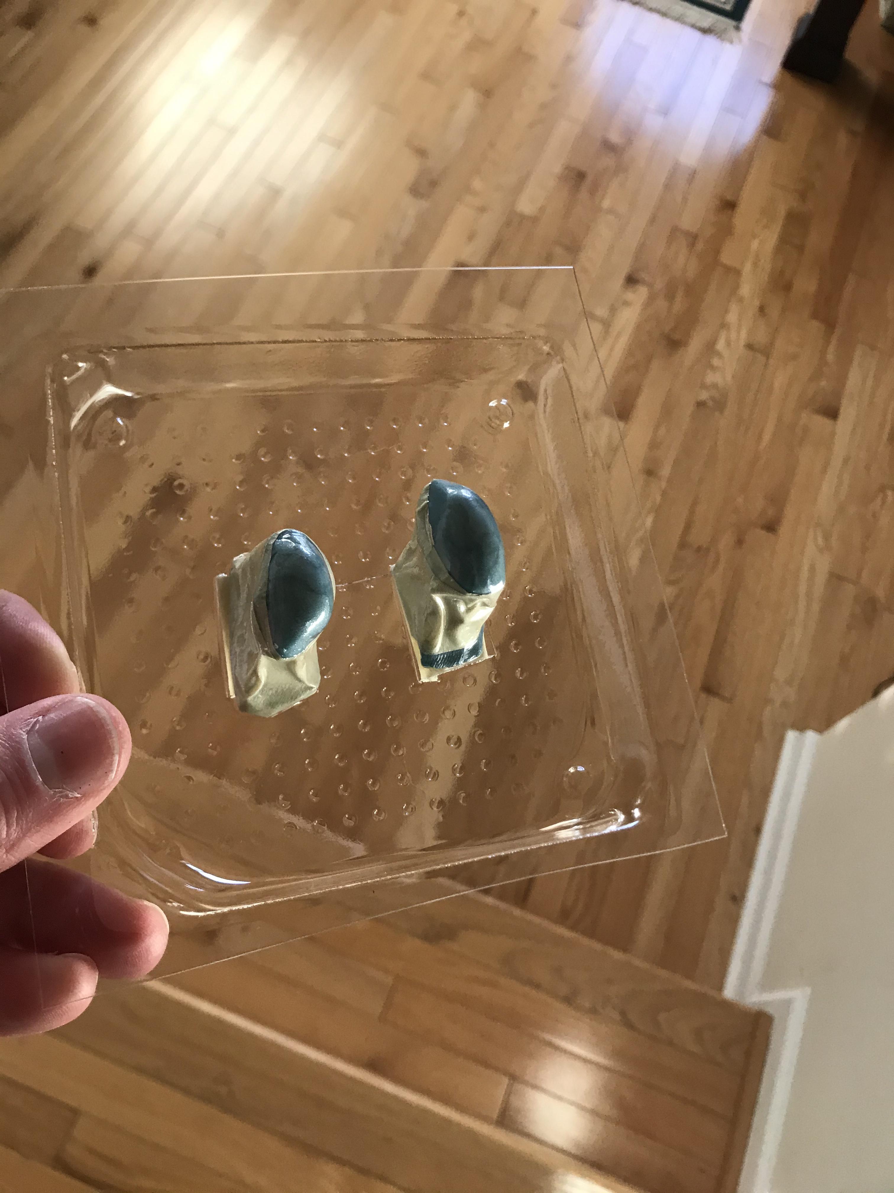

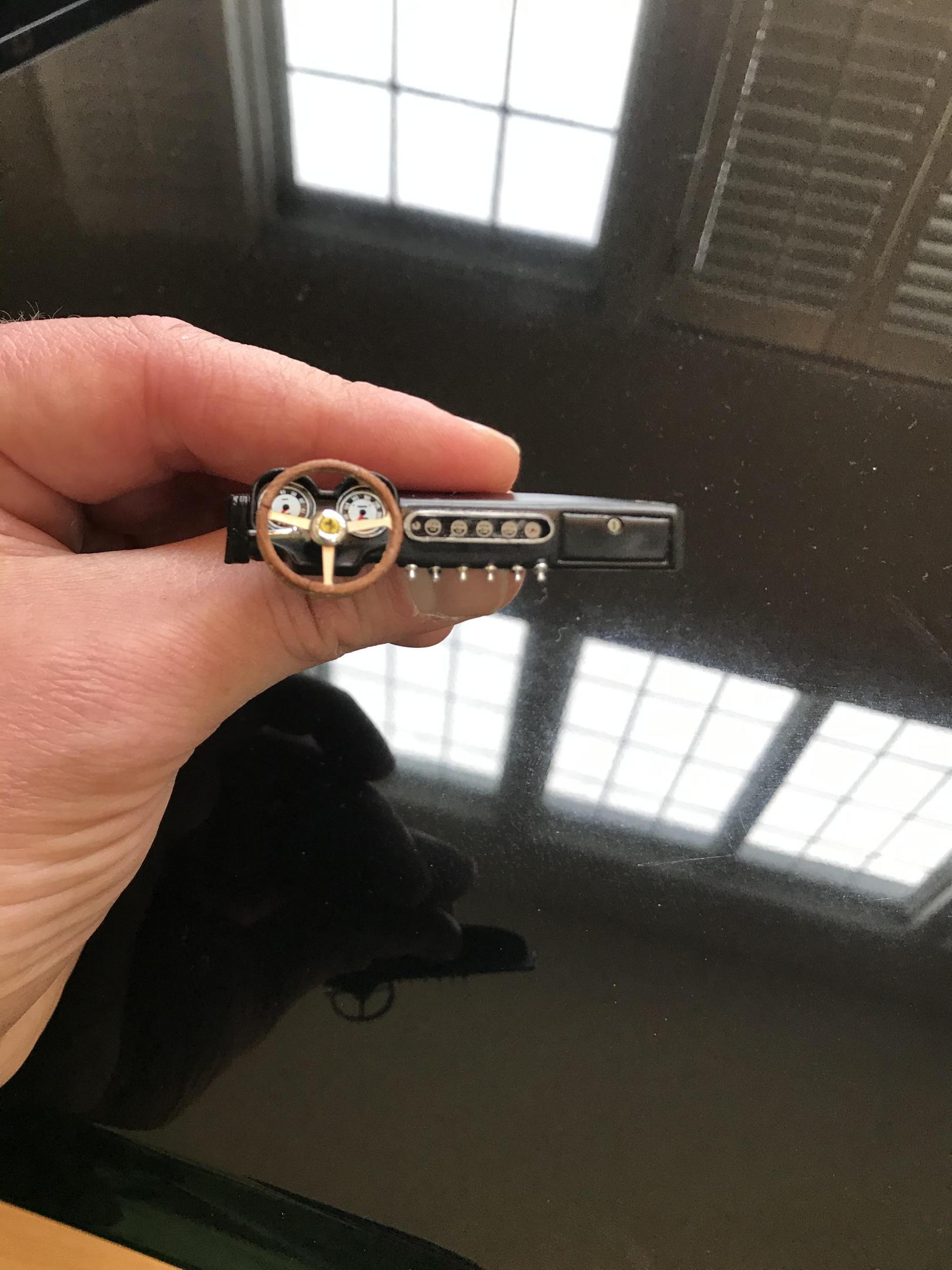

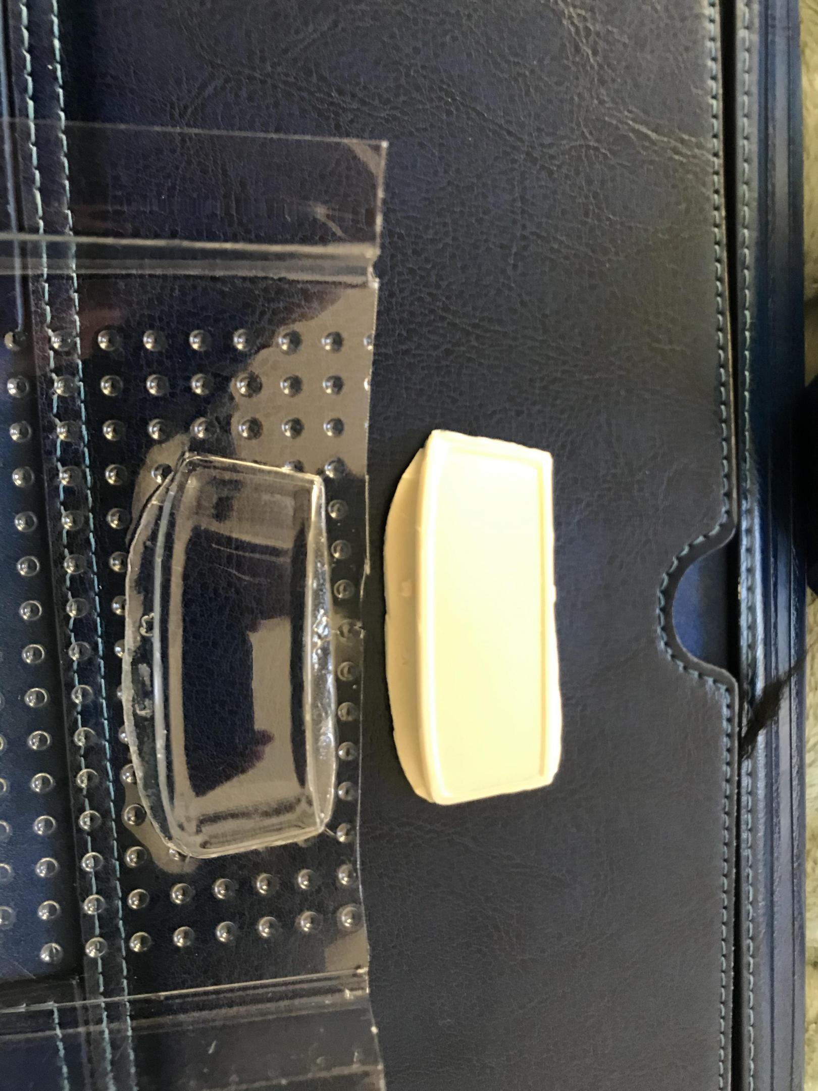

TC Posted May 23, 2021 Author Share Posted May 23, 2021 Dashboard, making future headlight covers. Casted windshield for future builds... Quote Link to comment Share on other sites More sharing options...

MrObsessive Posted January 7, 2022 Share Posted January 7, 2022 Another one of my Ferrari Favorites! This is looking great and especially the windshield you vac-formed looks really good! 👍 My vacuformer has been a lifesaver from rescuing what might have been stalled projects. There are those types of windshields that simply bending clear stencil sheet won't do. Your engine is looking very nice as well, and those carbs that Norm made make a huge difference. I was able to get one of the last complete V-12 engines he made as I wanted one for my 250 GT..........one of the nicest made engine kits ever done, and certainly require a LOT of patience to build. Keep up the great work! Quote Link to comment Share on other sites More sharing options...

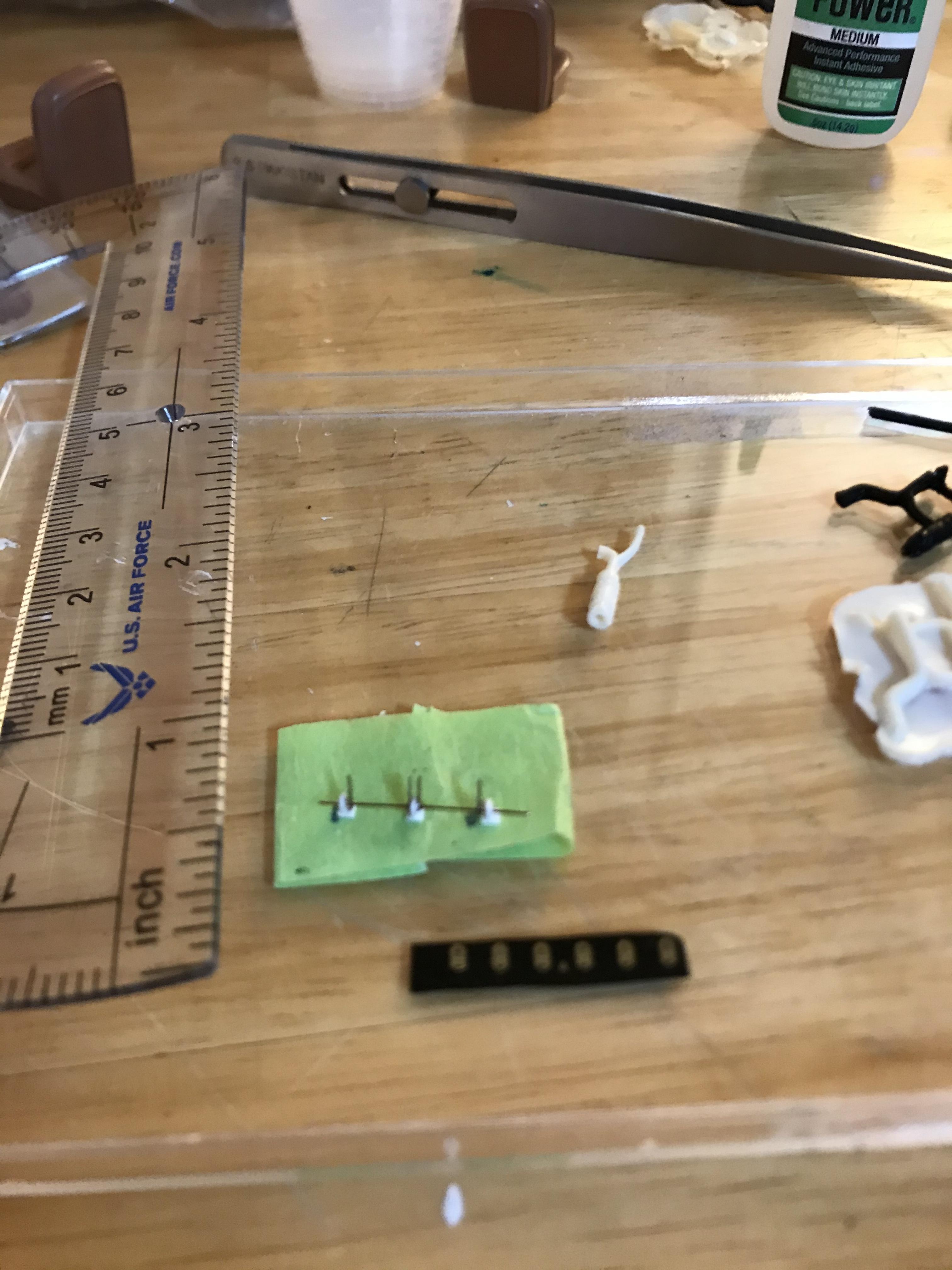

Bernard Kron Posted January 7, 2022 Share Posted January 7, 2022 Beautiful work on a subject deserving of the car, skill and commitment you are giving it. Bravo! I have this model sitting in a box at 60-75% completed. My project sticks very close to the kit. I, too, ordered the correct seats from RepMin and used them. My intention was also to get wire wheels from Fernando Pinto (I have used them before) if the results were up to par. The project was stopped because I haven't been able to properly drill the Marelli distributors to wire the engine. Any tips on how to get this done without trashing the parts? Are there are either pre-drilled or at least indented distributors out there? (I was thinking RepMin from the old motor kits - but Norm is res hopefully recovering so I don't want to reach out to him at this time). Any advice would help immeasurably. In the meantime I'll be following this project as inspiration. Quote Link to comment Share on other sites More sharing options...
TC Posted January 10, 2022 Author Share Posted January 10, 2022 For my distributor wires I pick a bit equal in size to my wire. Carefully pick where I want the wire to go on the distributor and then twist forward and back to get my start before drilling forward rest of the way. It can be tedious… Quote Link to comment Share on other sites More sharing options...
